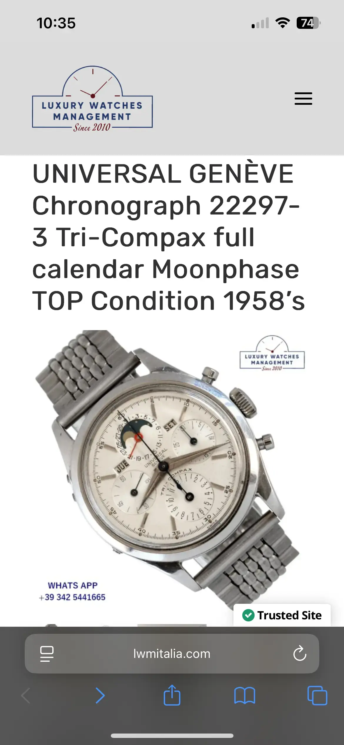

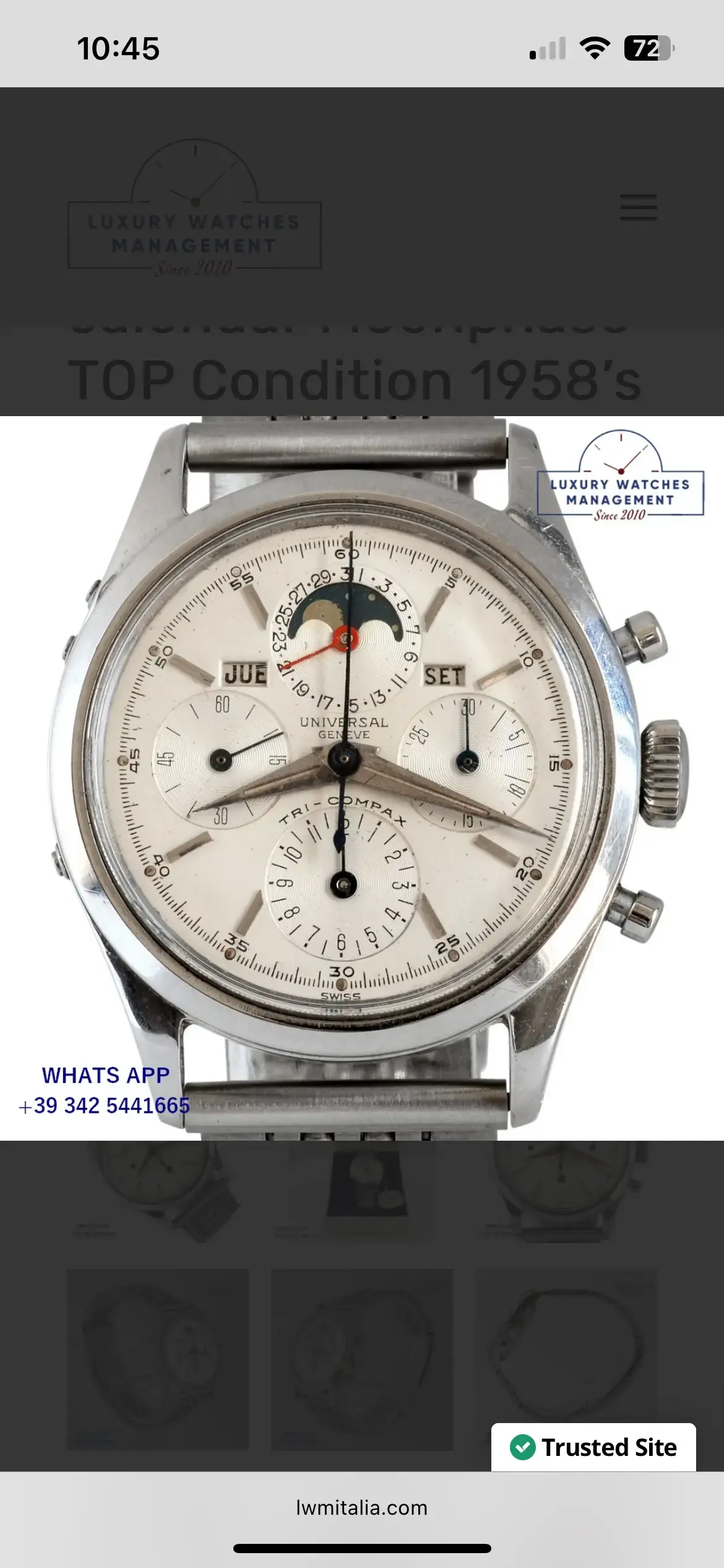

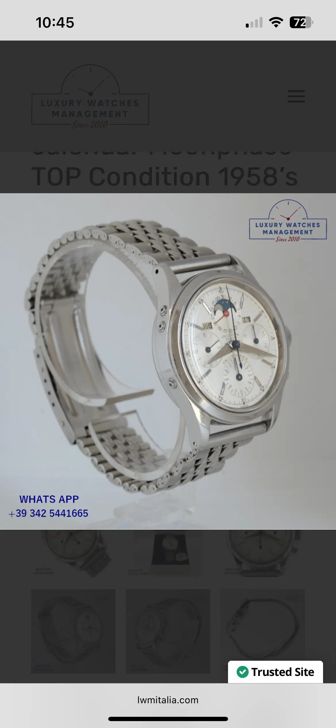

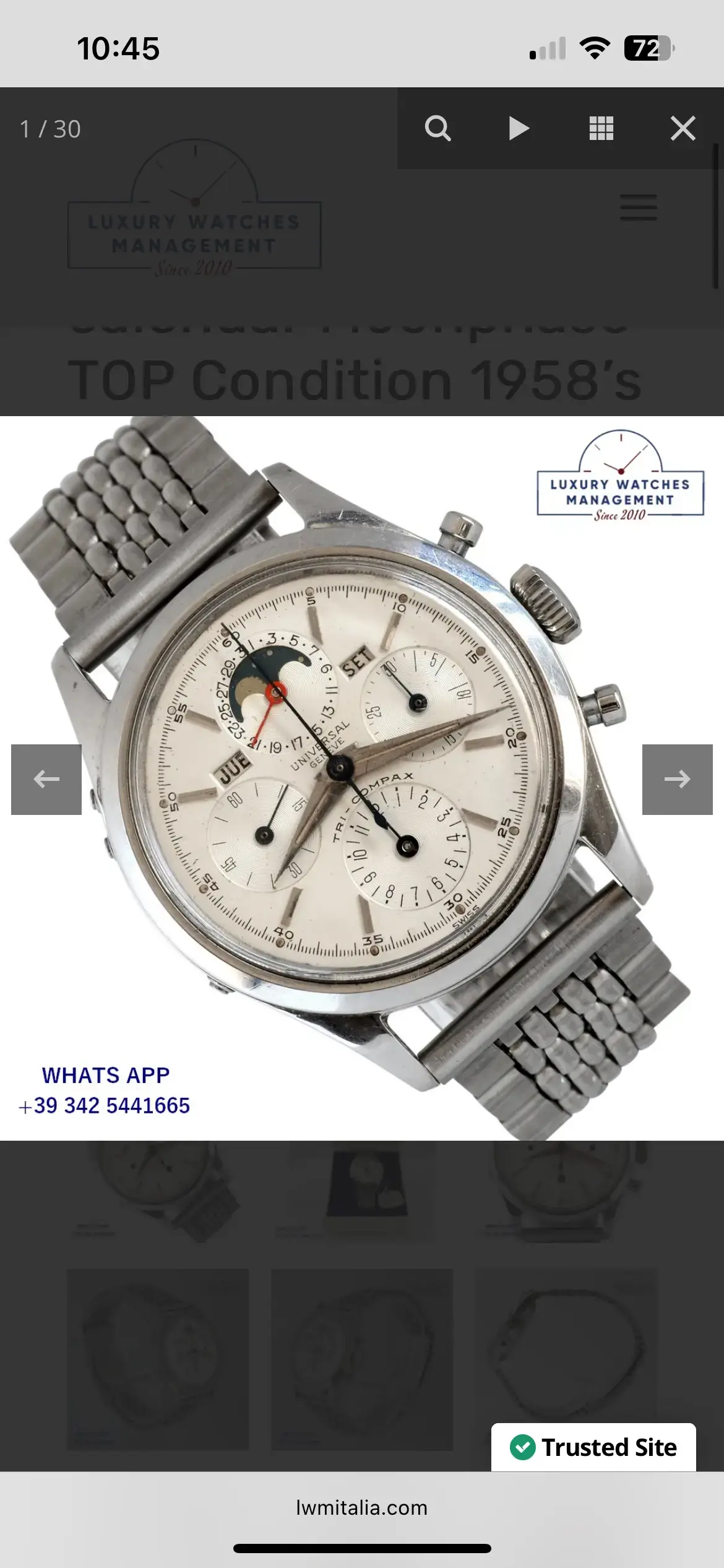

Hey folks,

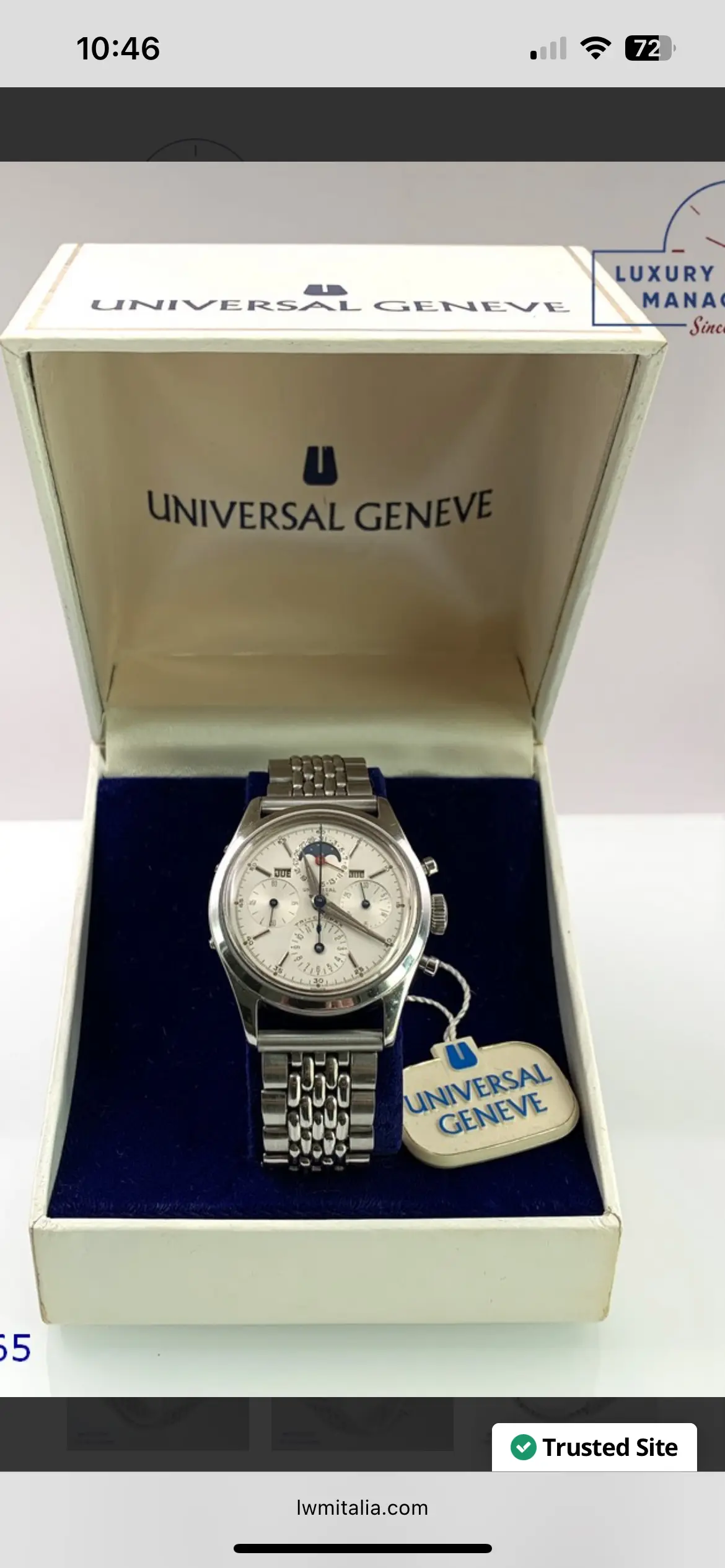

Rather new to the world of tricompax and wondering if there are experts who can assess this for me.
As a longtime vintage watch collector, everything seems in order but I'm not too familiar with the ins and outs of these watches. Anything jump out at you?
I'm attracted to it because of the bracelet. It's a bit higher in price than others I've seen offered but I haven't seen any of the 22297's selling with a seemingly original bracelet:
Thanks!
https://lwmitalia.com/watch/univers...-full-calendar-moonphase-top-condition-1958s/
3,629
8,389

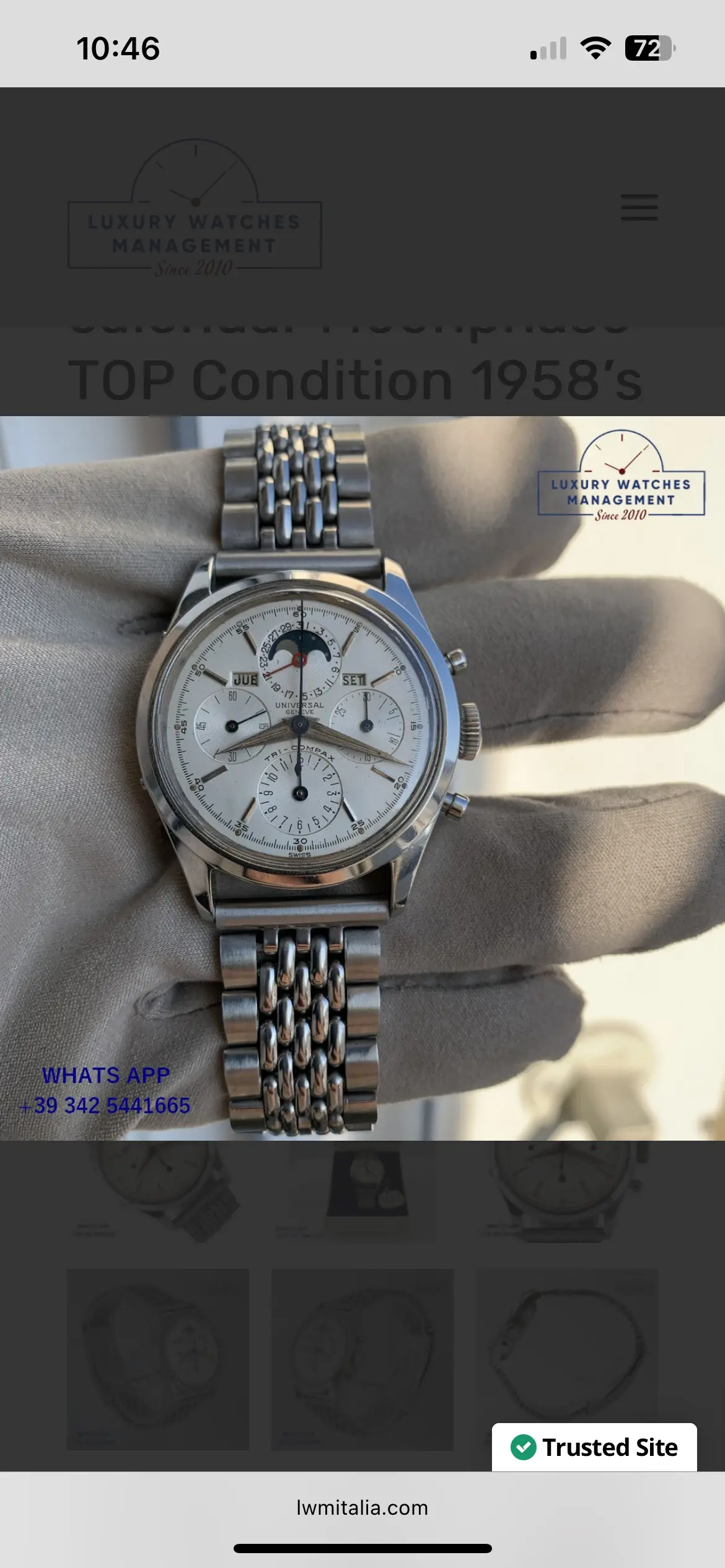

You should post pics not just links (for the MB watch).

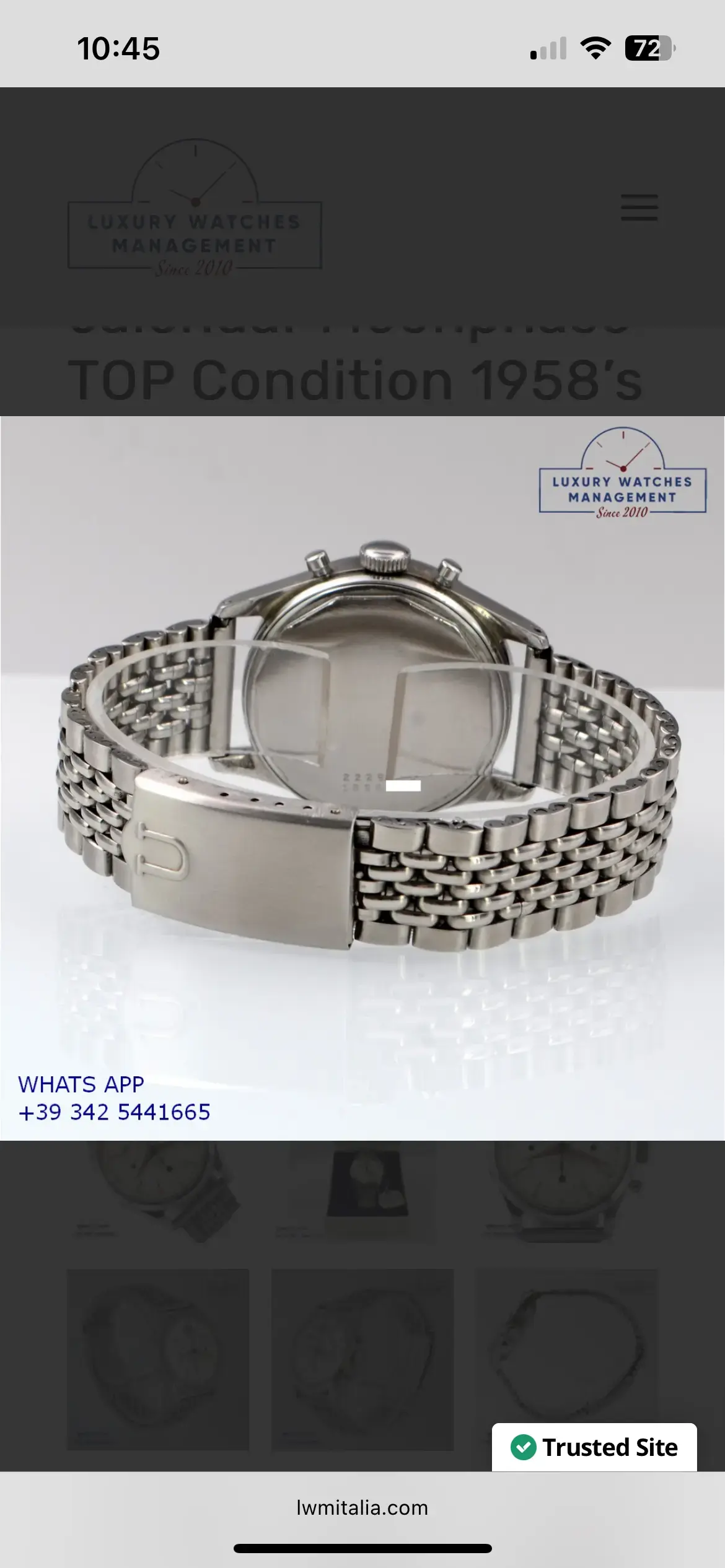

The LWM (first watch) looks fine to me offhand, I didn't do a super detailed review. That does not look like a UG bracelet, it's a very weird U logo that I have not seen and the clasp is not correctly signed, so I would assume its just something put together and would not assign any value to it. The watch looks nice overall, I'm not really tracking market prices to be able to comment on that.
The MB watch also looks nice, interestingly that's a short indice dial and the first example is long indice, which I think is more typical? I don't know enough to be able to comment on that. The case looks a bit polished on this example, and the dial not as clean, but overall still a nice watch.
Crowns are not signed on either example, and I would expect to see a signed crown.
not sure that box is original to watch on the first example, Fat U is a bit late for this serial? (can't remember the exact crossover, I could be wrong).

Thanks for the reply! I was very unsure of that bracelet as well. Seemed odd to not have any manufacturer stamp. I like the looks of it, but something didn't add up.

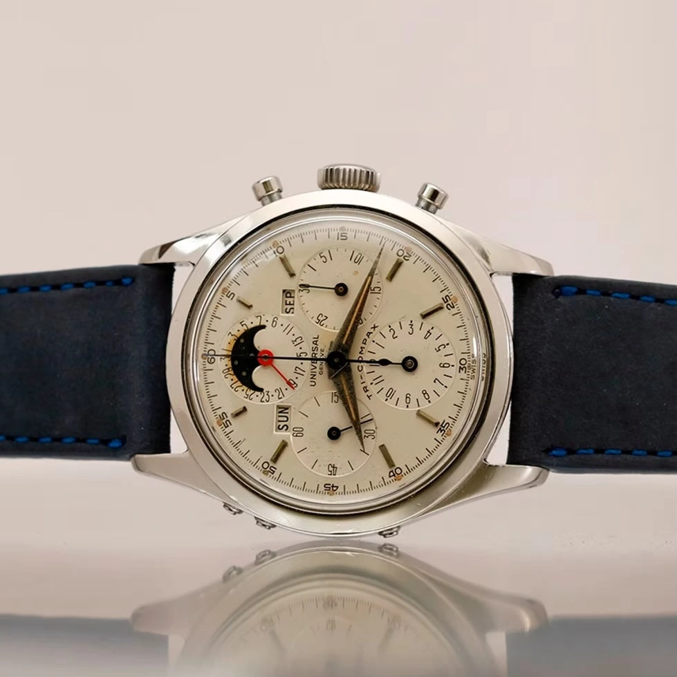

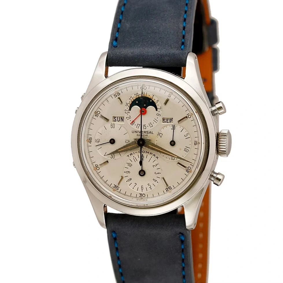

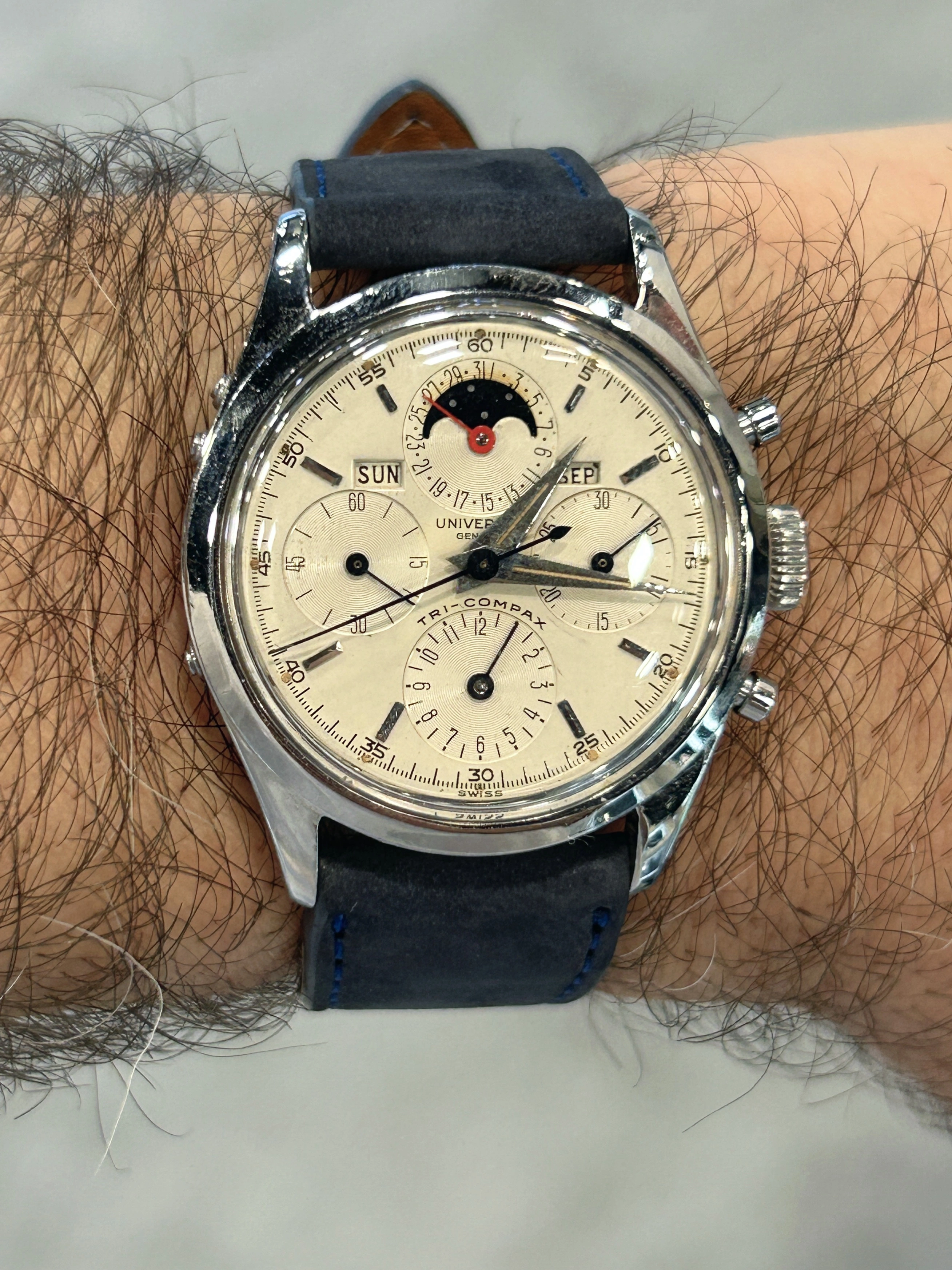

My mistake not adding photos. Here's the Bain Watch.
I actually prefer it, not just for price but because it's in the USA, has nicer aged lume and of course has English day and date.

I love the tiny pushers. It's one of the main reasons I'm attracted to this reference. I also think I like the straight batons of the -3 better than the other two.
One question about the Mathew Bain one is, as was pointed out by bgrisso, why are the indices on the 11:55 and 12:05 spot so small. I haven't seen those on others of this reference.
Other than that, the dial looks solid.
It's not just those two, it's ALL the indices. You would need to do a deep dive on 22297 to research, I have vague recollection we've discussed this before, but I can't remember offhand. I don't think we have great documentation on the 22297-X references in general, it would be great if someone flushed that out at some point.
I know that you mean about the MB dial, it does feel a bit warmer. I like them both for different reasons.
13,763
53,692

I think it’s fine, the indices are still symmetrical.

To be clear, is the Bain UG one to stay away from?
Also, what are my odds of finding a bracelet for this thing if I get it?
I'm trying to weigh that into the cost. Even if I pop on a vintage gay freres without a UG stamp.
More likely than not I plan to wear it on a private eyes GF style bracelet.
13,763
53,692
No … They are both fine. What I meant was that the dial configs in this series were unique. Re Bracelet … you could try for GF but an after market would work fine. Mine is strapped with a Hermes style.

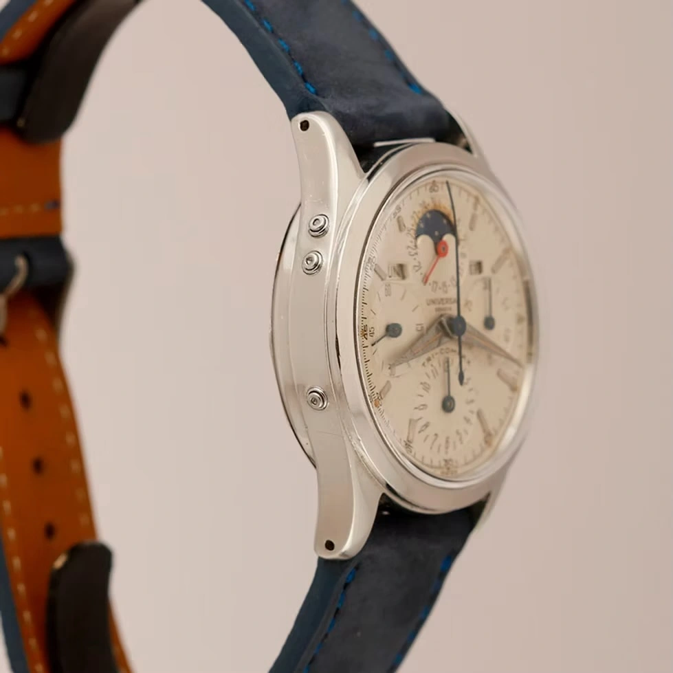

I had considered the Matthew Bain 22297 over 3 years ago (yes it's been on sale that long, possibly longer) and had even discussed it with @bgrisso rather extensively back then.
Everything seemed to check out fine except the slight stain above the moonphase and the inexplicable shorter hour markers at 11 and 1 (I've not seen another example with that anomaly since). There was also another remark about the 9 on the date subdial being open or closed, but nothing was conclusive about that discussion.
On the whole, it's looks like a good specimen and worth considering in my view.

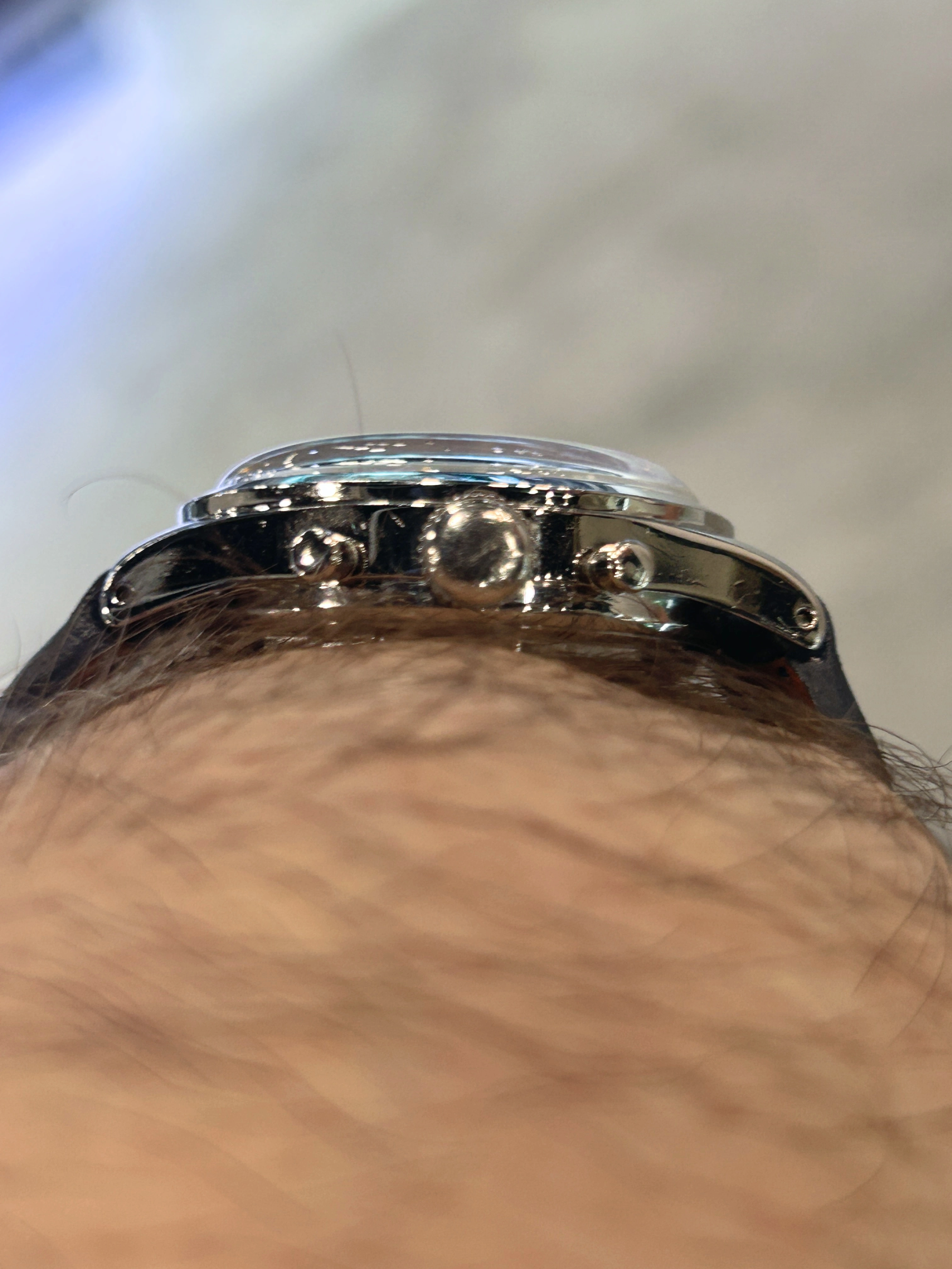

Hey everyone! Just checking back in. I was in Miami for the OMBAS show and was able to take a look at this watch in person.
I'm still considering the purchase and must say in person it is quite beautiful!
Talked to Matt Bain (seemed like a really nice guy) and he came down a bit on price.
Also said he'd have it serviced for me, and he even offered to source a signed crown....
Should this have a signed crown!?
I have seen some with them and some without. I can only assume those without (like this one) have generic replacements.
The dial looks good under scrutiny, and I would say it's an attractive example.

Looks pretty nice to me. I assume should have a signed crown. If you a price break plus signed crown plus a service, seems like a good deal to me, especially with the kind of asking prices you see these days on UG (with the pending relaunch).
Maybe close the deal before the 8th, in case prices surge with whatever the pending announcement will be 🤣
