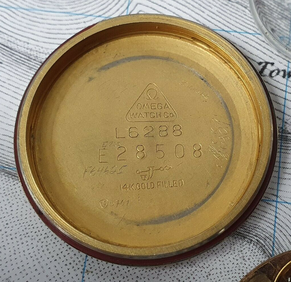

Although, I have a strong suspicion this caseback does not belong with this watch. Does the "E" denote that it is electronic?
The caseback is gold filled, the mid case appears to be stainless, but I think it's all due to lighting.
This is an American produced case made by Jonell Watch Case Company of Long Island New York.
The E has nothing to do with electronic, it's probably an inventory number, the model number is L6288.
The watch has significant rotor bush/axle problems, I didn't look at anything else.

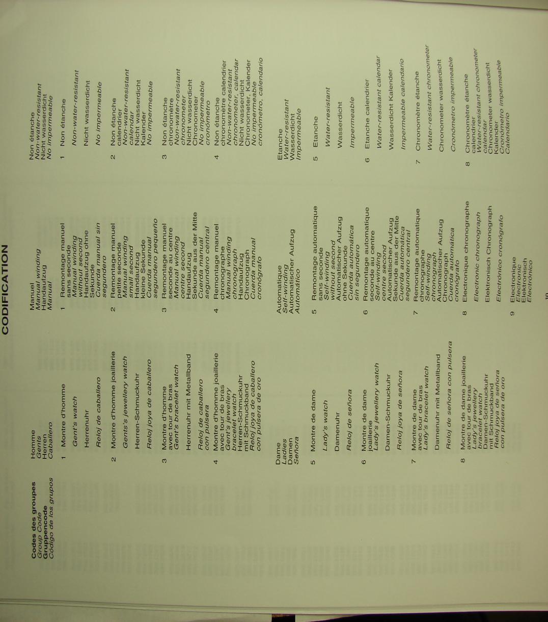

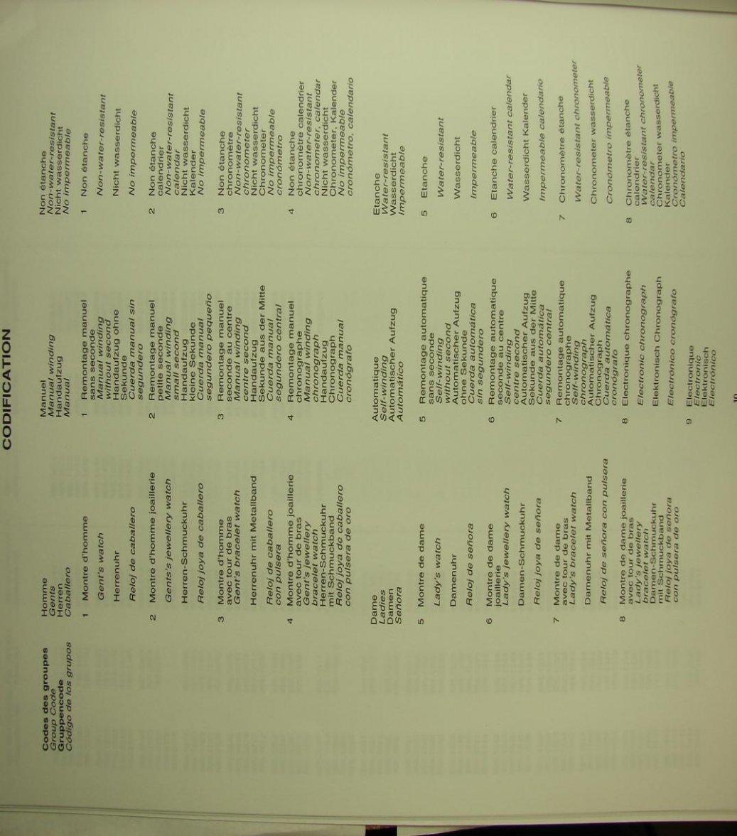

Please excuse my lack of experience but....E28508 is the lower # @JimInOz but, the 1st three #'s 285 of 28508. It is my understanding (perhaps mistakenly) that "2" denotes it is a "Gents Jewelry Watch". "8" denotes it is a "Electronic Chronogragh" and the "5" denotes it is a "Water Resistant" . This as per the attached photo of Codification. I am new and trying to learn. If I am missing something please let me know.

I think you are looking at a chart for more modern reference numbers.

The number beginning with E is a case serial number and nothing more it has absolutely nothing to do with the type of watch. Furthermore this is, as previously noted a US made case so any reference charts you might find are meaningless since they will always reference ROW watches, not US cased pieces.

Omega has had 3 or 4 reference systems in the past 70 years, that is not the era for the watch you are asking about.
