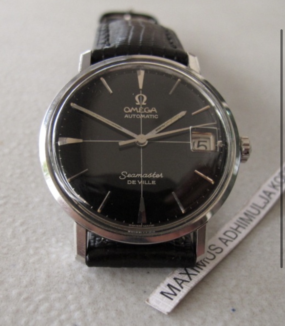

This is a DeVille / pre-DeVille dial variant I often see with a crosshair. Here are some examples that look okay to me. I’d want better photos of the one above of course (same with the second below).
https://www.ebay.com/itm/274095814159
http://www.maximuswatches.com/2015/07/omega-seamaster-de-ville-black-cross.html?m=1
146
600
So some Seamaster DeVilles DID have (original) crosshair dials?
Others here seem to think not.
Confusing ???? 🤔
1,117
1,791
The first ones a redial imo, fonts aren’t quite correct and the automatic text is poorly aligned with the Omega logo. Not sure about the second one as photos aren’t good enough.
