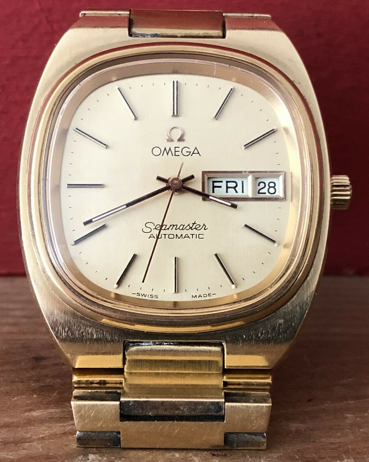

This is currently going for a good price on eBay. I've only seen gold filled versions with brushed gold dials before, but there aren't that many examples of these versions so I'm not 100% on all the real dial variants. What do people think?

jep-might be caused by the glass....from a distance:OK
But: check the S (Seamaster) again and length of the hands....

Thanks. Yes the S does look a bit ‘wide’/square and I had wondered about the spacing between Swiss and Made. I just don’t know how much variation there was in dials in the late 70s/early 80s. The Automatic position seems to move around even in Omega’s photos.

The Swiss Made doesn't bother me much but the S should be symmetrical top and bottom, and it's not.
That said, it's very good if it is refinished and if it's cheap and you like it, go for it.
