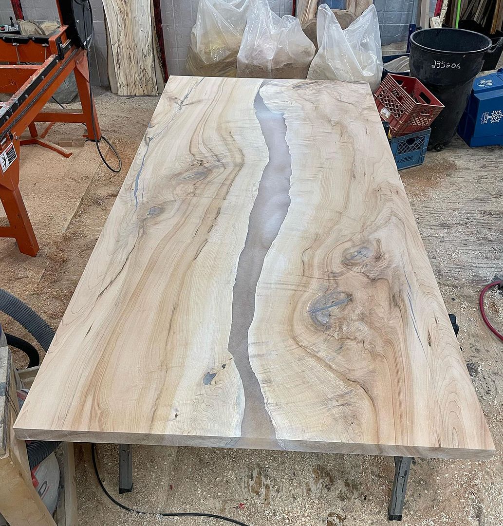

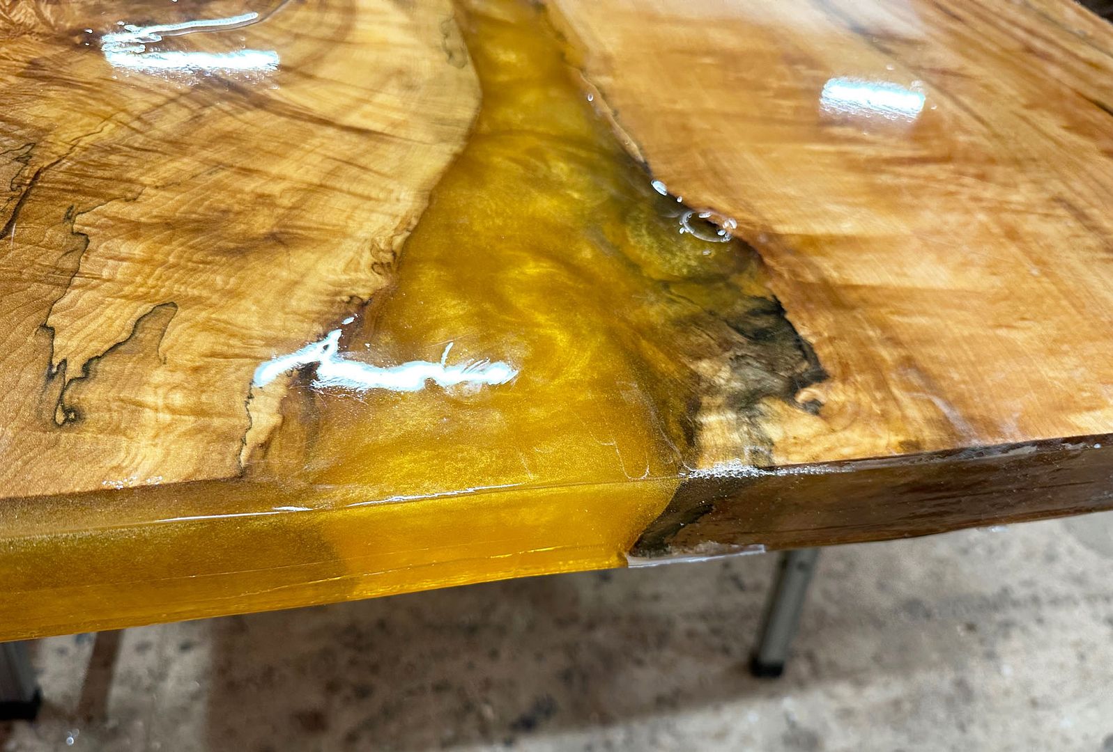

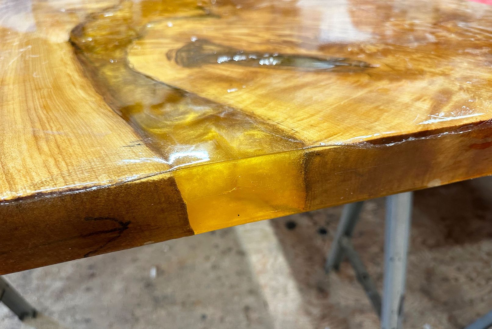

So, I thought I would share some photos of the unfinished table first. I had posted some photos just after the pour, and we visited a week or so later after it had cured, so here are a couple of quick shots I took then, just looking at the epoxy river:
So it looks more yelow coloured once removed from the mold. After the epoxy is cured, they use their router machine to remove the top layer of the epoxy, and to flatten the top again. Then the sanding begins - this is the underside of the top after sanding with 60 grit sandpaper:

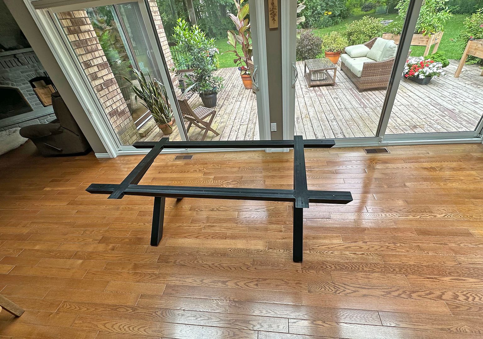

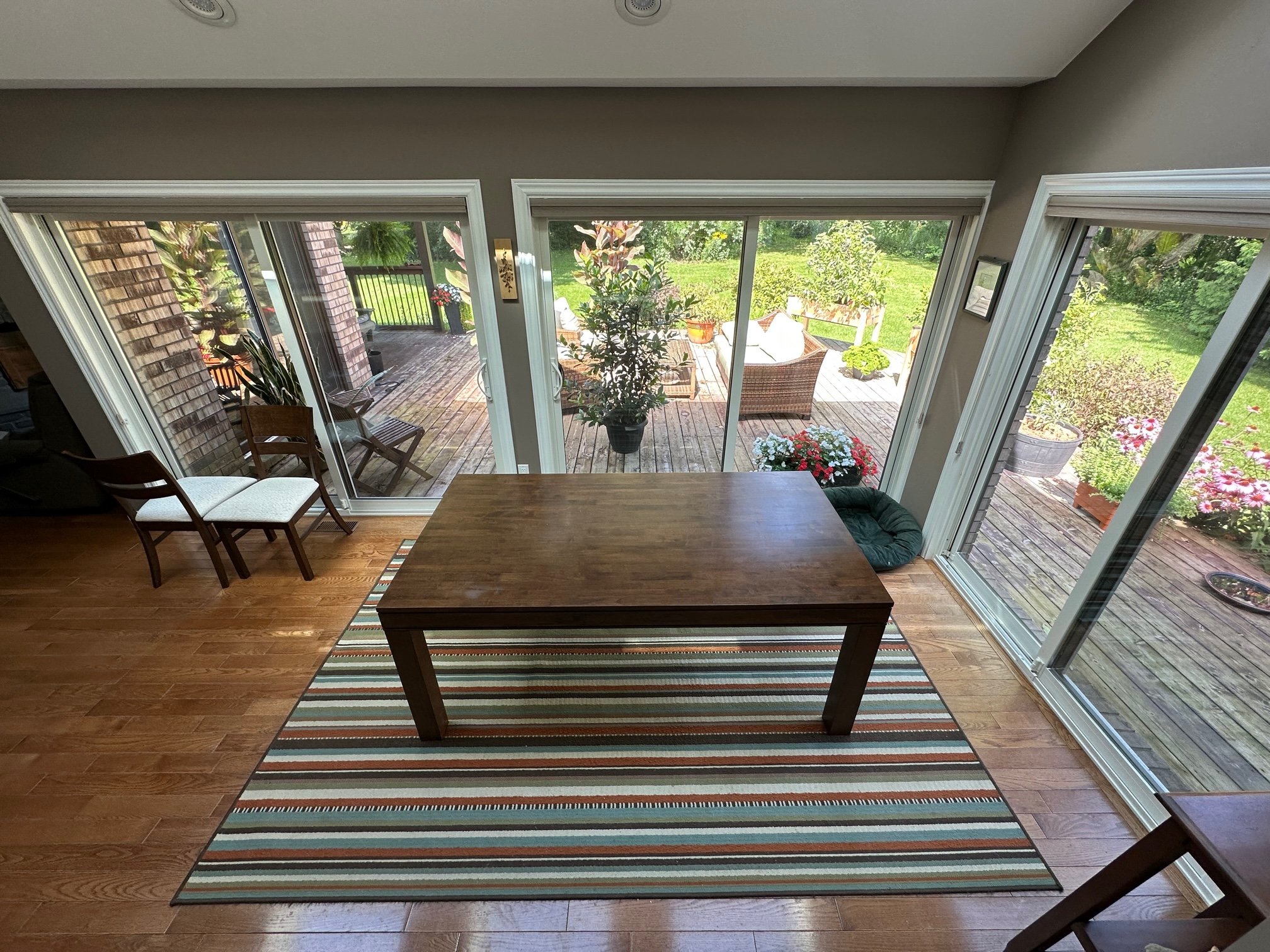

The owner is now back, and today it all arrived - here is the base:
The base is in the space:

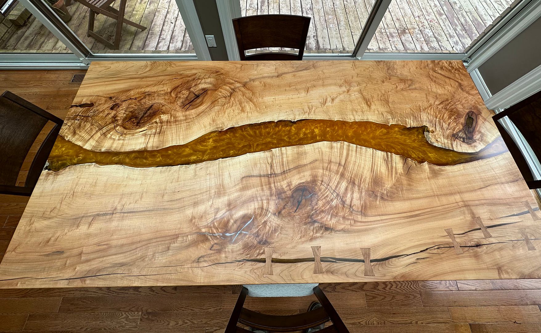

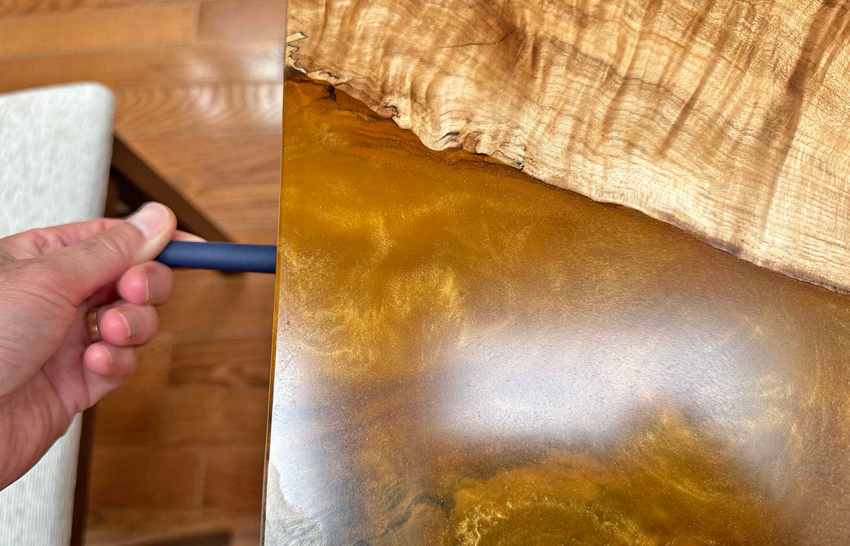

I'll show a few details before I post an overall photo...this is the final epoxy - it's gone from being more orange, to being more yellow, to now being quite amber - exactly what we were shooting for. It will change a bit in different lighting I expect, which is great. I am holding a pen under the area in question and you can see the shadow of it, just to give you an idea of the transparency:
If I put my hand under this area, I can clearly see my fingers - the photos make it look more opaque than it really is.

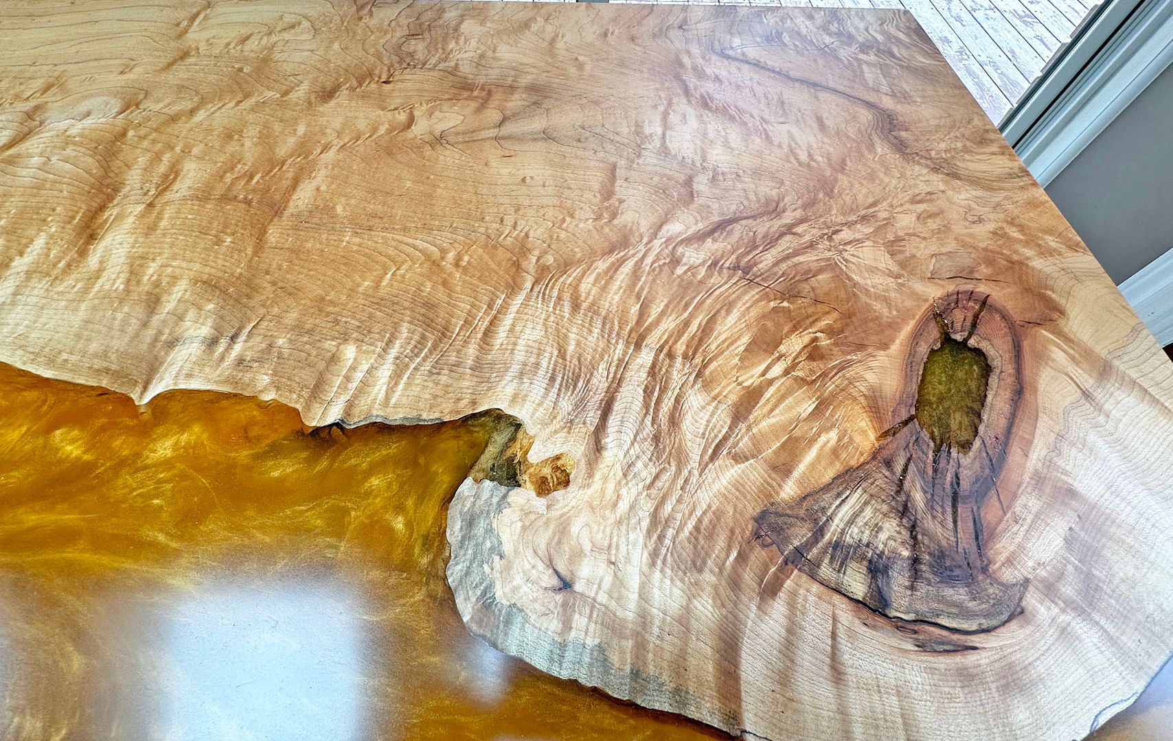

This is one of my favourite areas of the table - so much figuring in this wood:

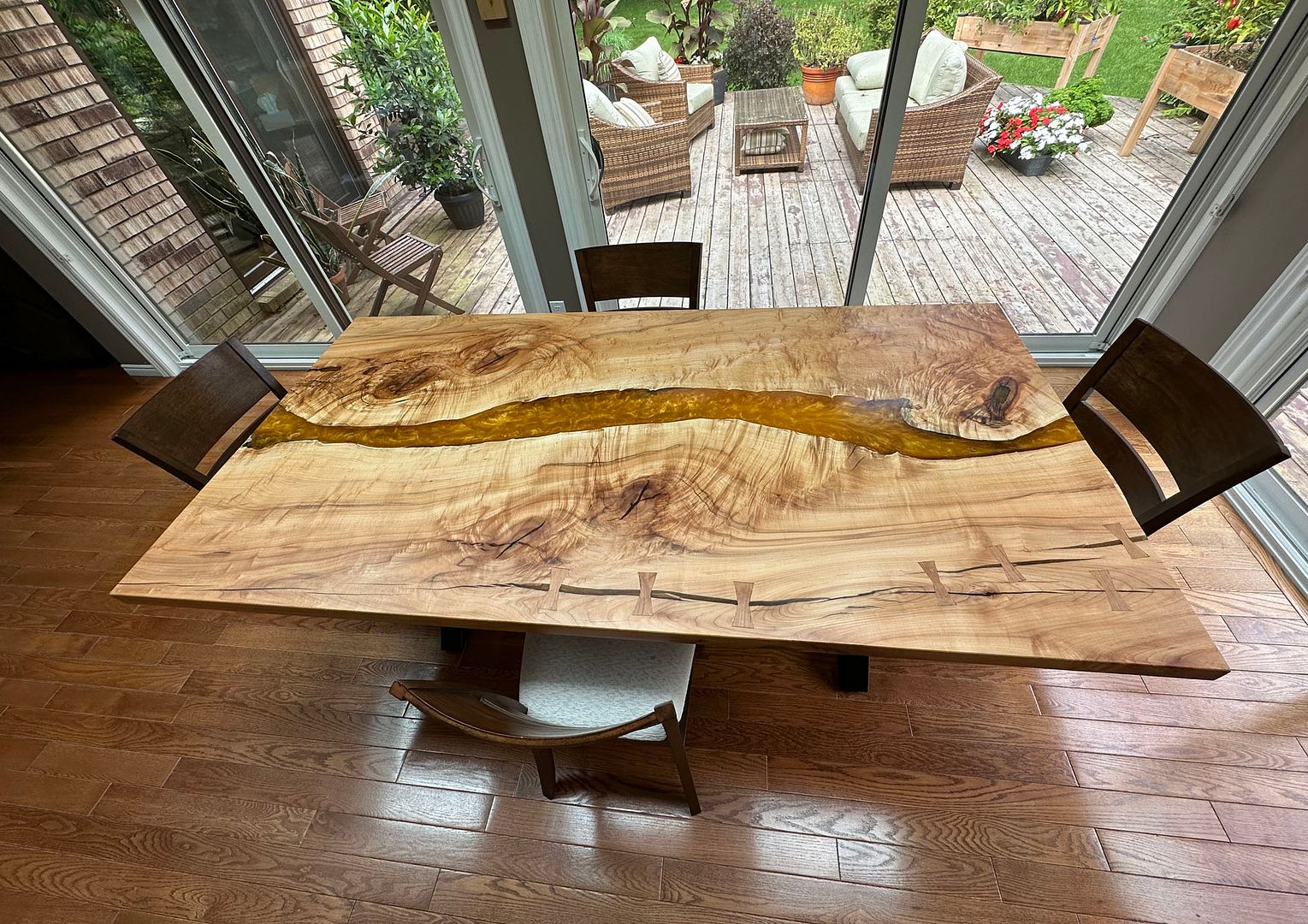

And here is the whole top:
We love it. It fits the space really well - and even the old chairs look okay with it:
We aren't done yet. There are a number of shelves being made, plus a wall hanging, and we are very likely going forward with getting that barn door in our bedroom replaced by one made from this wood. So more to come!

I really like all of the texture and variation in the epoxy, I wasn't expecting that. Looks fantastic.
The epoxy pigment had some metallic parts to it. During the curing process, heat is generated inside the epoxy, moving the metallic particles around, and leading to this pattern forming in the finished product.
