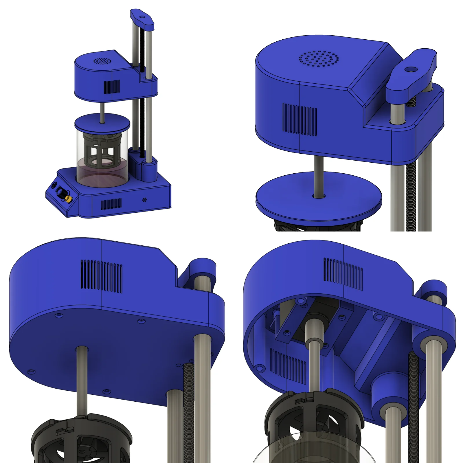

@GuiltyGear I do have one question about your product. Have you done anything to mitigate the EX risk associated with the use of the solvent based fluids? That in particular always makes me a little nervous with these vintage machines given the state of the wiring I have seen in some of them and presumably motors, heaters, cabling etc. designed long before this was really a safety consideration. Even worse when people are leaving solvents unsealed in a possibly poorly ventilated/confined space.
718
2,107
@AHW the KiwiCleaner is a different beast. It's a matter if you can justify the cost, space, and have the will to build it.
As for your safety concerns, totally valid. I'm a little paranoid in nature and that's been a recurring theme over the design process.
First off I'm using an external power brick. The machine receives 24v on the source and benefits from the supply's short and over current protection. Electronics are "sealed" inside the base. Plan is to use gaskets on control components and connectors, which also protect the machine itself.
There's 2 real points of concern:
  • Spin motor over the baskets where vapors could accumulate. Stepper motors don't have brushes so no arcs. The wiring won't have any stress points to rub or deteriorate. The lid over the jar will block some of the vapors from going up into the motor shaft.
  • Heating module. Two things can happen. First is the connection shorting, which now are magnetic pogo pins and I'm looking into making a safer design (no magnets). Second is the MOSFET failing open, which would leave the heating circuit energized. I was thinking to add voltage sensing through a divider, so I can tell if there's voltage when it shouldn't, but I'm running out of IO pins on the pico and space on the board.
Ideas are more than welcome here. I've tried to think about different points of failure, but I'm sure I haven't thought about everything.
I have no real justification for the Kiwicleaner other than I think it would be an interesting project, and I am sure a useful end product (and the same can definitely be said about your design). I ordered the X2D today so I will do a few test projects and see how quickly I learn the process. I have two young children so my hobby time/energy is quite limited, and the printer will probably be running full time on toy production so it will be interesting to see how it goes!
It wasn’t safety concerns with your design specifically as it looks very professionally and well thought out. As I am not an electrical engineer I don’t really have any specific suggestions, I just work in engineering in an industry where EX risks from solvents etc. are a big concern (and yet fires still happen occasionally) which is why I was interested.

Redesigned the head unit so I would stop fighting with the shaft and motor coupler. It's maybe not as aesthetic as the original version, and it's a couple of cm taller, but it increases the working distance and it's a straight descent; no visible coupler. On the latter, I'm using the same exact model on 3 places that need it: carriage motor coupler, spin motor coupler, and basket holder.
233
137
Did you find the old design would bind while lowering and raising sometimes? I don't mind the new design at all.
718
2,107
@CaliberKingPin no, it didn't have any binding issues. The bearings help and the motor is powerful enough. The issue was that I didn't have enough vertical clearance. This design puts the bulk of the head unit height away of the working area.
