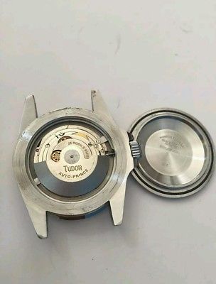

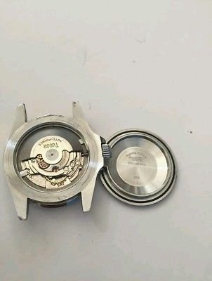

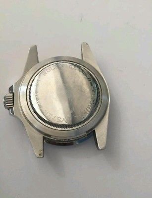

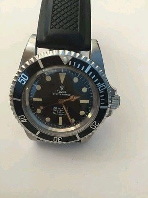

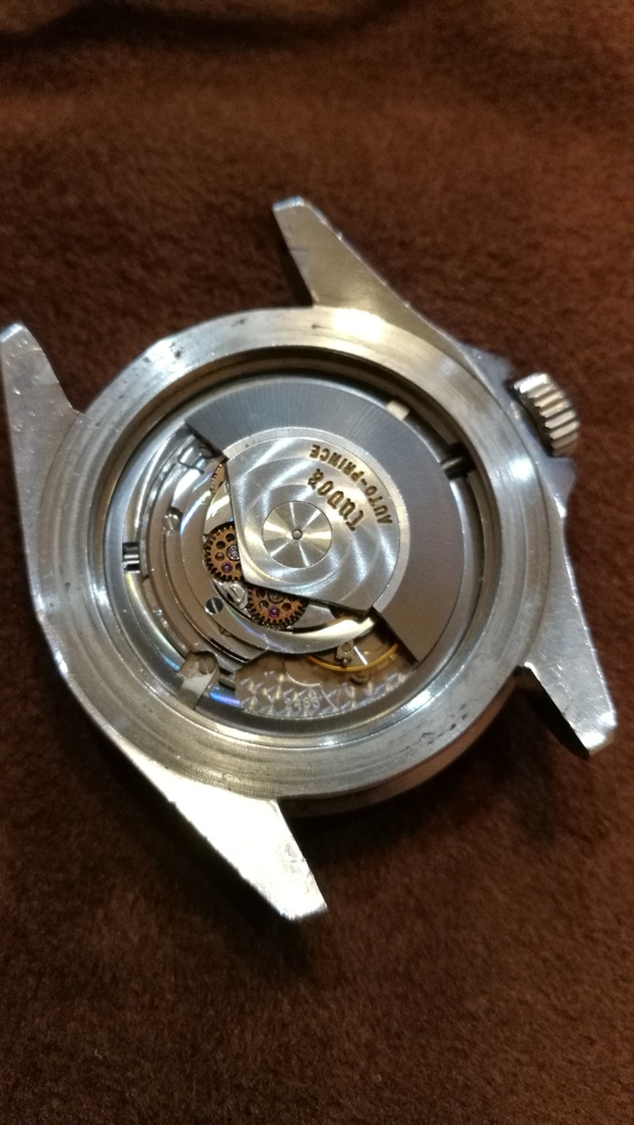

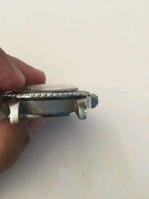

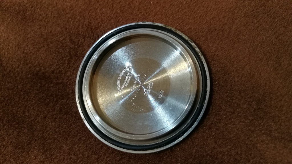

The caseback inner engraving is very different to any other that I've seen (Tudorsa) and also the 'E' engraving in Stainless Steel seems wrong, as the central crossbar is too long. All genuine Rolex and Tudor engravings had a noticeably shorter central crossbar in the 'E'. Also, the slash in 7016/0 should be sloping more than it is.
This all suggests that potentially the mid case, caseback, dial, insert and hand(s) aren't original.

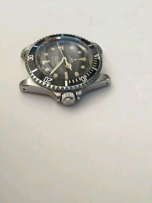

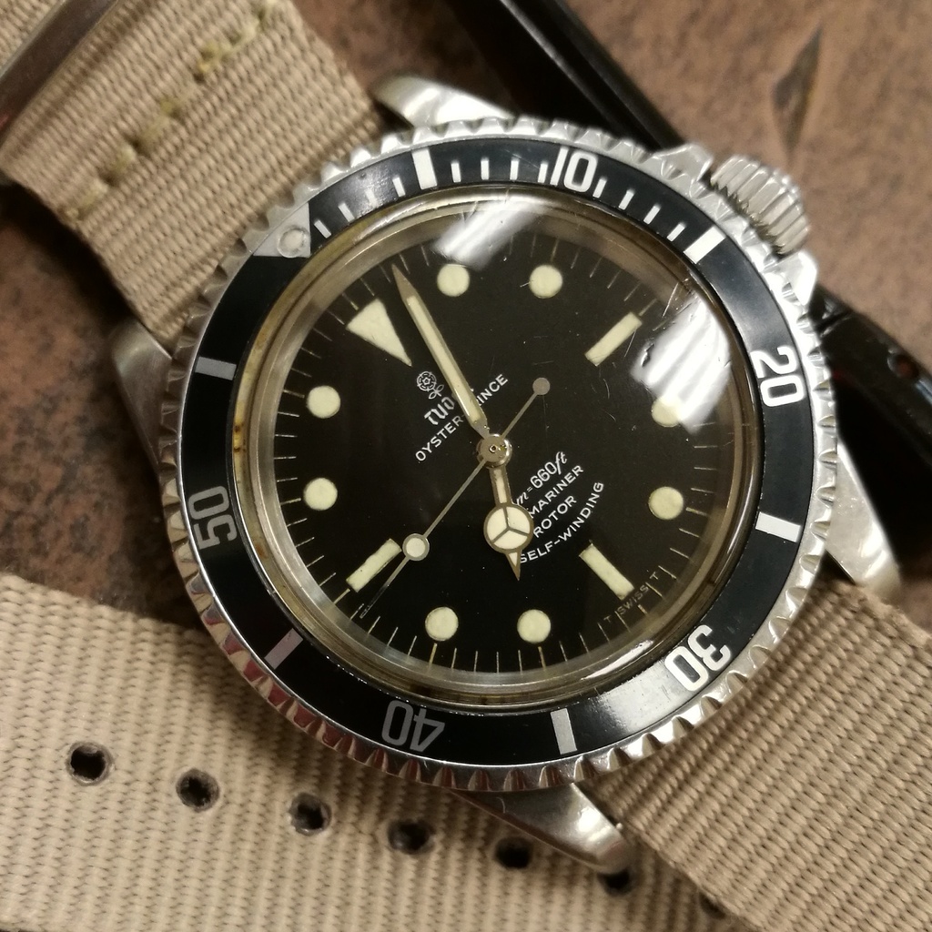

I think there are two separate issues here -
One is whether it is a fake/franken.
-The quality of the caseback print looks weird, not quite like the other IV.68 casebacks I've seen. Too thin, looks like someone just recently did this. There should be a space between TUDOR and SA (on the movement the print looks ok and comparable to others I have seen.

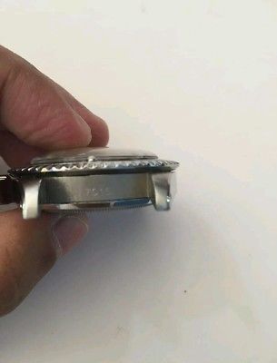

-I can't comment on the midcase - I am not good enough yet to do it over computer images - need to examine in person
-Bezel is certainly not original

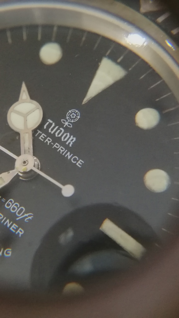

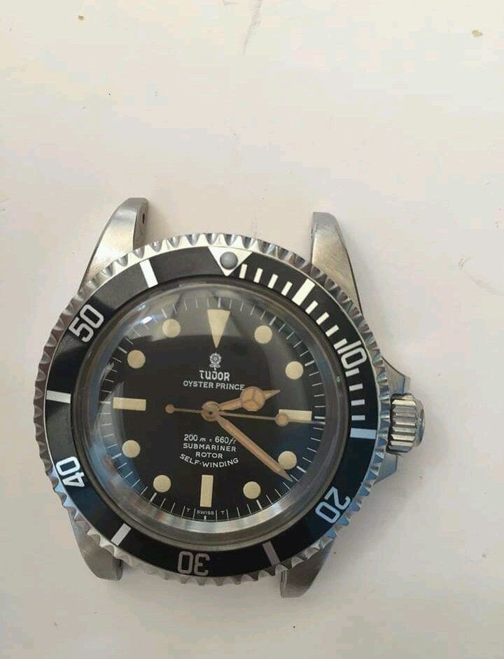

-Dial - even on the original photo, the SWISS T<25 is wrong...
The second issue is very poorly redone dial, EVEN IF WE ARE WRONG AND THE DIAL IS REAL:
-The rose is totally messed up
-The TUDOR print is wrong
-The "SELF-WINDING" is flat - not smiling enough
-The SWISS T<25 is wrong, but even if it was right - the way it sits above the minute markers is just lazy and ugly

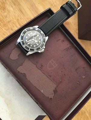

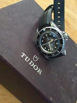

Sorry bud, but base on your pictures, that is a fake Tudor 7016. Everything is wrong on that watch. I have a 1968 Tudor 7016 Small Rose transitional with Semi pointed crown guards. Not sure if photobucket will let me post pics here(they've been giving me issues lately) but I'll gladly email them...
