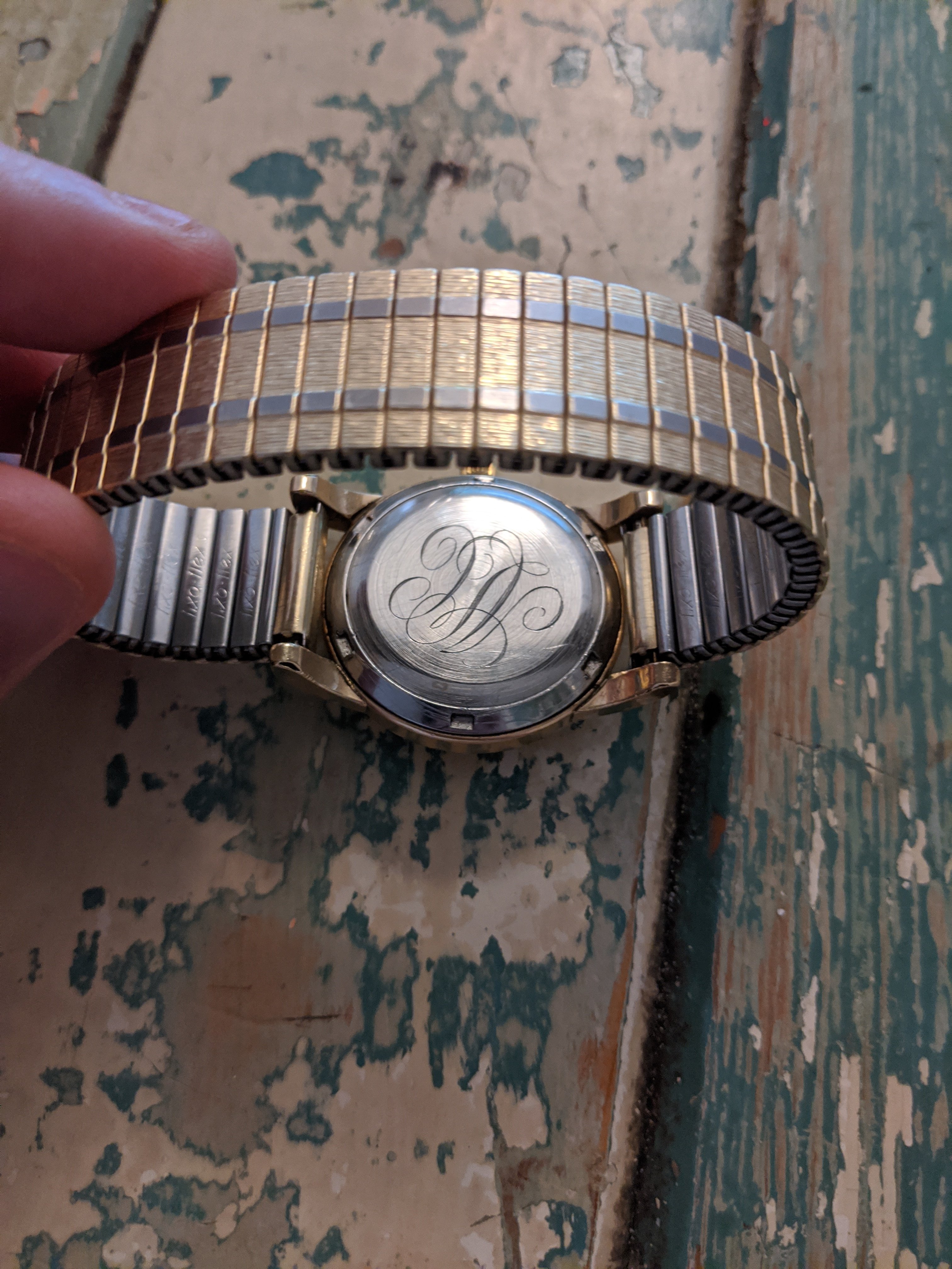

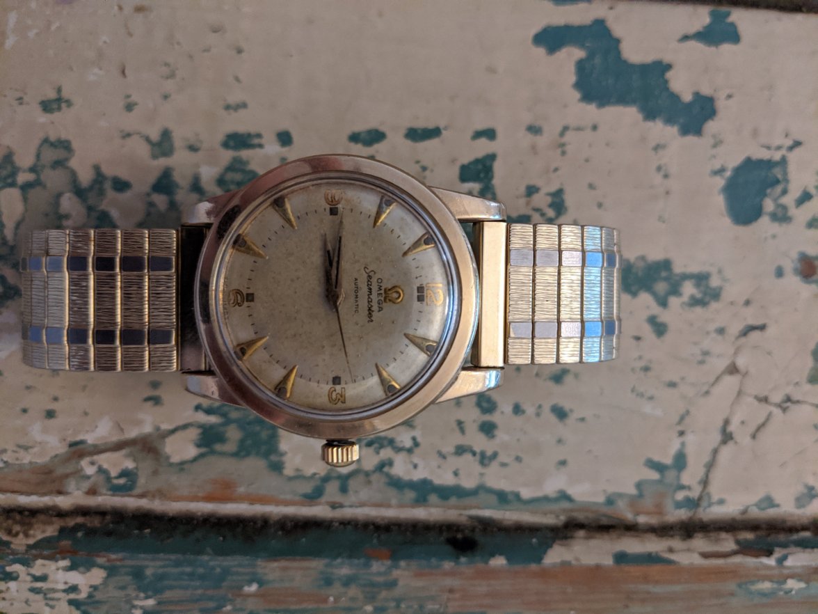

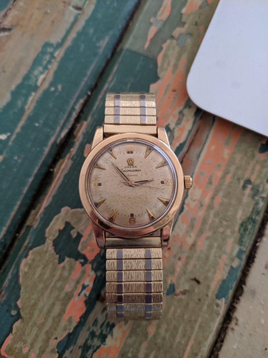

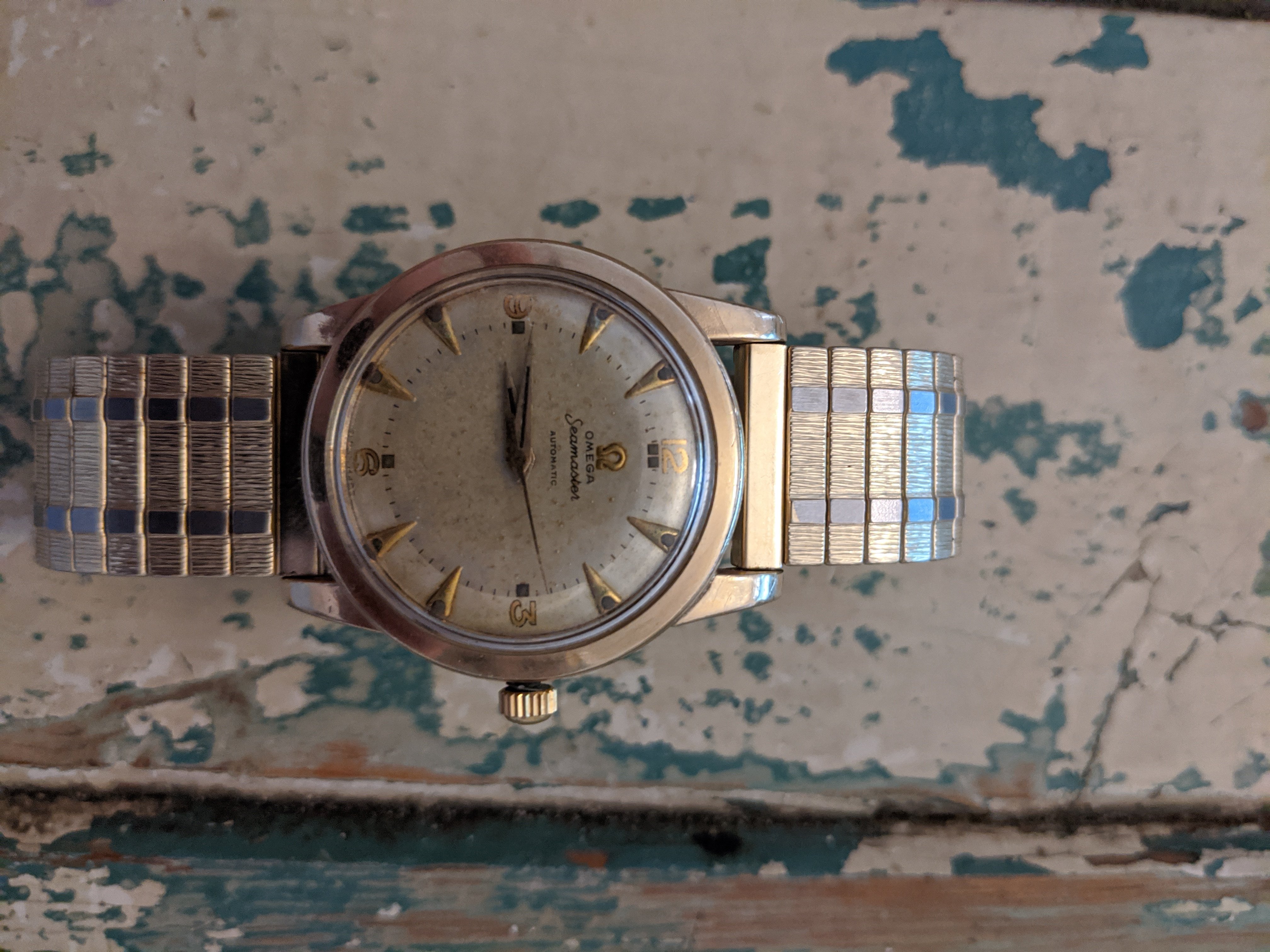

I've just inherited, what I think is a Seamaster Bumper 1950 Automatic, but after many hours perusing online archives I have yet to find an identical match.
I have yet to get the back plate off, I don't want to scratch or damage it with my needle-nose pliers and no Watch store is open due to COVID-19...
Thanks for the help,

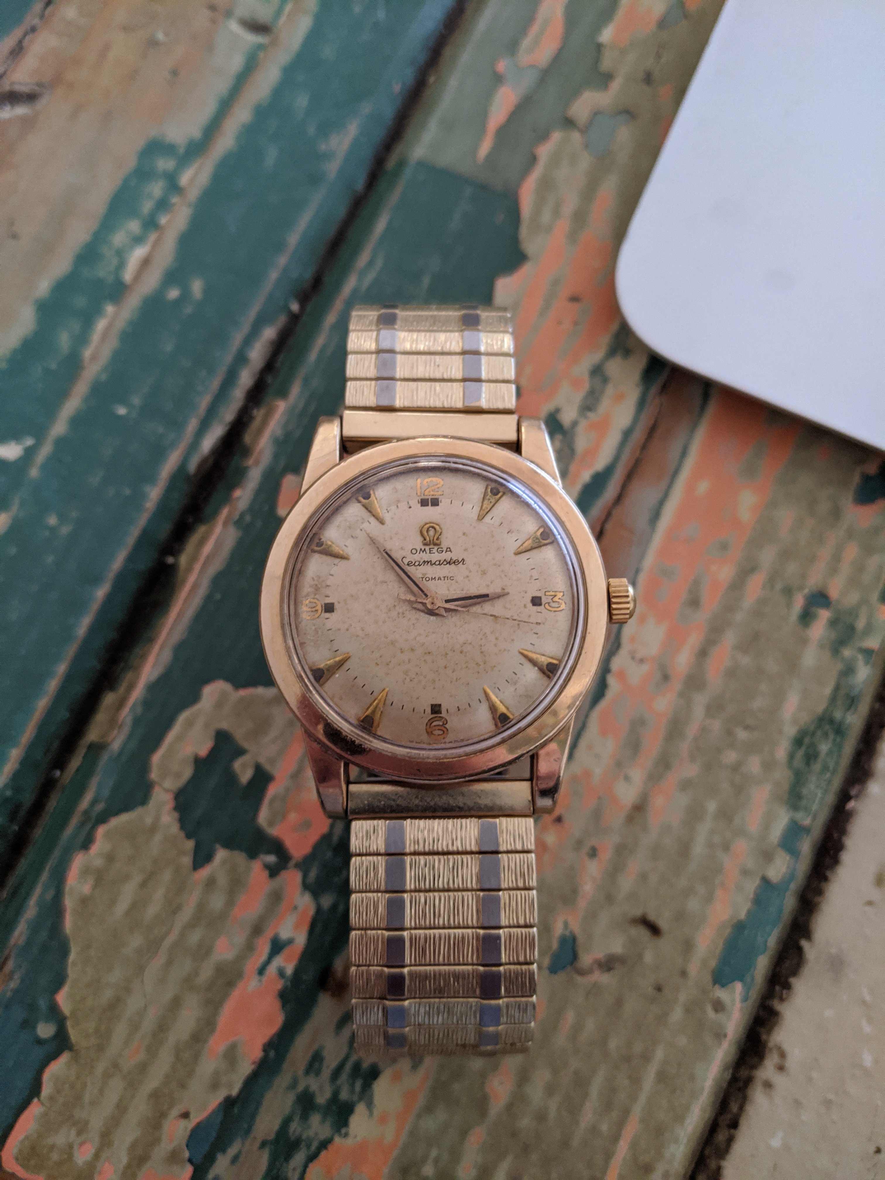

1949 - 51 would be my guess. Ref 2577. Otto Frei still has correct pink gold clover crowns.
10,804
16,814
It isn't one of the very earliest, for the first year or so they had no Seamaster text on the dial but as above it could well be 1950-53. The serial will tell all. I had a version with that dial I dated at 1951 but there are dozens of variants out there and they made 2577s up to around 1954 AFAIK.
I am assuming it is a 2577, if it has a screw on back it likely is, but if it has a snap back it will be a 2767 and will be slightly later, '54-'55. I also had an earlier 2577 with no dial SM text which I dated at '49 based on the serial.

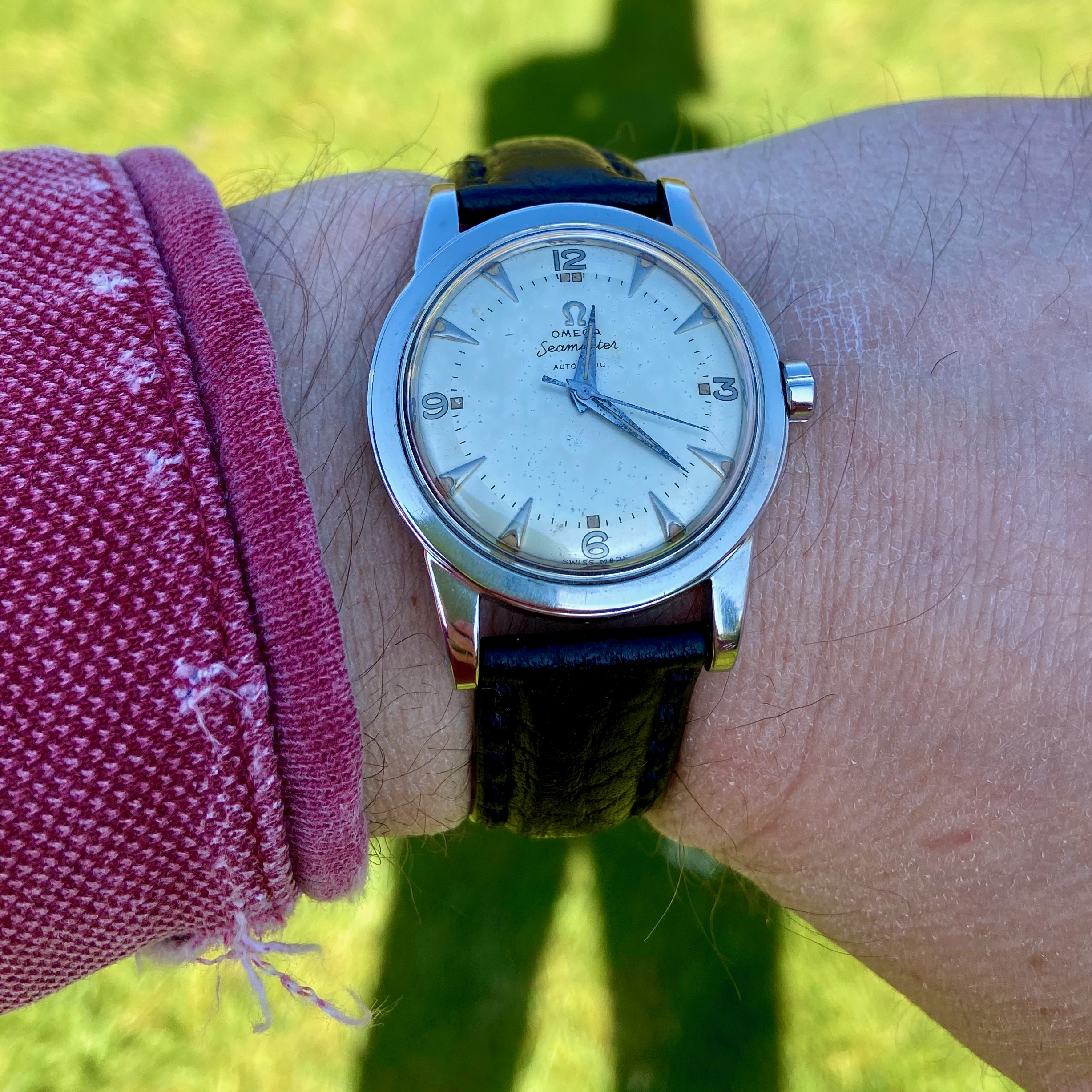

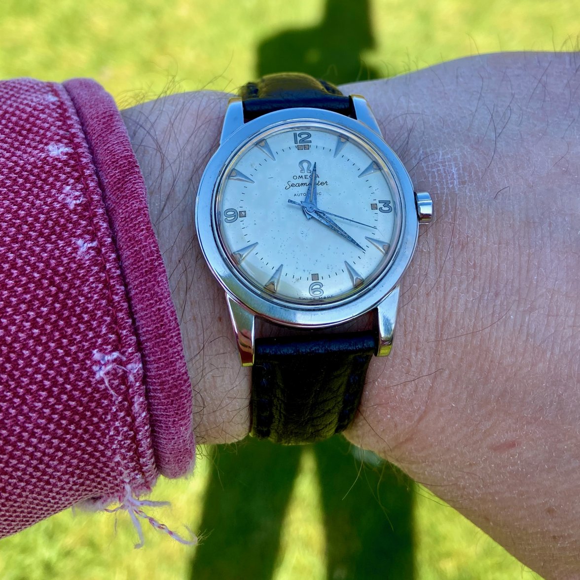

Here is my similar 2577-6:

If it's a very early model. might it not have a domed crown? I agree that one isn't likely to be original.
I saw on online that had an Omega domed crown....

If I remember correctly, it's been floated around that dress Omegas retailed by Norman Morris (US distributor) in the 50s may have come with bowler-style crowns instead of clover or decagonal variants.
The crown on the OPs watch is not one of those NM bowlers, though.

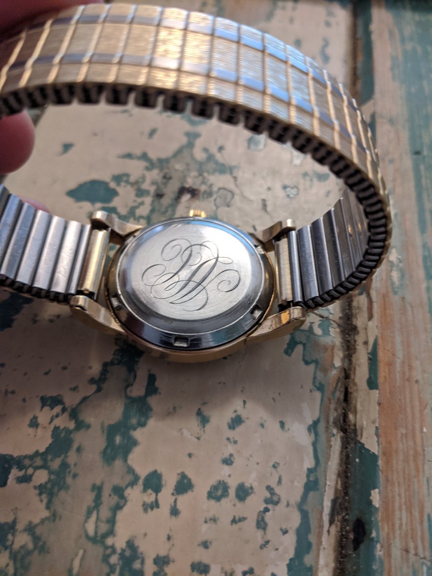

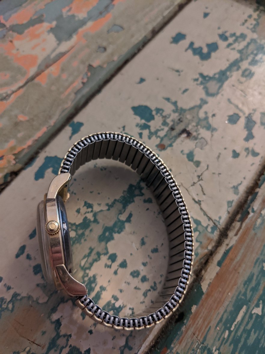

Well a DIY solution might be to try a rubber ball opener or if you are feeling brave, a 2 or 3 prong adjustable opener and case holder (with the use of tape to guard against slips maybe). You would have nothing to lose in trying a ball but if it is gummed shut it may need something with more grip. The original gasket fitted to screw back fat lugs was a ring of a hard material, leather or plastic maybe but these have often been replaced with a rubber o-ring which deteriorates into a gloopy tar.
A photo of the back of the watch would go a long way to identifying it as a starting point. A photo showing the top of the crown would help too since there seems to be some debate over that also.

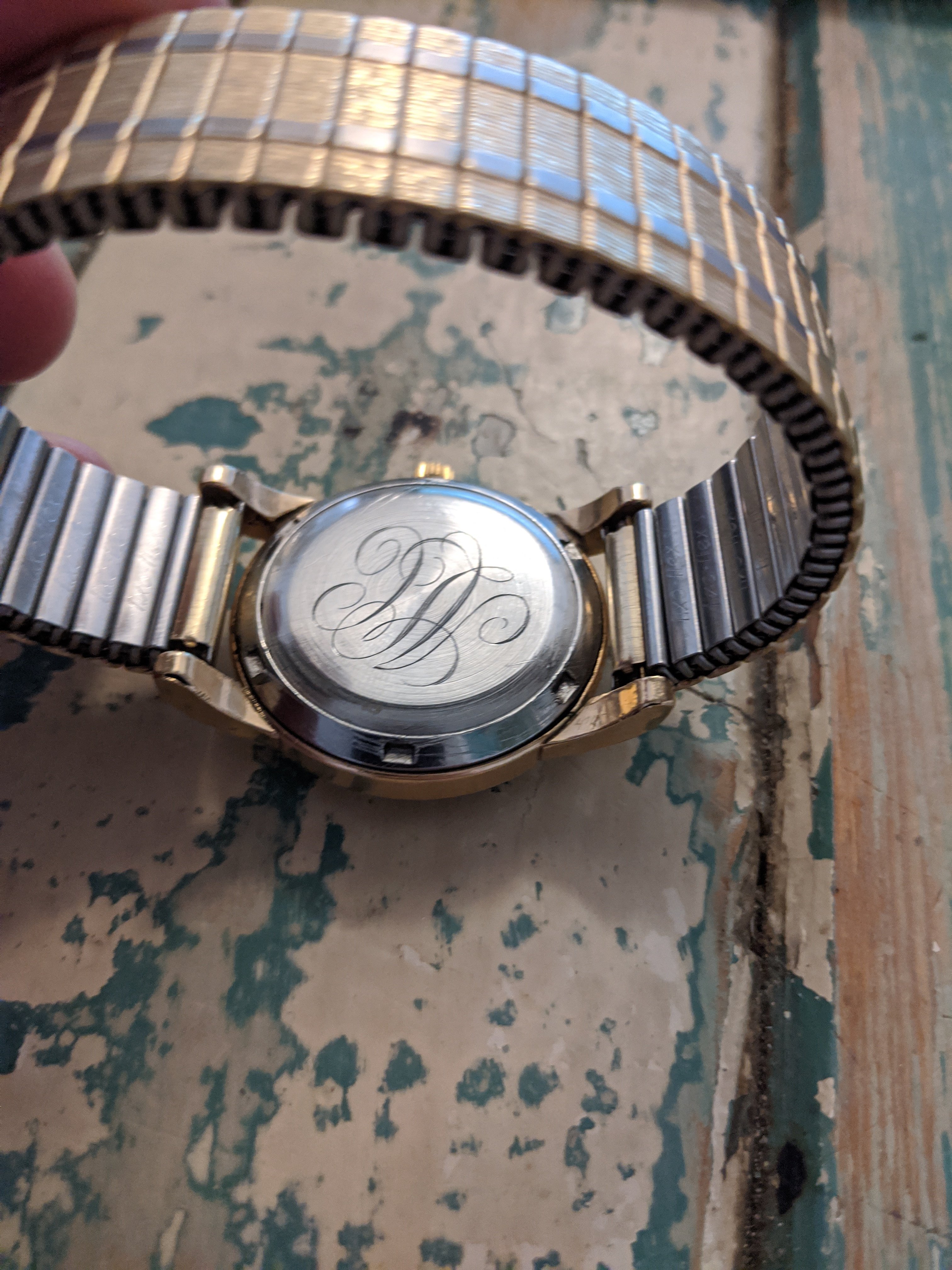

The case looks correct (crown does not, as mentioned above), though the gold plating has been worn off, partially.
The engraving on the caseback is individual for sure.
You should change the bracelet (to a leather strap?), because these types of "lug-independent" spring-end-piece-fixo-flex-wonders tend to do damage to the lugs.
