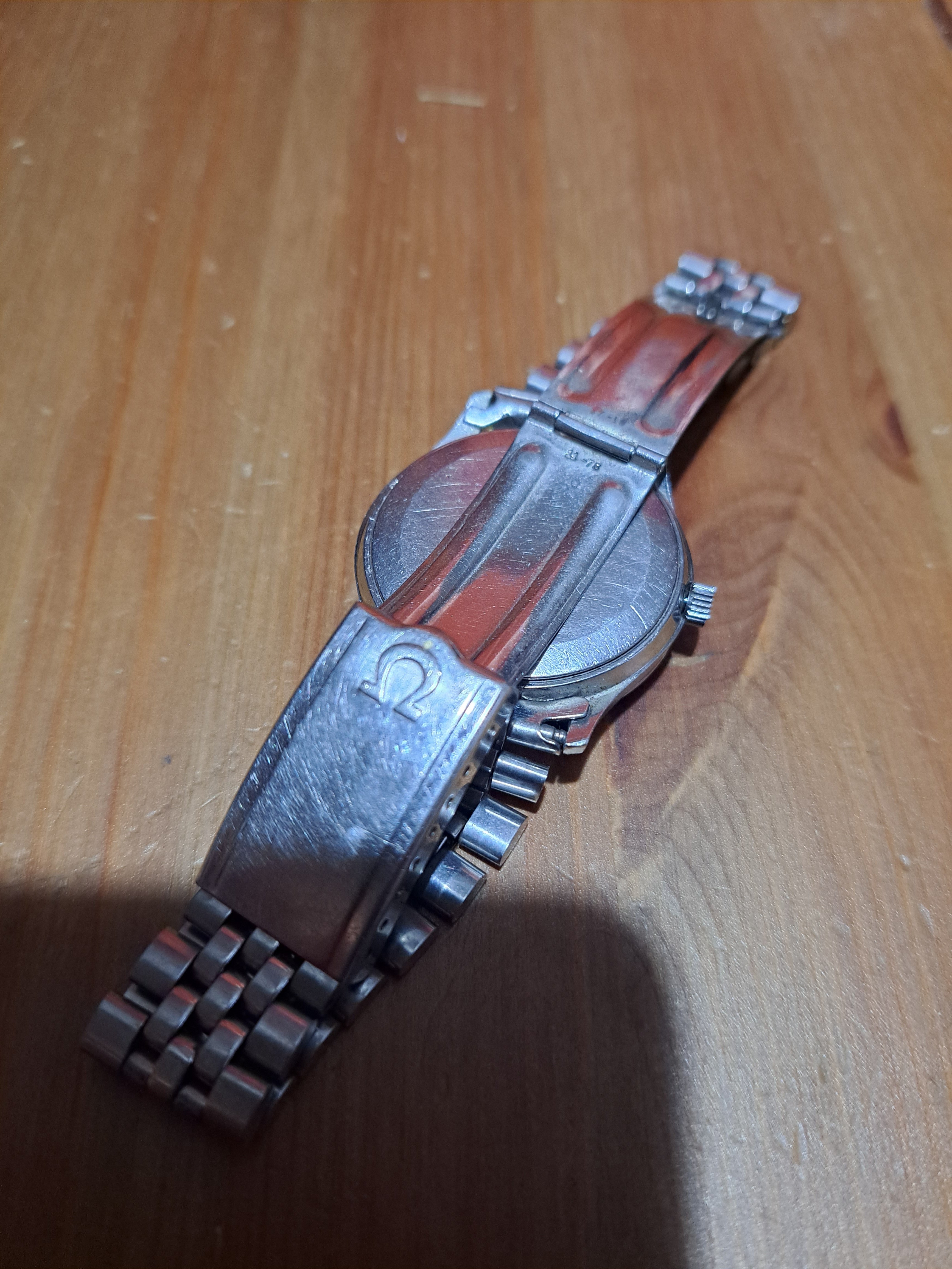

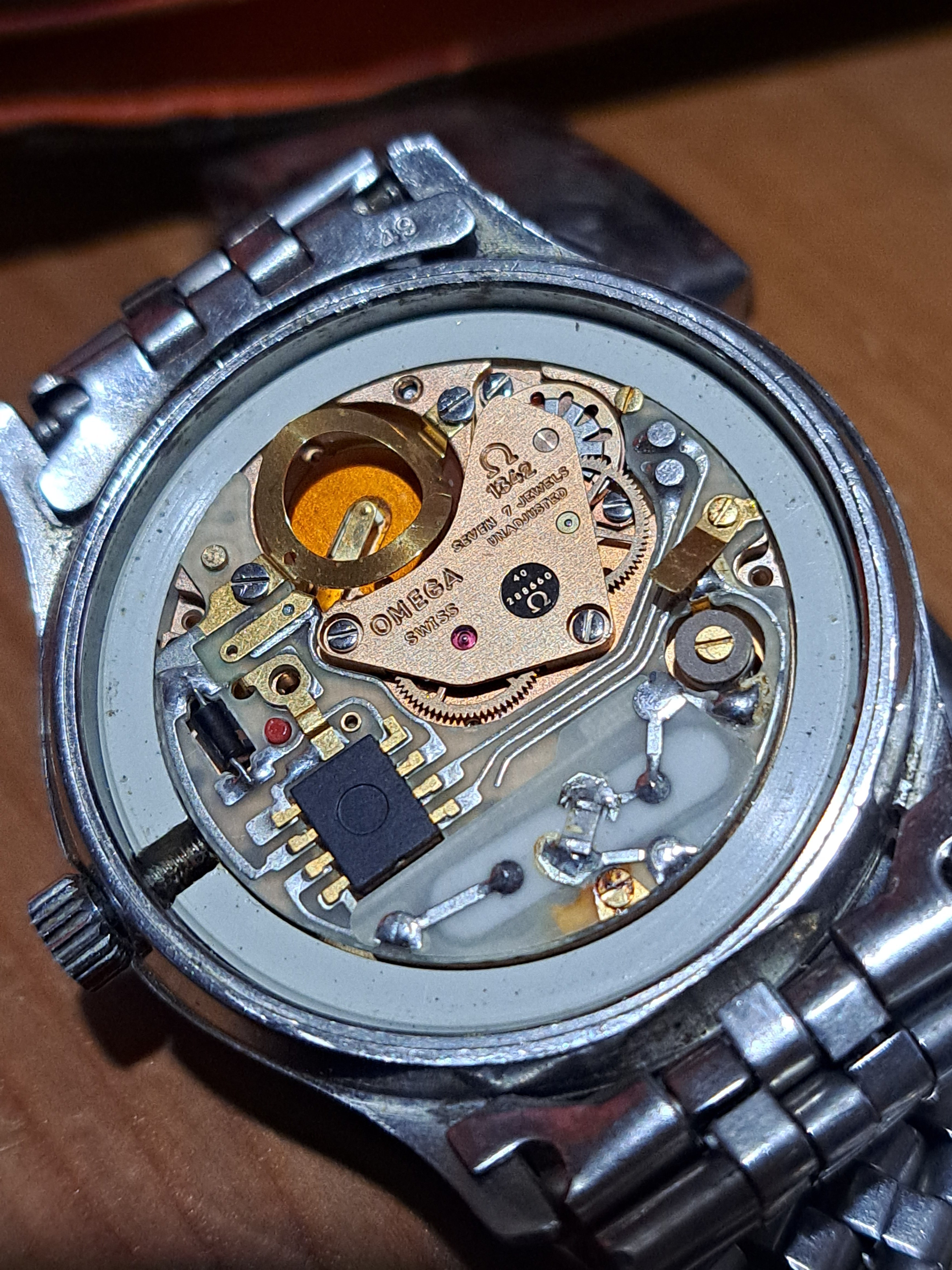

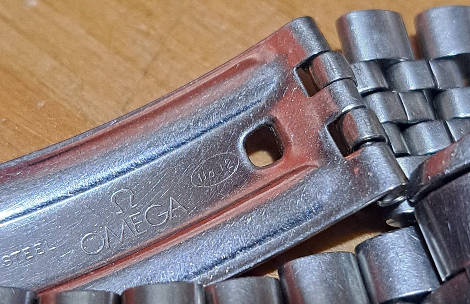

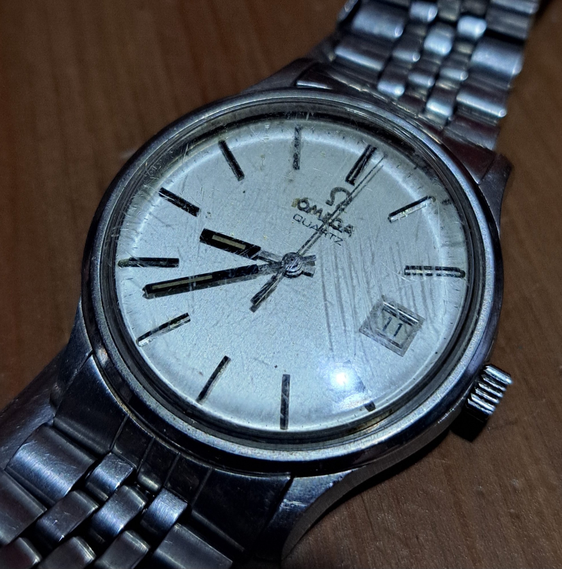

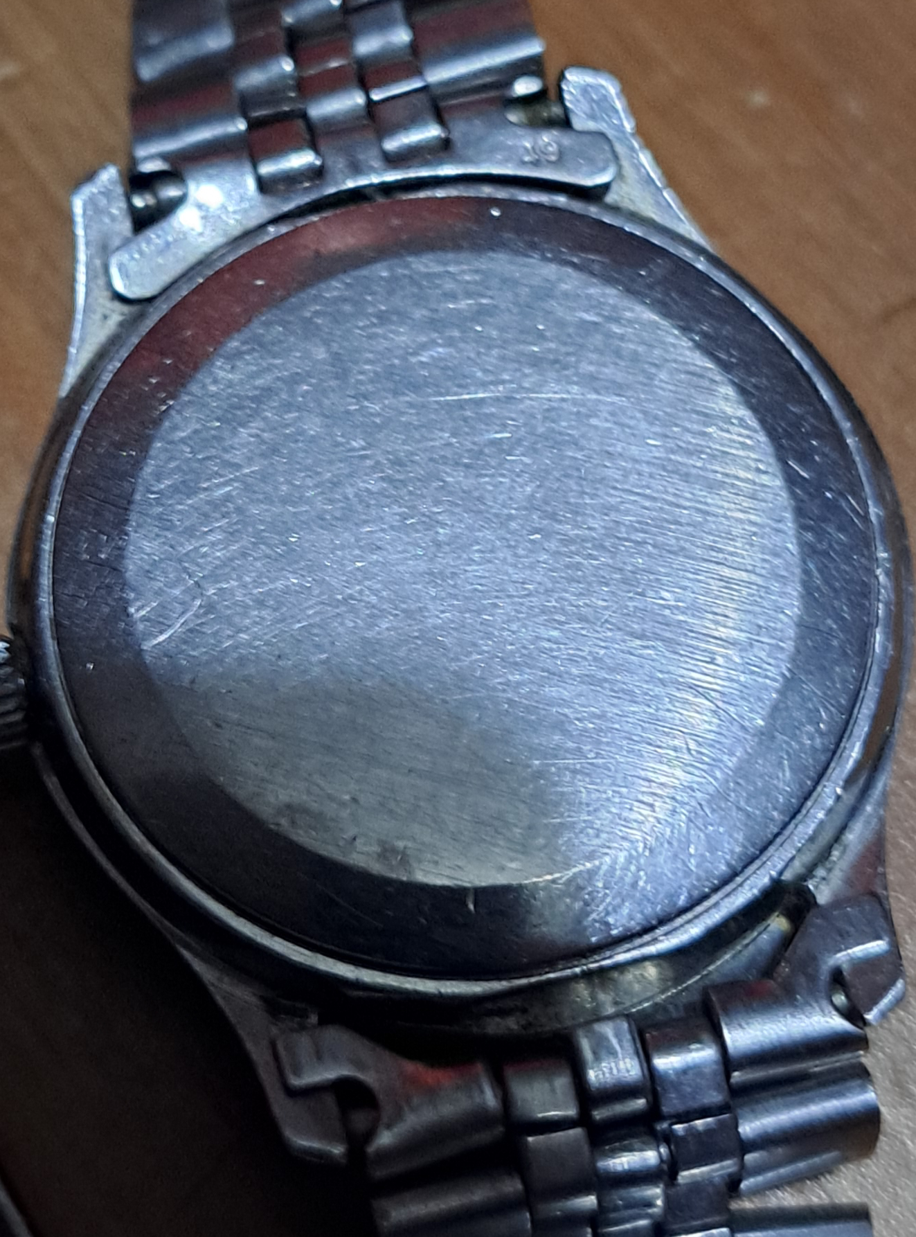

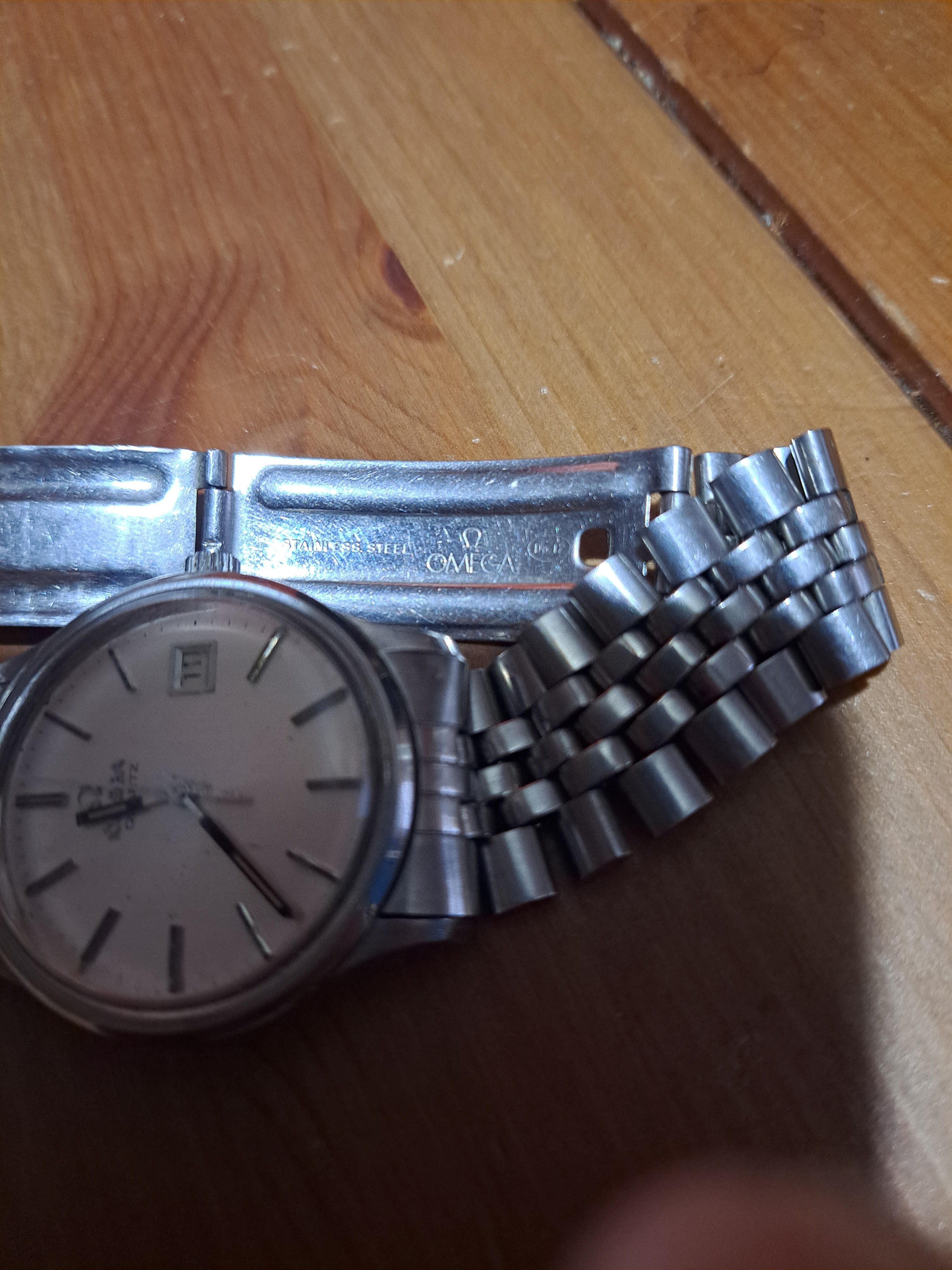

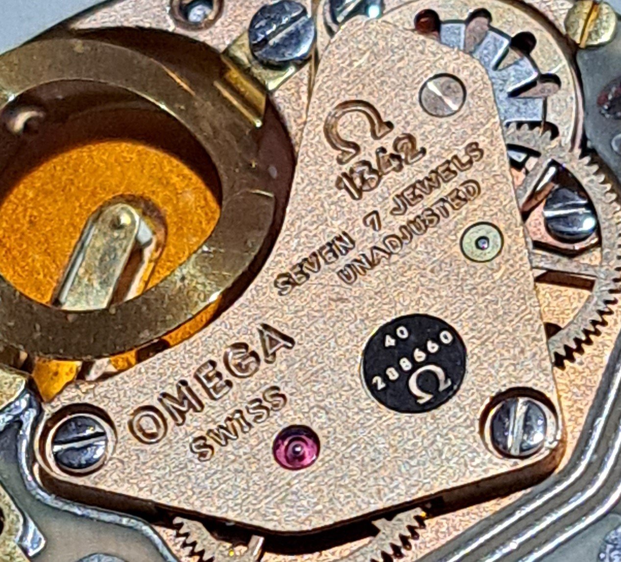

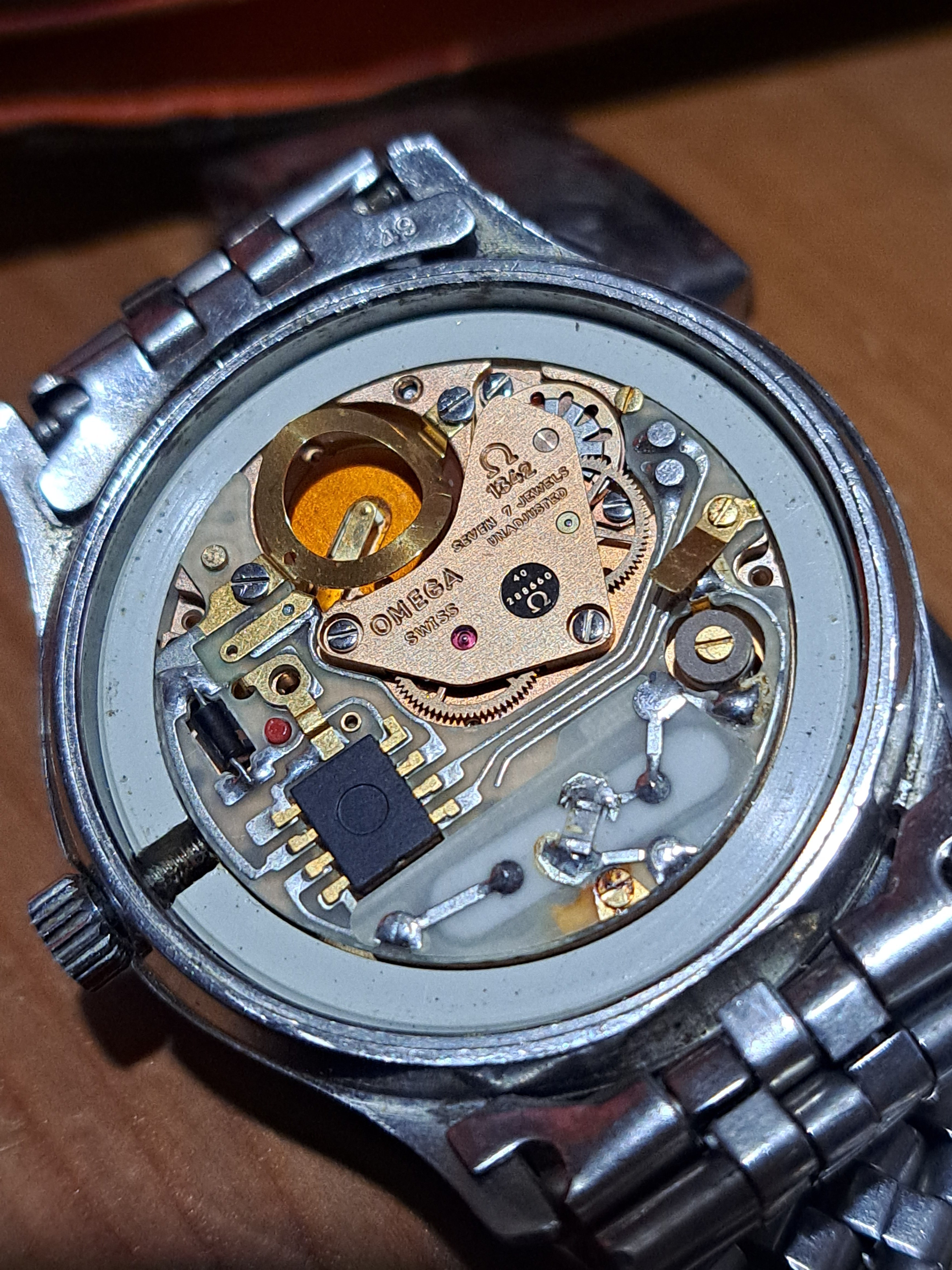

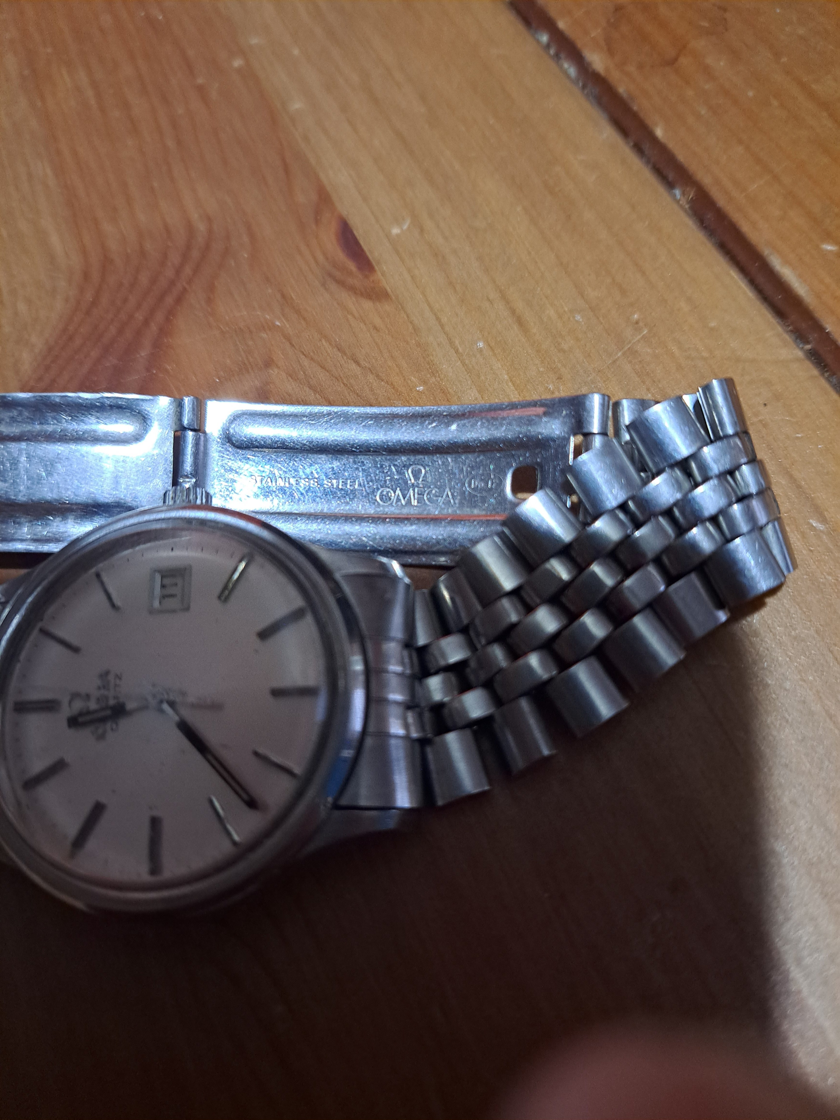

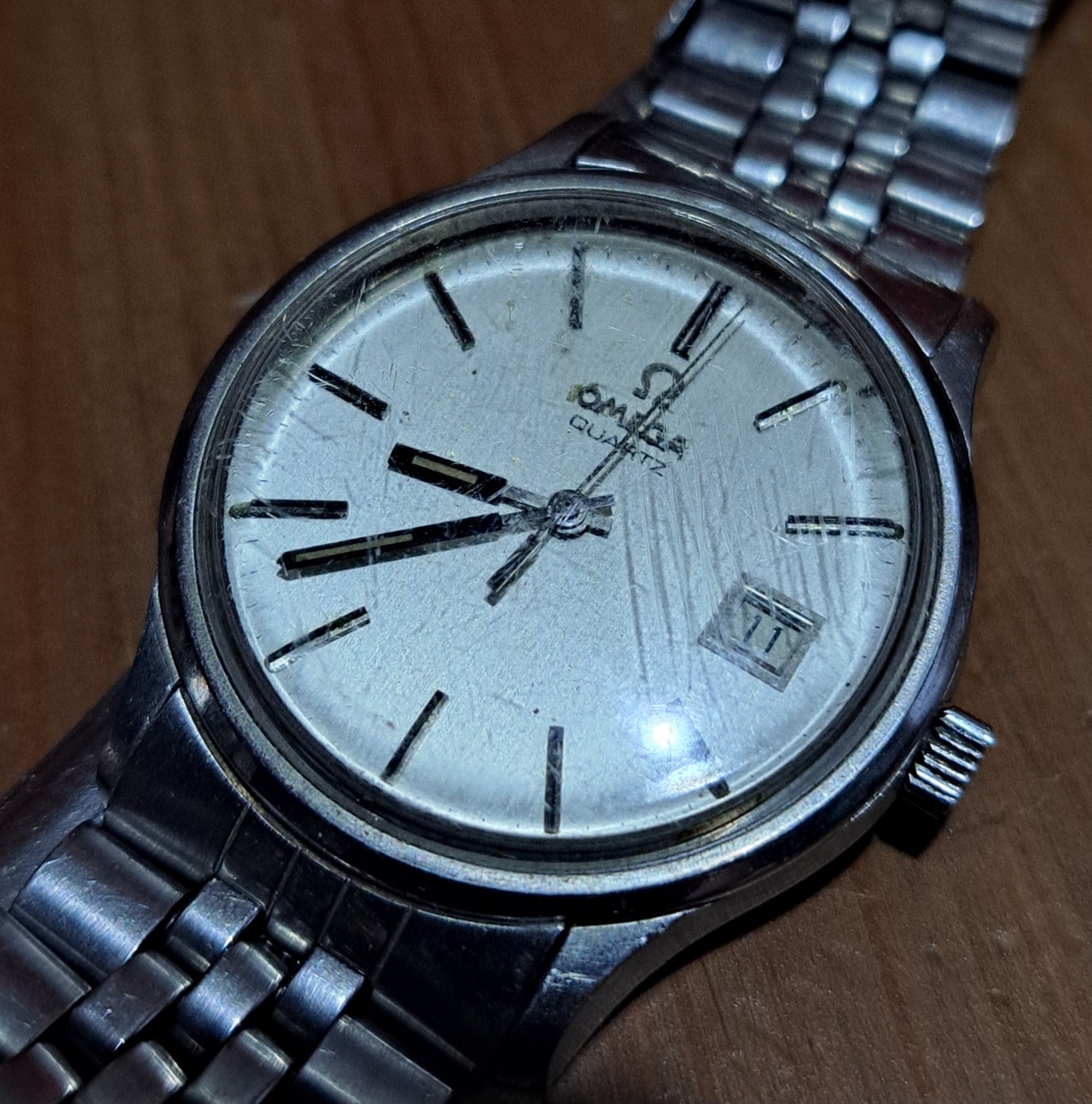

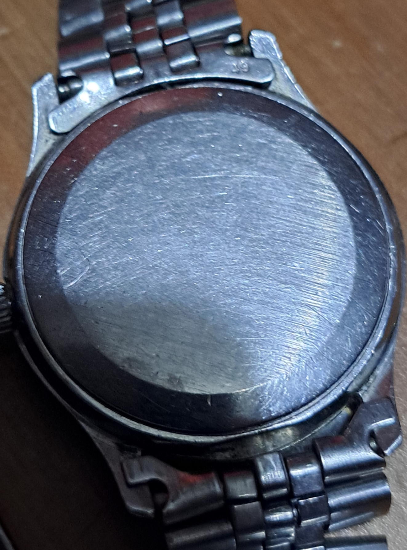

Trying to identify this watch. I think my father purchased this in the late 70s or early 80s. I am almost positive the bracelet is original. Not sure why I have this memory but the crown may have been replaced at one time. A few things I noticed. On the inside of the bracelet, next to one of the lugs is the number 49. On one of the flat parts of the bracelet that fold up is the number 11-78.
Looking for any info I can find but especially what battery this watch takes. I have taken it to a couple of jewelers and they were both surprised they did not have a proper replacement battery.
Any info is appreciated.
Matt
9,382
78,519

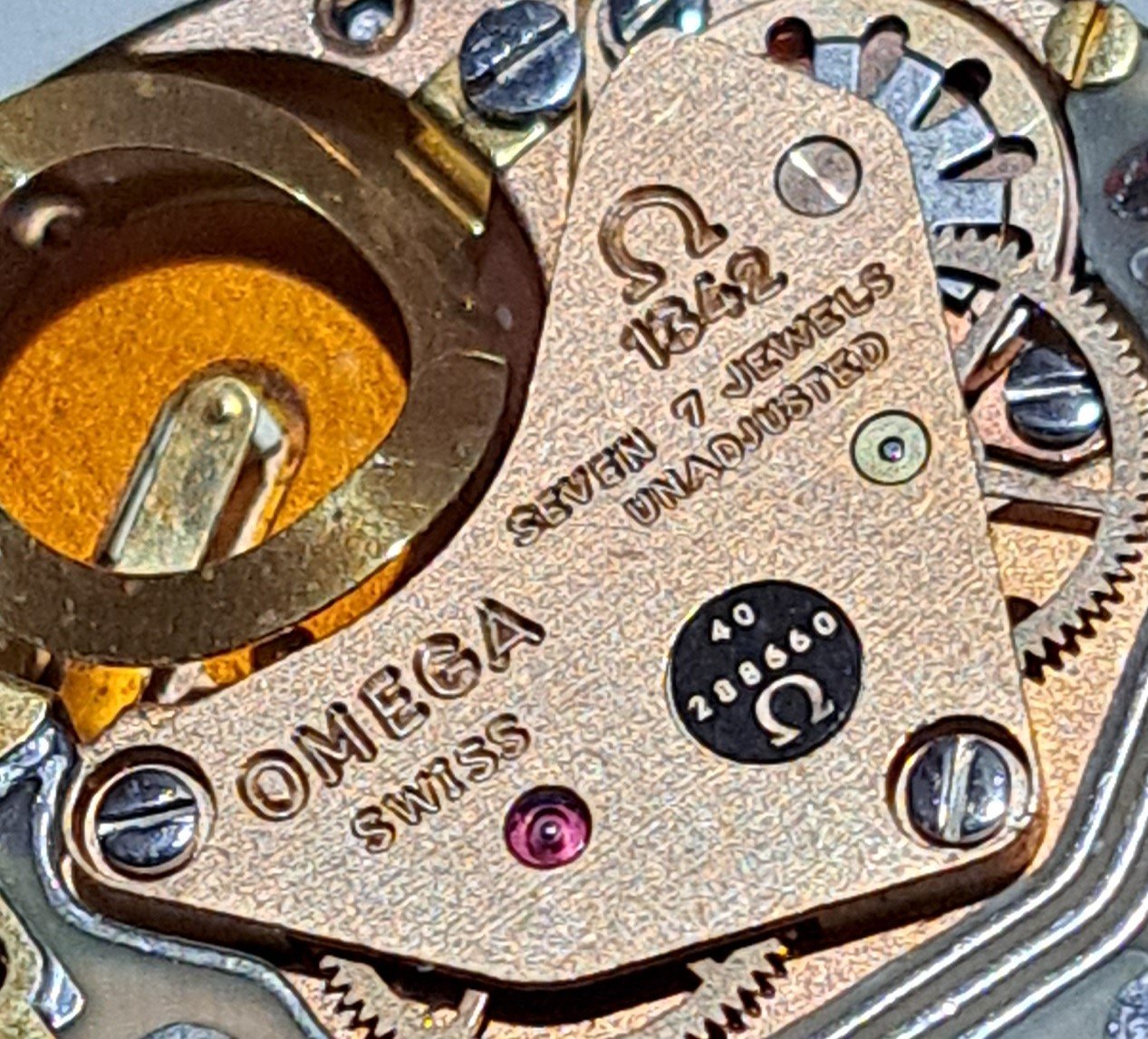

Or Omega cal 1342.
There are some on Chrono24

Thanks for the amazing info, this is great!

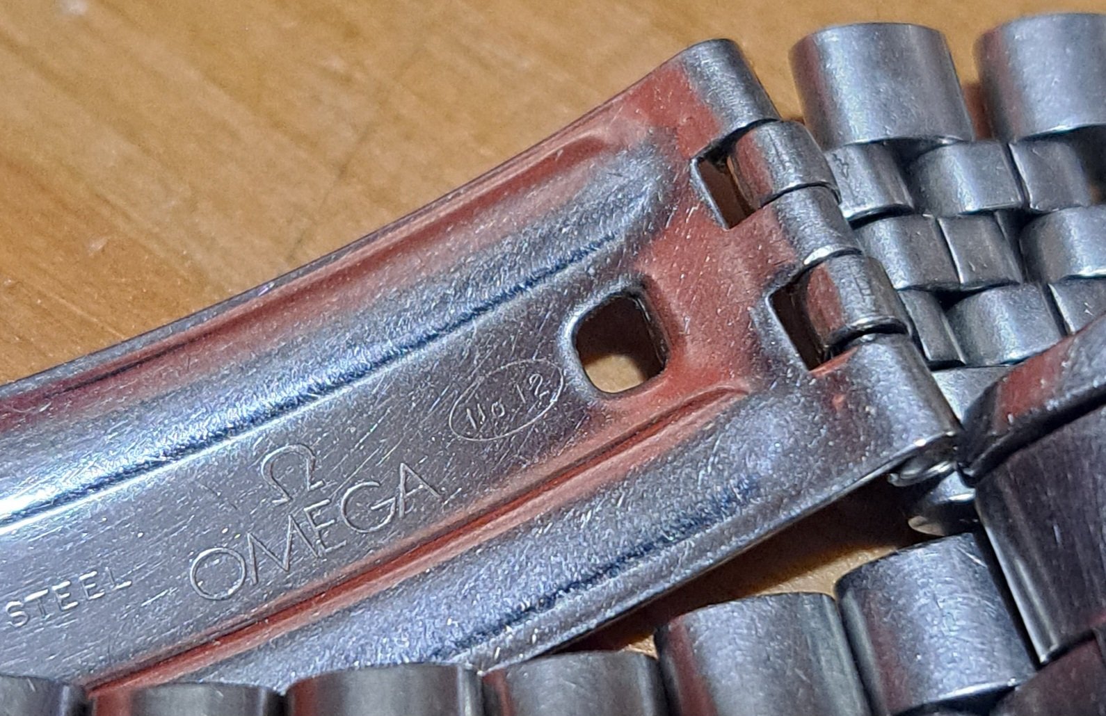

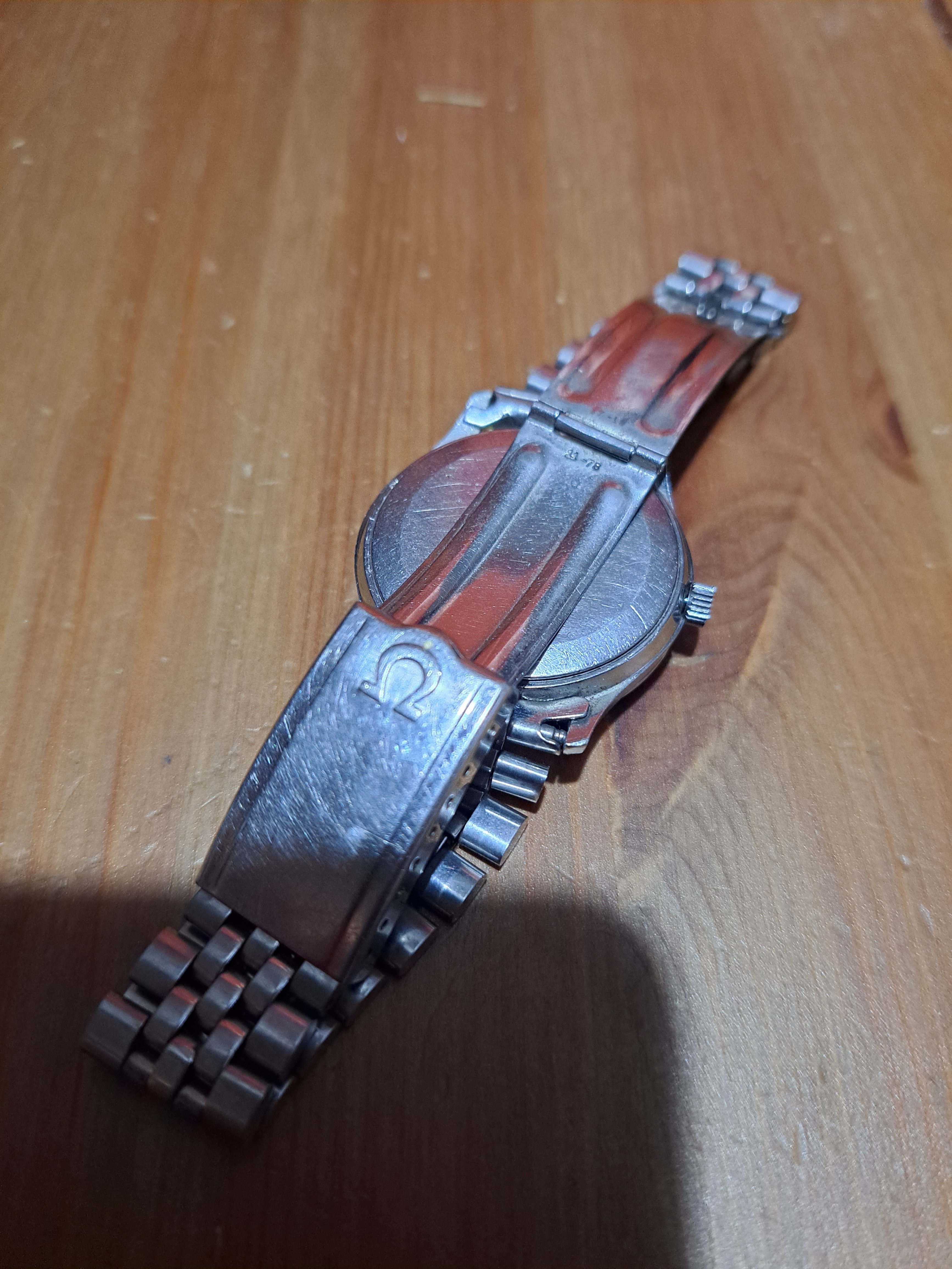

Any idea how to remove the bracelet? That one has me stumped.
THANKS!

Insert a springbar tool into the notch on the back of an endlink to compress the springbar and remove it. I imagine there might just be a YouTube video demonstrating the process.

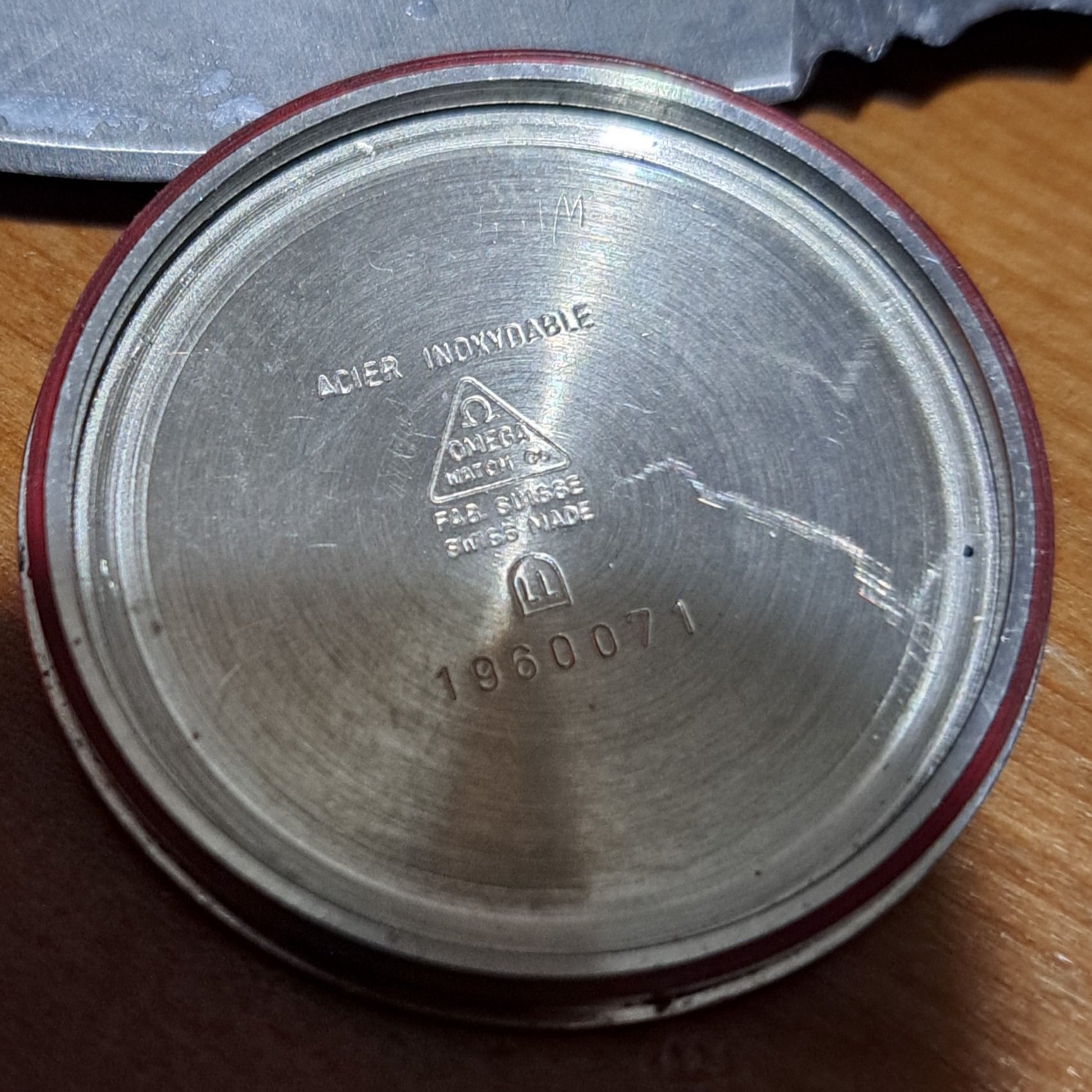

Serial number puts it around 1977

Good to see you value this heirloom. If the watch glass is plexiglass, then you could try to remove the scratches with Polywatch (just google it). Enjoy!

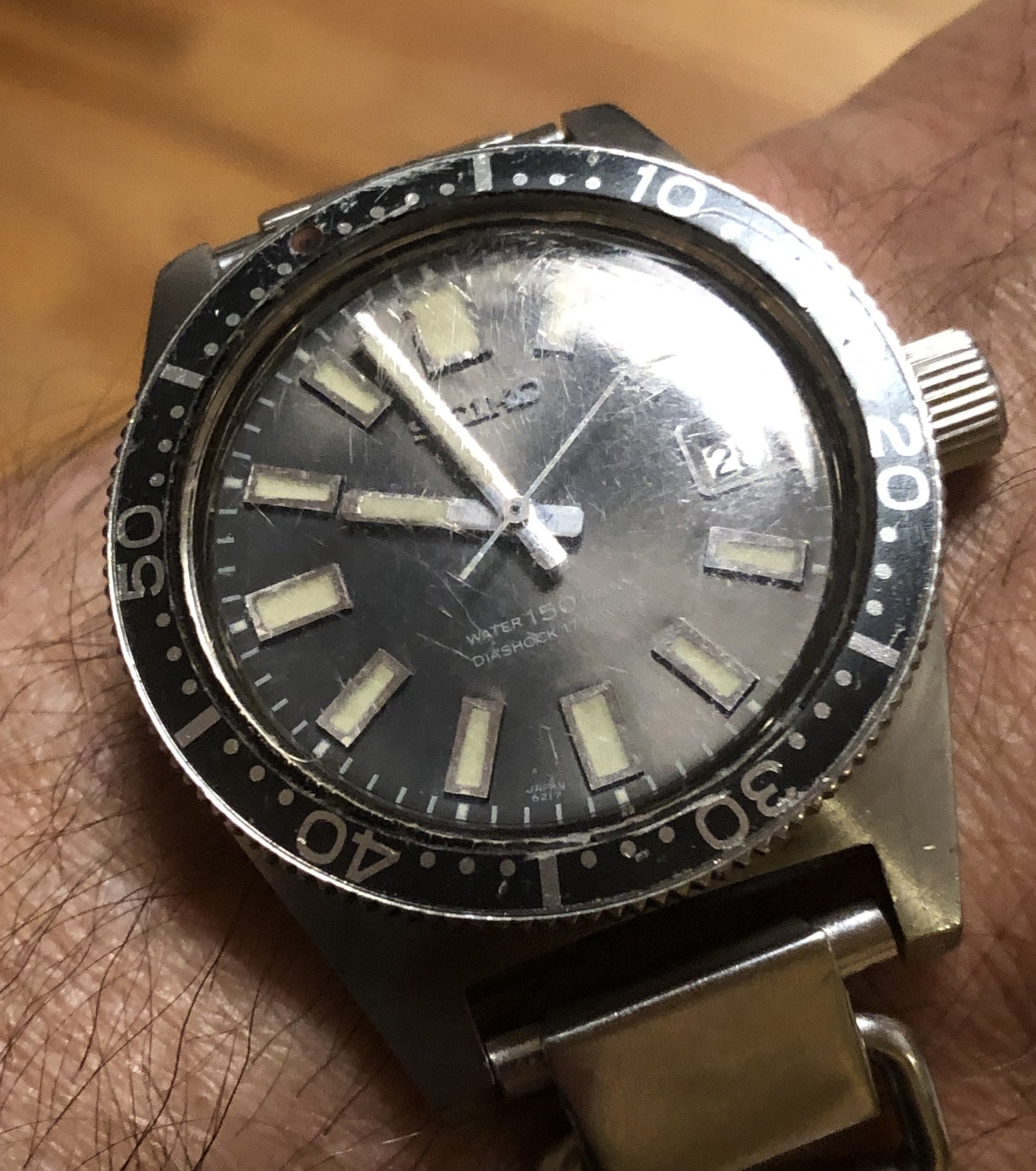

Your dad's watch is awesome. Did he basically wear it forever? The uniformity and amount of wear all over speaks to a lot of activity/use, which makes sense given as you said it was special to him.
6
5
Yes, definitely a daily wear watch. I thought about replacing the crystal but did not want to change it's look.
197
255
Totally get that. Obviously it's up to your preferences, but you could probably get a bunch of the crystal scratches polished out pretty easily without actually replacing it. That's what I did with the Omega I got from my dad last year, and it made a huge difference in how good it looked while still preserving the slightly worn look from the case. Maybe there are some great stories associated with some of those scratches too though, in which case keep 'em around! 😀
24,843
55,270
No problem polishing out those scratches. 15 minutes work by hand with a few grades of sandpaper and plastic polish.
