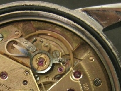

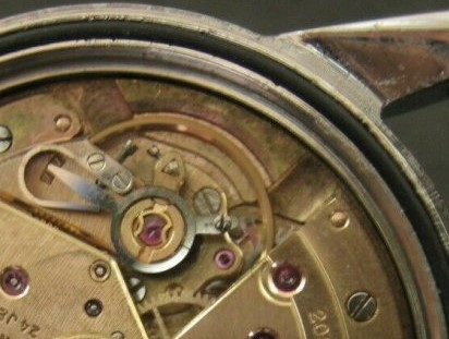

The movement seems okay though. Not much damage on the screws etc. Or am I missing something obvious here?
IMO crown is wrong for that reference, moevement seems very dirty, maybe these are remains of a water damage

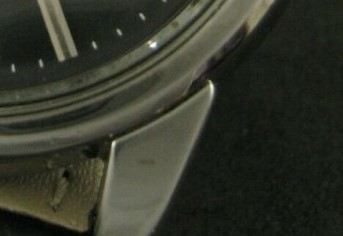

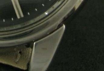

EDIT: Wrong bezel or too much polish? there should be no gap here between lug and bezel
You have a better eye then me, thought that was shadow!
