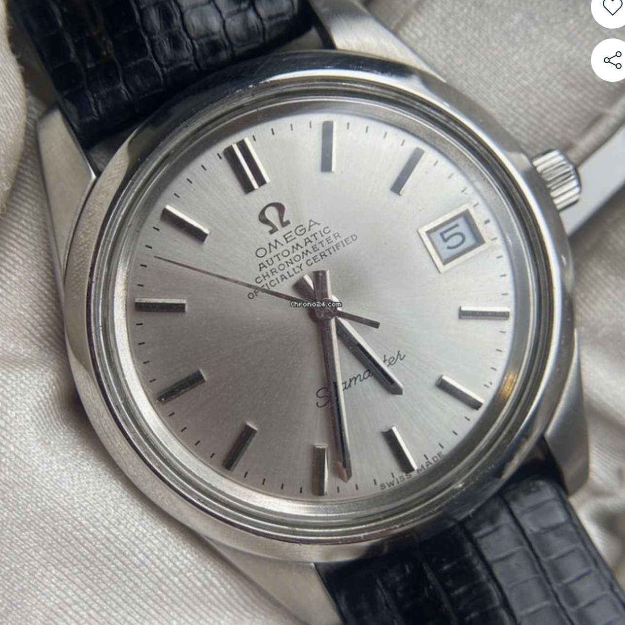

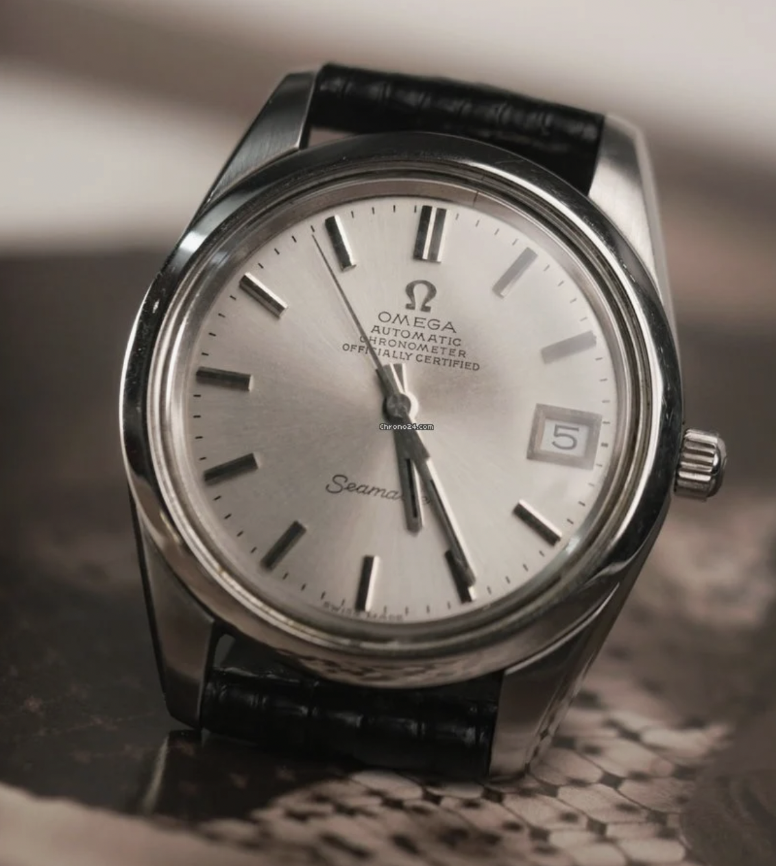

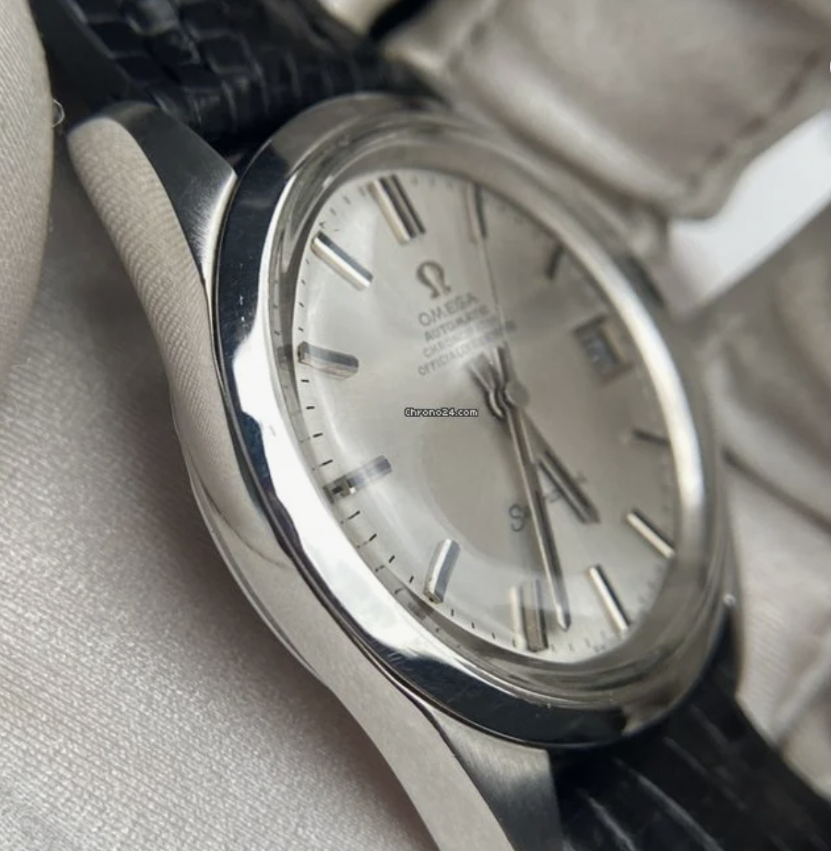

Still looking for my first vintage Seamaster, is this the one? Need help
New to the watch world and don't know much about vintage watches. I found one on Chrono24 that doesn't look too bad. Do you guys have any guidance on whether or not this is a good buy? Are there any red flags with this watch? Please help me out, Thanks (List price $966 CAN)

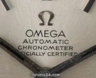

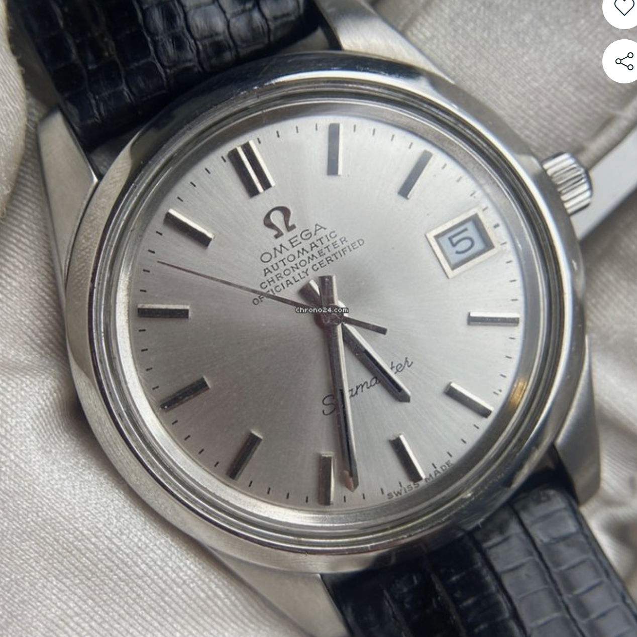

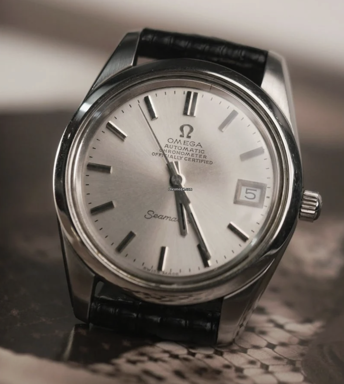

The OP example is a redial:

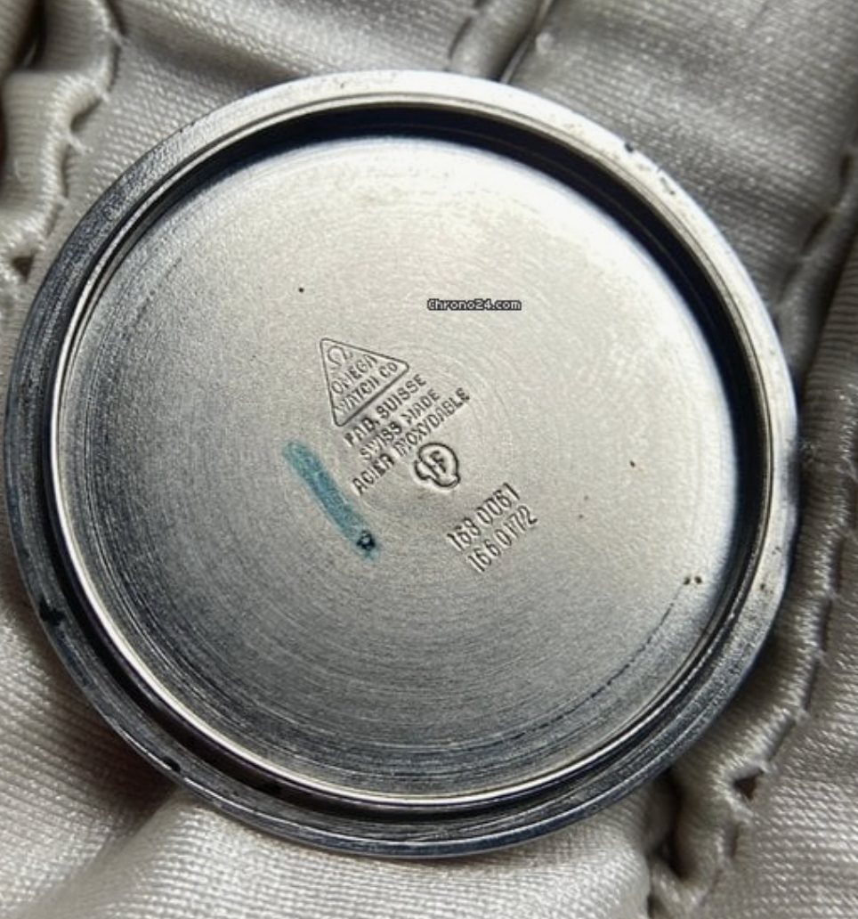

If you compare the font with other examples (internet search for "Omega 168.0061") you will see that it always differs, look for example at the "A" in "Automatic"
Maybe the OP dial is the rare "OM EGA" variant?
