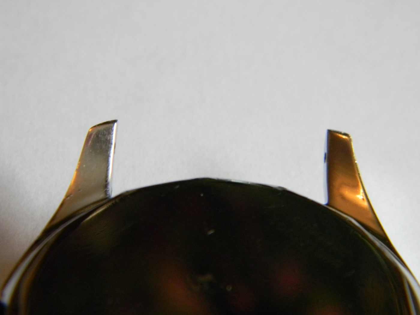

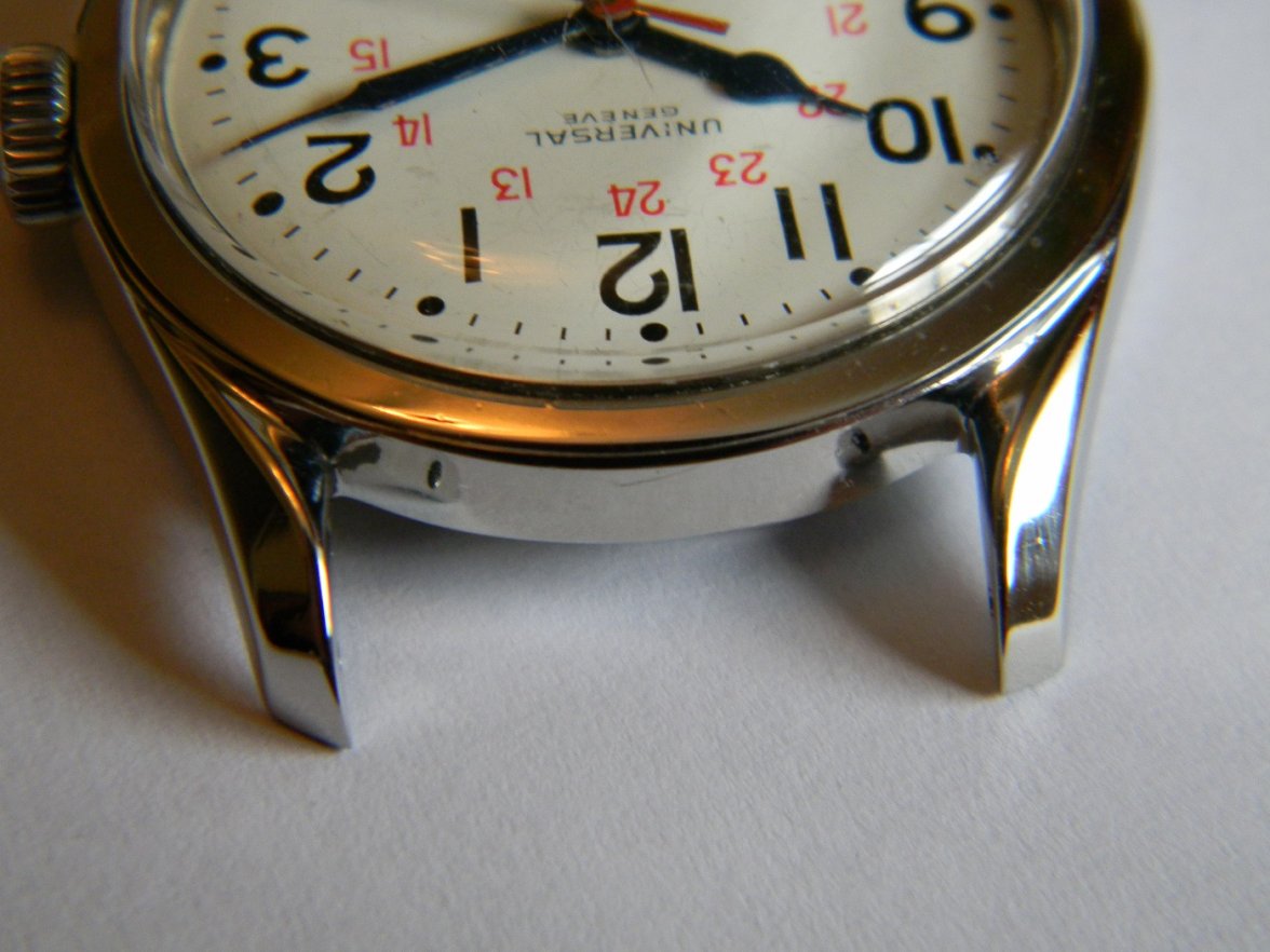

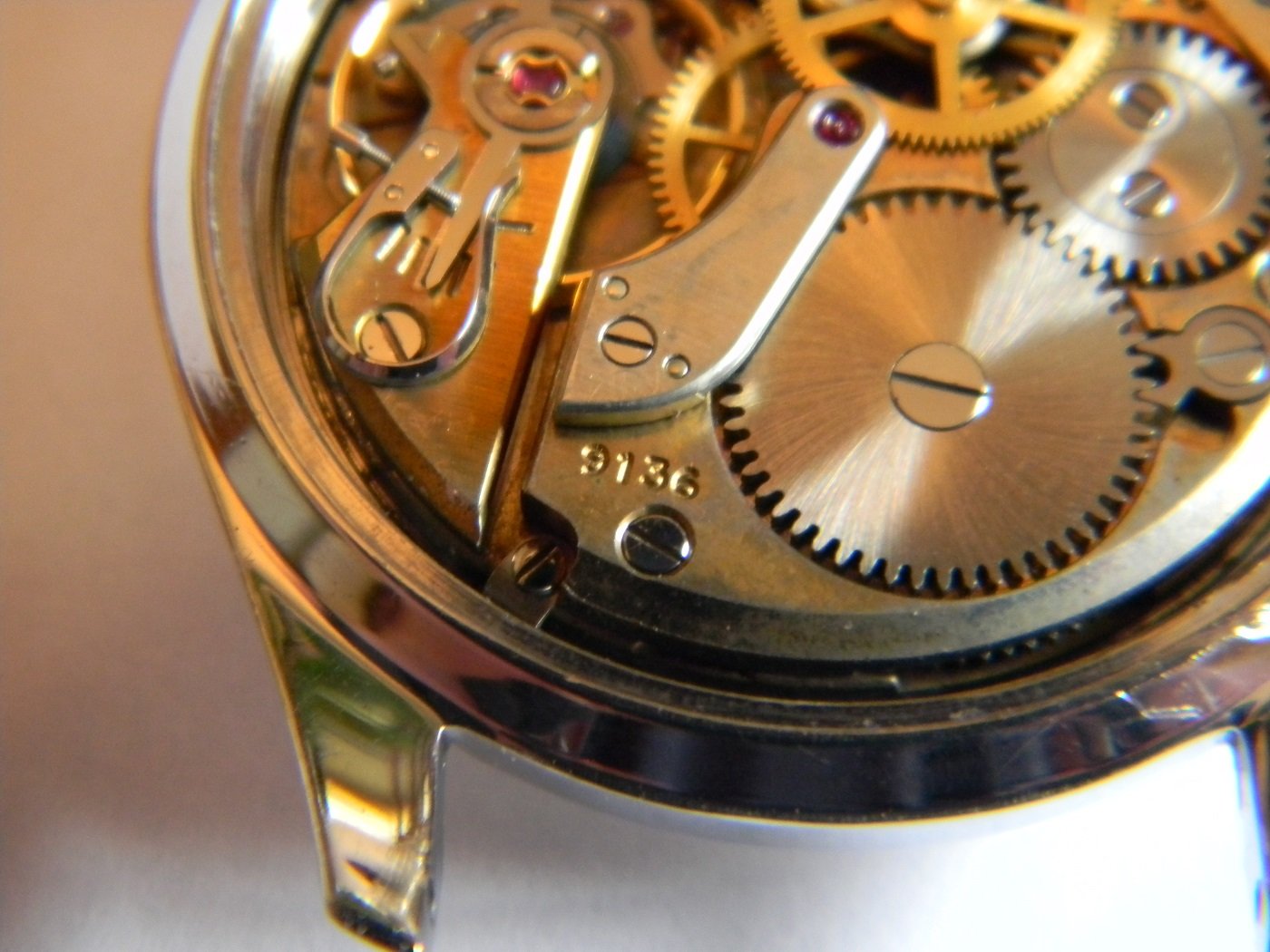

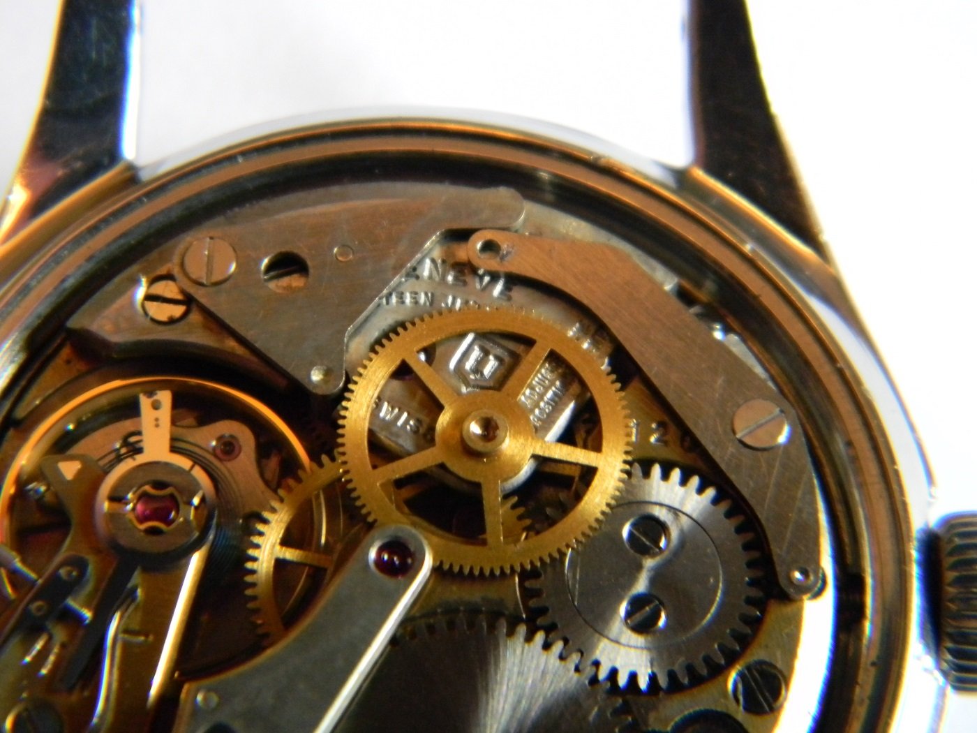

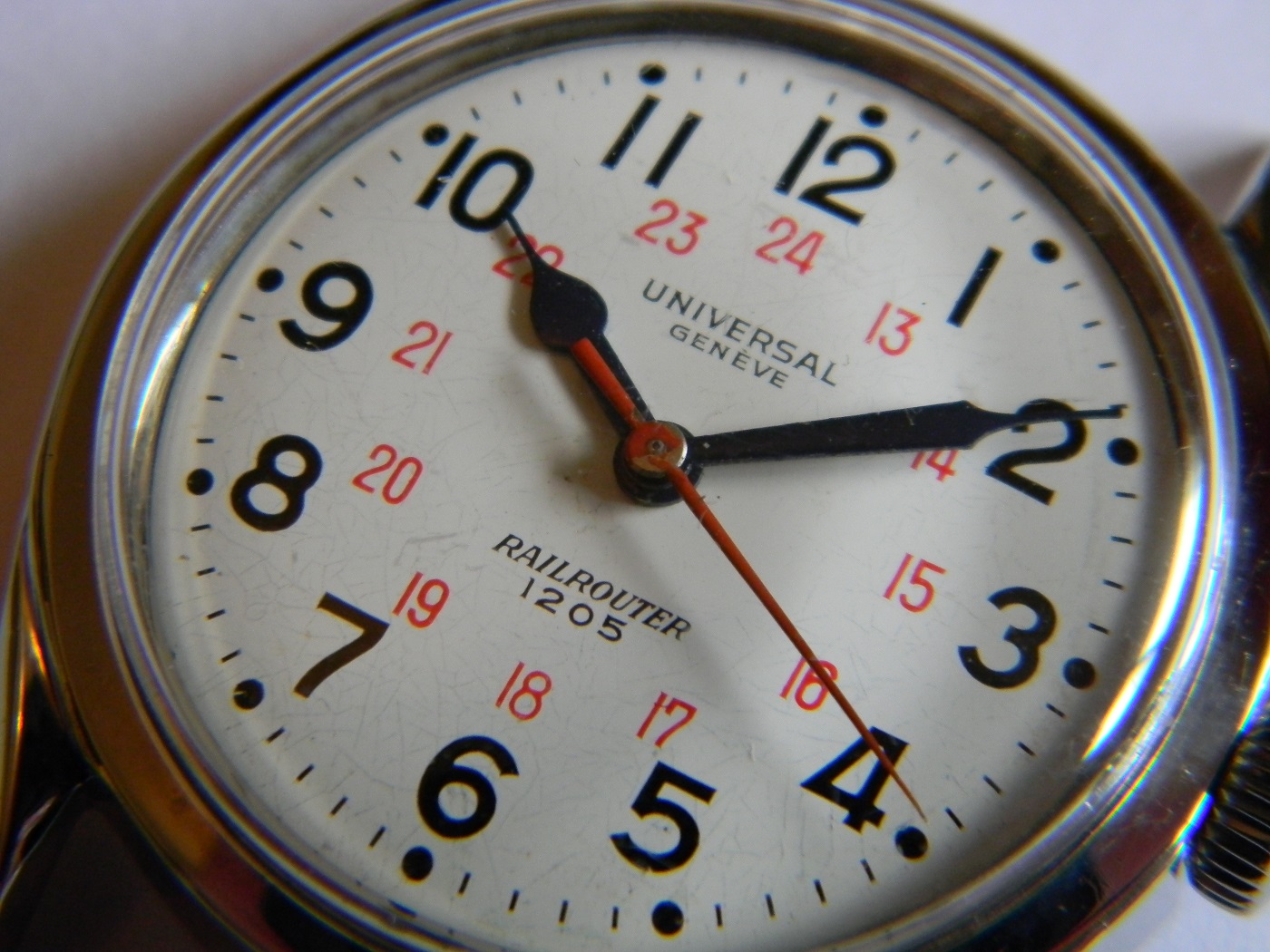

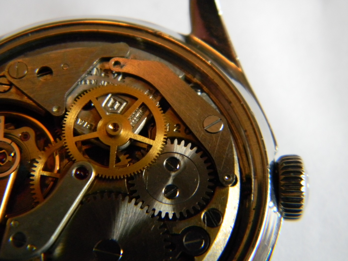

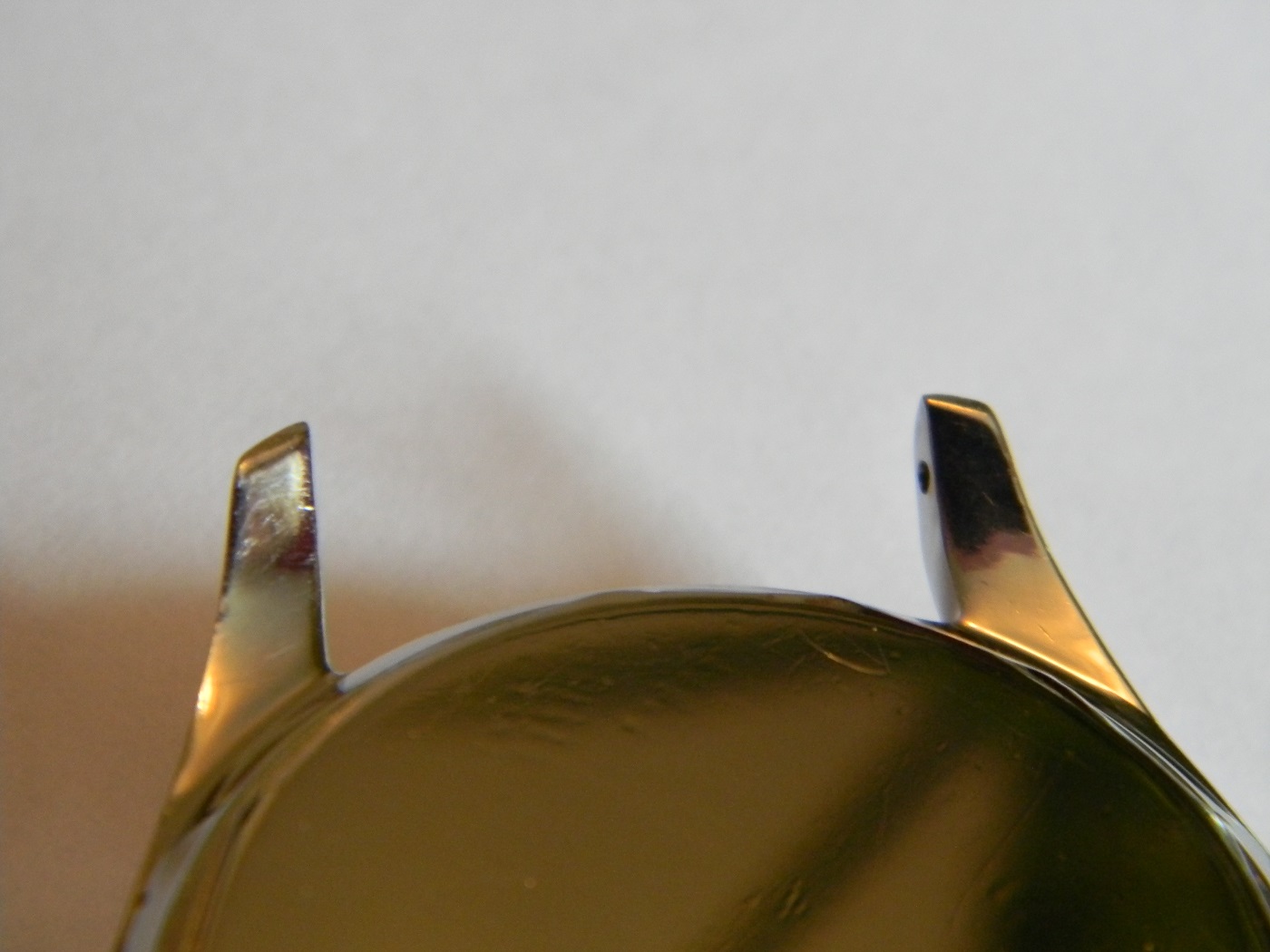

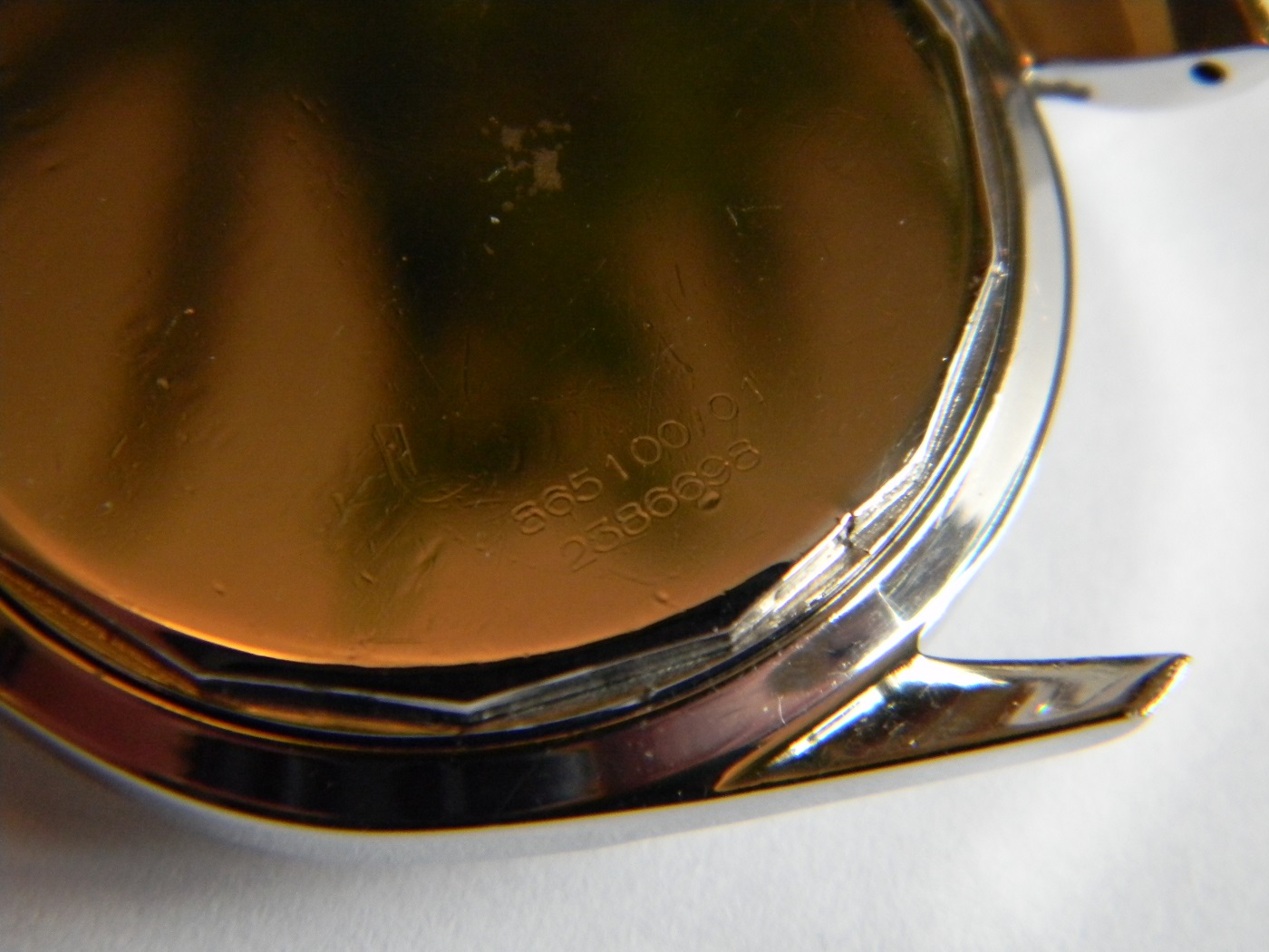

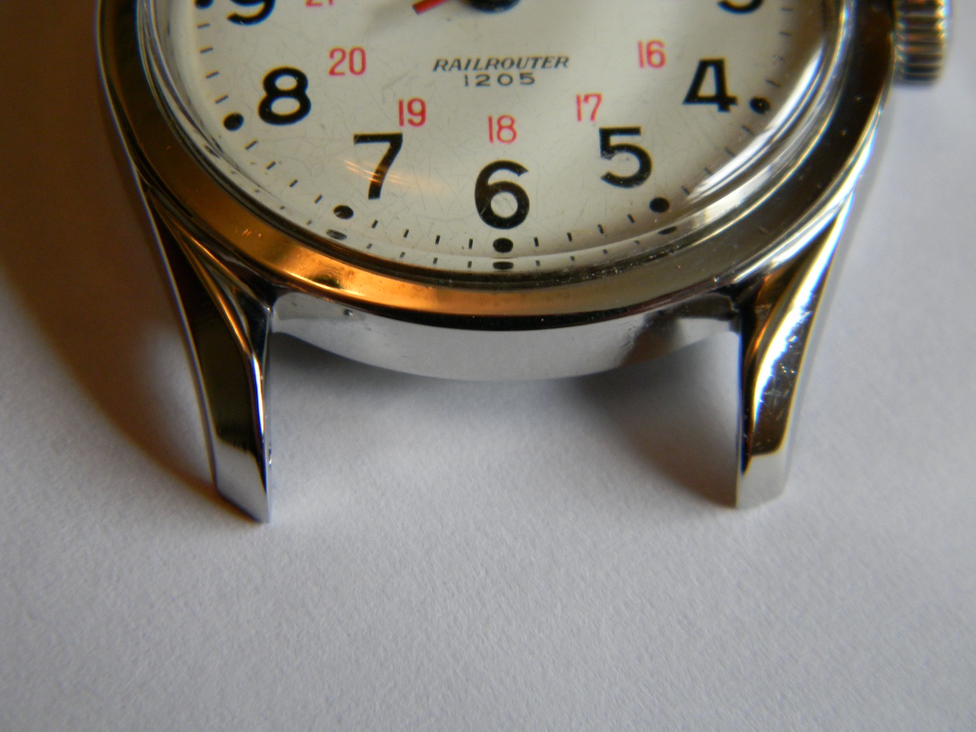

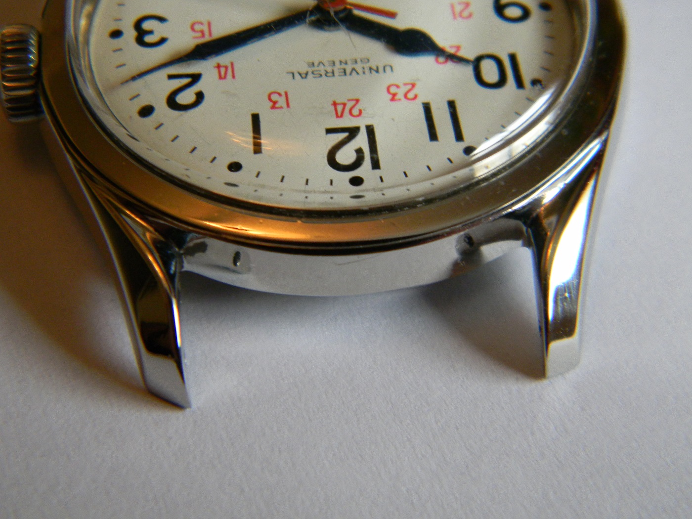

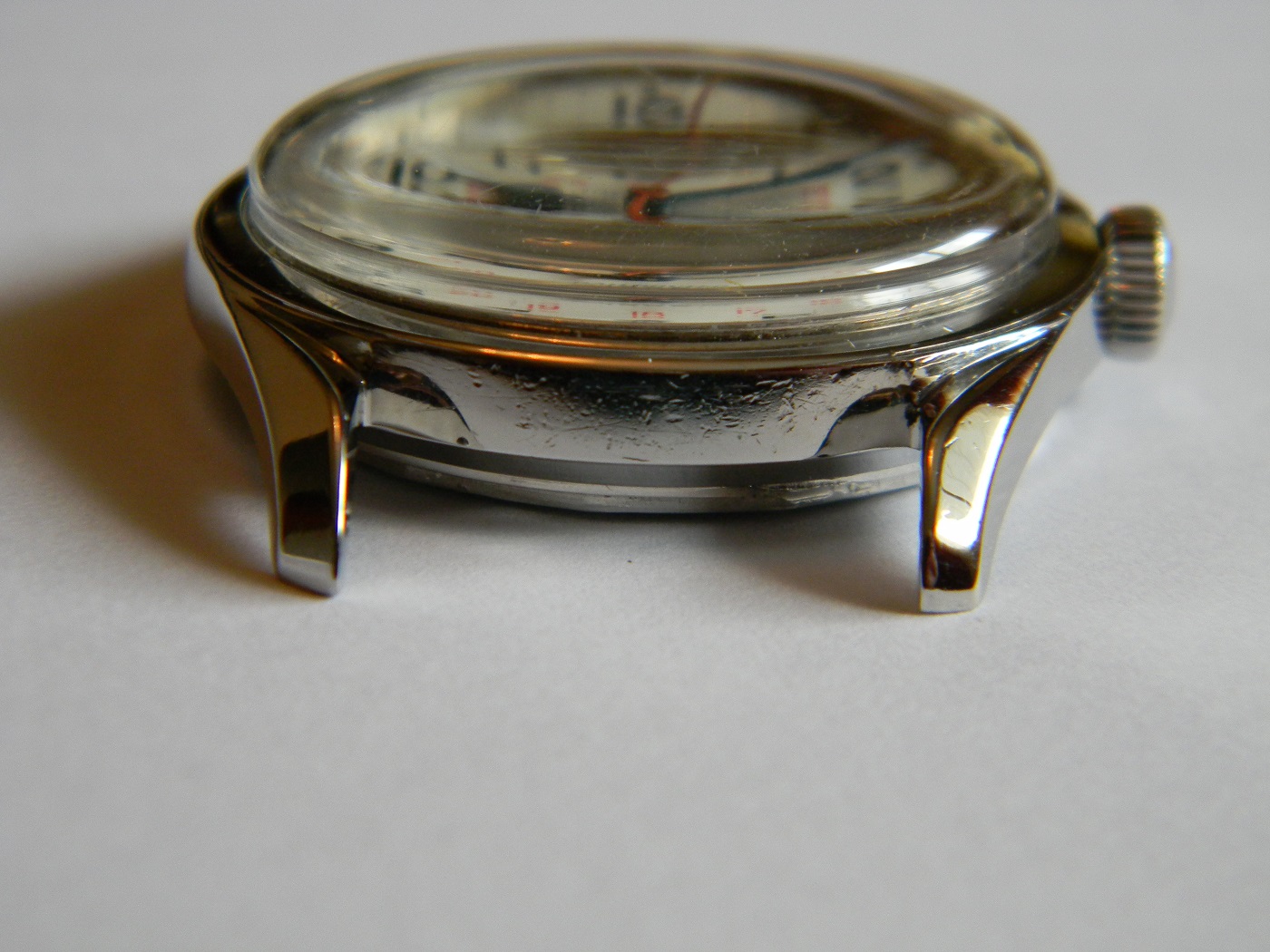

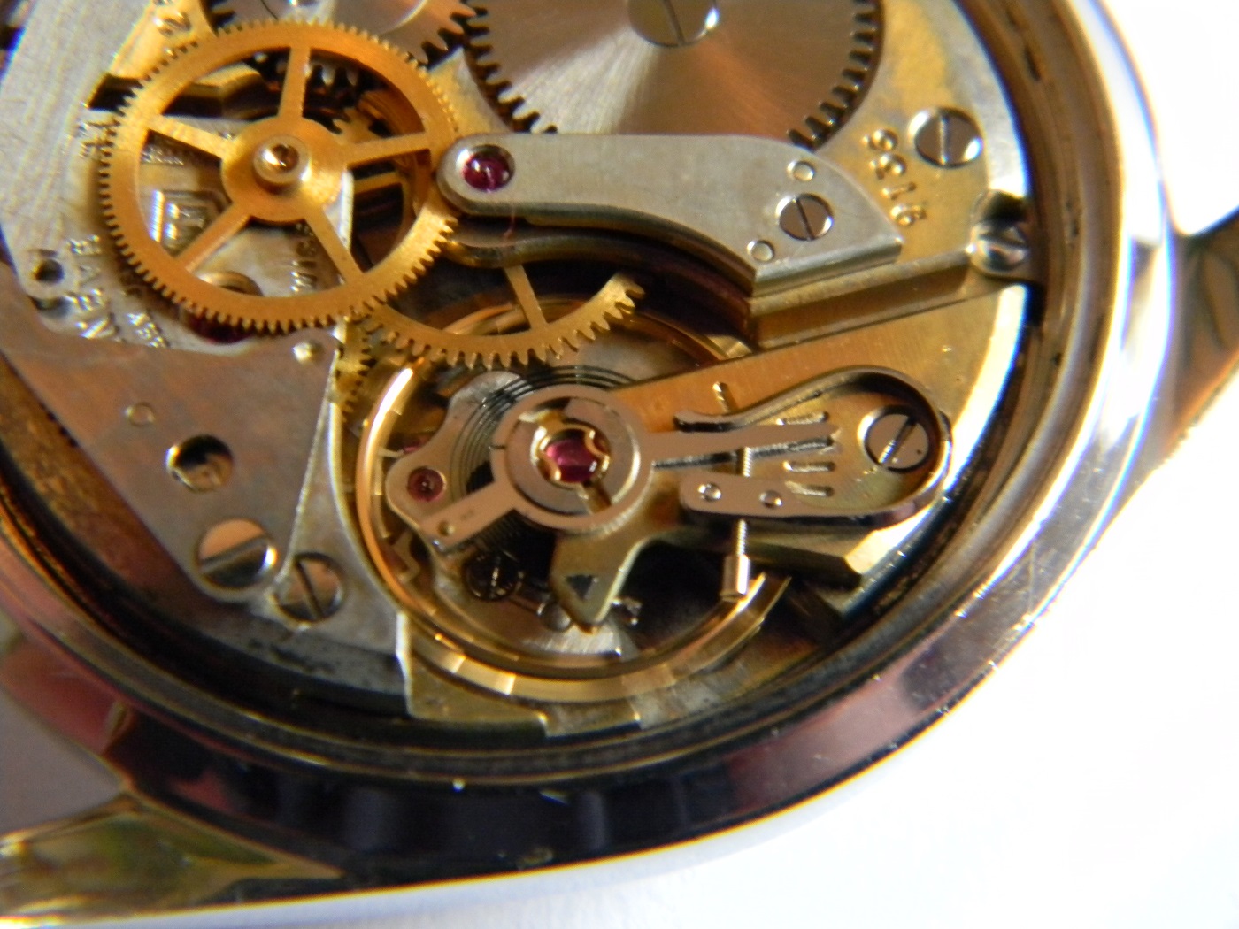

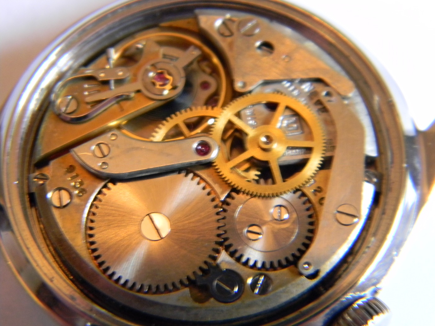

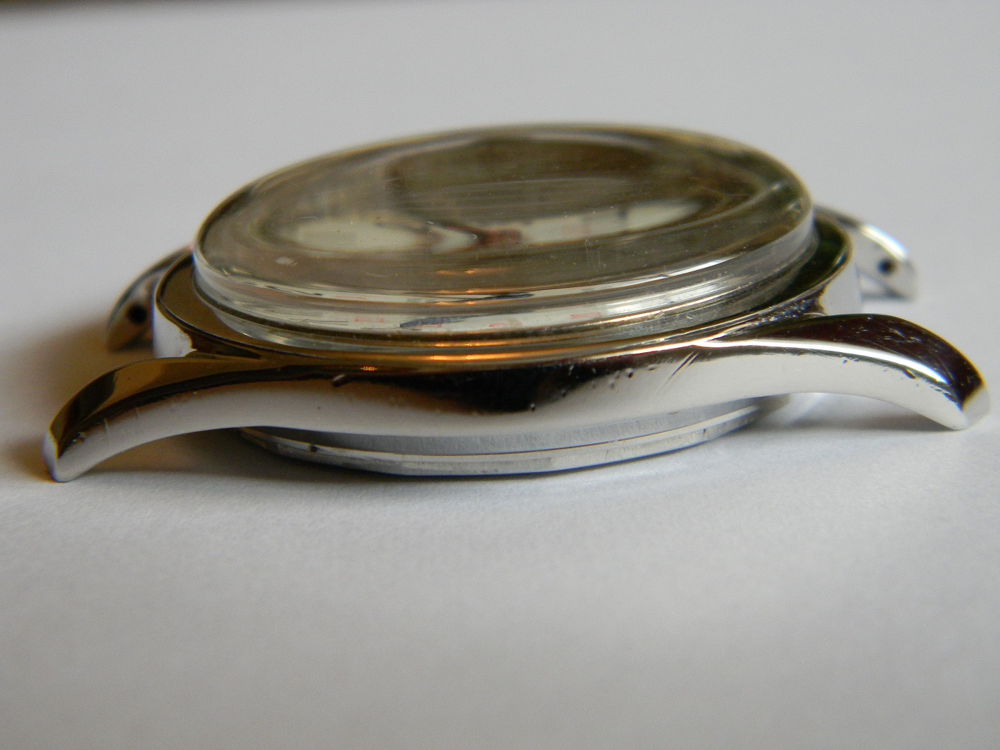

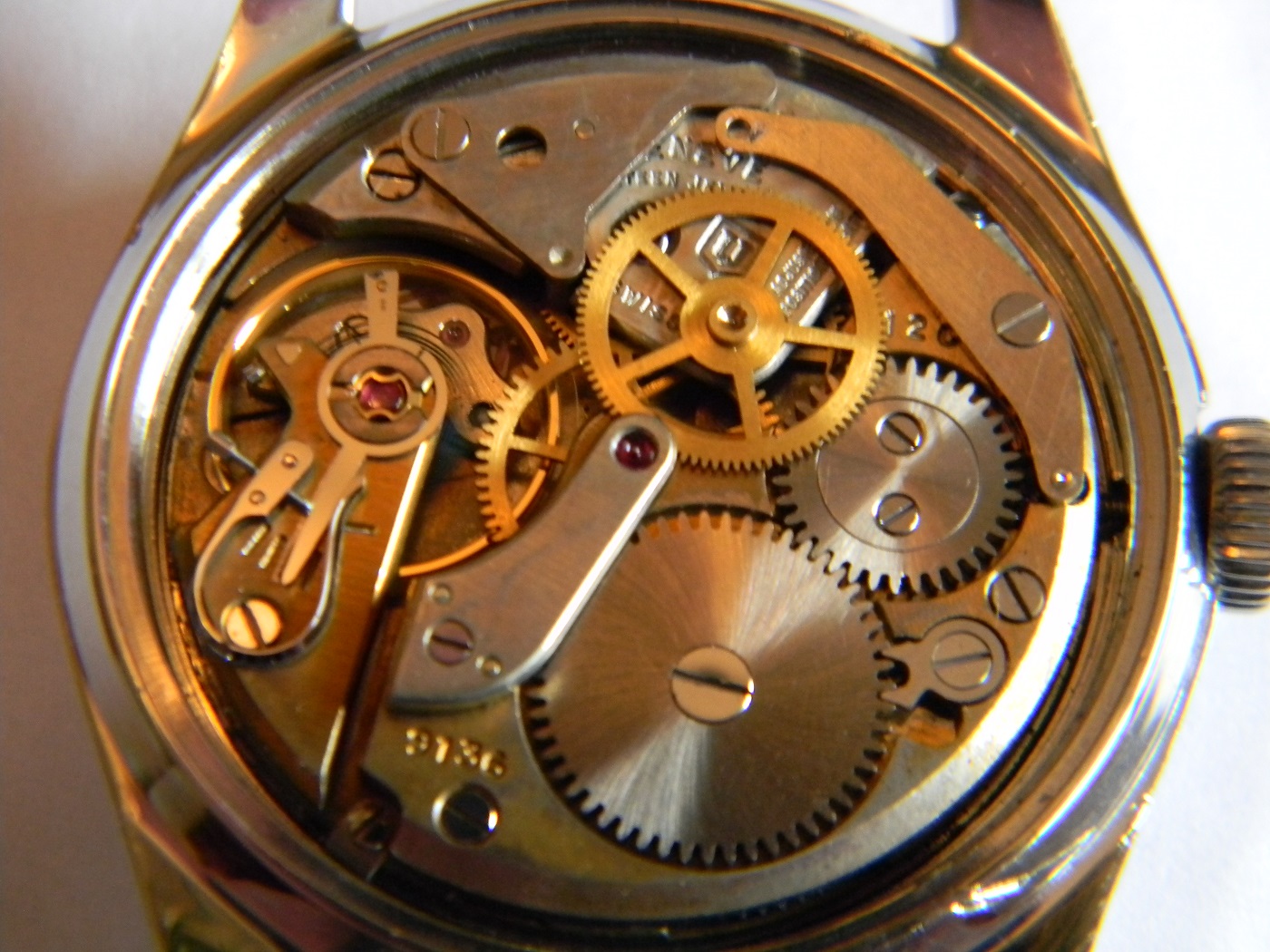

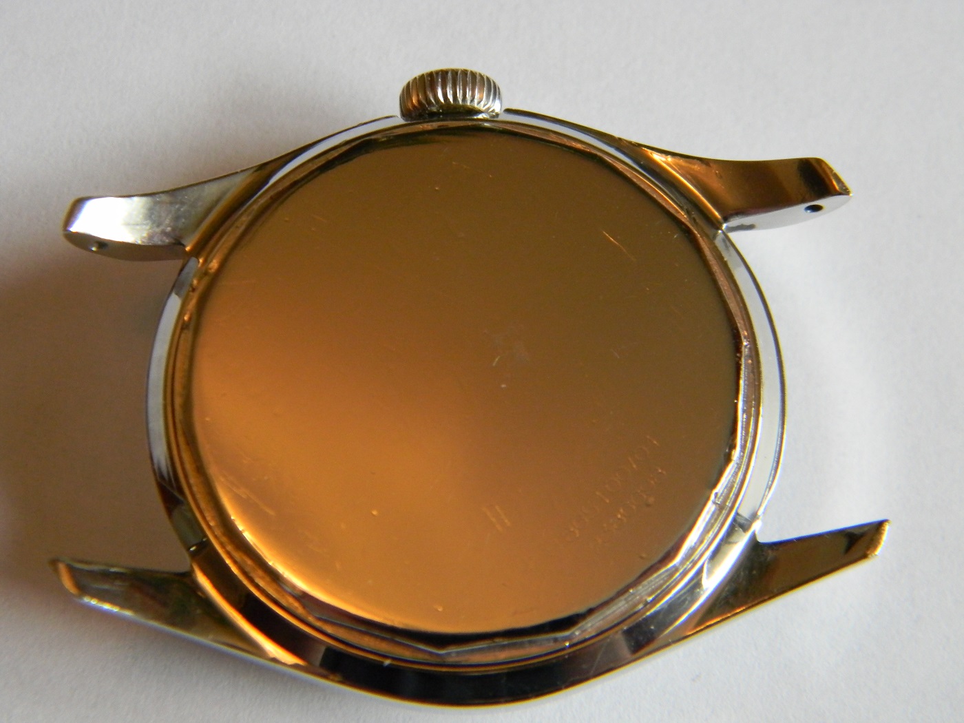

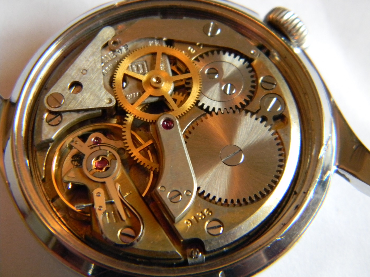

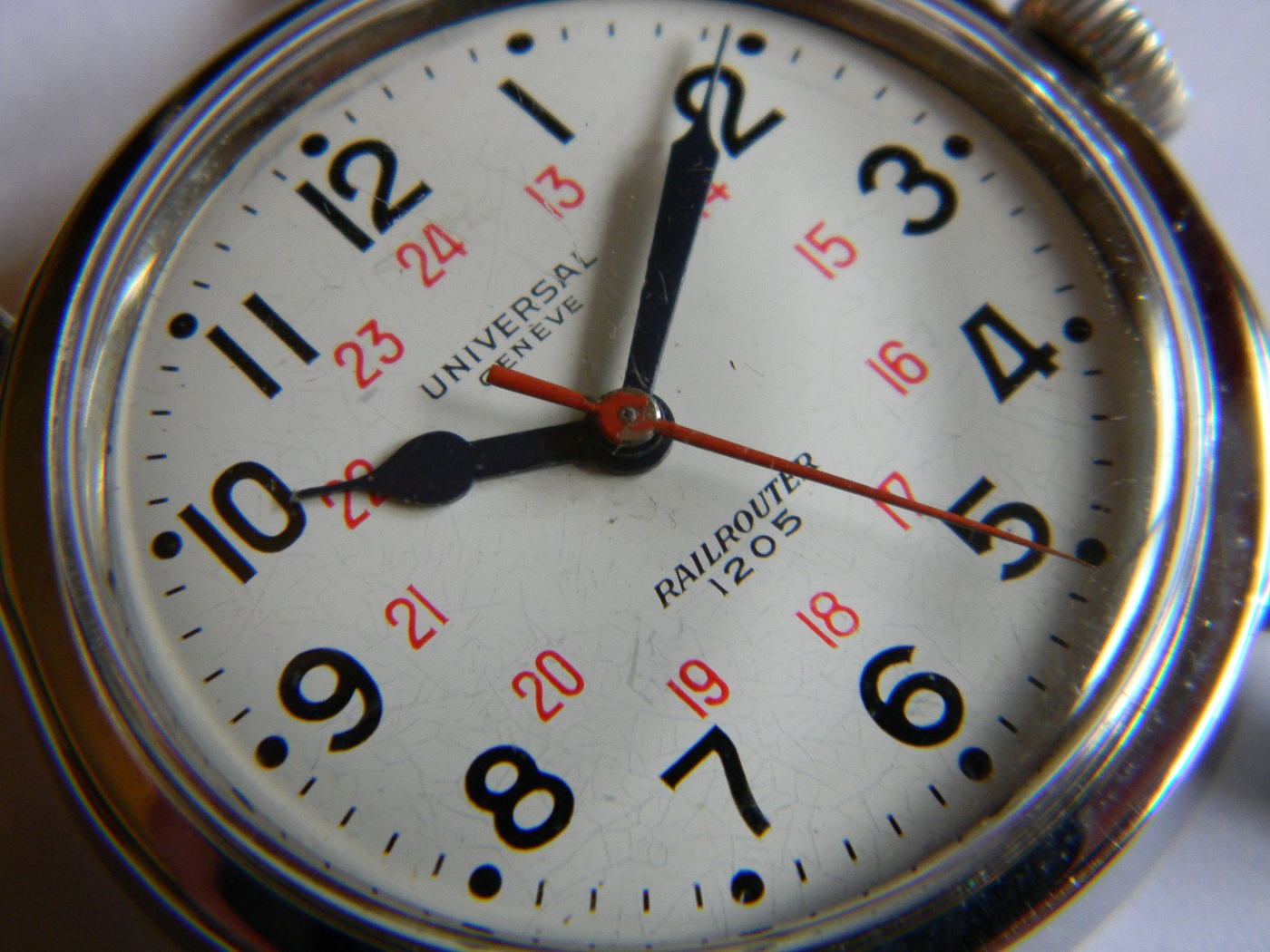

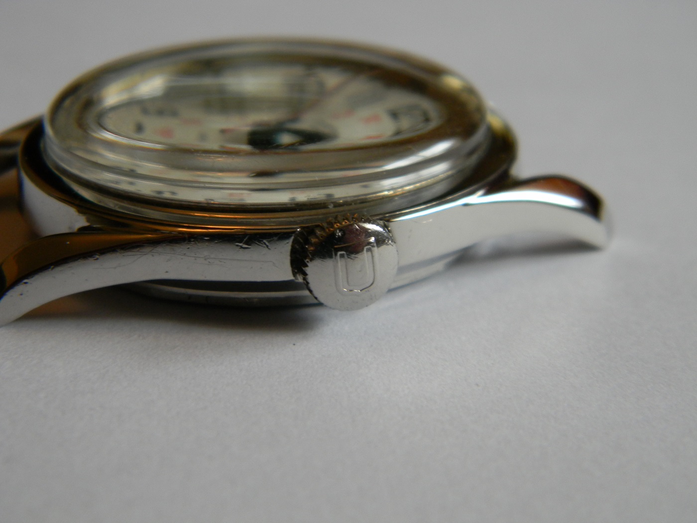

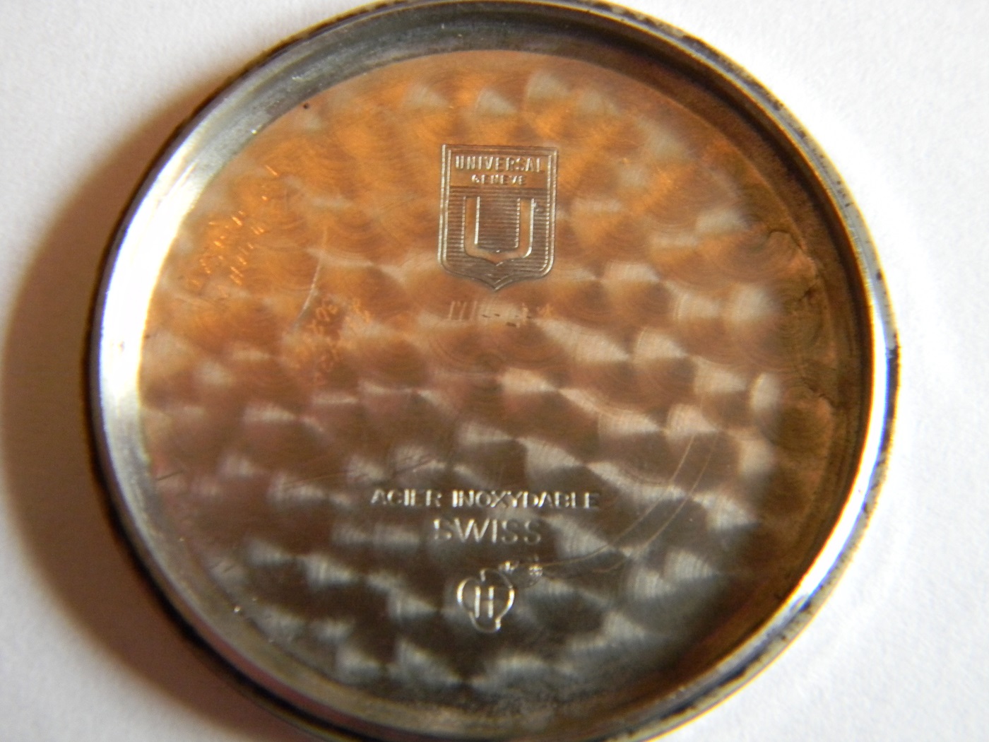

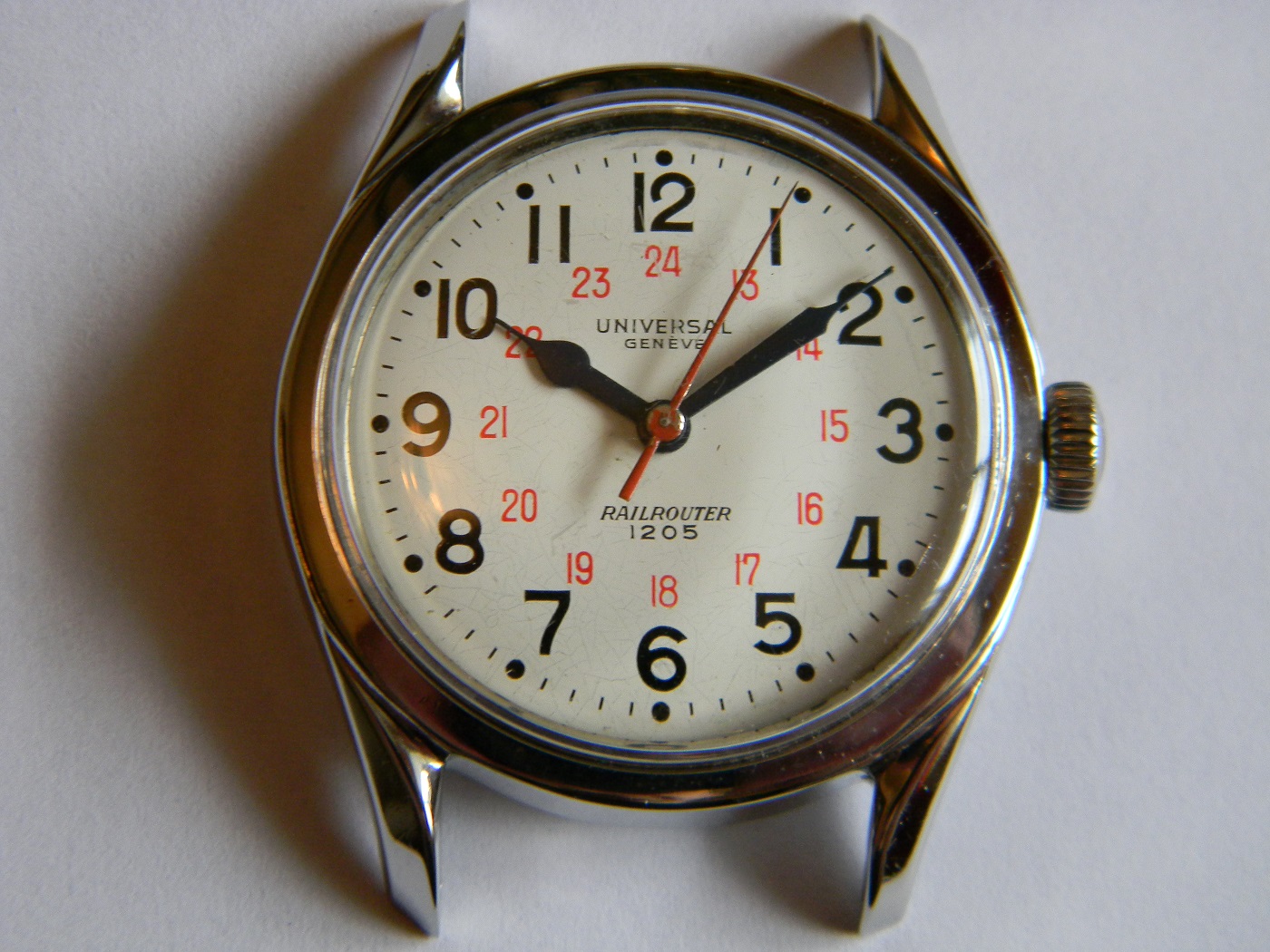

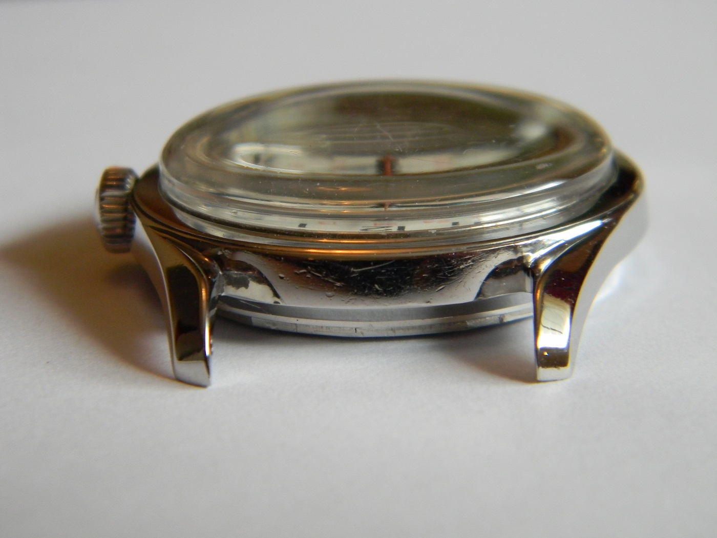

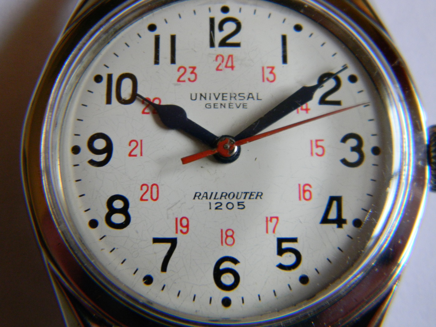

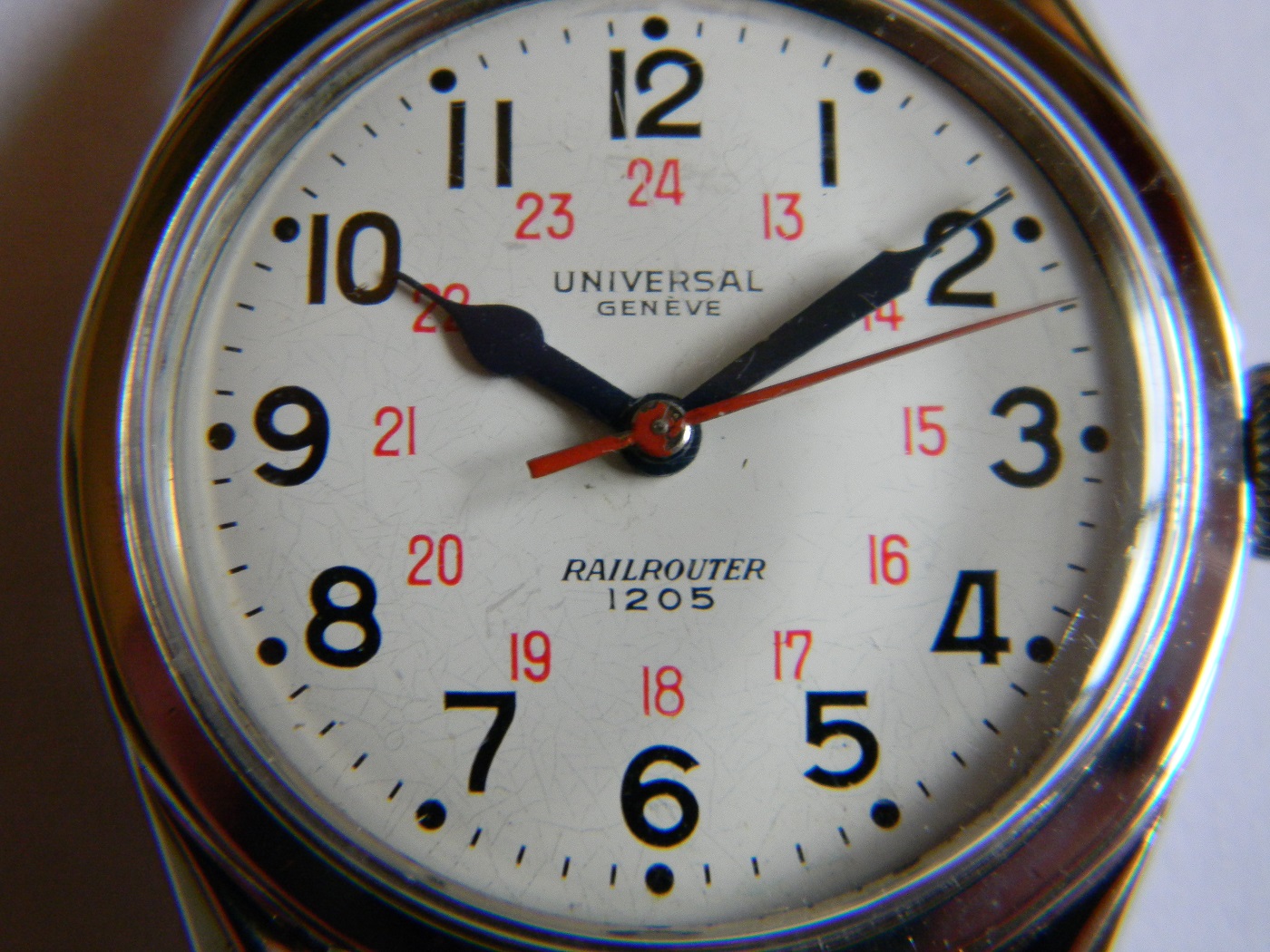

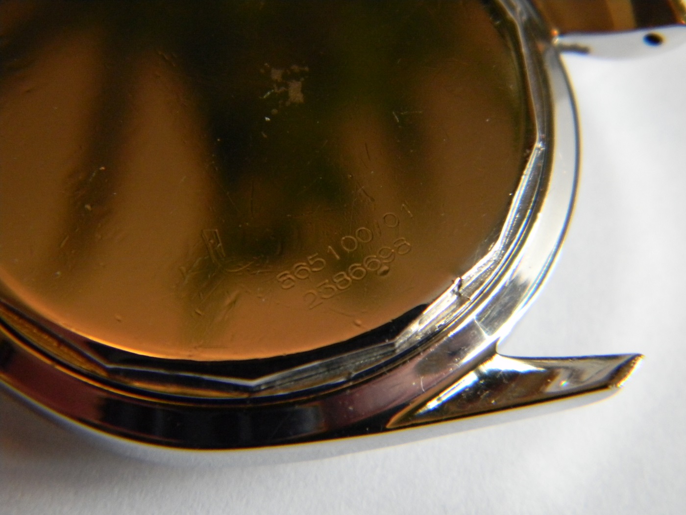

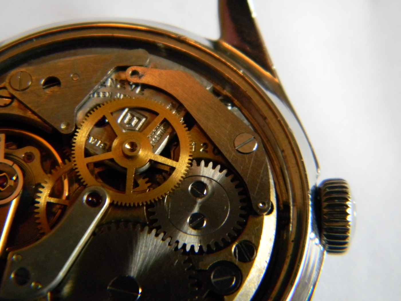

I was able to take the watch home and take some pics. I have a couple of concerns with the watch, the first being that the case was polished at some point. The second is the dial does not say SWISS and all the pics I've seen of these watches have a Swiss marked dial.
69
150
I have or have owned every steel UG Railrouter variation. The market for fully authentic pieces based on condition and which variation it is (some rarer than others) is around $1000-$2500. The biggest issue I see with this piece outside of the overpolished case is the fact that it has a Chronometre movement (numbered 9136) but is not in its original case which would have the same number on the case back. It it was a Chronometre movement then the dial was swapped in its life to a Railrouter 1205 dial as opposed to the Railrouter Chronometre dial it should have. Happy to share more if you like, i've handled them all 😀
1,458
940
Thanks for your reply MattF, very much appreciate it. So this is a Franken?
I found this 1205 non chronometer also with a chronometer number on the movement:
http://ninanet.net/watches/others16/Mediums/mug1205.html
And another in this extensive write up on the Railrouter (go to the section called RAILROUTER 1205 MODEL):
https://thespringbar.com/blogs/guides/railrouter-universal-geneve/
Is the value badly diminished because of the incorrect case and dial?Please feel to add anything else you can with this watch.

yep, OP caught it.
dial has lots of crazing lines
This is true. As a pocket watch collector I look for how stable the dial is and it appears the glaze is showing crazing but the enamel itself is stable.
1,458
940
I spoke with the owner this morning and only two people have owned this watch--her uncle and herself. I'm fairly certain it's all original and arrived on her uncle's wrist as we see it here. I'm still curious about the lack of Swiss on the dial.
