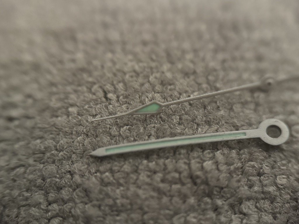

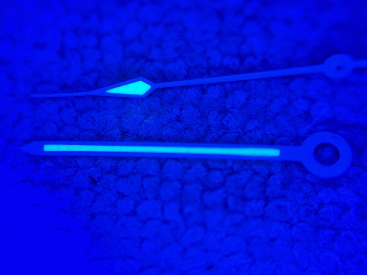

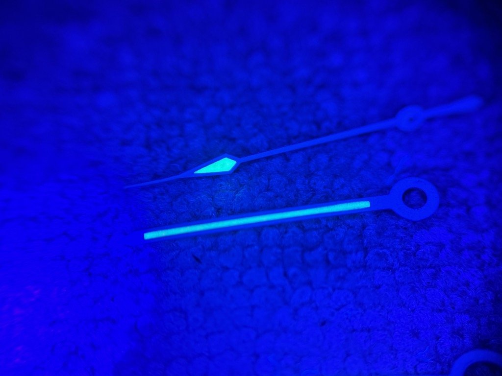

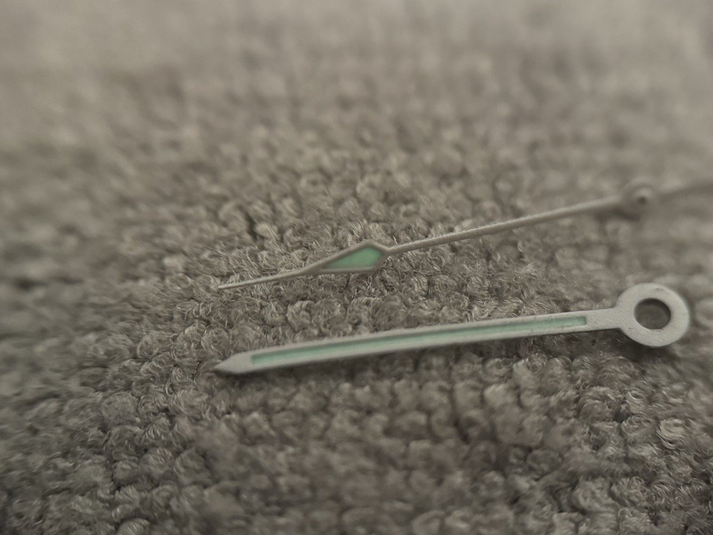

Hi OF. I purchased these Speedmaster hands based on them being described as "vintage", but the seller couldn't confirm the type of lume. I was hoping they were tritium, but they appear to be superluminova. Does that look correct? Thanks,
13,555
23,503
Look luminova. How long do they glow for? Tritium, even from the 80’s would be seconds/minutes, luminova is hours.
10,123
57,924

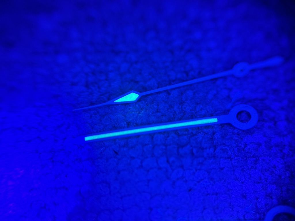

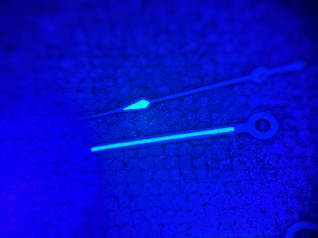

Let them sit under a bright incandescent light or bright sunlight for a bit and then take them into a closed dark windowless room. If they glow not at all or glow very faintly once your eyes adjust to the darkness: tritium. If they glow brightly: luminova. Both will glow brightly under UV light.

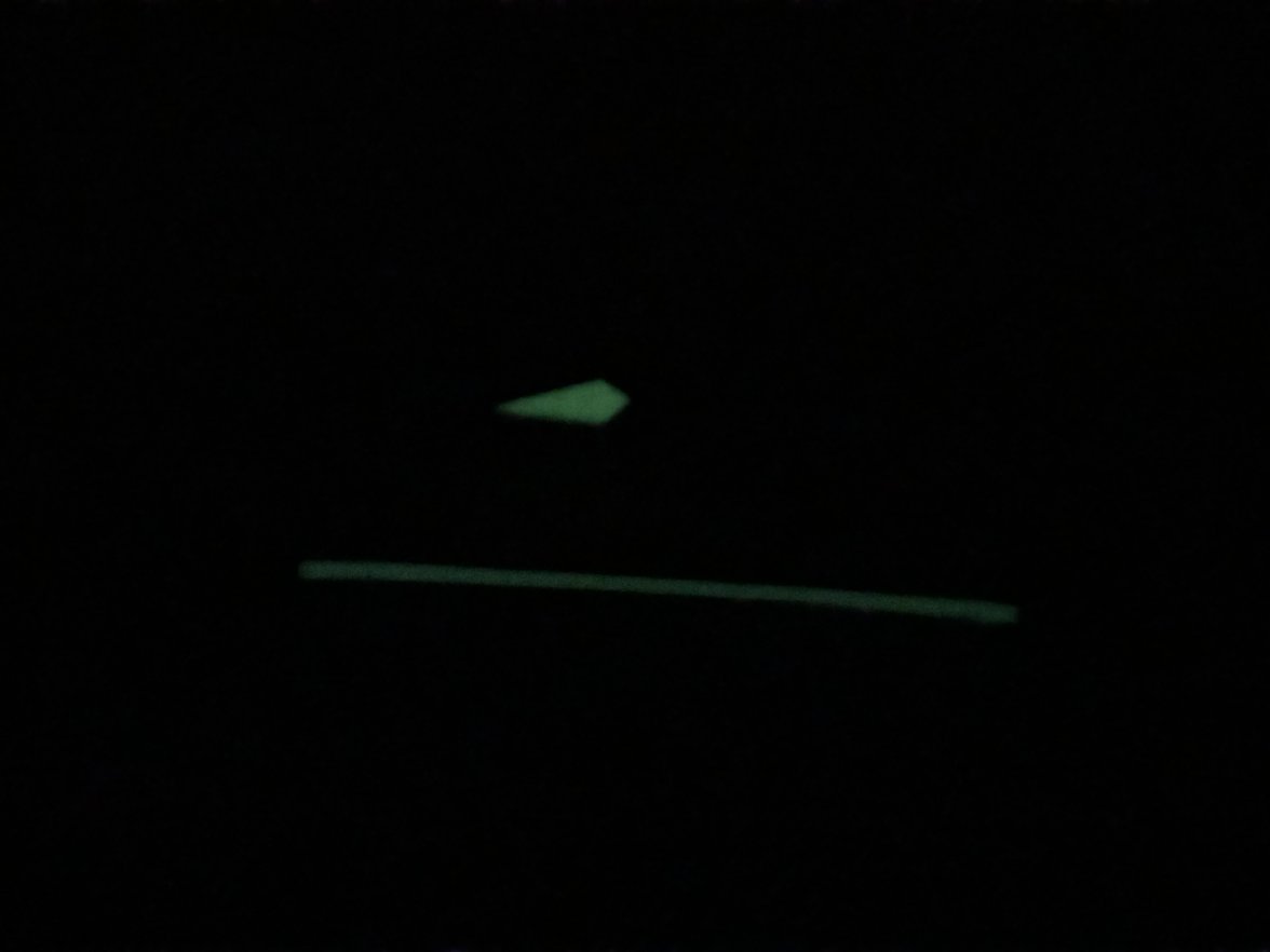

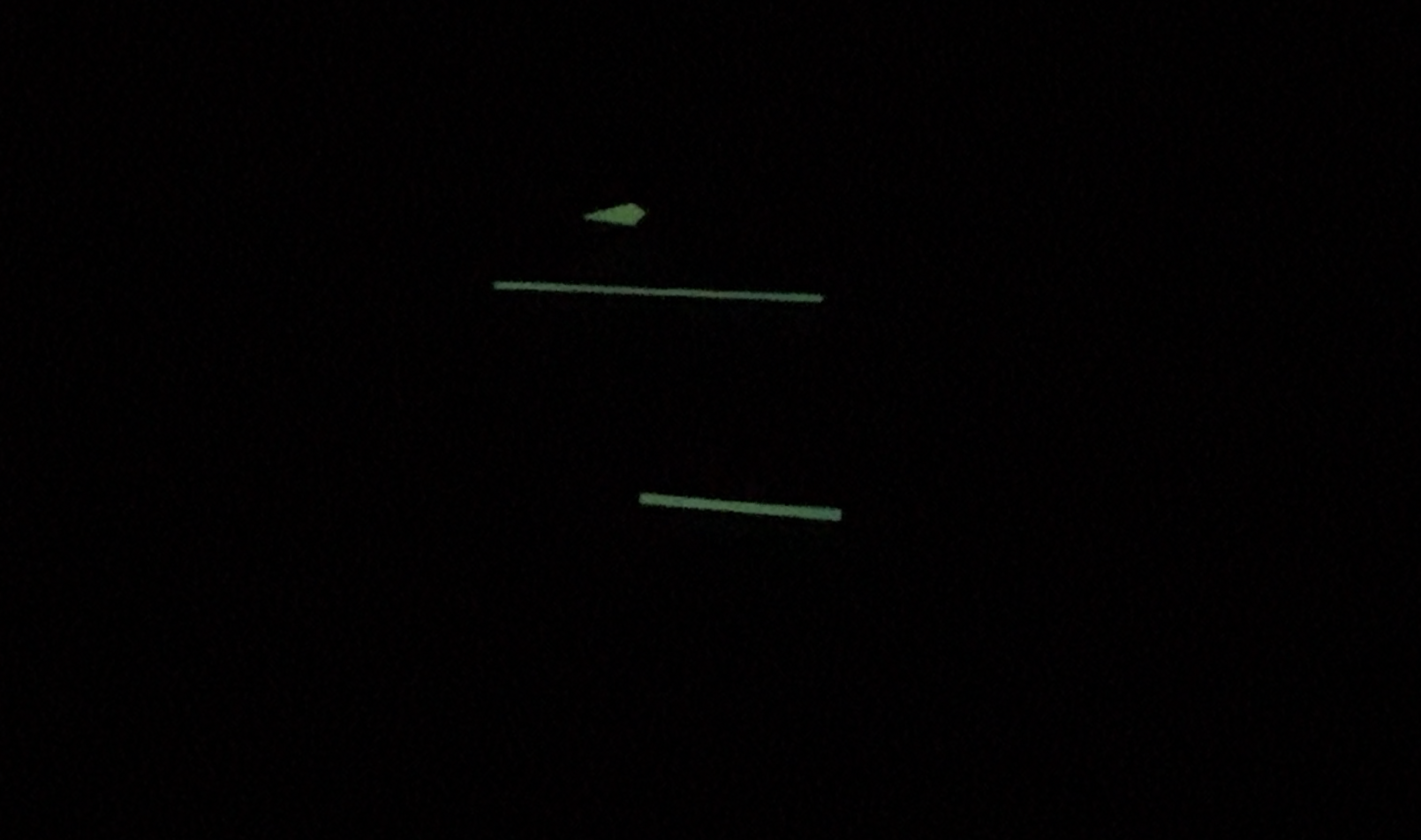

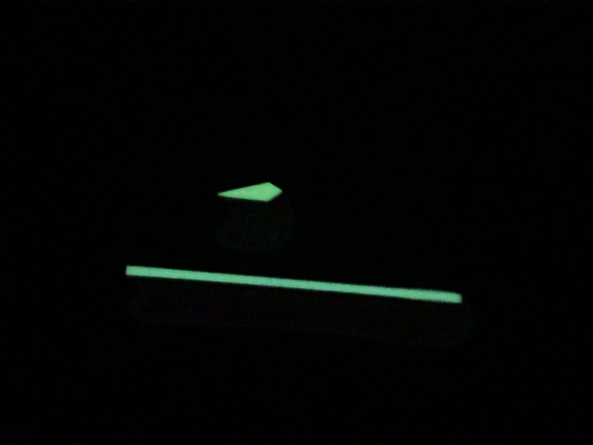

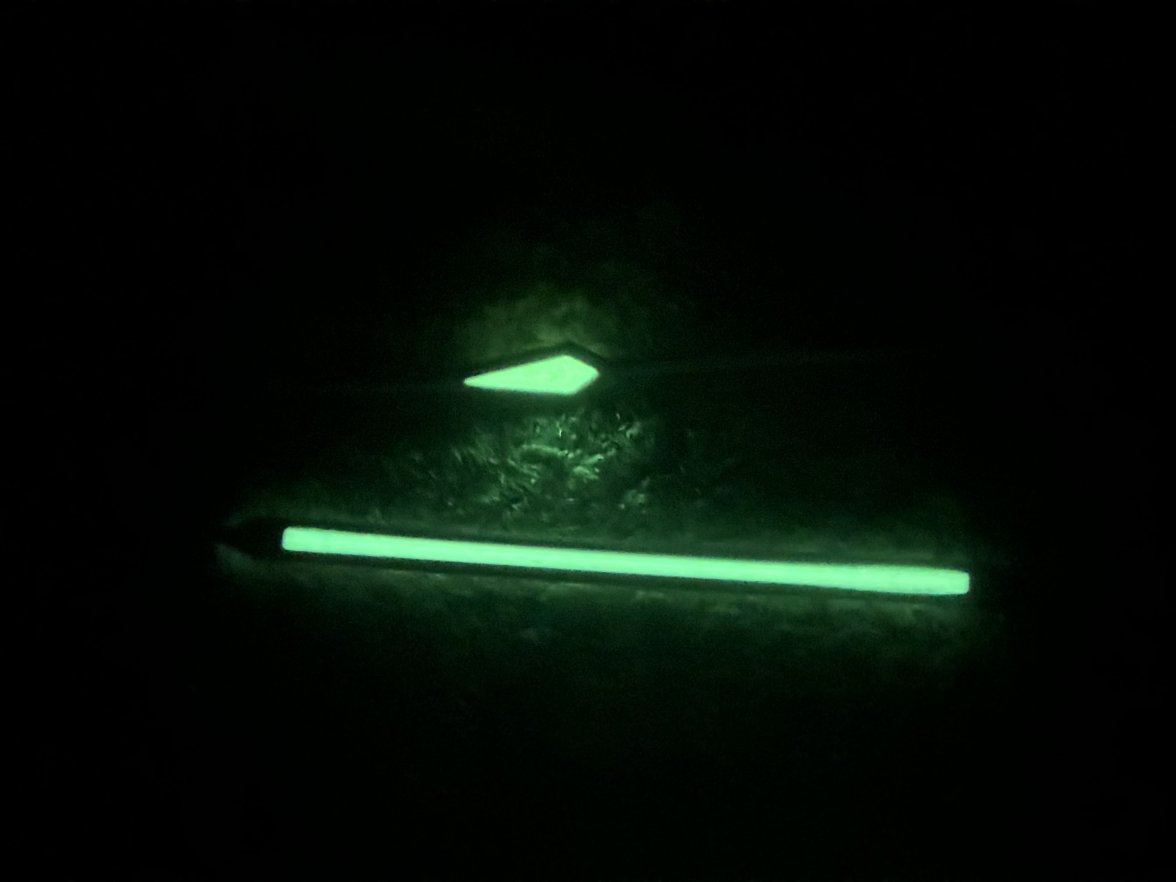

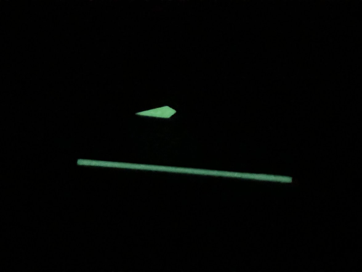

These are two photos from the start and end of a 1 minute video. You can see that they fade a bit over the course of the 1 minute. Does that look more like tritium or luminova?
4,131
8,847
Take a picture after 15 minutes. If there is any residual glow, it's luminova
10,123
57,924
Agreed. 1 minute is not enough time to evaluate.

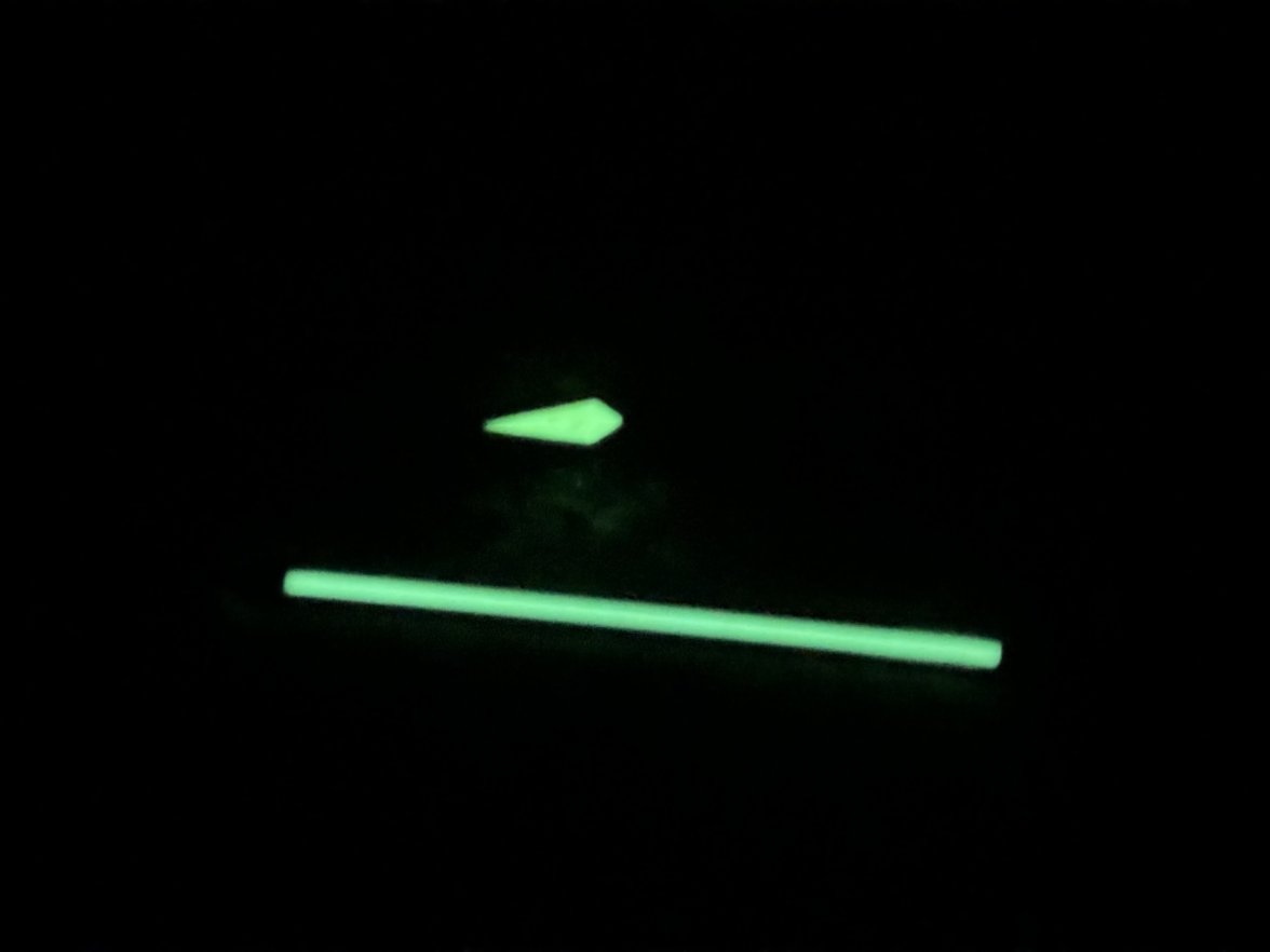

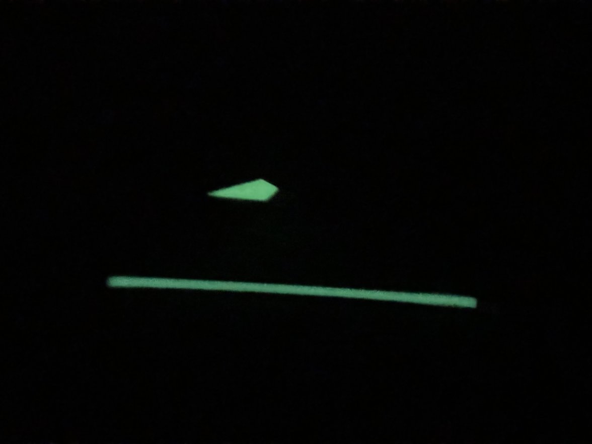

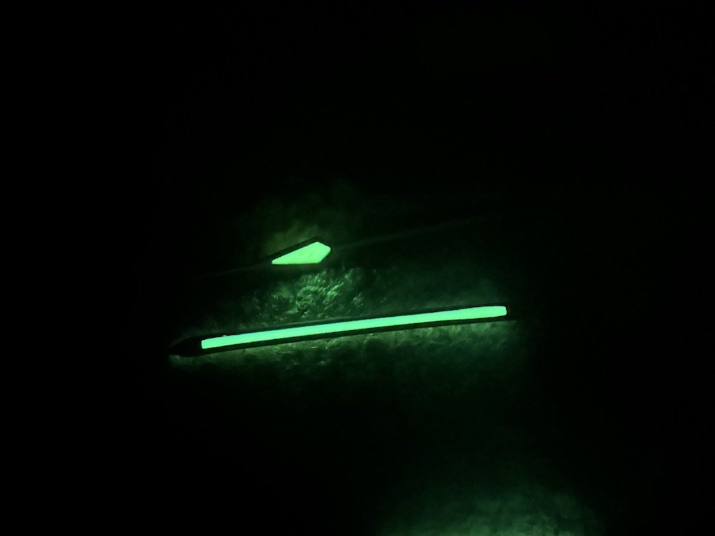

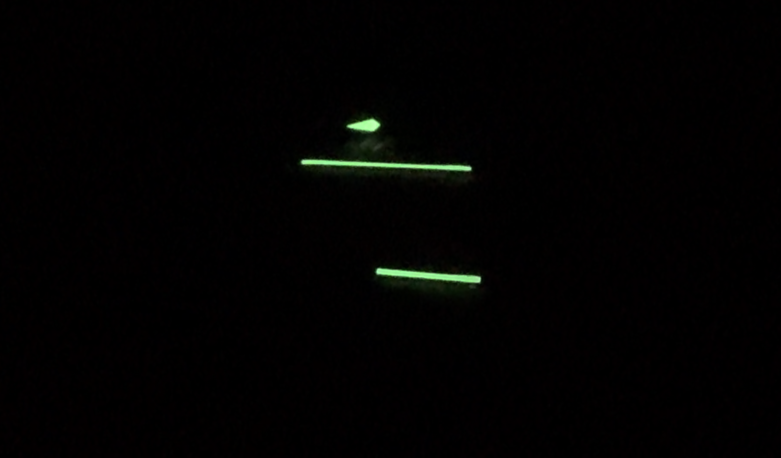

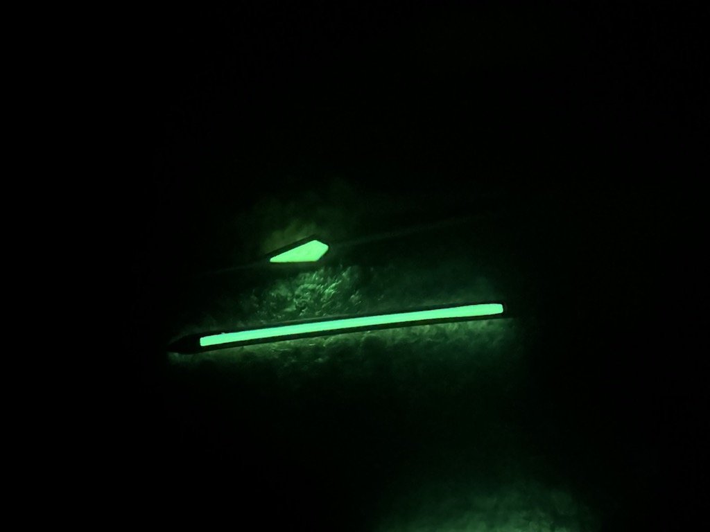

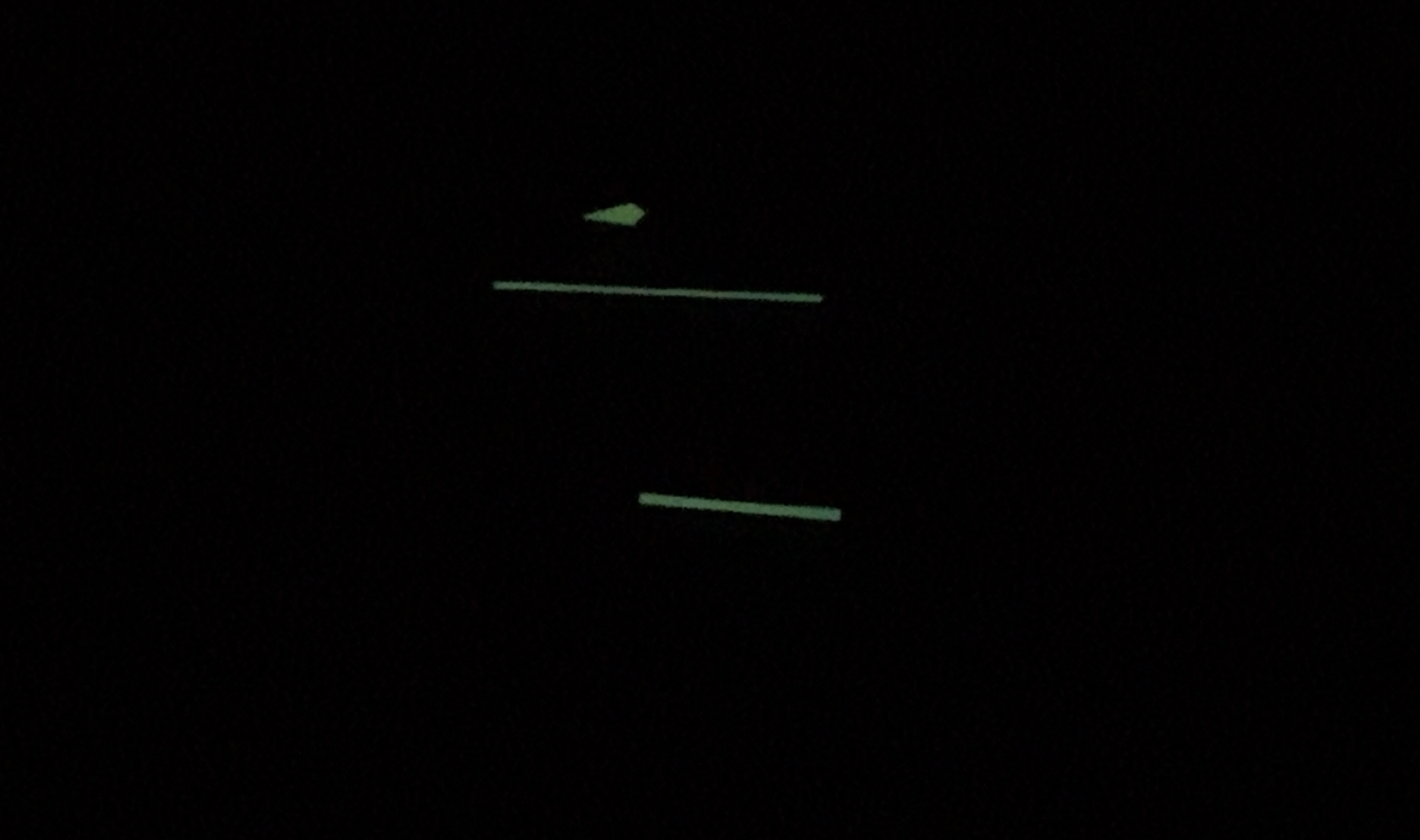

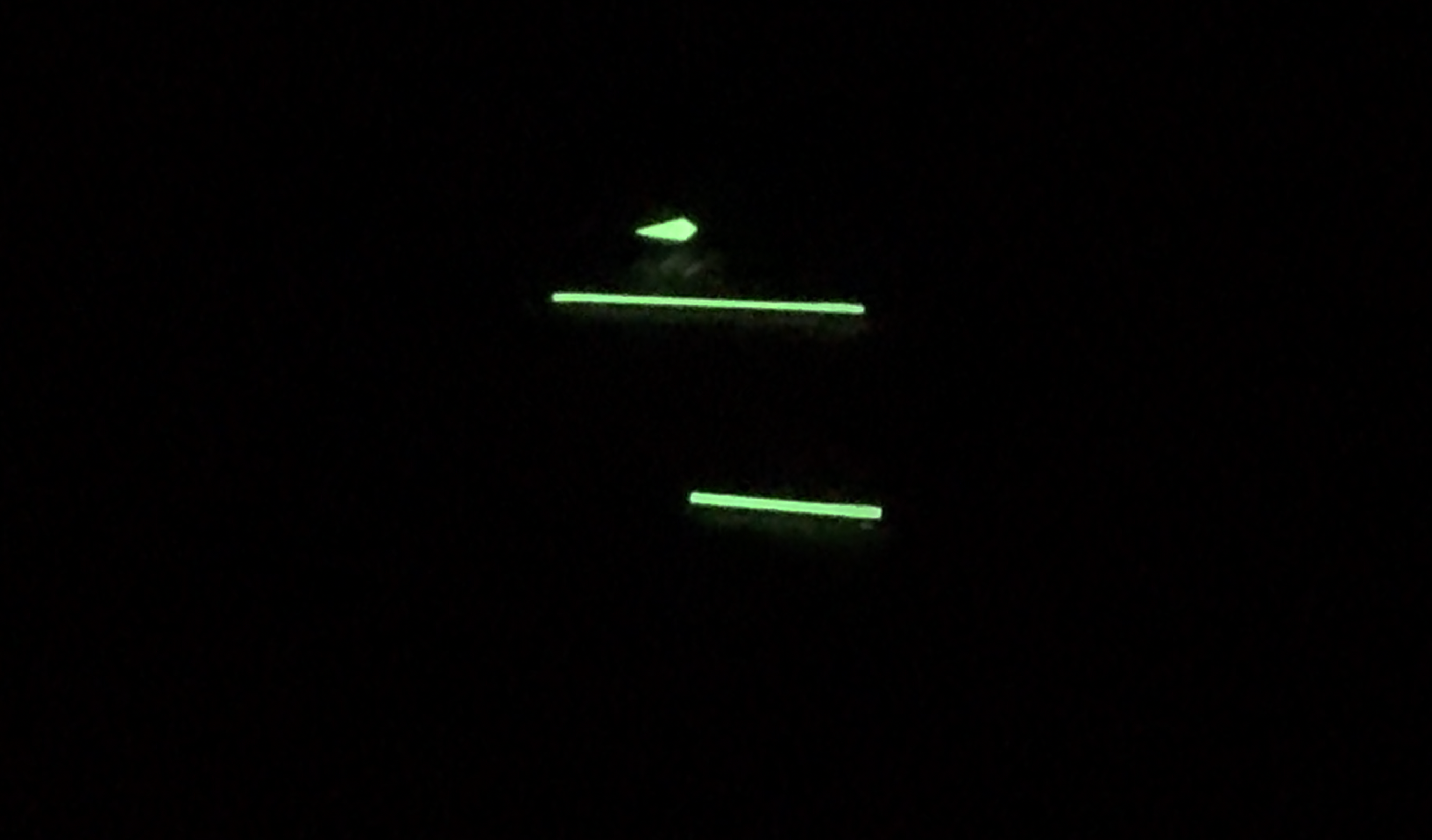

Here are a few more photos.
1) while being illuminated
2) with the illumination just turned off
3) after ~1-2 minutes
4) after ~10 minutes
5) after ~25 minutes
6) after ~35 minutes
7) after ~2.5 hours
Thoughts?

they are luminova - no way old tritium would have that level of glow after 2.5 hours
