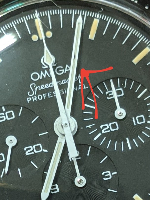

Hey you all!
Recently I had my watch serviced, and one of the hands was damaged (the minute hand) in the process.
How much would it cost me to get a good replacement? And since I am looking at Tritium hands I guess I'll have to get the whole set or the patina won't match.
Is eBay a good place to look? Where else do you think I should have a look?
Thank you so much to you all!

If it was me I'd contact someone who does a good relume work and let him try to fill in the tiny gap, before I'd spend 500 or even much more for a complete and well preserved tritium hand set. The lume of the hands could also be stabilized once they would lie on the bench.

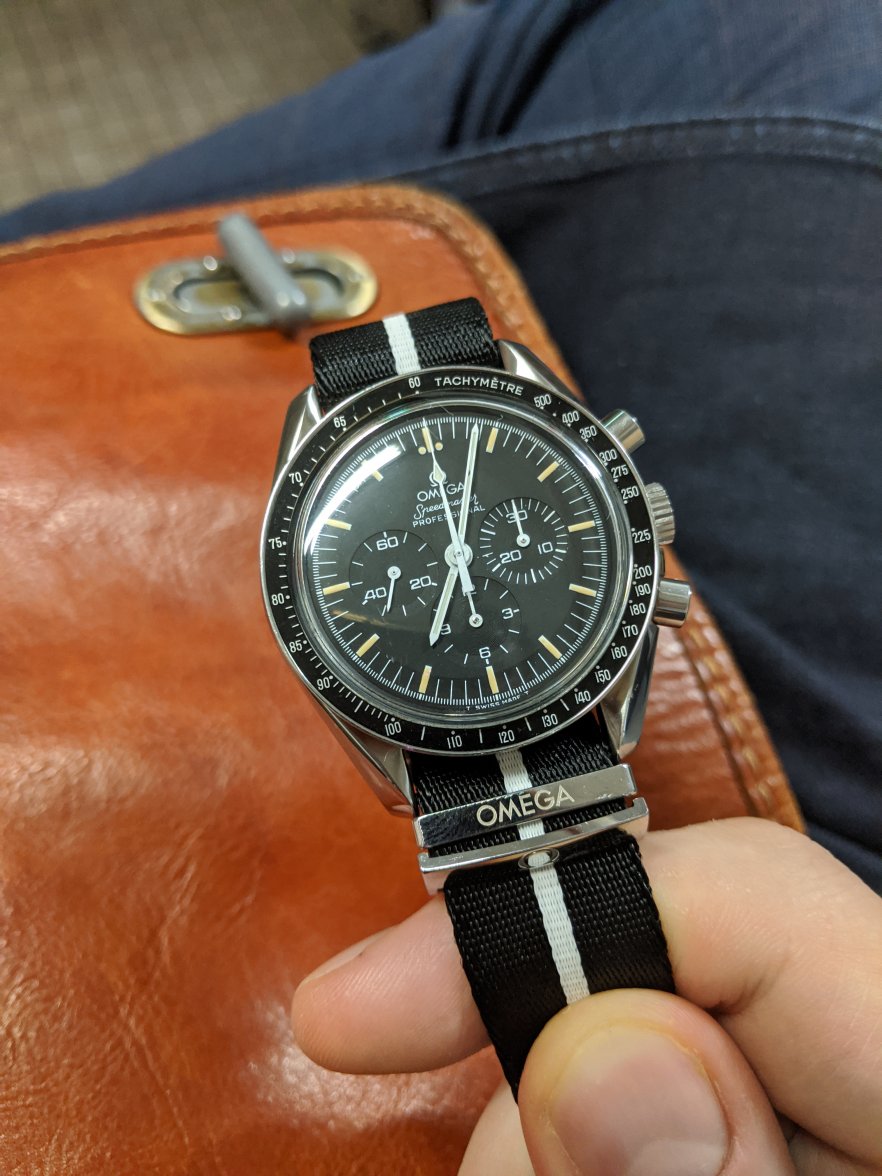

It looks like the original hands have been replaced with Luminova hands at a previous service, along with the bezel.
Getting your watch back to how it left the factory won't be cheap.

I am aware bog that. The current hands are Tritium, but much younger than the dial

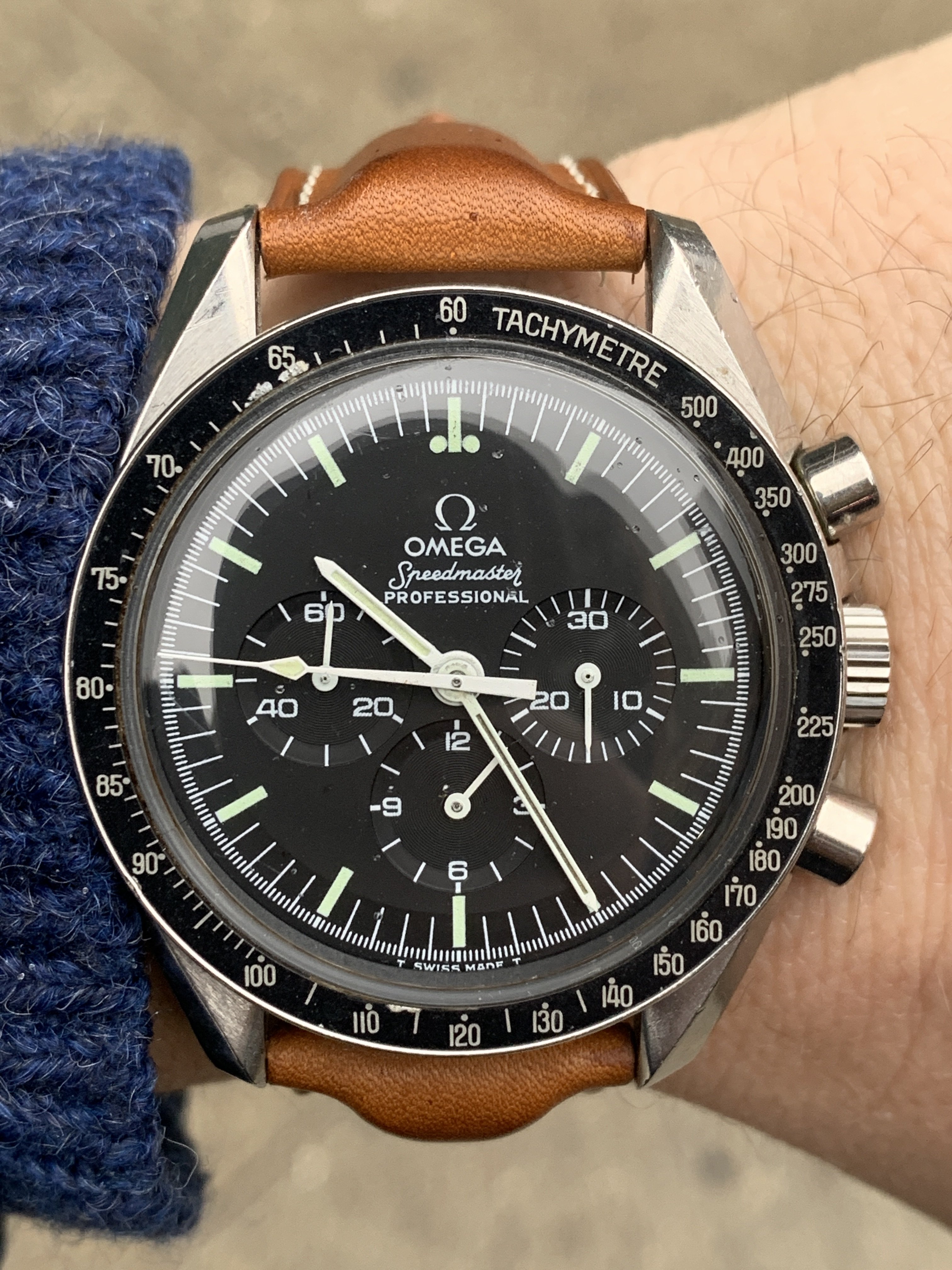

You wouldn’t need a DON bezel, just a period correct one for your late 70’s 145.022. Should have the dot next to 70 as pictured below.
