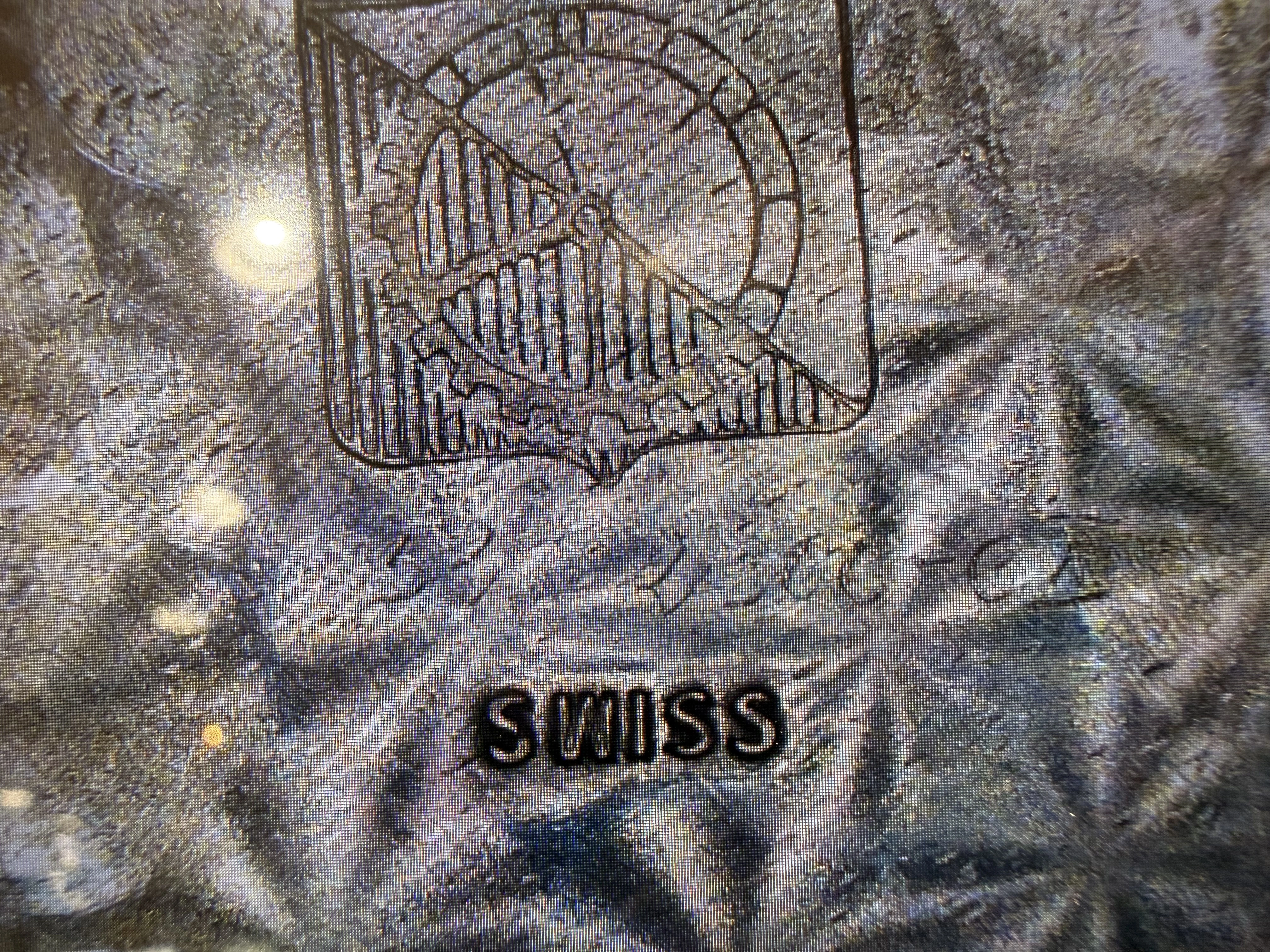

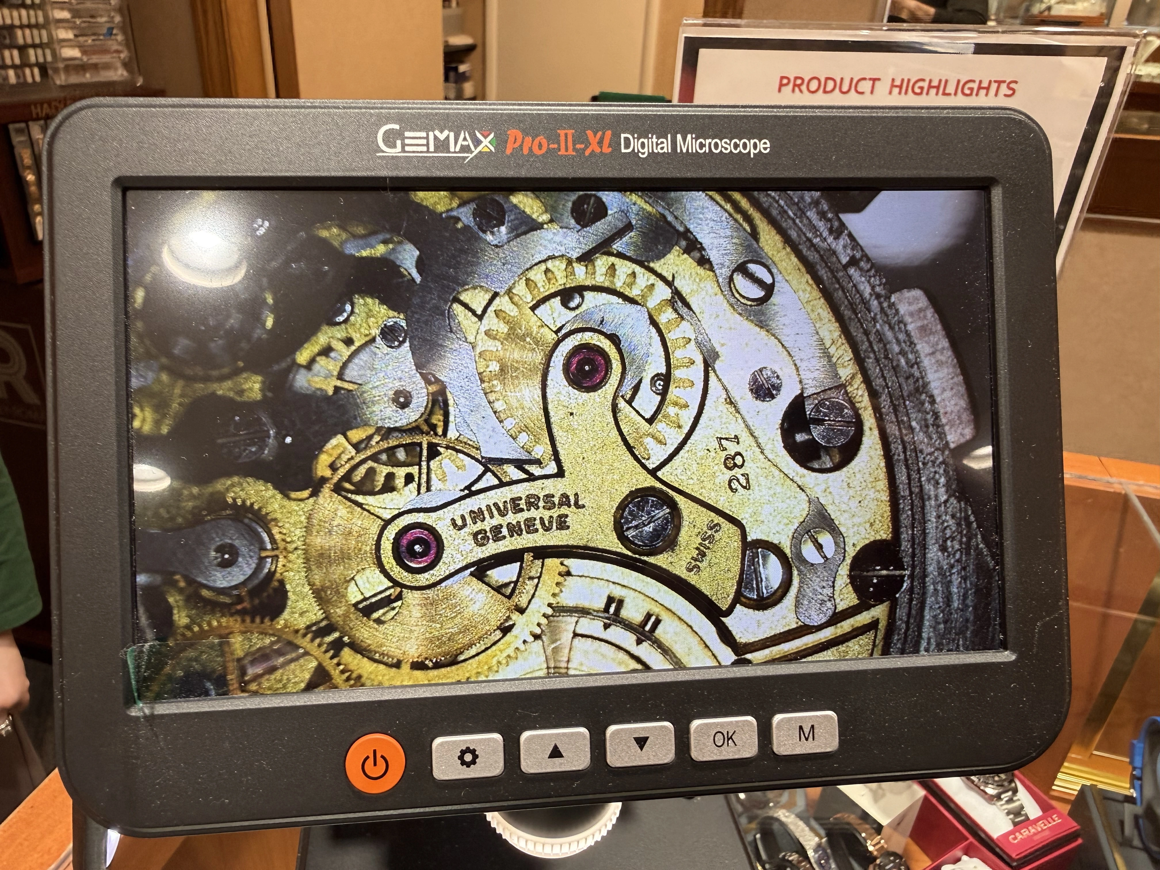

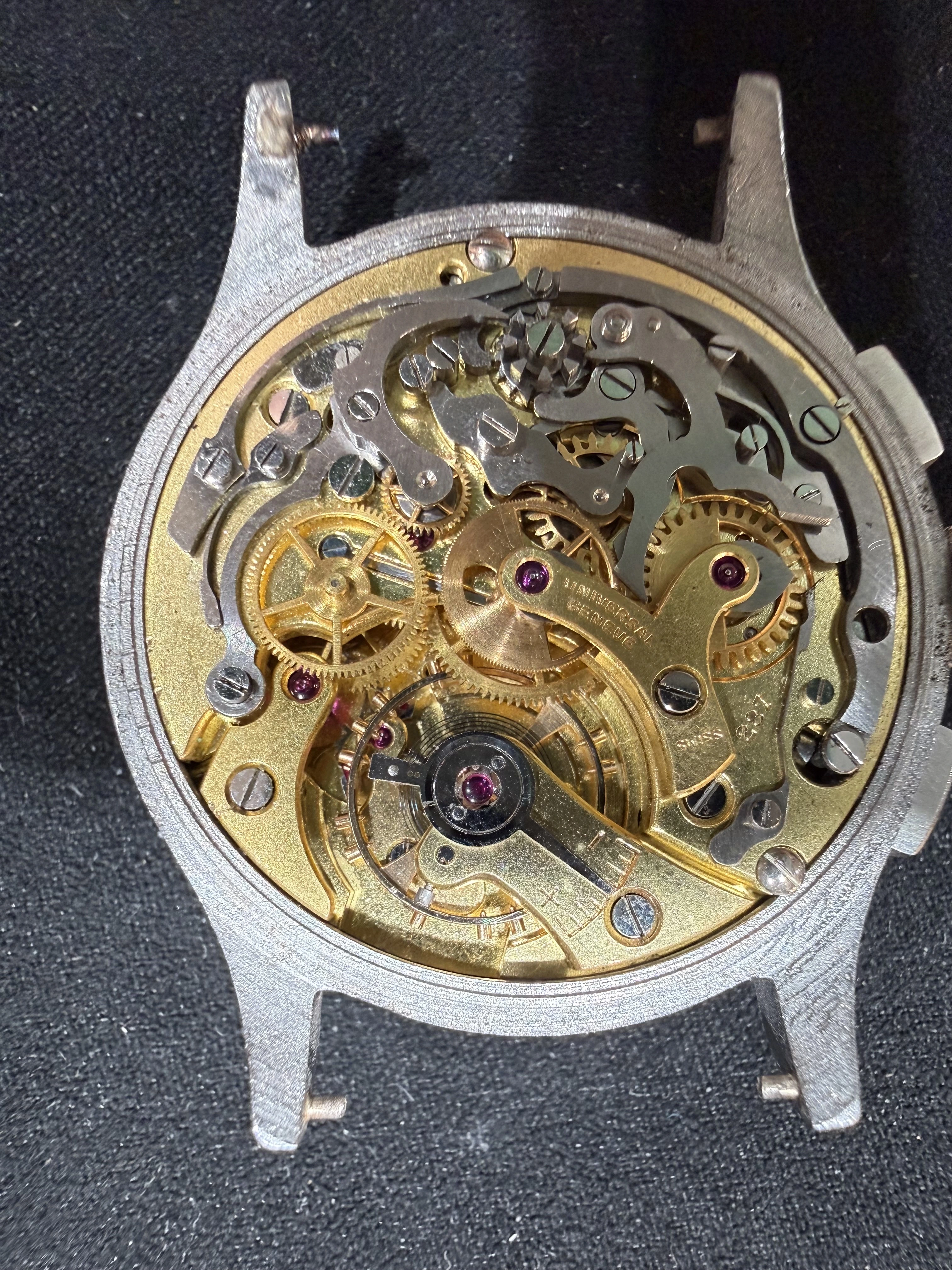

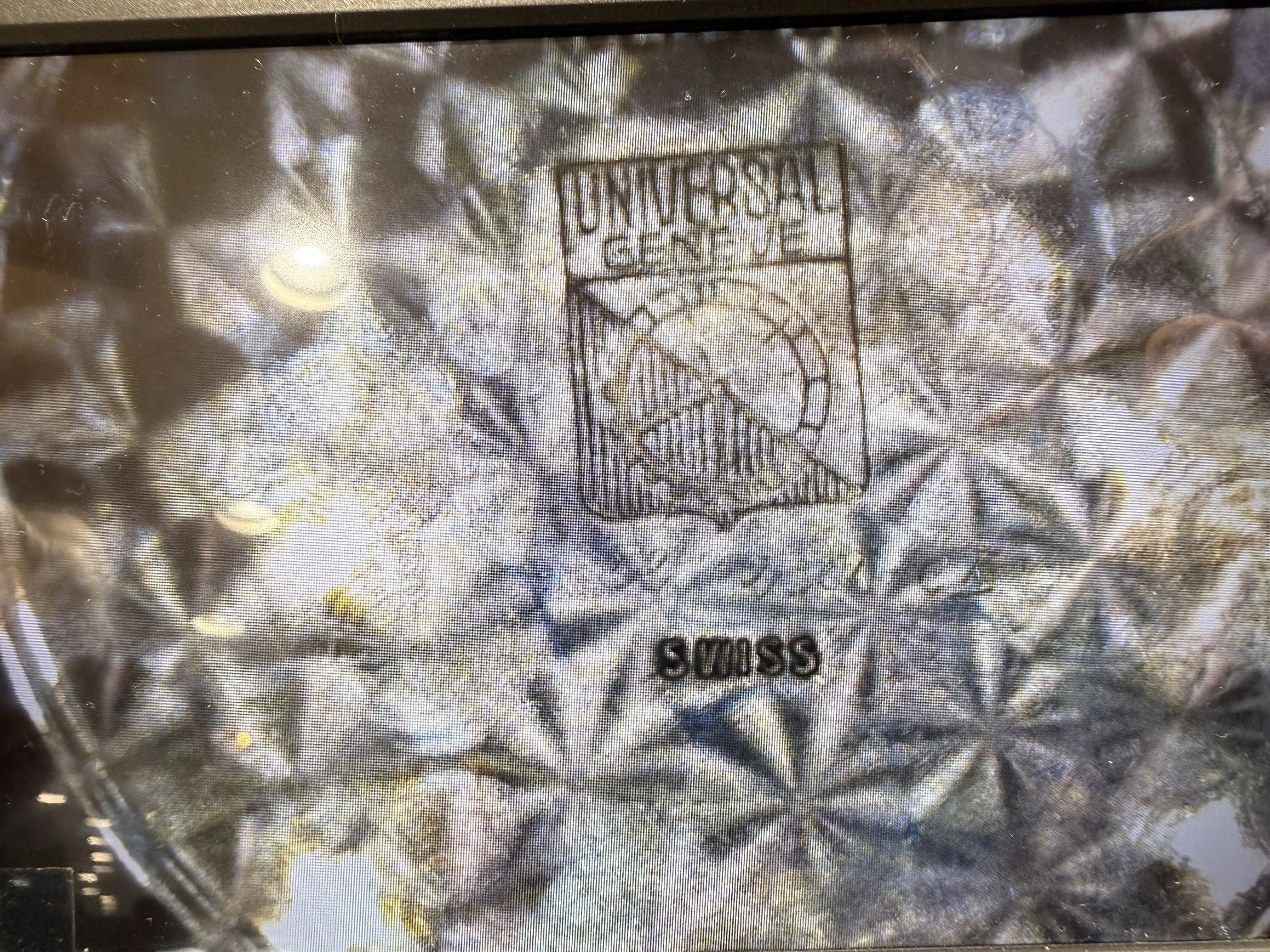

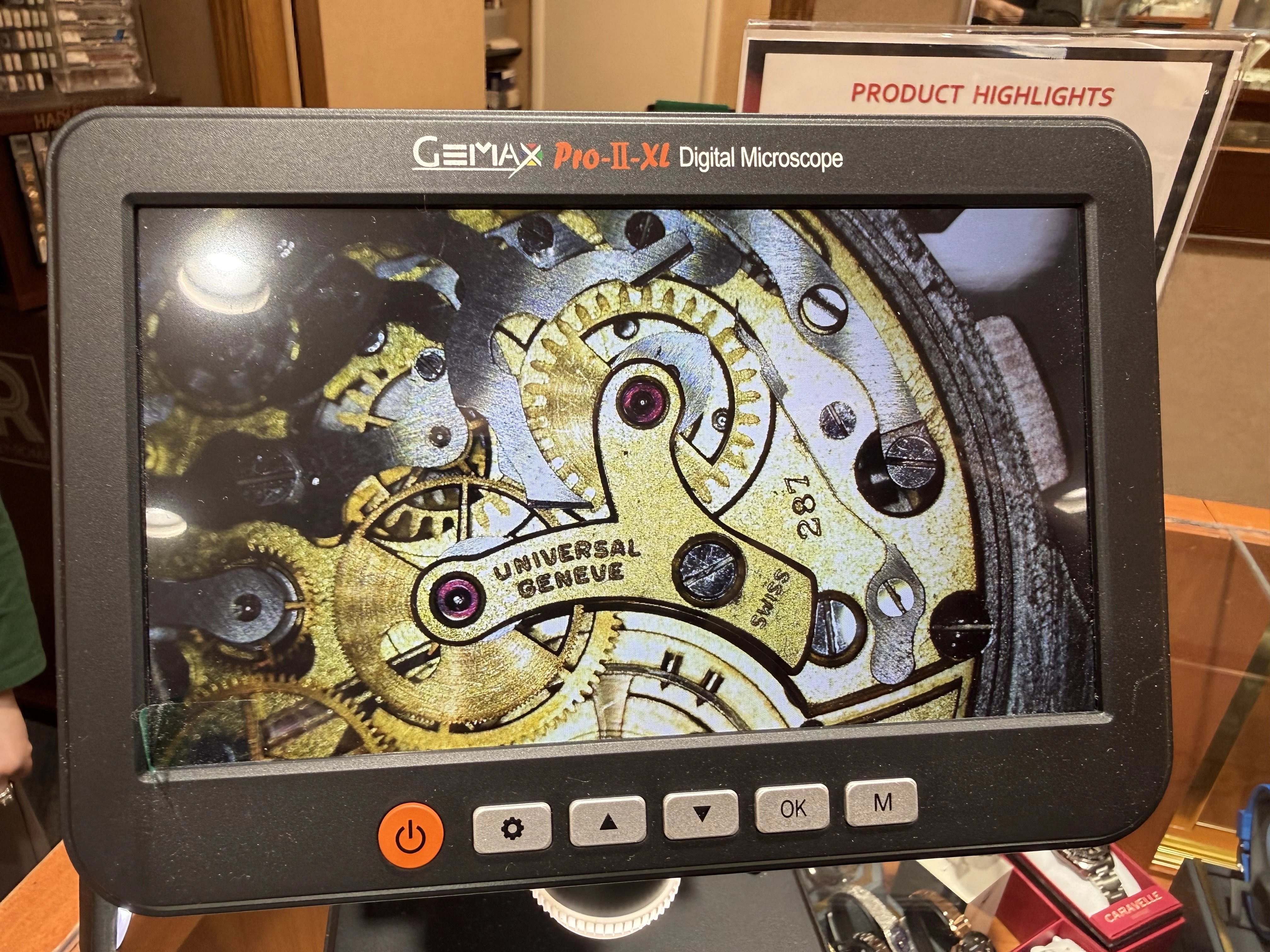

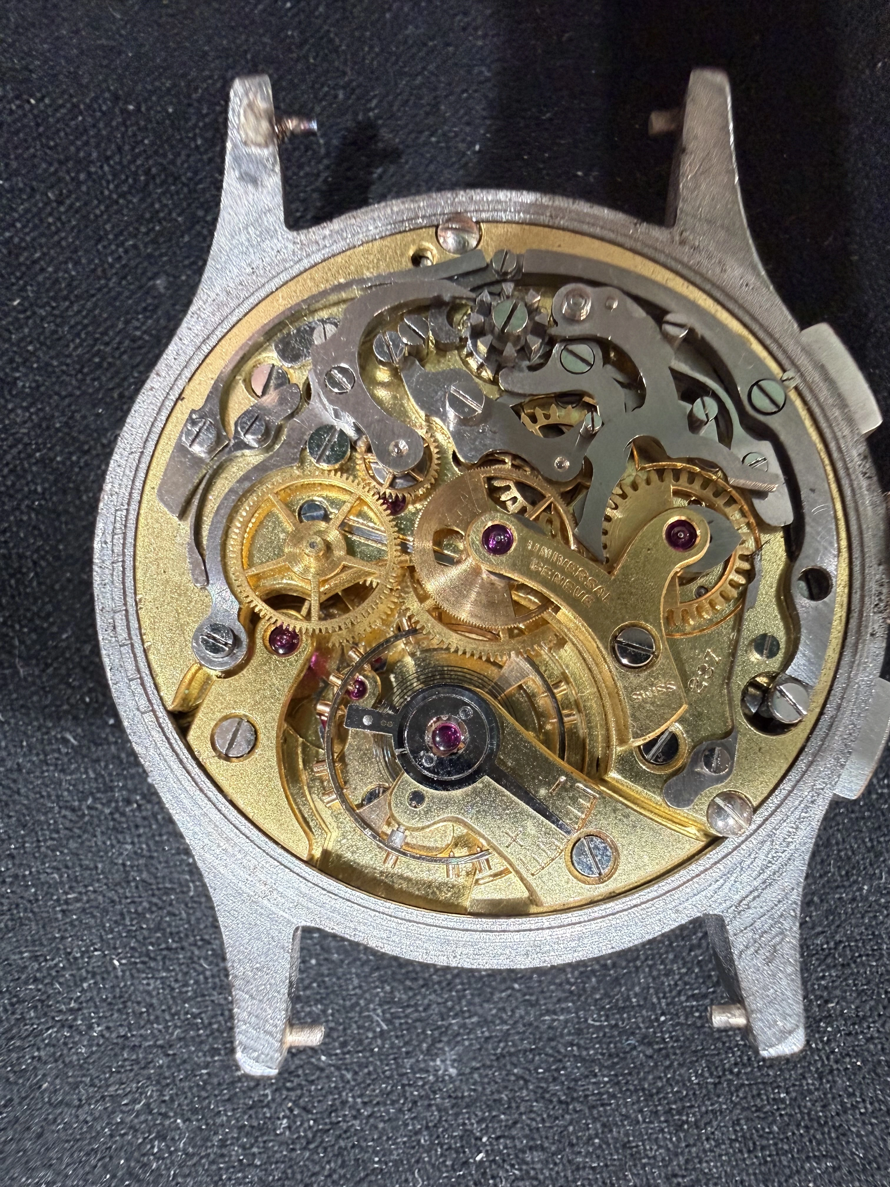

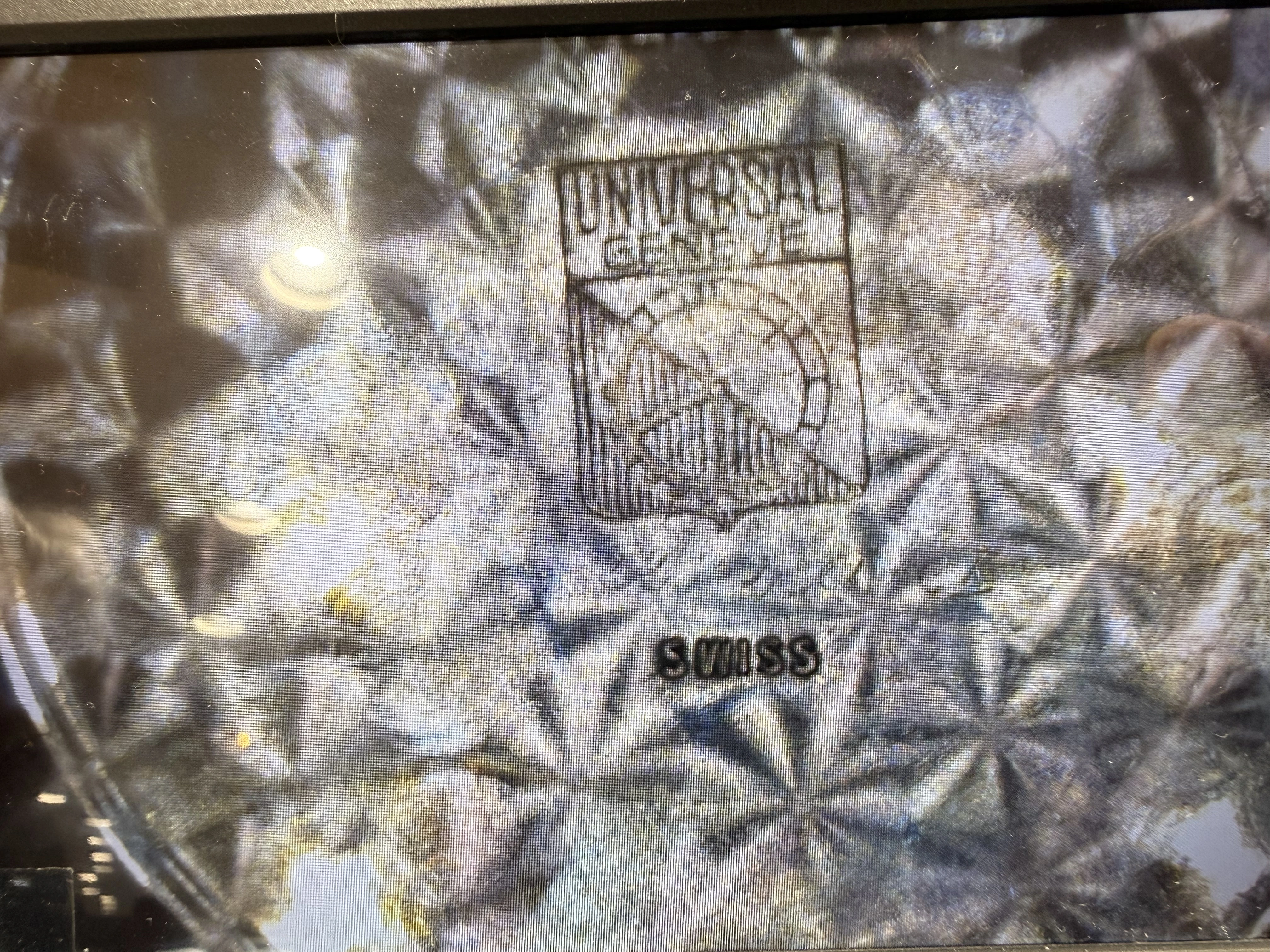

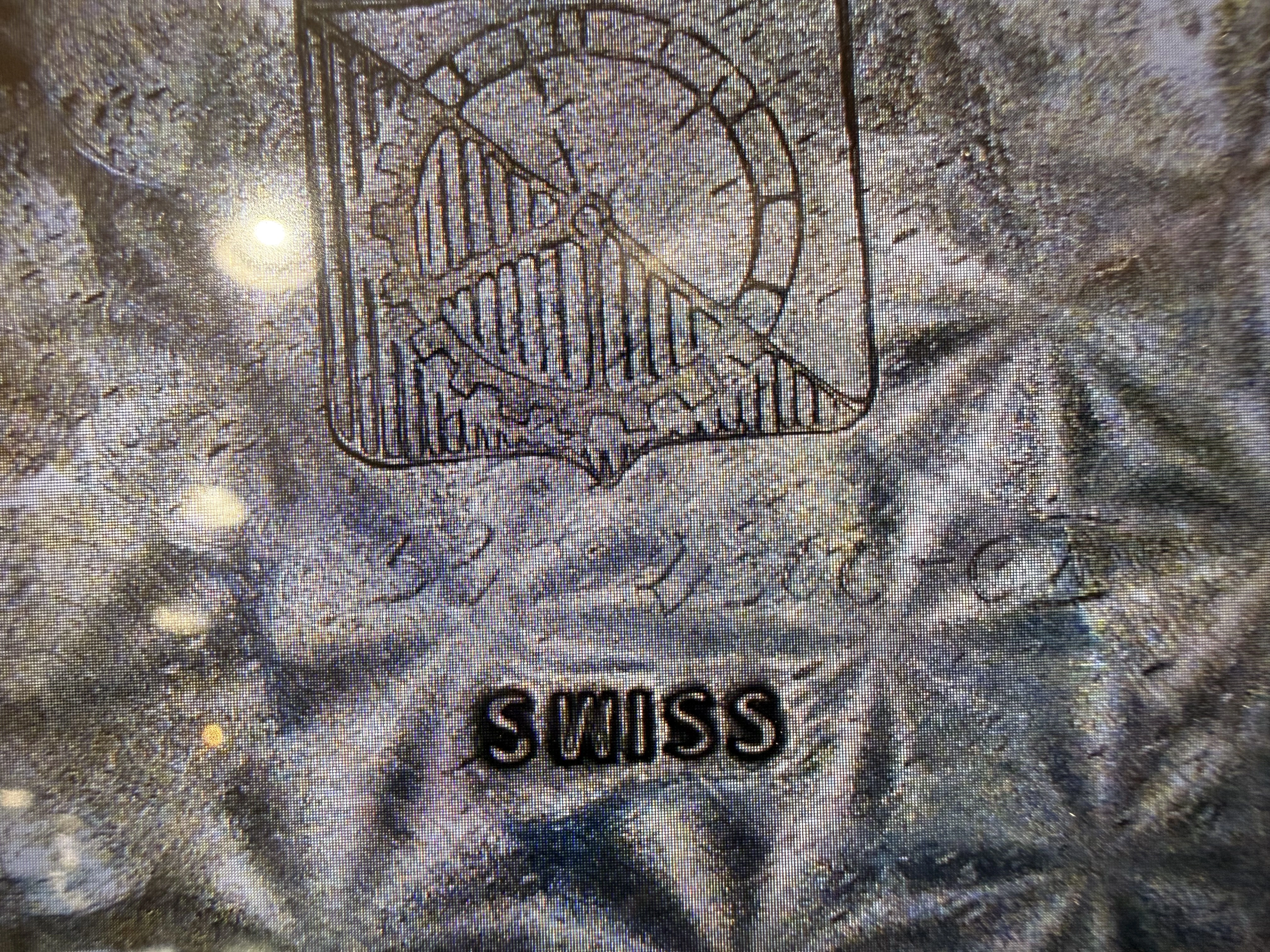

I stopped by a jeweler to have the back opened and snapped a few with my phone. Movement is a 287 and there is a number that is hard to read on the inside of the back. Any ideas what those numbers or letters mean? Any thoughts on inside condition? Being that it was easy for the jeweler to open and close the back, I can probably do it myself and photograph the inside better.
13,779
53,743
Service mark. Techs used to scribe into the case back inners. Movement looks clean.

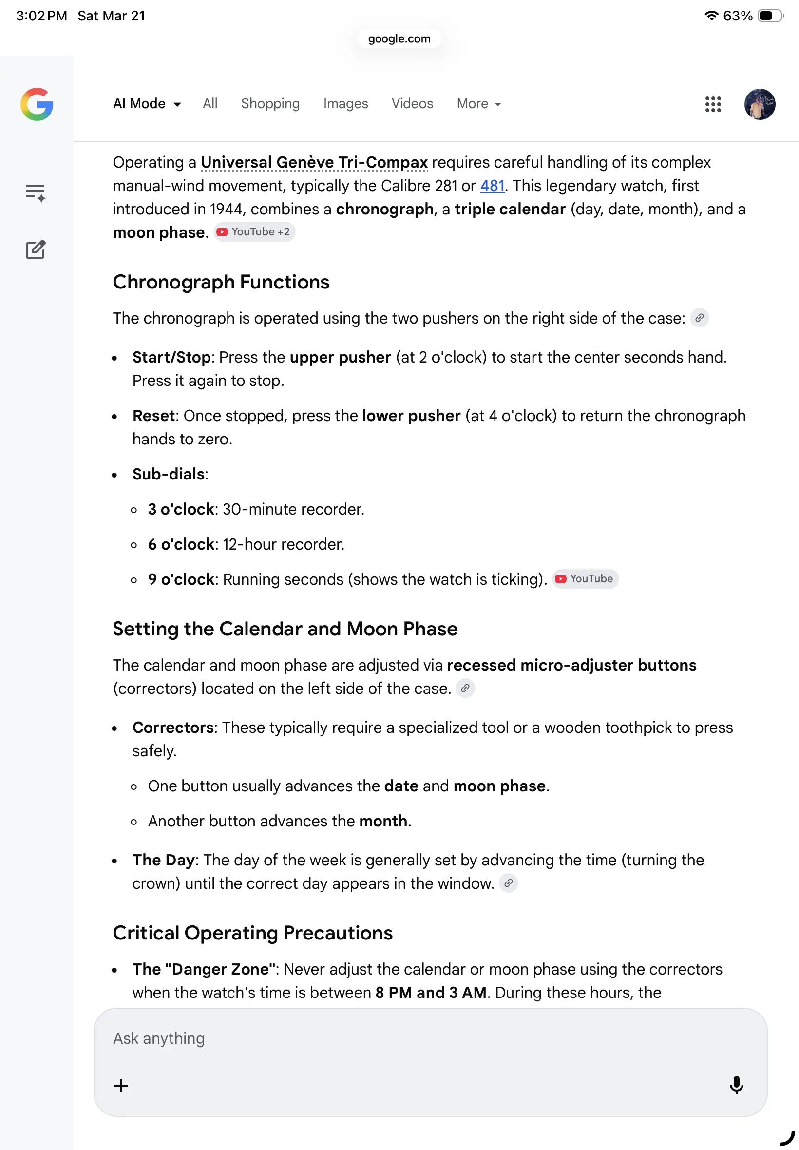

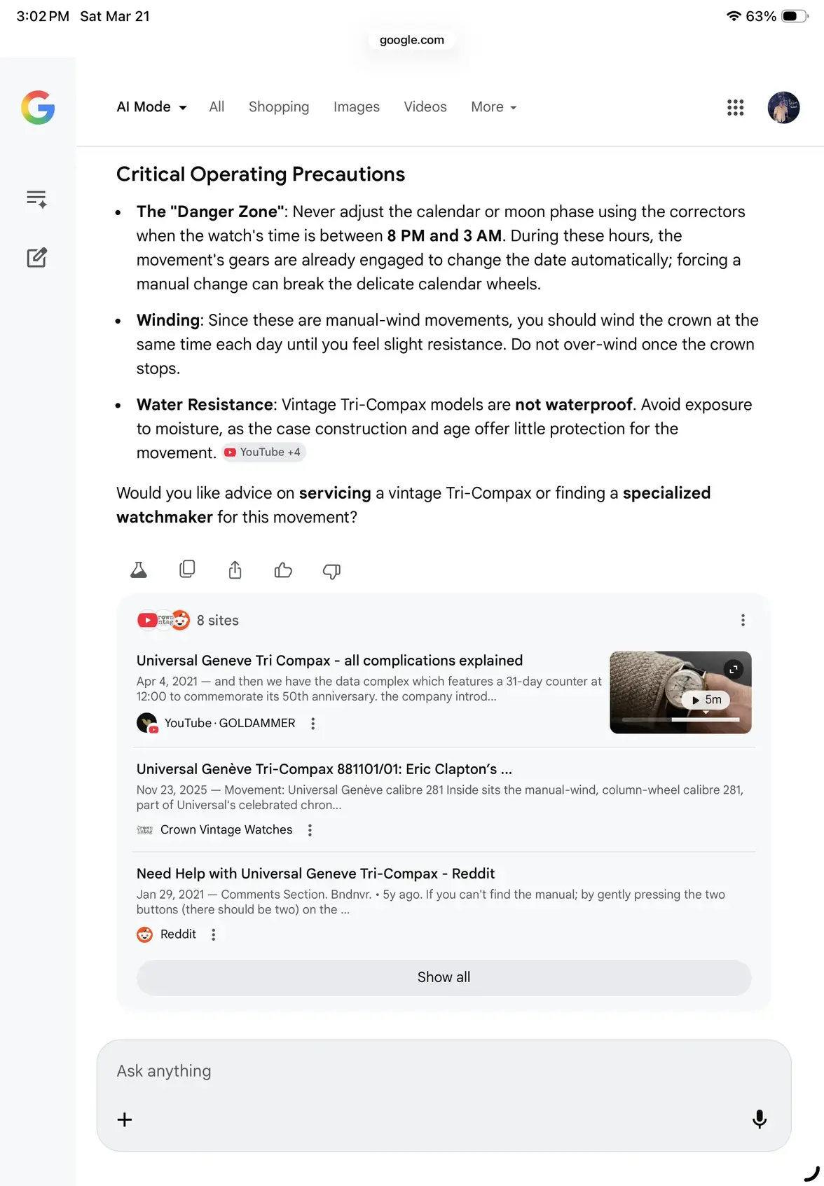

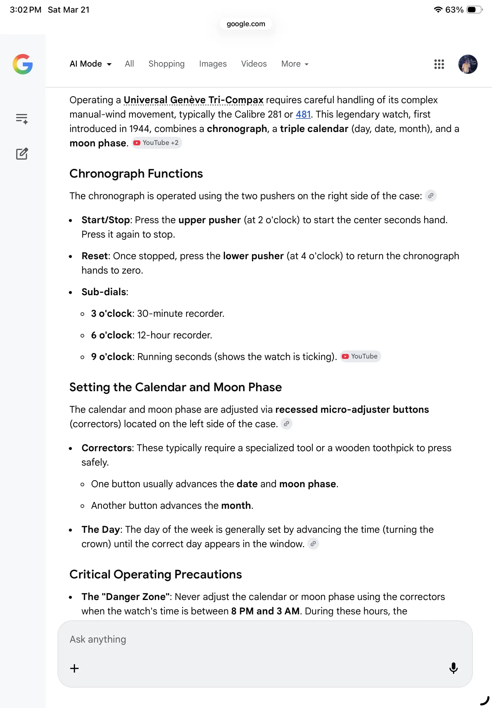

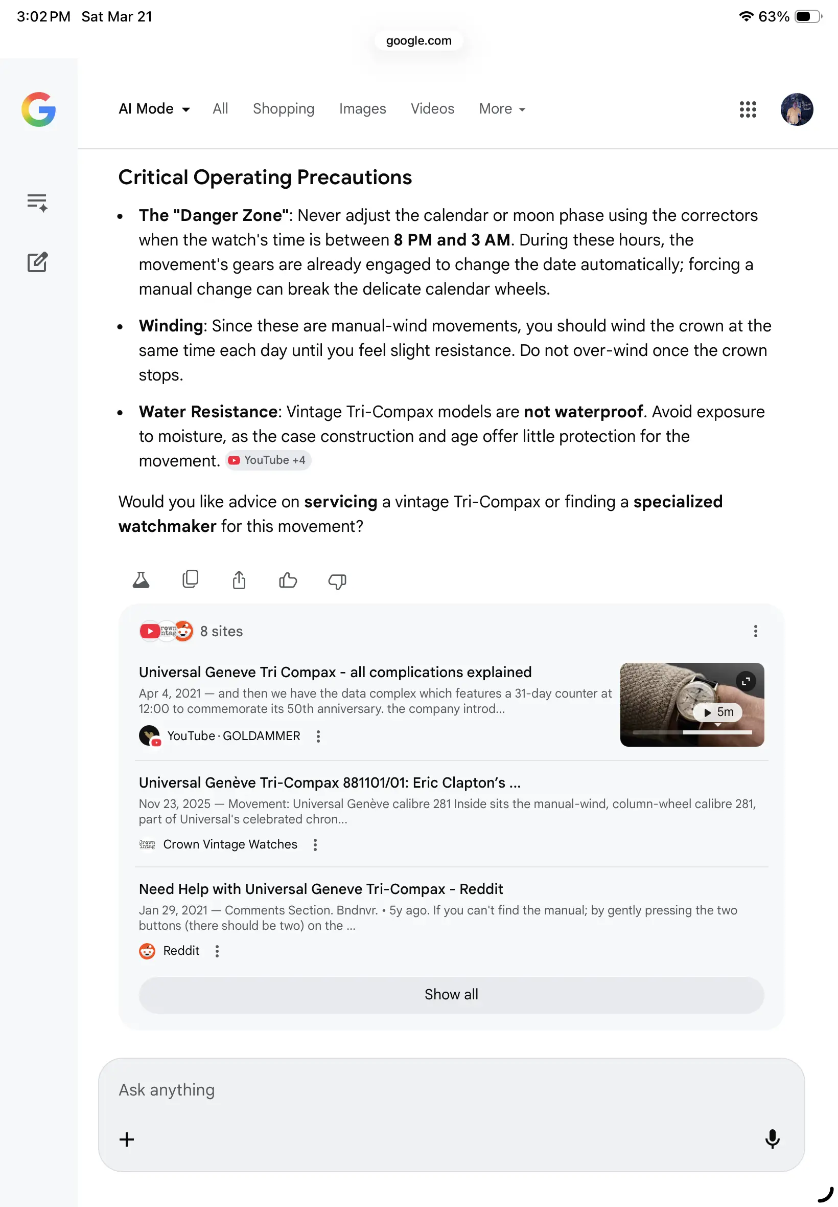

Have you actually looked up how to use this watch?
19
8
Thank you, Larry. I had not looked up how to use the watch. I know to keep it away from water but not the pushers or adjustments. I have set the time and wound it twice being careful to not get to where there is tension. I tried the pushers, but nothing happens, so I am not touching anything anymore.
