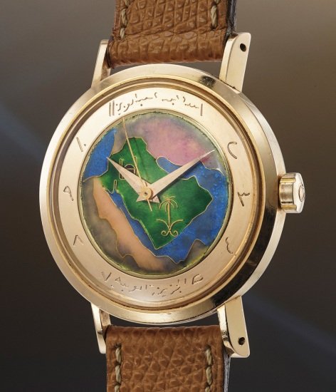

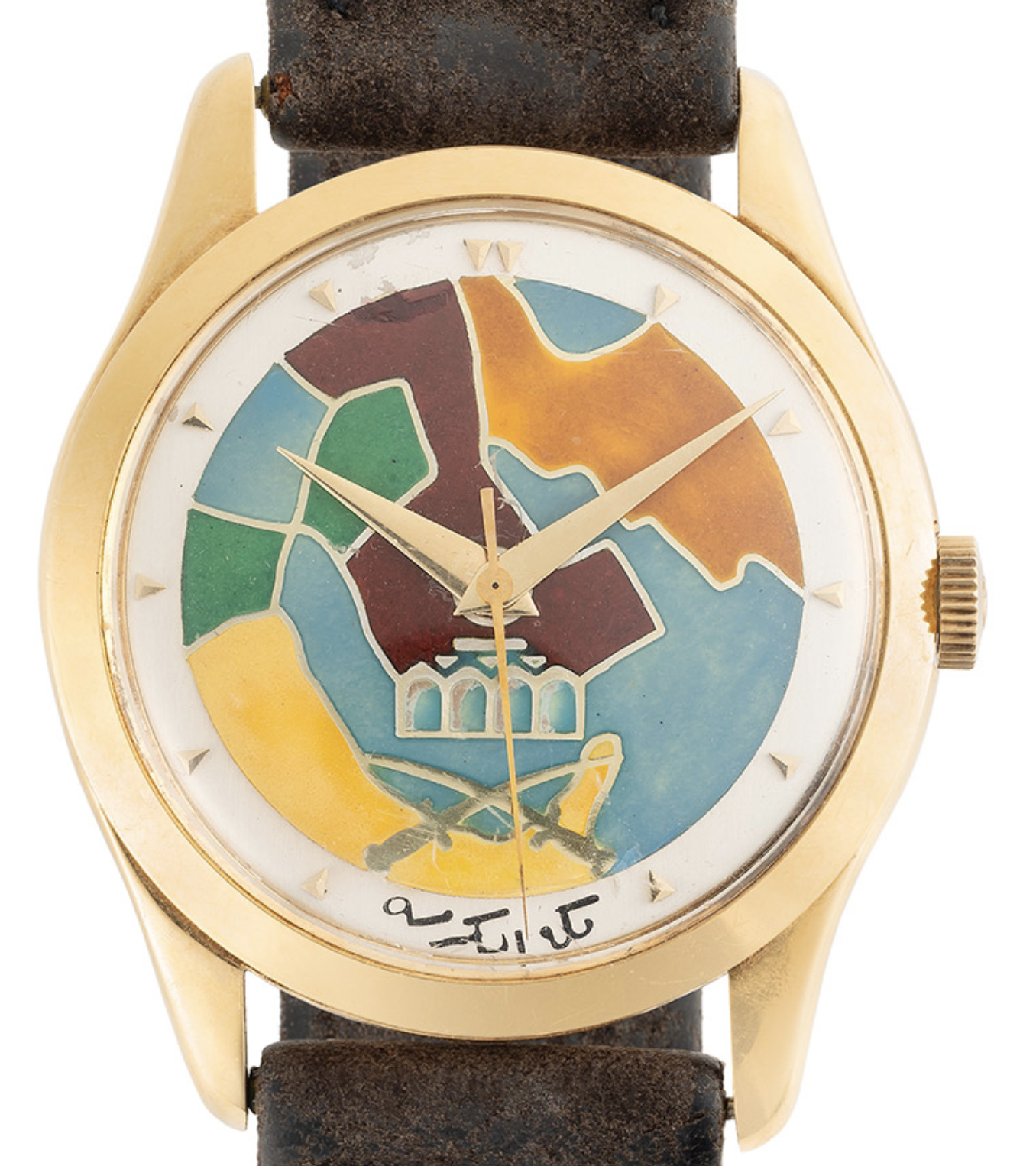

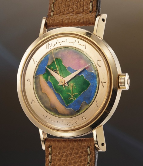

As some of you might know, I've spent quite a bit of time in Arabia and when this watch was posted for auction next month I sent a link to a friend out there - just for interest.
However, they came back and said that they might be interested in bidding on it but did I think it was correct?
Tresors aren't on my normal paper round, especially with customised dials, so I thought I would reach out to the good folks here for comment.
The watch is a YG 18k OT2642 Tresor, cal 283, serial 12,464,xxx
From research, whilst initially with a cal 263, later 2624s can come with a cal 283
- so that all checks out
There is an EOA from June 2023 (whatever that is worth nowadays) and the watch dates to 1952
The case has seen some polishing but looks reasonable.
So far, so good.
The elephant in the room is of course the enamel dial.
It depicts 'Arabia', specifically Saudi Arabia, with crossed swords and instead of a palm tree, it has an image of a 'religious building' and an Arabic inscription noting 'Mecca'.
Whilst there are later 'Aramco' enamel dialled Omegas, they aren't gold or Tresors and unlike them the Tresor dial has no Omega logo and is significantly older than the 'Omega Aramco dialled' watches, so the assumption is that it is an 'after market' custom addition.
There are however a number of Universal Geneve watches with 'Arabia' enamelled dials from very much the same era as the Tresor, some marked UG others are 'naked'.
The dial is of reasonable quality and very stylised in its depiction of Arabia, not up to the quality of the Omega enamel dials but probably comparable to some of the UG dials.
The EOA says delivered to Switzerland - is it possible that Omega released a watch to a local enamel-dial producer at the request of a valued customer? (e.g. one used by UG?)
Has anyone seen anything similar or know of custom dial makers that Omega used?
Any comments or indeed scepticisms will be very much appreciated
The Tresor up for auction next month - estimate £7,000-£9,000 (which means the reserve is probably £7,000)

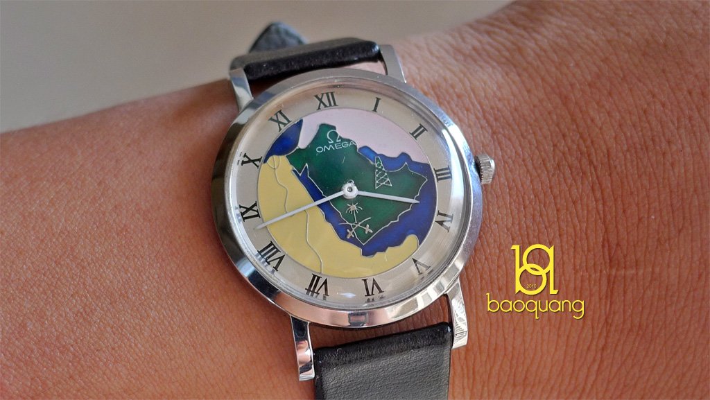

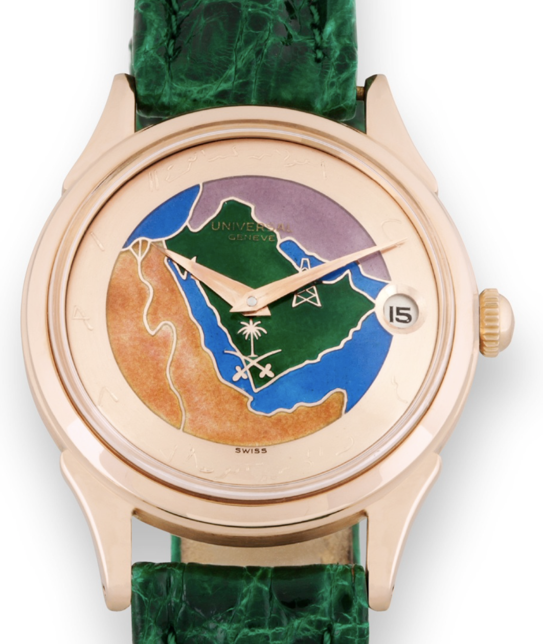

Later Omega Aramco (60s) dial (courtesy of OF sales and @baoquang )

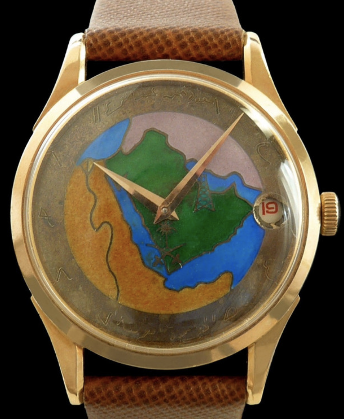

Naked UG dials - very similar era to the Tresor
Signed UG (Aramco?) dial - again similar era to the Tresor - sold at Antiquorum 2011

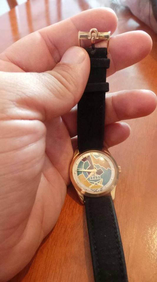

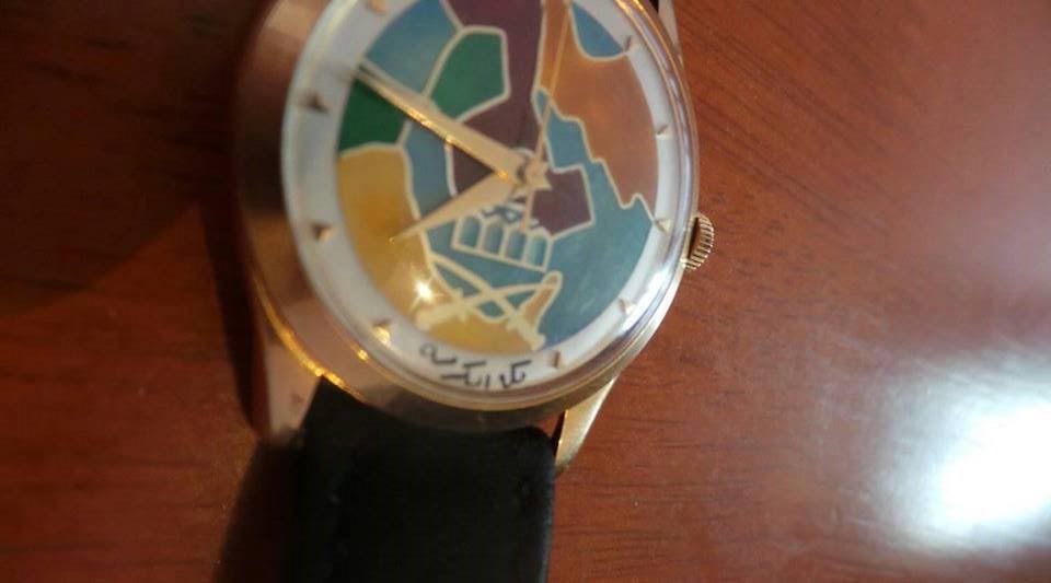

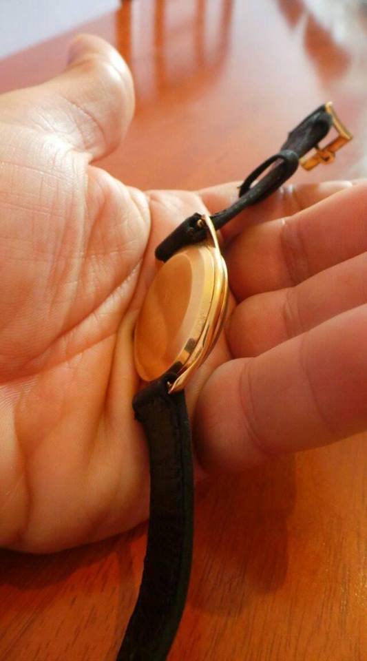

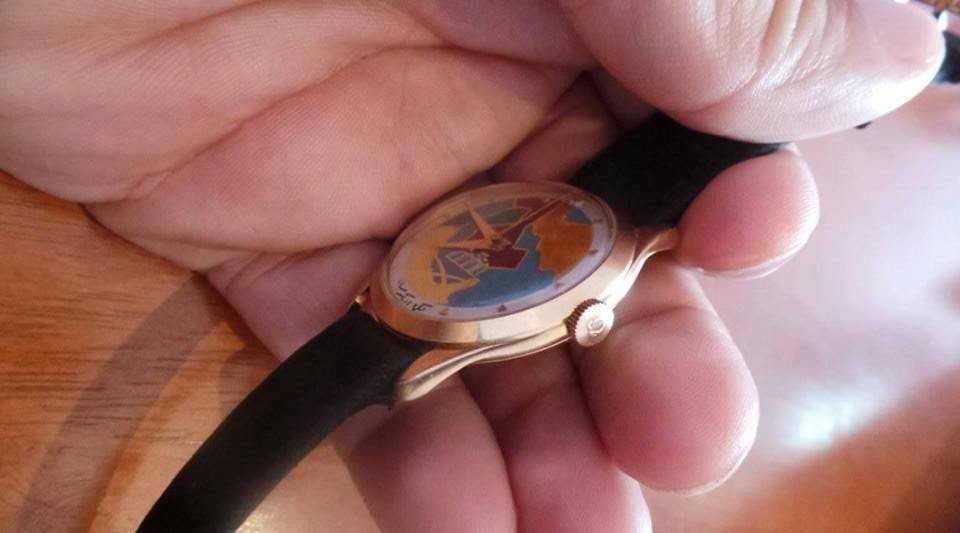

Lovely piece. I never though i'd see the same dial again. A friend once showed me these pictures from a gentleman in Algeria if memory serves.
I'm not an expert on these Omega Tresor by any means but since the dial looks exactly the same, I think it may be legit. The inscription at the bottom is "Makkah Al-Mukarramah" which is the arabic name of Mecca.
Sorry about the quality of the pictures, they were sent to me many years ago as is. It's a miracle that I still have them! No movement or case back shot unfortunately.
Stefan.

Many thanks for the response Stefan.
I think this could be the same watch.
what is very useful is that, on your pics, there appears to be some colour missing between 11 and 12 which is commensurate with ‘staining’ at the same place on the auction watch.
So, it looks as though the dial has been touched up at some point.
Something to take into account when advising my friend on whether he should bid or not.
Your observation is spot on! It could be the same watch indeed.

My 2 cents is that the dial in the watch you are asking about does not originate from Omega. The quality is not there.
Having said that…UG also did not make enamel dials, they would order them when they had these special orders. However, the UG examples look better and they are signed.
Btw, I heard that these watches were usually commissioned by watch dealers from London at the request at their clients.

Thank you for the comments @Verdi.
I also think that it is a non-omega dial - it would be of higher quality and have the Omega symbol.
The quality is not too dissimilar to the UG watches and not all of them were signed (as illustrated above)
According to the EOA the watch was delivered to Switzerland - so I wondered if someone there produced bespoke aftermarket dials for clients of Swiss watch makers.

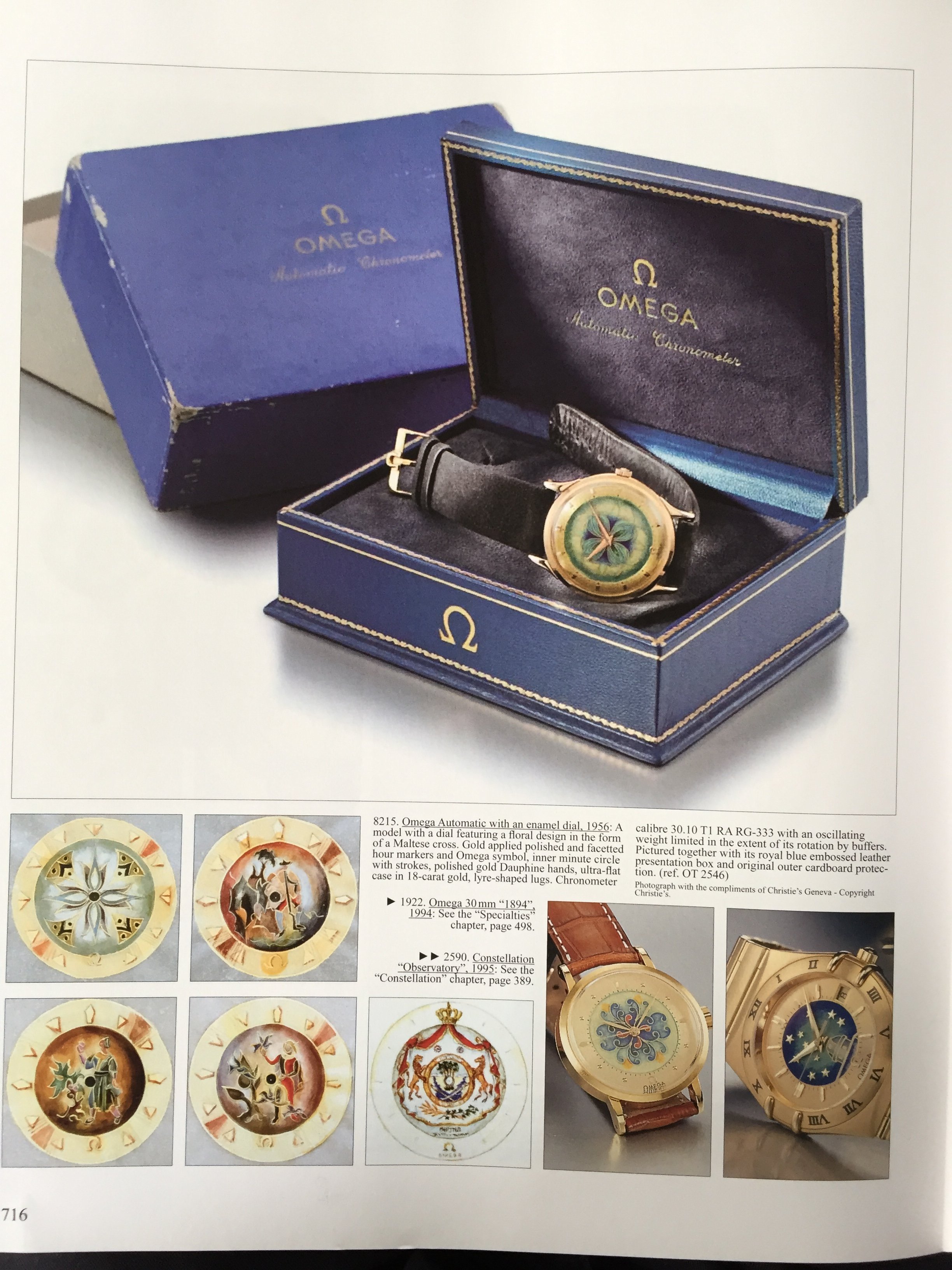

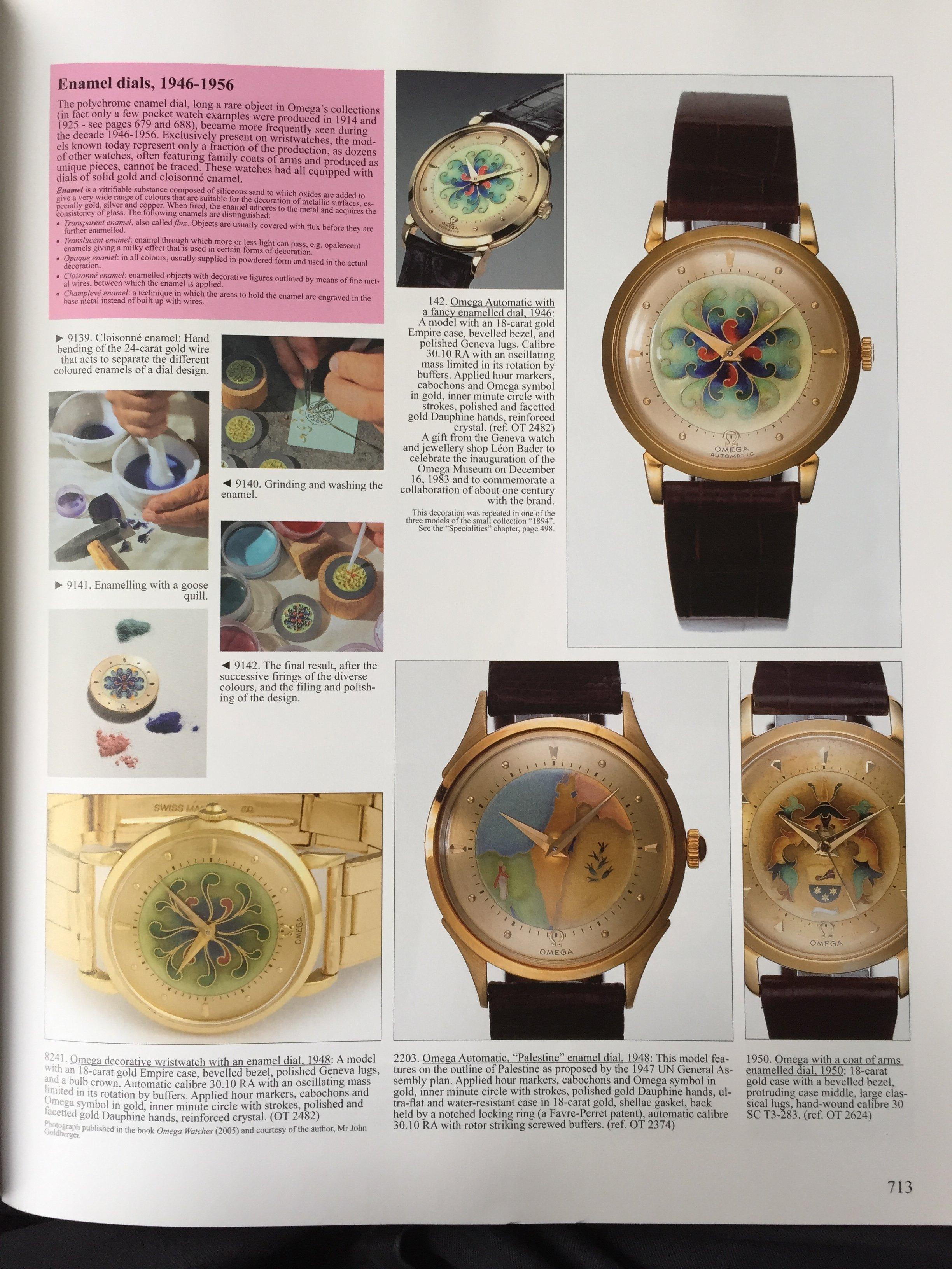

Have had a chance to look at my AJTT.
Pages 713/4/5 are great to reference thank you.
Omega did produce some very short runs of bespoke and obscure enamel dials - like coats of arms - but also maps of countries such as Brazil and Palestine.
However, they are all of very high quality and all have the Omega symbol.
So, I'm more than ever convinced that the 'Arabia' or 'Saudi' dial at auction is an after market addition and may be a one off.
A quick snap of Omega enamel dials, from AJTT, for those that are interested.

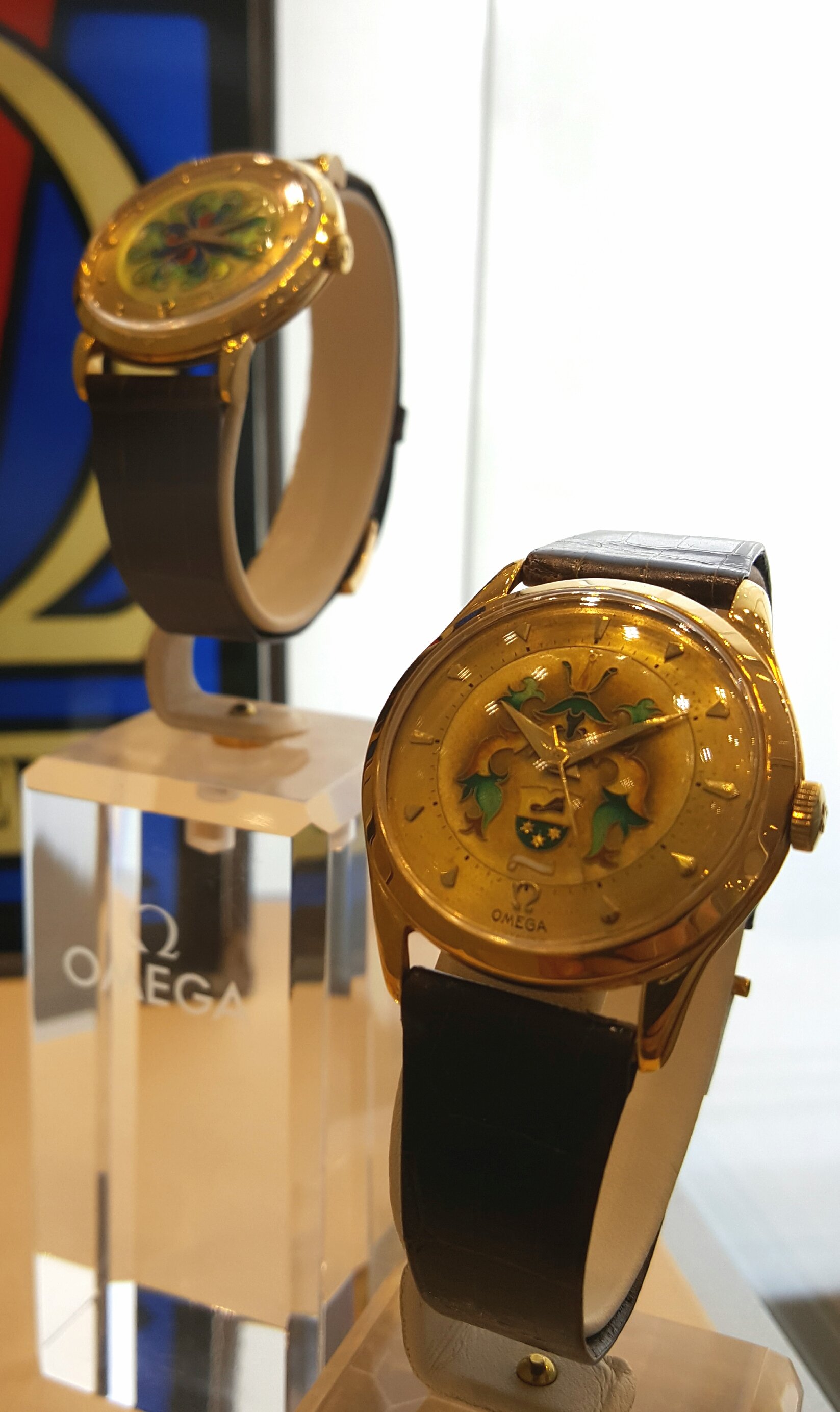

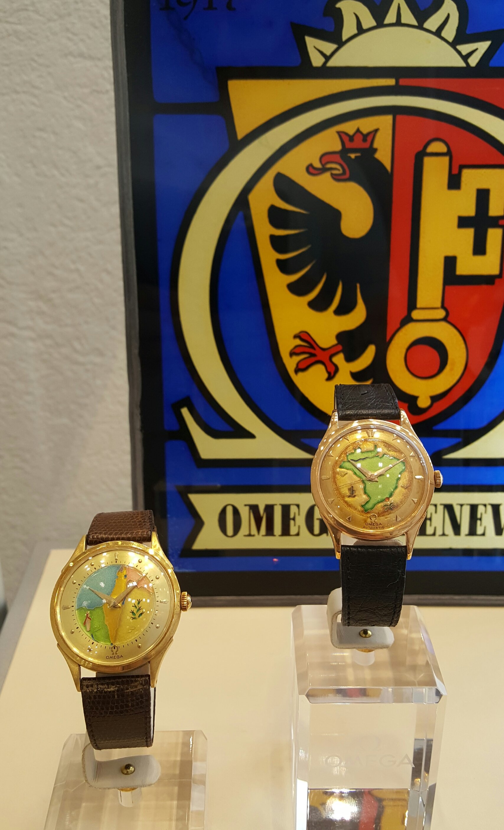

I saw a couple of enamel dials at the Omega Museum and they were very impressive indeed.
6,832
10,502
Thanks @cristos71
Those look like some of the ones from AJTT - pretty wonderful.
