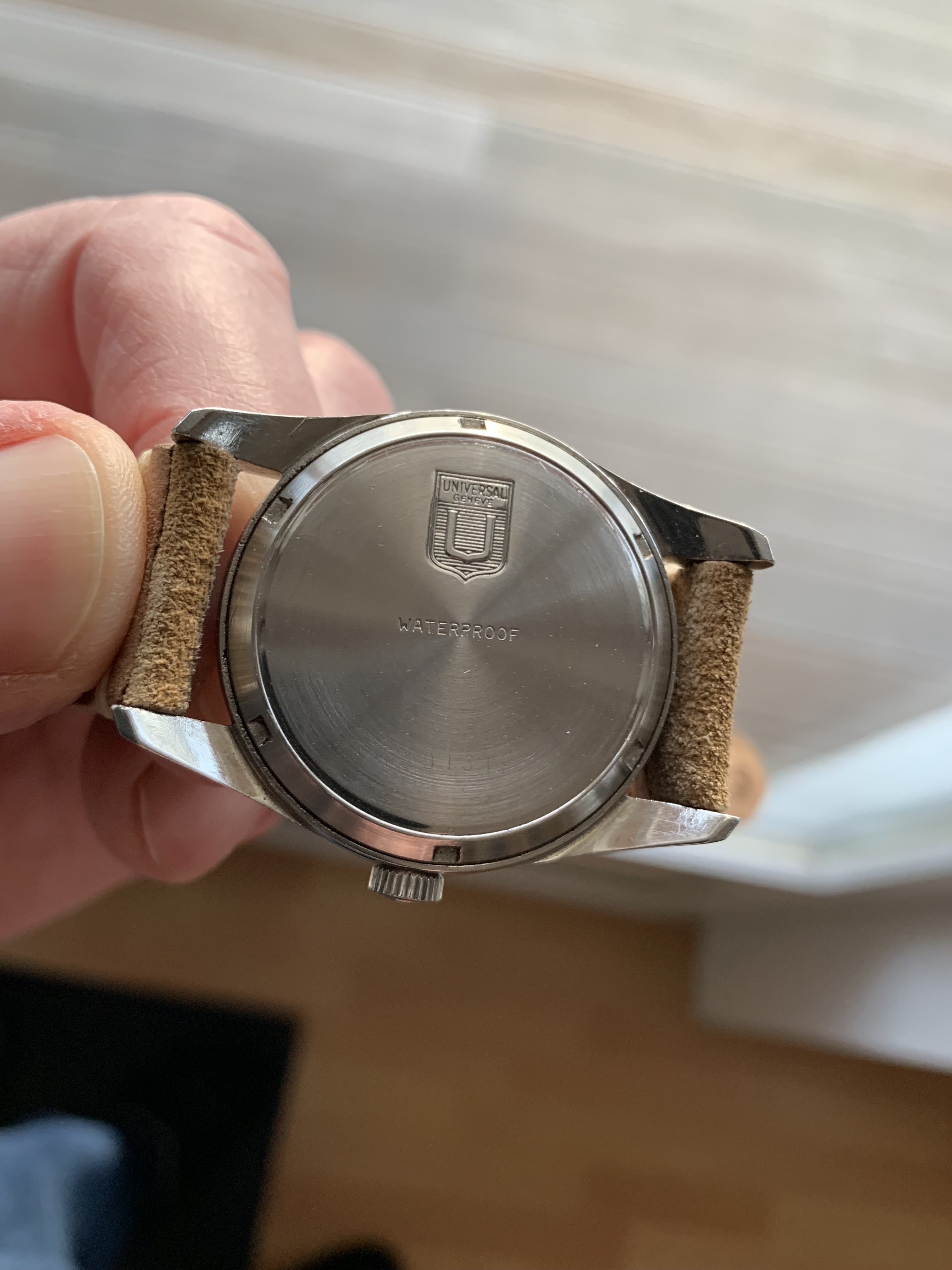

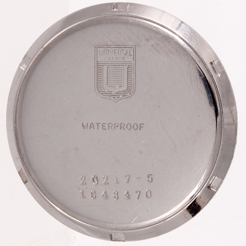

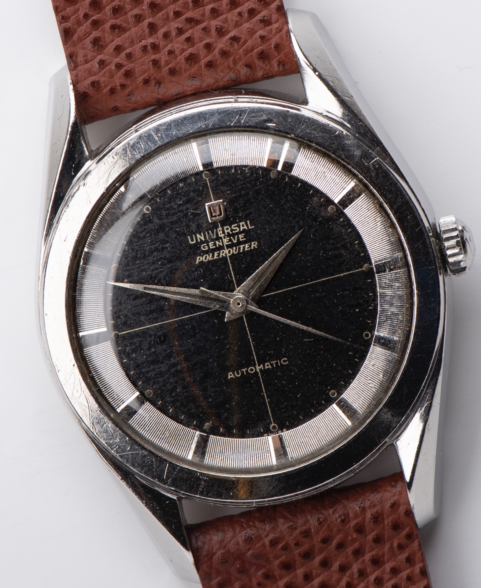

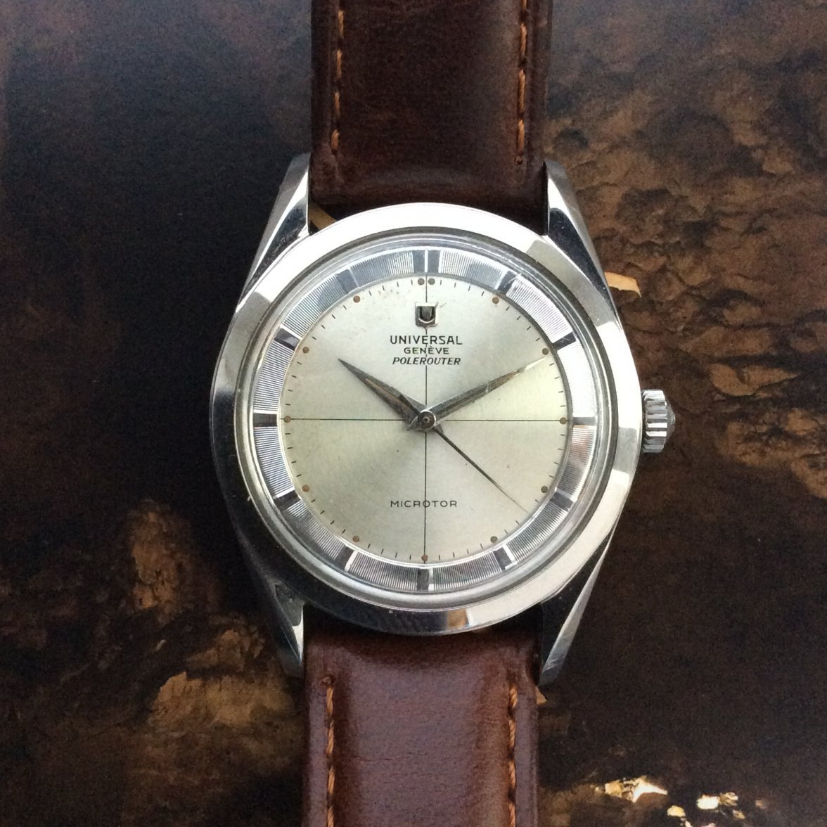

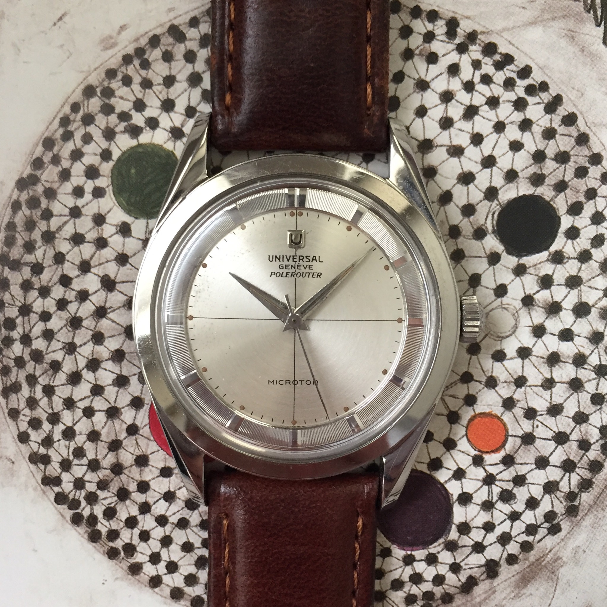

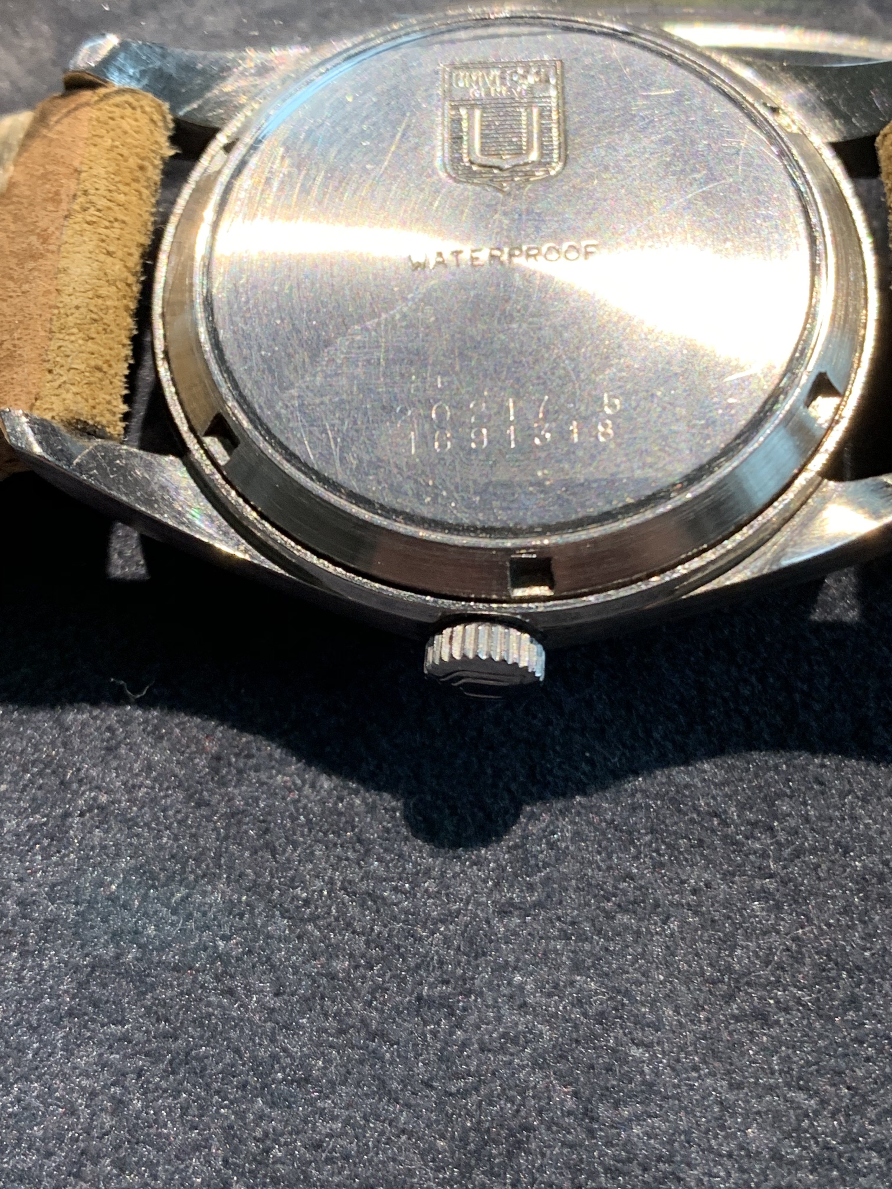

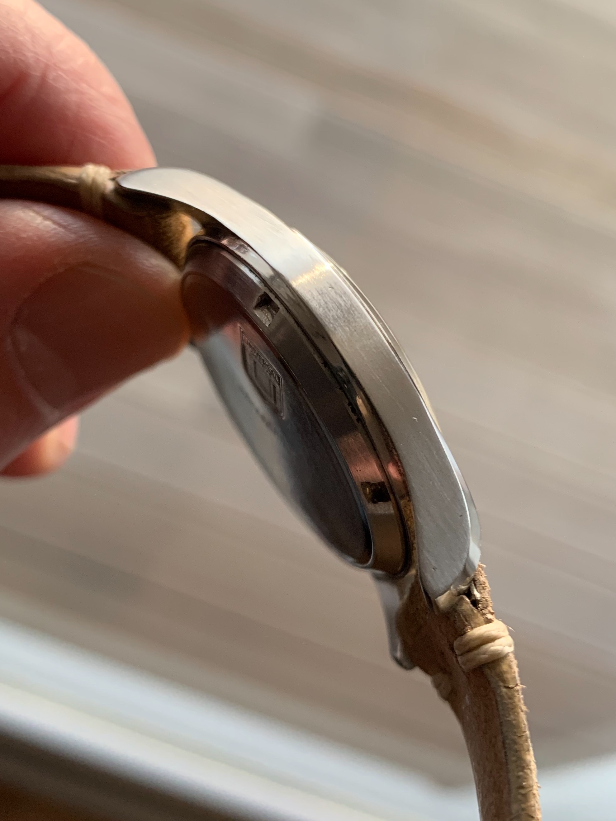

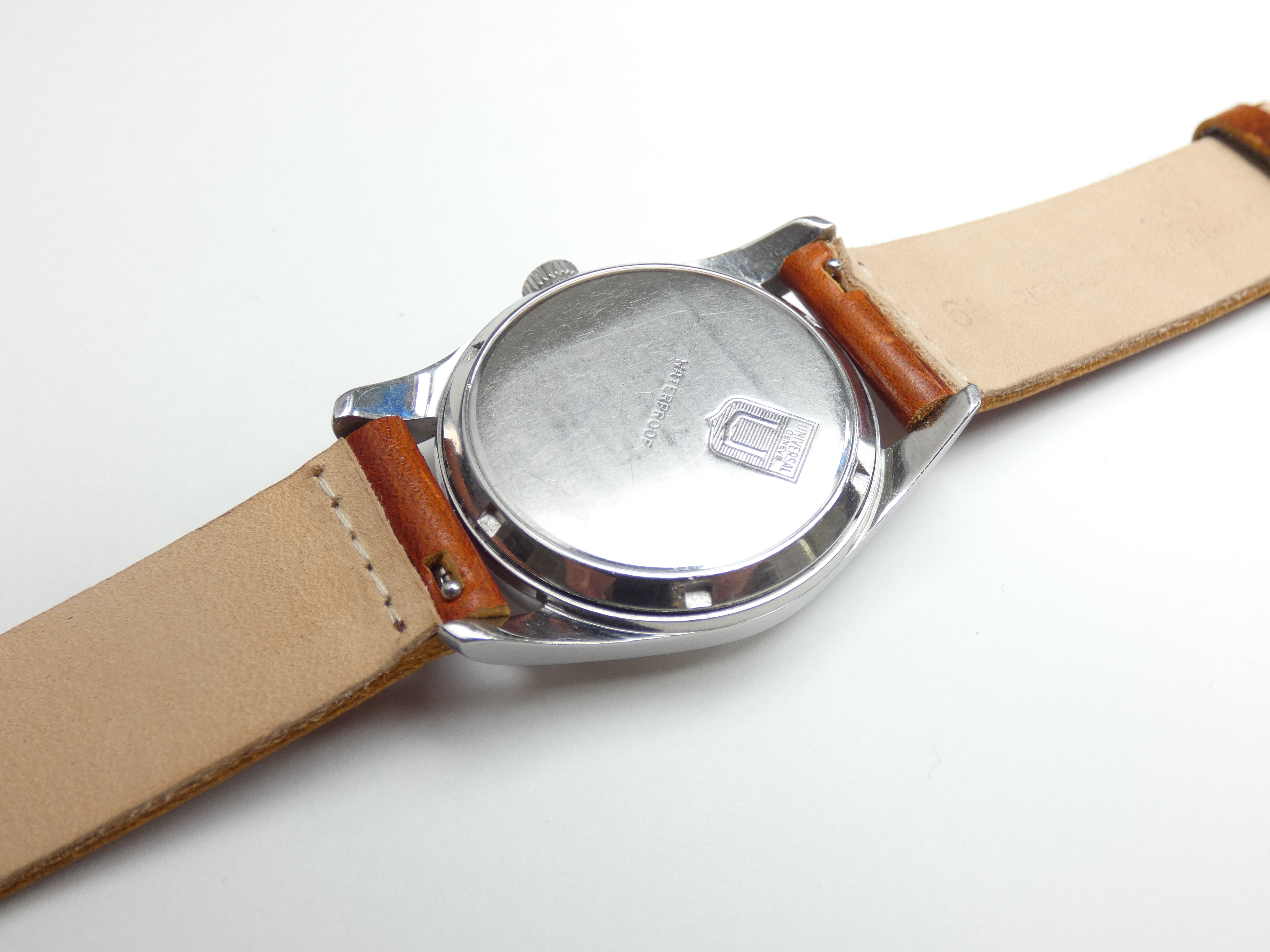

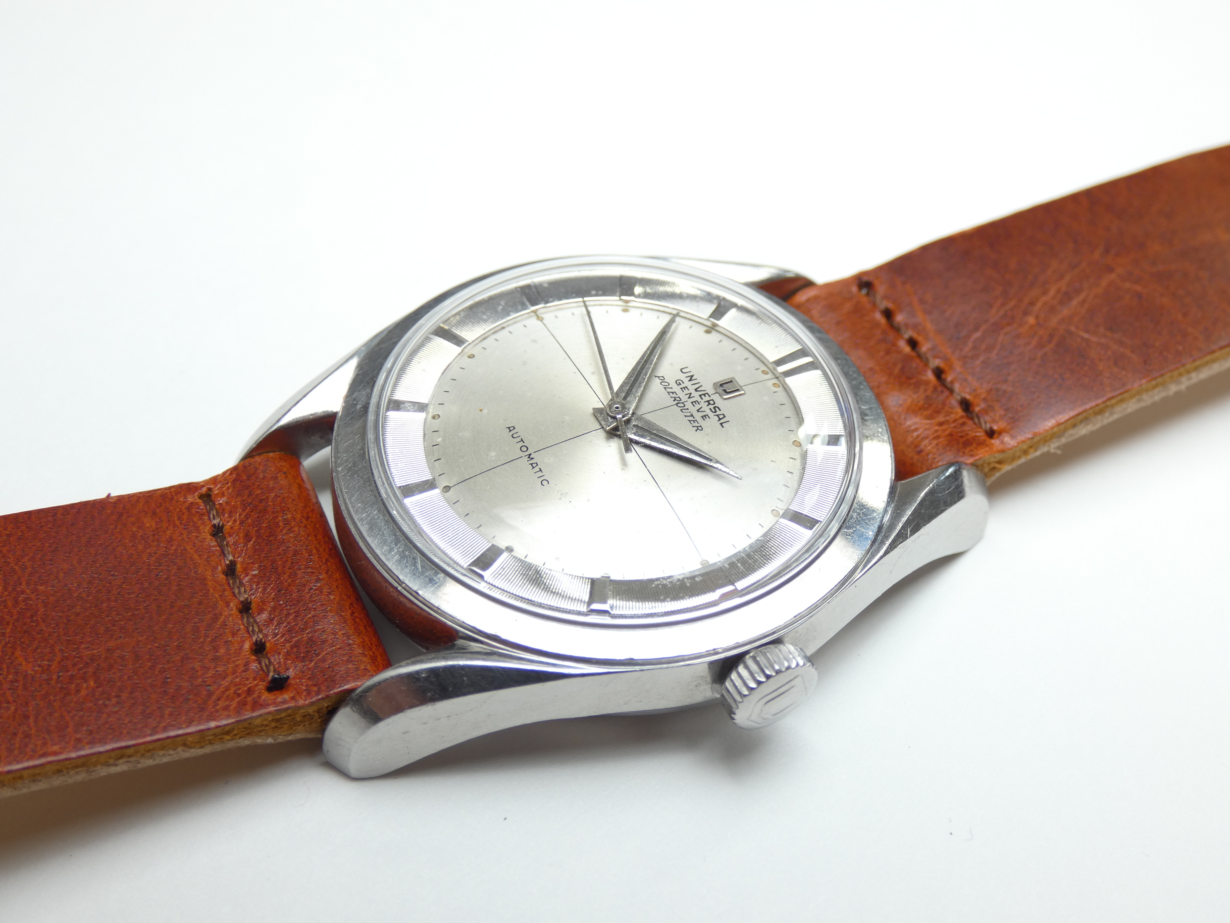

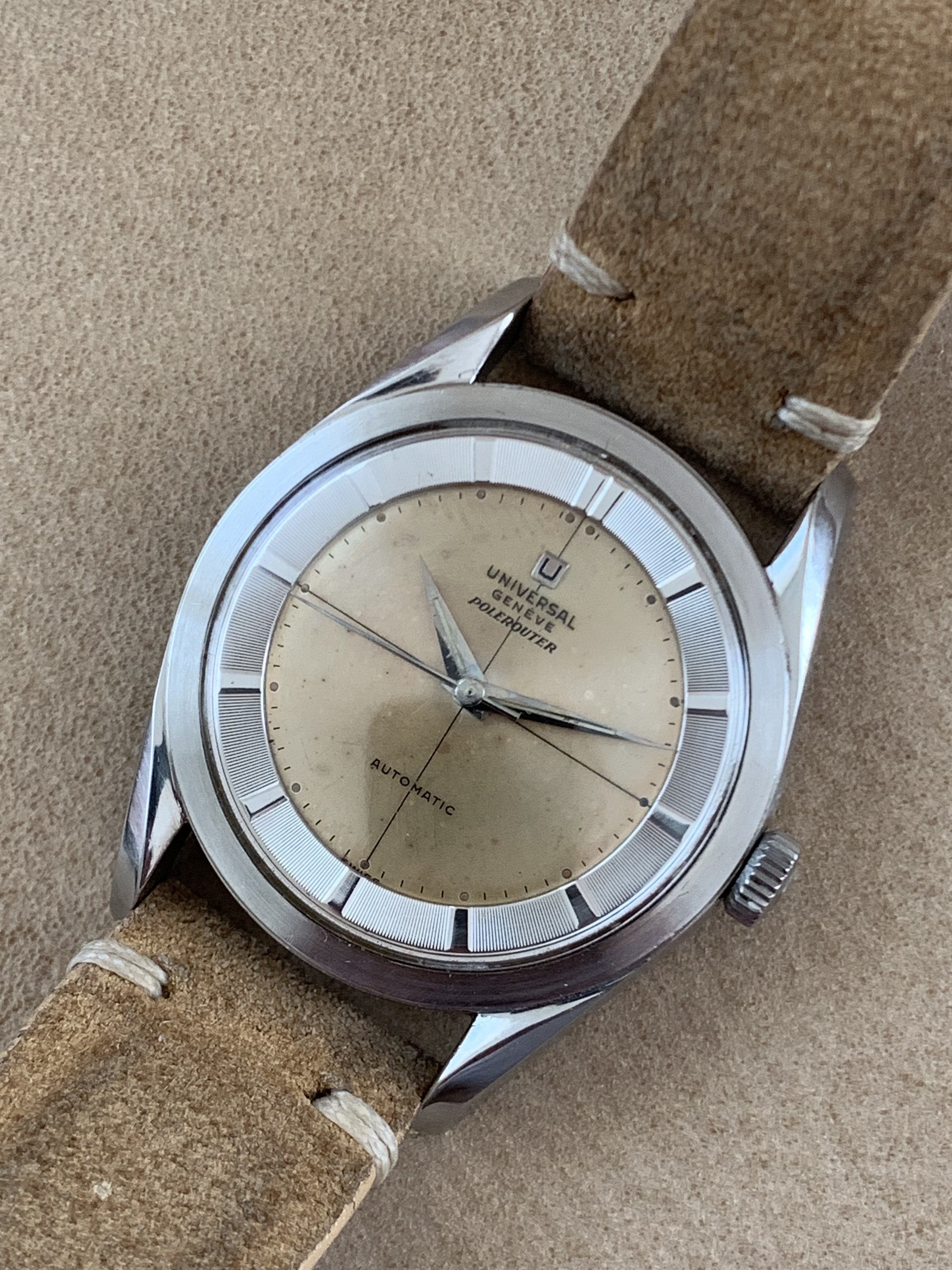

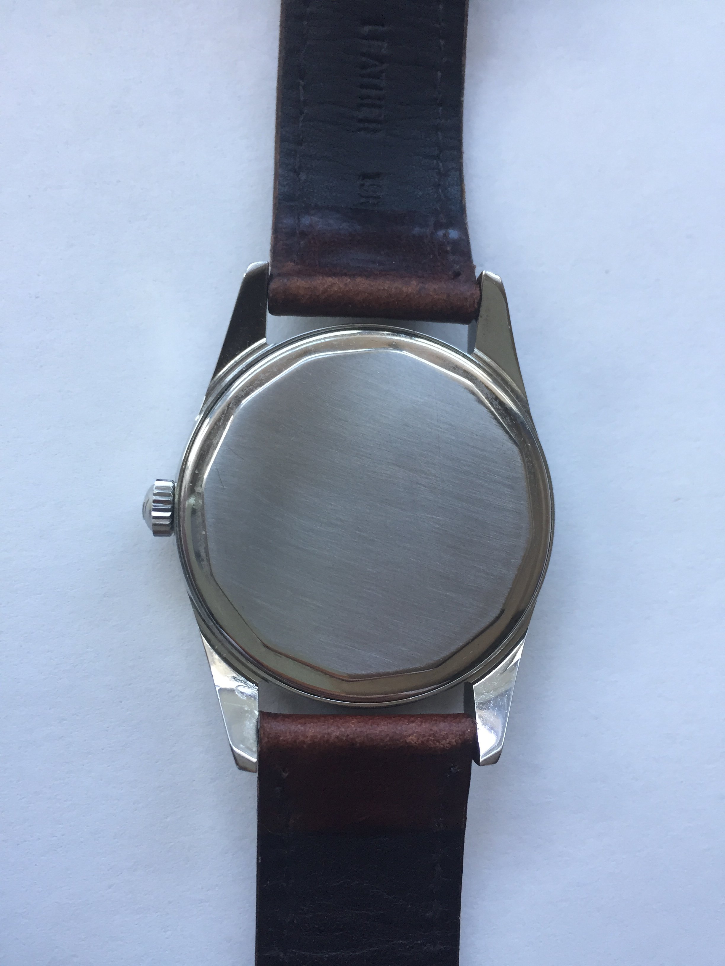

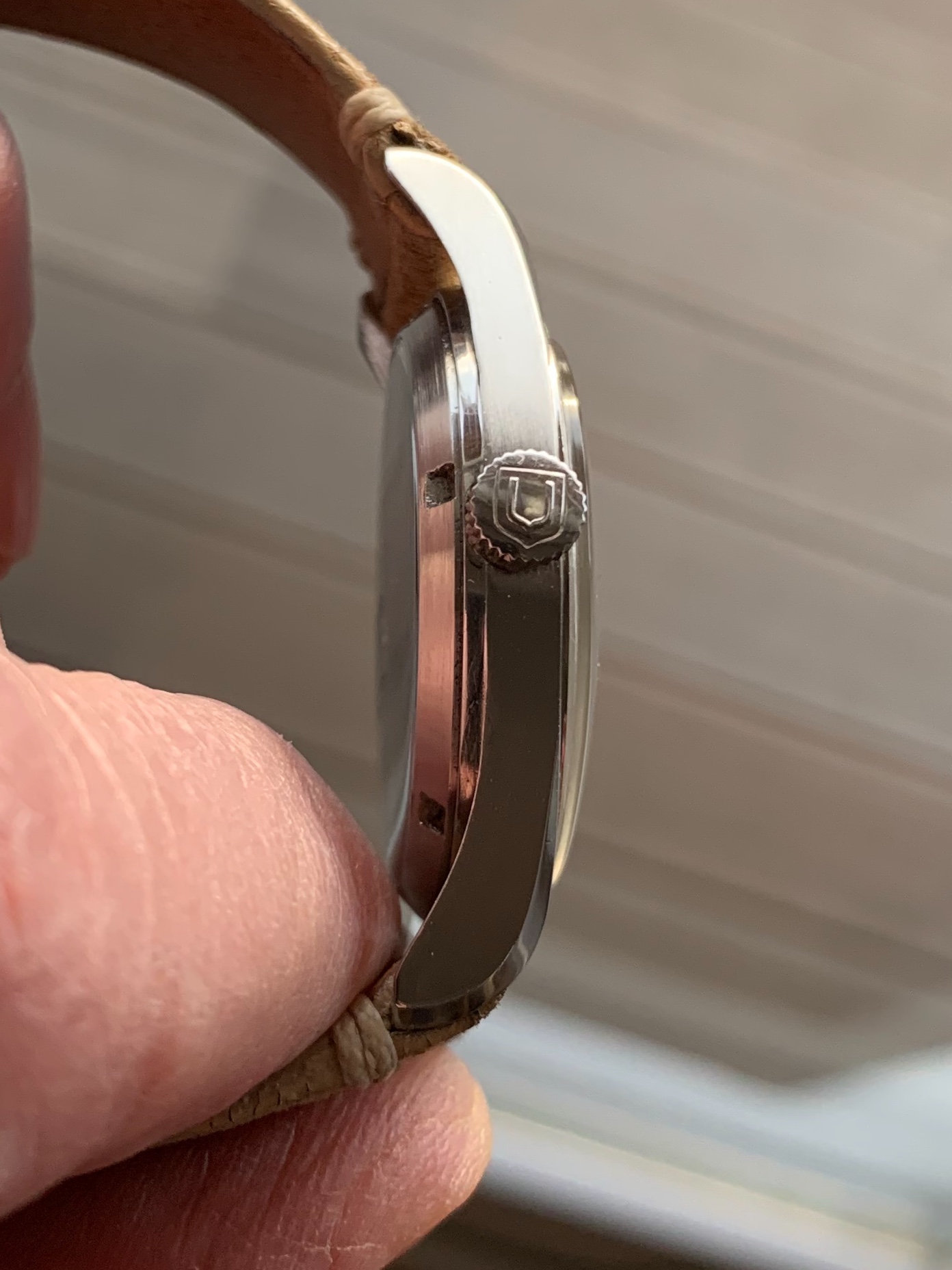

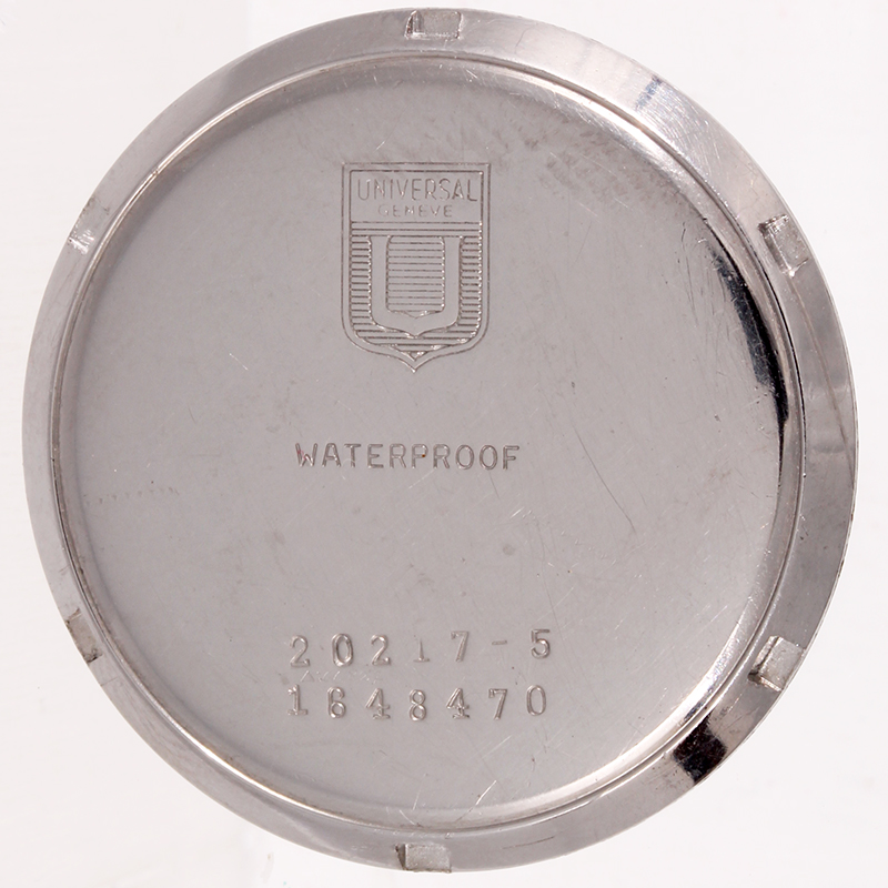

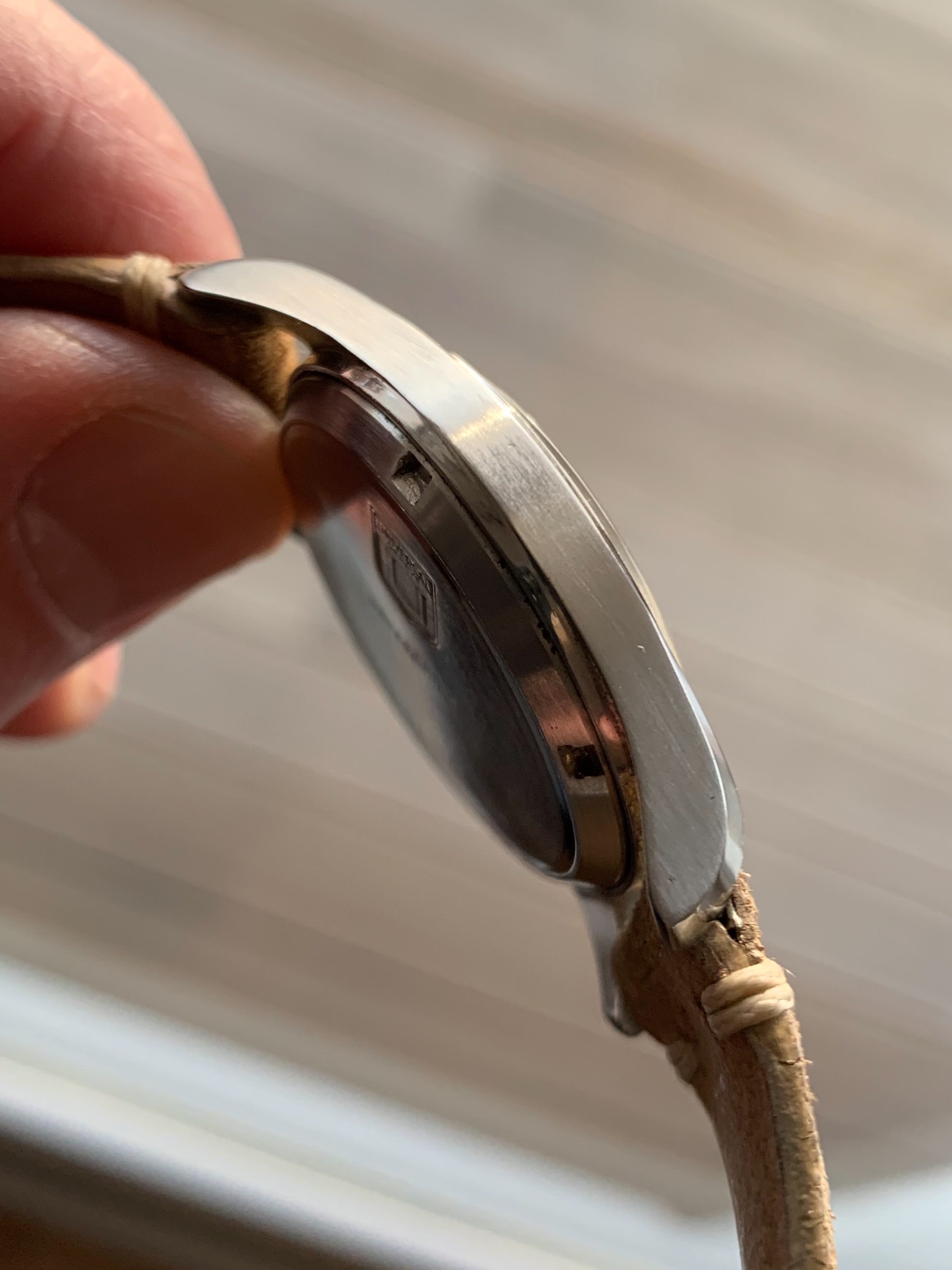

It's not uncommon to see Polarouter cases with Polerouter dials. I had initially assumed that these were Polarouters where the dials had been replaced at a later date but I am beginning to wonder whether there was one or more batches that left the factory this way.
Firstly, I think there are too many of these watches for them all to be dial replacements. Secondly, I've found multiple examples where the watch is in good condition and has retained its original crystal and original crown and it therefore seems less likely that just the dial would have been replaced.

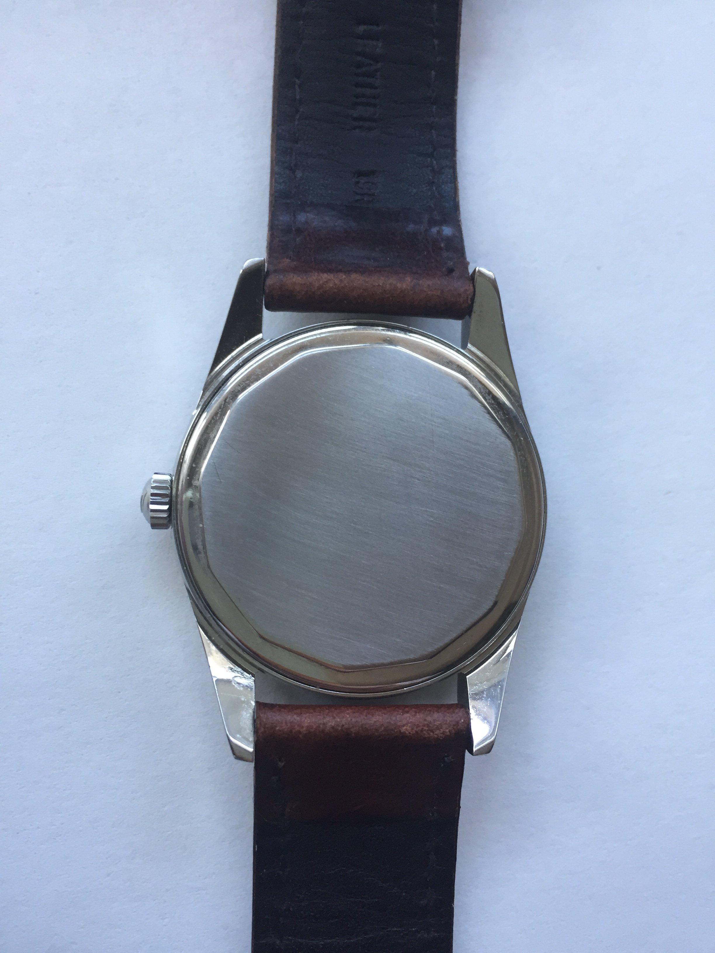

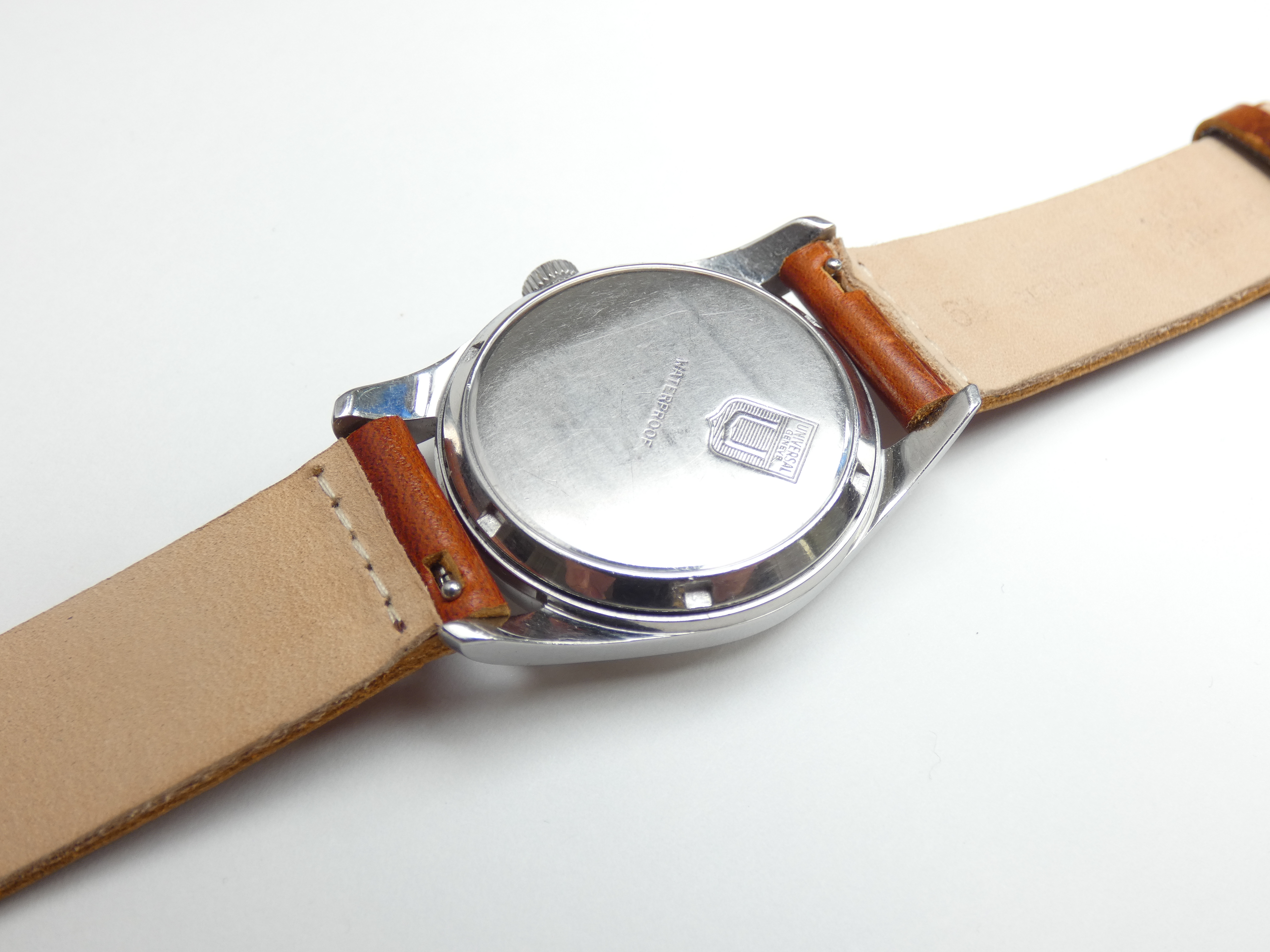

The watch pictured below is a good example. It has a Polarouter case, identified by the six key case back and the 20217-5 case reference (not S20217-5 as you typically see on a later Polerouter). It also has the original signed crystal and the original signed crown that we would expect to see on the later 2nd exec Polarouters. However it has a Polerouter dial - the dial from a slightly later S20217-5 Polerouter (note that it is the dial from the equivalent reference with silver dial and lume i.e. the 20217-5 v S20217-5). The serial number is 1'684'708.
Whilst this theory may not seem totally implausible given that Polarouters were only produced for such a short period, I should point out that there are Polarouters with later serial numbers that have Polarouter dials. If my supposition is correct, this would mean that the watches were prepared in batches and not in serial number order, which doesn't seem impossible.
Whilst it will be difficult to prove that these 'transitional' watches are all original, if we could find a number of similar watches with serial numbers within a narrow range then I think this would make it more likely that these watches are all original having been produced in the same way at the same time. Alternatively, if we found lots of 'standard' Polarouters with Polarouter dials with very similar serial numbers then that would make the 'transitional' theory less plausible.
If anyone owns a watch that is potentially a 'transitional' model or sees one, could you please either post pictures and the serial number here or send the details to me directly?

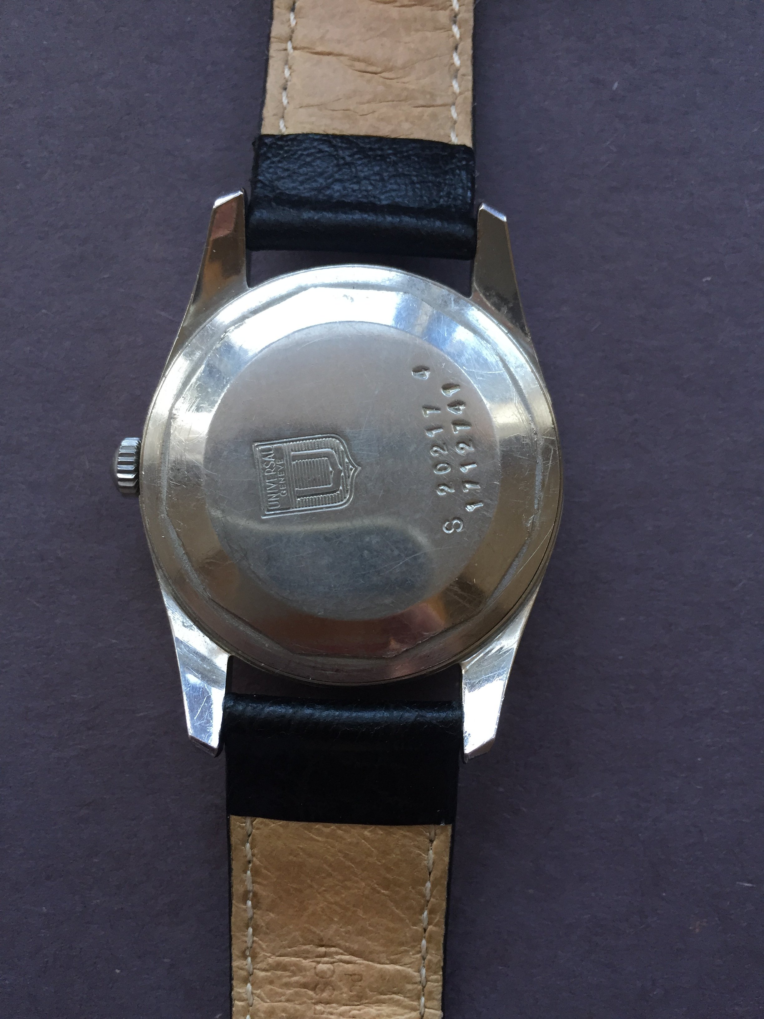

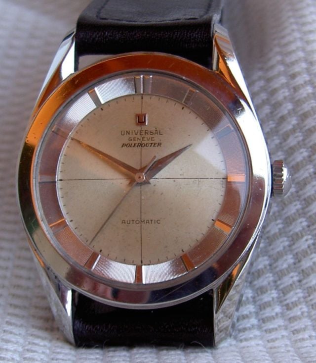

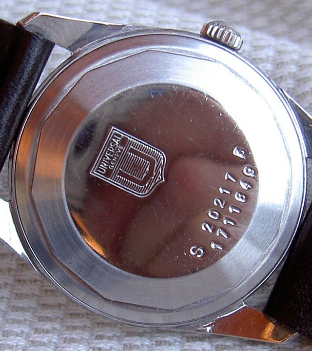

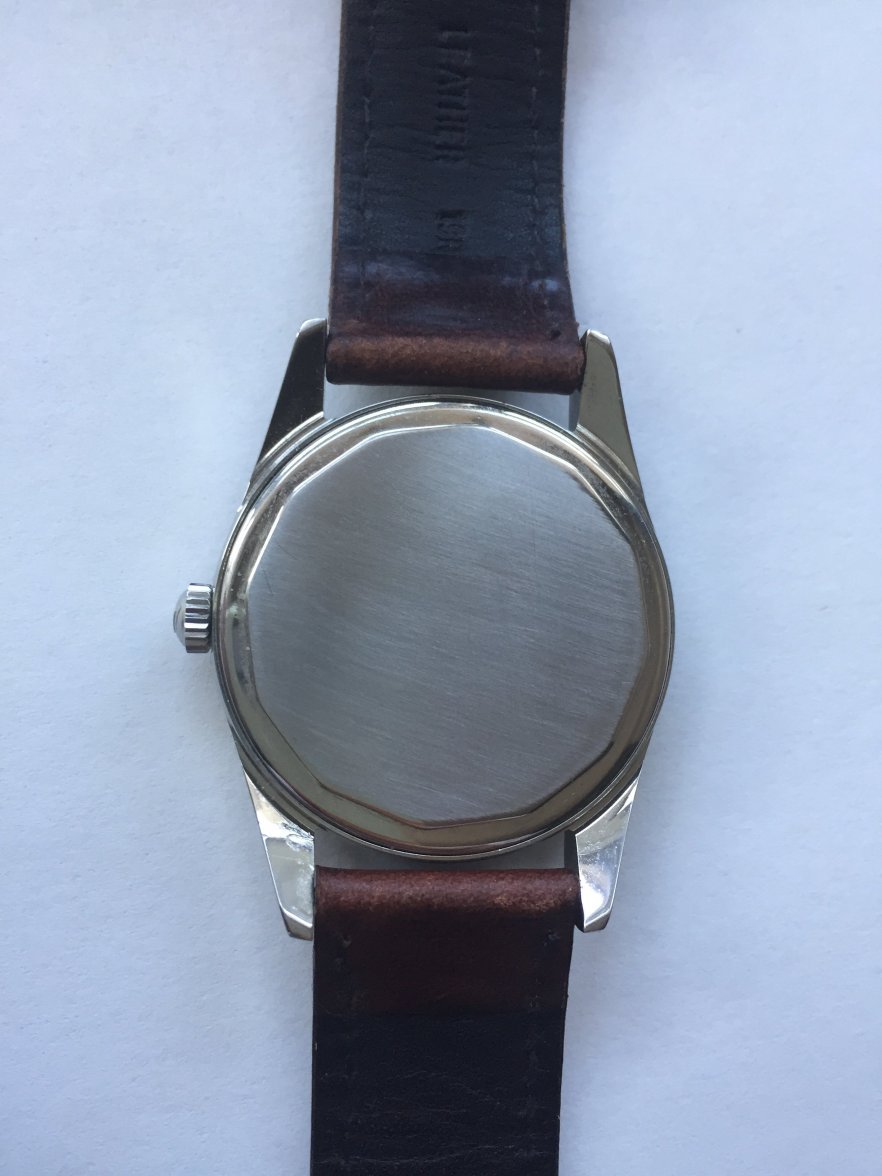

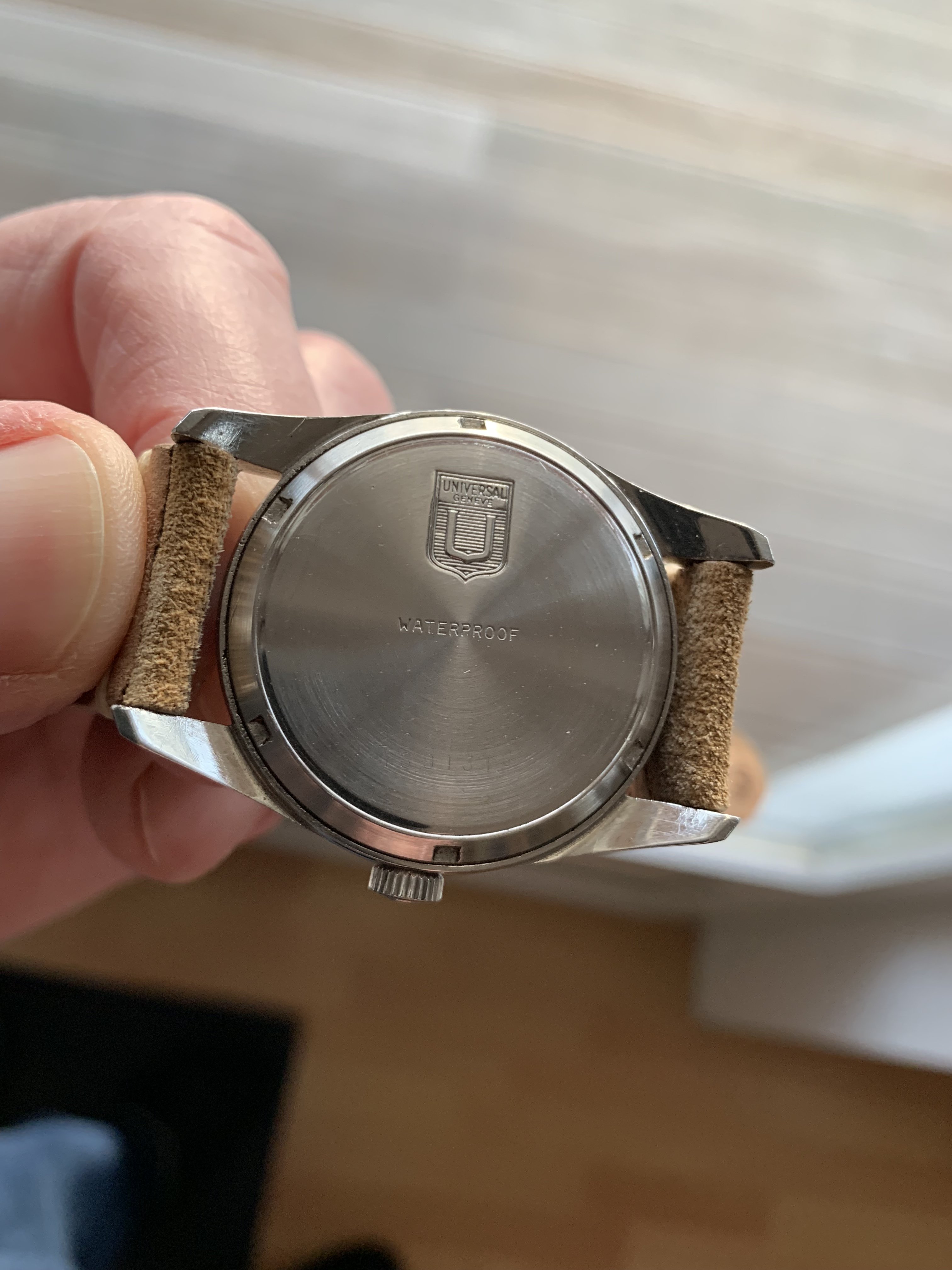

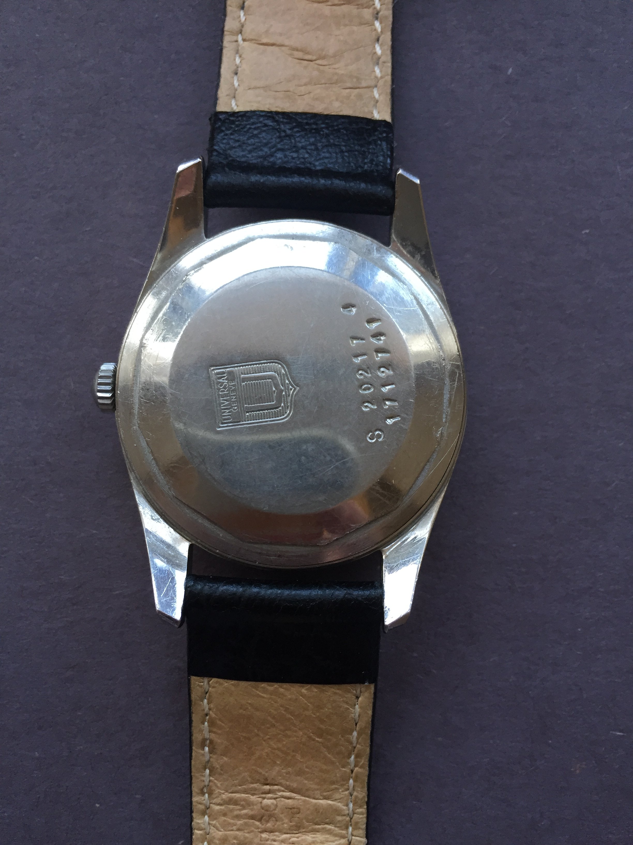

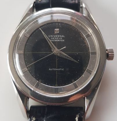

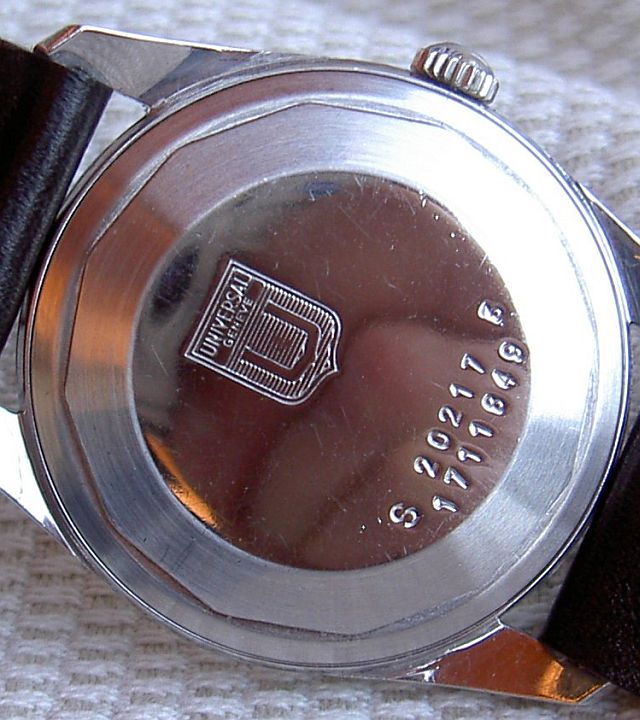

I don't know if my Polerouter is transitional, but for sure is all original 😀
"Dear Mr Xxxxx,
We refer to your above-mentioned email related to a vintage UNIVERSAL GENEVE “Polerouter” watch and would like to present you our apologies for this late reply.
According to our files, your UNIVERSAL GENEVE “Polerouter” in steel, model S-20217-3 (serial numbered 1’711’849) has been manufactured in 1955-1956. This is all we have been able to find out about this particular watch.
We gladly remain at your disposal for any further inquiry.
With our best regards,
UNIVERSAL GENEVE SA
After Sales Service"

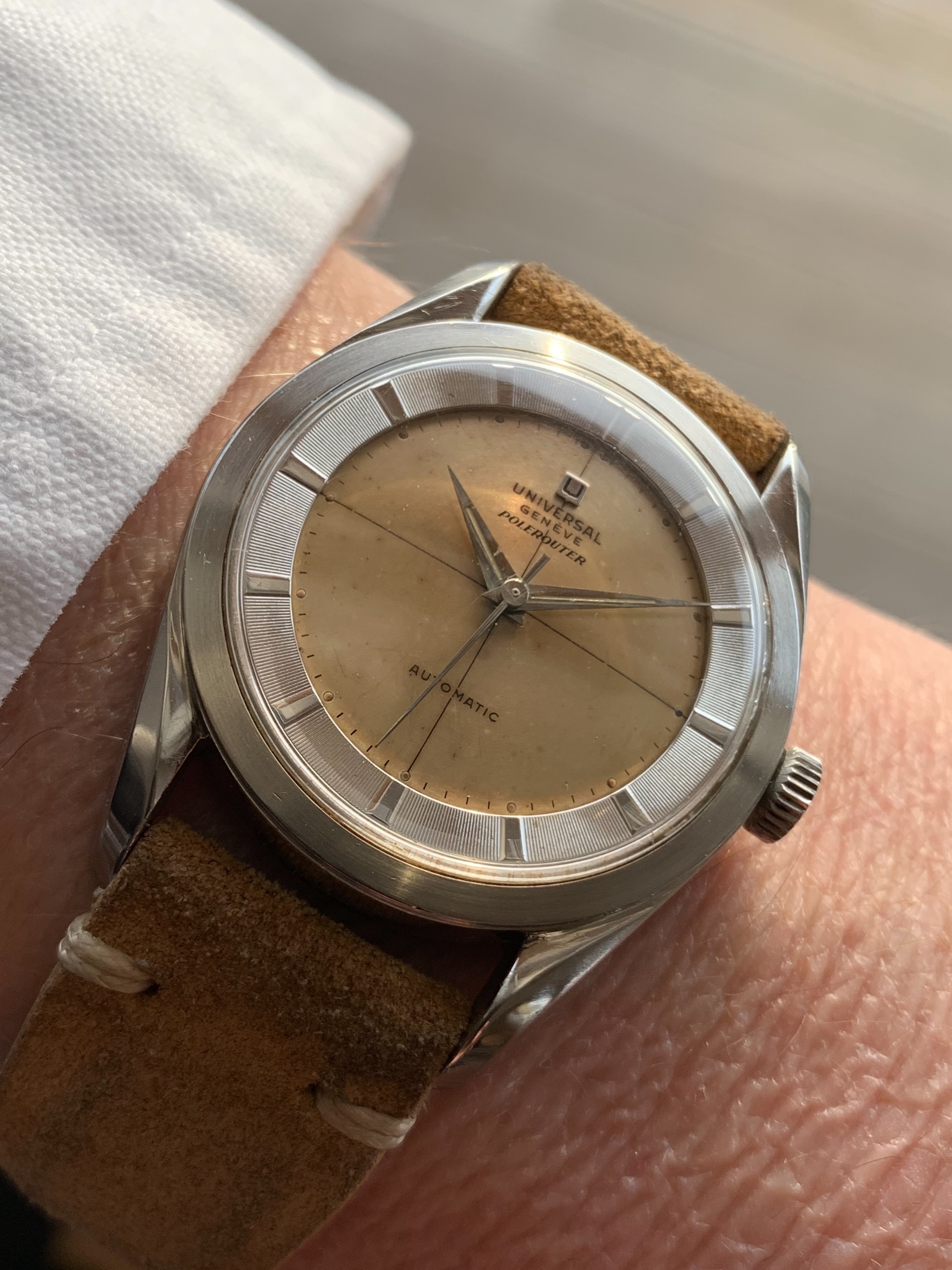

It woudln’t Surprise me, @Mazoue (by the way, thank you for this Interesting thread).
We already know there is some overlap between other, non-Polarouter generations of polerouter cases. For example. Here is my 215 with a large 138 case, 19mm lug width. Serial is approximately 1.84 million, ref 208360-2. (What is the movement in your example (apologies if you’ve mentioned it somewhere and i missed it)).
I am leaving this reply now in the spirit of a quick, initial impression rather than as a piece of thoroughly researched reasoning.
For further reference, here is one of my bumpers:
One reference value and a few serial numbers apart from yours:

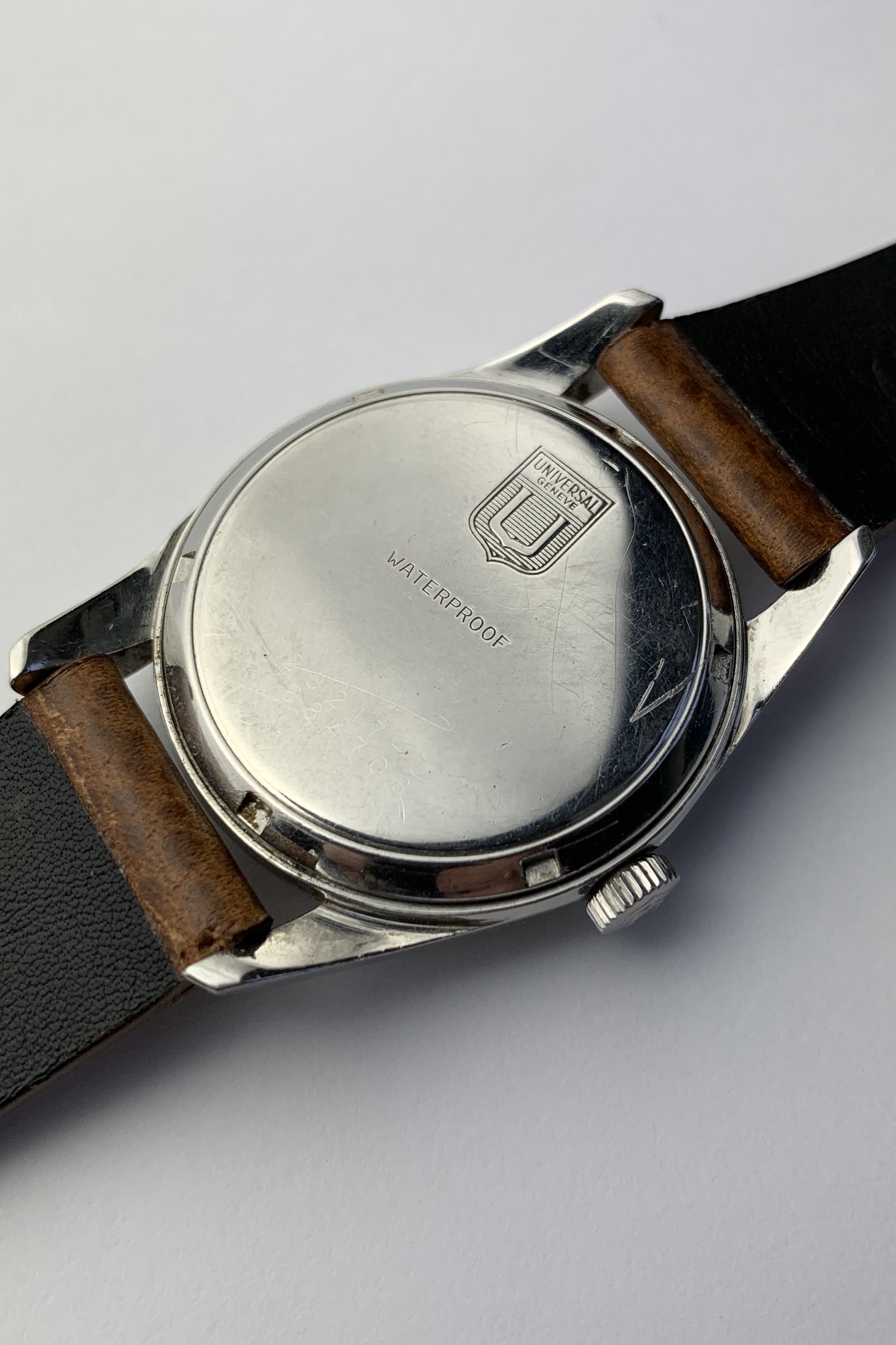

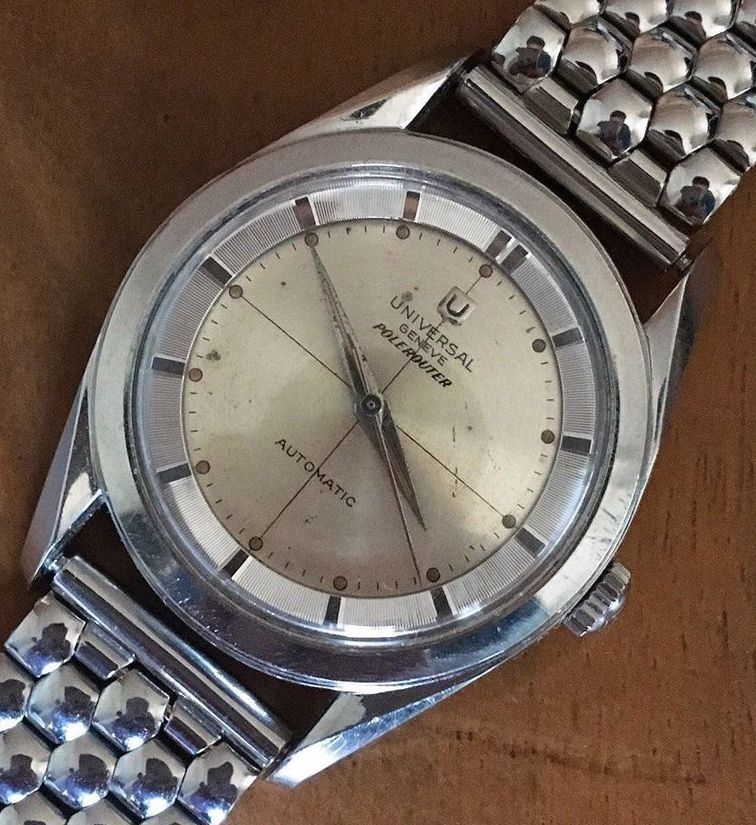

Definitely not a candidate for being 'transitional'. It has a Polerouter case back with polygonal case back and a Polerouter case reference of S20217-3. It's a good example of a typical bumper Polerouter.

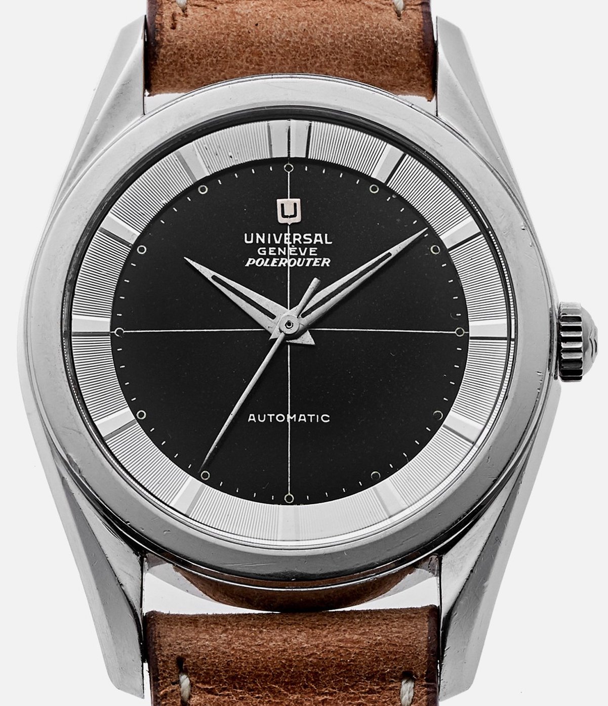

The watches in question are bumpers with the Cal 138ss movement. They are effectively very early Polerouters and will date to 1955. The Polarouter was first available at the end of 1954 but it is thought that the name changed to Polerouter during 1955.
Polarouter serial numbers are found in the range 1'64x'xxx to 1'69x'xxx. These 'transitional' examples are found towards the end of that range but have Polerouter dials.
Bumper Polerouter serial numbers typically start at 1'71x'xxx.

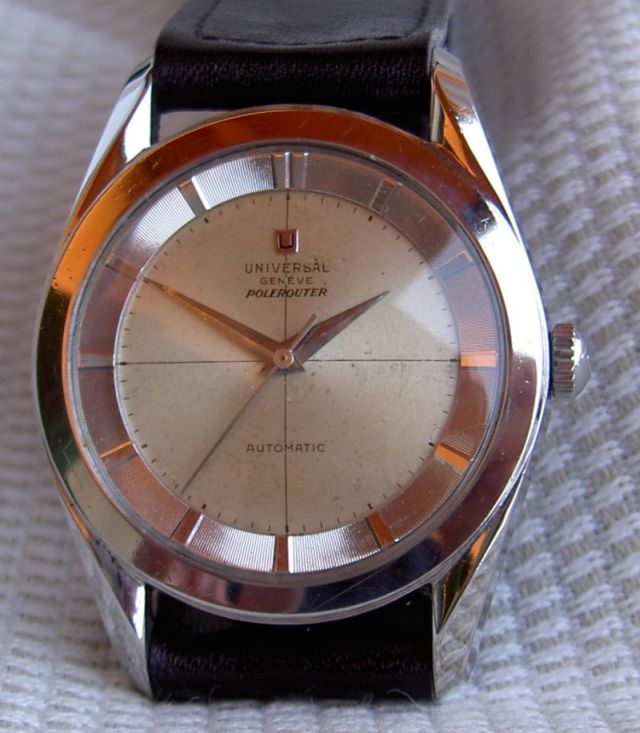

212
2,499

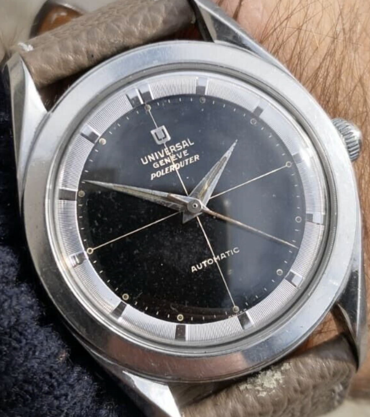

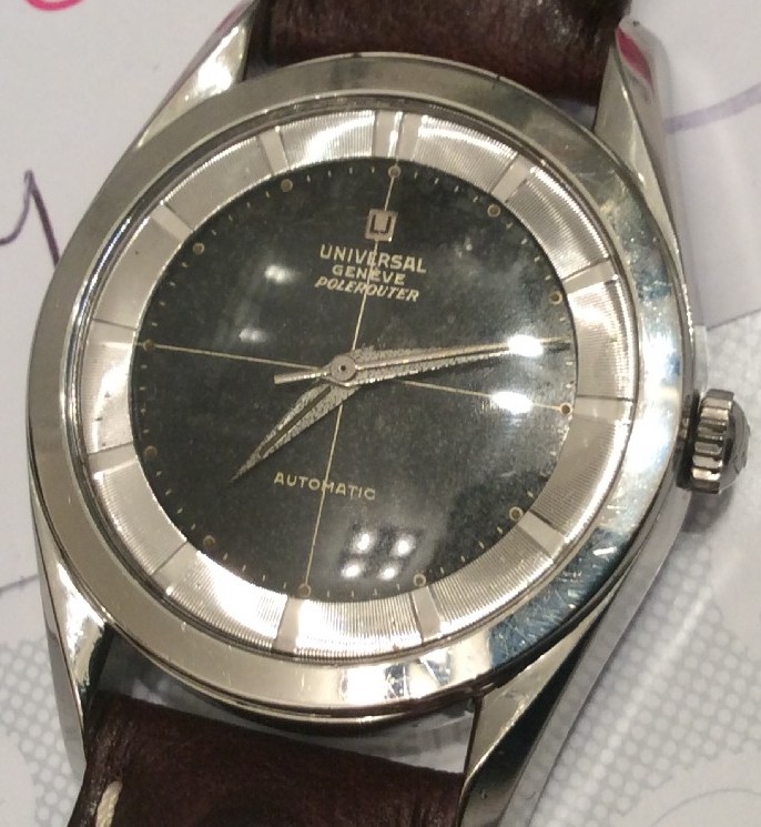

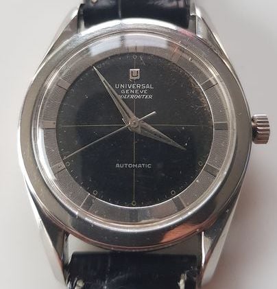

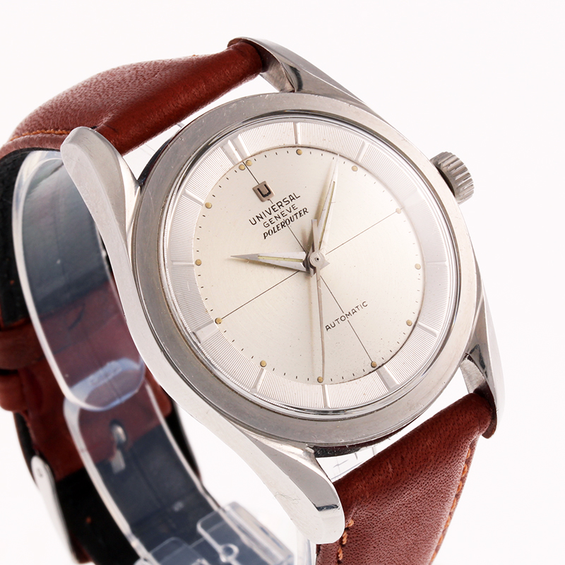

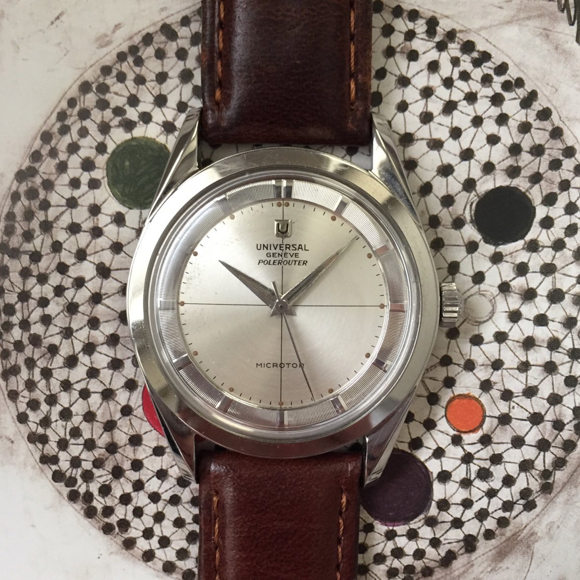

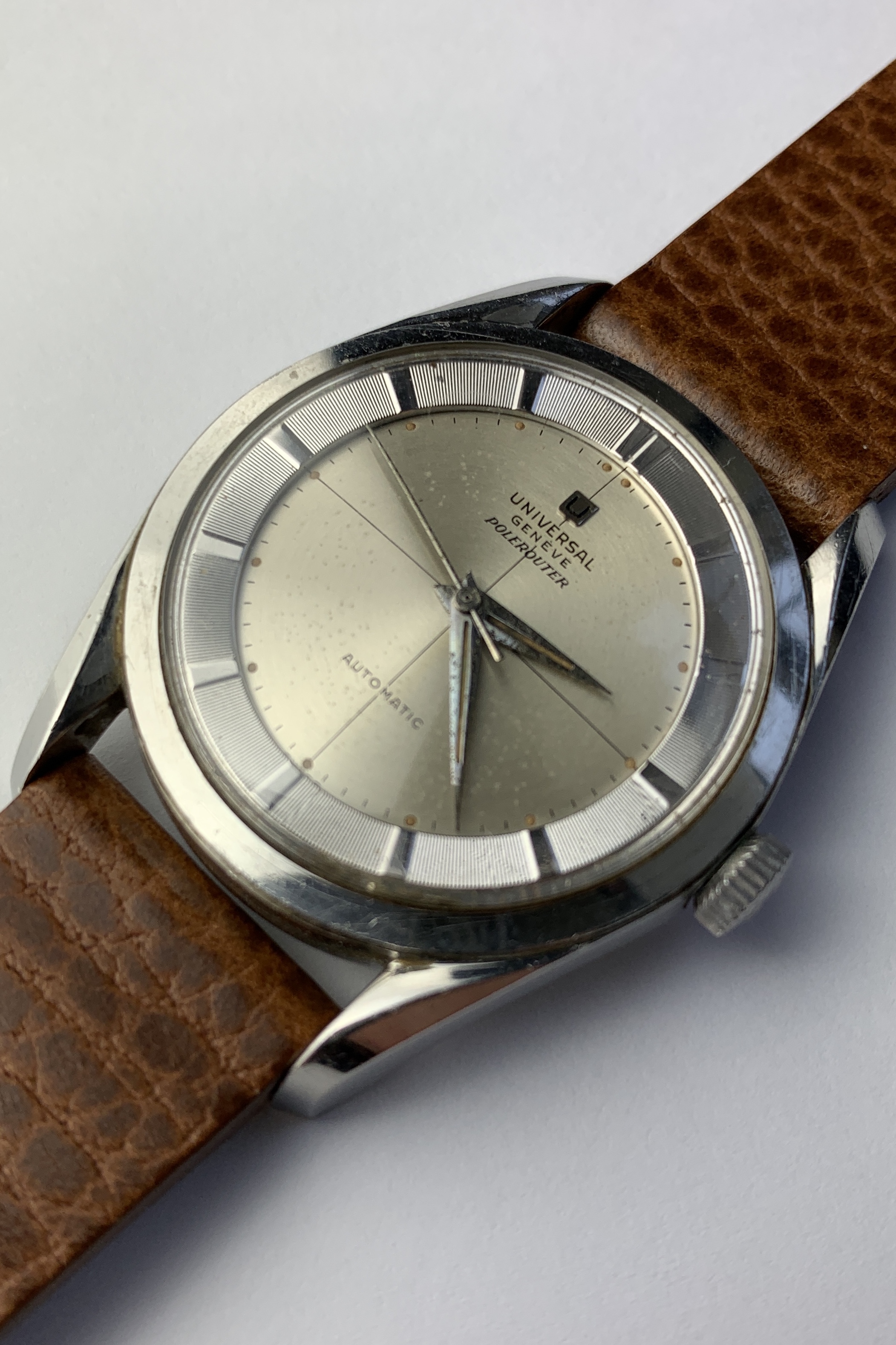

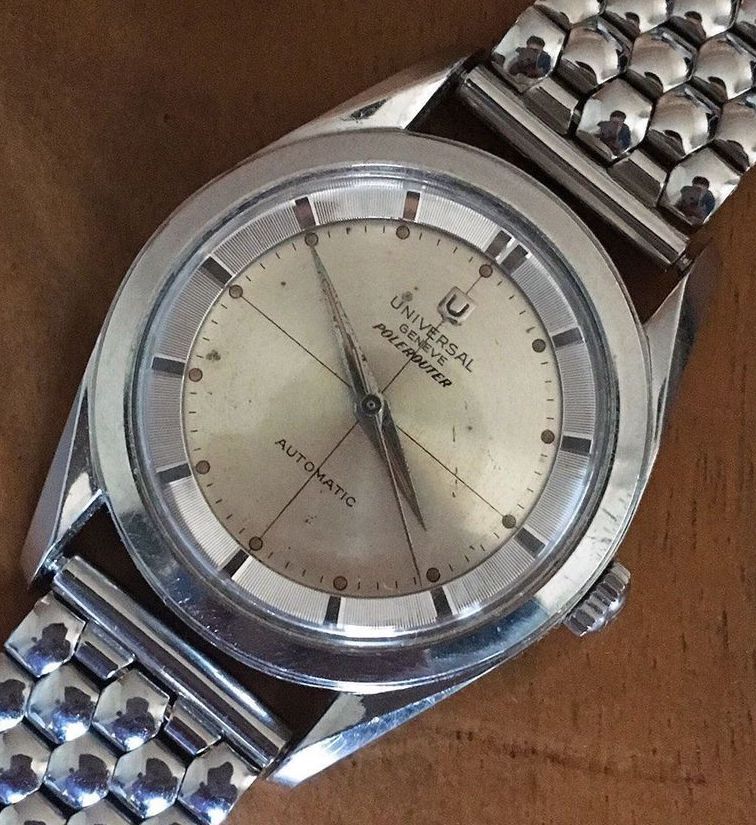

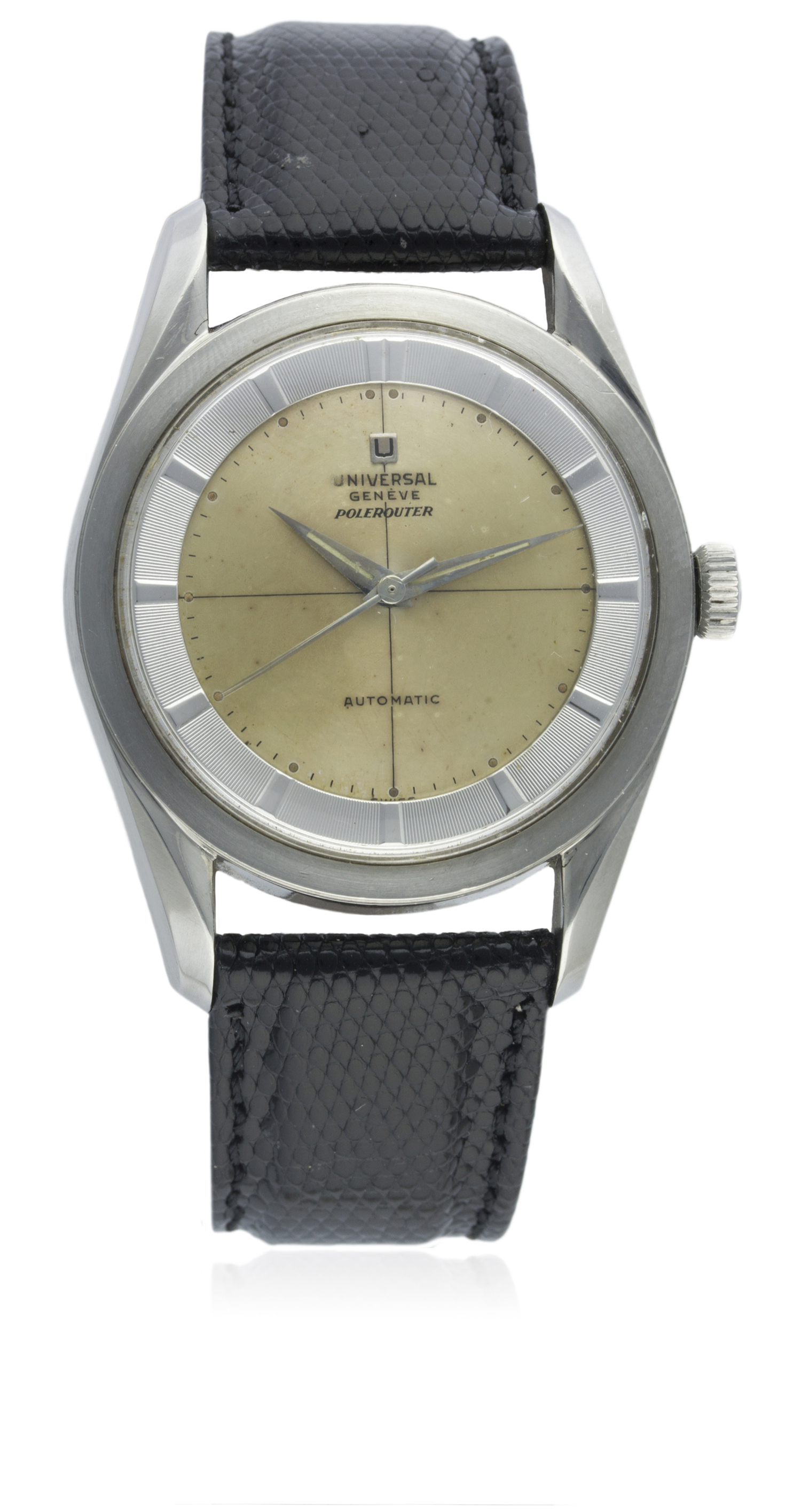

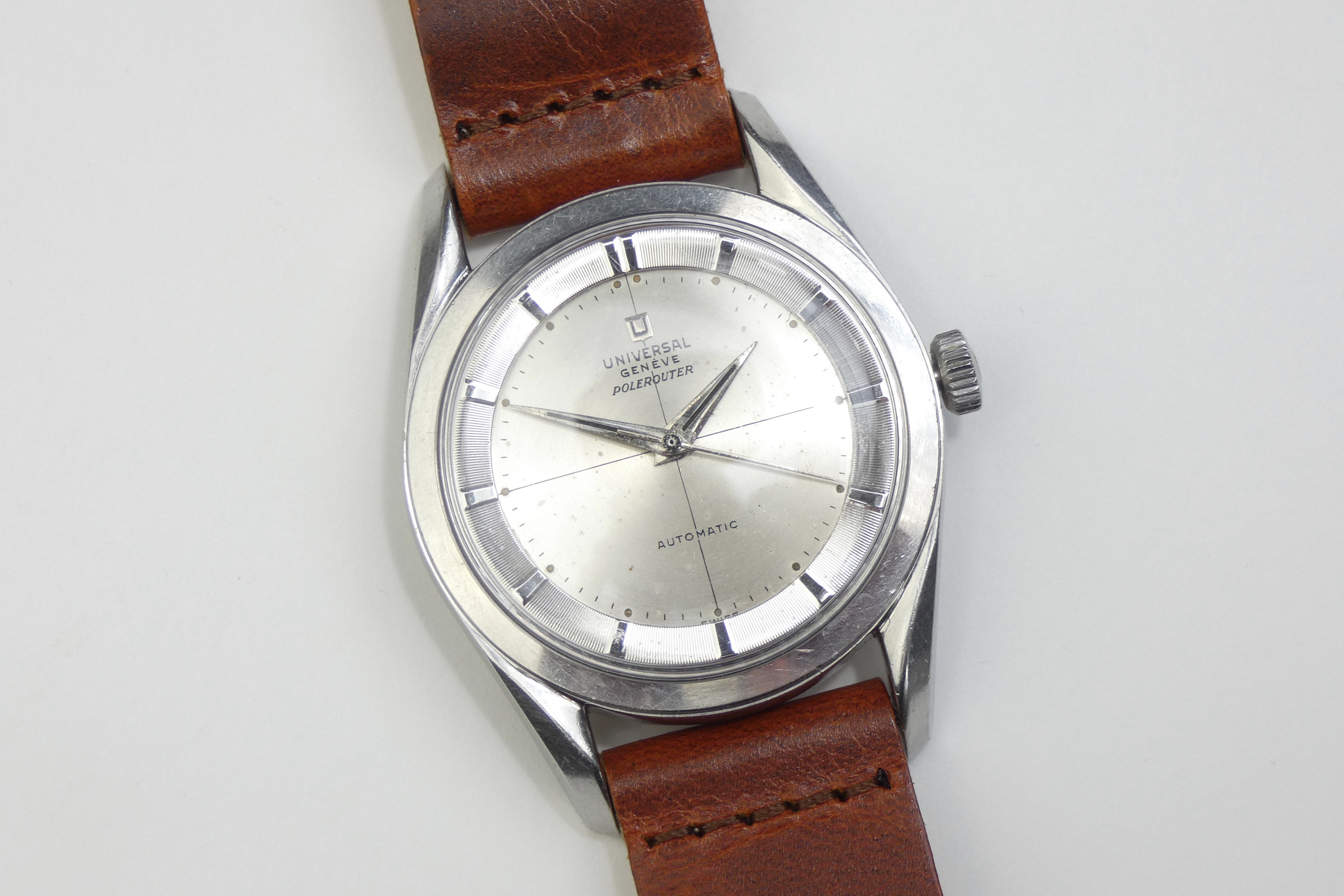

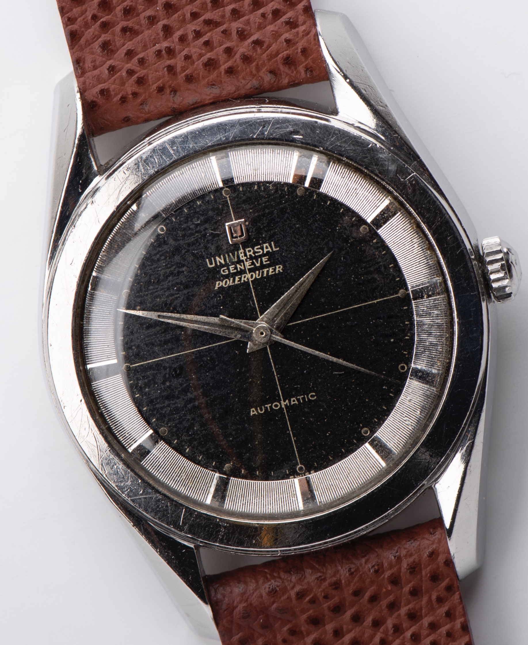

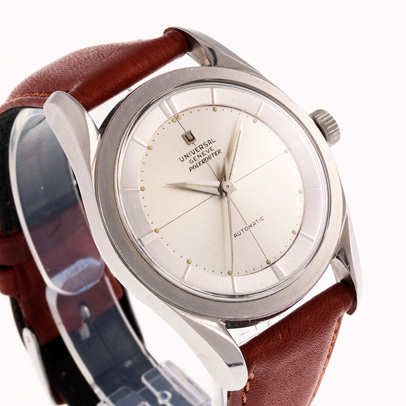

I spotted this one some time ago and thought it a redialed Polarouter as the serial was so low and it had the typical narrow indices on the chapter ring. Perhaps a "transitional" piece?
It's a tricky situation - without any real records from UG we're all just guessing with transitional this, or service dial that.
1,211
3,071
I agree, we are guessing but it's possible to find evidence that makes things more or less likely even if we can't prove them.
This watch doesn't fit the transitional theory very well and I would say that it is most likely a Polarouter with a replaced dial.
Polarouters appear to have two distinct serial ranges:
- 1'64x'xxx (First exec)
- 1'67x,xxx to 1'69x,xxx (2nd exec)
If there were transitional watches then you would expect them to be 2nd exec watches with later serials but that is not the case here. In addition, the watches that I've seen that fit the transitional theory have the standard Polerouter marker ring with wide hour markers.

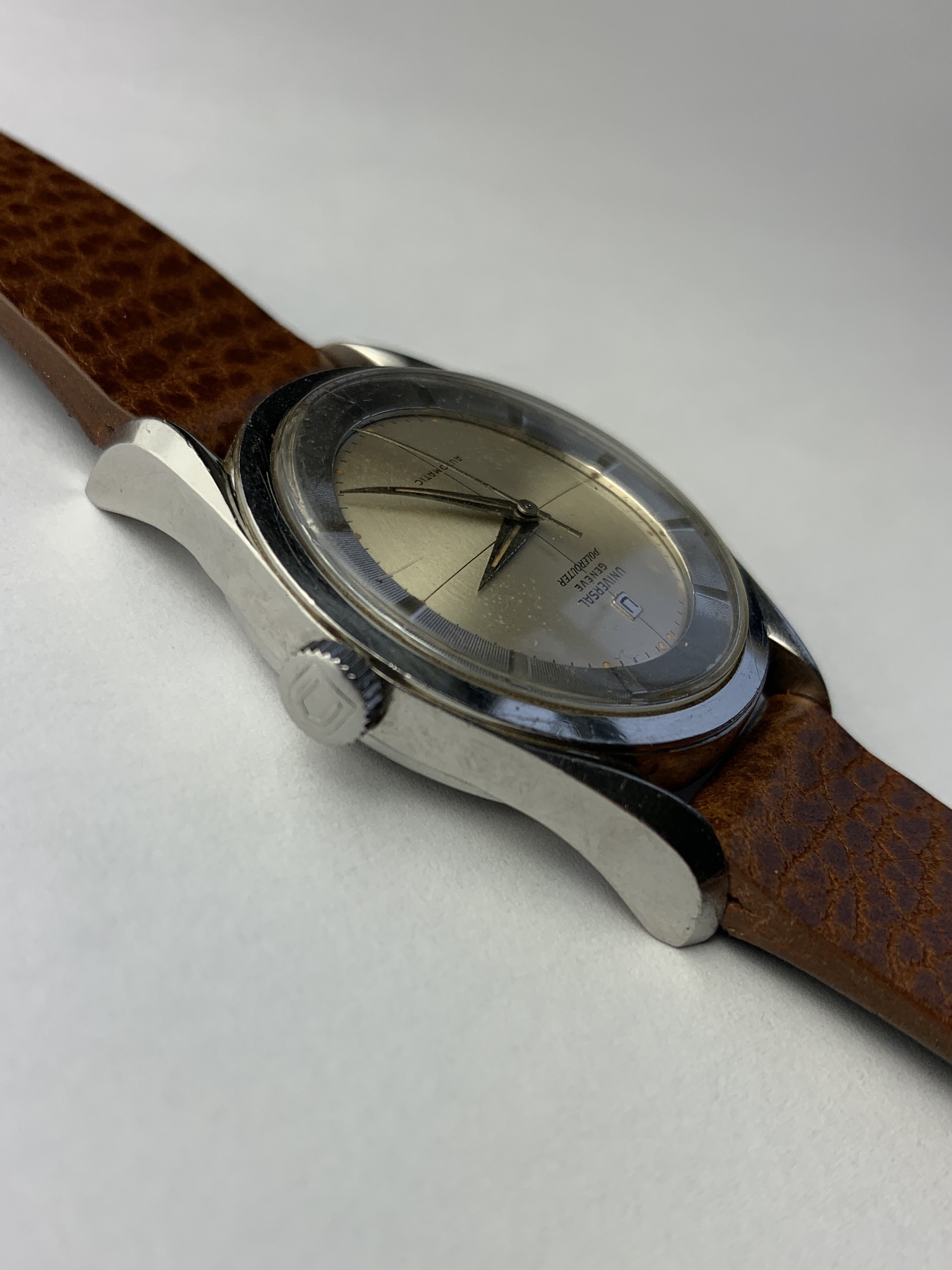

1,211
3,071

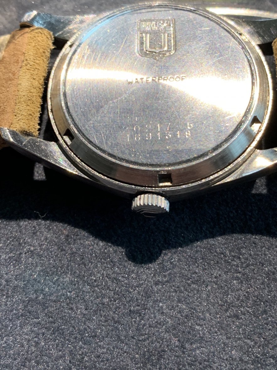

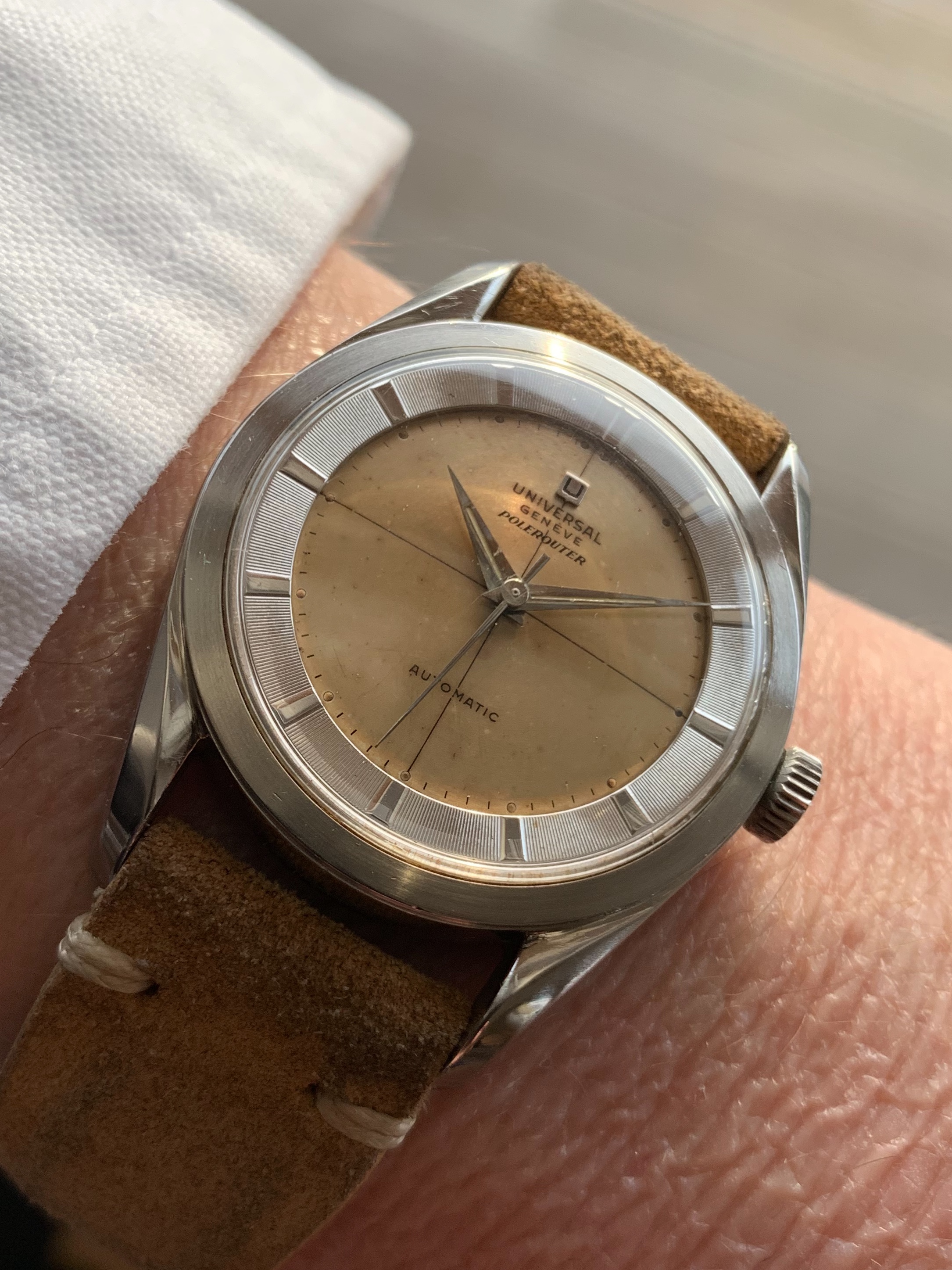

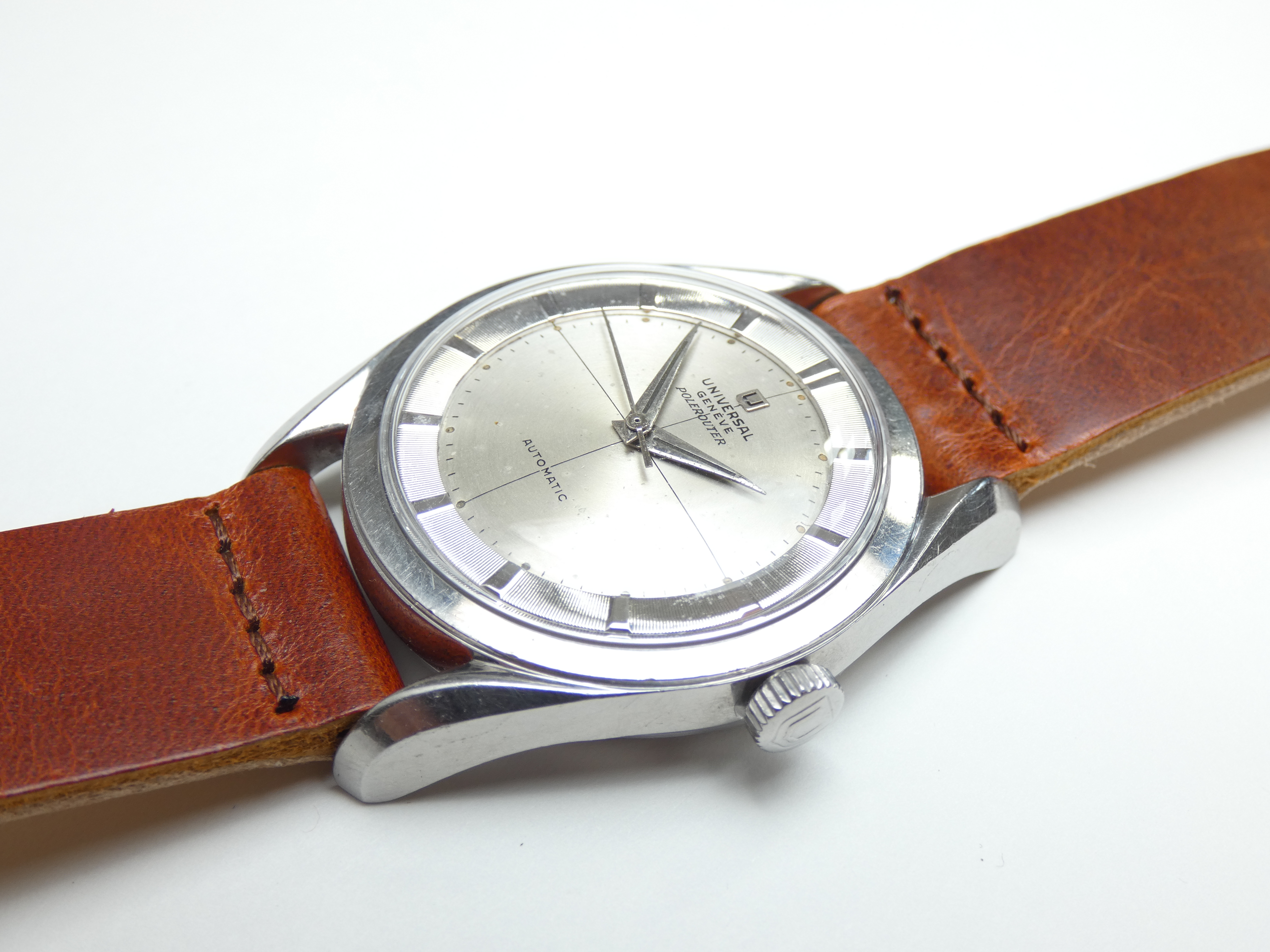

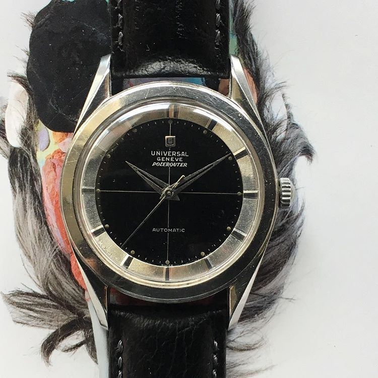

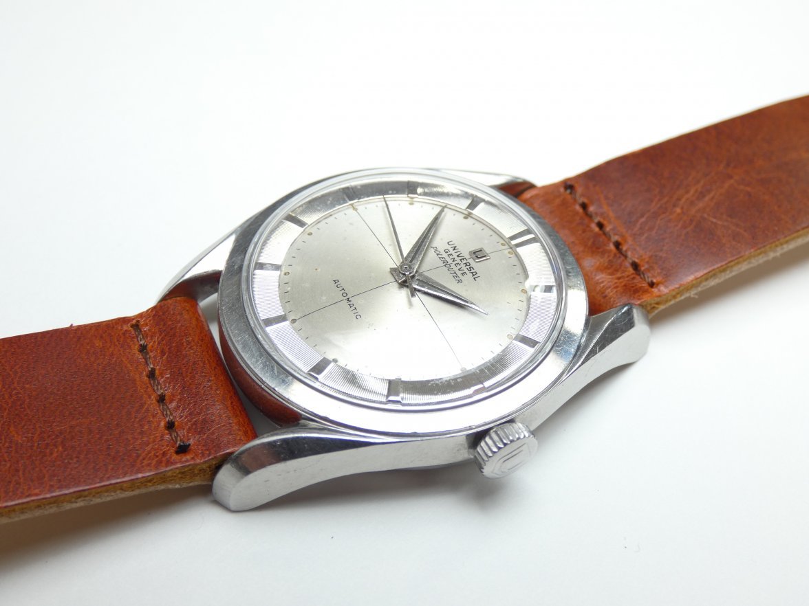

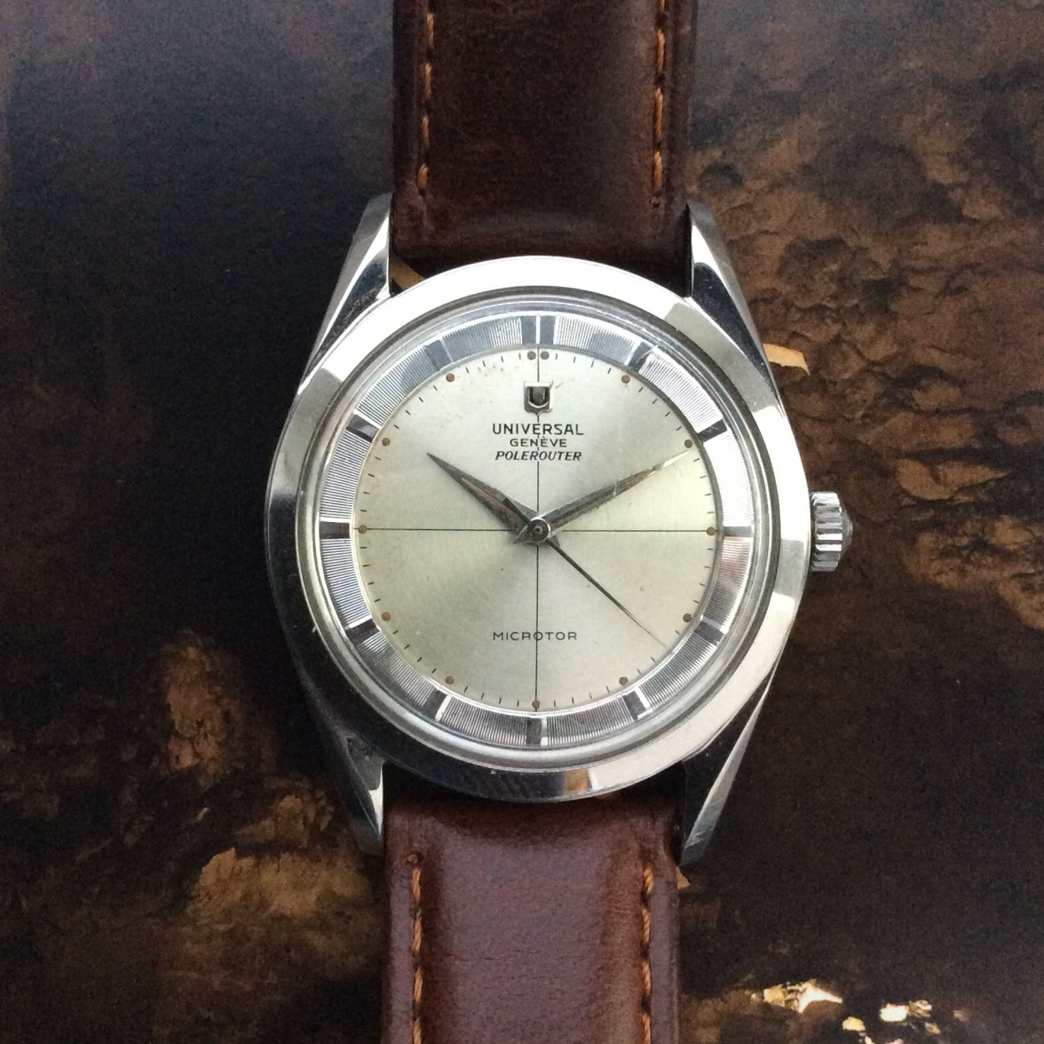

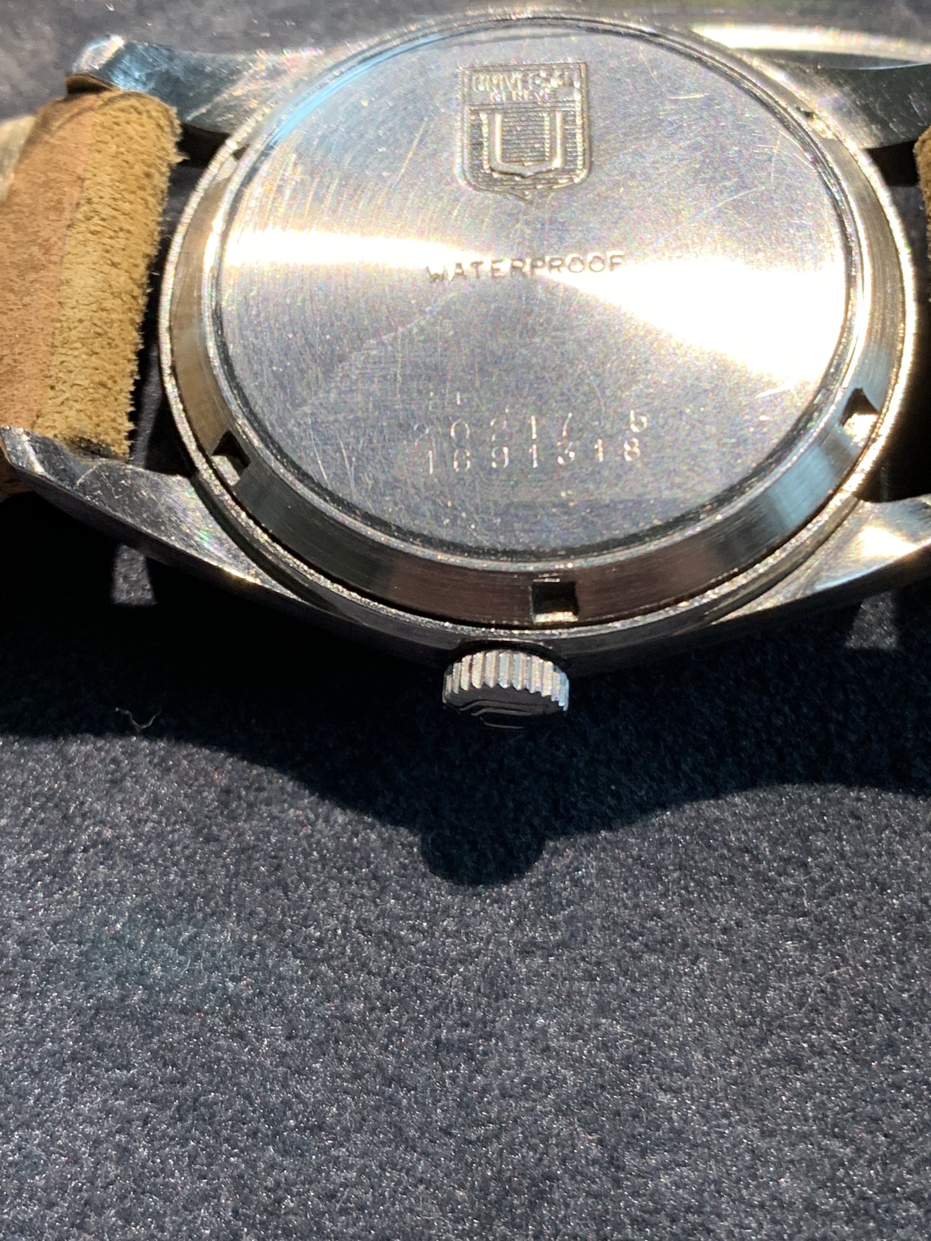

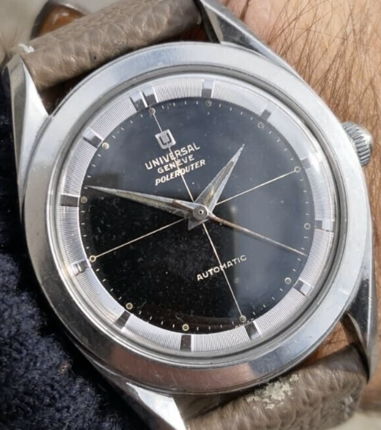

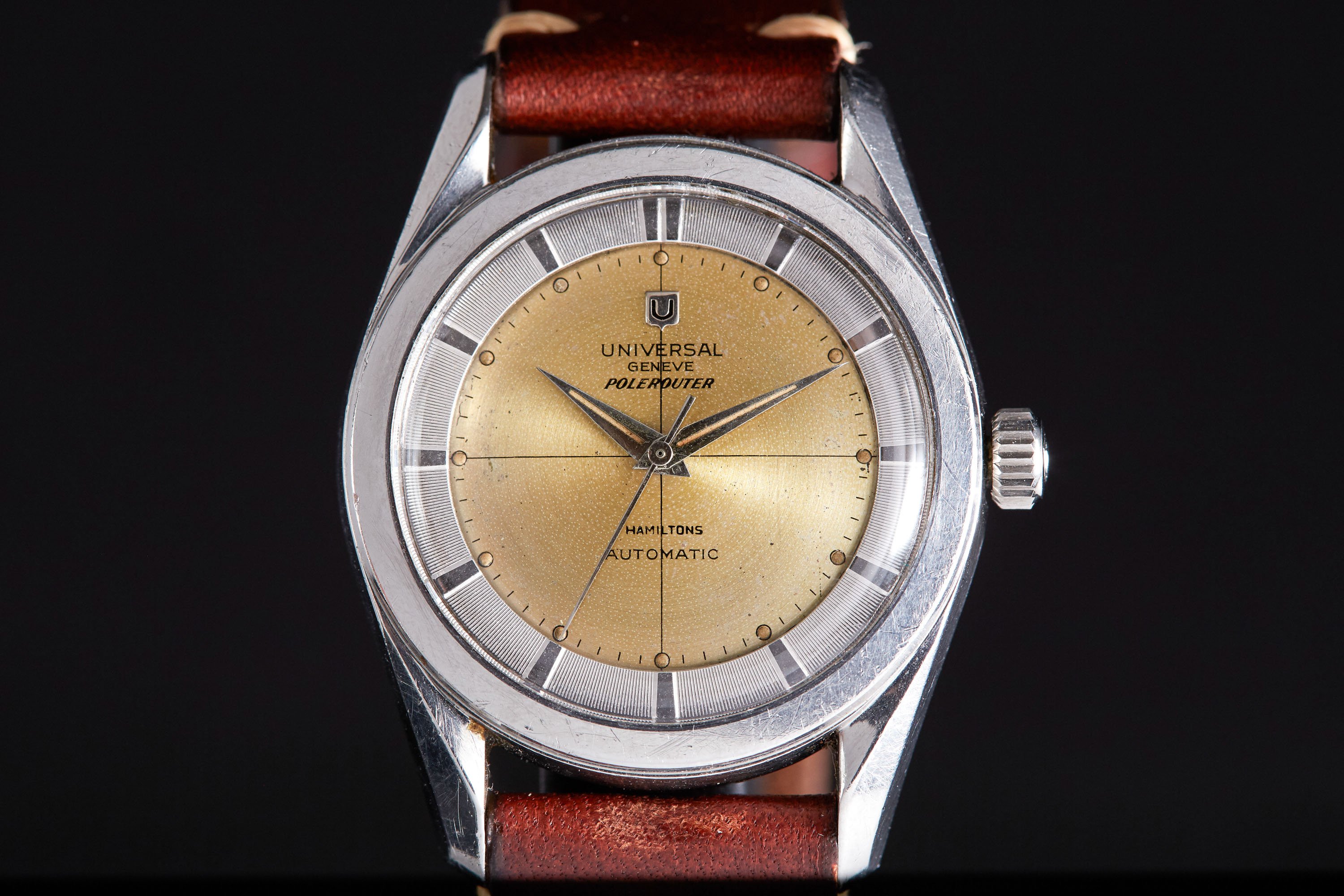

Another example of a 20217-5 with Polerouter dial. In common with my first example, the serial number is 1'68x'xxx - sadly the remainder of the serial was not visible because it had been worn off. Same crown seen on late Polarouters.

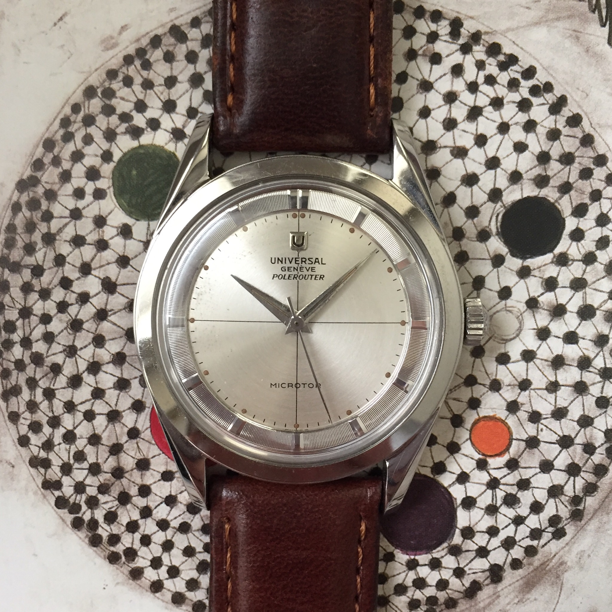

411
1,076
In my opinion (and only opinion of course...), its completely possible for there to be some sort of transitional model.
I'm just yet to see evidence of it.
Ill keep it short, but my main reasons are:
1) I have seen and recorded later serials than these potential "transitional" pieces, with polarouter dials;
2) I estimate around half of the "polerouter dial in polarouter case" examples are shown to be incorrect (e.g. hands or dial not matching the reference number) and the lume colours very rarely match;
3) The early 138ss with polerouter dials used a single lume dot at 12 for the first 1500-3000 serials (depends on the reference). The "polerouter dial in polarouter case" examples (including those above), all have 2 lume dots at 12 (they made a lot more of these dials, so more likely replacements would use them). If there were a transitional dial, one would think they would be a real transition... e.g. the case from the latest polarouter, with the dial from the earliest polerouter (single lume). Im yet to see one.
So, it doesnt yet add up for me.
But of course, that doesnt mean its wrong.
As always, more serials, more examples of all different types surface and the patterns start to emerge, followed by the "of course!" and a slap of the forehead. Until then it remains a mystery. 😀
Just my thoughts on the topic...
Glad there is a bigger interest forming in "Polerouter research" though...! 😁
411
1,076

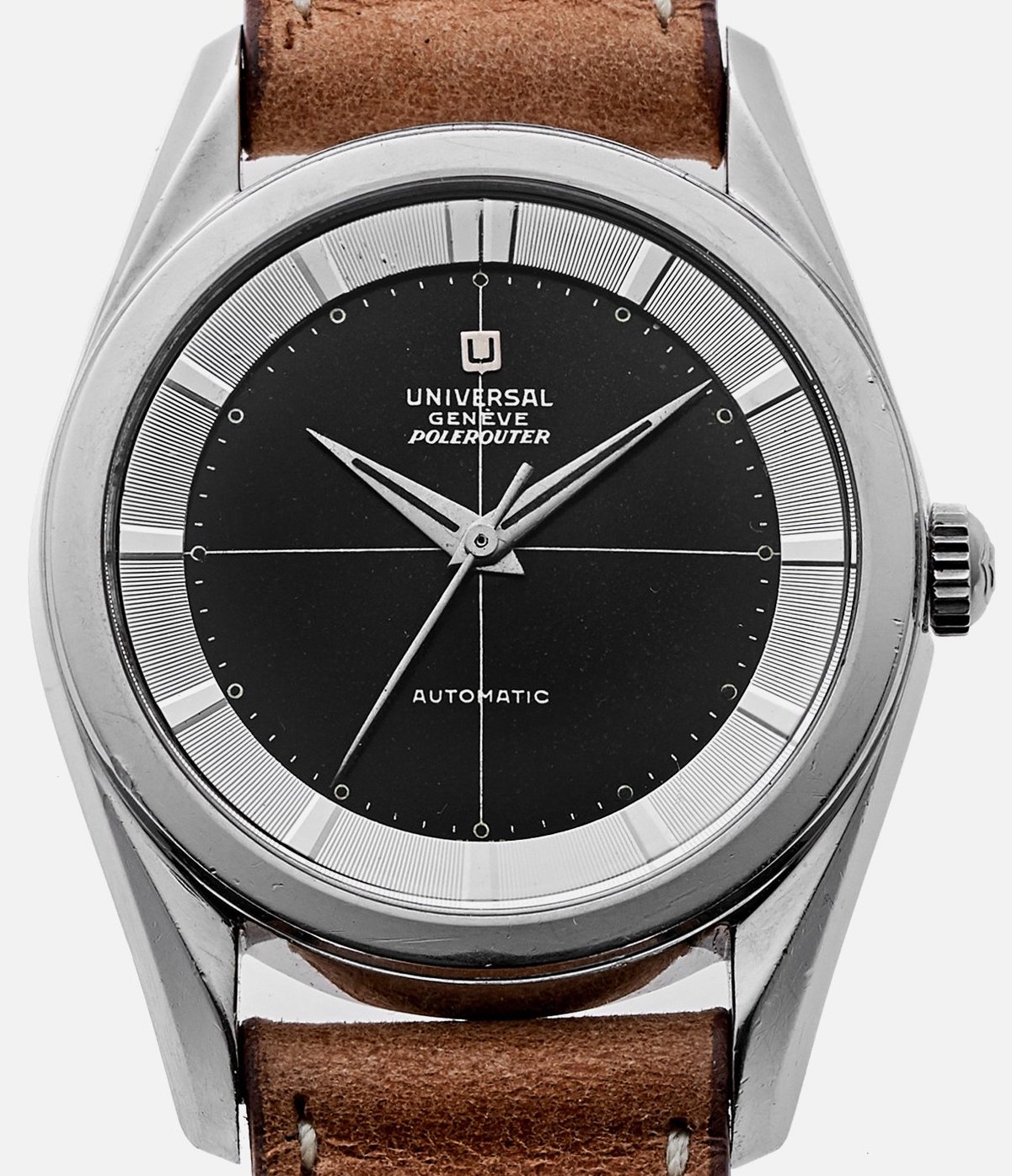

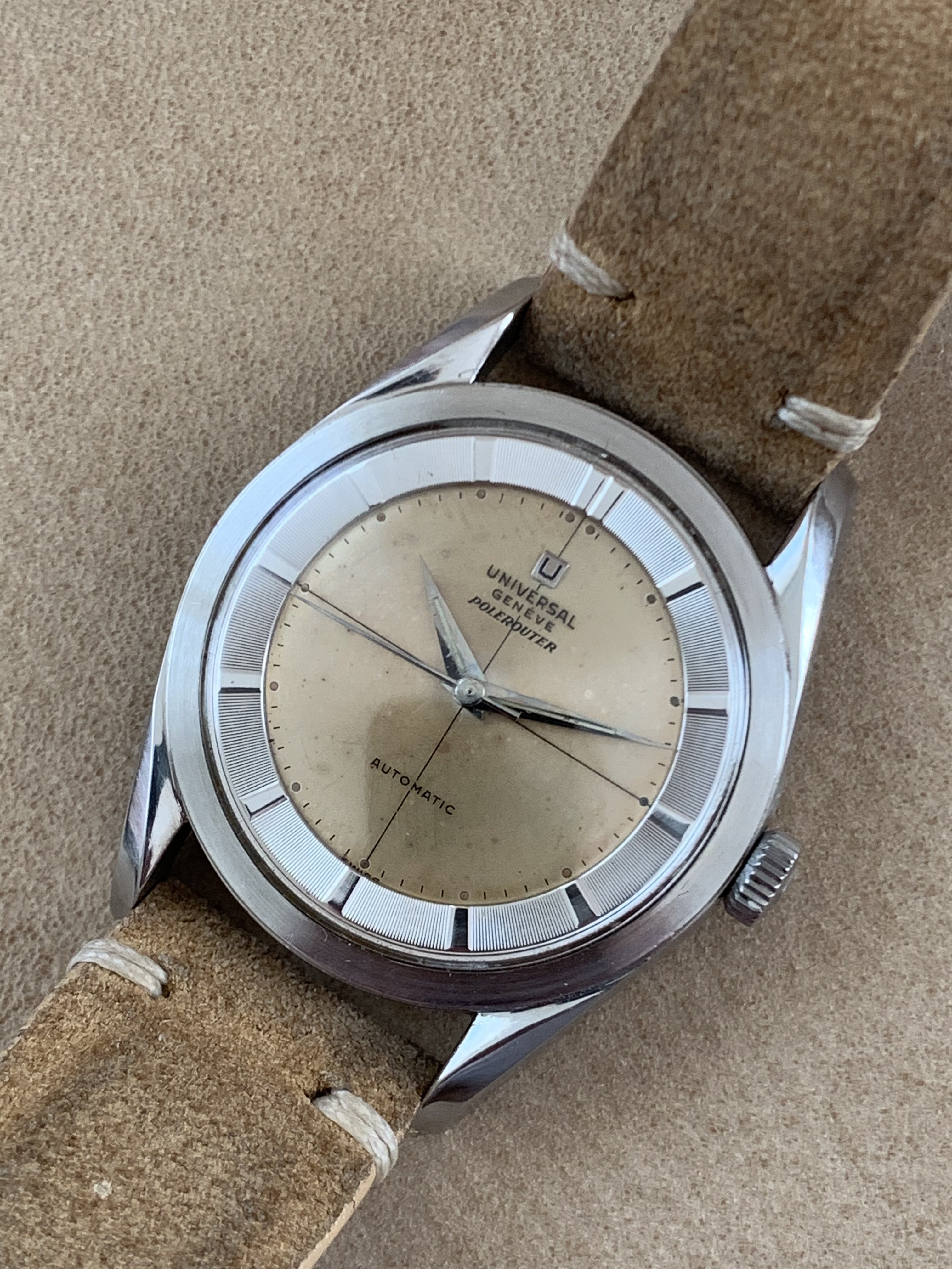

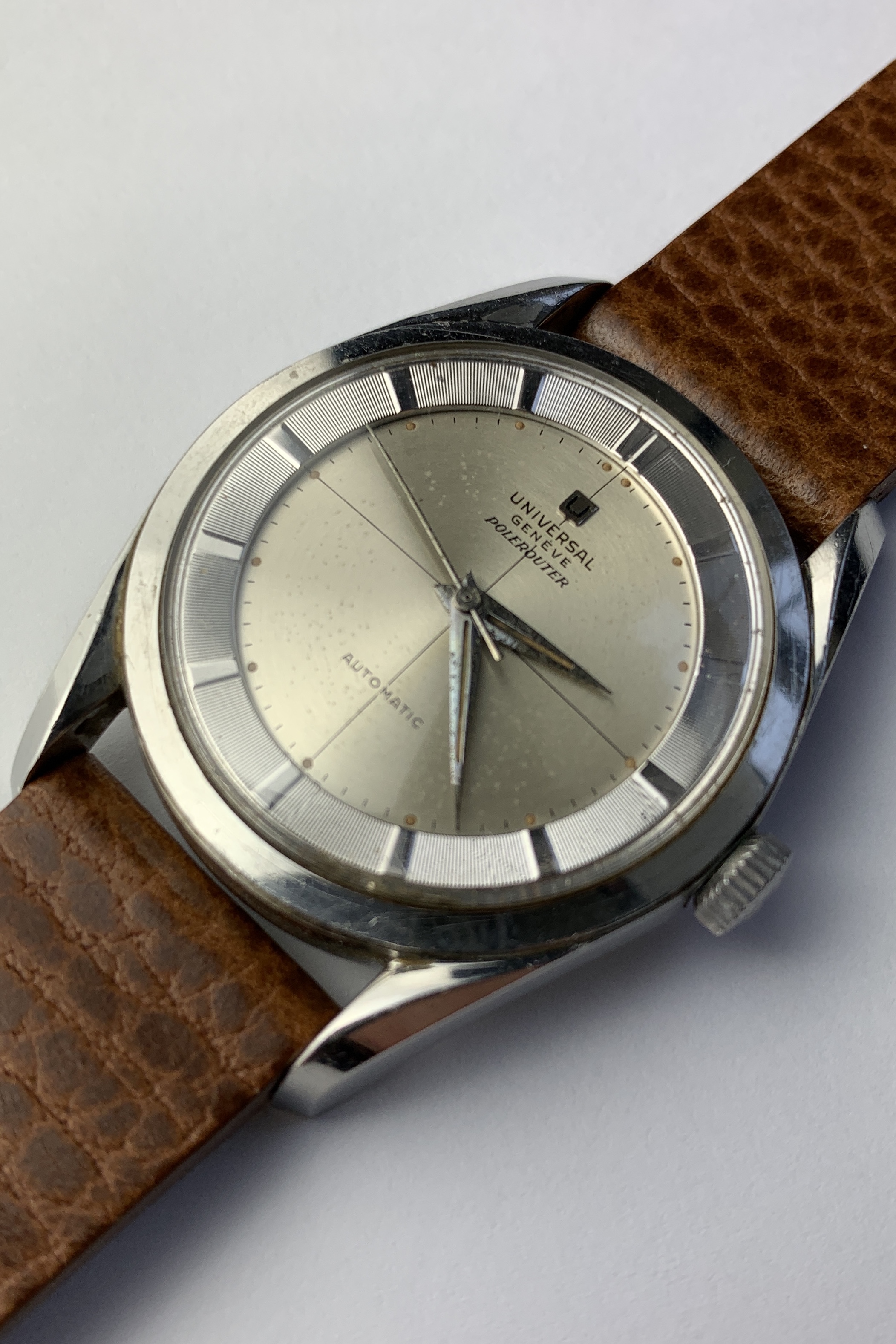

Appendix to above, some examples of the early "Single Lume as 12" polerouter dials, in photo order:
S20217-2 1710863
S20217-4 1712420
S20217-4 1712554
S20217-4 1712753
S20217-4 1712762
S20217-4 1713074
S20217-4 1713282
S20217-4 1714796
S20217-5 1715219

Thanks Adam, helpful stuff as usual.
Interesting how much variety there is even within these early S20217-4 dials. Five of your examples have the cross hair crossing the Universal Geneve and Polerouter text and the cross hair stops on the other two.

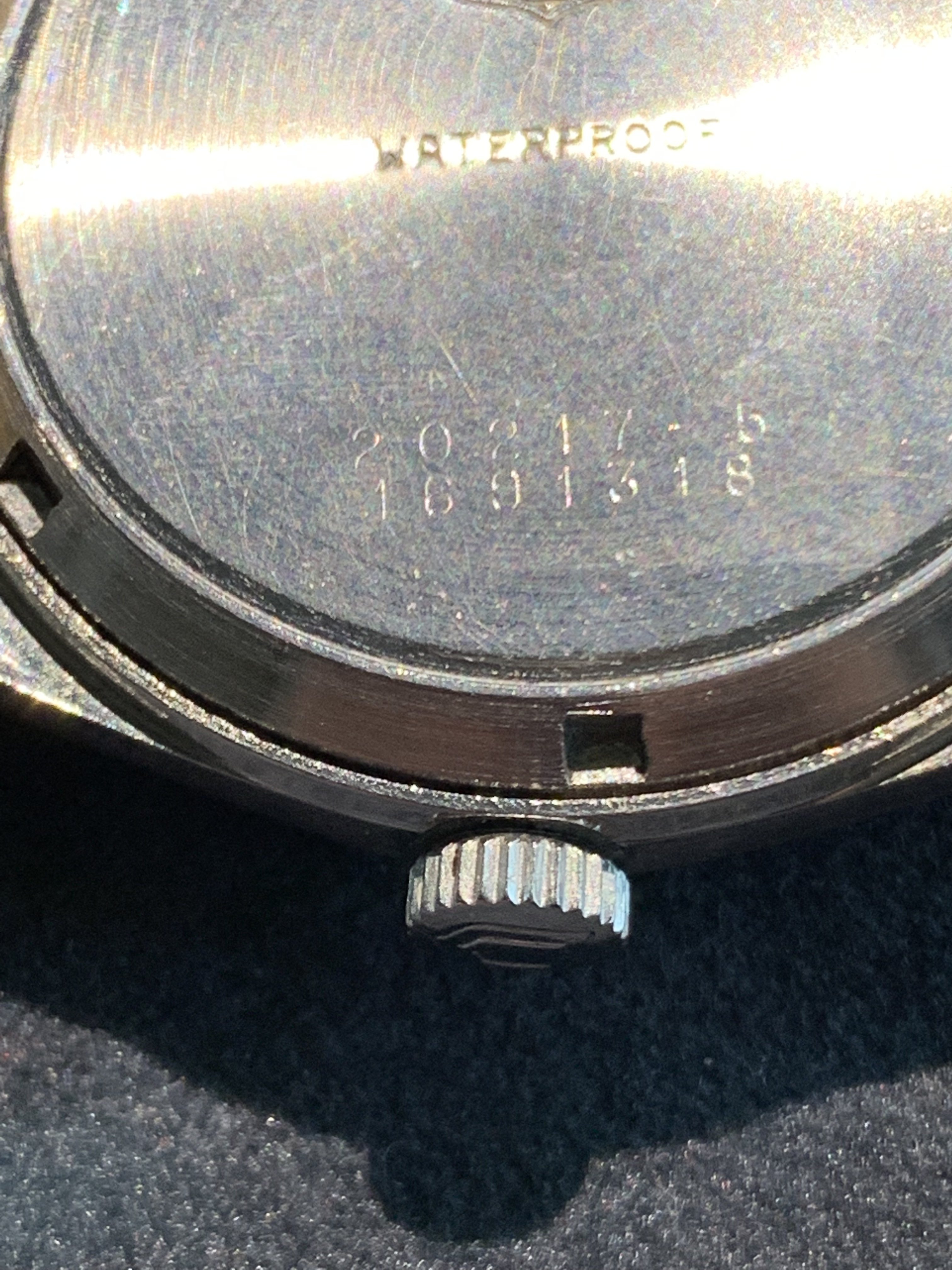

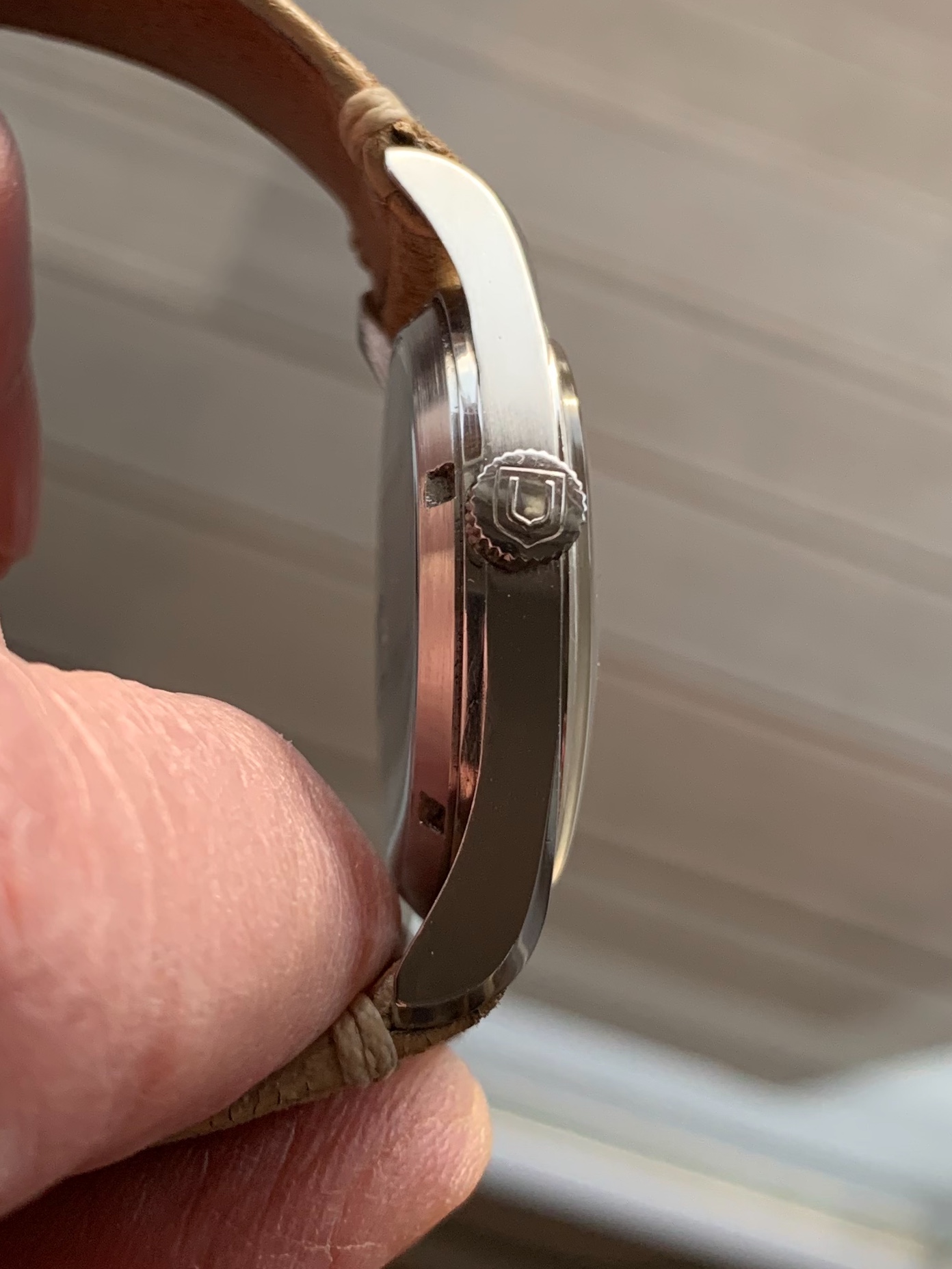

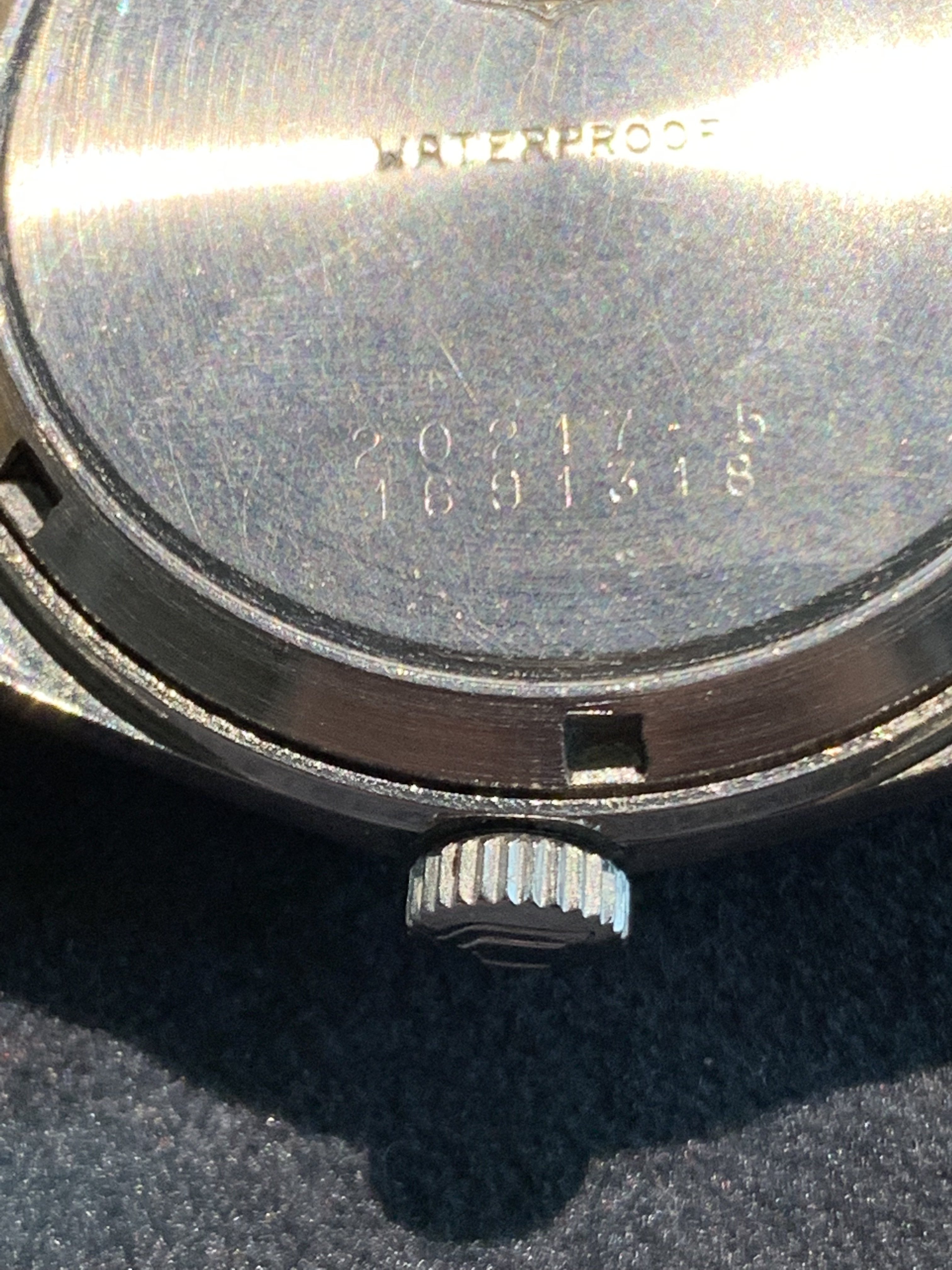

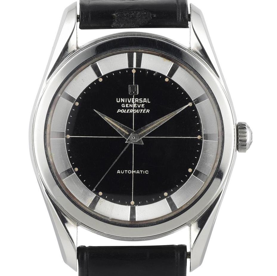

1,211
3,071

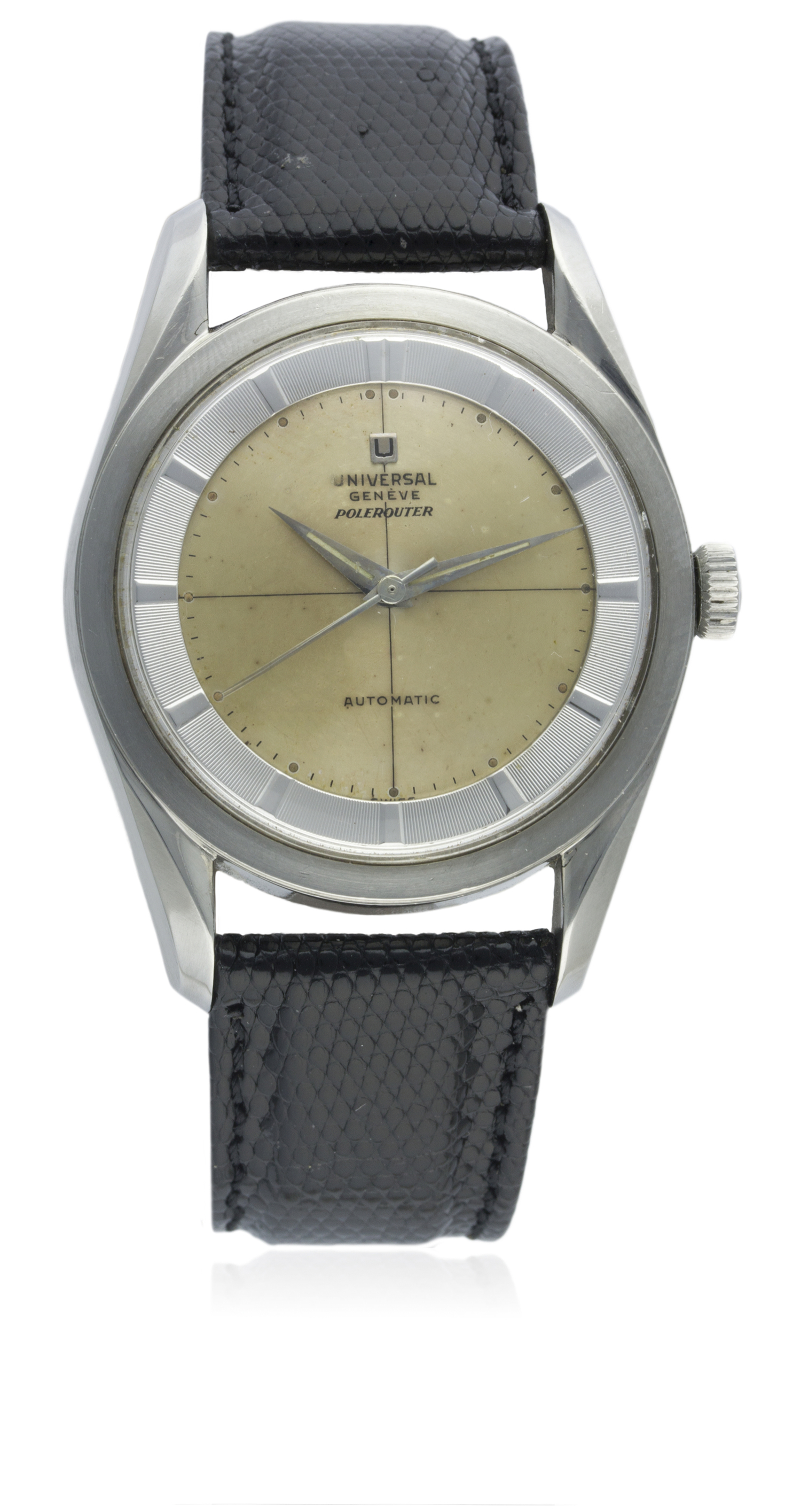

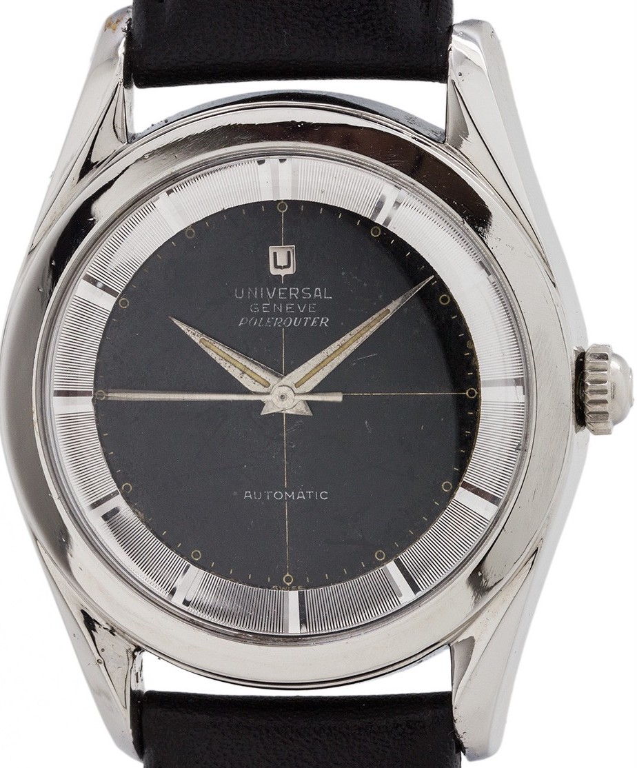

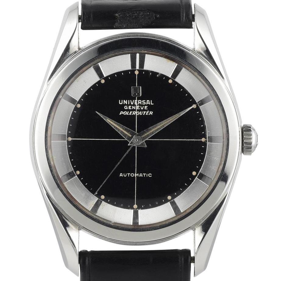

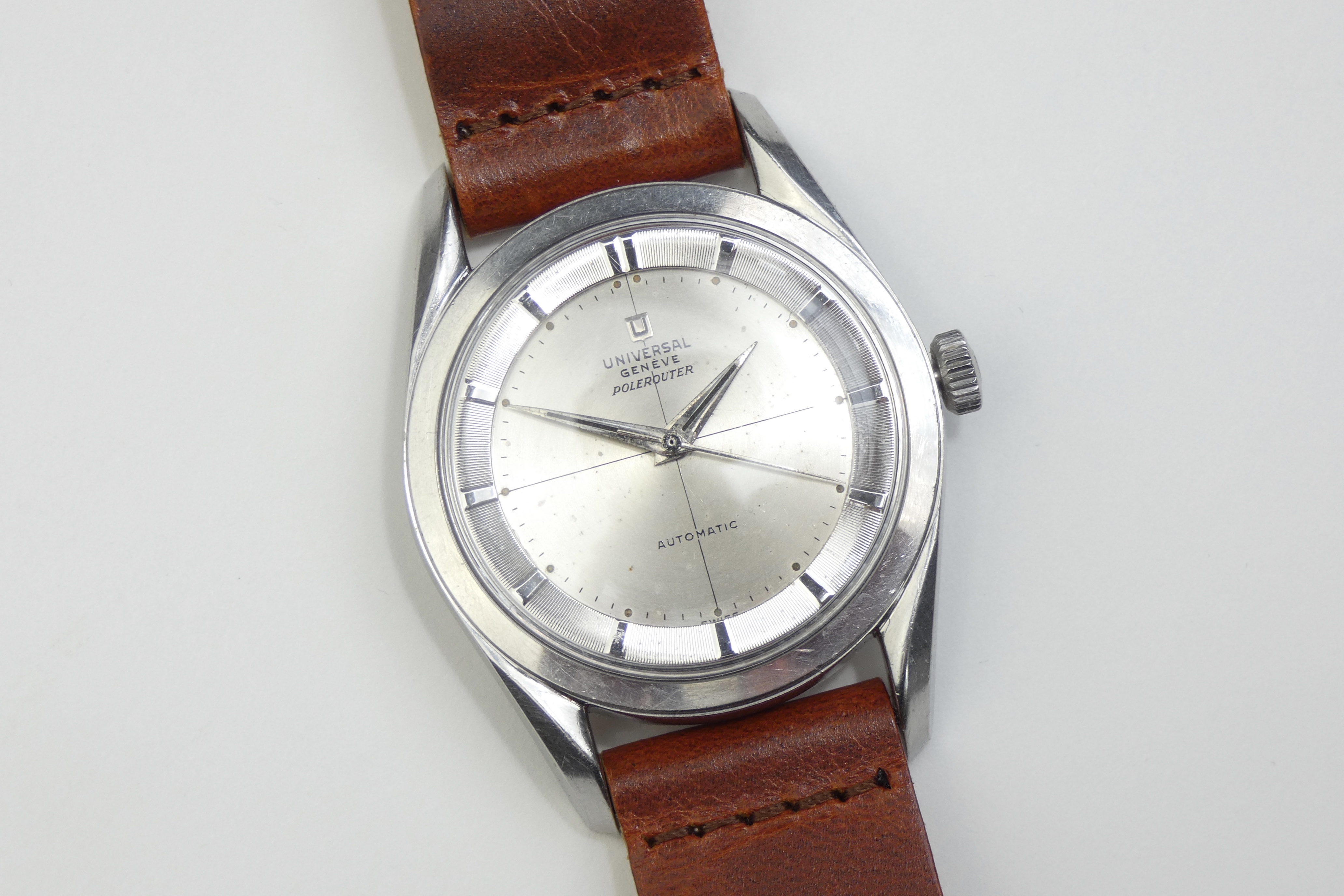

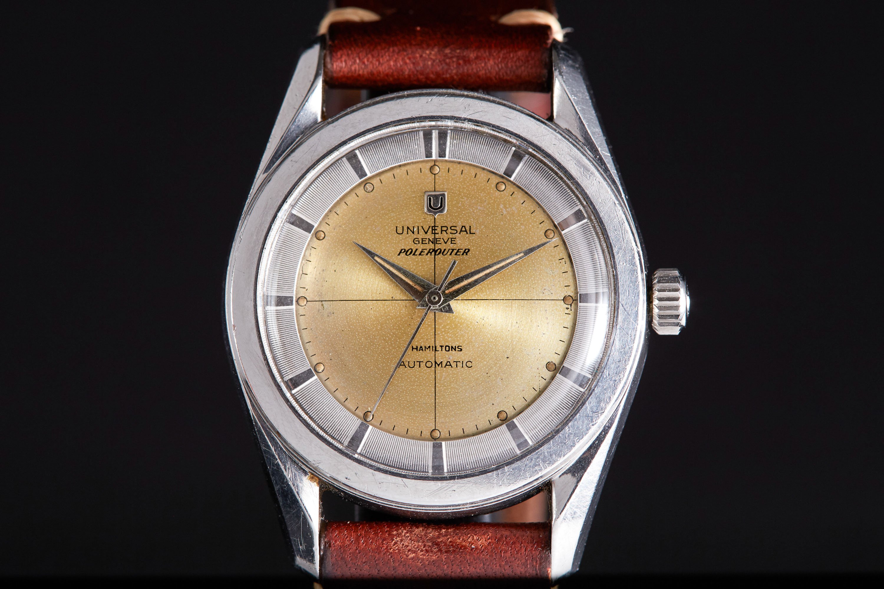

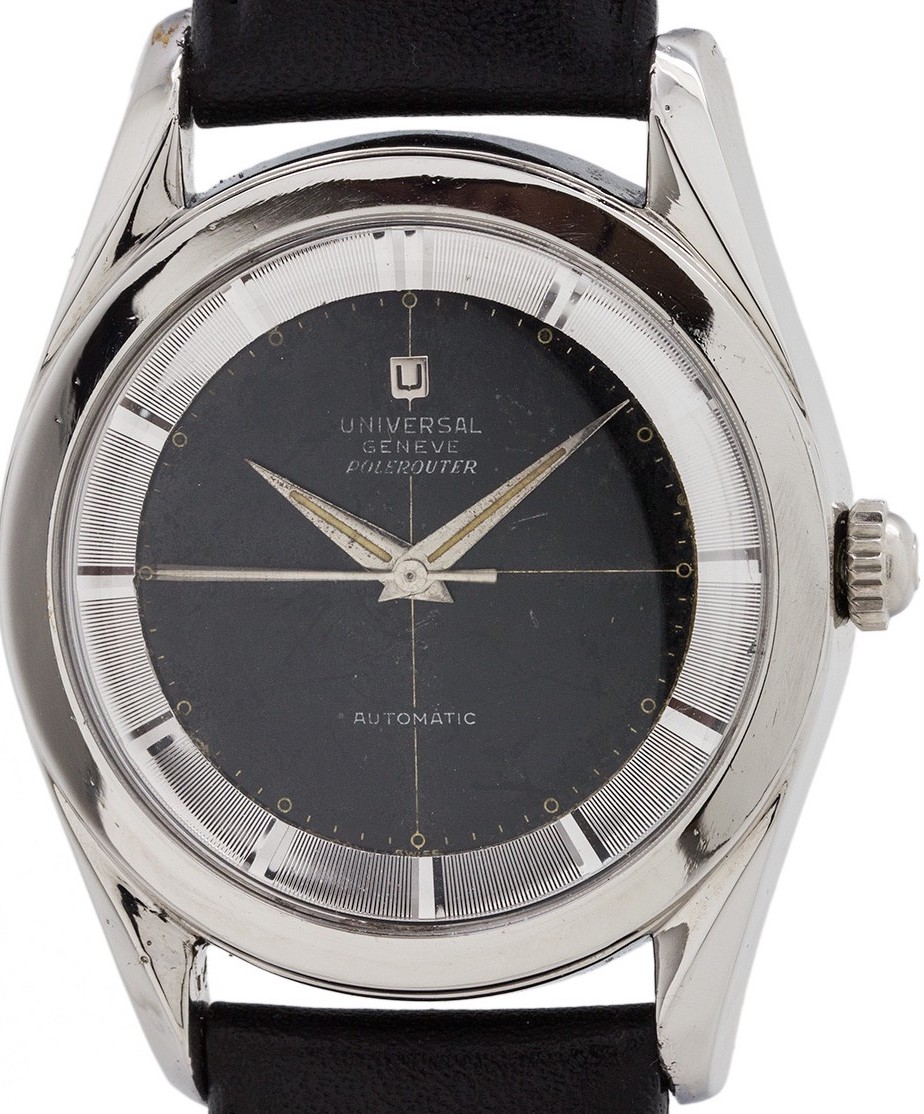

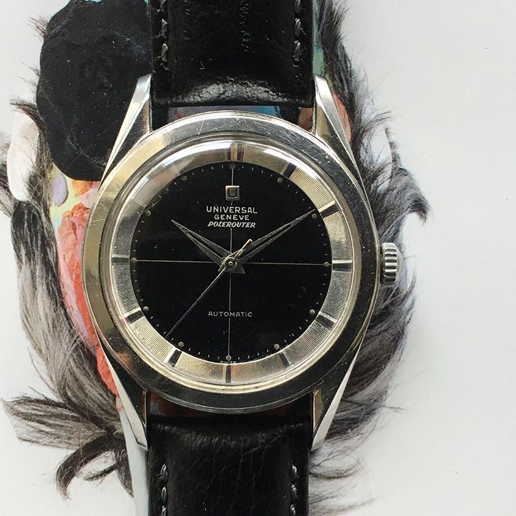

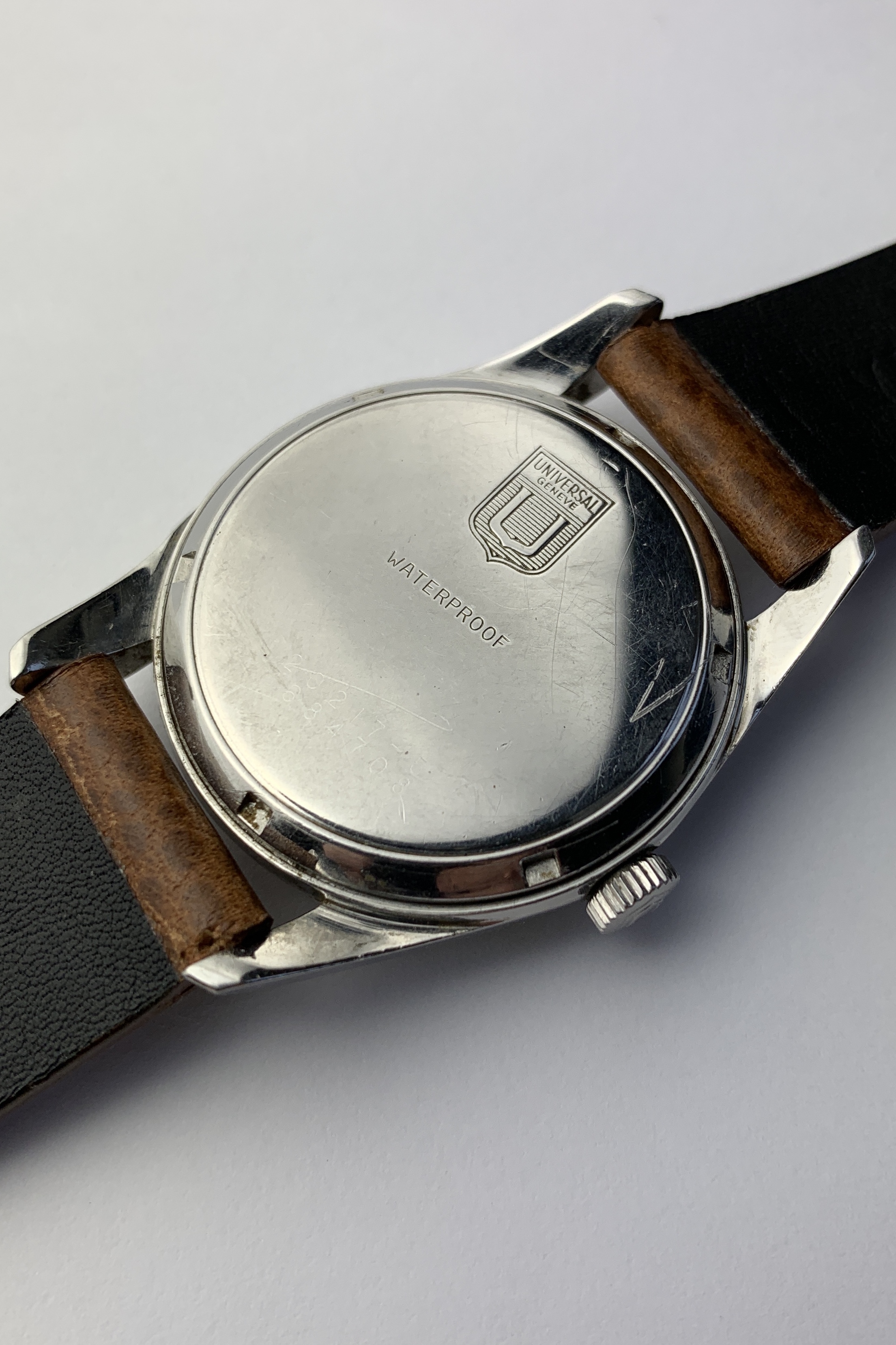

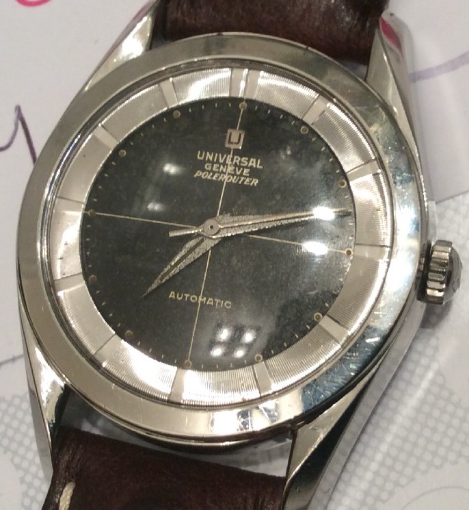

And this one sold at Watches of Knightsbridge in 2016. Serial number 1'691'318. Same crown as the other 2 examples.
411
1,076
But again, the stark difference between dial and hands lume raises doubts for me.
1,211
3,071
Fantastic.
As much as I would love this to be another potentially 'transitional' example, it's actually exactly the same watch that sold at WoK that I posted above.
