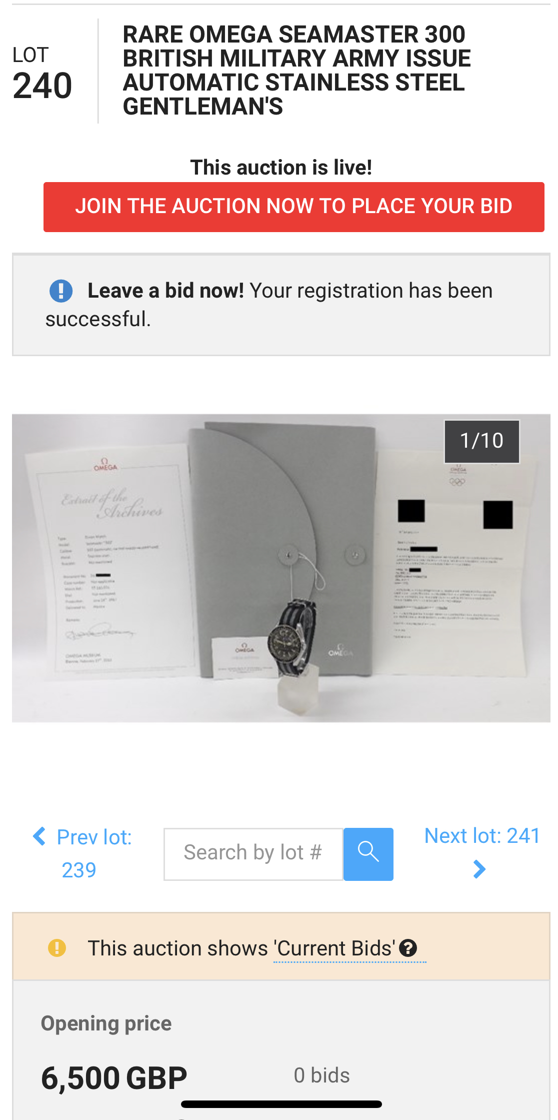

Hi guys,
I was looking at this 165.024 prior to the auction and at least to my eyes it felt a bit “off”. The auction house states it as a “British Military Army Issue”, but i’m not buying the provenance.

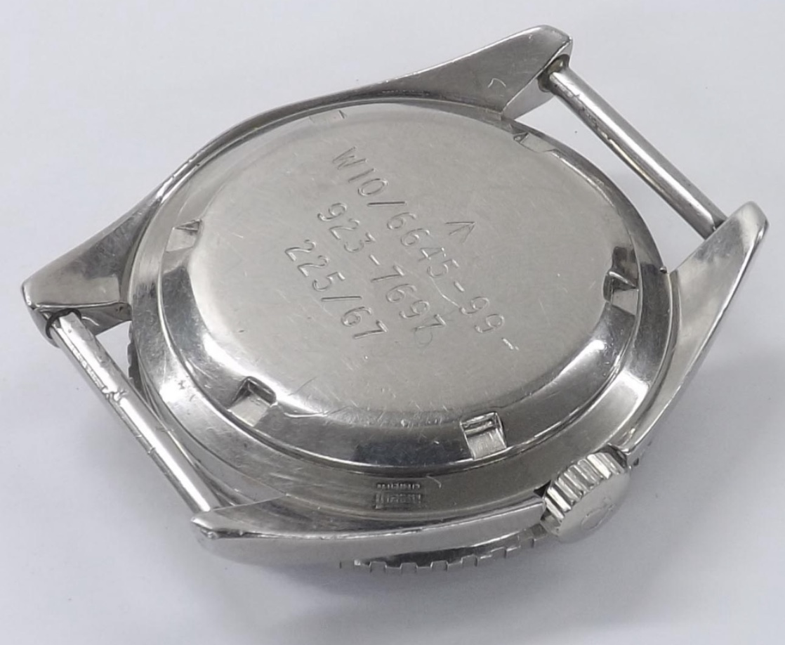

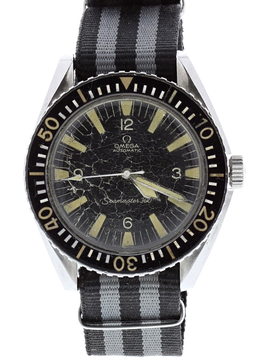

The watch is with sword hands and this type of bezel is to young for a correct Military with a W10 case back?
So my opinion is that this is just a “run of the mill” Seamaster 300 that has had a W10 case back fitted to it, am I right?

Sceptical. It seems strange that if it has the correct caseback, the 'T' emblem denoting British military is not on the dial. Bezel is also very different from the early military SM300s (from which the dial T is absent).

This is my point exactly, these Military Issue watches look like a mine field and now with prices up it’s not that difficult to weld / solder solid rods on a watch and call it Military in order to try to get an premium on it. The caseback looks legit in this picture though. At least the watch should have been shipped to UK, and not to Mexico??

The case and case back look genuine enough after a quick inspection, however this is obviously not a correct issued watch having been delivered to Mexico! Delivery to the U.K. would be a minimum for the extract, they will often state that it was military issued as well.

Legit: Case with fixed bars, engraving, no A/ matches to the NAIAD crown, dial, hands and bezel are all from 1967
Not so good but could still be legit: missing circled T (quite common for a W10 SM300)
Not legit: movement delivered to Mexico, although the S/N is in the correct range for a W10
