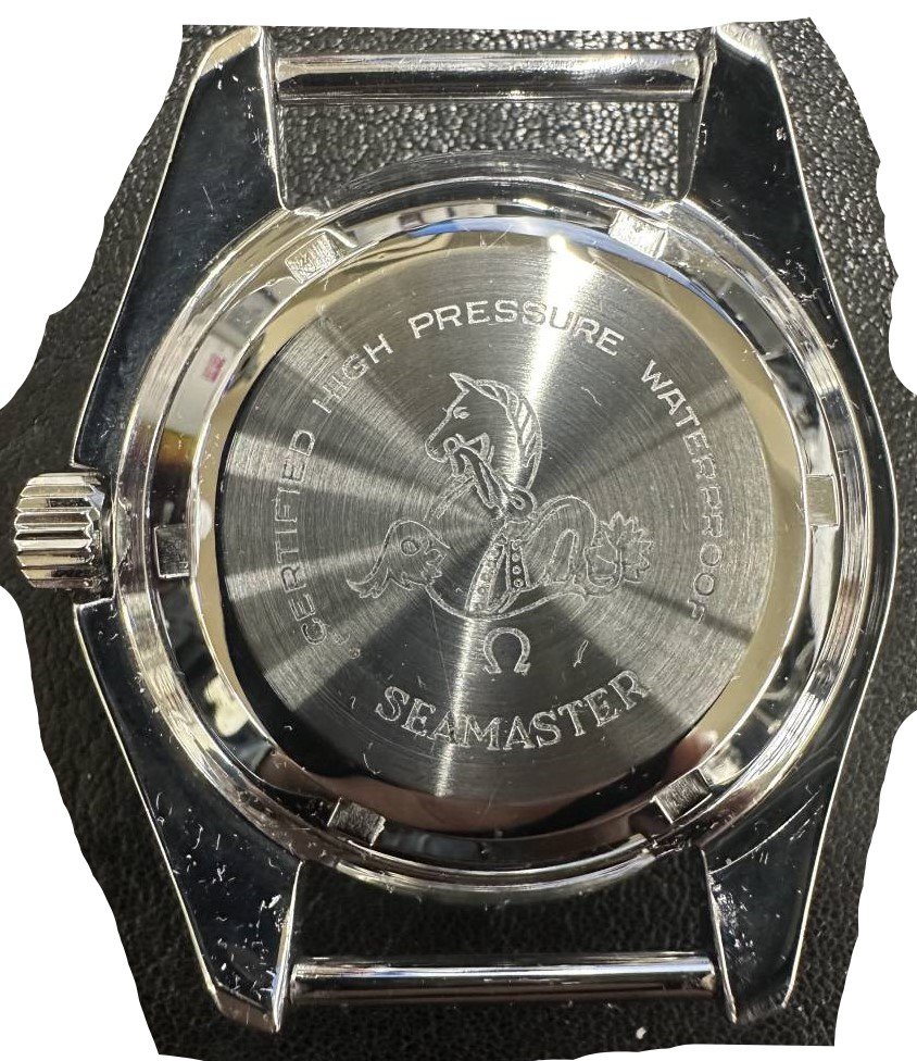

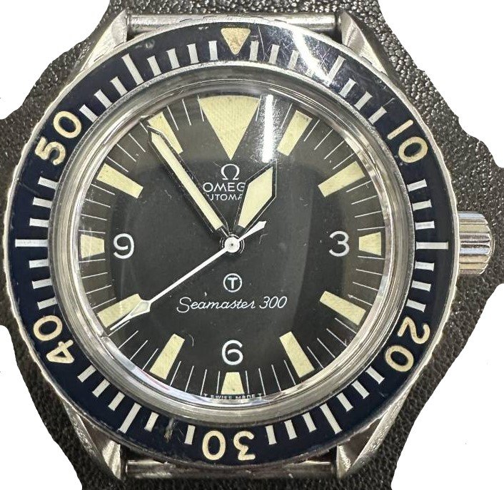

The movement on this 'Omega Seamaster 300 Military SAS British - Big Triangle' apparently doesn't match the case, but the circle T tritium mark looks really odd.. It looks like a completely different color to the arabics, and overall the Watch looks a bit weird.. Am I completely wrong? Is this actually a genuine watch?
https://www.chrono24.co.uk/omega/om...tish-royal-army---big-tiangle--id12997113.htm
I don’t like much about it.
Dial printing font looks all wrong, engraving (last line) should be off centre, not centred. A 67 dial should also be a 12 dial not a BT.
