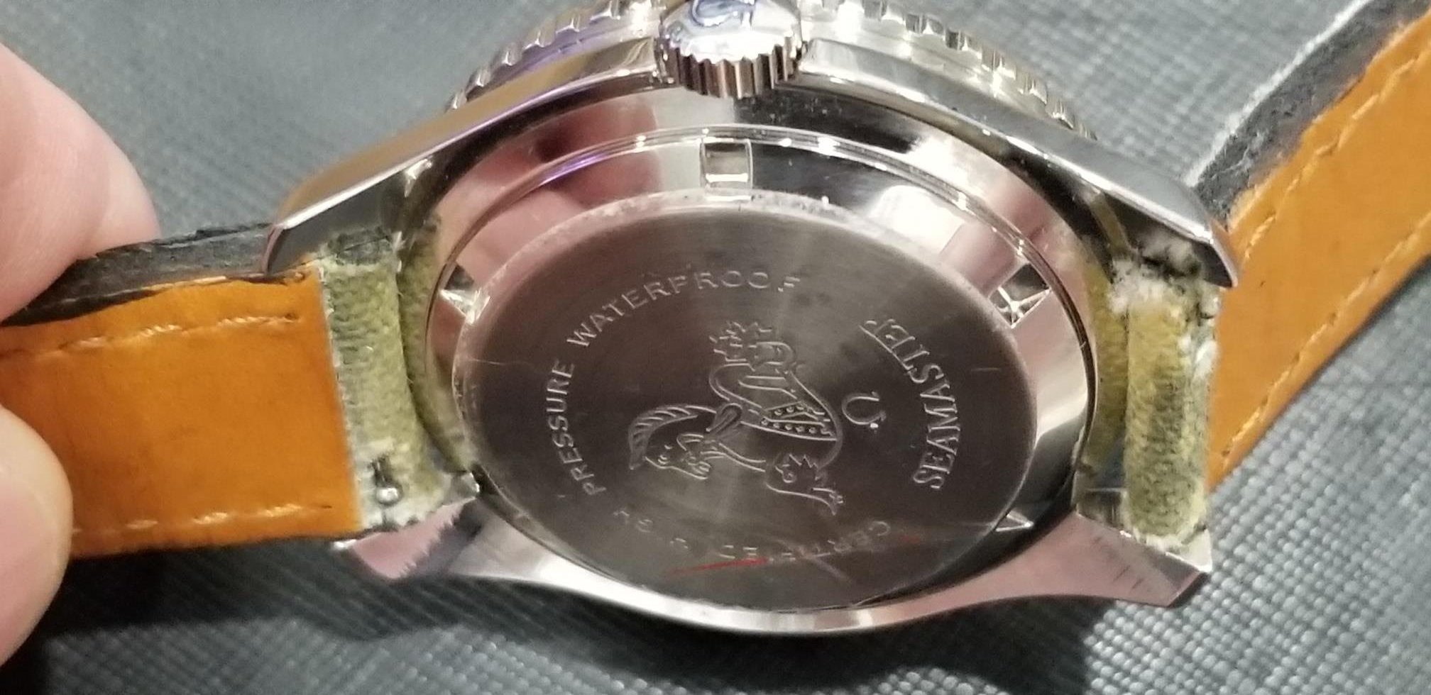

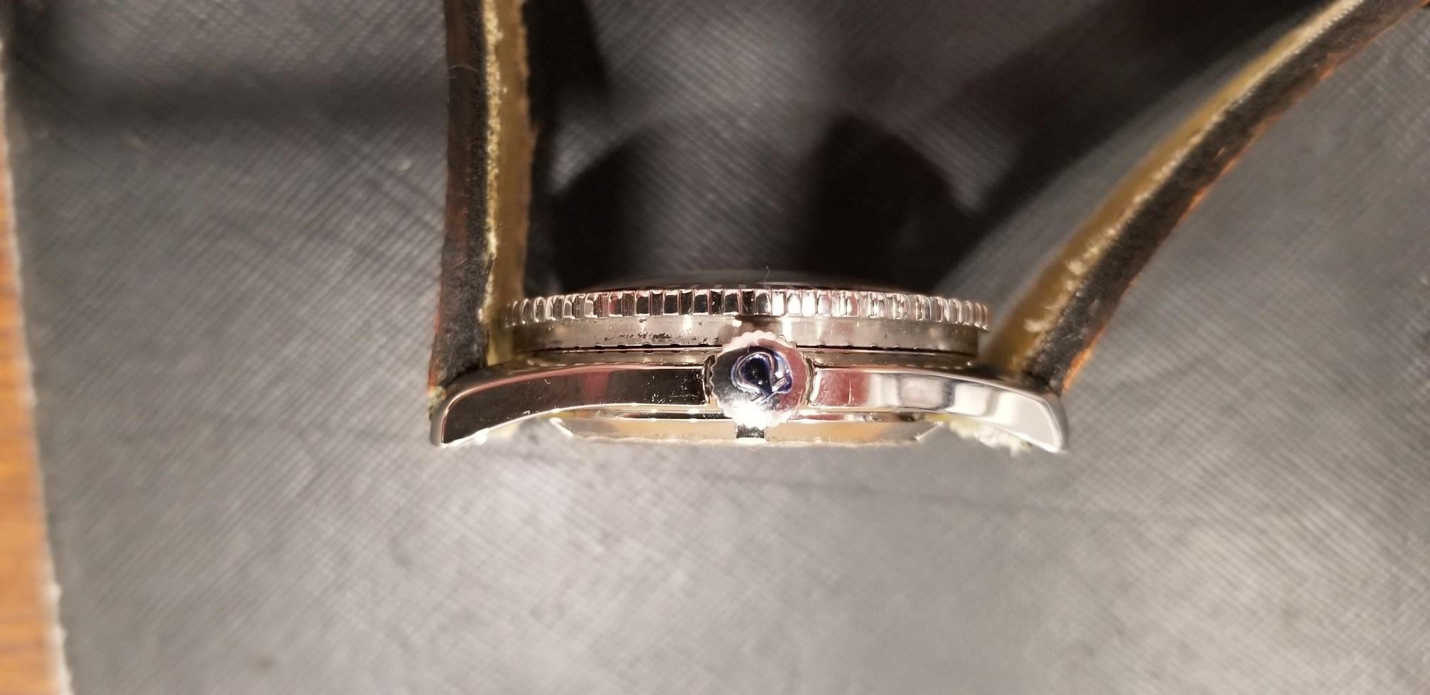

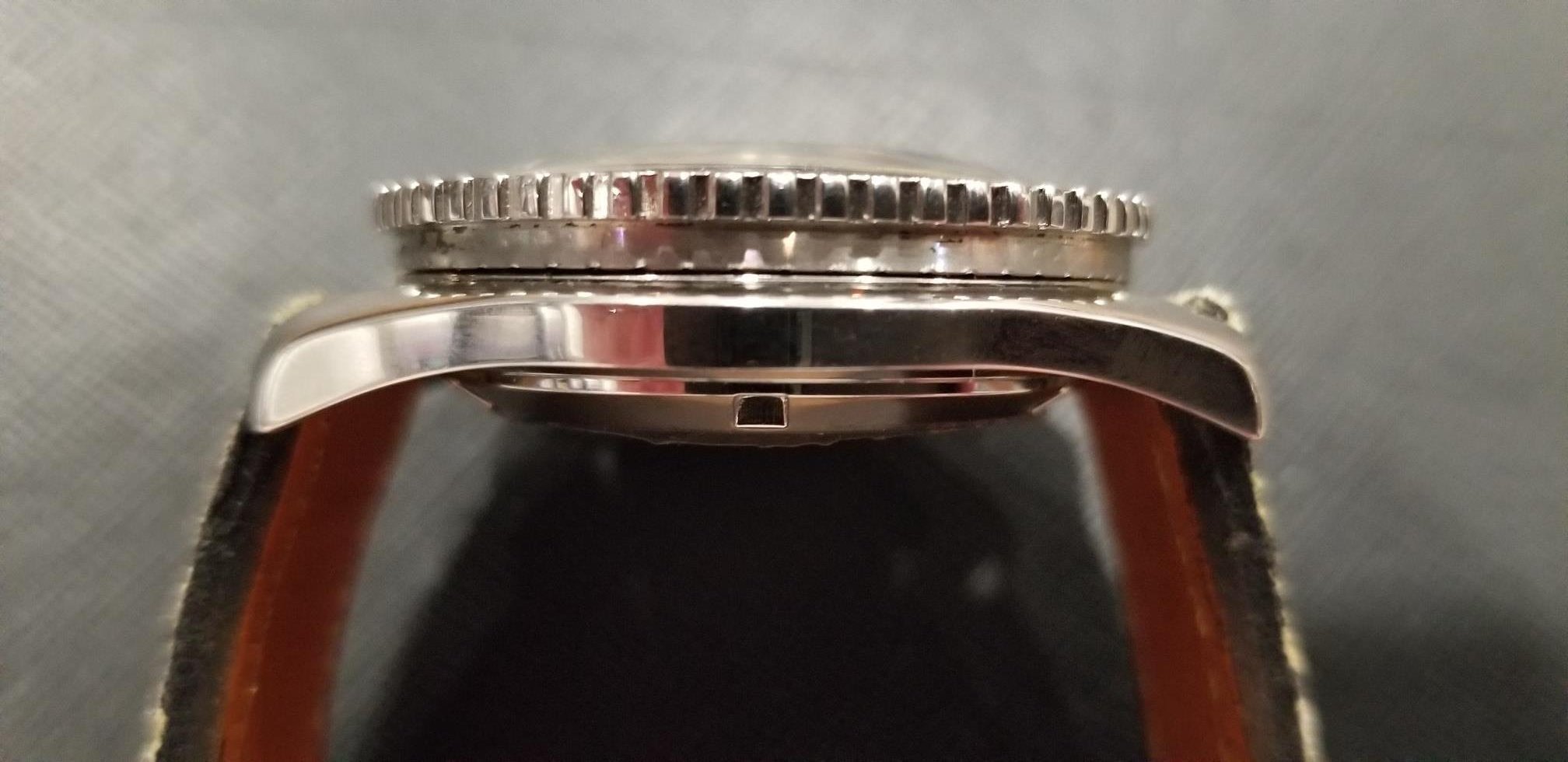

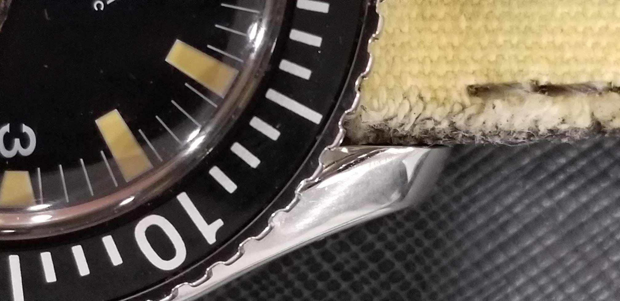

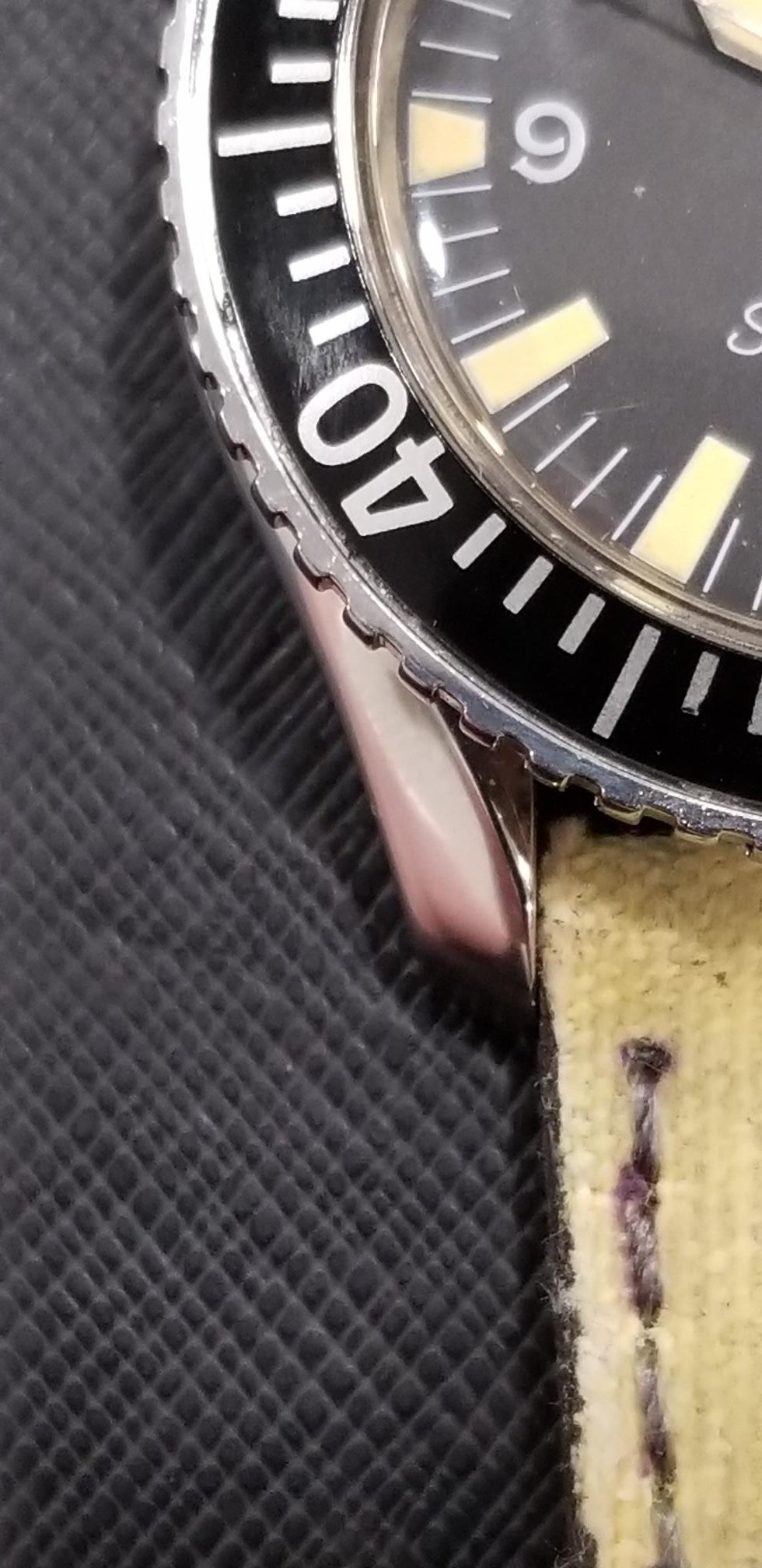

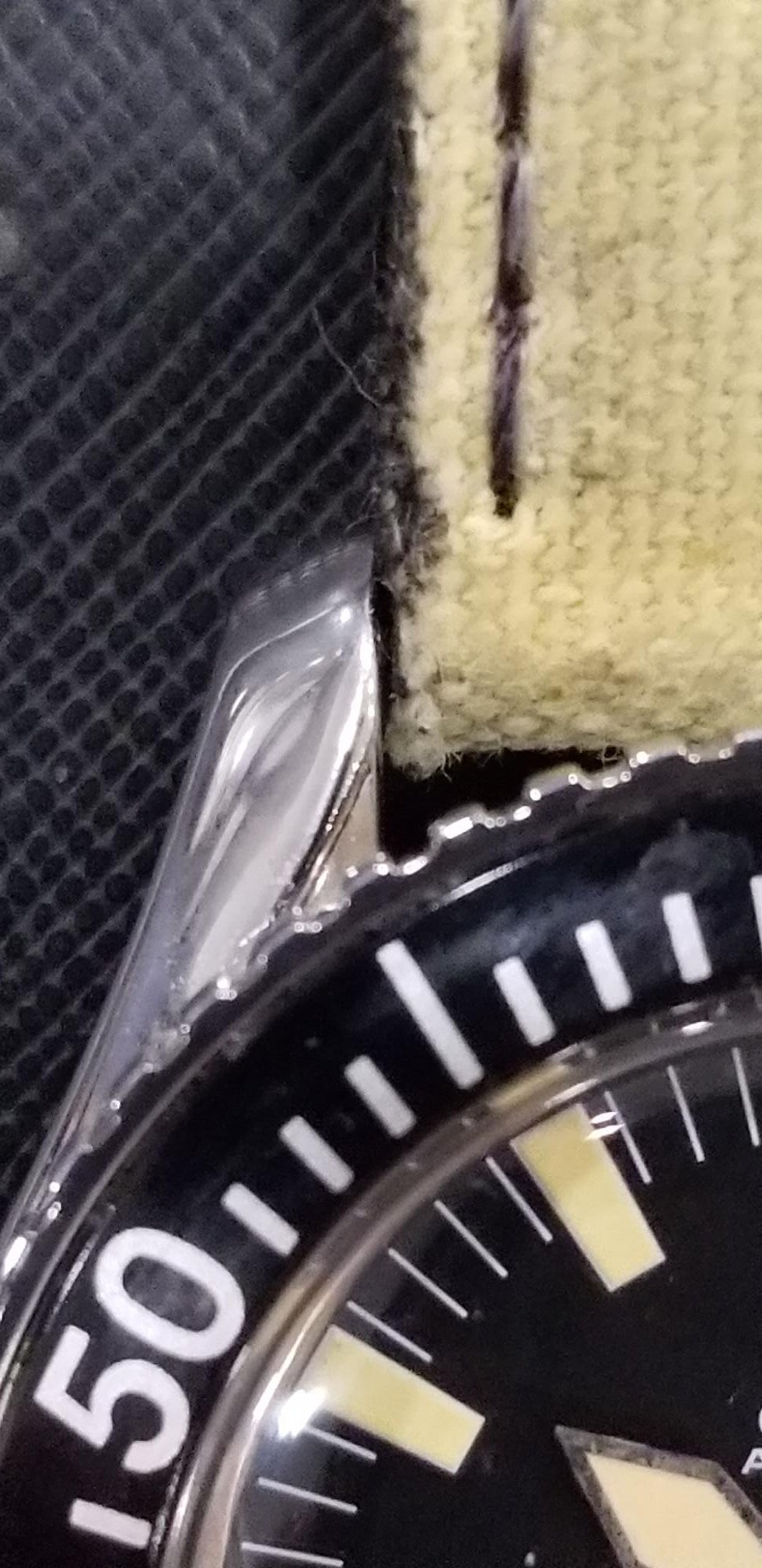

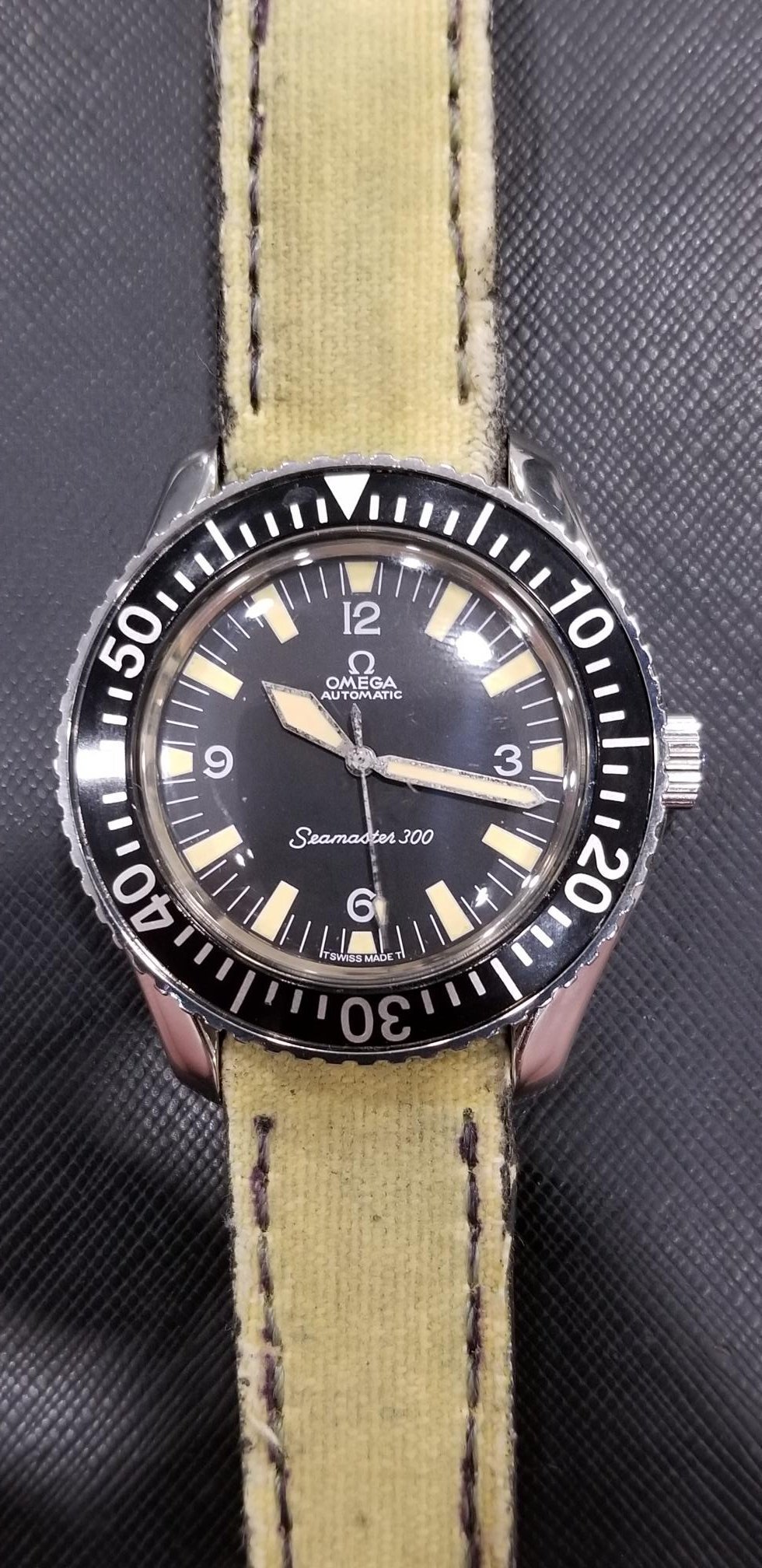

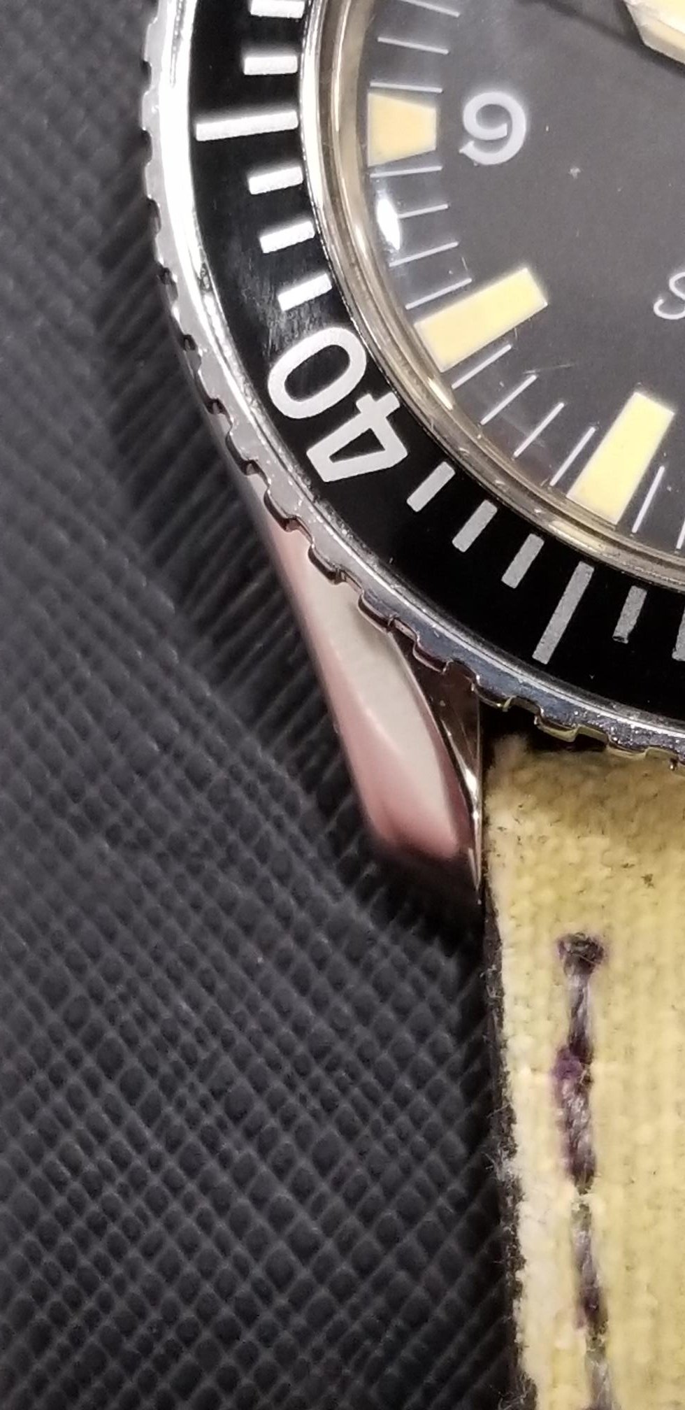

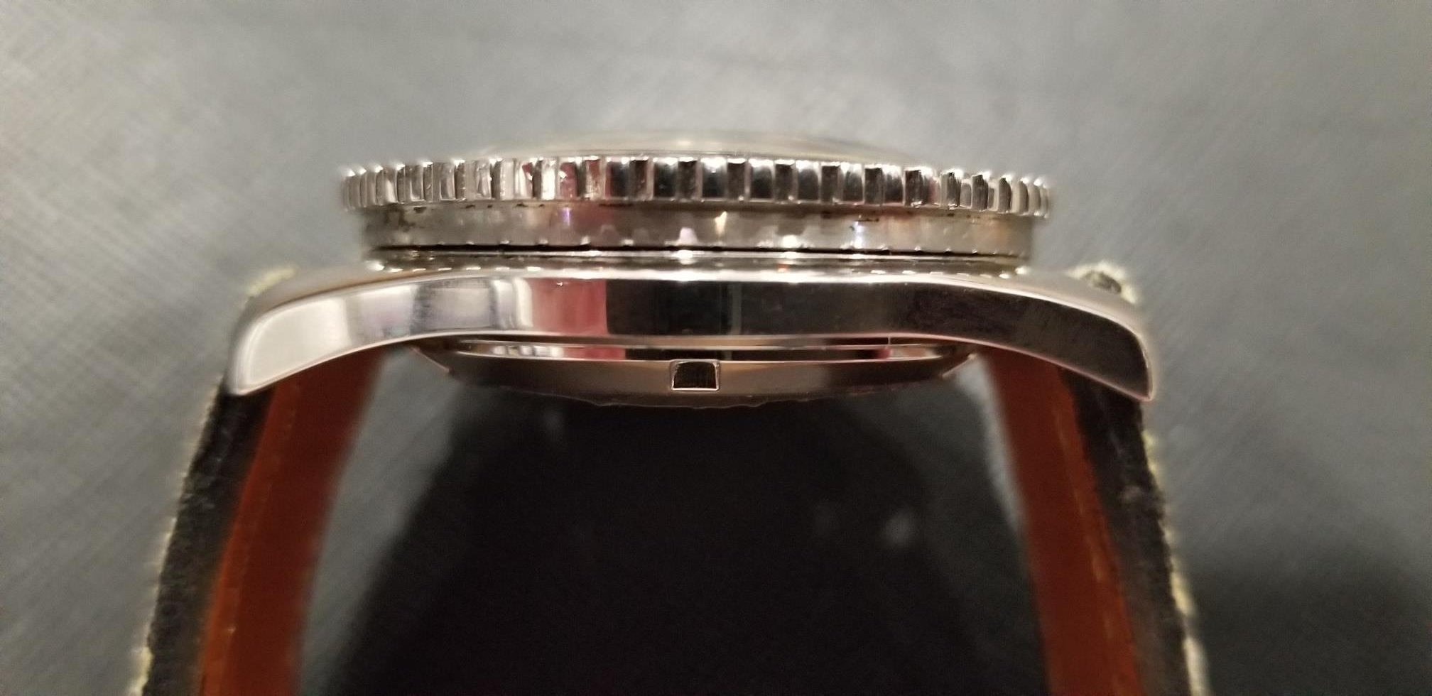

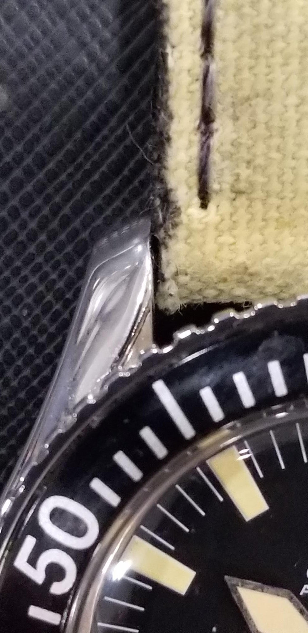

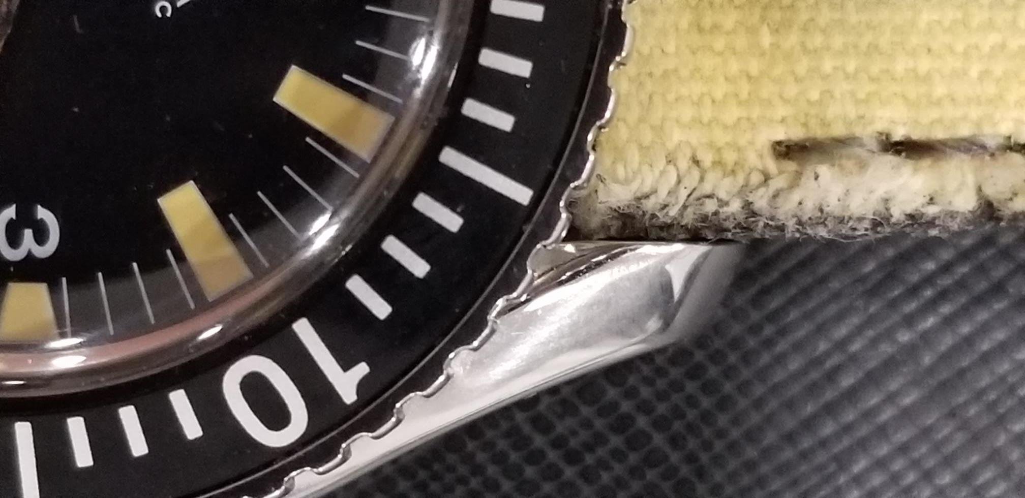

This watch was offered to me as a WatchCo Seamaster 165.024. I thought it would be a nice daily wearer for winter. Upon arrival, it seems that the lugs are too thin and the bevel angles on the lugs is not correct. Do you think this is a WatchCo service case or a total fake case? I was also told that the bezel insert is a service insert, but it has no lume so I think it is also fake. Any opinions will be appreciated. Thank you in advance for your help!

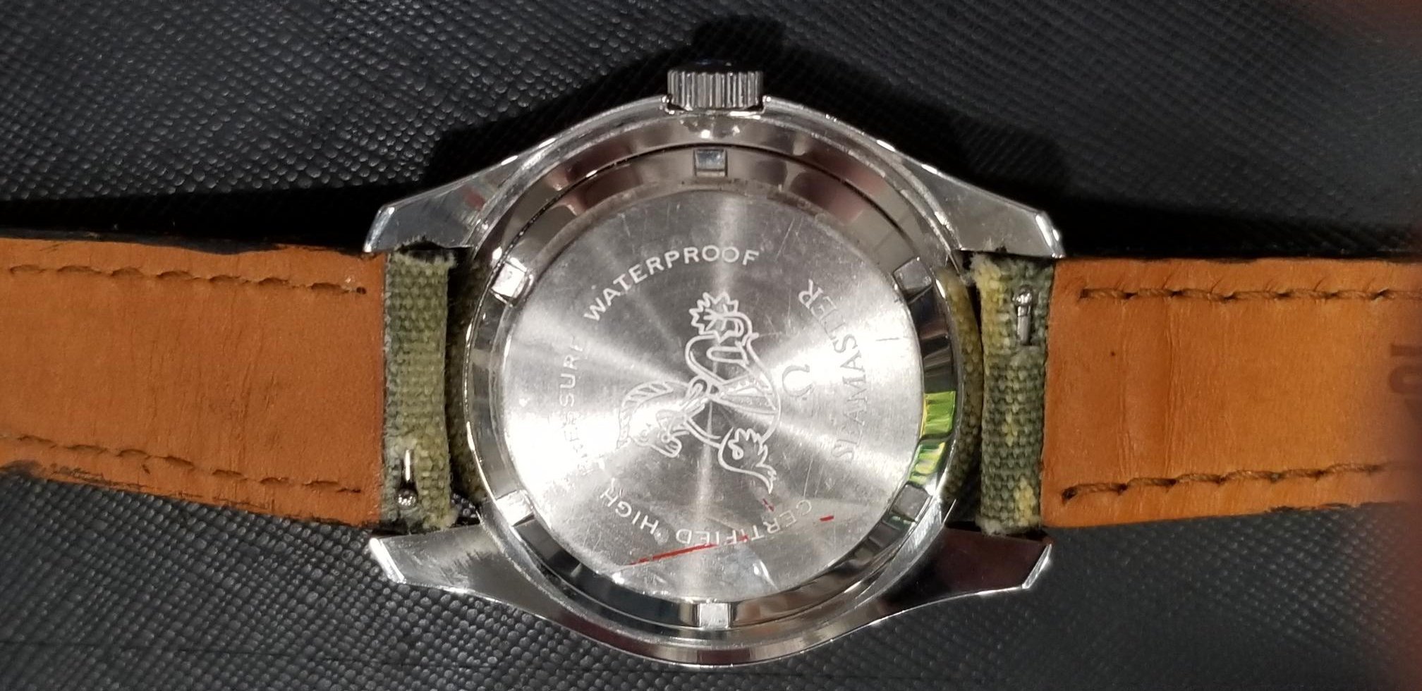

The case is IMO heavyly polished or total fake. The dial is a "nearly good" fake . Lets see the case-back 😁

It’s all fake I’m afraid, with the exception of the movement which will be genuine.
These ‘newer’ fakes have really taken off lately. I saw on Instagram a fairly well known collector recently showing his genuine SM300 along with his friends fake sm300 as a “nice pair of 300’s”. Seems neither we’re aware one was fake and looking at the comments, no one else did
Have you actually bought this one? If so get it returned asap

Watchco type modern put togethers always use SL lume dials so never have T marks. If you see a supposed ‘Watchco’ with dial Ts then you need to inspect the dial very closely since something is amiss. These are a minefield and I think all but the most avid collector should avoid them unless you are prepared to throw money down the drain.

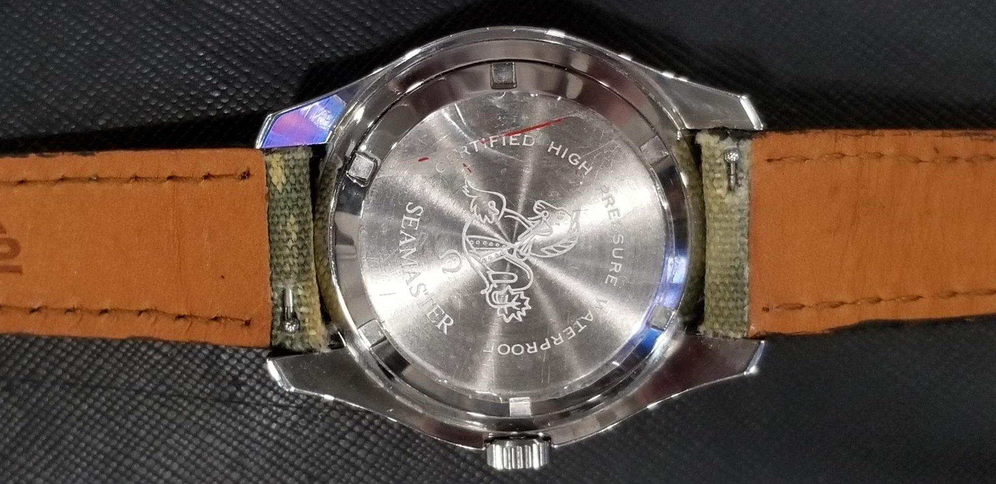

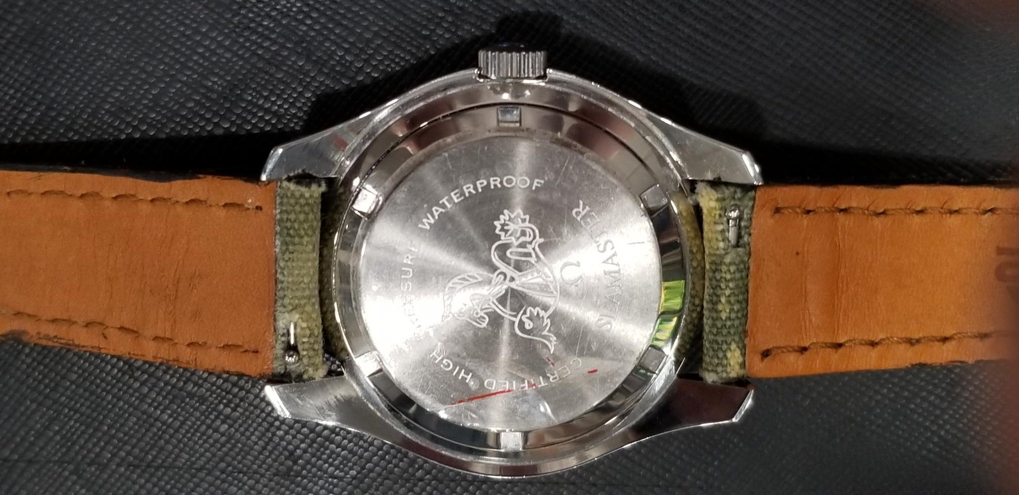

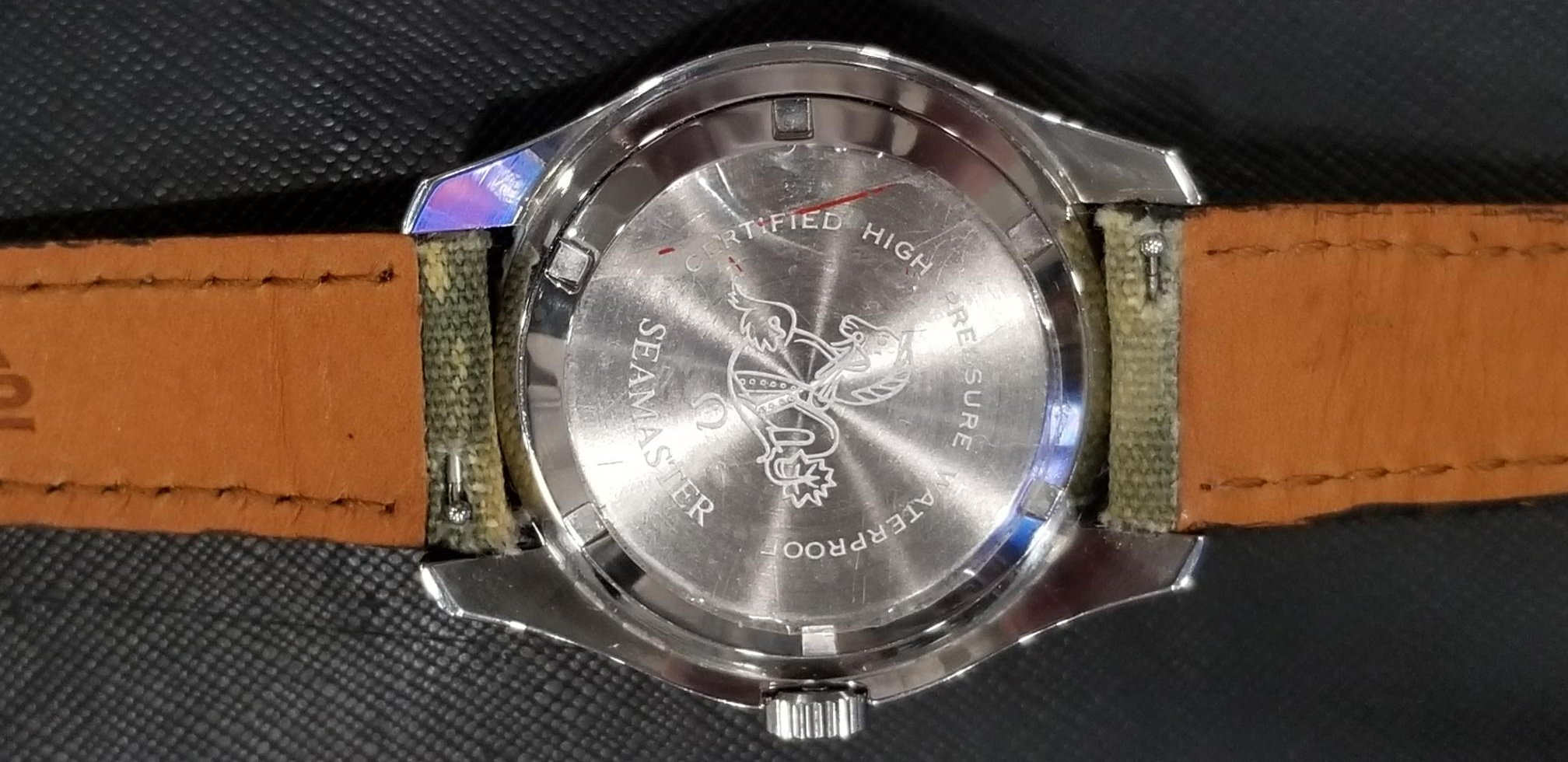

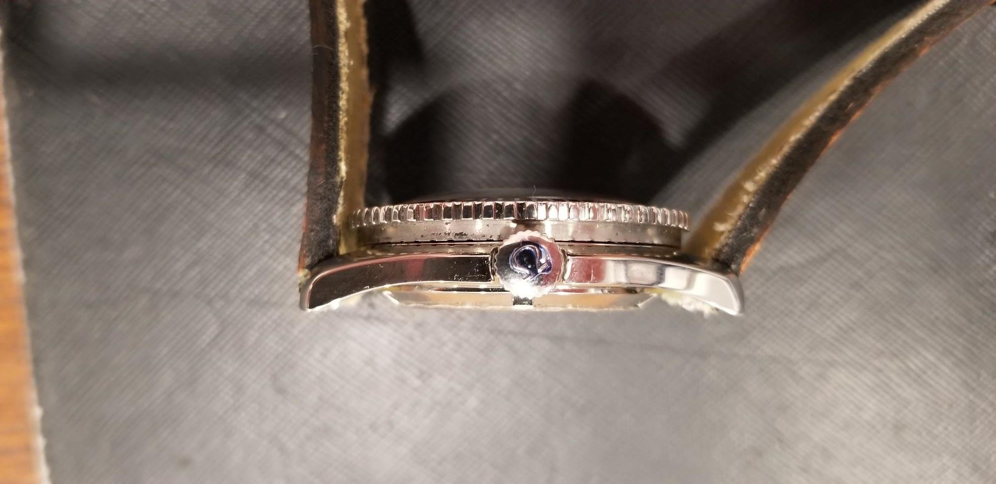

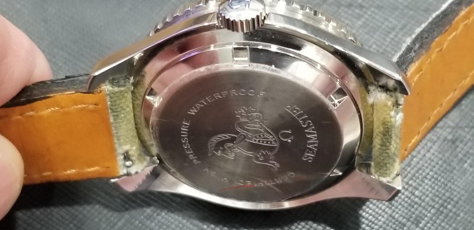

Thanks everyoe! Here are some back photos. It does not show signs of being over-polished, other than the bevel angles being wrong and the lugs seeming too thin. The back is pristine. The seller supposedly has sold a few of these over the years at NAWCC shows. My hope is that he is being honest and just accidently bought a fake thinking it was a modern WatchCo case, but perhaps I am being naive. He has offered to give me my money back, so I will return it Monday by FedEx. It took almost 3 weeks for it to arrive via USPS Registered Mail.

It won’t be over polished as it’s completely new. There are fake Seamaster 300’s that are almost vintage themselves now. This however, is the newest type of fake. Some unscrupulous sellers will try and scuff them up to make them appear worn and some simply sell them as they bought them - brand new.
Unfortunately I do think some people have bought these believing them to be genuine, if however a seller accepts a return without question, it suggests they know precisely what they are, otherwise they would question the ‘fake’ label and at least try and maintain that it’s original.
