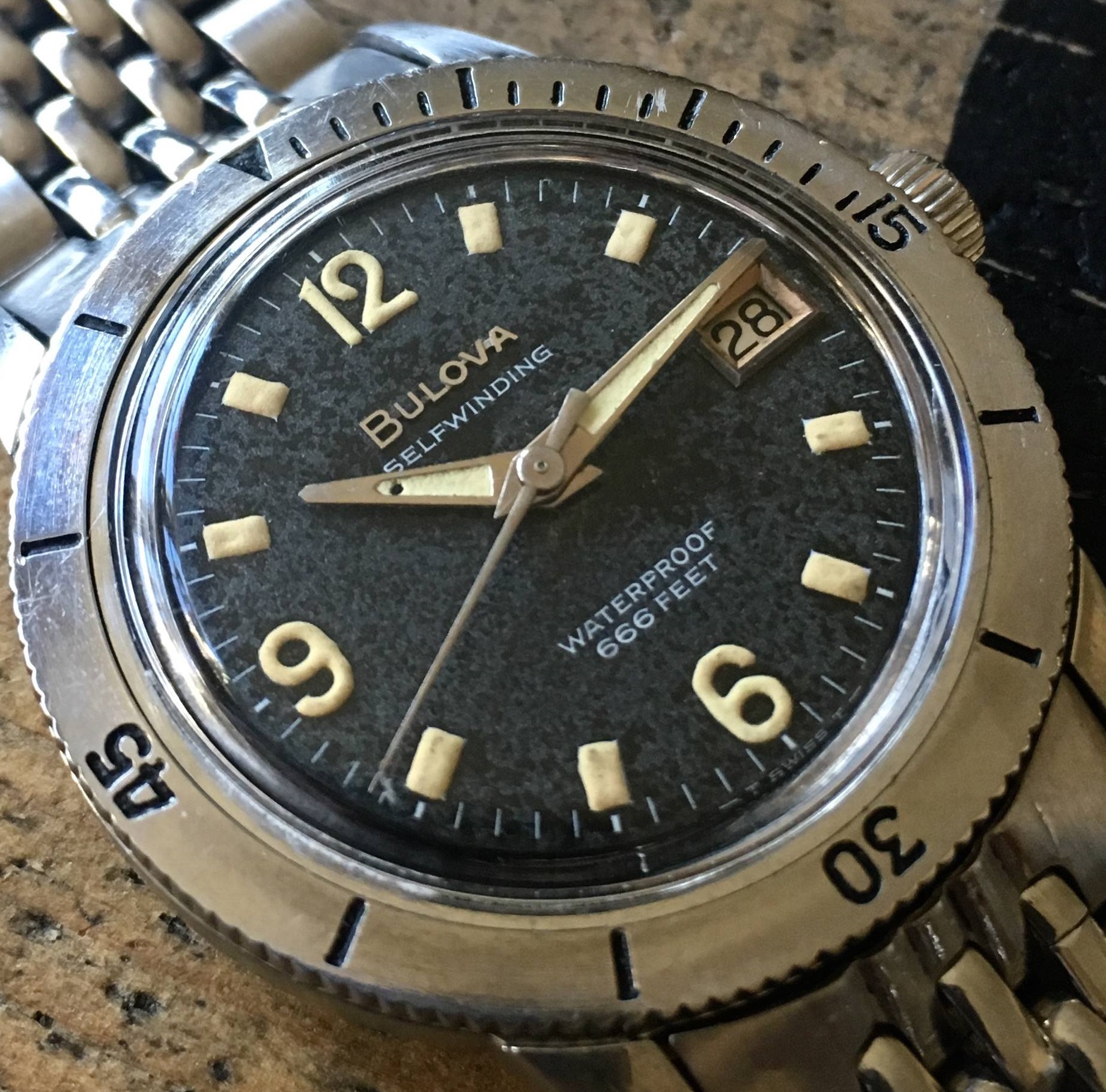

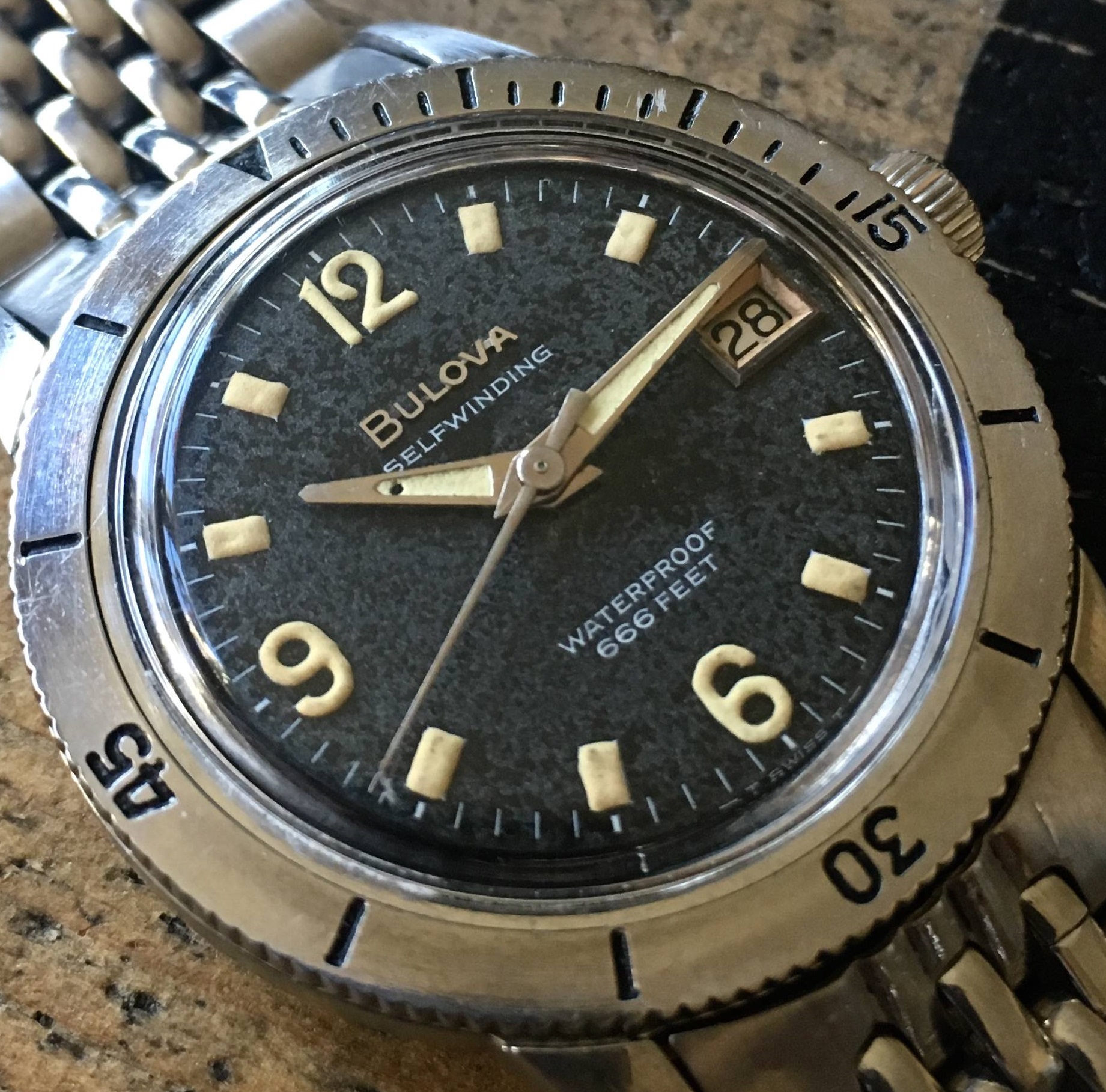

Personally, I love the colour of yellow... popping out from behind a dial. I would definitely prefer a re-lumed Watchco vs a proper clinically white version, but that's just me.
Love yellow lume on my vintage watches, like this devil diver:

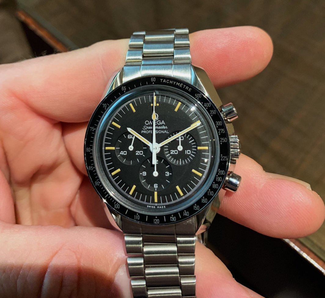

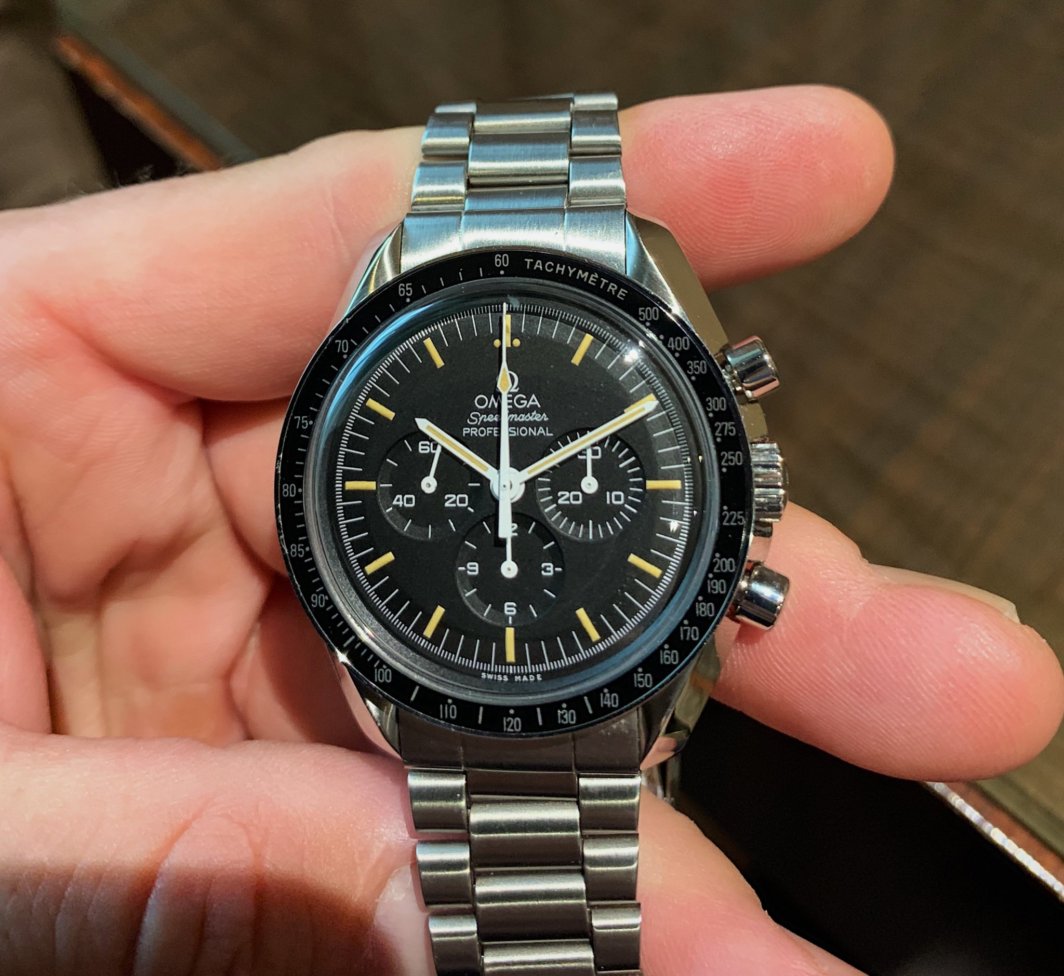

Love it on this beautifully re-lumed modern Speedy dial:

IMHO that relumed image you showed looks so over done. Back it off at least 50% and maybe there’s something there. But again, I wouldn’t bother and it won’t match the bezel or dial.

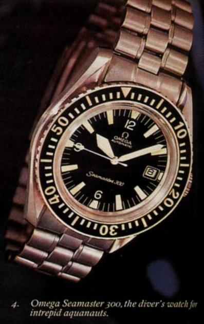

I’m fairly certain vintage ones, when new, did not have white lume (based on vintage adverts, it looks the same colors as Speedies of that era, so a canary/off-yellow). As such, I would most certainly relume it as the stark whiteness of the luminova dials are a modern thing. But get the bezel done too should you go this route...the bezel marks at every 5 minutes were colored to match the dial, as can be clearly seen here...
From what I could understand the bezel is tricky to relume. I believe that the relume is basically just a paint over of the superluminova, as it is challenging to scrape it off the dial. I don't think that approach would work on the bezel. Not saying it can't be done, but probably tricky and time consuming.

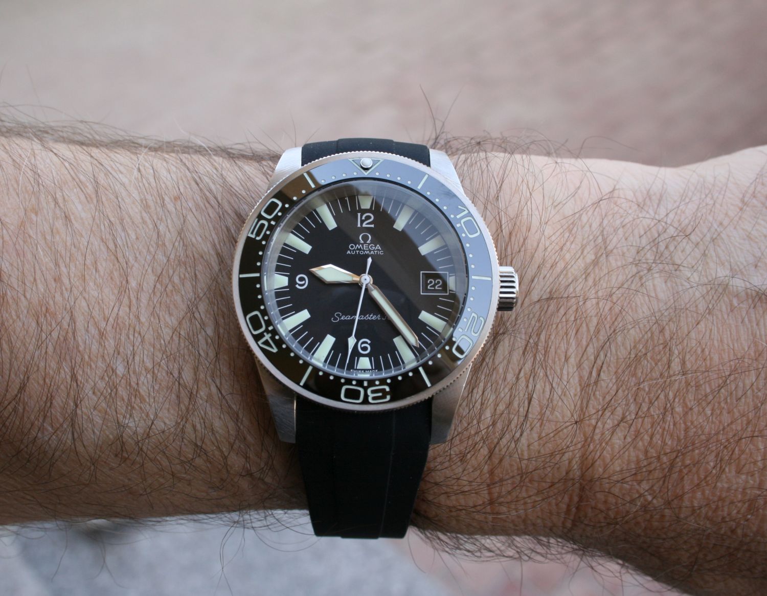

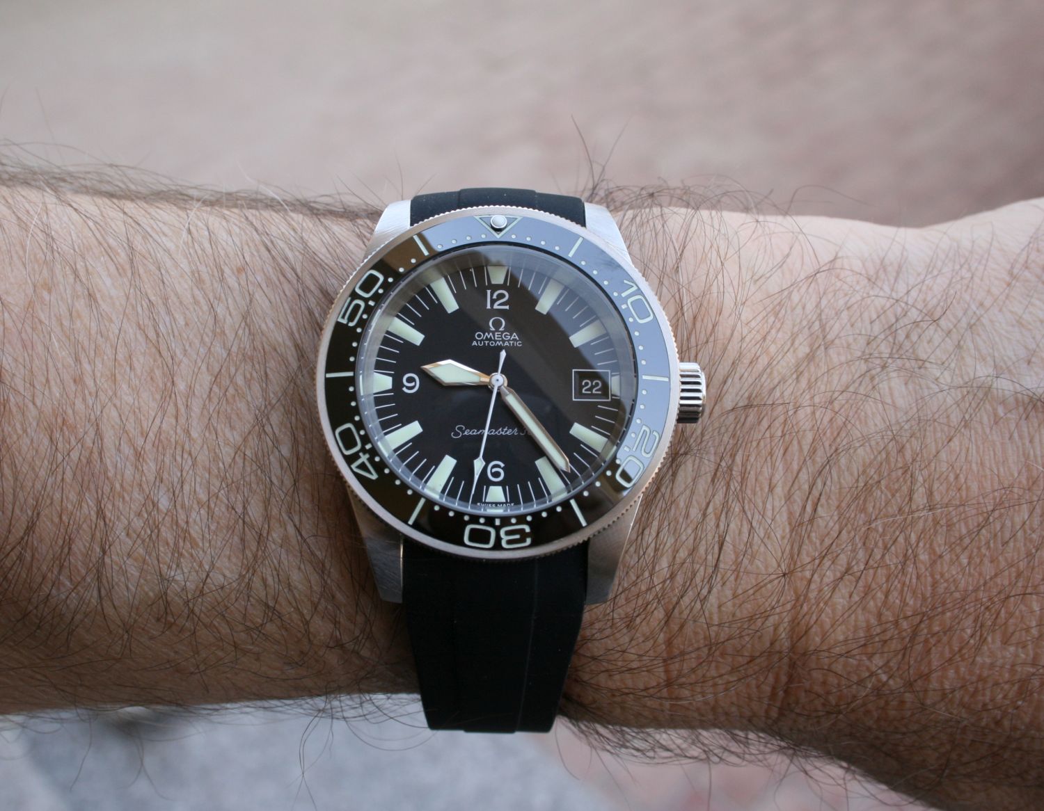

I created something a little different, modern and vintage...... a fun project
565 movement, genuine SM300 dial and hands and custom case. I already had a 552 Watchco and wanted to use my 565 movement and dial in something a little different, and way cheaper than buying a SM300 case 😁

Is that a CNC’d case? What bezel and crown?

The case is from a readily available watch which is popular with watch modders, it just happens to accept the 565 movement and dial, with the addition of a custom spacer to locate the movement. The stem lines up correctly and uses a 565 stem and the crown from the case. Its a fairly straight forward and cheap option for an everyday watch with 300m pressure rating (I've only tested it to 6 bar but that is more than enough for everyday use 😁). Its just a fun project while I was working on other modded watches 👍
