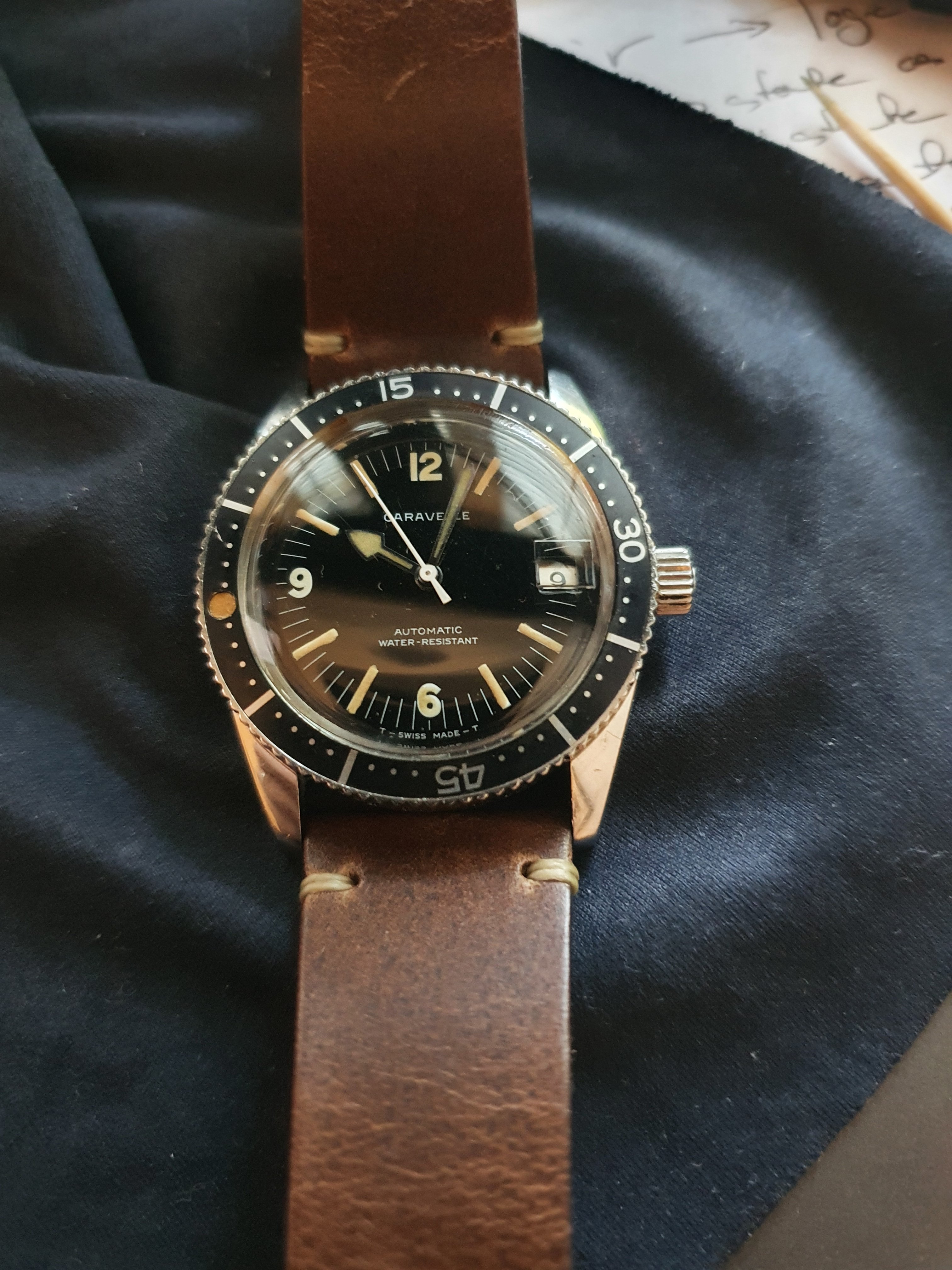

Caravelle Sea Hunter 665-1 w/ETA movement. If you're lucky, you can find one in decent shape for between 1-1.5k, but they're gaining value fast!

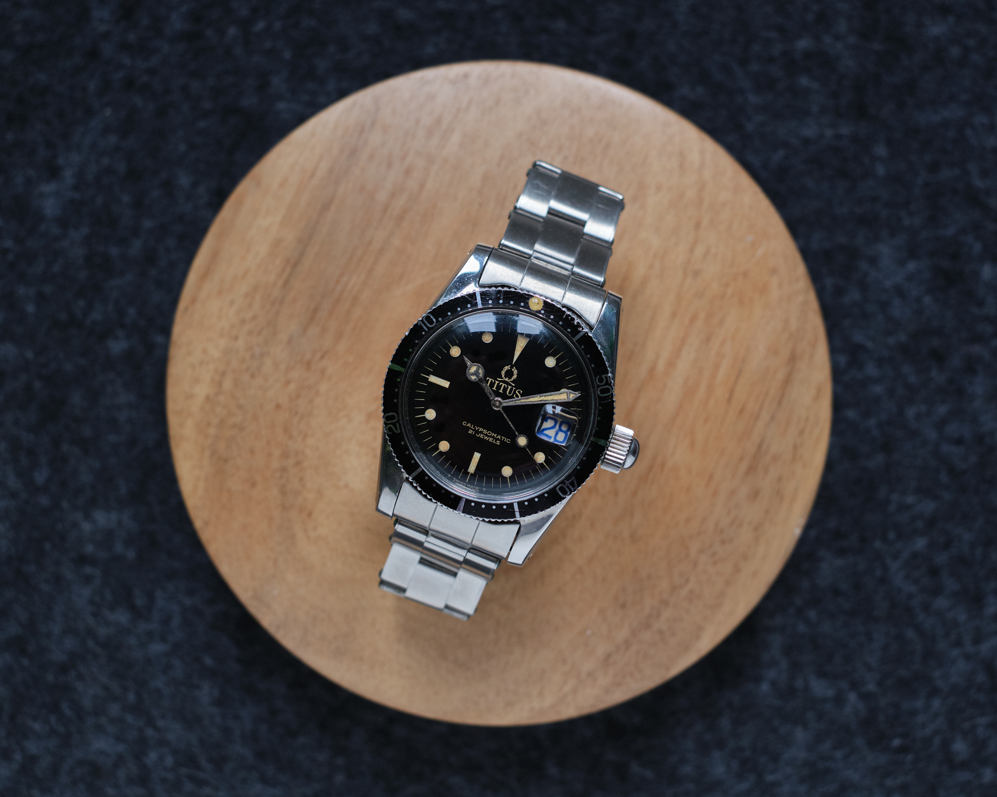

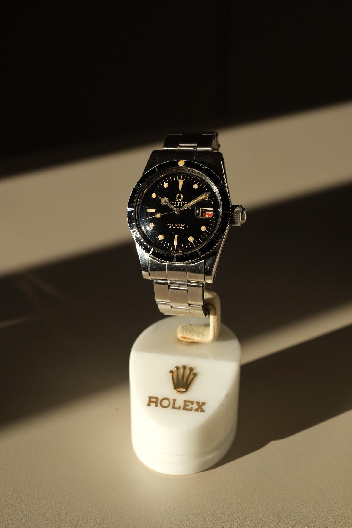

Do you see what’s special about this beautiful glossy lacquer with gilt print dial? - No “T Swiss Made T” designation. This is an early “Swiss Made“ only dial, meaning a Radium example, not often seen in the Ref. 7085. These dials were same as some 2nd Generation 5913 in very early 7085 production runs. Titus’s production of the two overlapped and they also likely used left over parts before using newer parts, creating these early "transitional" models. - Rare & early 1960’s “Transitional” Titus Calypsomatic Ref 7085 “Big Crown” (3rd execution) - ETA 2472.
Lovely Caravelle, and in great shape too! But, not a Calypsomatic Case at 35mm. Calypsomatic and Sky-Divers are 37.5mm.

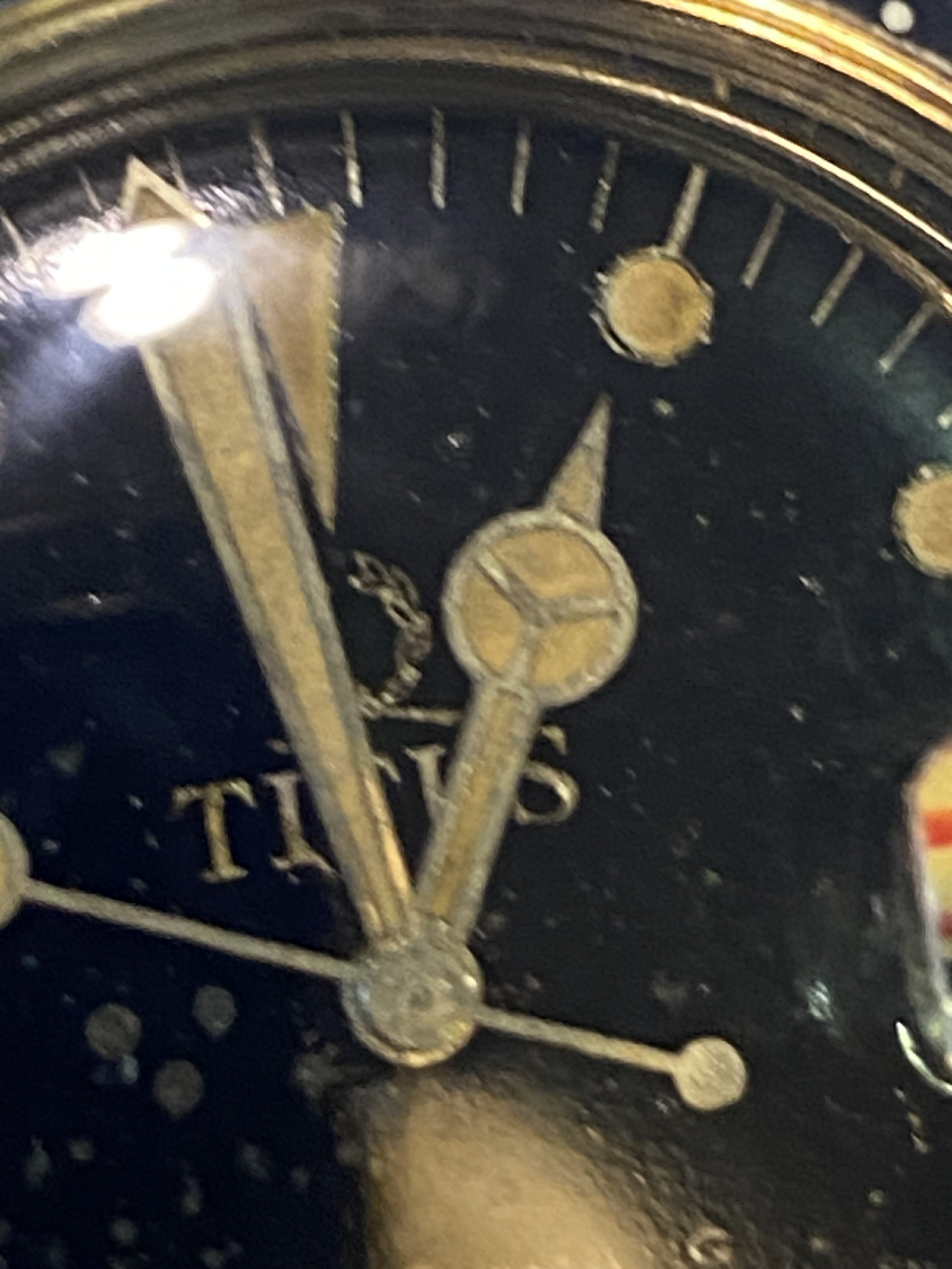

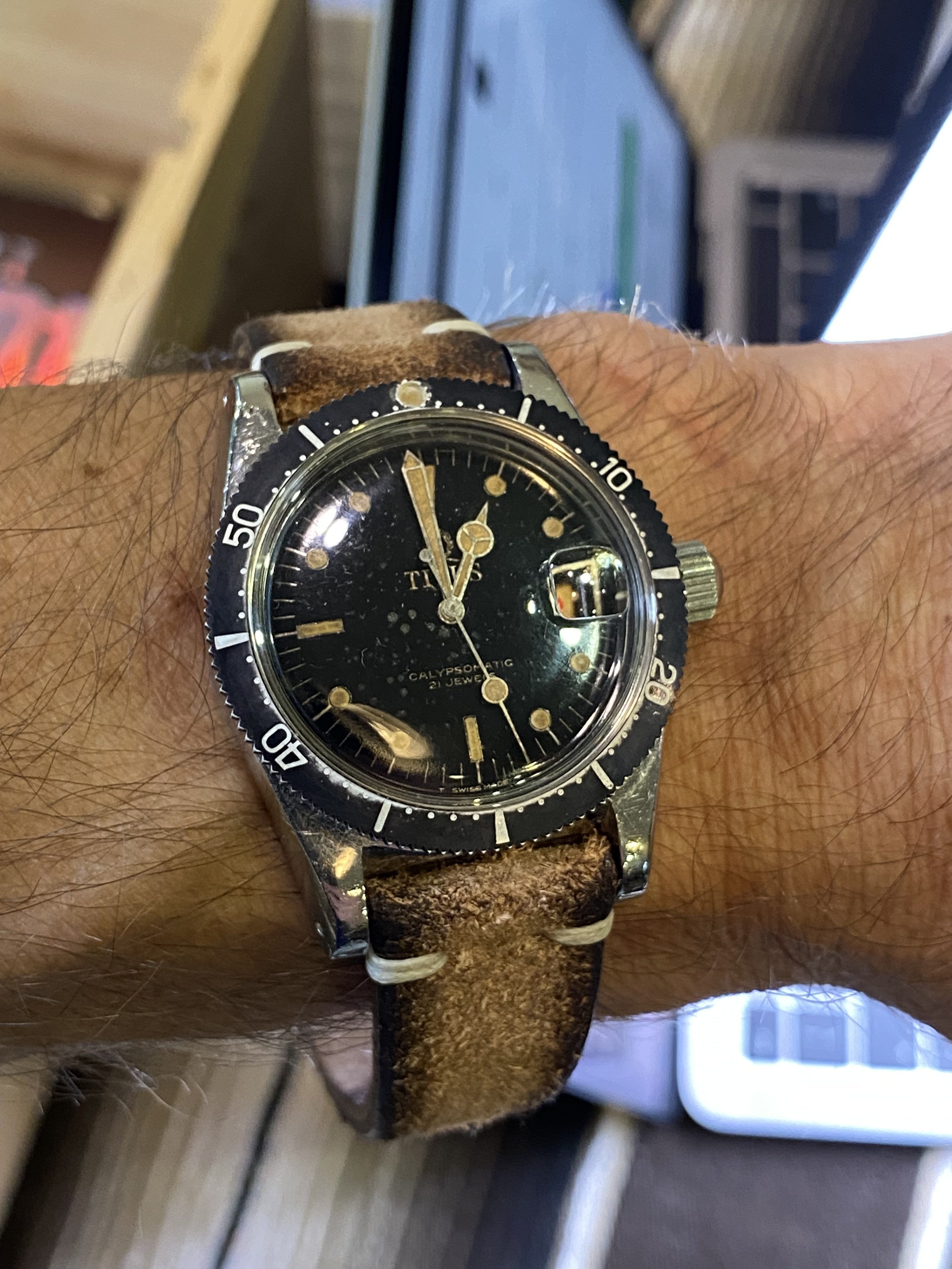

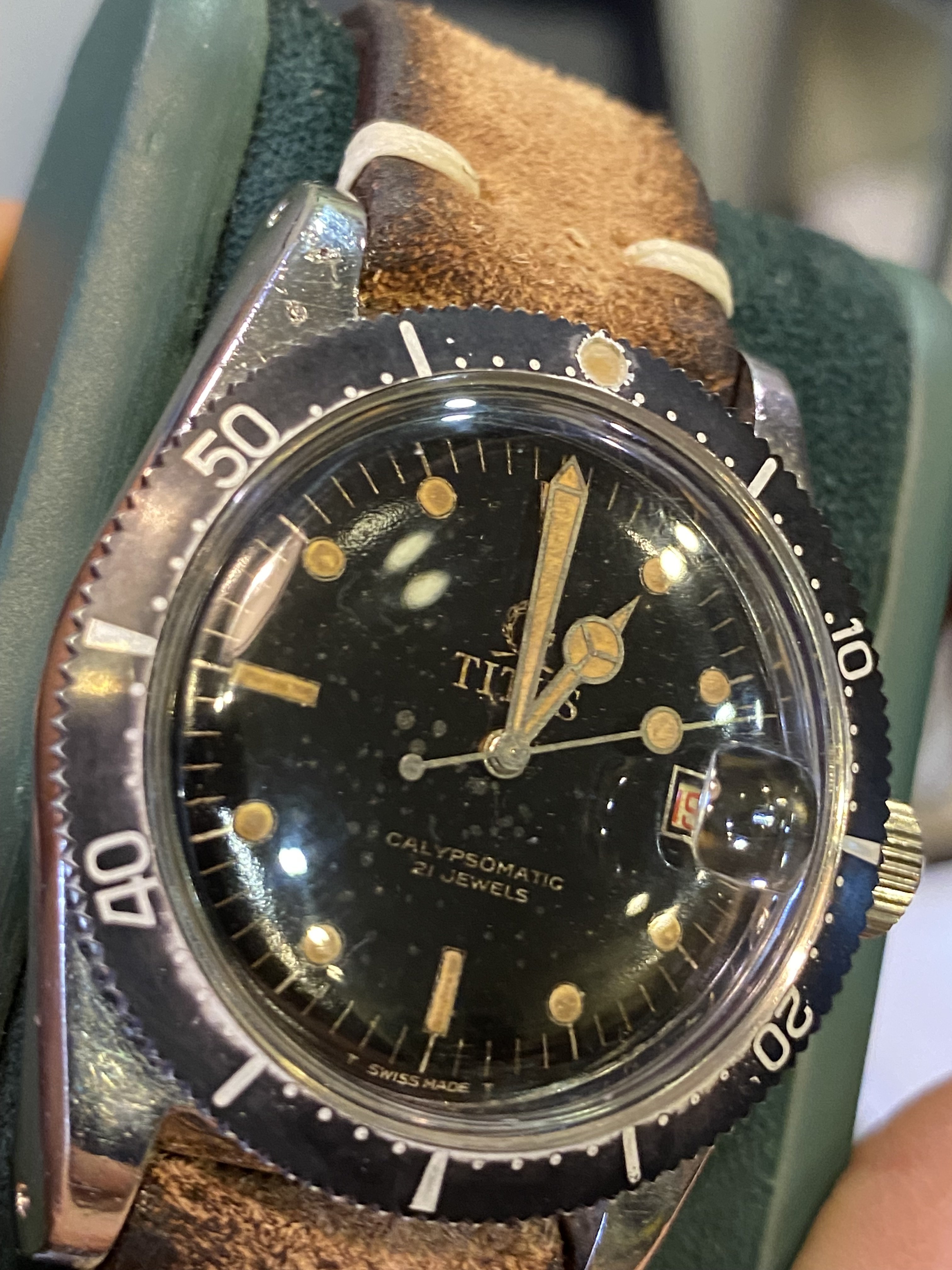

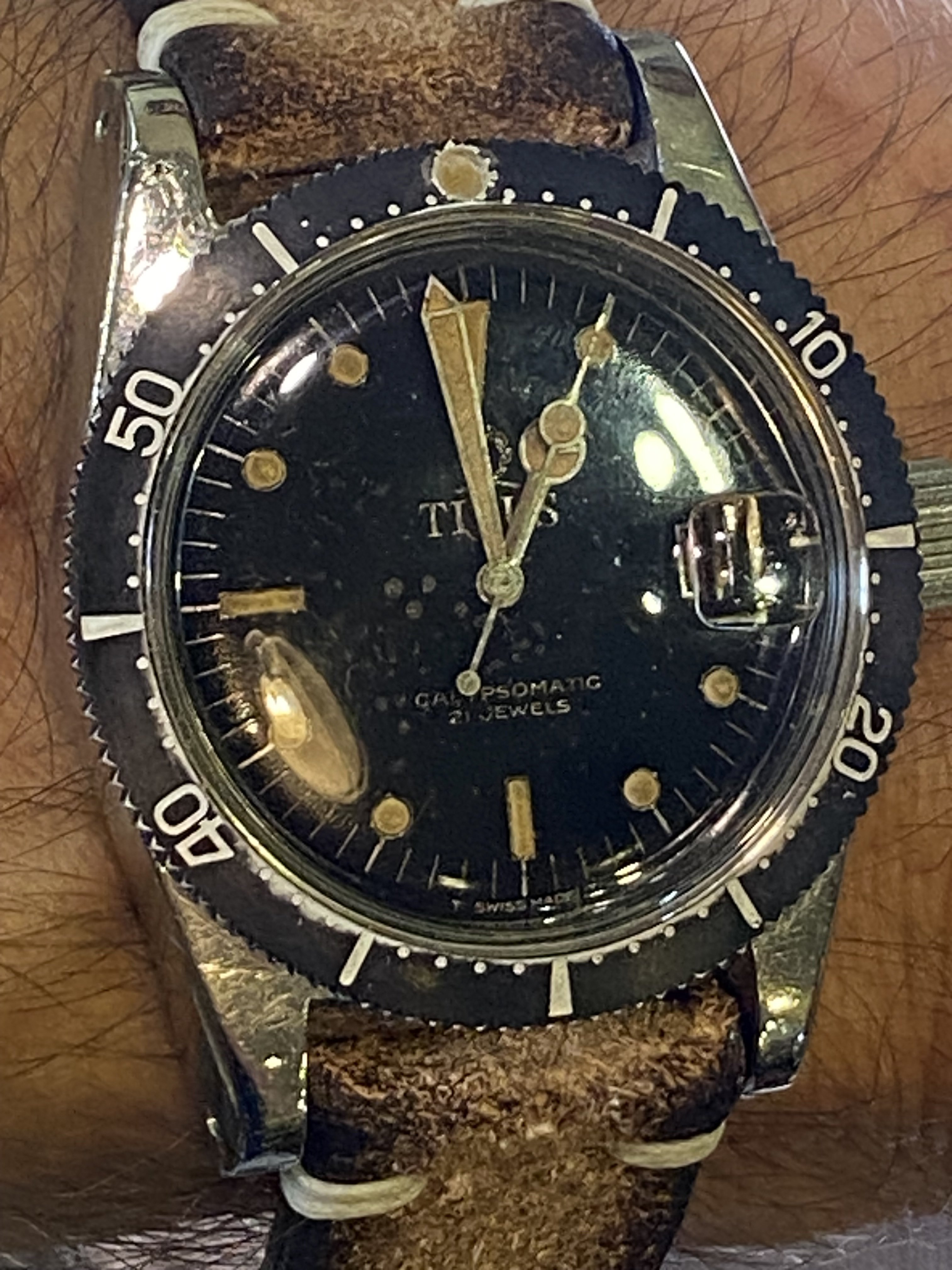

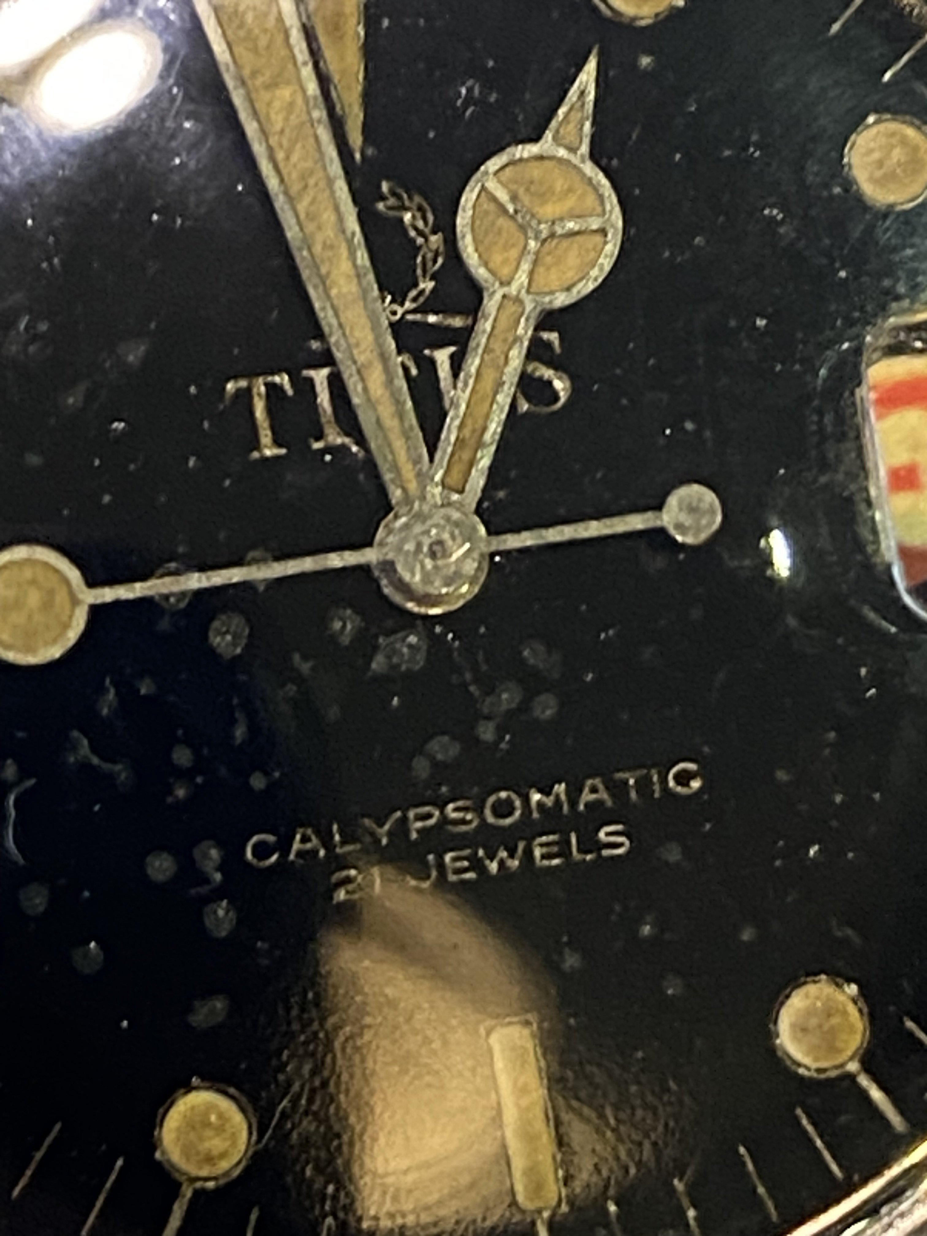

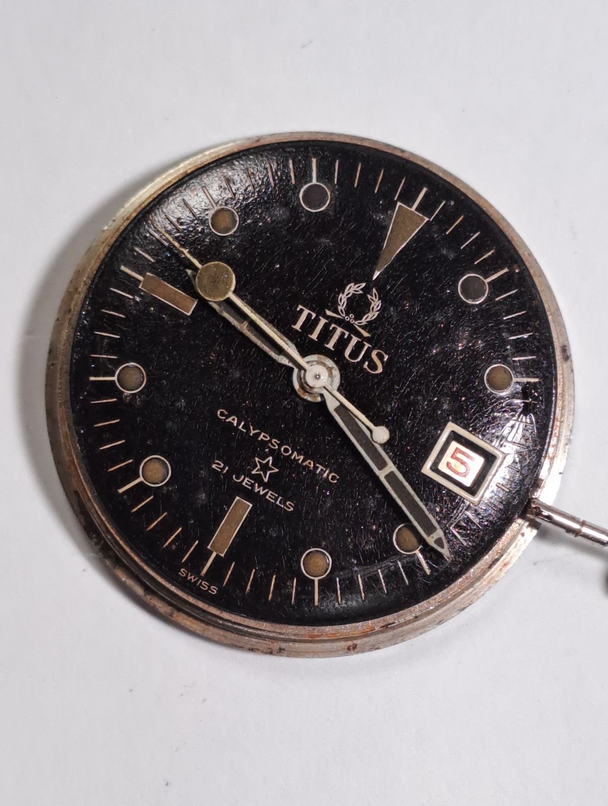

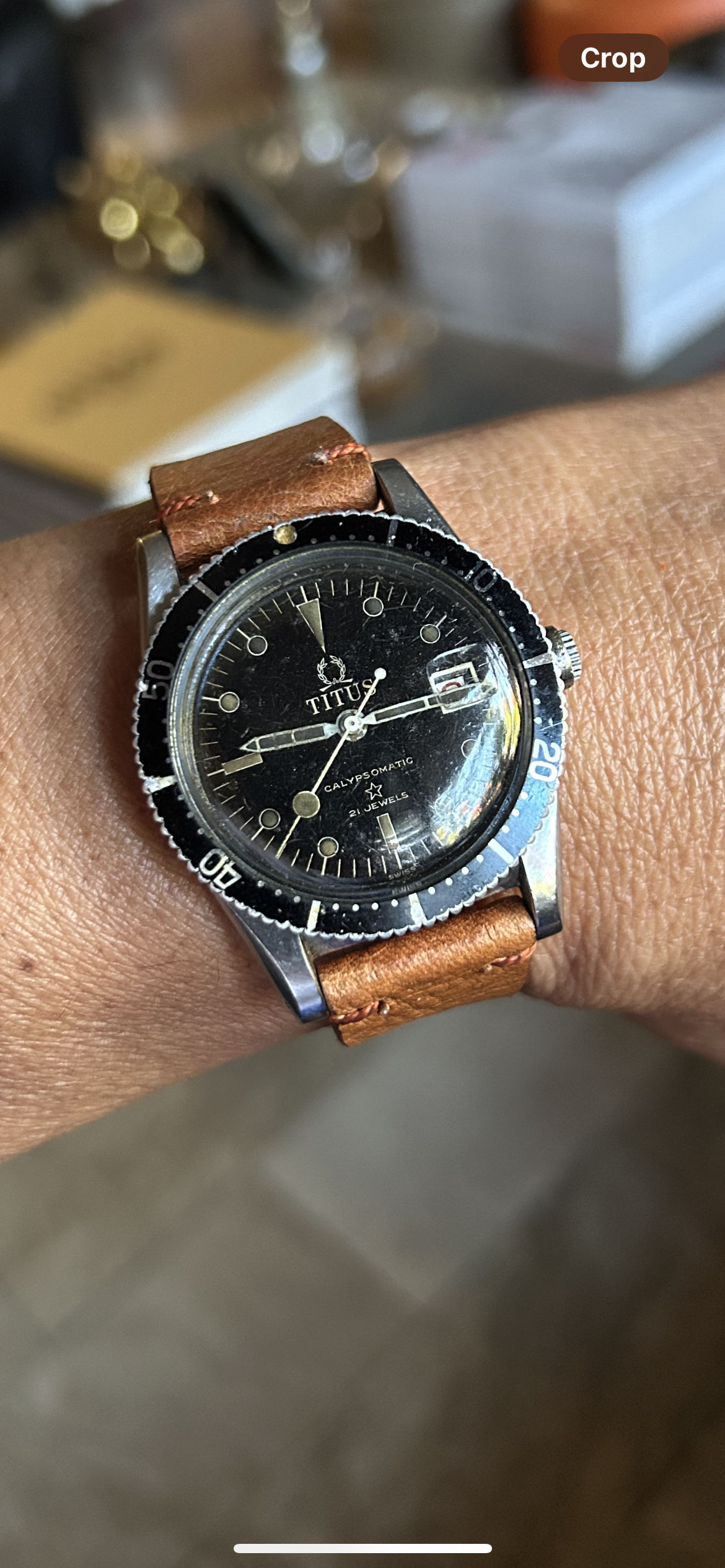

I turn to you experts to clear up my doubts about this Titus Calypsomatic that I am considering purchasing.
My doubts are:
-What reference is this? The number on the case back has disappeared (due to use?)
-Are the Mercedes hour hand and crown NOT signed correct?
-Is the bezel with the dot instead of the triangle correct?
-The dial has some spots perhaps due to humidity. The writing is not very legible but suggests a gilt dial.
-Was it relumed?
-The date display has red/blue numbers
Ultimately I would like your overall assessment.
Without reference I do not understand the correctness of the watch.
The request, as often happens in Italy, is very high although with a good margin of negotiability: 2500 Euros ($2650)
I thank you in advance for your patience, competence and advice.
I attach photos.
24,246
53,992

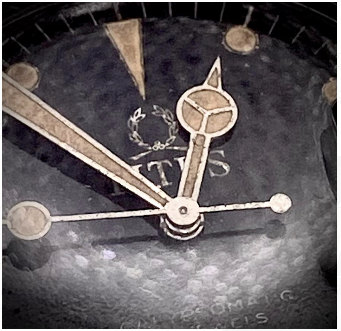

It's quite annoying that the hands are positioned to block the logo. Nevertheless, it appears to be a small logo dial, but it's a bit hard to tell. Also a circular lume pip on the bezel and a big crown (?). And a Mercedes hand. I'd say that it has parts from several models. And a damaged dial that I find unappealing.
I suggest you read some of the resources on the internet that will allow you to study the different features of the variants. Here is a start:
https://chronopedia.club/Titus_Calypsomatic
85
216
I'd say small logo, right?
I know the page you recommend me to consult.
The fact is that I couldn't make out the difference between the watch I was considering and the different characteristics of the reference I was reading.
I know there are sub-references and transitional models but I think your explanation is the most plausible: different parts from different references applied over time.
I also agree about the lack of appeal.
Given the price, it seems better to me to look further, right?
Thanks very much for reply.
Have a great day

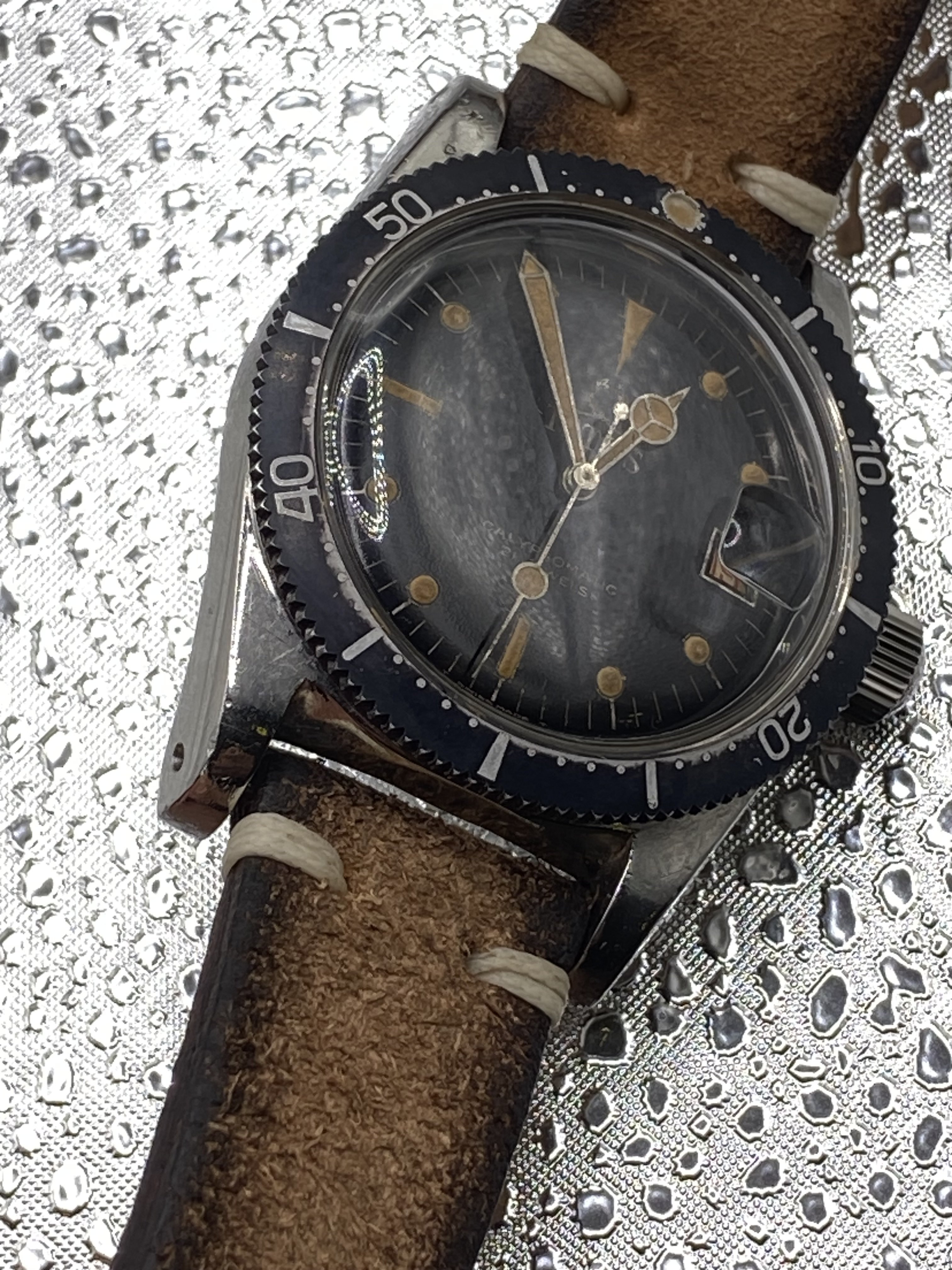

I finally caught a 1st generation 5913 after a long search. It’s in good condition and the case appears to be unpolished. Dial is very nice for its age. It would need a new crystal and the parmentier crown. I am not if the bezel is correct because it is not a reverse countdown? Overall, a great addition to my collection.
1,094
5,727
Or under 500 like this one the dial is a little weathered but gives it some vintage charm.
