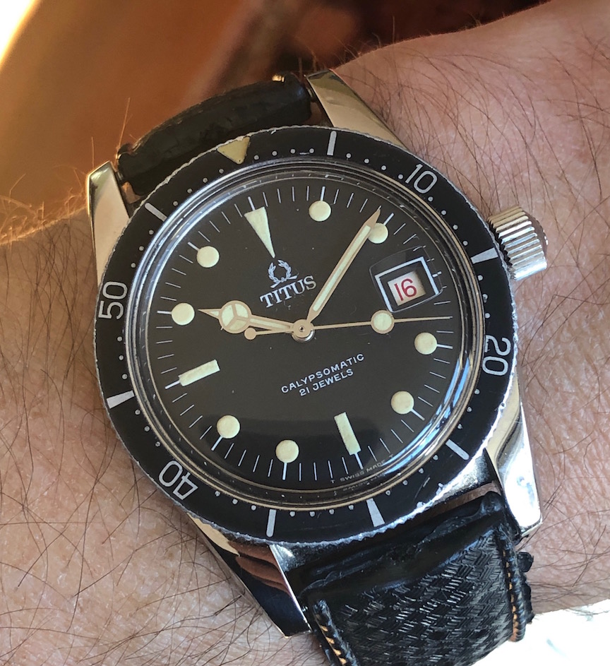

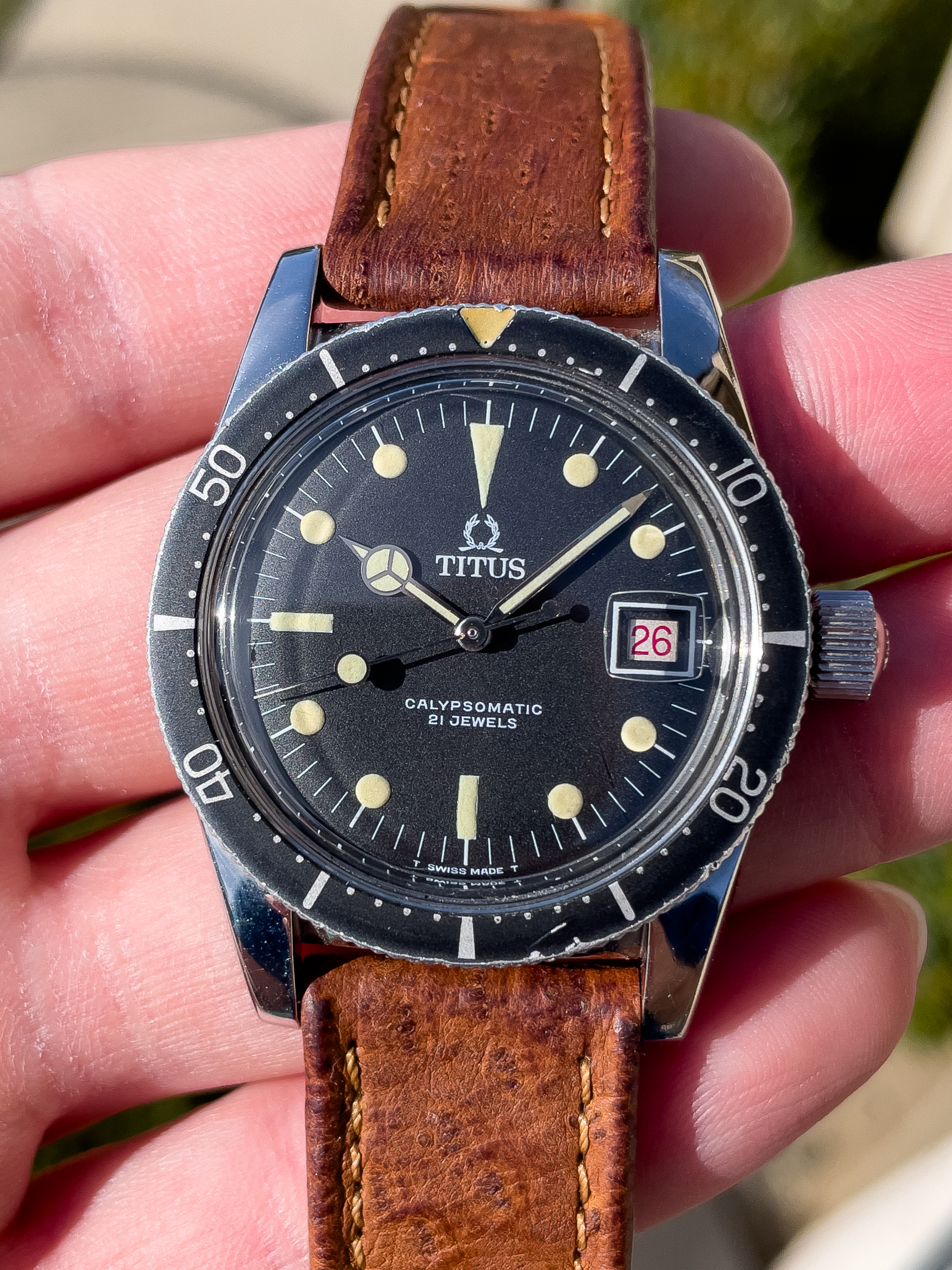

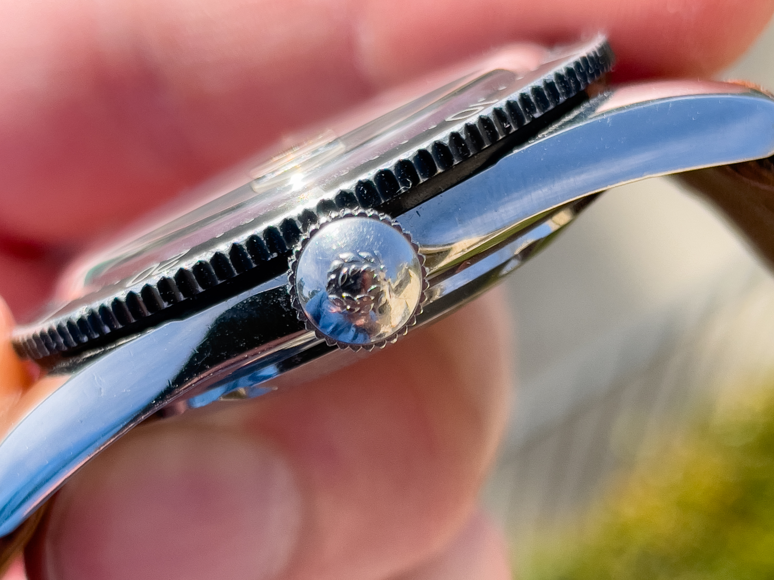

Ah I missed that this was a 7985. In that case, yes the crown should be the flat version. Not the big crown.
Not to say it's not a real crown from a 7085. But yes, wrong for this reference.

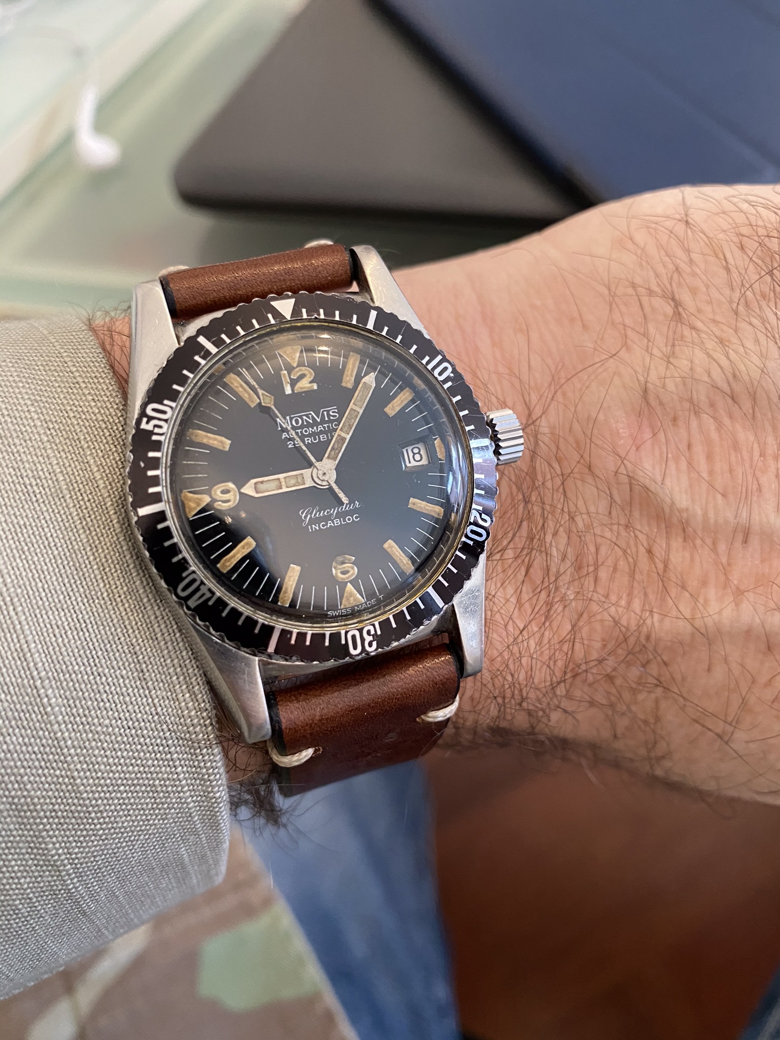

Some incredible watches here. Perhaps those who know about the brand can confirm that there is a connection between Titus and my Monvis. I was told the cases were the same/similar. Mine is 37mm with 20mm lugs.
No connection really, just used the same case. There are many brands who used it from the same supplier (some of the bigger names would be Technos, Hoga, and Universal Geneve,)

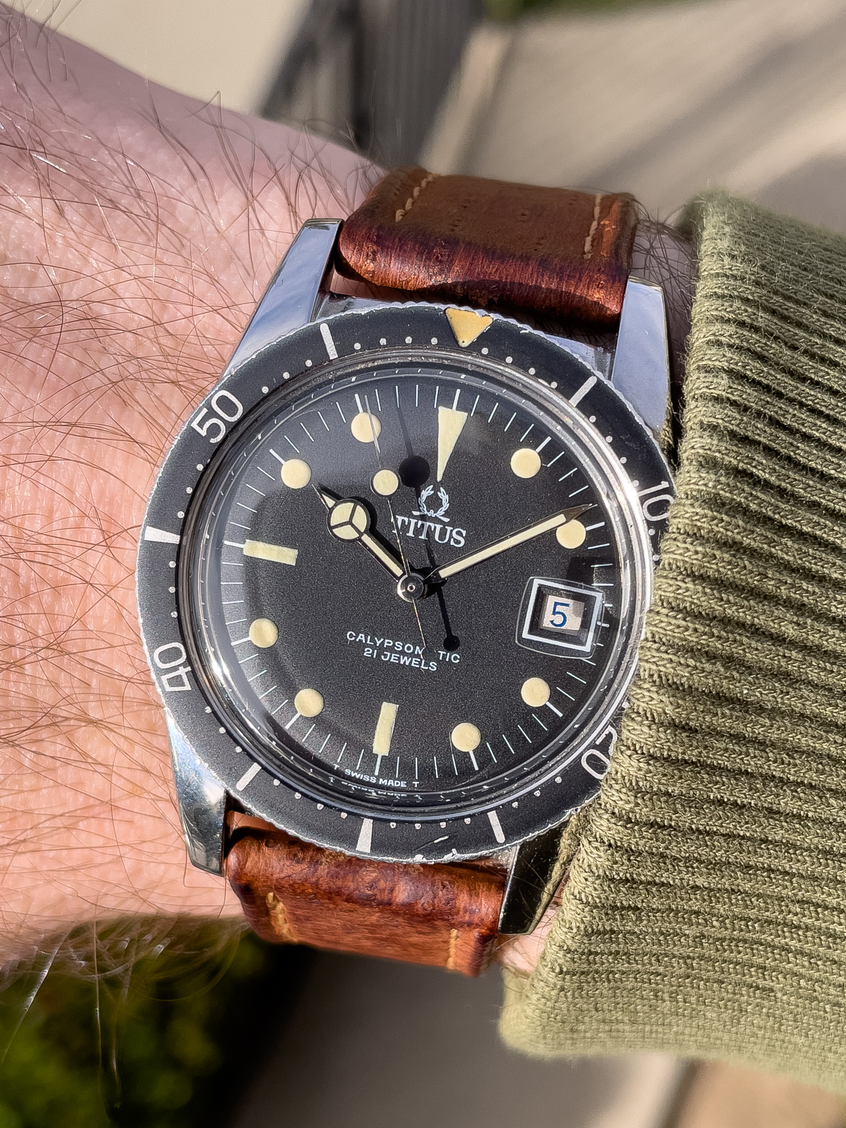

Yes, but we are talking about gilt versions here, not 7986. The OP dial is gilt, and should have a lollipop hand ... as it does. Apologies if I misunderstood some part of your post.
no problem. maybe you can educate me on the gilt dial of the calypso 'cos i noticed that while mine is
gilted dial the others are not, at least in the 7986 series. could it be that since model has many interesting
vairations especially the references, some parts like gilt and non-gilt dial alike could be could be mixed in
the production process. tia.😉😀

Most 7986s are not gilt, but I have seen a few like yours. I have this 7986, which is pretty typical.
OMG. that's a killer. very nice and neat. 👍😉
Thanks so much for confirming.

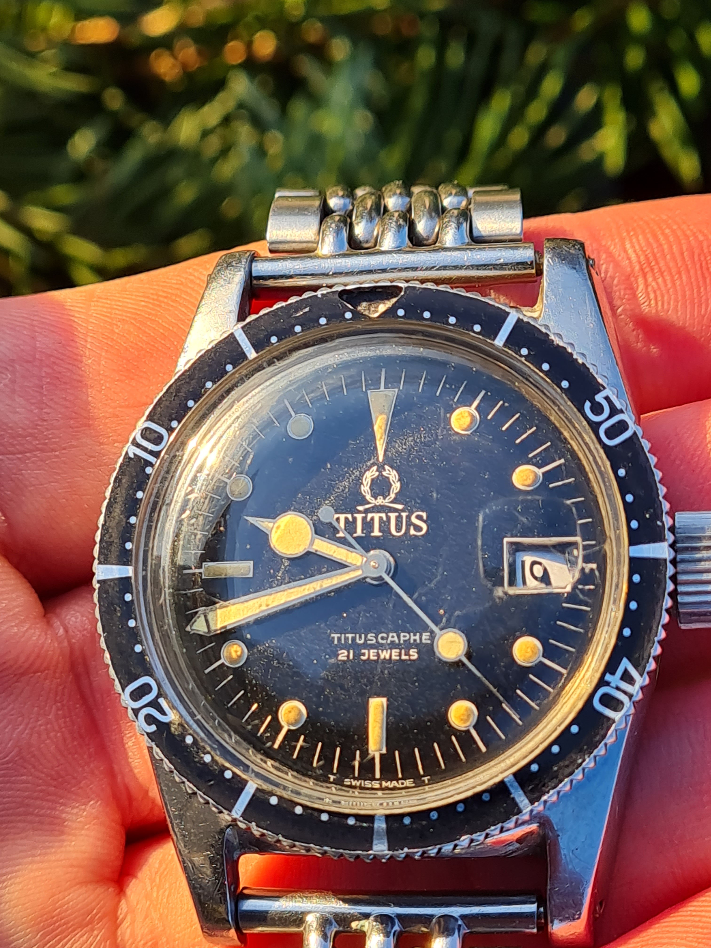

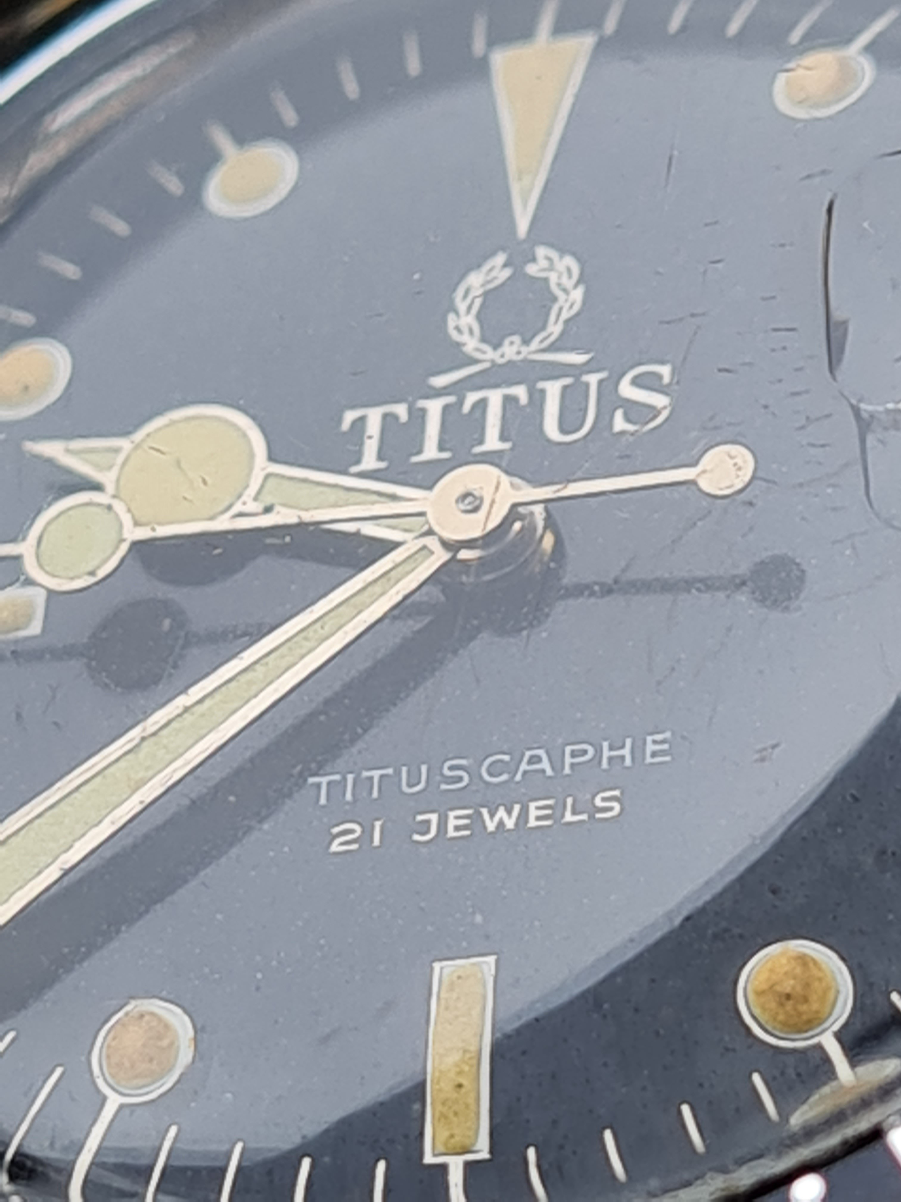

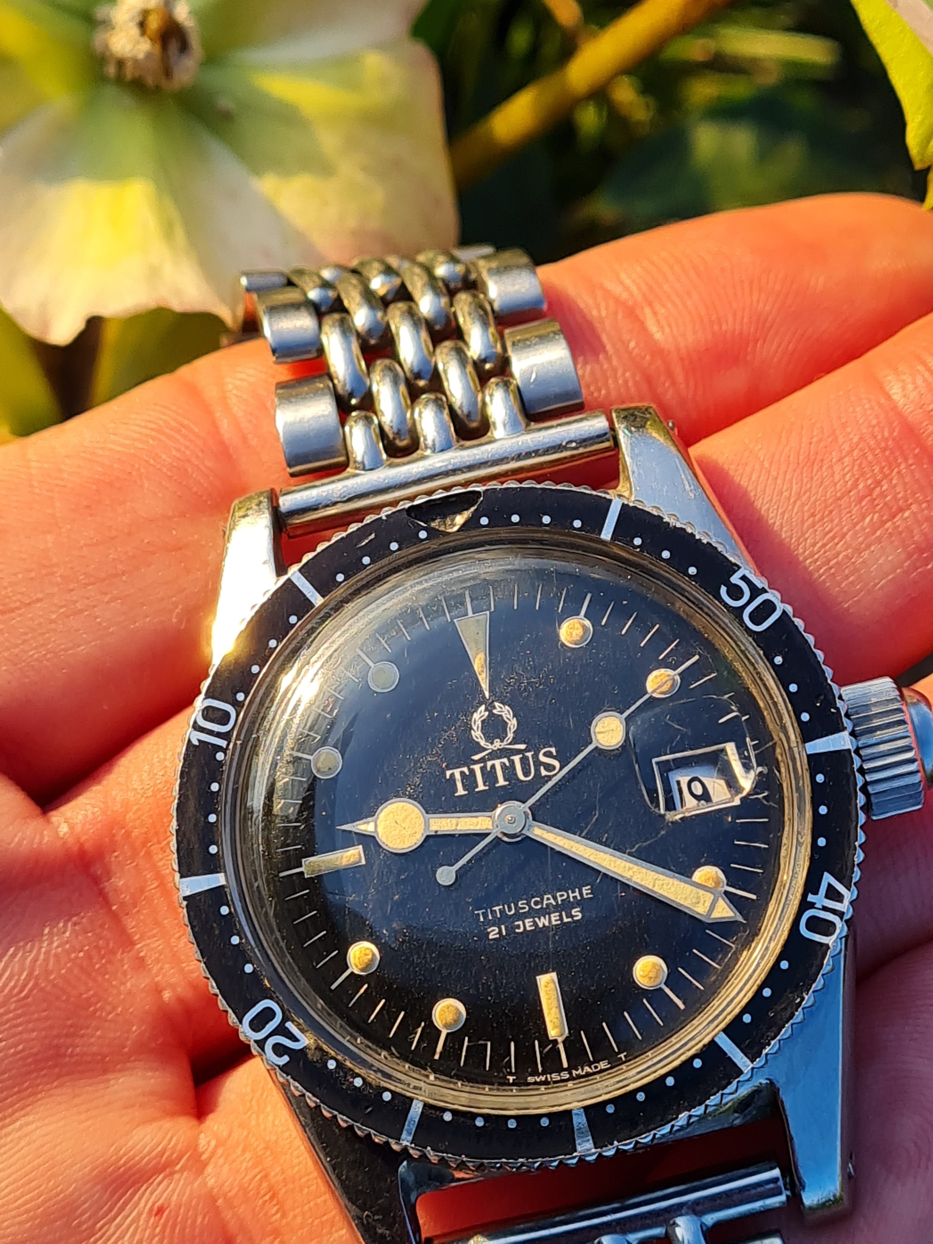

Perhaps, I can find more informations about my rare example of a Calypsomatic here.
Some weeks ago, I bought a Titus Tituscaphe.
Found only one other in www.
My watch was from a seller, who claim to be son of the first owner.
He gave me some informations, but could not tell me more about the model name "Tituscaphe".
The case is a Ref. 7085.
My Tituscaphe has a big logo, the other one, I know, has the small logo.
I know the BP Bathyscaphe, was Tituscaphe based on this model name?
And why is it a real rarity?
Did Titus have had some legal problems with this name?
Thanks in advance!
Very interesting watch, but I suspect that it was more a matter of marketing problems!
That is also possible.

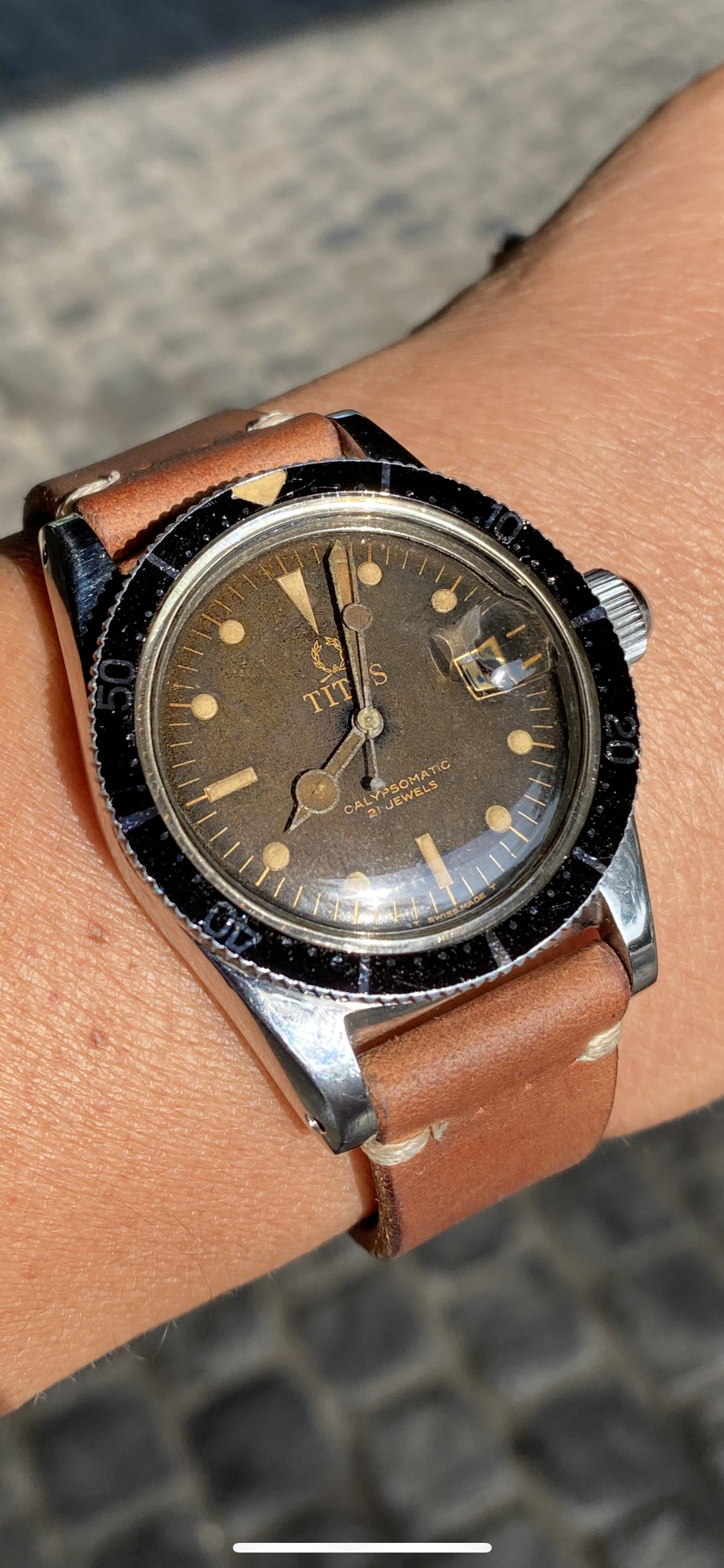

Wow. What a nicely aged dial with matching patina on the plots.
