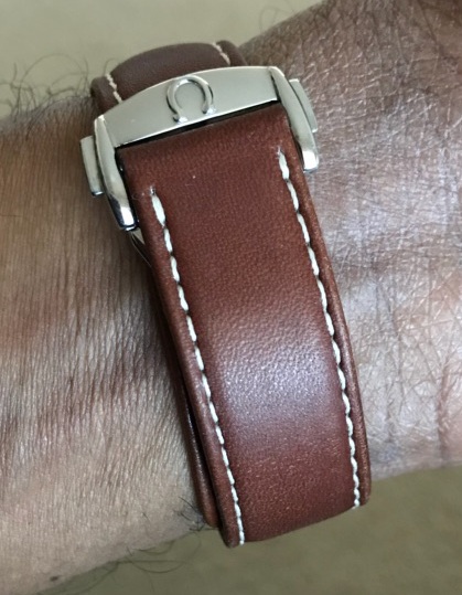

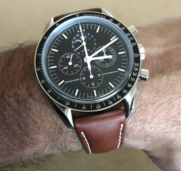

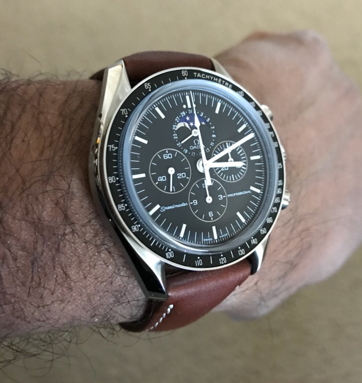

Greetings all, thought I would pour my quick thought here to get an answer from all you pros.
I’ve just bought an omega speedmaster professional moonwatch (hesalite) on a bracelet and recently purchased an aftermarket calf leather strap with tang buckle.
Story short, because I was afraid to change the strap myself, I brought it to an Omega boutique in where the staff there changed it for me.
Because the spring bars that came from the bracelet is too thick (the holes on the aftermarket strap is quite small), they have to use the aftermarket one which came with the strap. What do you think about this? Is it okay to use aftermarket spring bars with aftermarket leather strap?
My main concern is that the watch will fall off my wrist unexpectedly but it seems to be holding itself firmly as of now
Thank you 😀
Thank you 😀
A pic for the lengthy read
No pic seen...but what is the diameter of the spring bars you used? The regular bars are 1.8 mm, so were these 1.5, or 1.3? Did the ends of these aftermarket bars fully fill the holes in the lugs?
