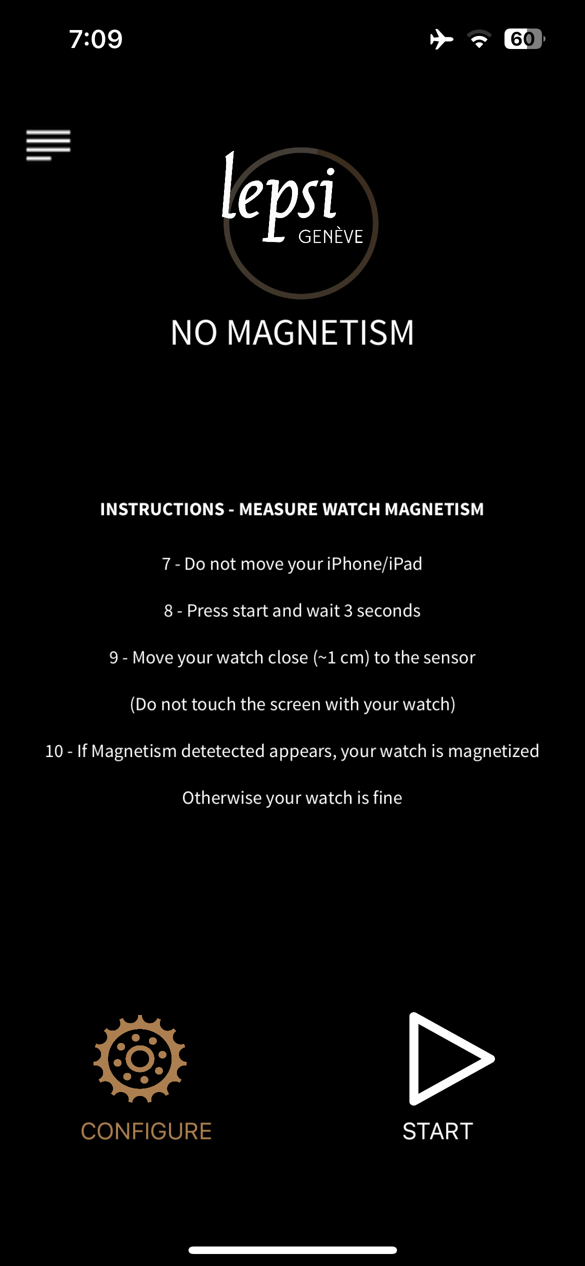

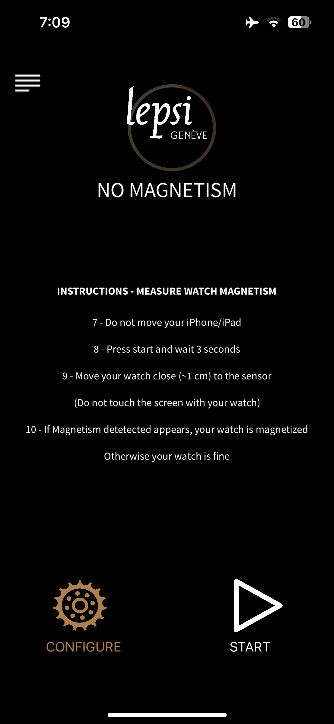

I got one like this. There’s an app called Lepsi which I downloaded and it supposedly shows magnetism when you hold watch just above it. While I wonder about its accuracy, I have had several watches that ran very fast that were magnetized on Lepsi and changed to non magnetized after running through the machine, and then no longer ran fast. Take with large grain of salt please but machine also demagnetized tweezers quite well. Maybe someone who knows will comment.

Thanks for the guidance, for some reason I couldn't find the app, but the demagnetizer is inexpensive enough I can get it and see what happens, the alternative is a $650 service from Panerai, so it is worth the effort to try!
