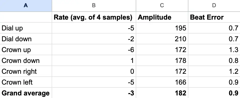

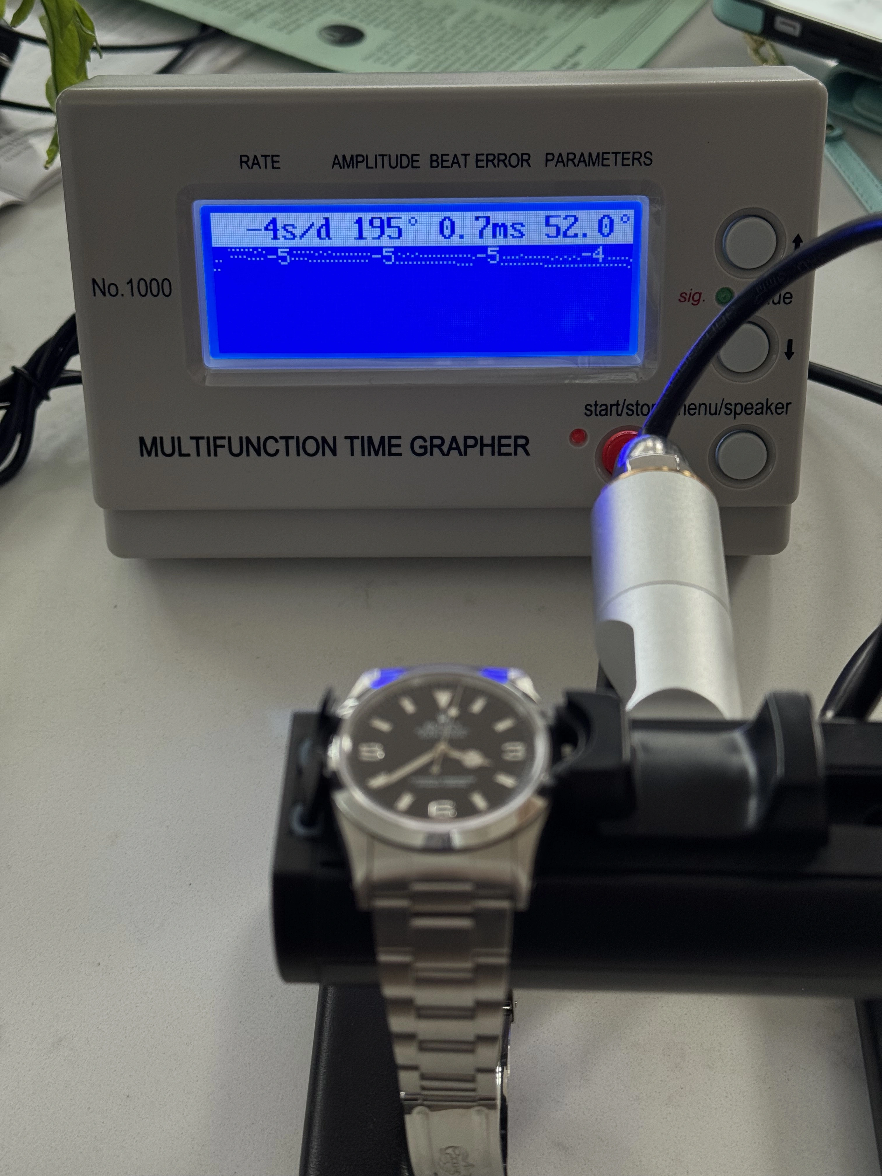

Hi OF, I just got an Explorer 14270 and am trying to decide if the combination of timegrapher parameters is cause for concern (amplitudes lower than 200 and beat errors around 1.0). In my experience with vintage/neo-vintage watches (~20 of them over the years), I've certainly seen some with higher beat errors, or with worse timekeeping, but none so far with amplitudes this low, even for a Speedy with a damaged mainspring! I know that some people would say that either of these values indicate problems in need of servicing, eg https://www.beyondthedial.com/post/collector-guide-interpreting-timegrapher-results/, but I haven't owned many Rolexes (not sure if that matters, but I know there can be different norms for different watch brands)...
In general, I've come across two perspectives on servicing, one being to just wear watches until they present with obvious problems (what I'll call the more "reactive" approach), and the other being to service them after certain periods of time of regular use and/or mild timekeeping symptoms such as these (what I'll call the more "proactive" approach), the reason being that you could mitigate more costly servicing if/when something more serious goes wrong.
1. So is one approach more prominent in the Rolex world?
2. Either way, given these parameters, would you say this is a case where the watch should definitely be serviced, or not necessarily? (PS the service history of the watch is unknown).
3. Just out of curiosity, would you describe this watch as "running well"?
Thanks!

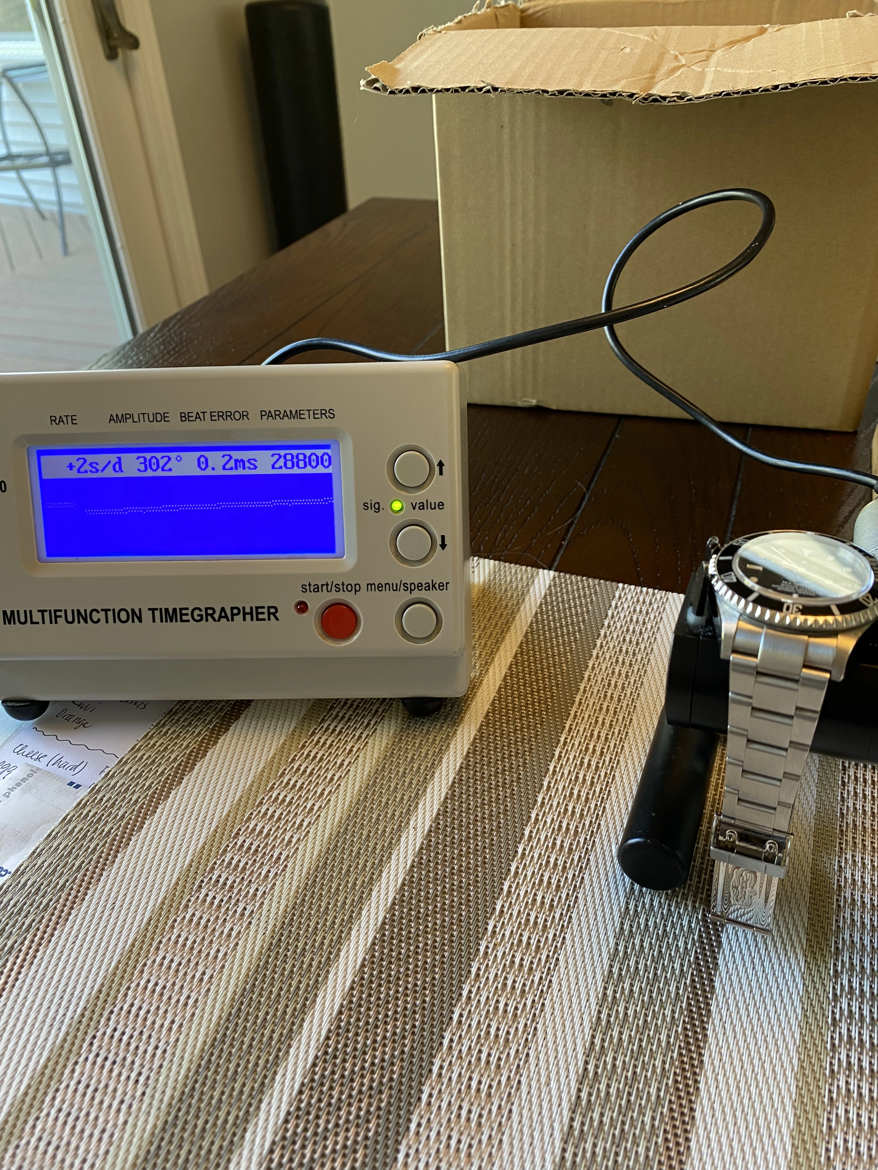

Did you wind it fully?
I believe so. I guess since it's self-winding I don't know 100%. But I wound it ~dozens of times, wore it for a bit, and also checked it a couple hours later after winding it some more...

Hi,
To my opinion it definitely needs a service.
Very low amplitude, in this case it is the main clue.
Even more if the service history is unknown. For the sake of the movement, it is better to do it.

The variation of the daily rate isn't terrible. I'll bet if you set it to an atomic clock in the morning, it's probably still keeping good time by the time you take it off for the evening, and into the next morning.
Your amplitude is low. To ensure that you're winding it up all the way, I would give the crown at least 20 revolutions and make sure that you're keeping an eye on the coronet symbol as a reference point for each revolution. If you're still getting similar amplitude numbers as what you posted above after winding it that way, it's probably time for a service, despite the fact that time keeping is still decent.
Beat error isn't great (but I've definitely seen worse).
Considering the beat error being on the high side, and the amplitude being on the low side (even after winding it for 20 full revolutions of the crown), I would probably send it in for a service.

Disclaimer: Not a watchmaker; rather, I am just an enthusiast.
I like that your watch on the TGer seems well-balanced.
Lowest to highest beat error is about 0.6
Amplitude changes or variation by position are better than average.
Timekeeping variance from +1 to -5 is quite good.
There appears to be no bias one way or another due to changes in internal friction, worn or damaged bearing surfaces.

Full service needed.
It is possible the oil has migrated to the escape wheel, which will drag the amplitude down.
But running slow, and with a high beat error, it is in need of service.
I place more "stock" in beat error than amplitude, but I'm certain both will improve with a proper cleaning, fresh lube and final adjustments (which are probably going to be minimal once it's clean and properly lubricated). Adjusting it now to compensate for the condition is not a good idea.
