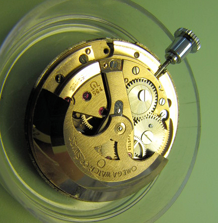

On some watches (omega cal 564) you should change the time till the date ticks over (so just past midnight) and then change the date...according to my omega certified watchmaker this is due to the particular date change mechanism (which is a pulling out, pushing in of the crown) on that particular movement. There is no ‘one rule for all’.

That only makes sense if it’s a cal564 (I beleive) which has the strange crown-popping date advance feature...

I have a 1967 564 - amazing movement. If I jump up and down near the watch it seems to be enough to set it ticking from an empty main spring. Pumping to set the date did take some getting used to / I still have a fear I might pull the stem out (I had a bad experience with an old 30t2 movement once)... I can be a bit heavy handed :0)
