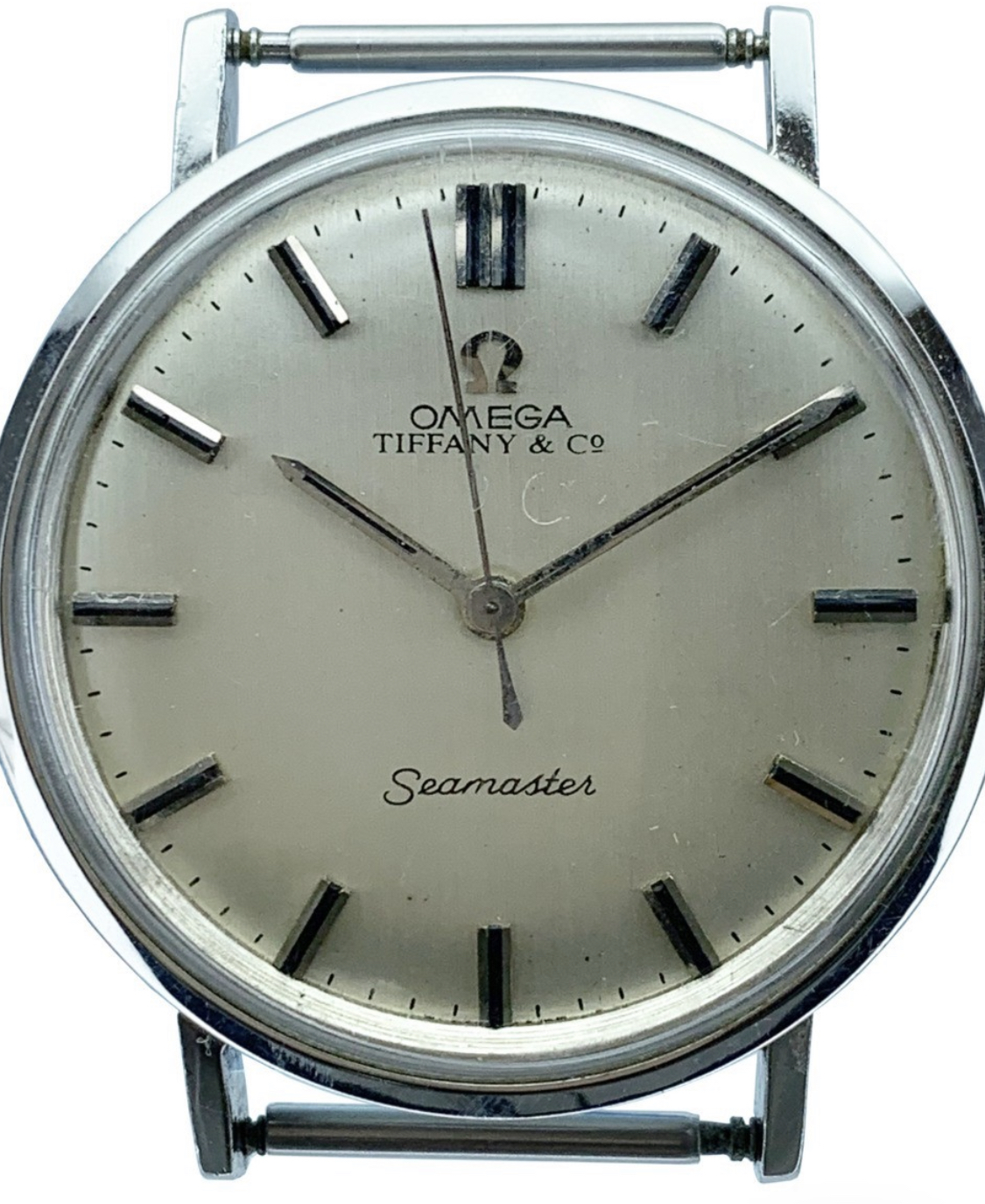

I have just picked this up on a whim. I think it was too cheap to be original and not re-dialled but what do you guys think?

No signs of a redial to me.
an extract will easily tell you.

I mean it's a fake... I will take it off your hands for what you paid to save you.

Looks at first glance ok, but check the thread about the S in Seamaster..it went through a lot of changes..this could be post "coat hanger" the hands suggest mid 60's ..other will know a bunch more.....be nice to see the movement, crown and caseback.

Looks OK to me, and what looks like onyx hour markers on the dial as well. With a polish of the glass it will really make the dial come alive.

Paid £350. Sounds ok?
Without seeing what the rest of the watch is like I would say that you picked it up for a reasonable price. Is the watch all working ok? If you can post some additional pics it would be nice to see the rest of the watch and it’s condition.

I agree that there's no obvious reason to think it's a re-dial. I have no idea whether "Tiffany & Co" is legit.

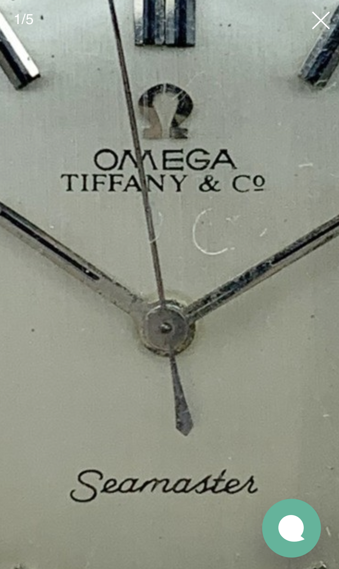

IMO the dial is a total fabrication. The Omega font looks way off to me.

Unfortunately there is strong evidence that this watch is not authentic:
◾This OMEGA wordmark has serifs, whereas 1960s OMEGA wordmark forwfor Seamaster series was sans-serif.
◾M in OMEGA wordmark seems to be stretched to the right.
◾Assuming the watch is dated to 1960s, the Tiffany &Co. wordmark design is not at all consistent with that of the period-correct wordmark.
◾There is virtually no negative space to allow 'breathing room' between two wordmarks.

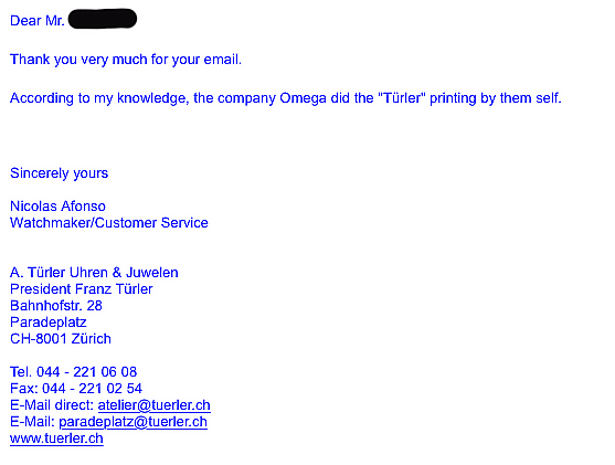

Some time ago I asked the T¨ürler company about Omega dials marked with their company name. The answer can be seen below. I doubt that Tiffany did print their company name as well. Besides that the print is not by Omega standards. In my humble opinion, it´s a sloppy redial.

I believe that most Tiffany stamps were done by the retailer themselves. There may be different fonts, placements and some may be slightly slanted.
I believe that original post is a genuine stamp by Tiffany however an extract from Omega will defintely help to clarify the origin.

Take a look at the movement. If it is not marked OXG, the Tiffany branding would not make sense.
I agree with @gatorcpa that the fonts look off.
Edit: It also looks like T Swiss Made T at 6 oclock with no sign of lume...

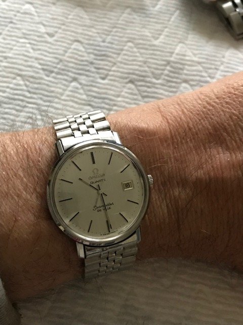

This is one of the seamaster styles we own that I was thinking of that's similar. I believe this is from 1979-1980.

I partially agree with this, I have found that Tiffany & Co. had the marks applied rather than the manufacturer, but I do not believe this particular example to be a genuine of-the-era Tiffany & Co. dial. It also doesn't seem like an original "Omega" text with a later addition of the "T&Co" mark, but rather a total redial. Try to get as many vintage Omegas in your hands as possible, pick up every one you can find at antique shops and watch sellers, and in time you can spot redials almost intuitively. If you're buying online that's not possible of course, but you will get an eye for it in time.
Original "OMEGA" font from this era is thin, delicate, and lovely. Never sloppy and I have never seen the fonts match so closely on a genuine T&Co dial where they appear to have been done at the same time. That dial doesn't look centered properly either and the outer track marks aren't aligned properly between the 12:00 and 1:00 indices.
