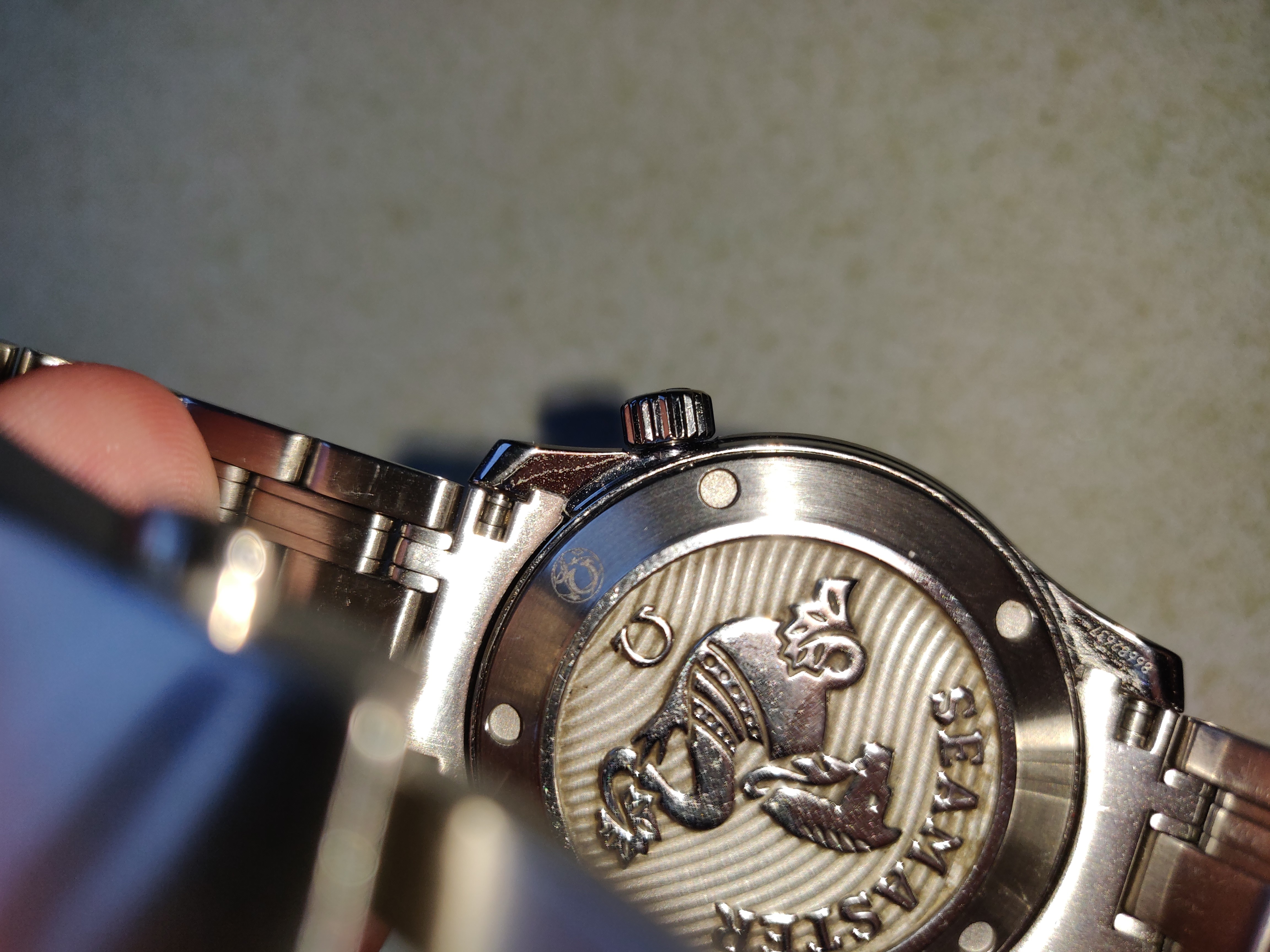

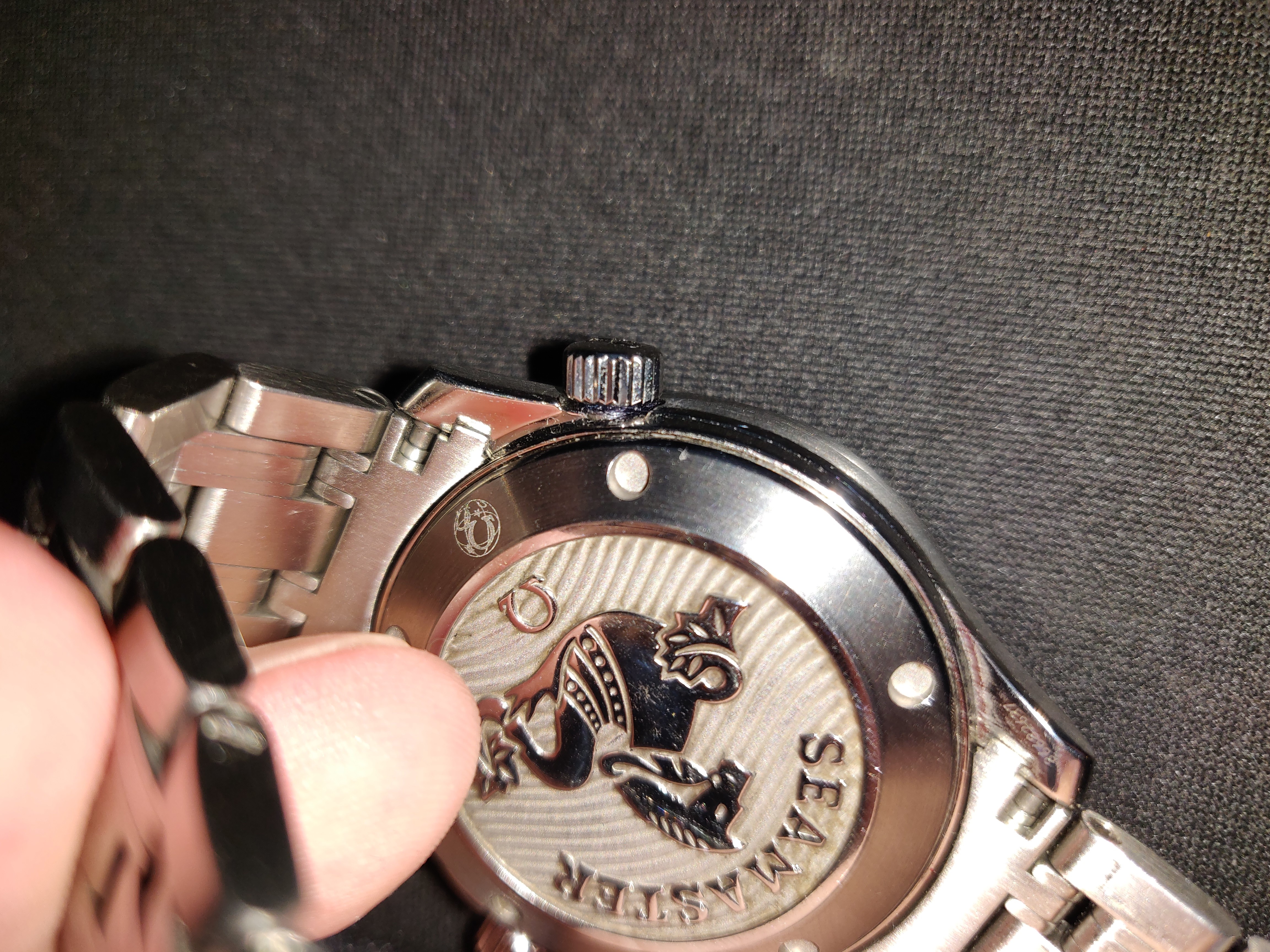

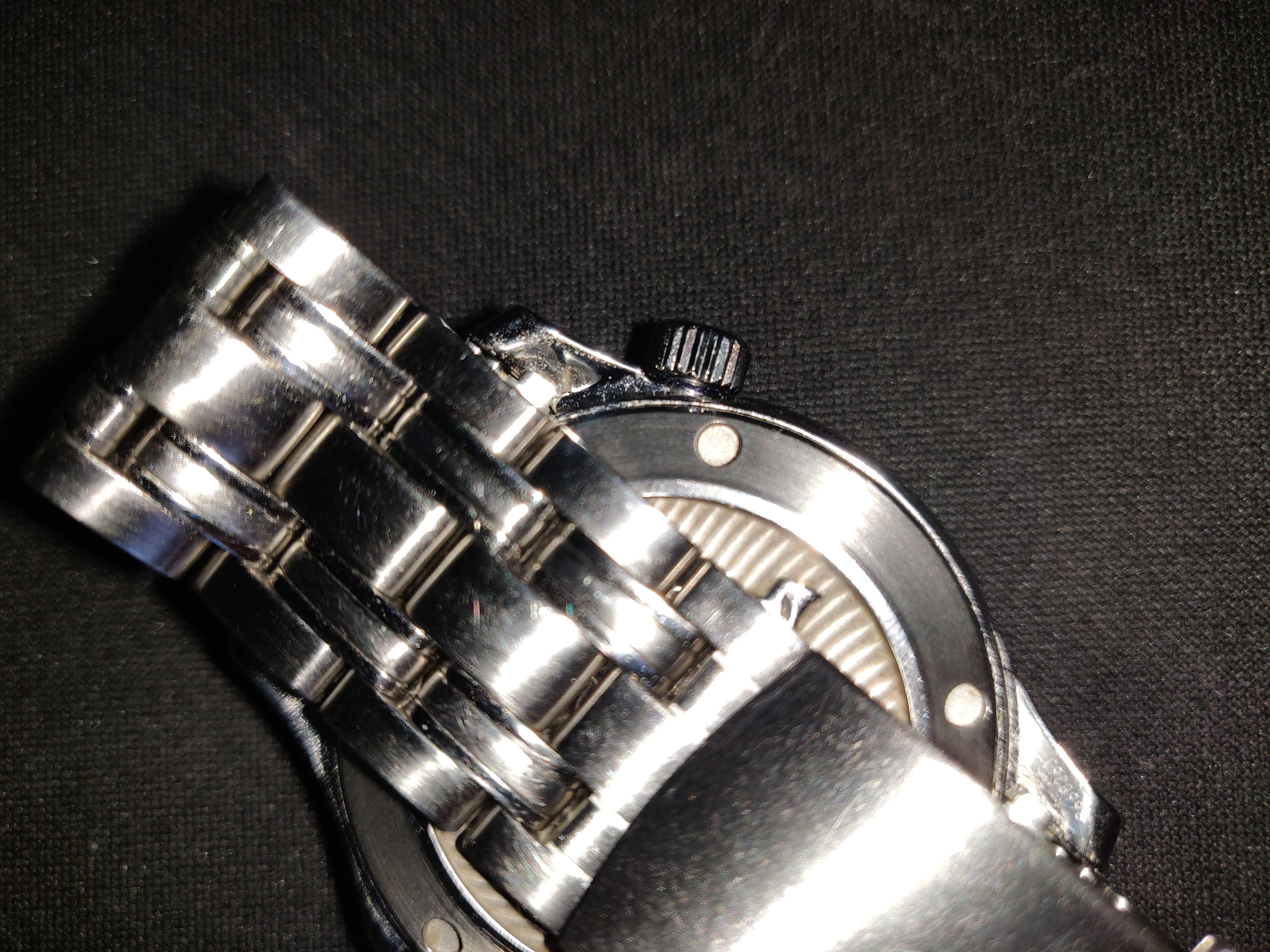

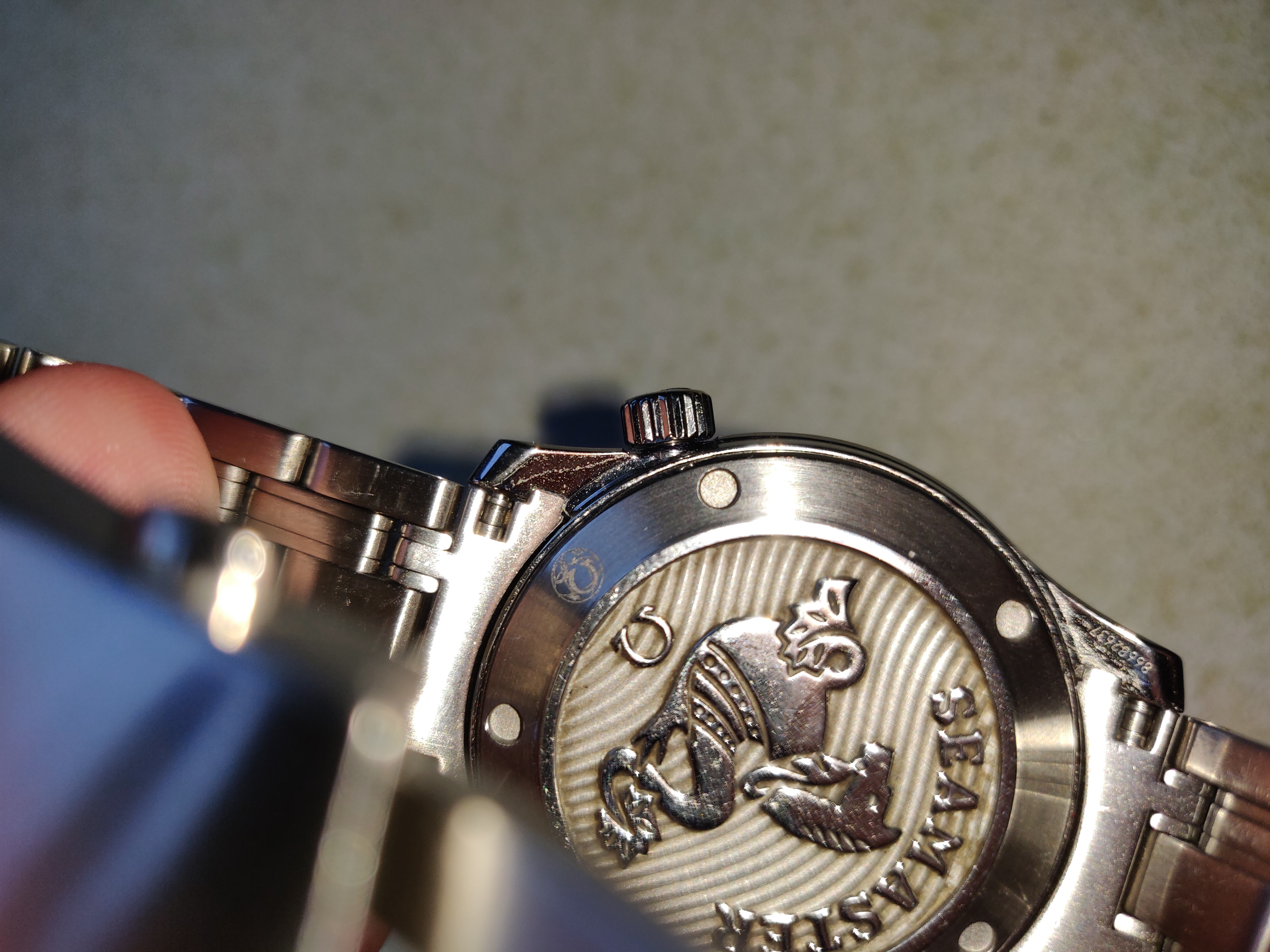

Hello,
I purchased my Seamaster 300M second hand and it came with a piece of blue thread wrapped around the inside of the helium escape valve/screw.
I cleared most of it by simply pulling and unwinding, I didnt realise how bad the problem was until the thread got caught and snapped. There is still a fair bit of thread left wrapped around the screw that I cant access.
Has anyone got any advice to clear it out? It is almost certianly not water tight and I am currently sheltering it.
Thanks and regards,
FluffyHaggis
UPDATED: added photos. Apologies for poor quality, I only have my phone.

Looks like just something wrapped around the threads - should be able to get something thin in there to get it out. Other than that you would have to contact the seller, depending on how long ago you purchased it. I use use some #5 tweezers to get it out personally. If needed the movement can be removed and the HEV unscrewed to remove the cap, but of course you would need to take this to a watchmaker for that.
Just FYI - the HEV has water resistance even with the cap unscrewed...

Hi again
I had to order the micro tweezers and a lupe tto properly have a go at the thread.
I can access it but now I can see that it is wrapped tightly twice around the shaft!
I am still struggling to get it off.. not knowing the material, wonder if submerging it for a whihle would be worth a try?
This is my regret buying off the grey market, F*ck knows what the guy was doing to get it stuck in there
Thanks

I have a dental pick that I use for situations like this, you can get into tiny places with a very sharp hooked end. Not sure what else is going to work in such tight quarters. You may have to take it to a good watchmaker and have him deal with it.
