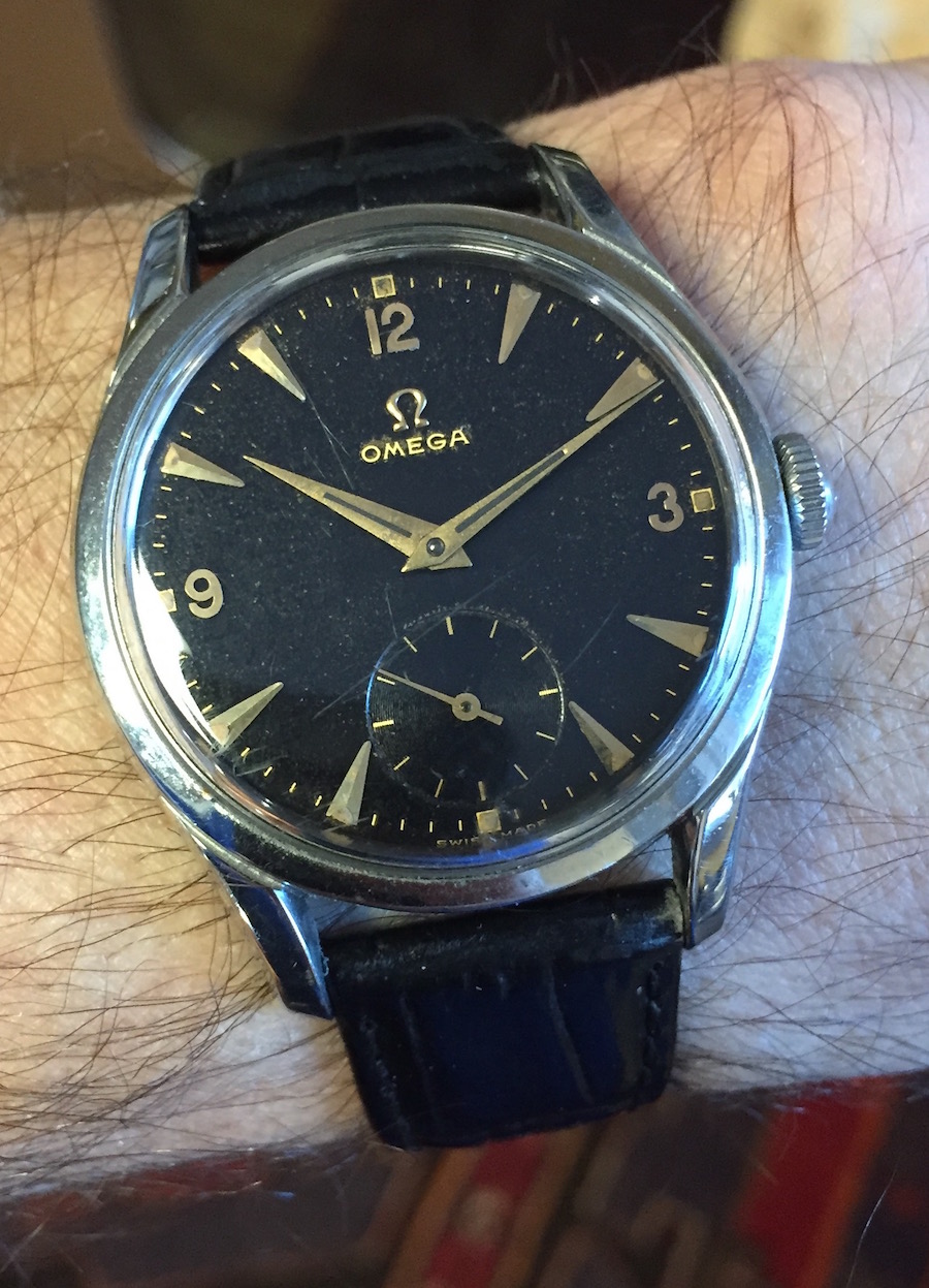

Thoughts on this Seamaster?

Guy wants $525 for it. I am somewhat concerned of its legitimacy? I have found a reference with this dial / hands combo, but none in this case. I think possibly this is a different case? The lugs look off for a Seamaster with that dial. Thoughts? He claims it is a 1959 Seamaster. He is going to take photos of the movement tomorrow when he takes it to his watchmaker.

Looks ok except for the crown. I would have guessed a little earlier than 1959.
That was my thought as well. The case says mid 50’s to me, but the case doesn’t look off to you? Most Seamaster sub seconds refs I have seen have, idk, smoother lugs?

I don't see a problem. Search for ref 2759 or cal 410.
Oh, that’s exactly it! He said he believed it was a 26X cal so that’s where I was searching. That is definitely the correct ref. Thanks!
Sorry for the double post. Assuming the movement looks all good, thoughts on the price considering the condition?

As I mentioned, the crown is wrong and unfortunately, it's hard for me to really judge the condition of the dial from the photo because the crystal is so bad, so I would have to give you a pretty wide range of $400-$700 in a private sale. I know that's not too helpful.

$525 is too much. You can find nicer examples for this amount of money.
The watch looks kind of tired (especially the dial and case).
