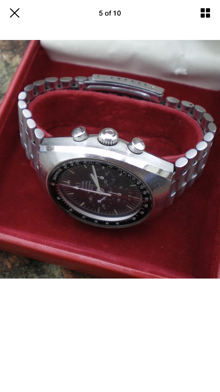

And slightly OT: this 2014 model just popped up (pretty sure it’s a bogus listing) but I wanted to ask if anyone has ever seen such crazy faded hands on a 5-year-old watch before?

@johnnylarue I saw that too and seller even sent a nice 7% off offer.
I was honestly very confused by the aging on it. The band looked fine for the new models but I have no idea how it got that faded looking and why such terrible photos.
Maybe it was found in the bottom of a lake or something?
Yeah I‘ve yet to see a MKII replica with a correct bracelet on it, and so there’s a *chance* its first owner just beat the crap out of his $4K+ watch—those cases do tend to record most of the bumps, dings and scrapes they encounter. Or maybe it was strapped to the back of an iguana and set free to wander the desert for five years?
Either way, some red flags (0% feedback seller, basically only two brutal photos) but, you know, the greater the risk, the greater the spoils, right? 😉

With the disclaimer that I have no connection to the seller, I did manage to get a few more pics out of him and am throwing 'em up here for the curious. This much honest wear is hard to come by on such a young watch so it's hard to gauge what a fair price would be for it as other used examples are usually in nicer shape. But if it's genuine as I suspect it is, it could be a hell of a bargain. (That said, I haven't studied the replica scene for these, and those faded orange hands... 😕)
