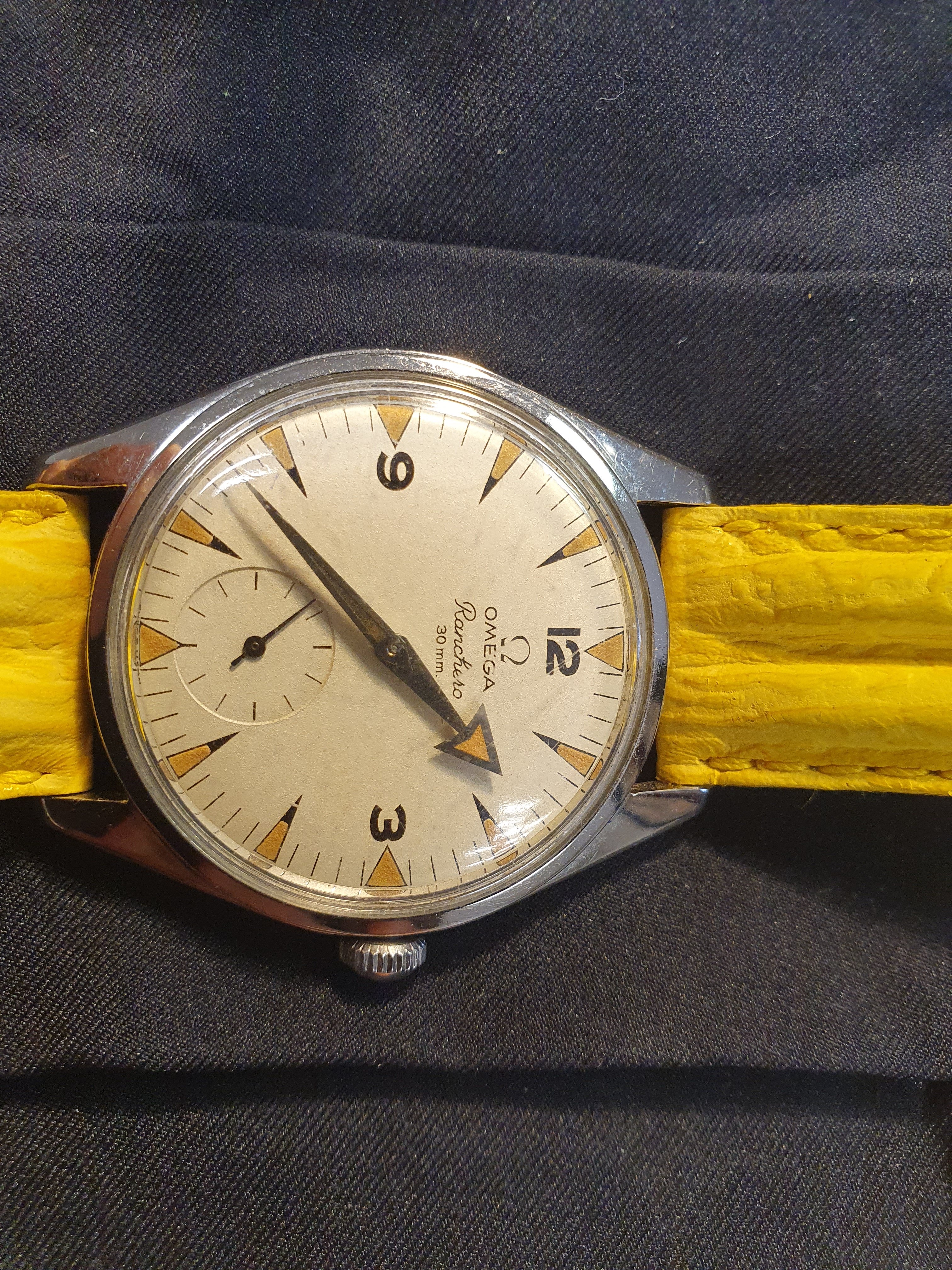

Hi all!
Was wondering if this ranchero checked all the boxes? It seems nice to me but I’m far from being an expert on these...
No movement pic unfortunately, that’s all I have
Thanks!

Looks very clean. Original dial and at least the correct crown possibly the original. original examples are getting harder and harder to find.
8,284
29,296
Possible lume replacement on the hour hand (note the disparity with the minute hand), but otherwise looks excellent.

Dial looks great to me, cross referencing with some originals online.

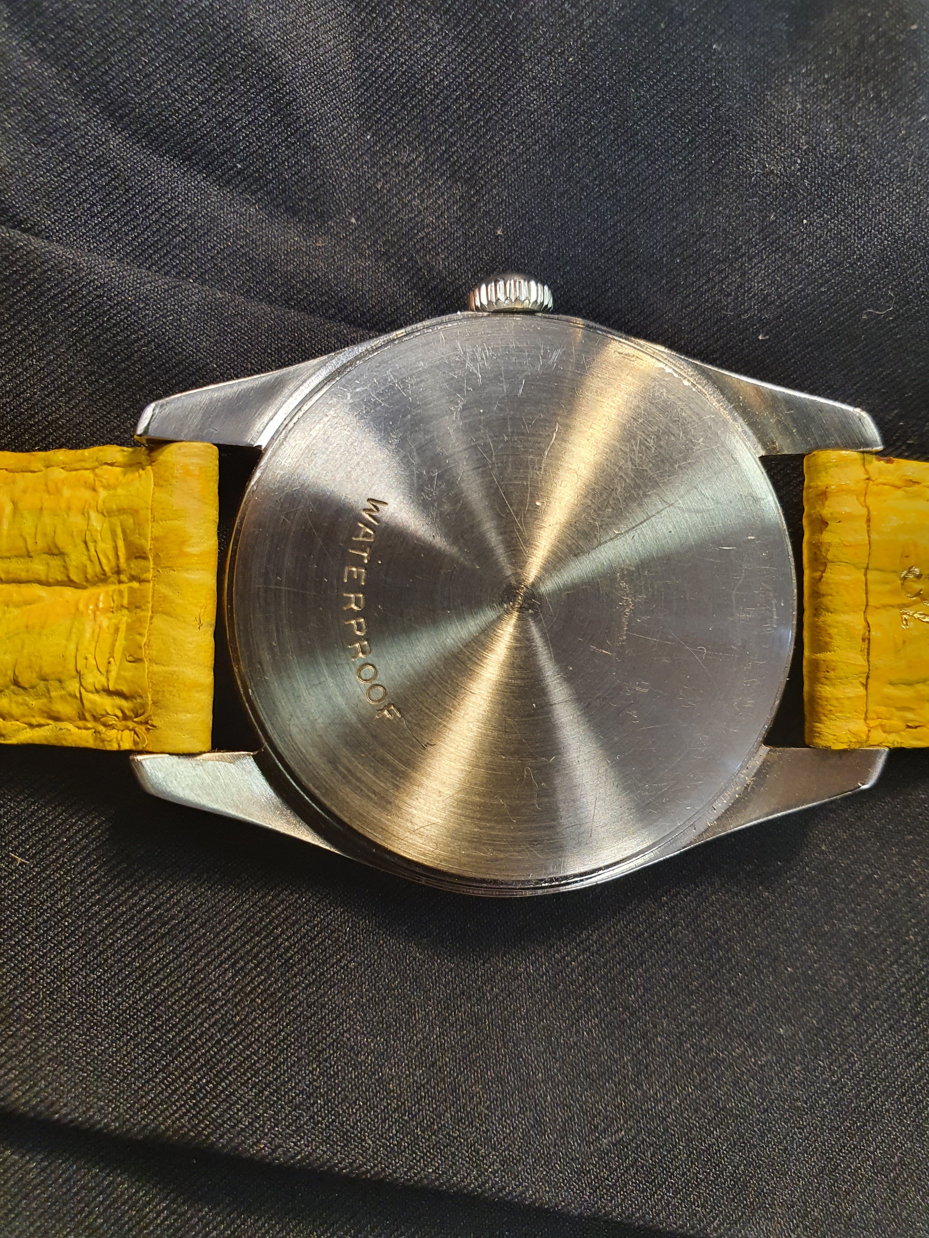

Given the amounts that are asked for these, there is no way I would consider any Ranchero without seeing the inside of the case and the movement to be sure that everything lines up.
It all depends on how much you want to gamble.

Looks correct, but get an extract from the archives to sure that movement is checks out to be from a Ranchero

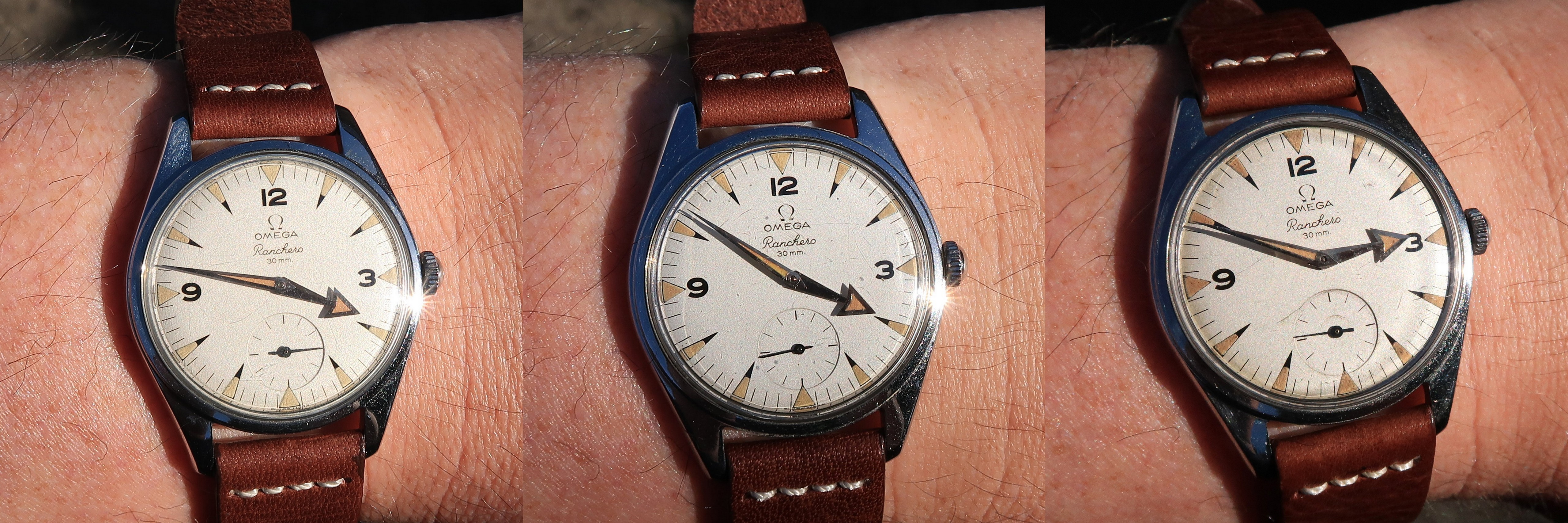

Here are three of my white ones to compare
