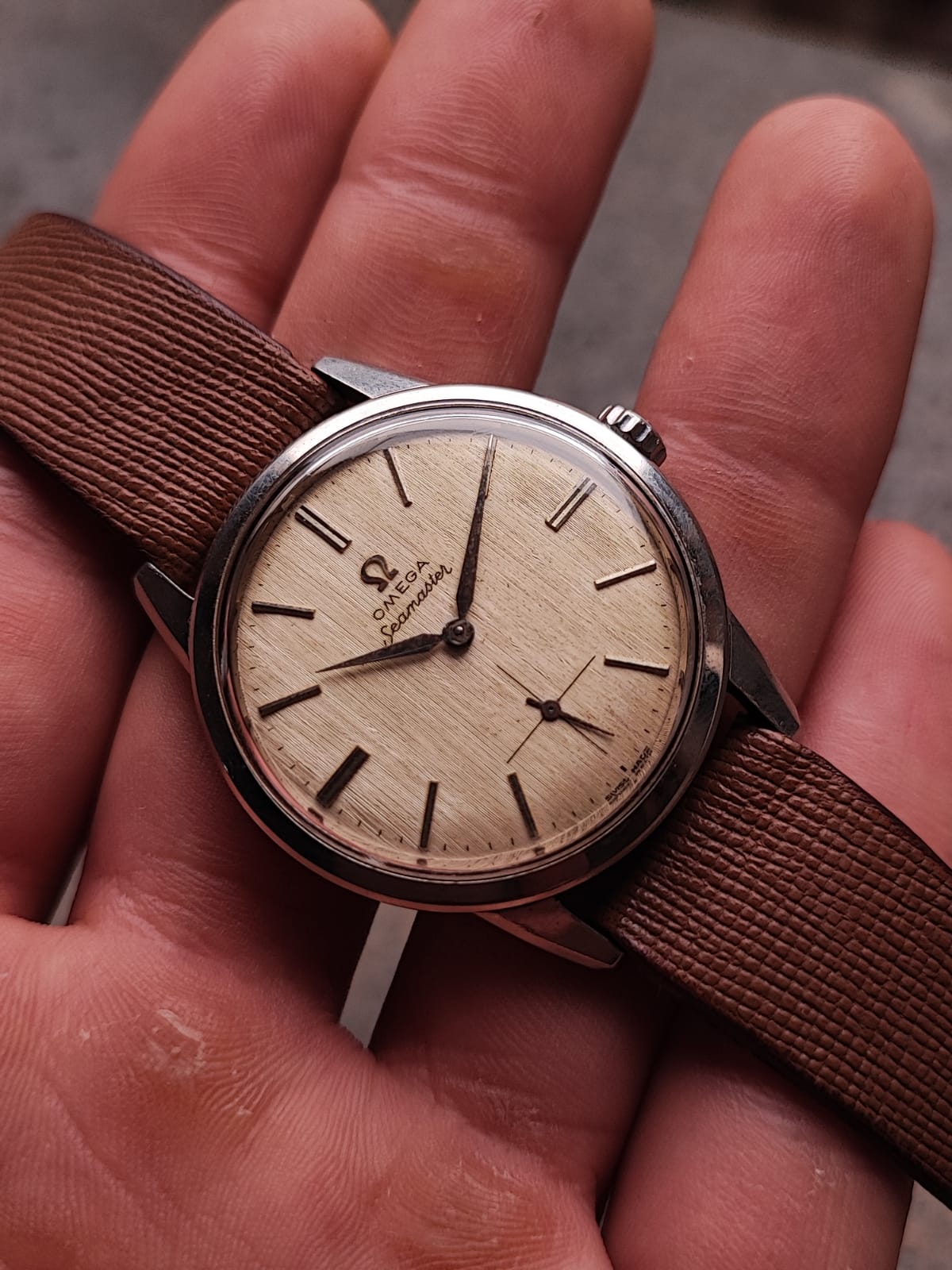

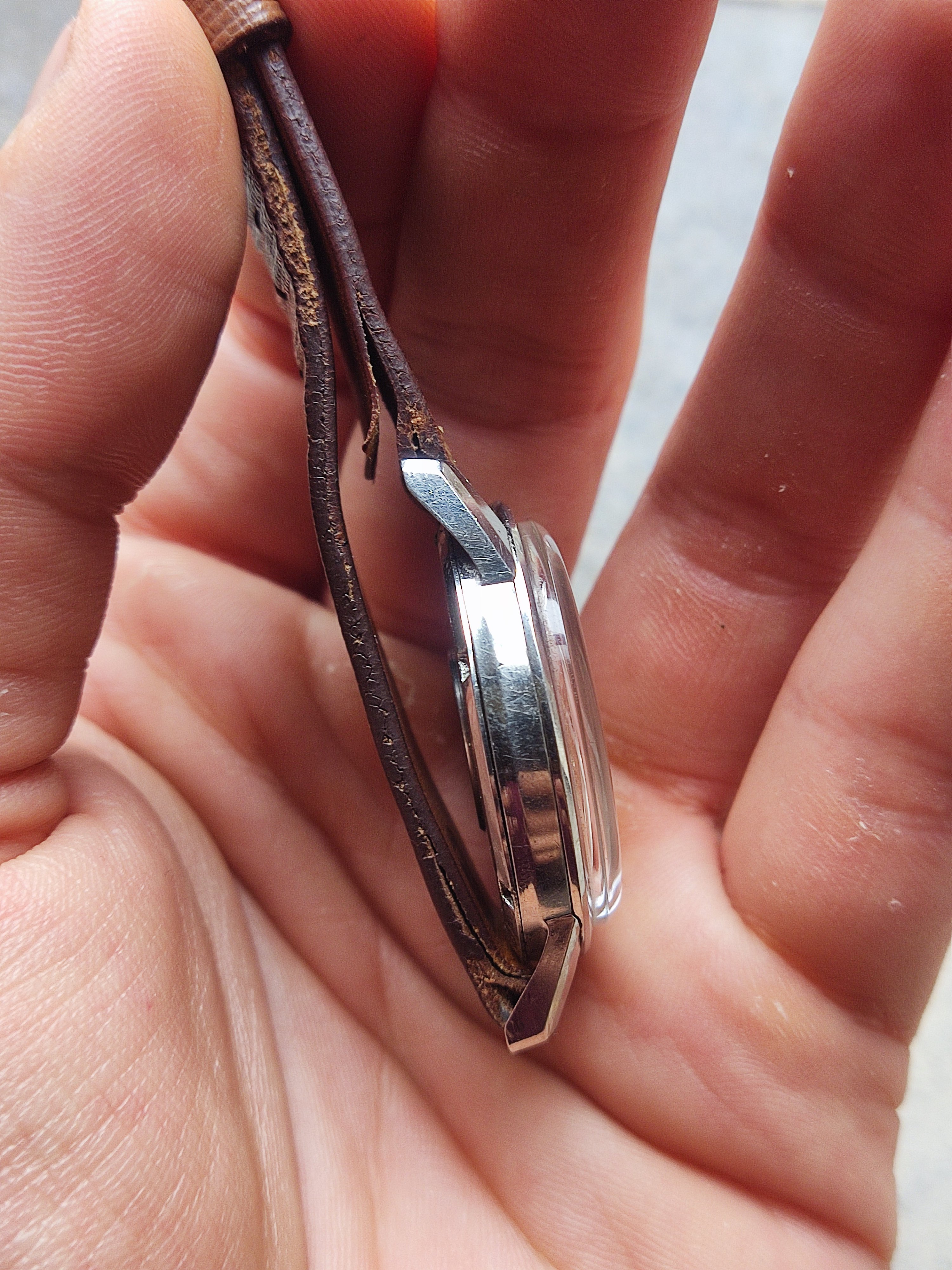

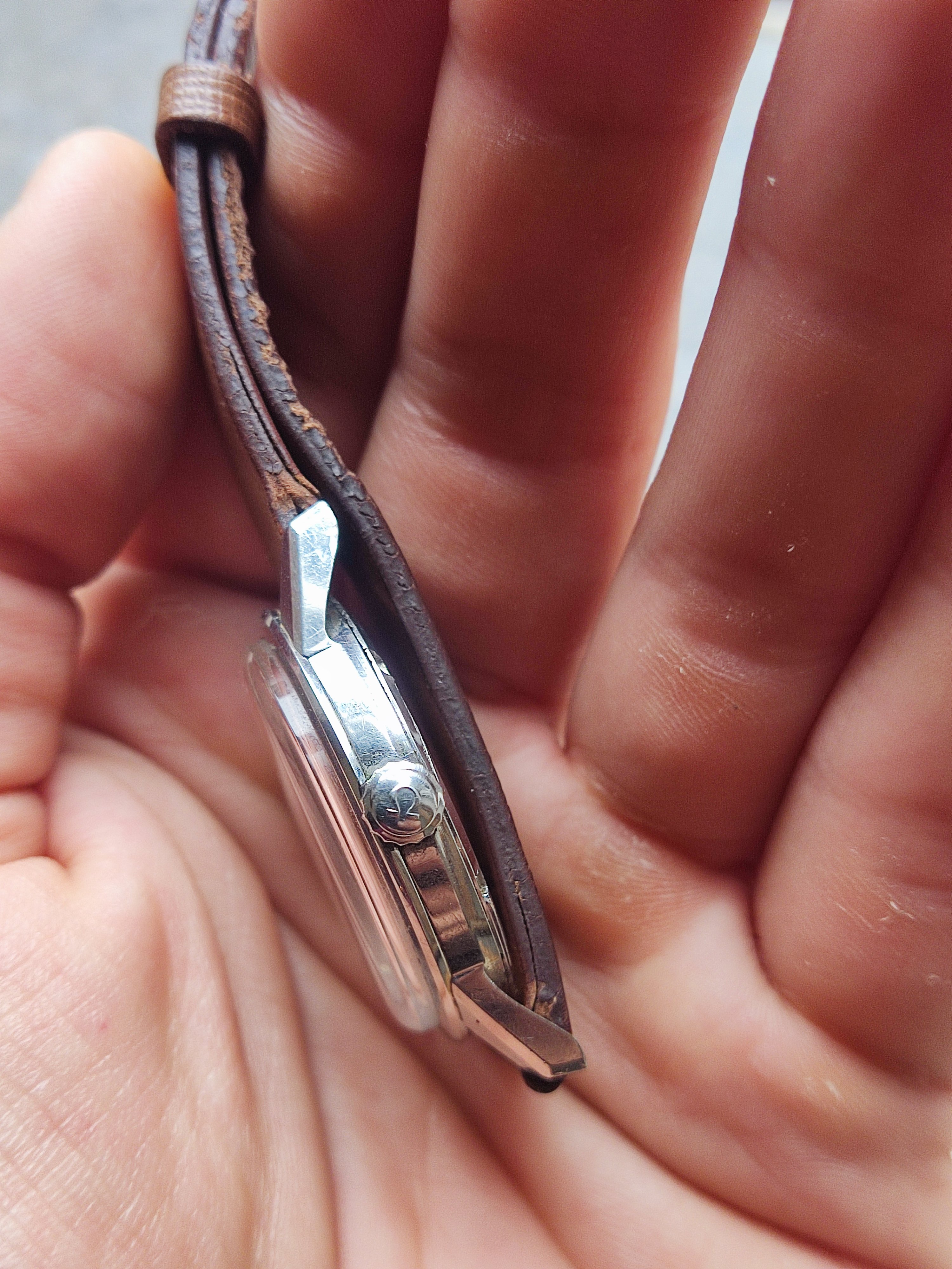

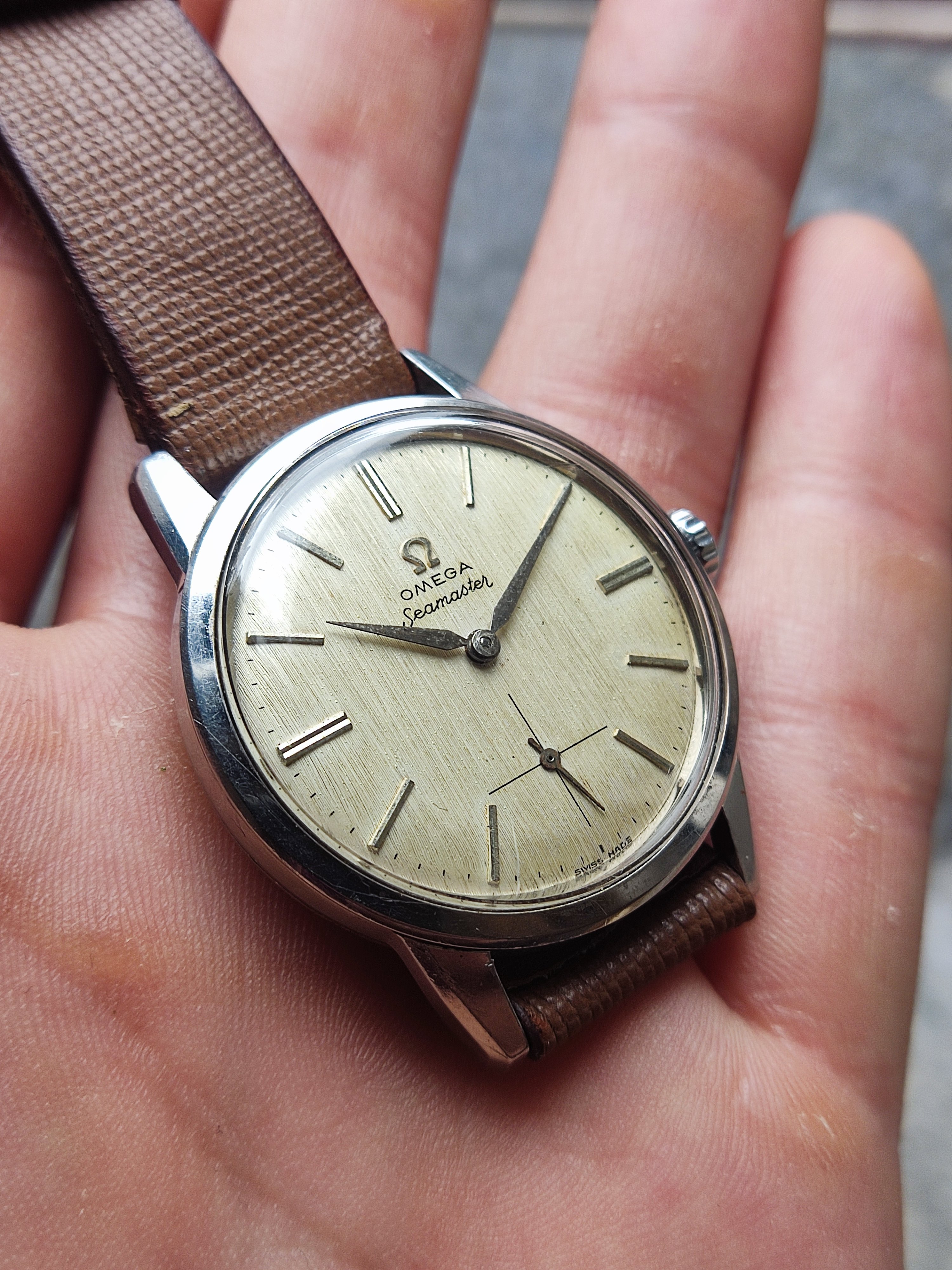

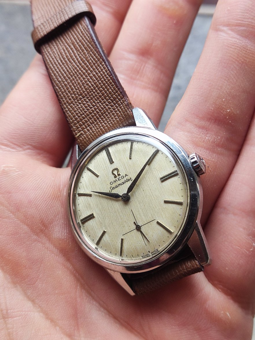

Good morning, I stumble across this watch while looking for a beefy lugs seamaster. ( Still my first choice)
The point is that this watch is located very near where i live so easy deal by cash.
Is this case number more collectable than a beefy lugs seamaster like 2577?
Is this 14389 all original? Price is 680 euros
Many thanks regards

It’s not a particularly rare reference, but it’s one that I like. Case looks unpolished and a linen dial, I think? Looks like it could use a good cleaning. Assume that it will need a service. Price isn’t outrageous.

hi, yes it s a linen dial. Does it wear smaller then a 2577 ?
I own a constellation 167005, I don't wear it much because i found it too small.

I believe that the 167.005 and the 14389 are both sitting at 34 or 35 mm, so they will wear very similarly. That's also a pretty common size for most vintage watches. If the guy lives nearby I suggest trying it on first if you don't like how your 167.005 wears.
It's looks like a pretty nice example. I'm not sure what the conversion rate is at the moment but that price seems not oulandish. Factor in a service and if you're happy with the price ab the way it fits I'd say buy it.

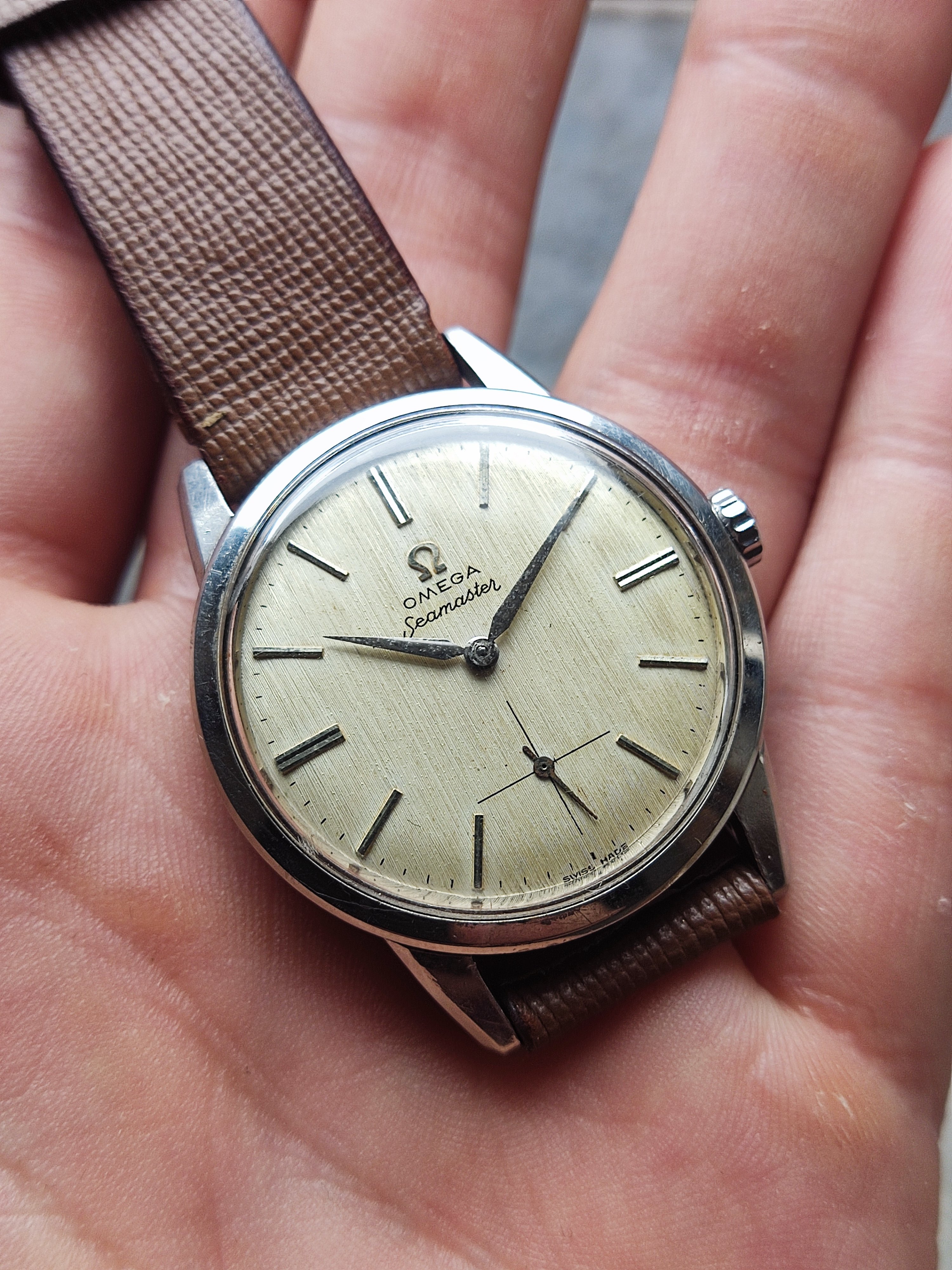

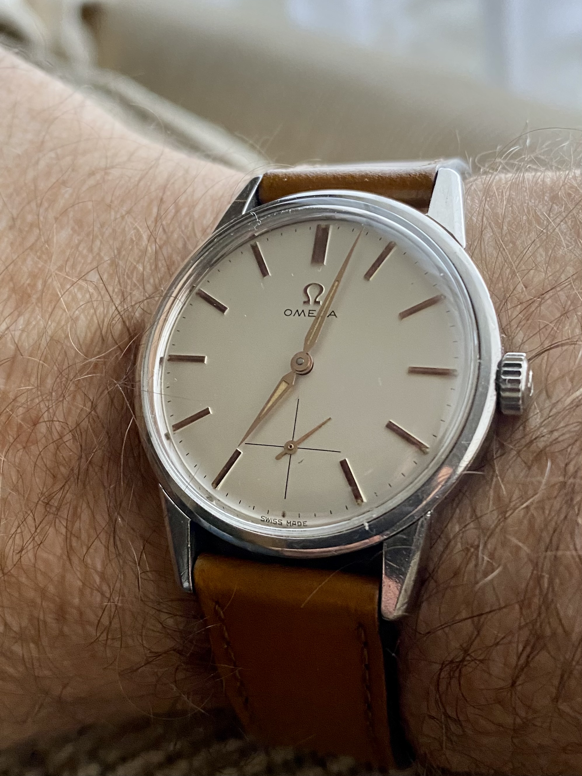

Actually, I think that the 14389 is more like 35.5 mm. It definitely wears larger than a 34 mm Connie. I own both. Here’s a photo of my 14389 on my 7.5” wrist.

If a 167.005 at 34.5mm is too small for you, the 35mm of a 14389 will likely also not quite cut it. How about looking at jumbo beefy lug refs, which are about 36mm in diameter?

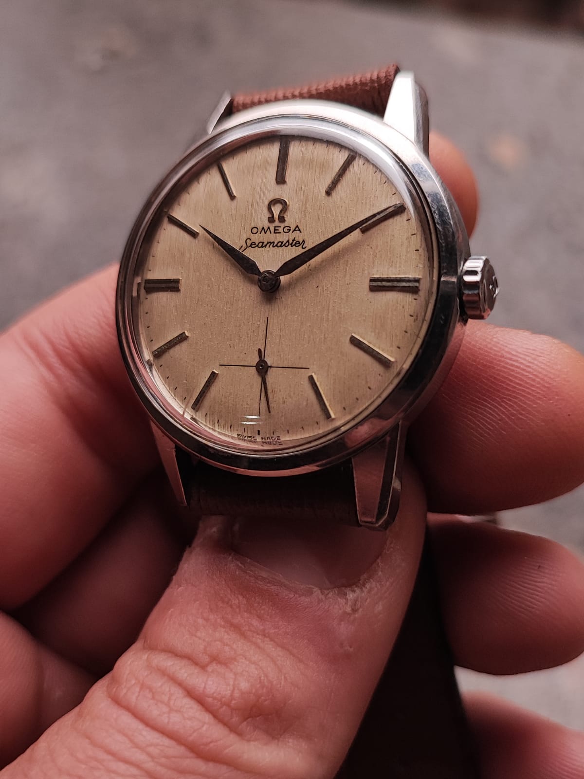

Collectibility is a subjective matter, but to me this is inferior to the 2577s, the earliest Seamaster (together with the 2576) with bumper automatics and a wide variety of dial configurations, an Omega icon. Which is not to say it’s a bad watch by any means - personally, I just find it less exciting. Anyway, I wouldn’t care so much about collectibility as about your own liking.

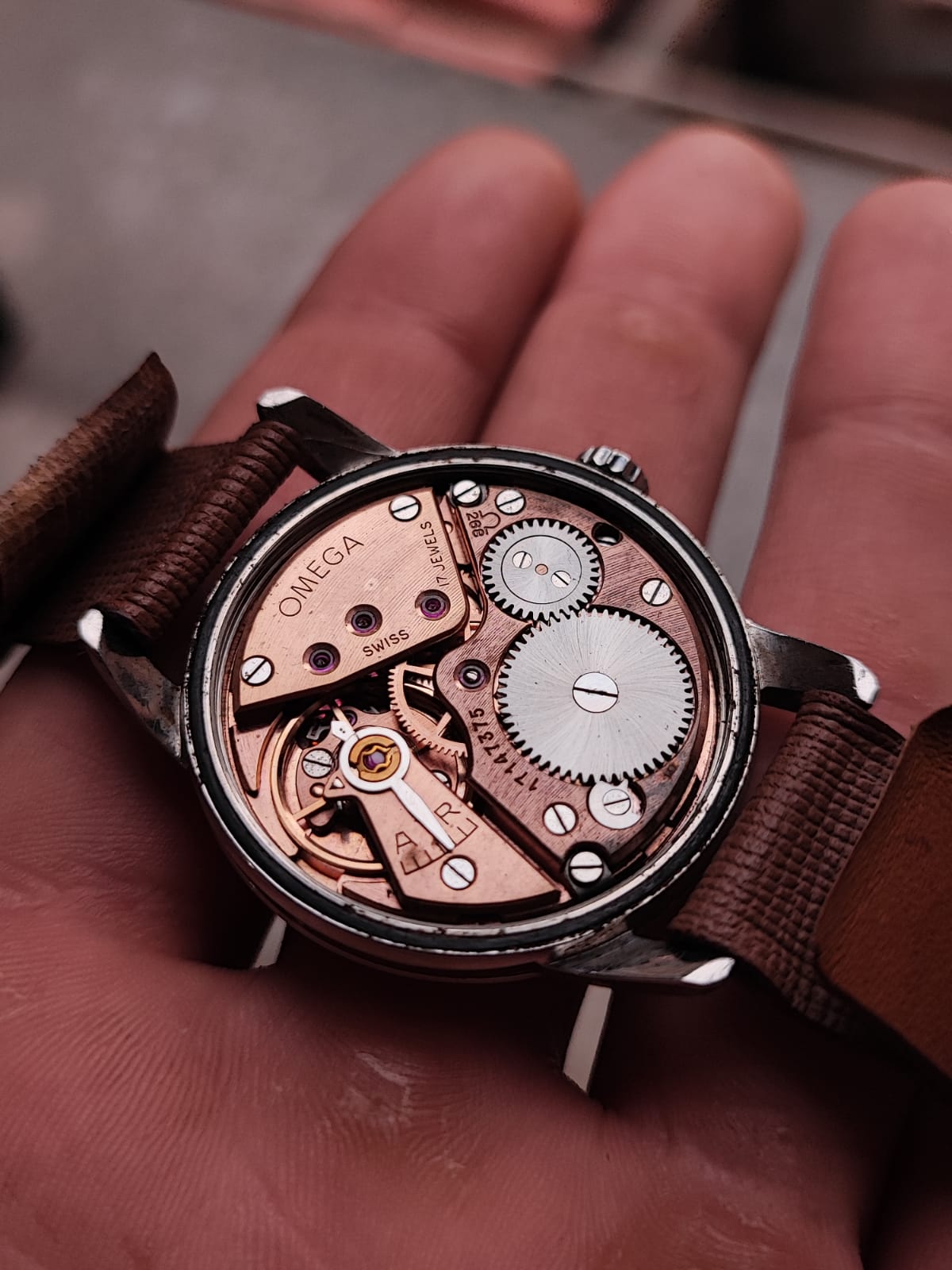

Also, the price is on the high side. The slightly dirty movement with different colors of gold-plating and a half-dissolved gasket suggest a service is necessary. The dial, while a slightly more desirable variant, is dirty and unevenly so, note the lighter spot left of the 3-marker, for example. A quick search in the sold items on eBay suggests this wouldn’t fetch 500€ in an auction. I’d say be patient and keep on hunting for the one piece that’s really yours.

I agree with MtV

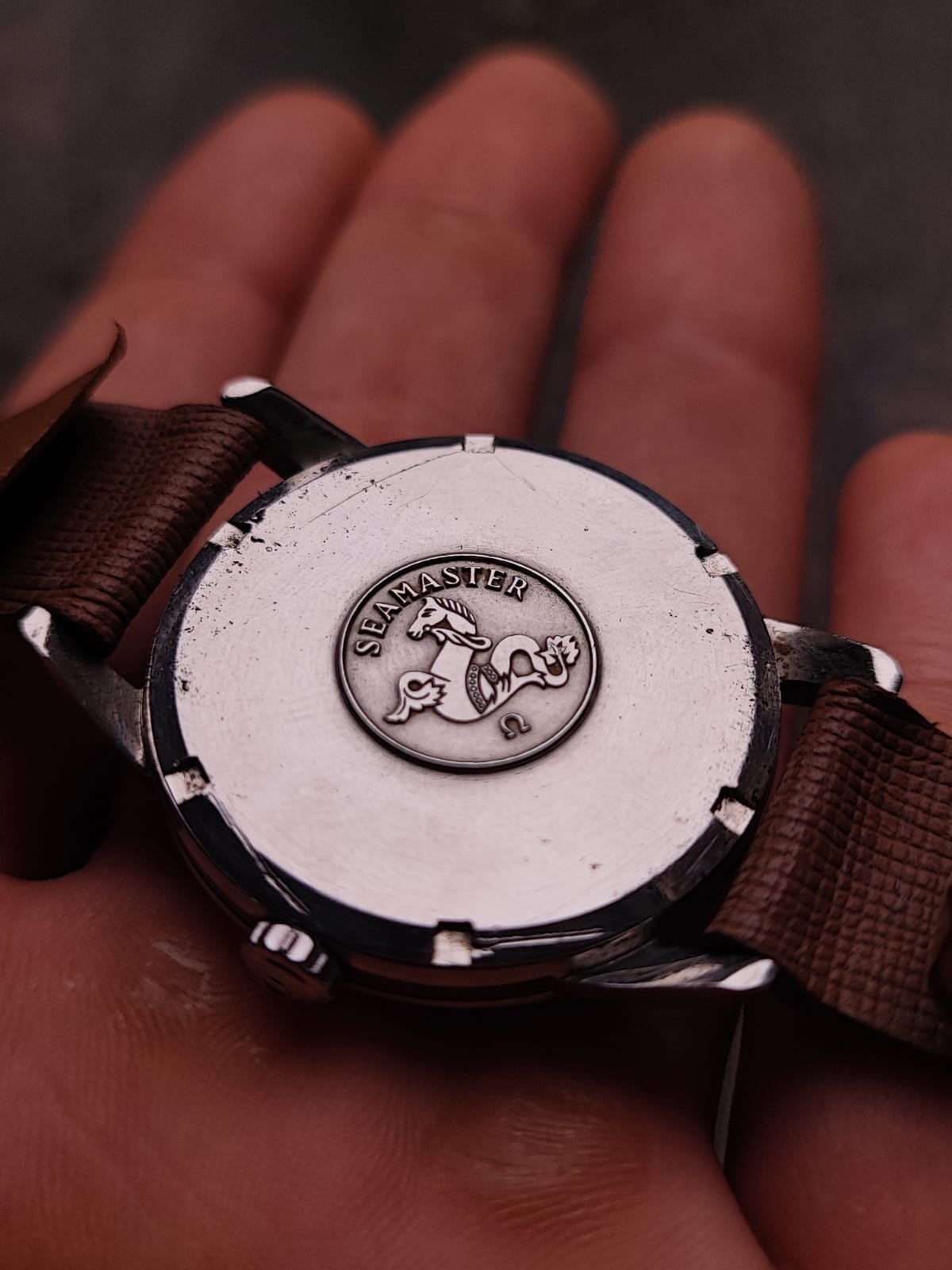

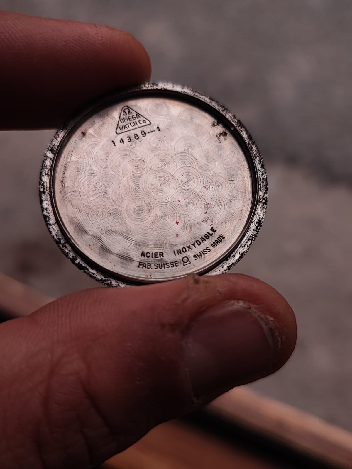

Case has corrosion, deep scratches in the back and set screw is not original (sits deep in the hole)
Overpriced for the condition and to me if I was still restoring
It would be a parts movement

good morning to all, many thanks for yours suggestions, what references numbers should I look for a 36 mm jumbo beefy lug refs ?

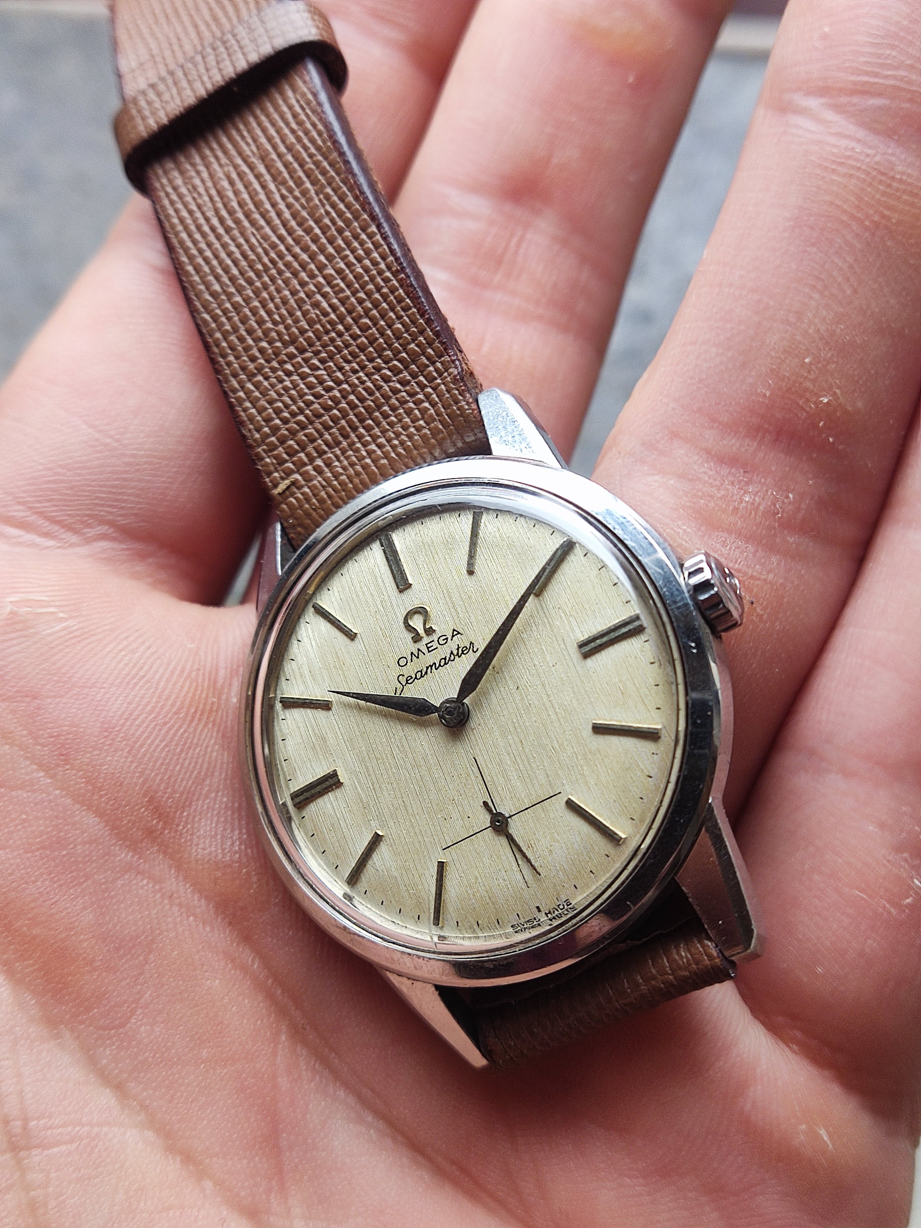

You can also look out for the 2891 Seamaster which has a 36mm diameter with a more flowing look to the lugs which makes it wear a bit bigger. This also has the 266/267 movement which has the more adjustable screw balance instead of the ring balance of the 268.

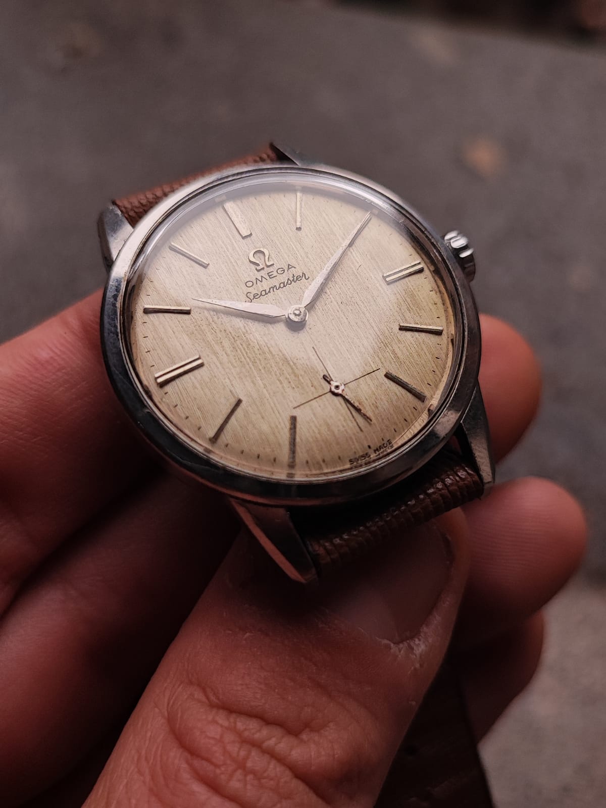

True, though maybe not this particular one, as it’s a redial. 😀

Yeah just found a random one online to show the case, which is pretty destroyed by the polishing wheel as well, maybe not the best example lol

It looks great! Non-lume is a plus too because this model used radium sometimes. Looks unpolished and the bevels on the lugs are nice. These wear larger than beefy lug and dog leg lug cases I would expect a cleaner dial at that price point. Price is a bit high. I owned one in the past... manual wind ratchet wheels are a nightmare to me 😵‍💫
