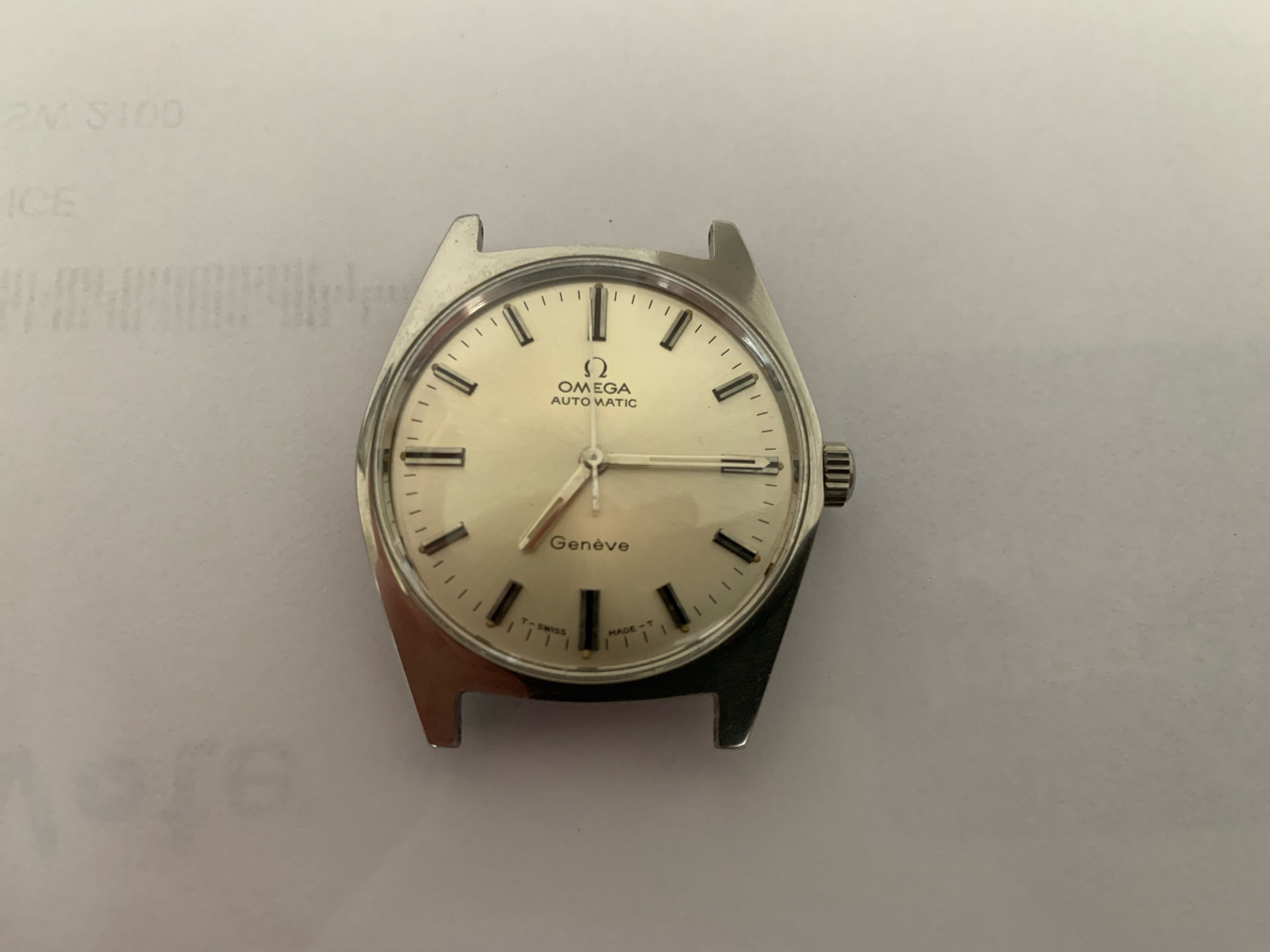

Thoughts on this Geneve?
121
70

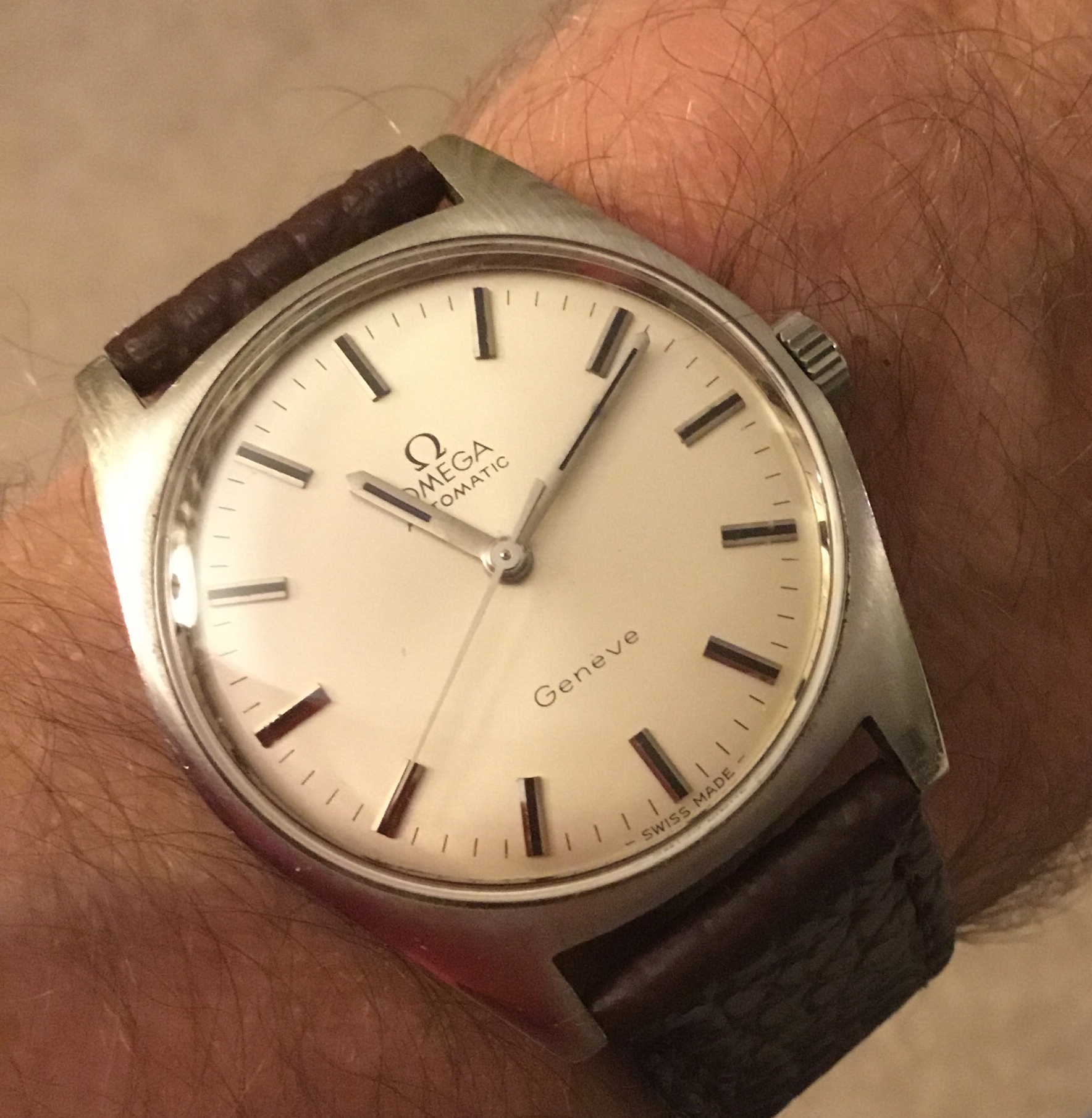

I have a habit of getting carried away with purchases and then becoming paranoid I've been taken for a ride, in this case I've been watching this forum since I purchased this back in sept, looking for something similar but realising that every watch seems to have variances and finally decided to take the plunge and ask.
Suspicions around:
1. The painted/printed logo but then I see plenty of others, even ones recommended here after reading 'if its not embossed/raised its fake'
2. The polished nature... I'm guessing it has been polished at very least.. guess that happens.
The face has a slightly tinted/yellow finish as can be seen, not sure how close to original that would be.
Heres the twist though... it was sold as not working, but was working fine when it arrived but since stopped again. Will be getting it serviced if its legit.
Please put me out of my misery ;p
415
1,090
Geeetings. Your watch is a 165.041 and the dial looks original. Google the reference number and you’ll see examples that look very much like yours. There seems to be considerable lume loss in the minutes hand and the case, as you mention, is polished. An untouched case will have brushing on the top and quite sharp edges. Hope that helps
121
70
Many thanks, yes there is no lume at all, and being maybe naive thought that was normal. I'll need to get on with the servicing then. I don't mind the polished finish, sure it's not original but I liked it enough to purchase in the first place.

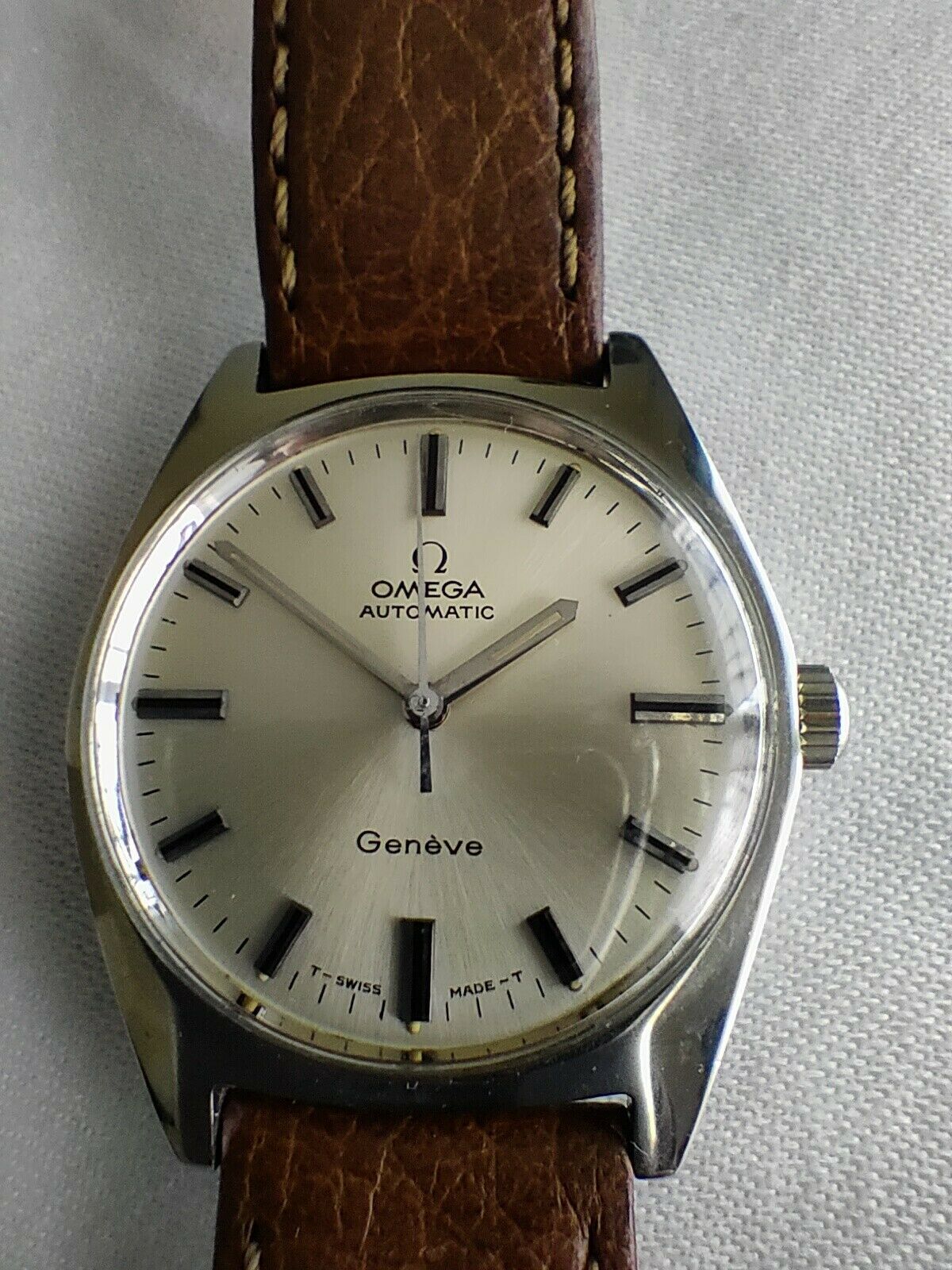

Hello Grog, and welcome to the forum!
Beautiful piece, I especially like that case shape.
I recently sold a Geneve with a raised logo, serial in the 30M range, approx 1969~1970. Lovely little piece, (I need to stop wondering whether I should have kept it.)
img_20211121_121052-2-jpg.1322431
Another forum member, @Toishome , recently sold a Geneve with a painted/printed logo, serial number in the 32M range, approx 1970. Also beautiful, with a design leaning more toward the '70s than '60s. Picture below is theirs:
img_0377-jpg.1309910
Interestingly, your watch has a dial similar to the second one, but hands like the first.

And the case is different to both, ie the shape of the lugs. I do wonder what it was like before the polished it i.e. condition not the finish itself.
963
1,252
Yours is 165.041, the ones I posted are 135.070.

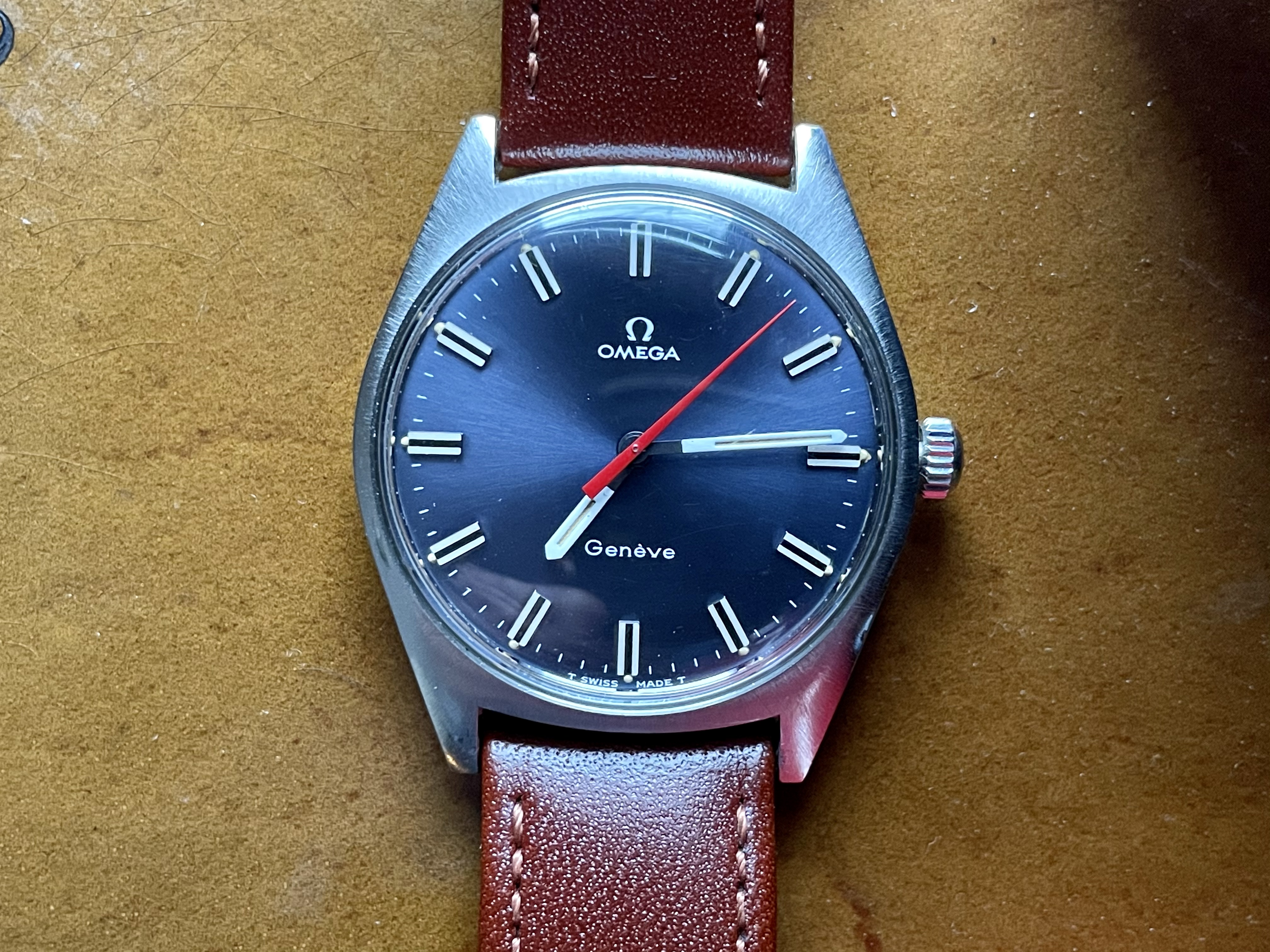

Here's an unpolished 136.041 @flqt-9000 sold recently. Same case as yours, manual movement, with date. Pics are theirs:
dsc_5013-png.1259001
dsc_5020-png.1259007
415
1,090
The 041s, which these are generally referred to (note that the last 3 digits refer to the case itself), have a ton of fun variations (the OPs and the one above included). This is one from my collection and you can see the brushing on the case quite clearly:

The hands may have been replaced. I would have expected some black inlay to match the markers. Also, the hour and minute hand appear to have different shapes (one is straight and flat and one is tapered with a central ridge).
121
70
My thoughts are that this is not the best example for reasons others have pointed out. If you can recoop most of your costs by selling it on eBay, I would. Then watch this thread for tips from @dsio. He regularly recommends nice entry level Omegas in honest condition.
https://omegaforums.net/threads/rec...-watches-only-on-ebay-not-for-inquiries.1790/
I have no desire to recoop as you put it, its as you say no the best example, but its a start. It will go in for a service if i can find someone nearby (Sydney, Aus) and ask if they can maybe sort the lume.
349
228
Service hands are available, but will not match the tritium on the dial. Not a massive deal on a watch you are fixing up.
Some watchmakers can reapply the case brushing. They need a special lapping wheel to do so, not all places have one.

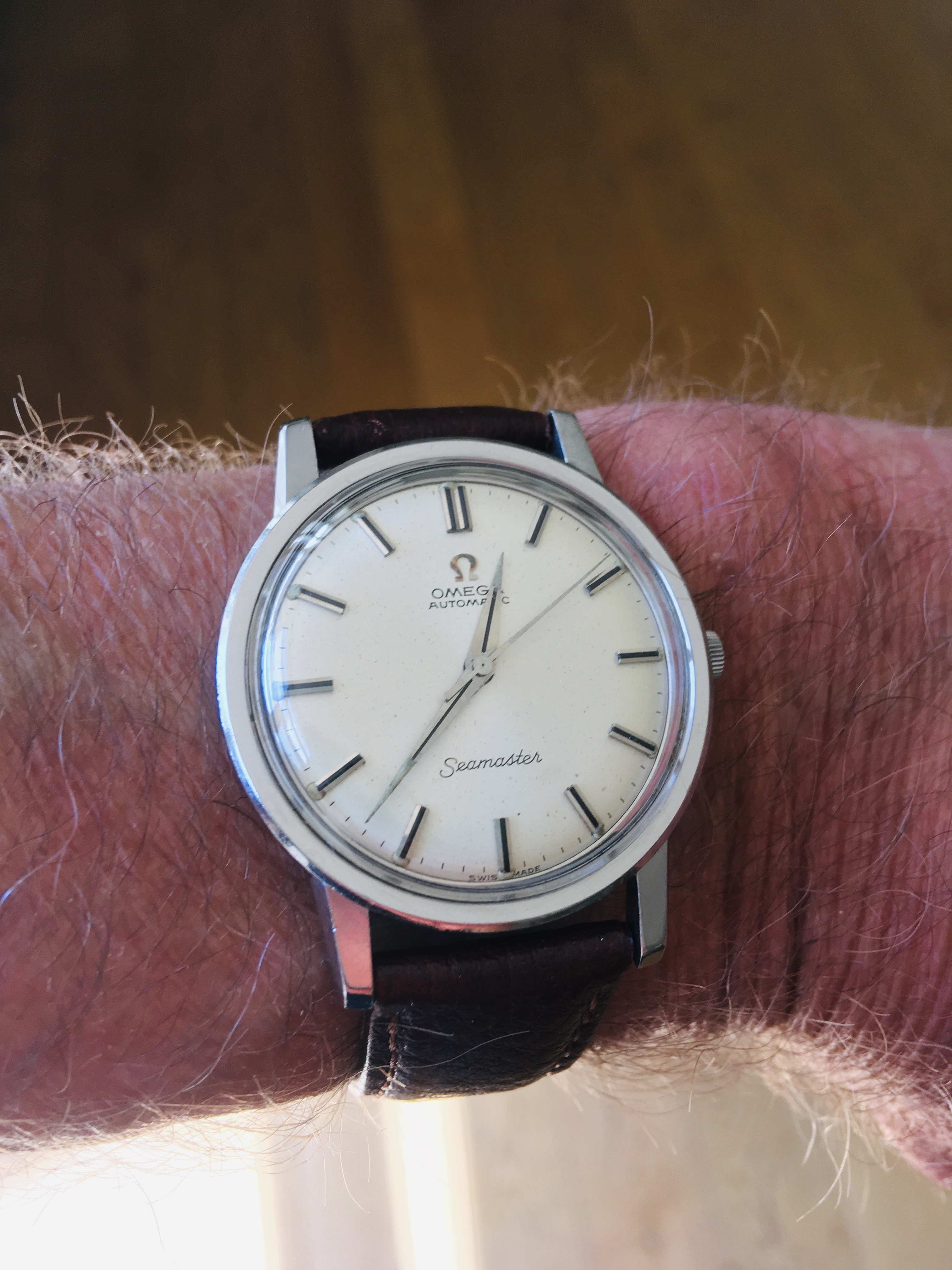

9,381
78,516
A previous owner had applied lume to the ends of the hands. A man on a galloping horse wouldn’t have noticed but it niggled and when I put the watch in for service I also got the hands cleaned/restored.
Almost too nice to wear now - 😀

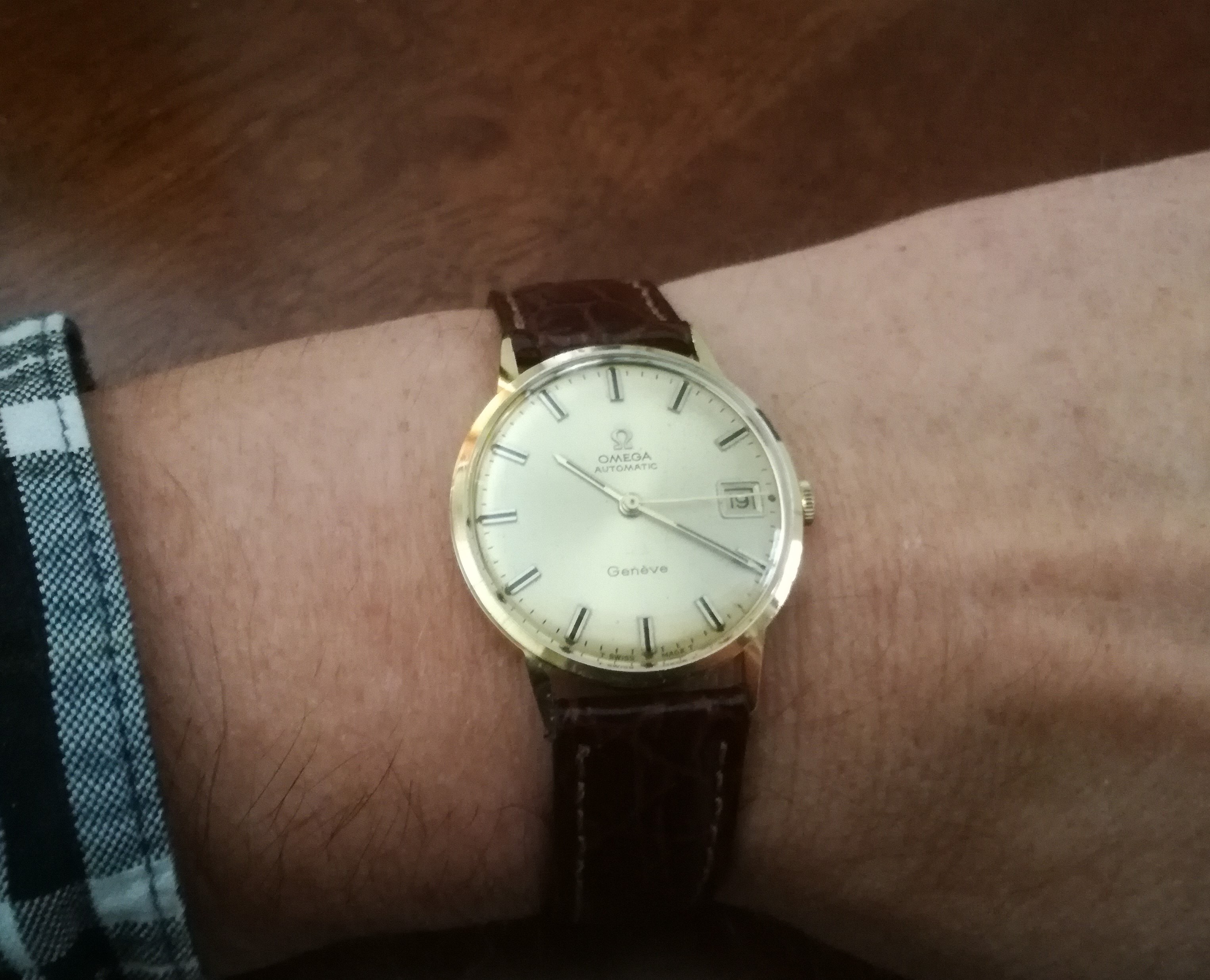

Hello from my Geneve. It is 18k and I belive it to be mid 60s?
