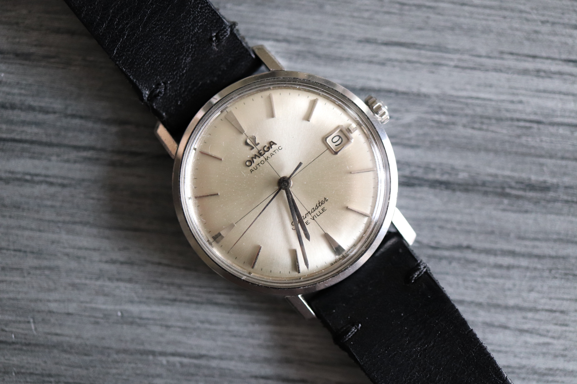

Can you help a new member/recent lurker with a potential purchase? I've been trying to accumulate enough knowledge to buy a watch as a gift. Which means I now understand that I know pretty much nothing.
I've found something nice. It checks off almost all my criteria - date function, automatic, 500 series caliber, Seamaster or Constellation, stylish, not horribly modified and in nice enough shape to be a gift to an Omega fan.
Better yet, it's being sold by an OF member. He suggested that I post photos and ask for comments. So here goes.
Case/Caliber
Collection - Seamaster Deville
Case - 165.020
Caliber - 550 caliber.
That case and caliber combination doesn't show up on omegawatches.com/vintage-watches but I've seen the combination elsewhere for a 1965 watch and the cal comes up for an automatic DeVille on Mondodec's caliber listing. So that seems to check out.
Serial number - I don't know

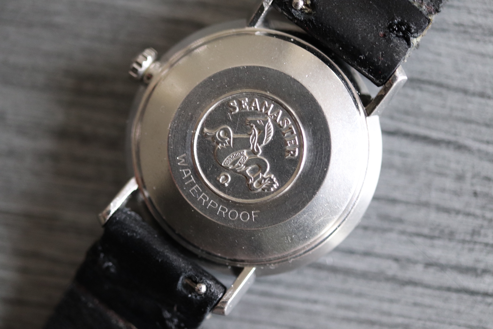

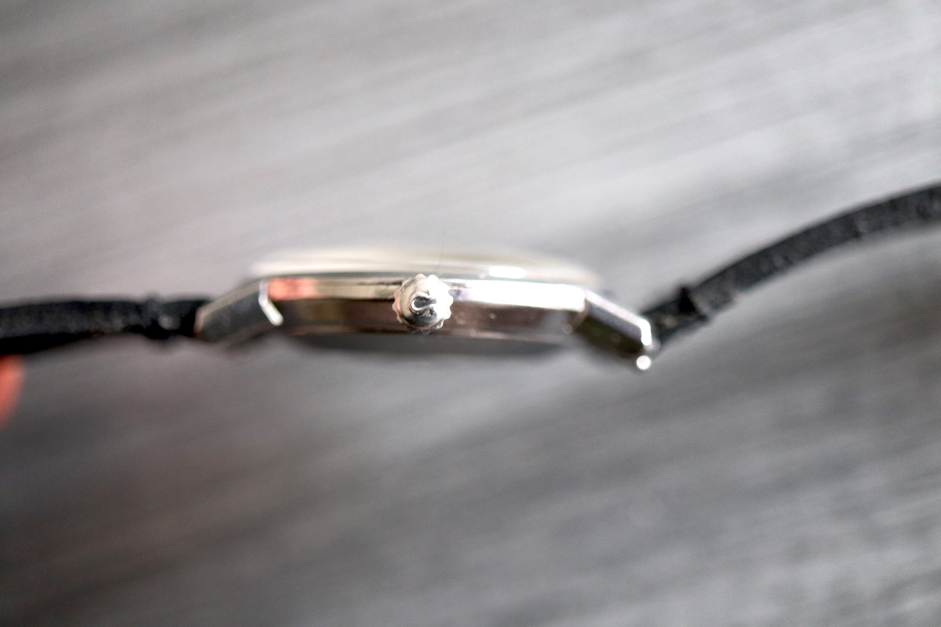

He indicated the case has to be opened by a watchmaker; the watch is thin so I guess it might be one of those one-piece cases I've read about in some Devilles, maybe all Devilles have them.
Condition - well, wow, look at it. Works for me. Back is maybe a little worn but hippocampus seems sharp.
Strap - Sigh. Less than ideal (leather is fine but maybe not this leather). But not a big deal. I've seen this strap elsewhere though, maybe it is original although 50 yrs later that seems unlikely.
Original?
He says all original, not redialed or any other alterations.

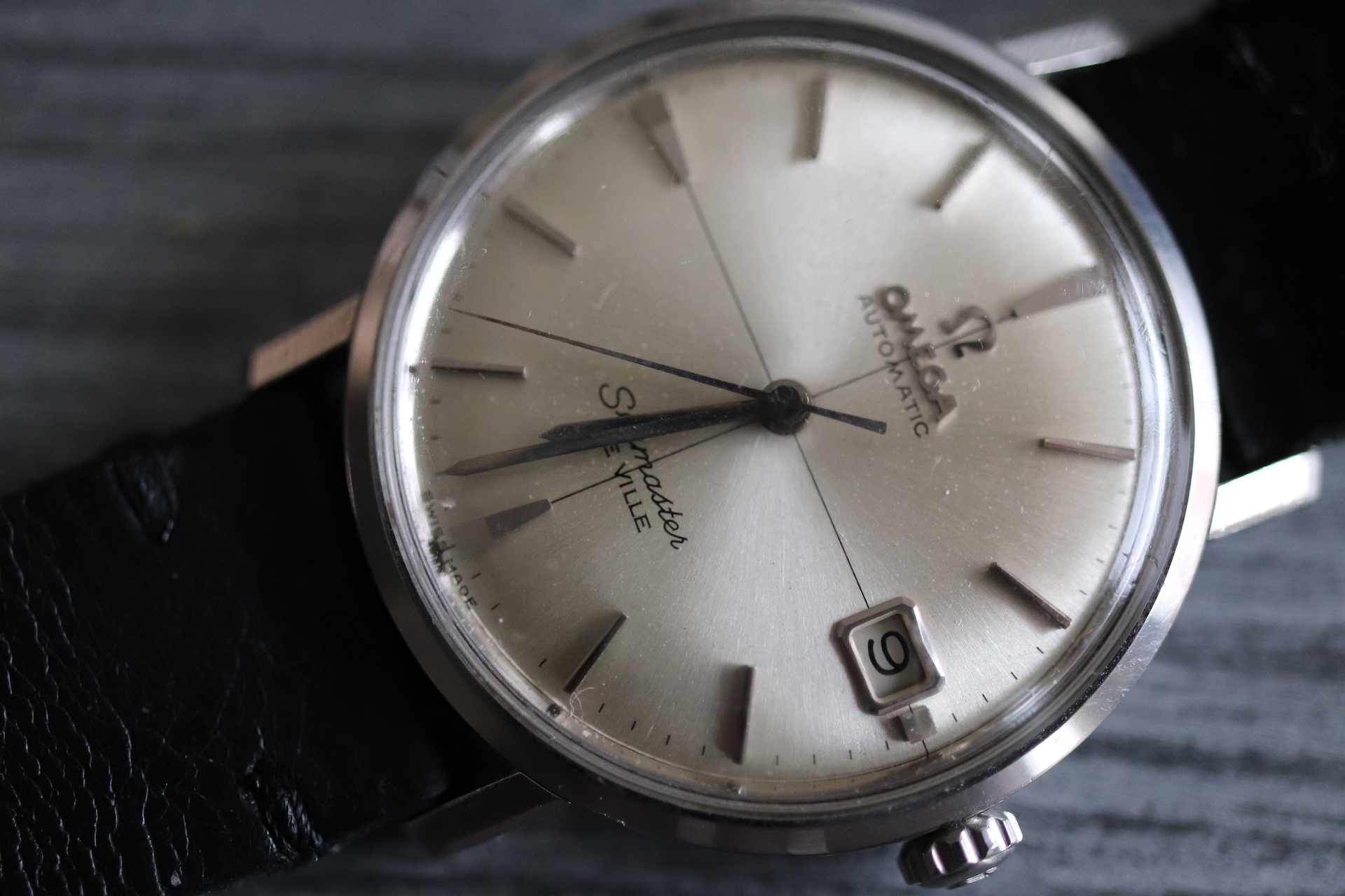

Looks not very polished (angles seem sharp and being stainless helps I guess). I can't see any of the redial indicators that I've learned (font, pen thickness, minute/second hands hit the minute marks, second S in Swiss lines up with 6 o'clock). Crystal and crown have Omega symbols and it's a typical Seamaster crown.
Movement
Very unfortunately he doesn't have photos and can't open the case. So I don't know 17 vs 24 jewels (conceptually that seems significant but perhaps not practically, I'm not sure) and I can't verify the caliber or look for things like copper plating stripped away from the brass by rotor rubbing or a mismatched bridge or lousy case clamp etc etc. But then, the OF member says all original and has good reviews and he seems extremely trustworthy. To the point where he advised me that if I could wait, he would take it in for servicing before selling, to find out if it needs any significant work.
But I would really rather not wait since I've been looking for a couple of months and trying to find something for a birthday that comes up next weekend (the seller is local to me). Yes buying emotionally is dumb, but it's someone else's emotions and he's on his own in isolation, so small things easily become larger things and I think the timing would mean something to him. Yes I should have started six months ago (some OF members would say 6 years ago I think), but who knew I would have to learn a profession to choose a watch, or learn that there are predator sellers?!
Price
$1000 US. Plus what it will cost for servicing. That's a lot of cash for me, but it seems comparable to others I've seen in this type of condition. At least, in my extremely limited experience as a newbie. It's a gift, not an investment, but I'm trying to be cautious (despite the admittedly ill-advised move of considering buying without servicing...).
Thanks for being patient to read my long description (or at least to skip to the end). Any thoughts would be more than appreciated!

Buy it, before someone else does.
In this game there is three rules.
condition condition condition
and it passes all 3

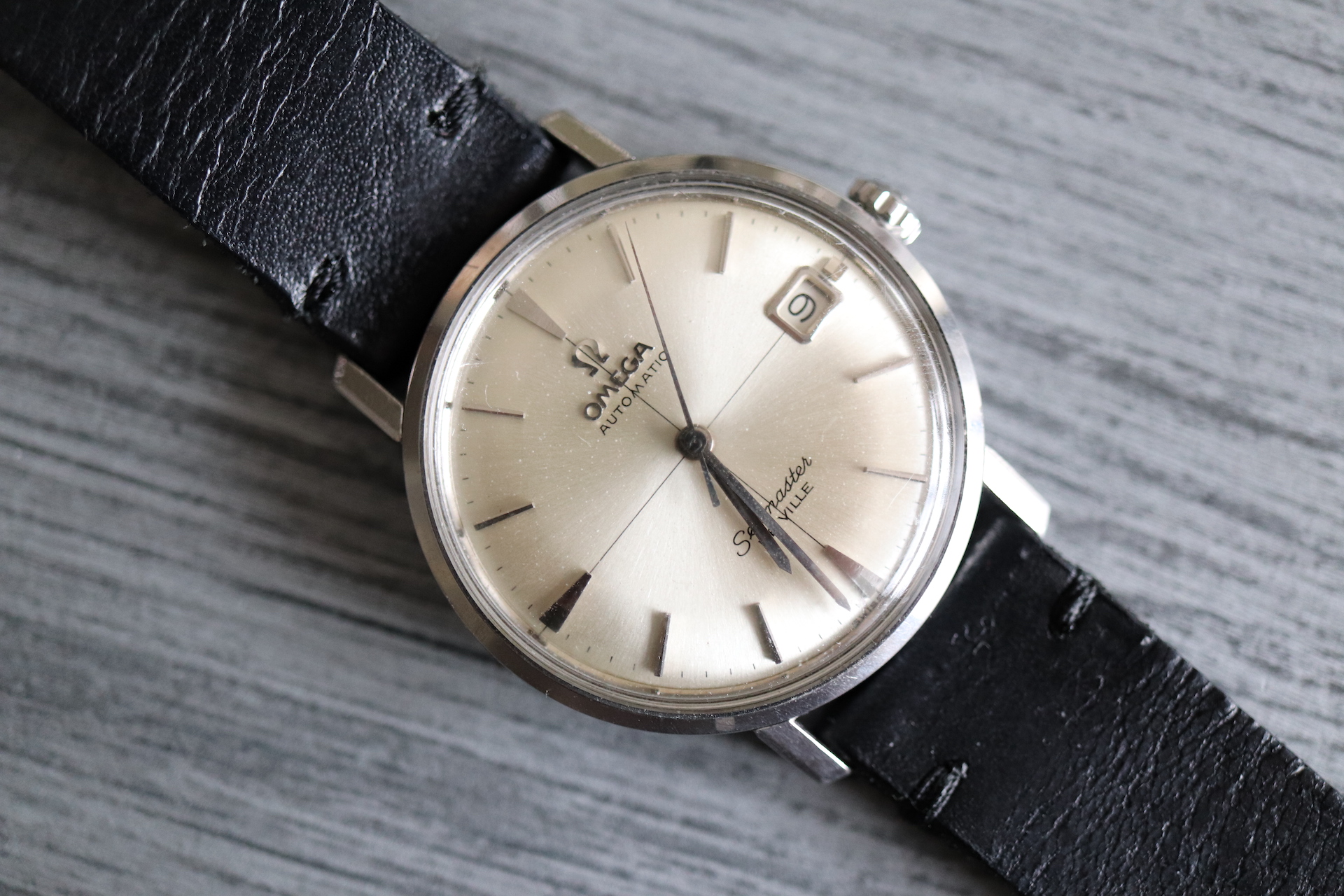

The dial looks original (has some slight spotting). The crown and hands also look original which is a plus. Overall it looks like a nice early Seamaster DeVille.
As a comparison I sold this DeVille (below) last year, with its original rice bead bracelet, excellent, original are rare 'sigma' dial for £795 GBP.
Thanks, that is reassuring. I hadn't heard about sigma dials (or noticed sigmas instead of a T or hyphen) and just read a brief article on them. That's interesting. That is one nice watch. The onyx is perfect too.

Oh, a new collector interested in a Seamaster DeVille - how extraordinary 😁 😁
Very good looking watch, price reflects this. If you were willing to spend time and effort into looking for something comparable, my guess is that you could save up to $3-400 and dig up something similar. I can well understand that you wouldn't want to go down that route, however.
You are right in saying that the strap is a mismatch to the sleek watch. A simple and appropriate leather strap shouldn't be very costly, so don't fret to much over that.
Very well done research, I'll forward new members to this thread to show how it should be done.
+1.
Also, crosshair is nice, you don't see them too often with those.
For the record: It is not a 165.020, those are without date. It's probably a 166.020 with a 562 or 565 movement (560 or 563 respectively for 17J US models).

That might be spotting on the dial or it might simply be dust on the crystal. I think it's dust as you can also see it on the hands and the applied name and logo.
IMO the Seamaster Deville is an underappreciated line. It's possible as @ConElPueblo says that you might find one as good for less money, but it would take a lot of hard work. Good examples seem to be quite scarce (at least in the UK, which is the only place I look) - I see considerably more Constellations, which command much higher prices.
I don't think you could go wrong with this one as a gift. And if the seller knows it's a 550 movement, which is quite likely in the US, then it's 17J. I'm no watchmaker but everyone on here seems to think the quality of those movements is excellent, so I wouldn't worry about that.
