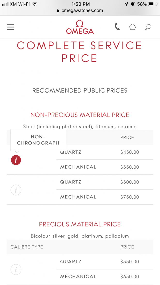

So let me throw this out here. As a bench mark, If I asked Omega to fix this watch what do you think they would quote?

At least $550.00

They’ll do a routine service(overhaul). I just had my 2254 and my 2531 done from Omega. Each one was $608.00. That’s included shipping which was $25.00.

Look at it this way, you're actually coming out ahead financially at this point LOL. Had you never had an issue with the watch and worn it all this time and maintained it as you should, you would have serviced it at least twice in 16 years, maybe even three times. So forgetting about it and not seeming to really care again until now is a good thing for you. Get it serviced and it'll be like you just got a new Seamaster.

Regardless of its operation it really needed a service 7 years ago. In fact it probably should have had 2 by now.
A service would correct the issue anyway.
