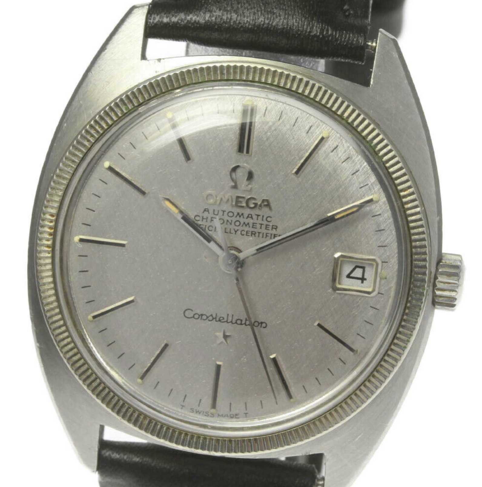

Thoughts on Omega 168.027
I was hoping to obtain some opinion/clarification, I have obtained this Omega 168.027 Serial No 25,656,659 and I have now learned about the MOY test which it looks like this one does not meet, but all else looks fair? Is this a redial or a manufacturer's variation? I think I have seen on another forum someone with a similar MOY alignment and discussion was that it may be authentic/original? Thanks for the time and consideration.
5,026
18,608
MOY is just one of the tools for assessment of a connie but it's not 100%. There are a lot of connies without the MOY allignment which are authentic. With this one I dont see any red flags. I would say it's a legit dial.
214
188
I would read Desmond’s Constellation blog on dials part 1 and 2. There is lots of helpful information in regards to everything Constellation.
