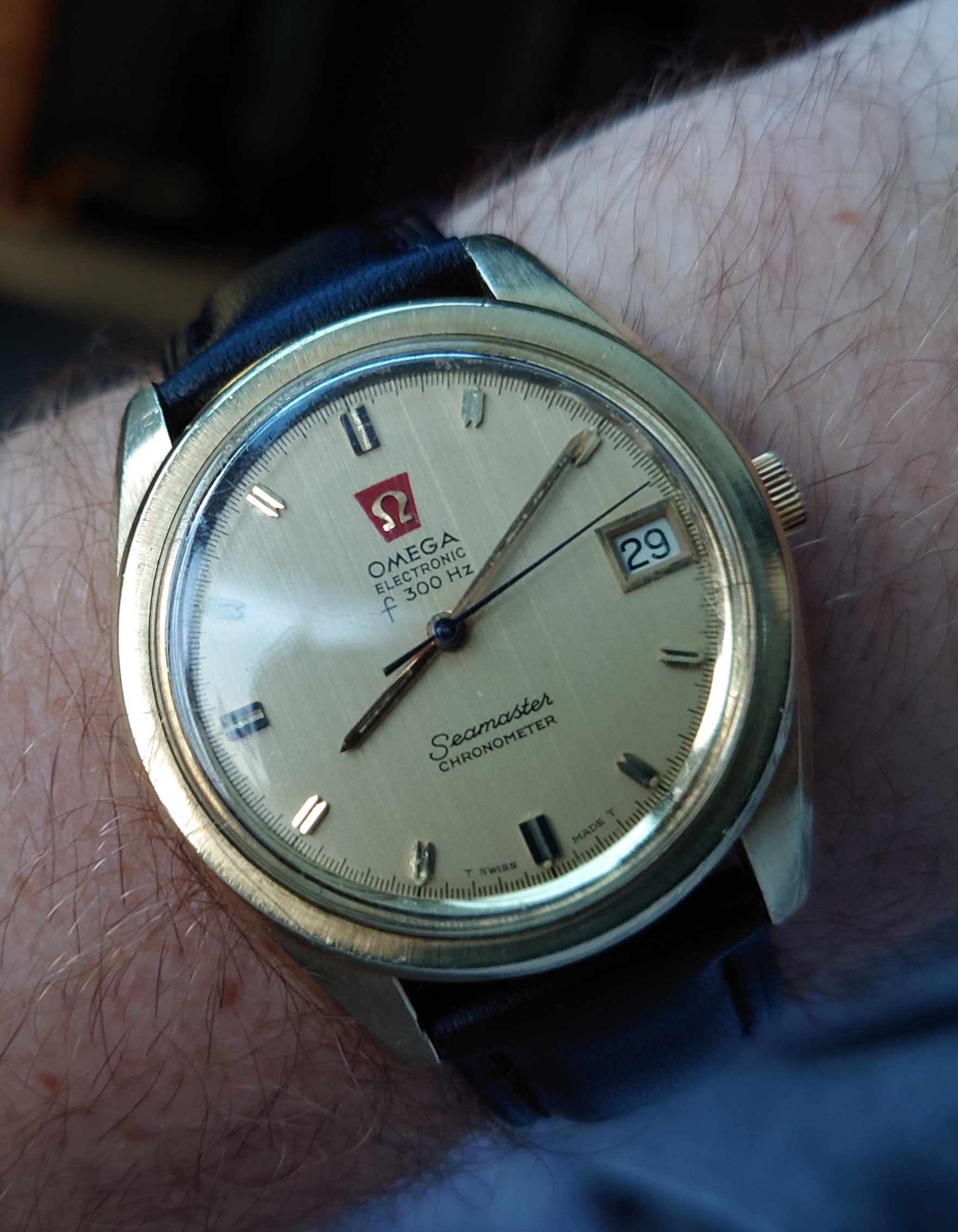

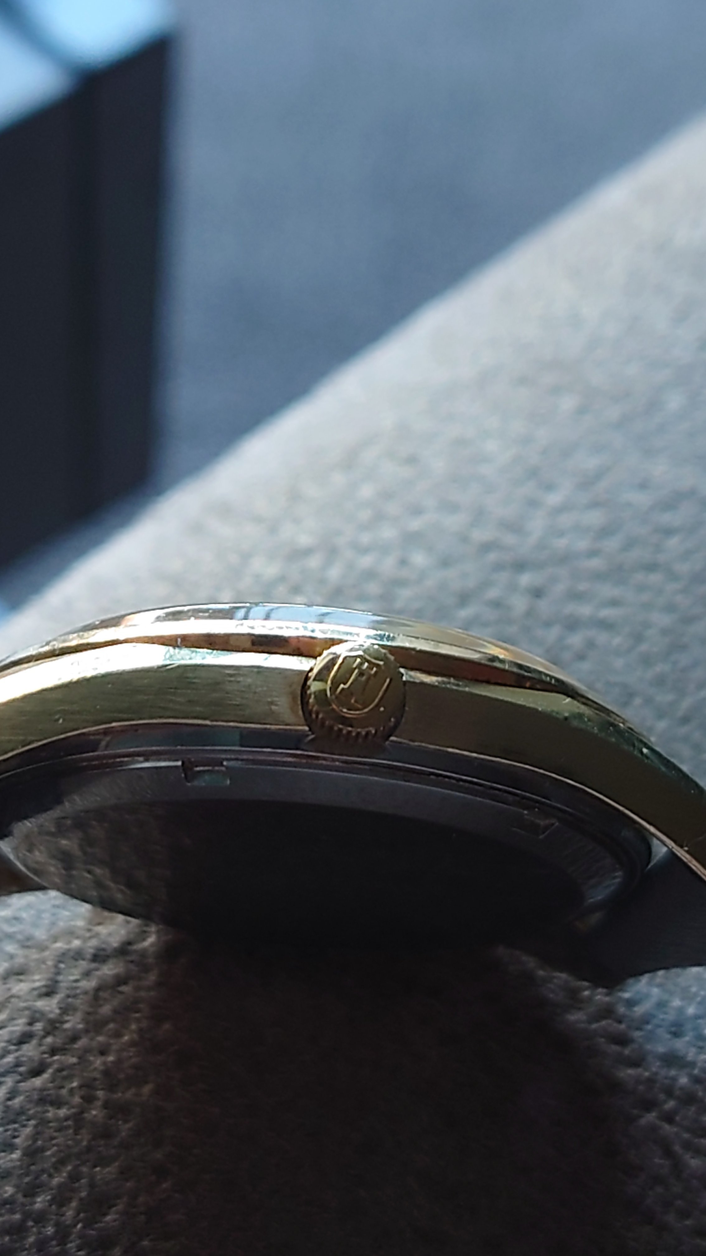

Good evening all just recently picked up this seamaster f300 chronometer at what I believe a very good price. I think it's all genuine Dial/ crystal with logo in the centre and case in good condition maybe slightly over polished as this should be brushed?? . My question is the crown I'm trying to find an original or anything close the case number is 198.001 but looks like 199.001 could be my eyes lol. If anyone knows a part number etc would be much appreciated. If anyone has any information what this Crown was originally off would be cool or what you think about it if I should leave it or change it. Thanks

Nice watch. One of my favorite case designs, as an owner of a 168.022.
According to this reference, it takes crown (SX)43067. SX is for gold plated and you can omit it when searching (in eBay for example). This one looks like it does the job: https://www.ebay.com/itm/143992458123
Perfect thankyou. Yea I'm pleased with it. Dial in perfect condition just a few very light scratches to crystal should polish out easily
