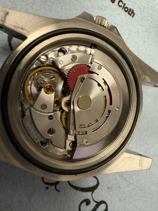

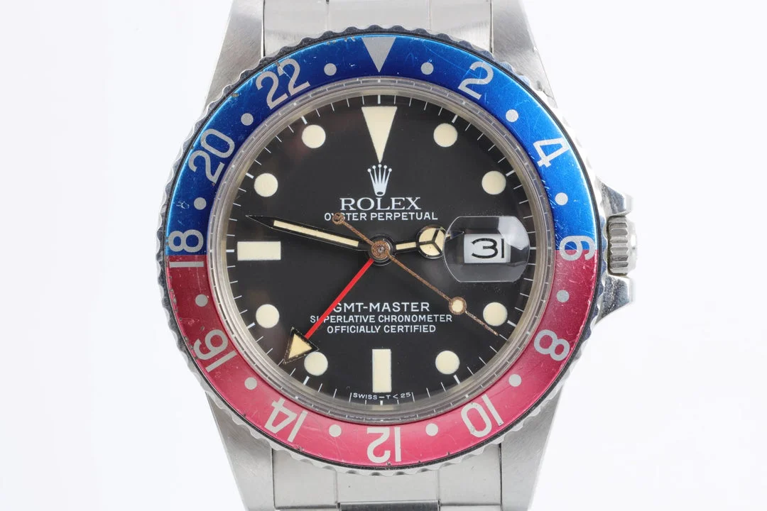

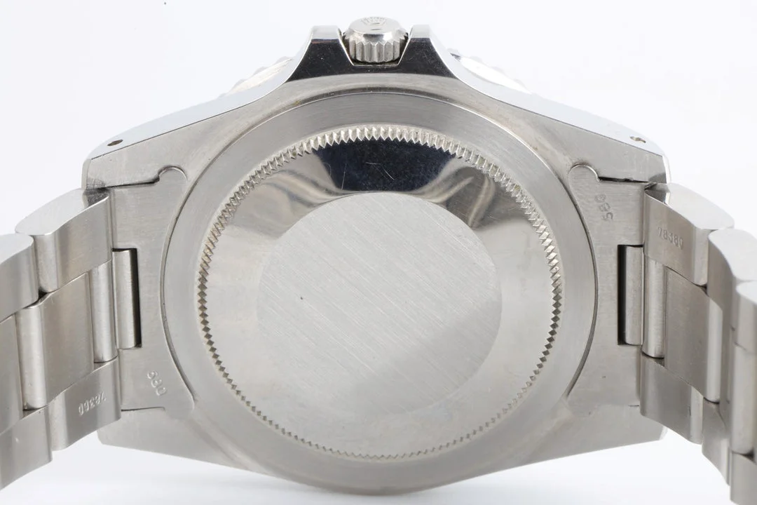

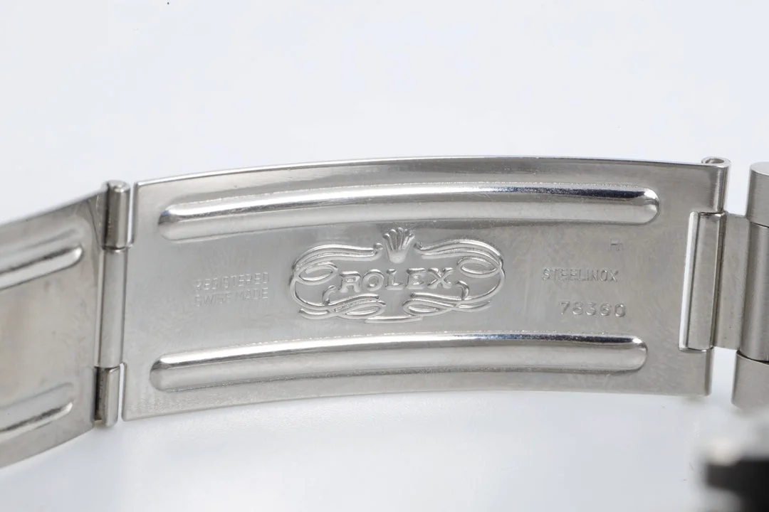

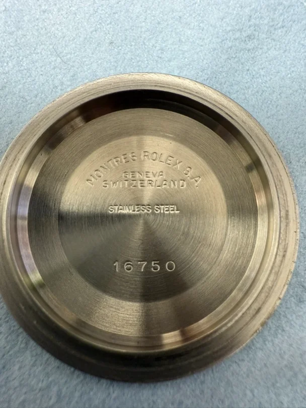

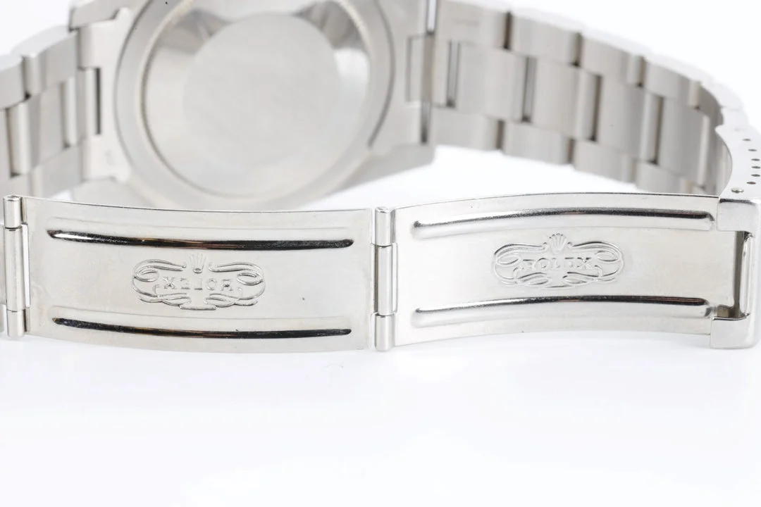

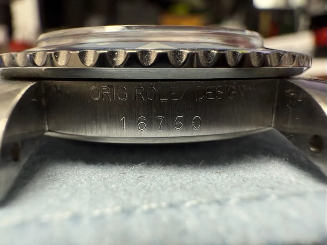

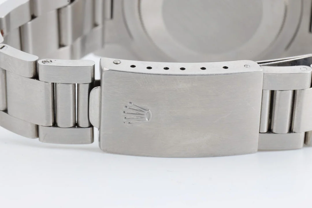

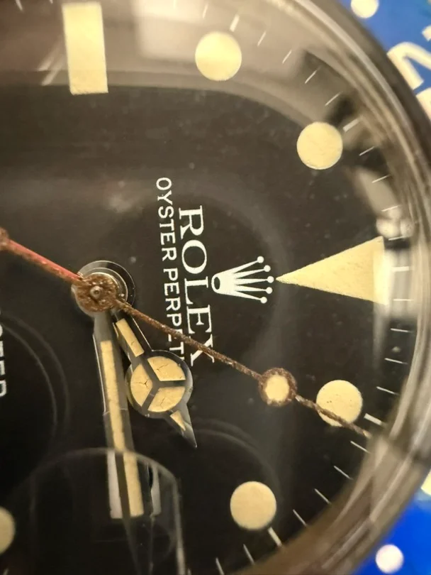

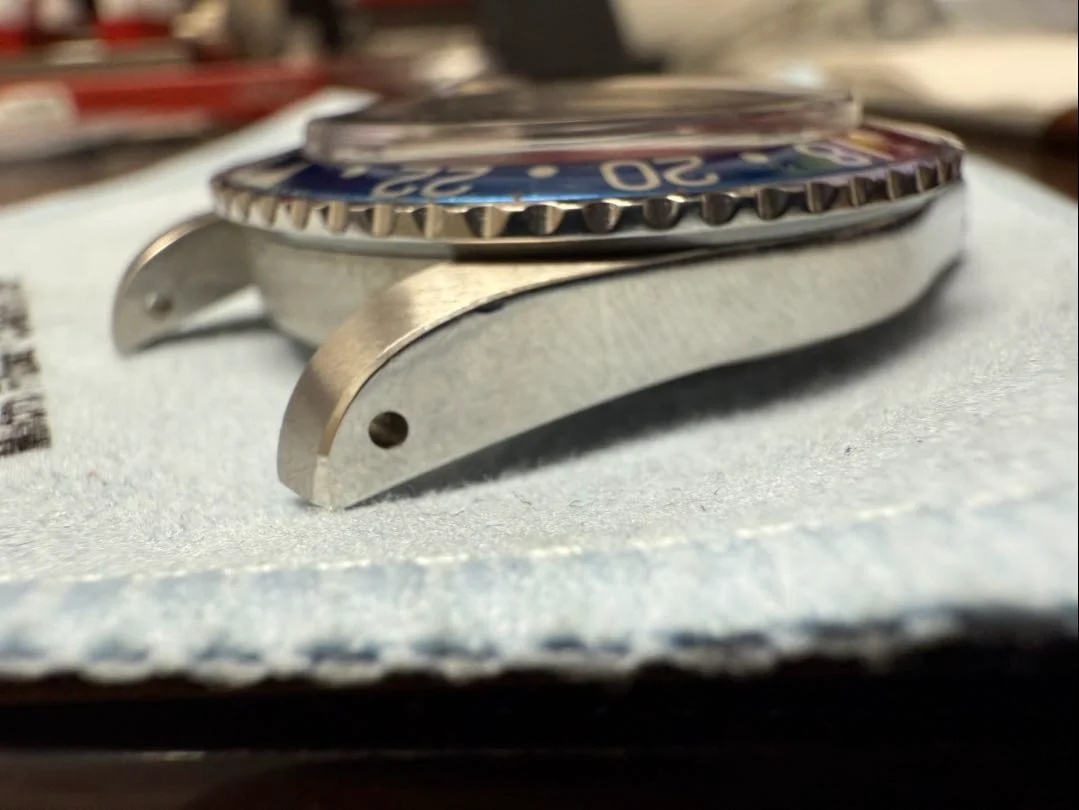

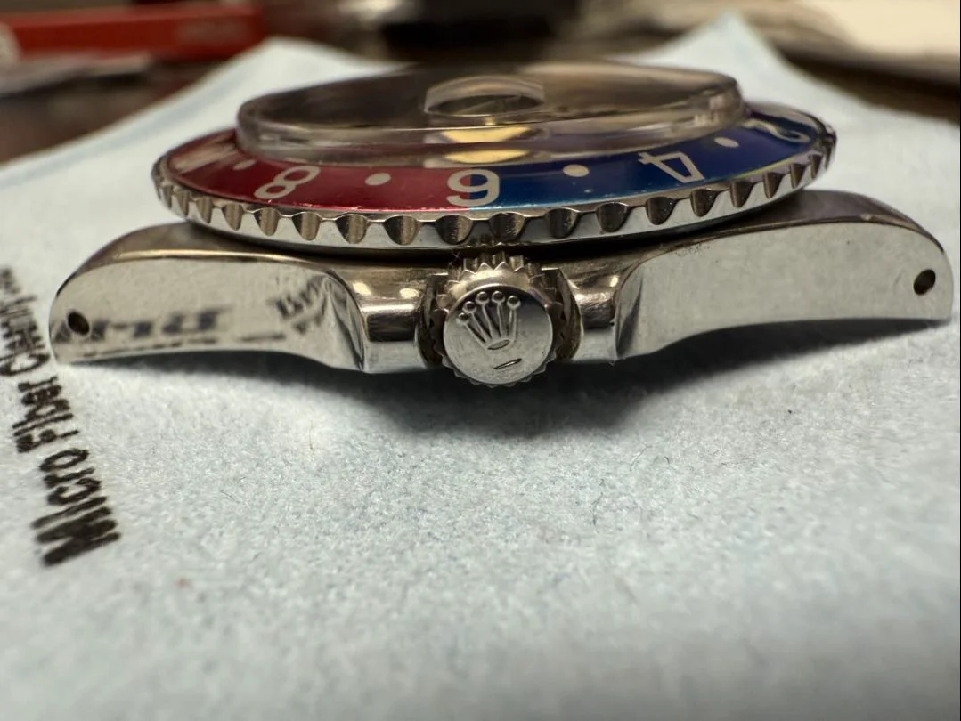

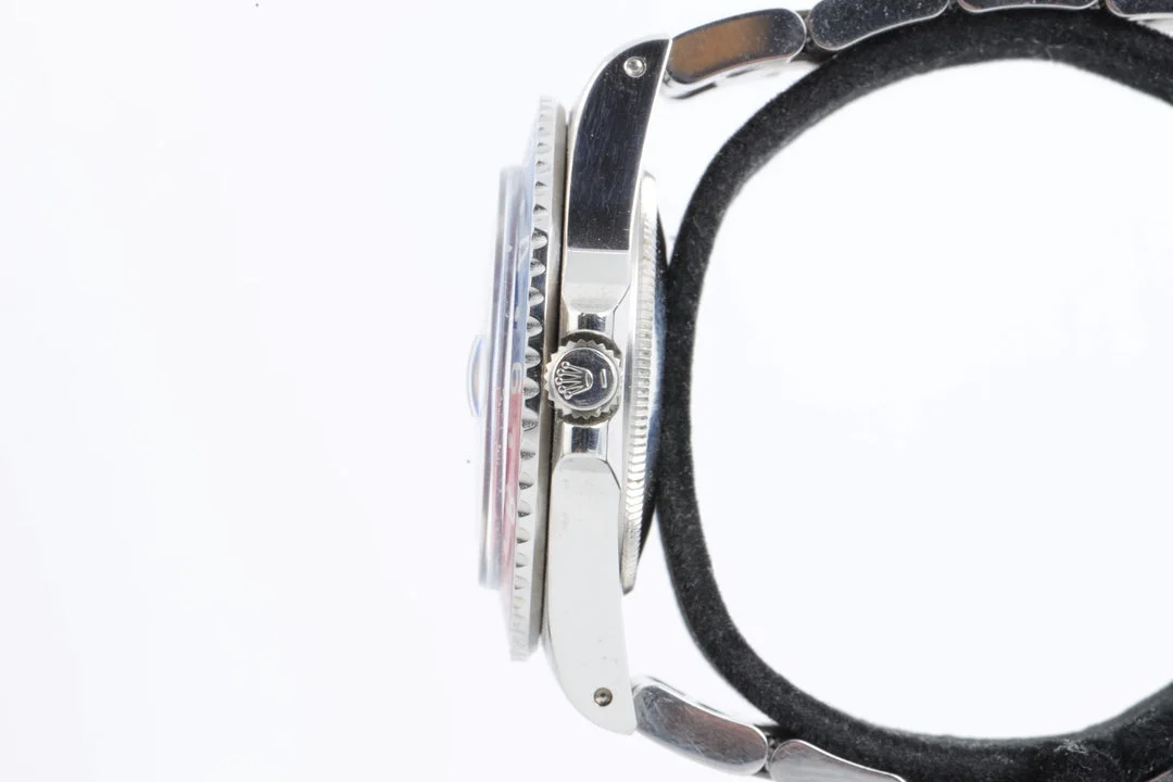

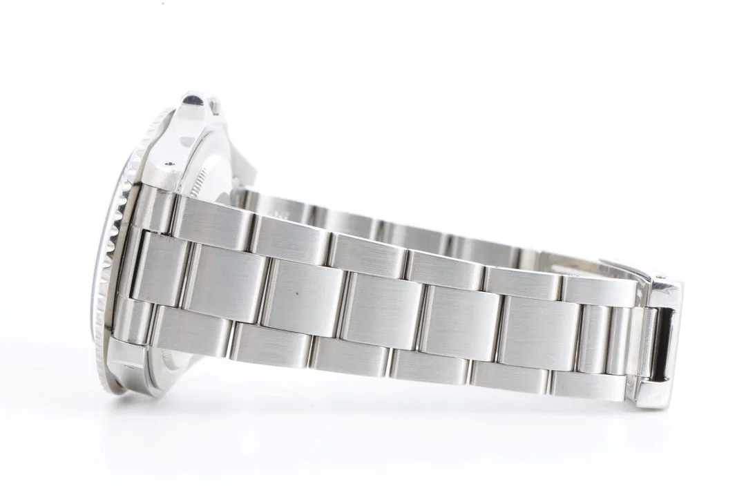

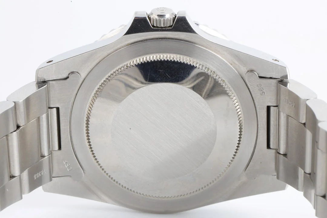

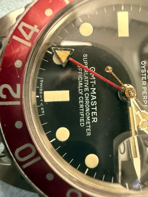

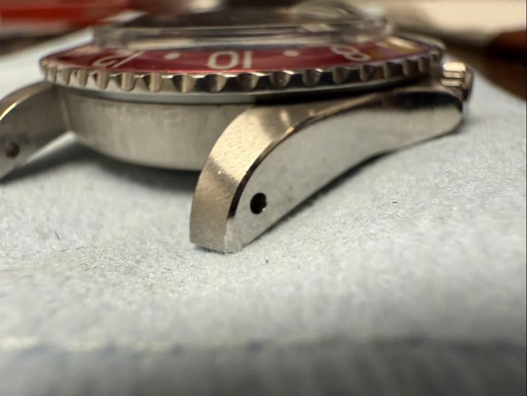

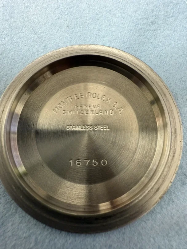

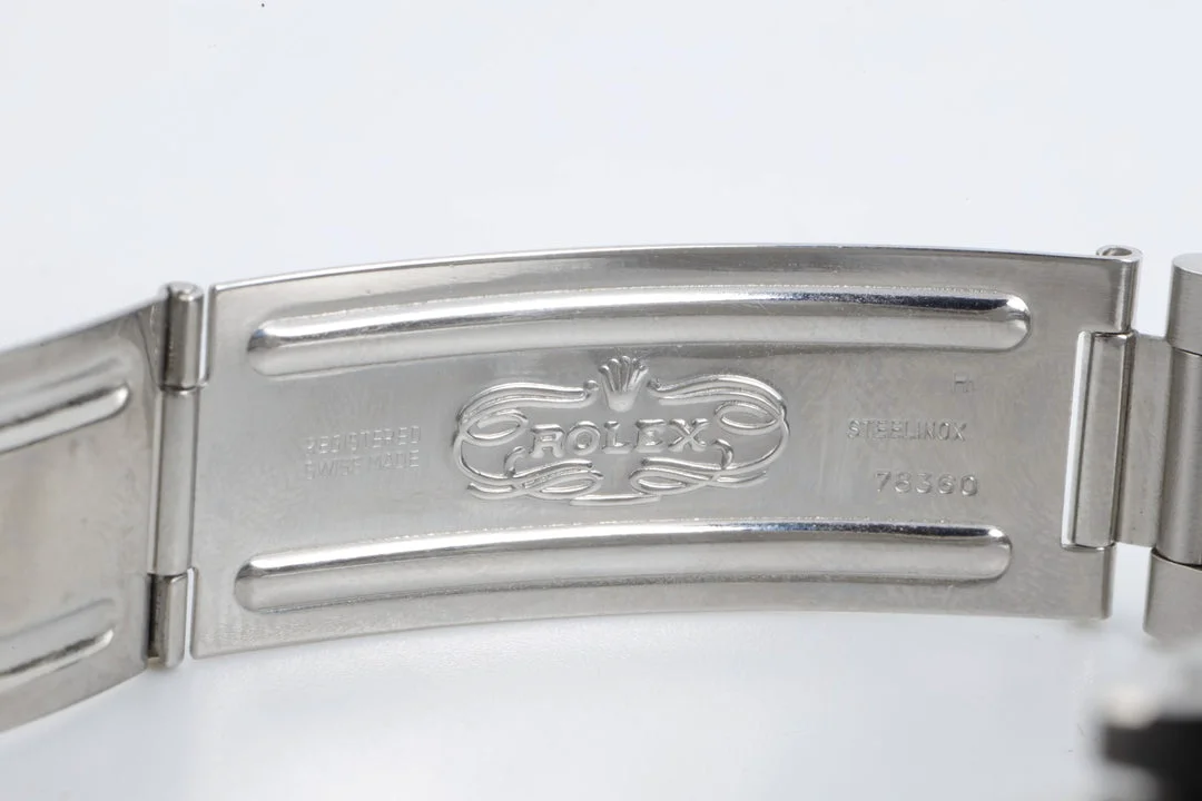

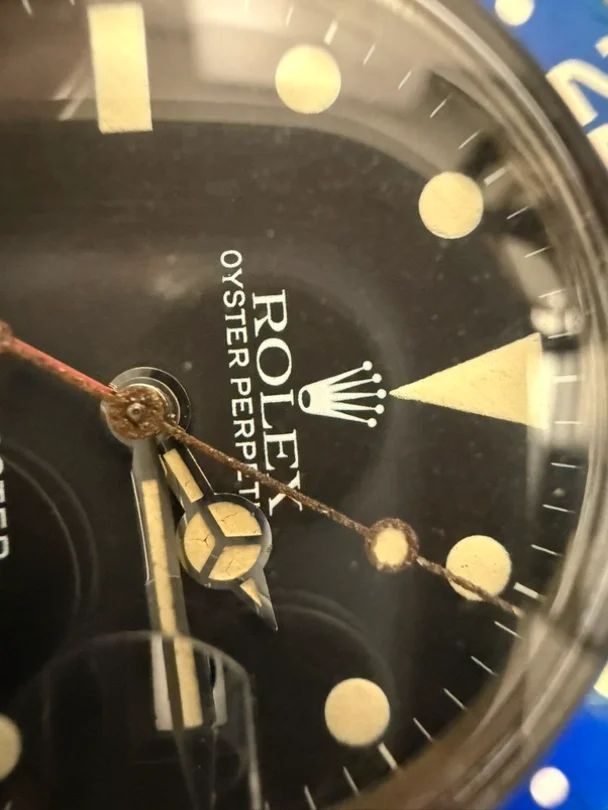

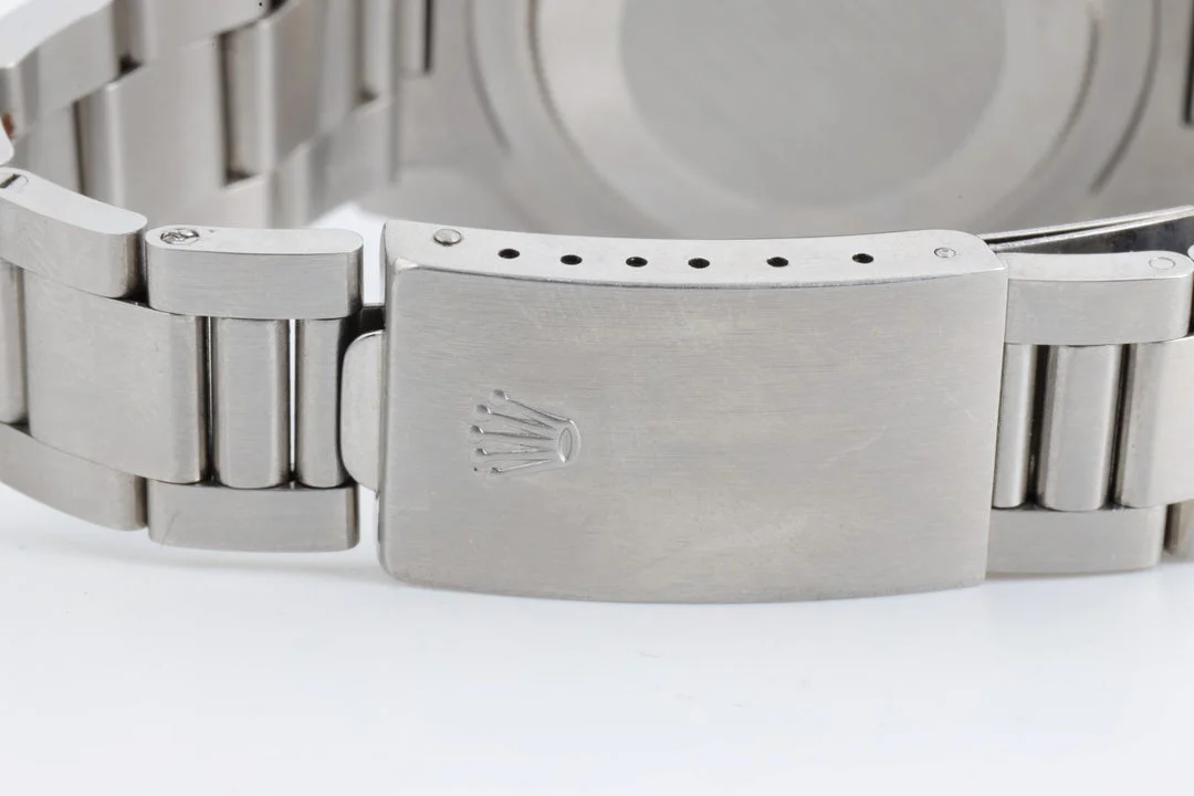

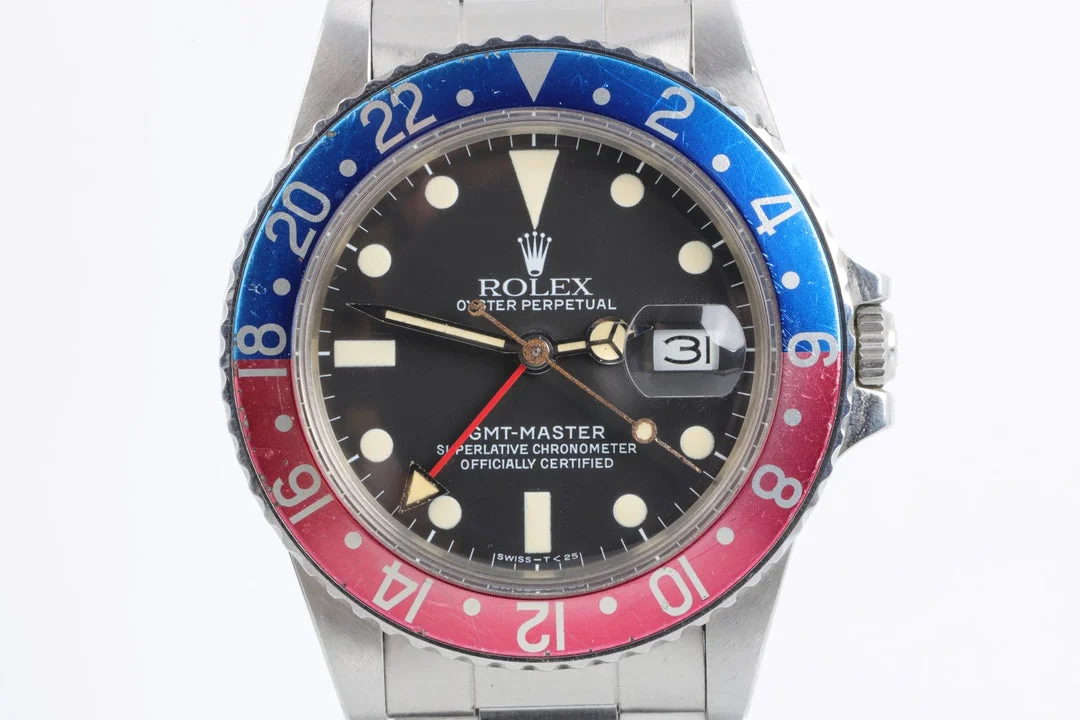

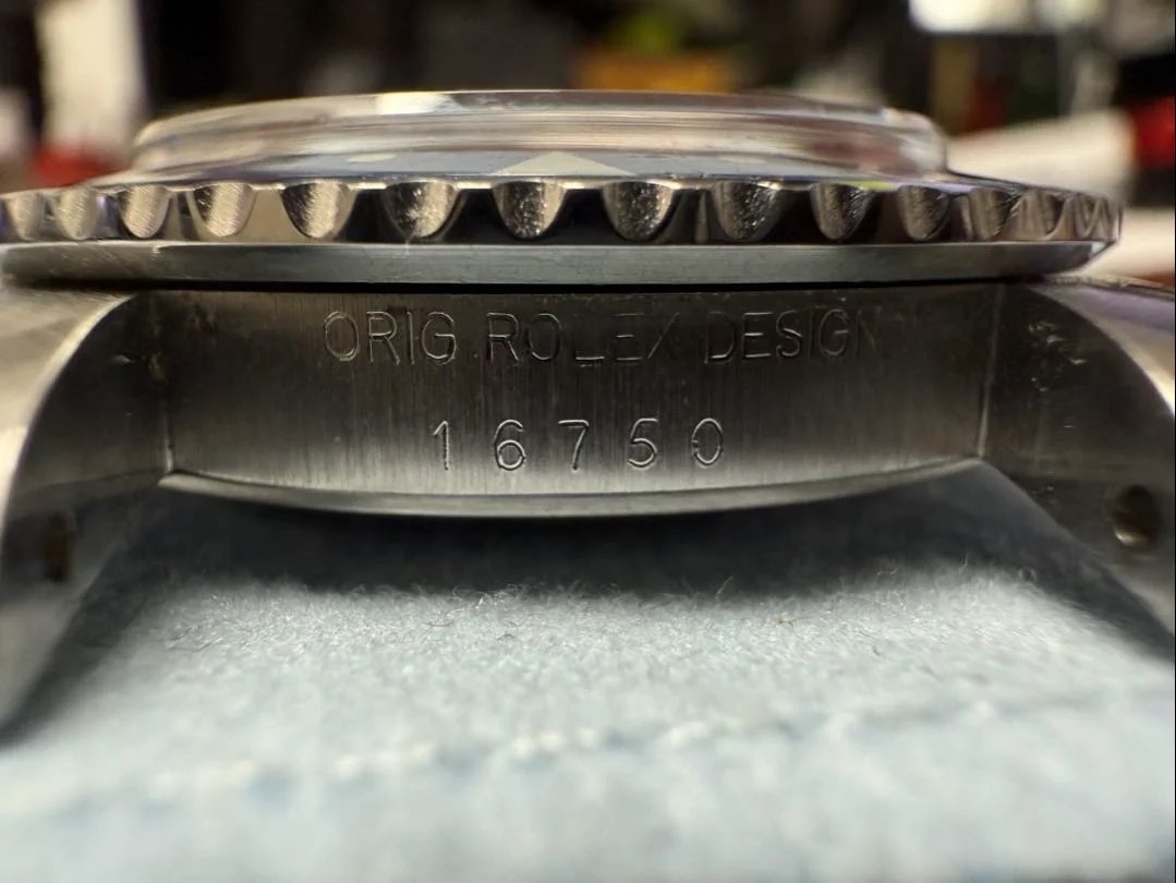

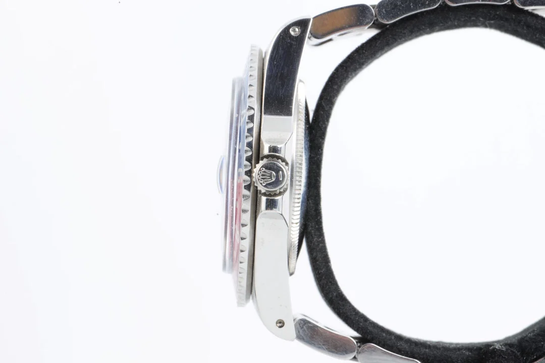

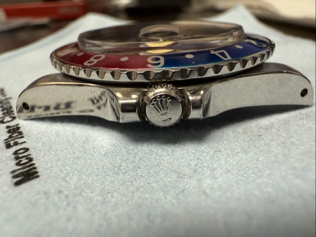

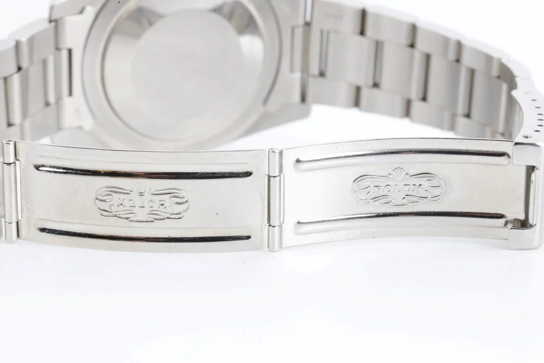

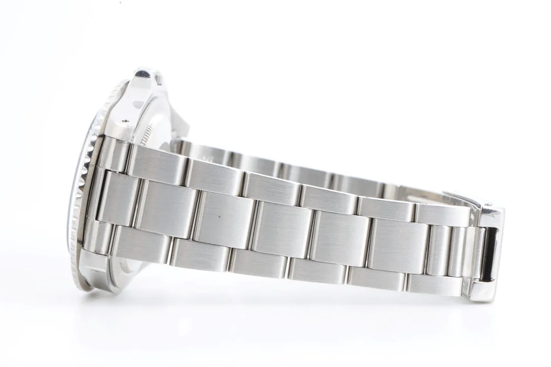

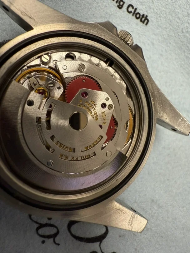

Hey guys, just purchased this matte dial 16750, 8.2mil serial, original bracelet, original red-back insert.
What do you guys think? Thanks!
2,218
6,929

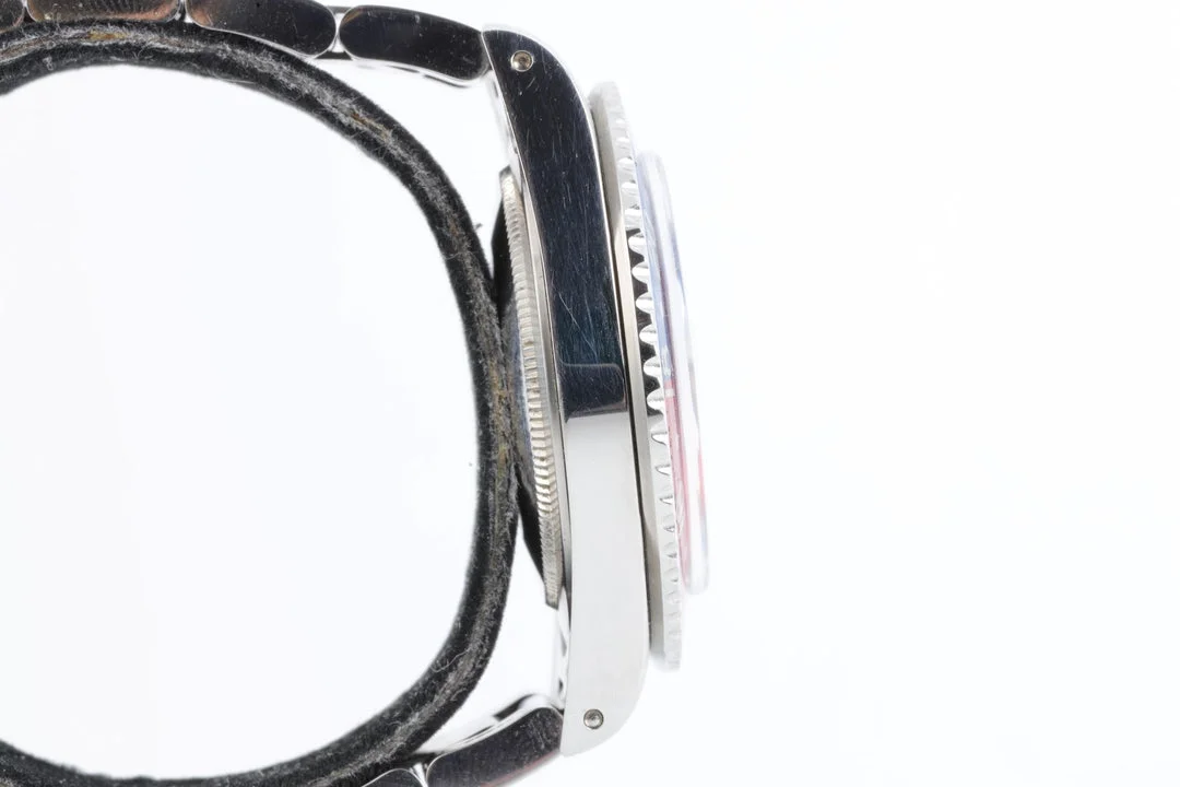

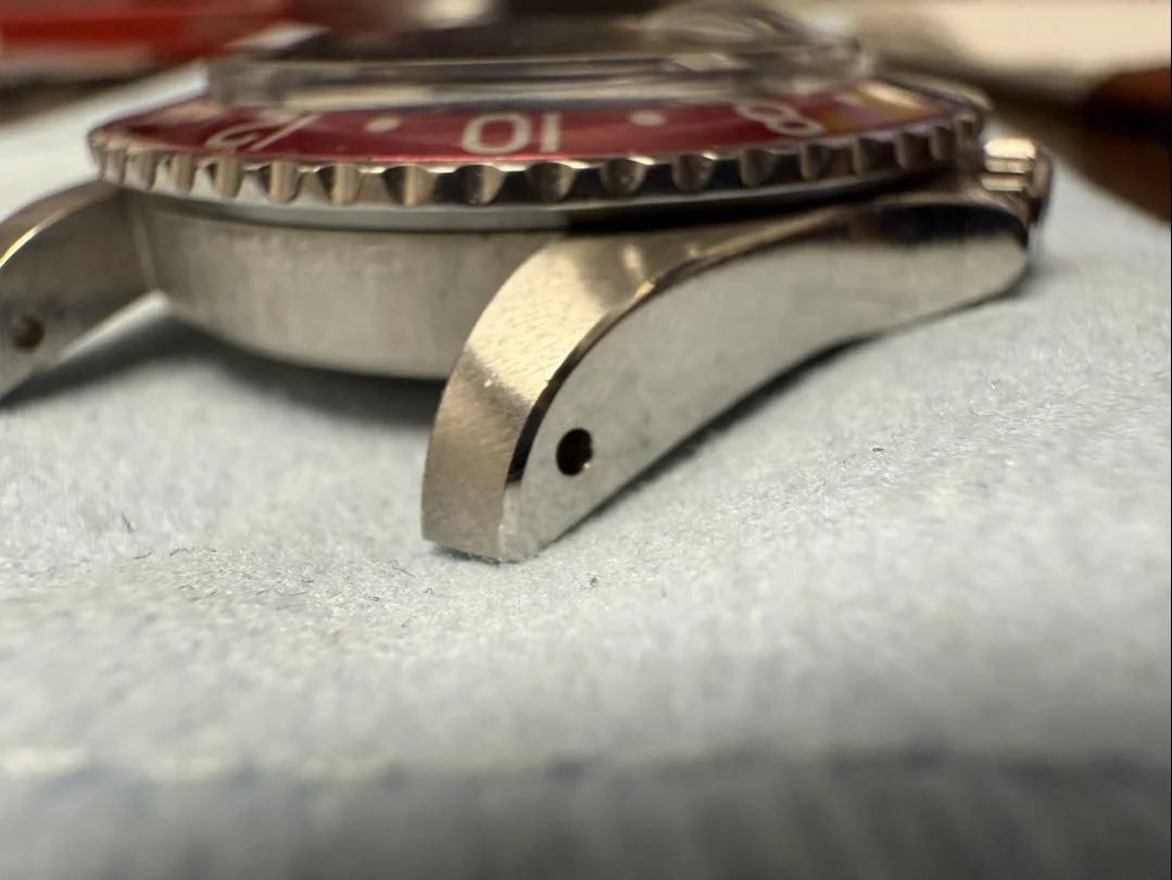

When I inspect the watch based on the provided pics, the question to ask is does the overall look and condition correlate with all components? So, lets start with the case, looks like it has been recently recut quite nicely. There is no catering around the lug holes which is a big plus. The reference number between the lugs looks extremely clean, but the type font is consistent with 8m serial GMTs.

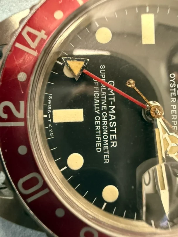

The dial also looks nice and is period correct for this reference. I can't tell if it has chips, blemishes or missing lume which is extremely important. The hands are not attractive and is what holds this watch back. I suspect, they were relumed in past; the composition of the 24hr hand is different and the lume on the hour hand is cracking which is indicative of cheap relume job. Regardless, I would be looking for genuine replacement for the second hand as its not worth salvaging and reluming the other 3 hands to color match the dial.
Lastly, the insert also looks to be period correct and would be worth swamping for a nicer genuine Redback to complete the make over. These items won't come cheap, but will make this watch quite attractive.
Best of luck.

Thanks for the info!
What makes you believe the case has been recut vs original?
Also, who would you recommend in the states for color matching the hands and for sourcing a seconds hand?
2,218
6,929
Think about it, look at the condition of the hands and insert, does it match the near perfect condition of the case? It's been clearly professionally recut. These are prepared watches for sale, meaning the selling dealer dresses them up for a quick buck.
I would try LAWW in CA, they do an admirable reluming job and might be able to source a genuine second hand as well.

Thank you, I will contact them.
