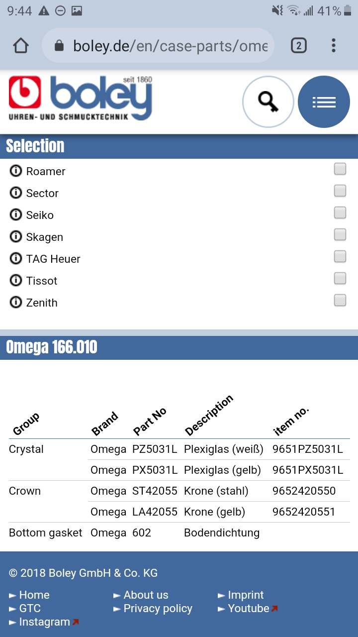

I can confirm that the 166.010 uses the same replace crown as the 14710, i.e. 42055

I am assuming my watchmaker who has an Omega parts account will have no difficulties finding a stem
If not, feel free to drop me a message. I have a spare (and unused) 501 stem here.

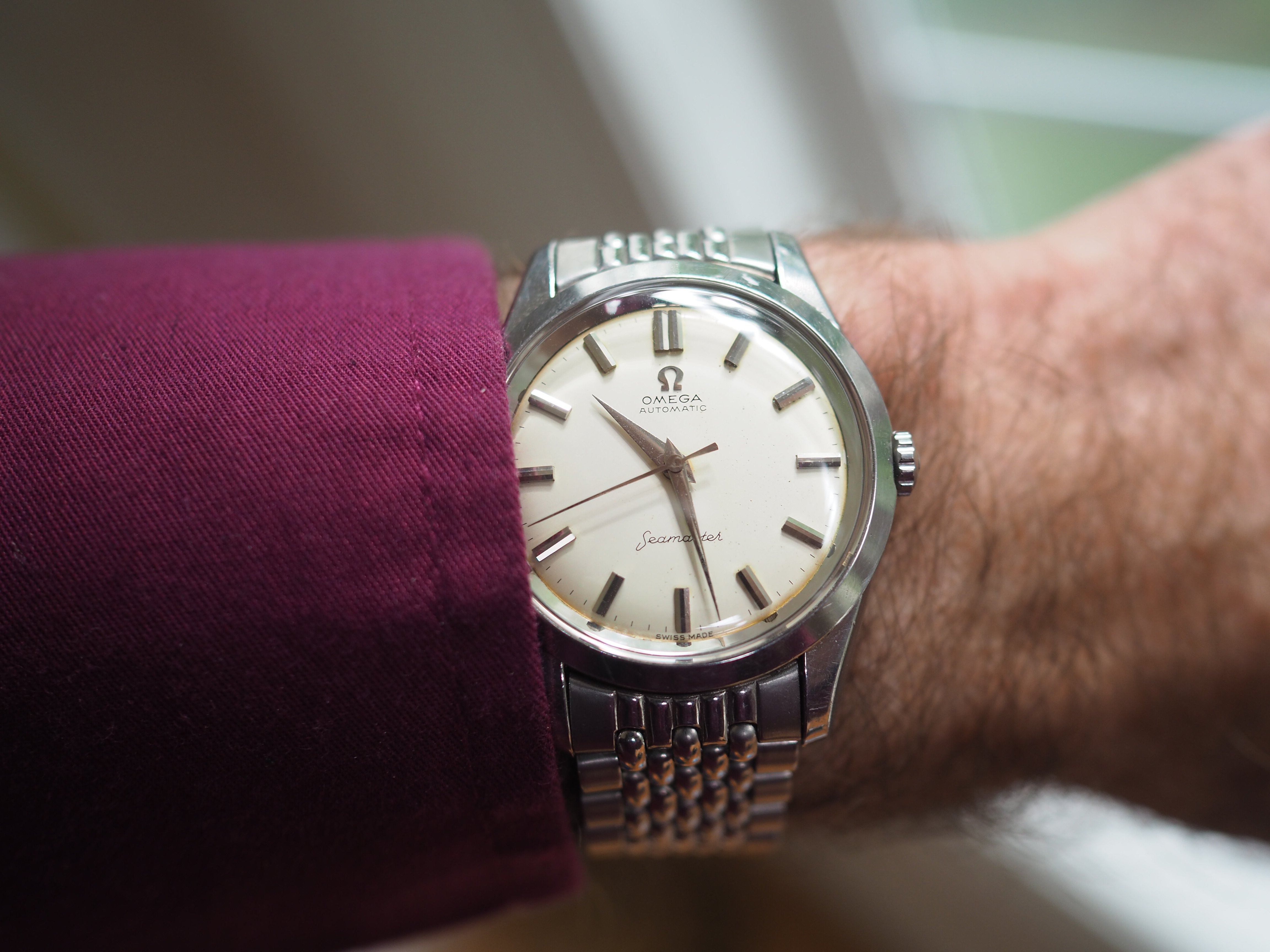

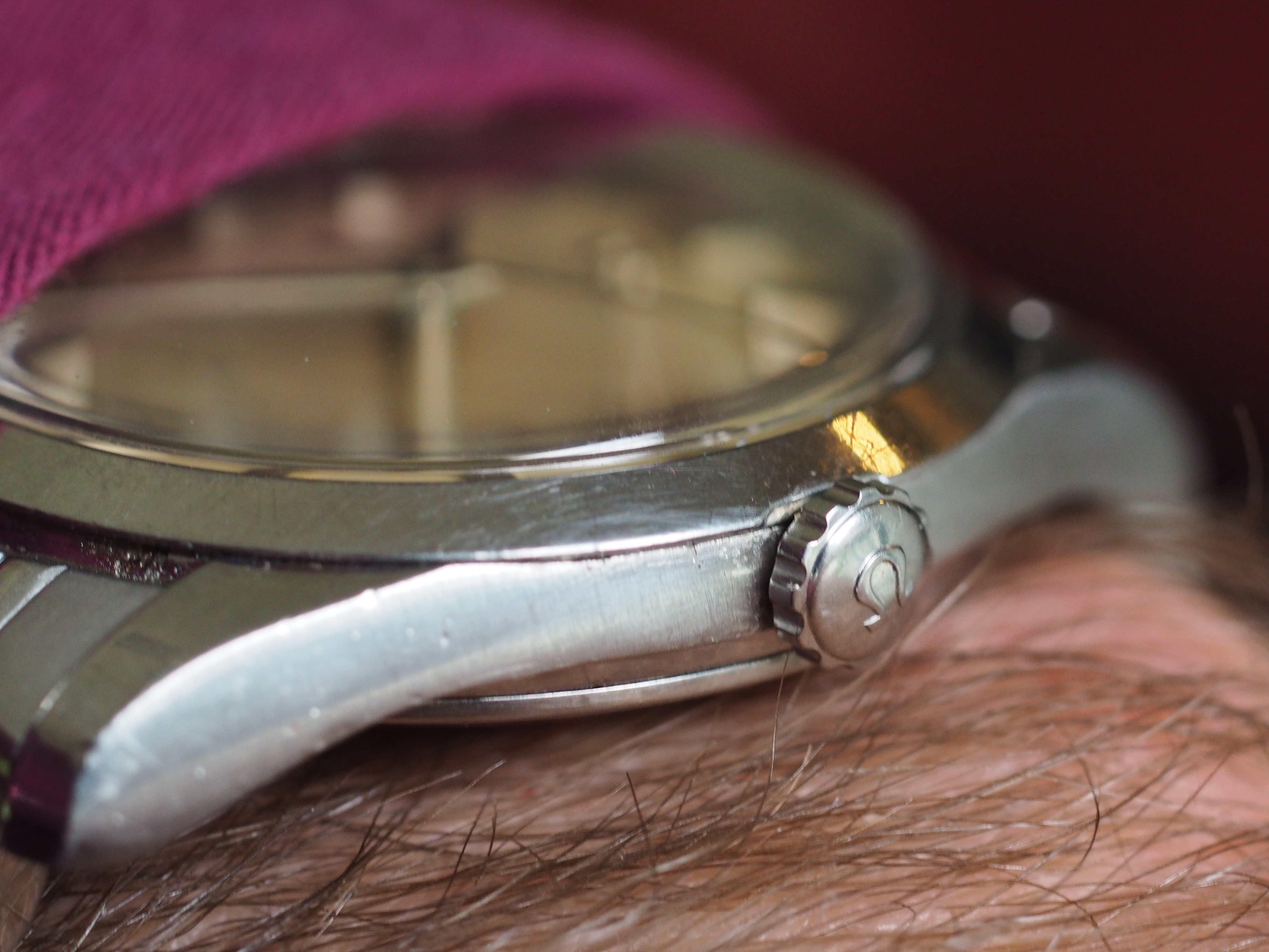

Back from the watchmaker all good to go. It had some rust issues in the keyless works, but the rest of the movement and case were fine. Also all four springbars had to be drilled out. I have a very patient and thorough watchmaker, props to Kelly Hunter at Art of the Watch for resurrecting this baby.
NOS crown from @new_heuer.
