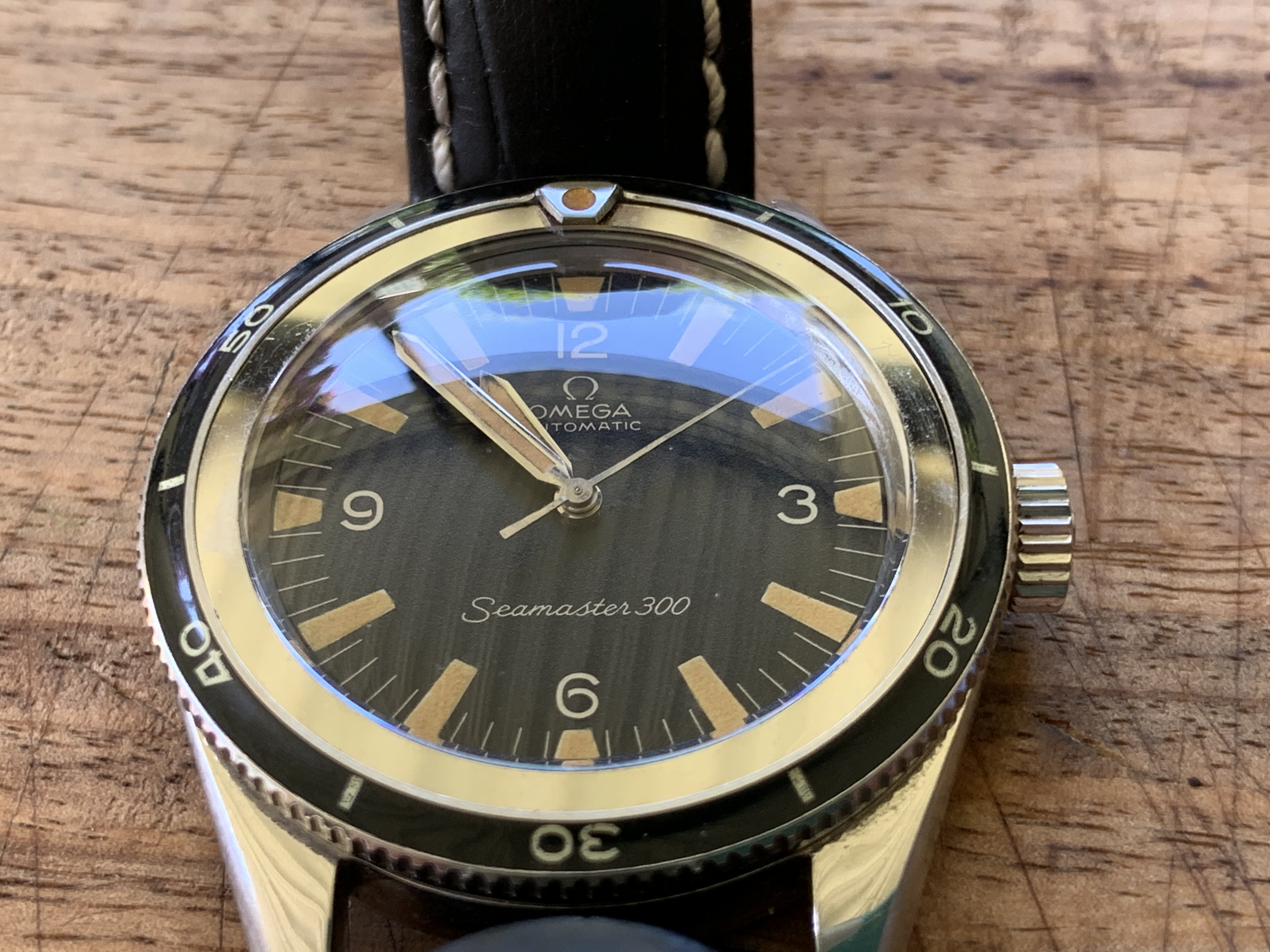

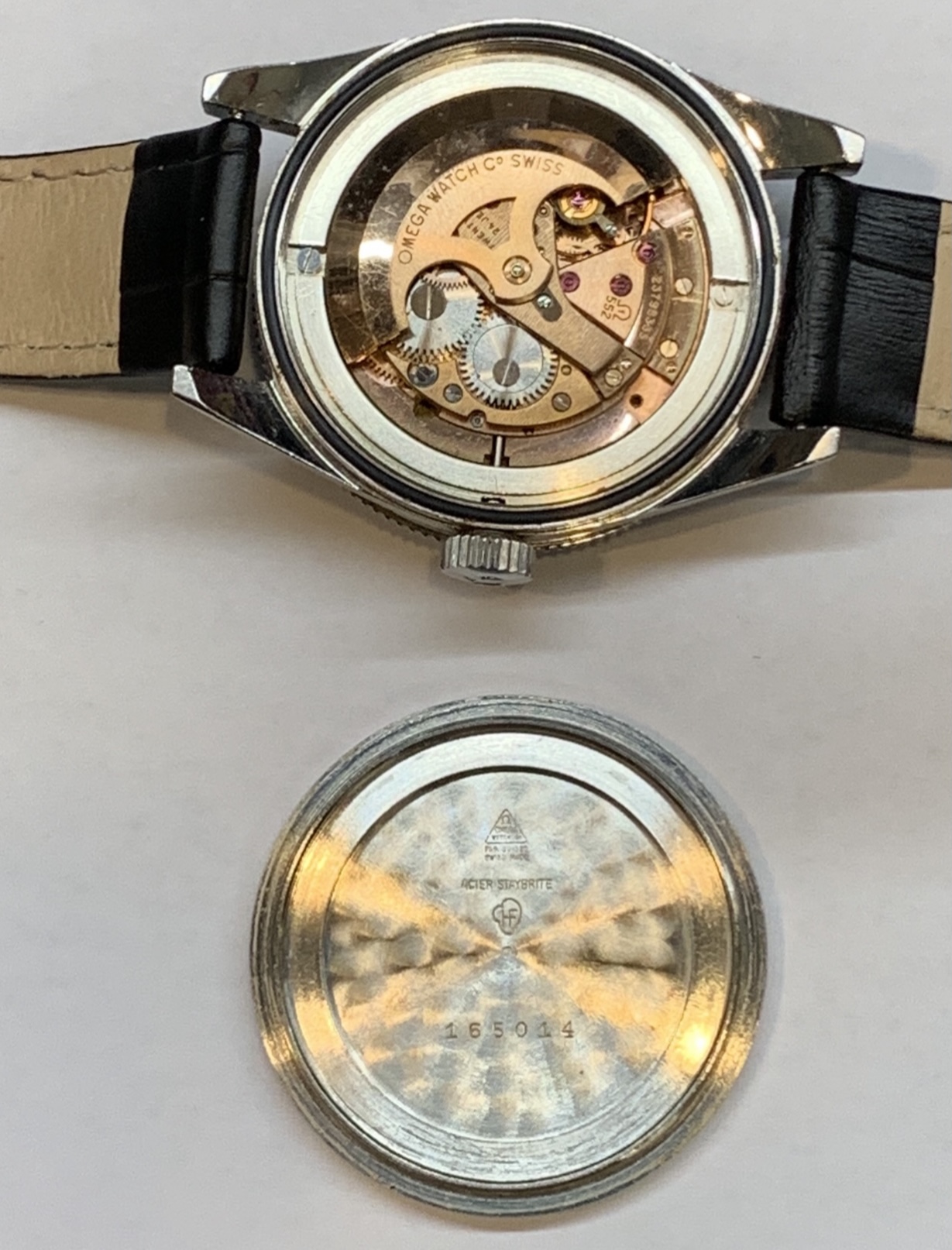

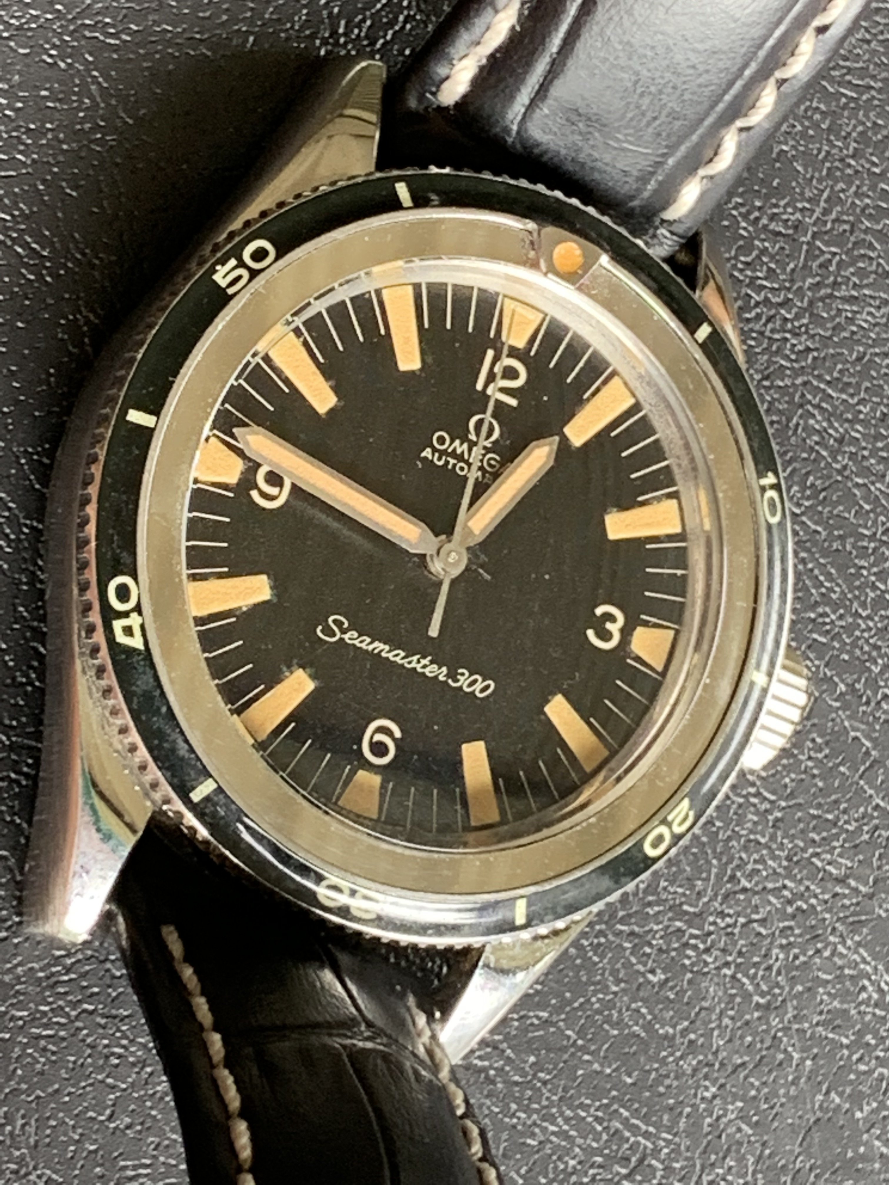

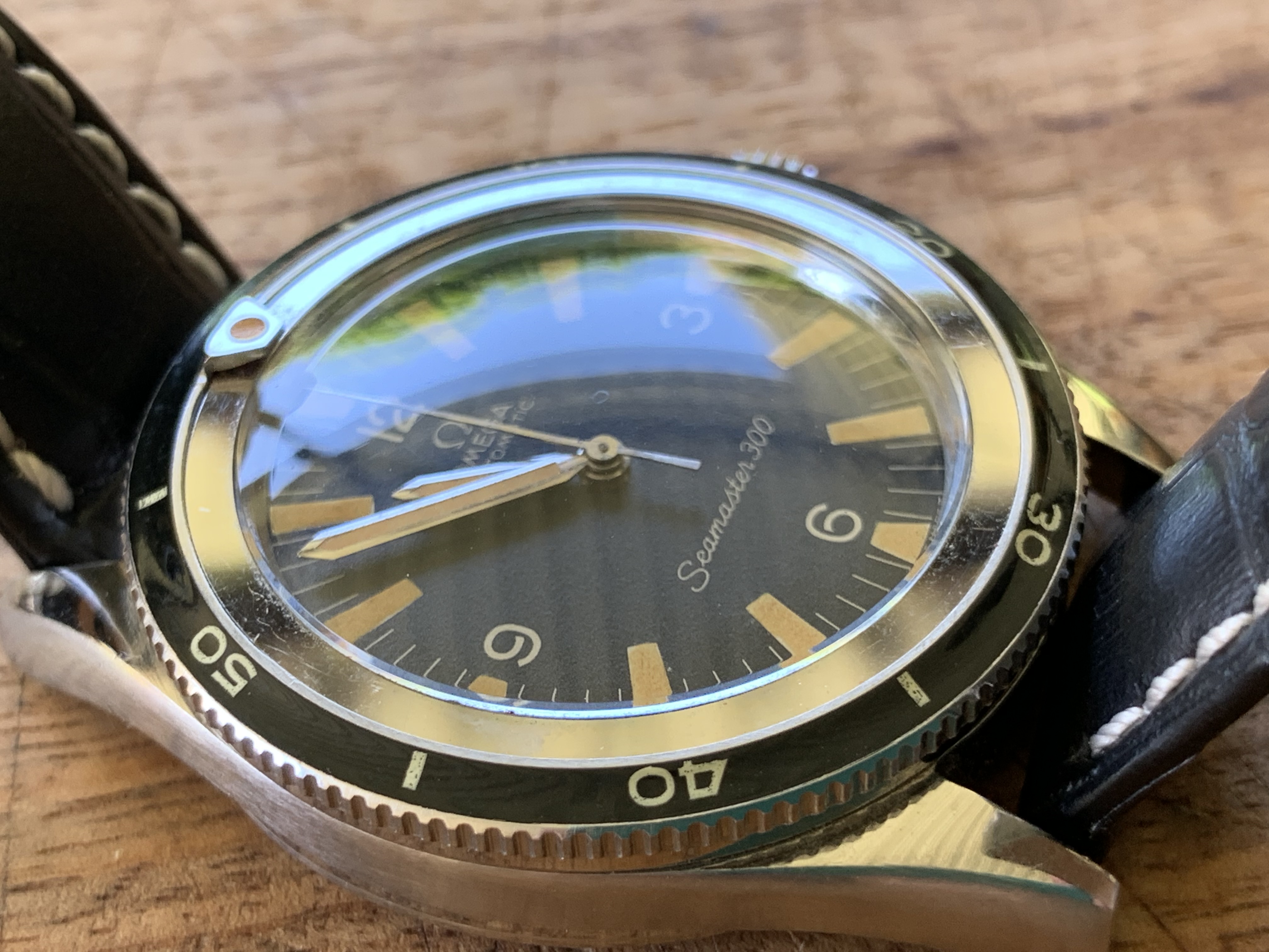

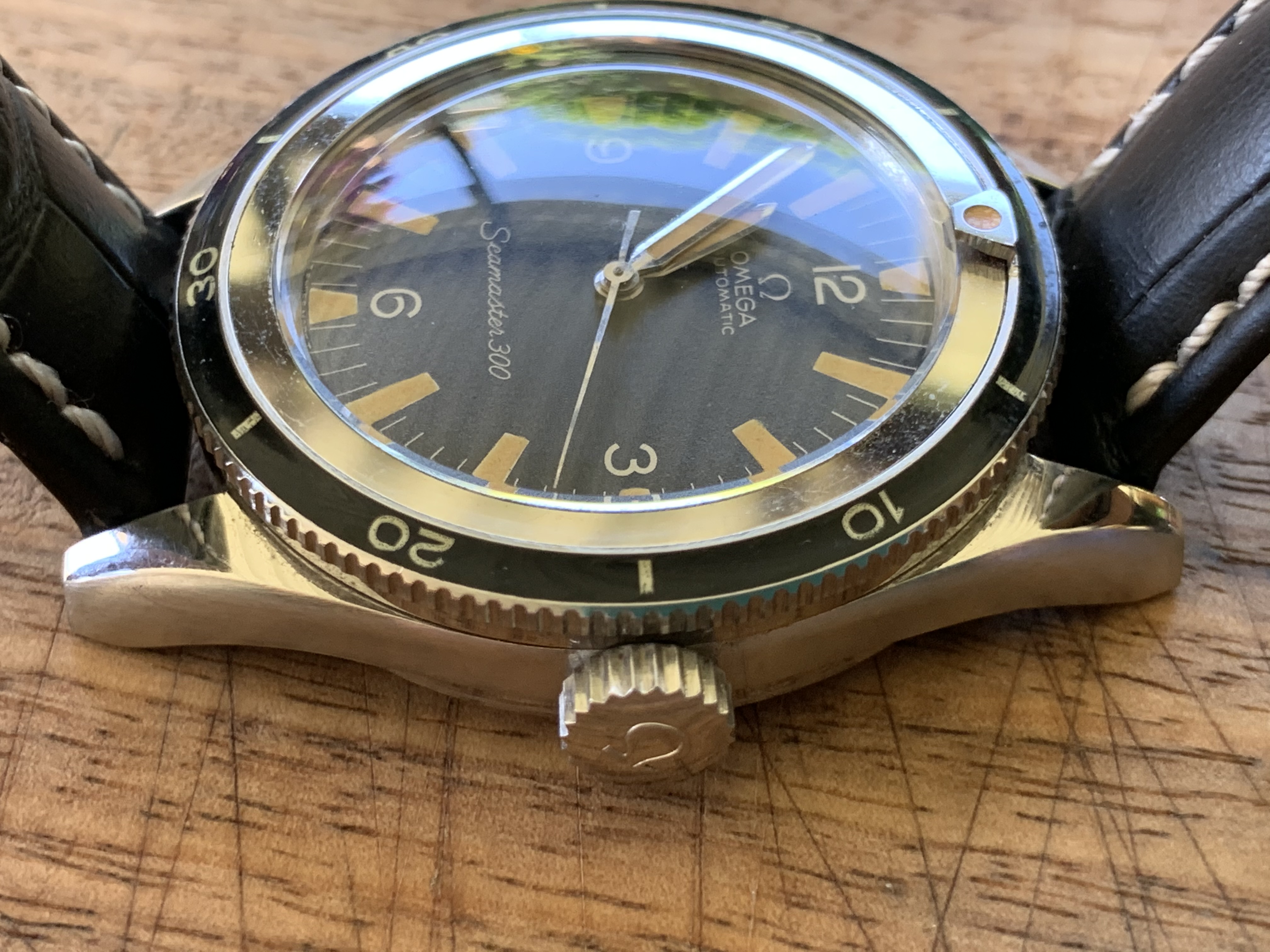

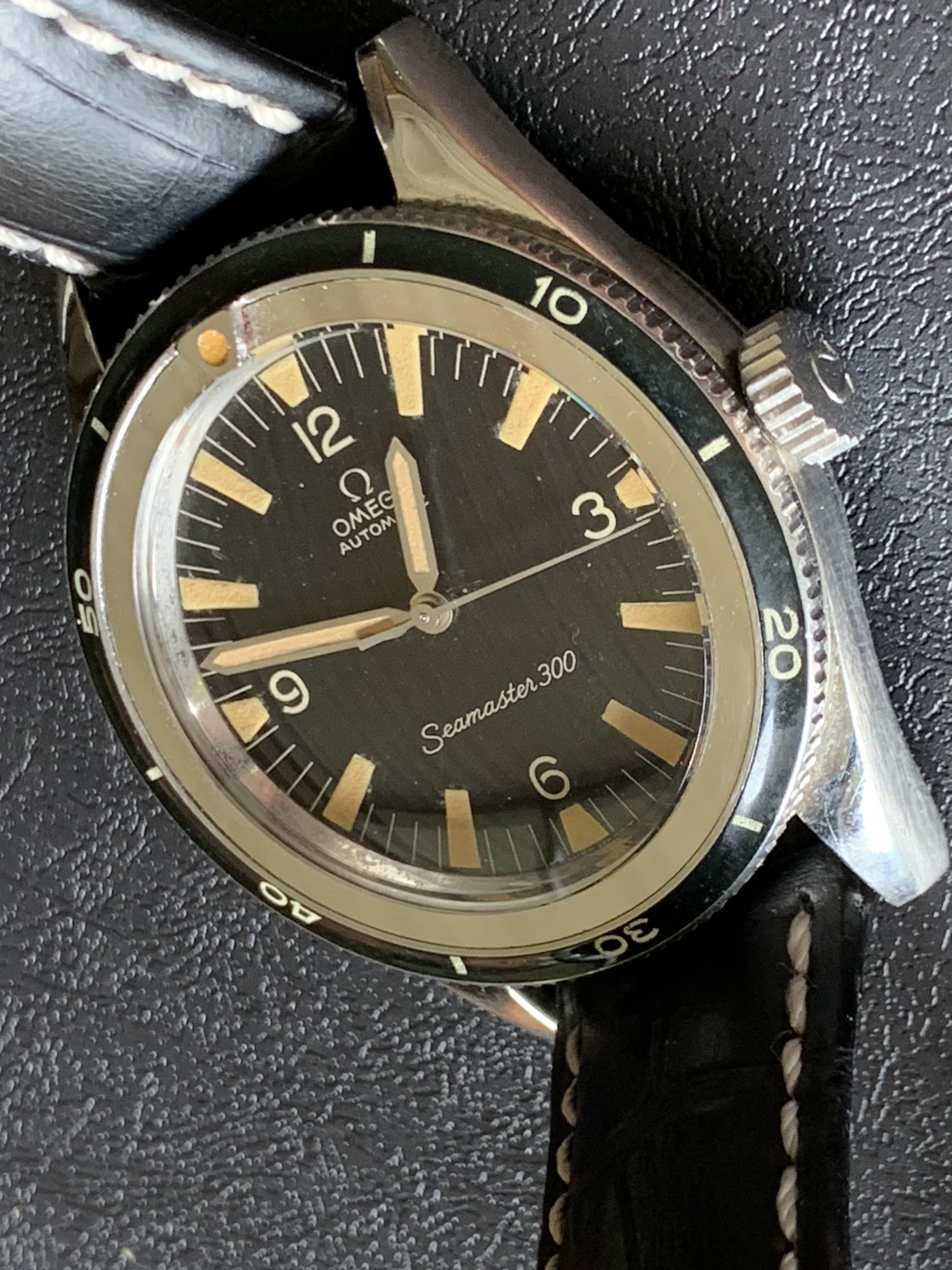

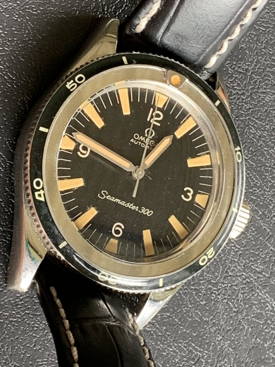

Hey guys! I’ve been looking at those straight lugs SM lately and was wondering what to think of this one. Serial would date it to 66. I know macros would be needed to assess the bezel’s originality but maybe there are obvious tells I’m missing...
Thanks! 😀

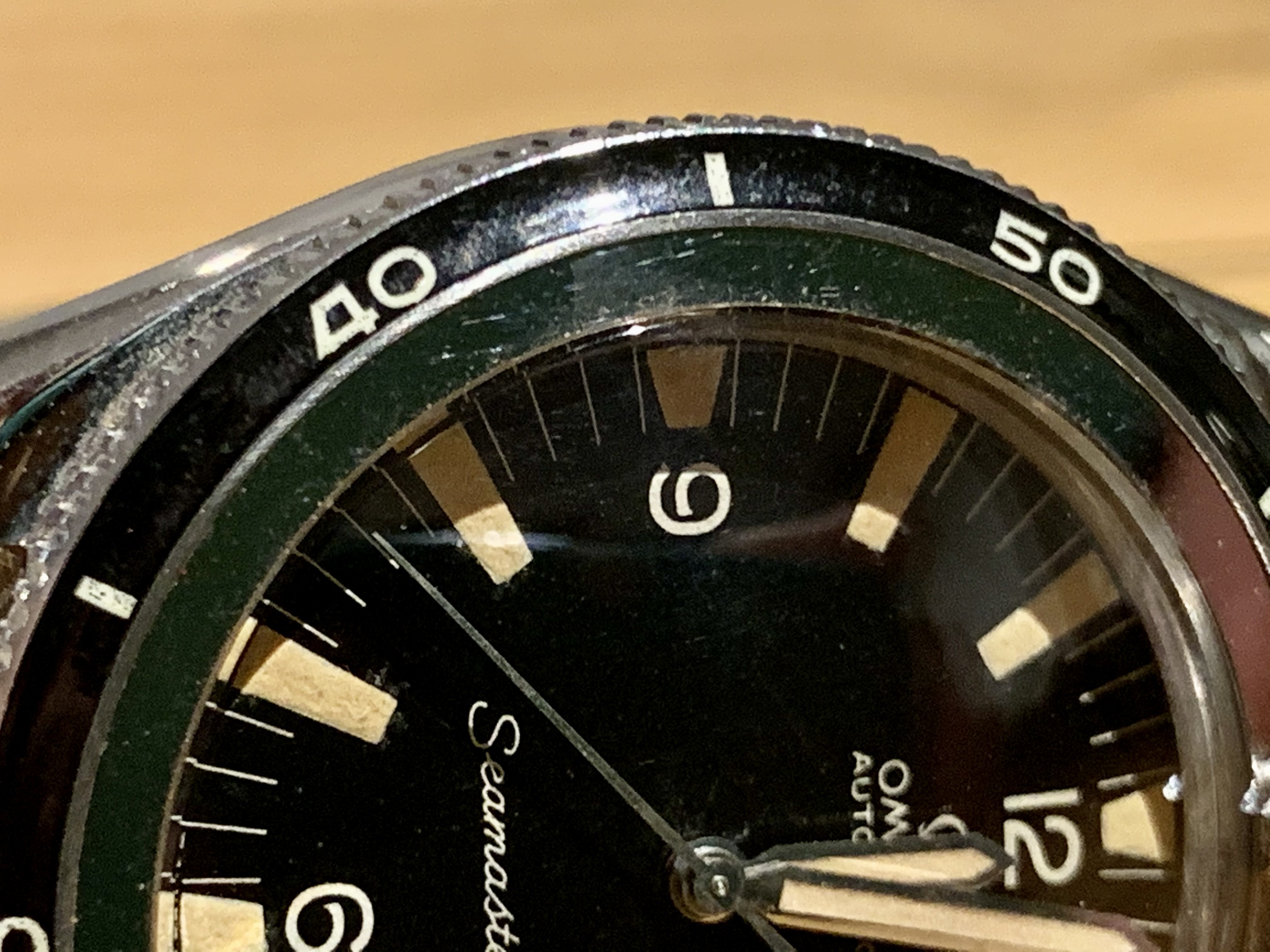

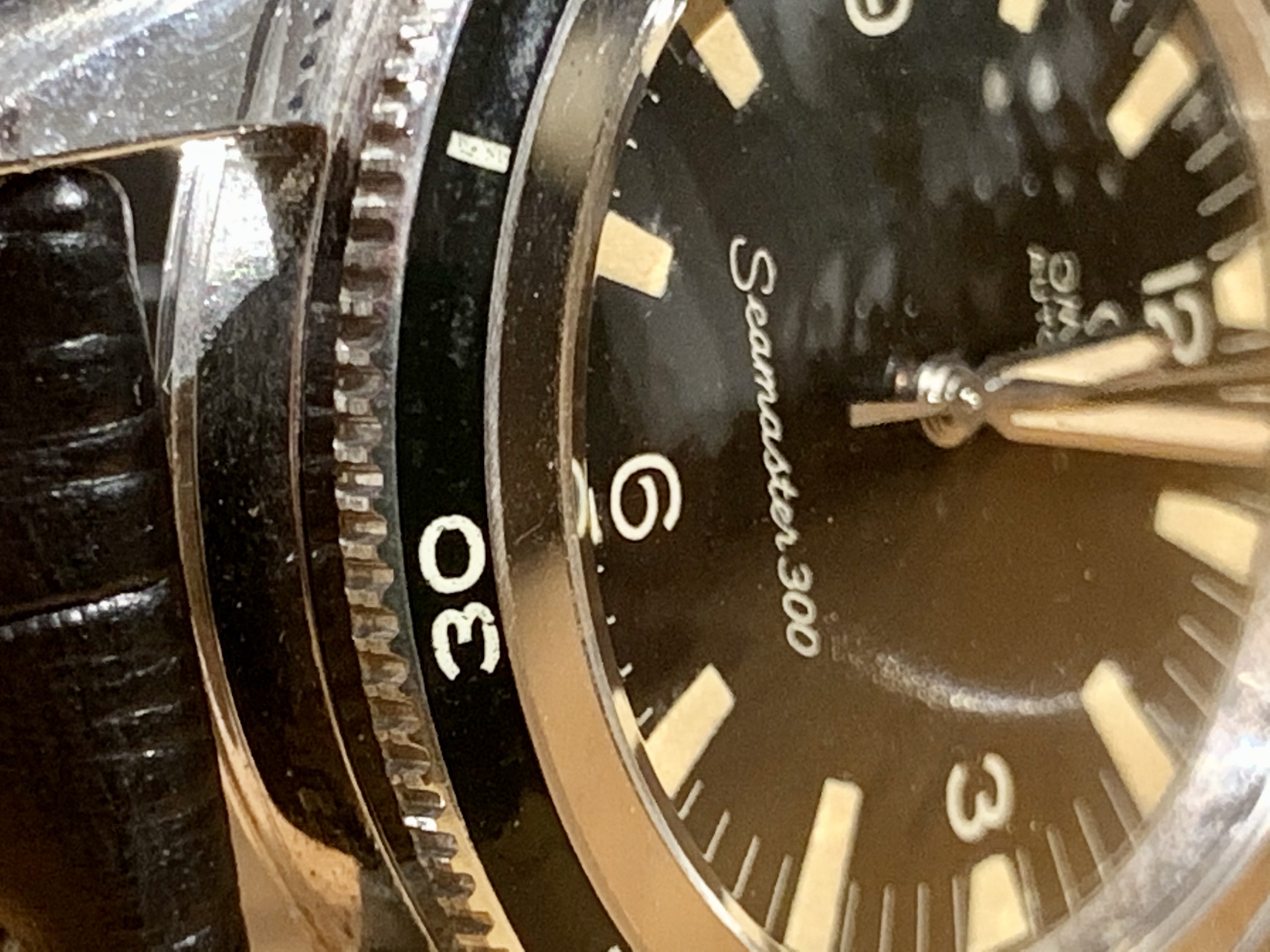

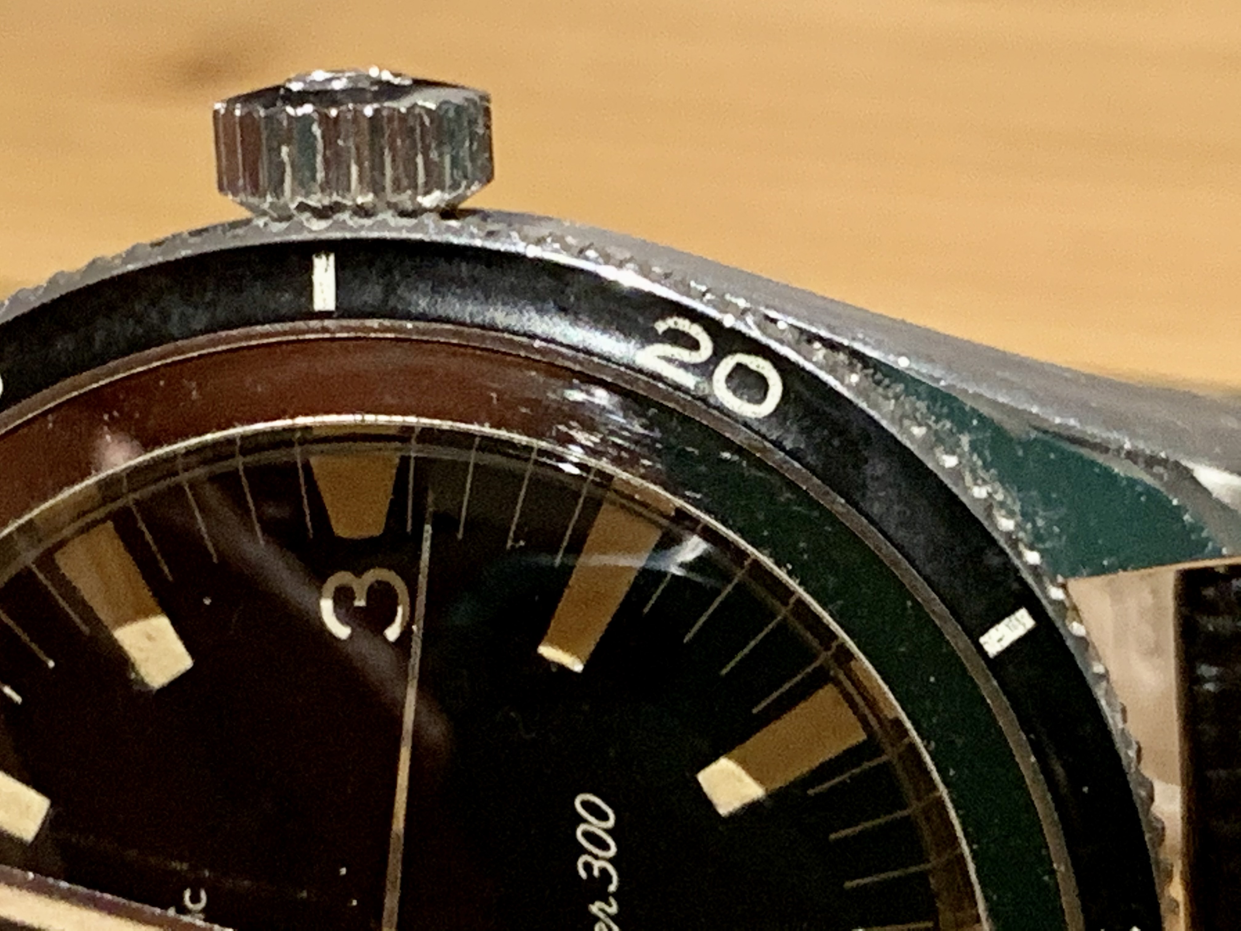

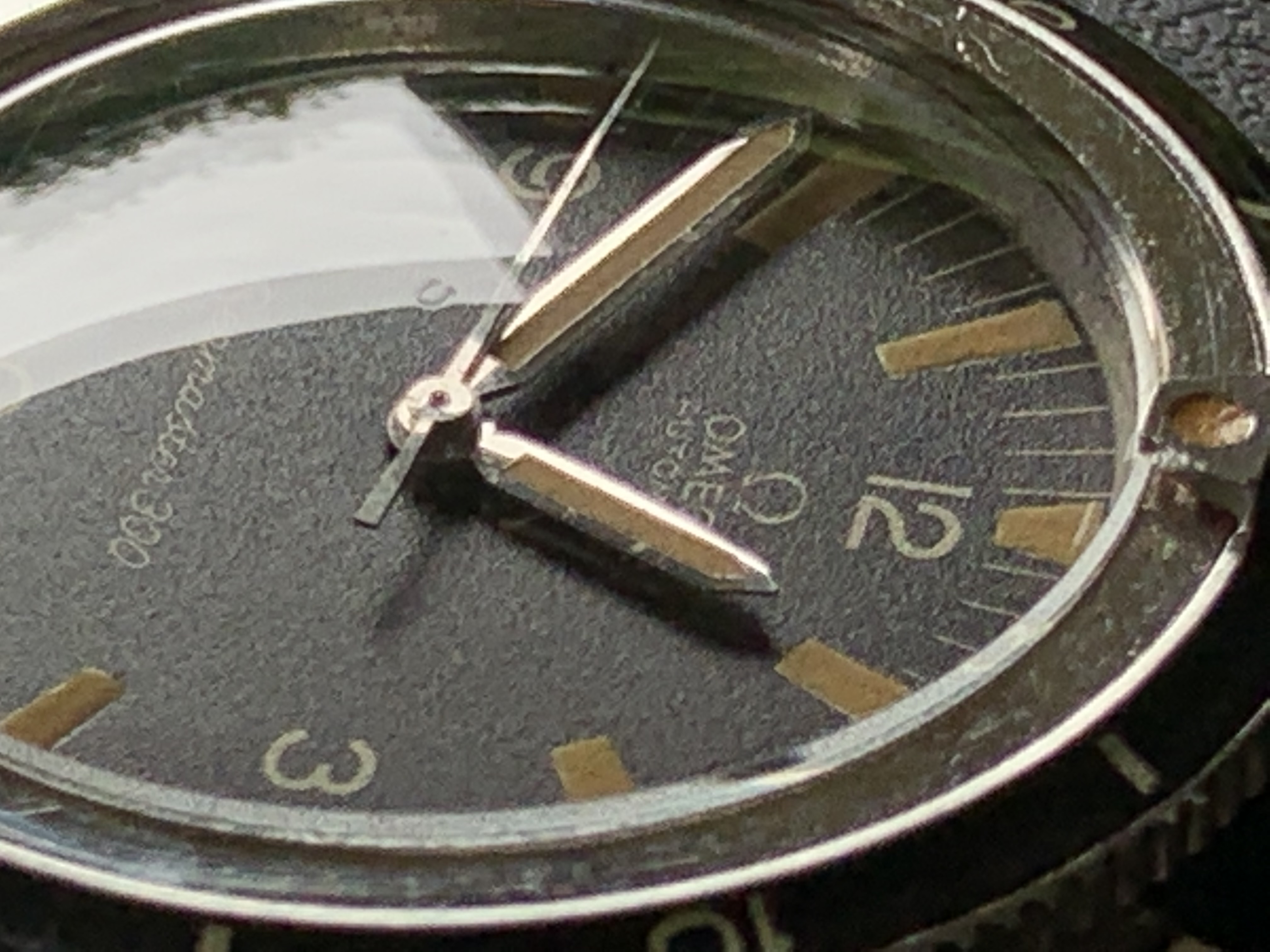

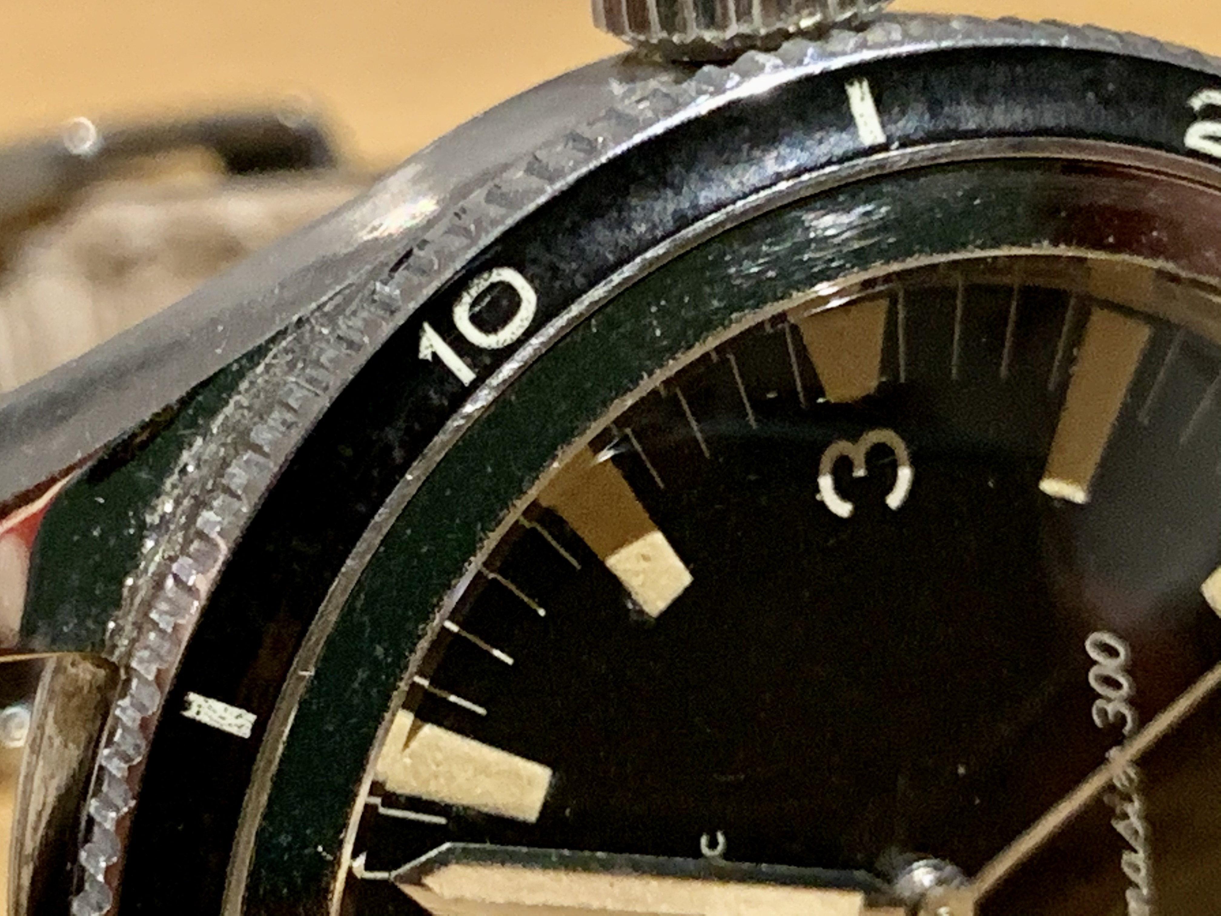

The seconds hand for example seems very suspicious to me, I’ve never seen a straight one like this but the sellers maintains it might be original.
Same for the bezel, 100% original according to him...It doesn’t react to Uv light by the way, while the dial and hands do!

I think the bezel /insert may be original but not as good as @CajunTiger or @kox or some others at identifying it through photos. Overall the watch looks phenomenal to me.

looks original, but without a loupe its impossible to say for sure

The bezel looks original but as told before you need a loupe to be sure.
The second hand was replaced. You can search for the original one here with a WTB post or on Ebay.
I can't tell from the pictures if the dial has been relumed.

No extract was available unfortunately. Being unsure, I had to let it pass. It was an auction that stayed without bids at 5.8k€ until a couple minutes before the end...It ended at 8k+€ which seems to me like a very good price if everything was correct but the many unknowns made it a huge gamble in the process...😵‍💫
