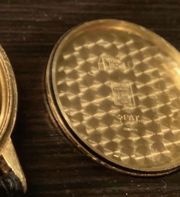

I’m not clear how one would tighten or loosen the rear screw ring? Don’t see any notches or way to get a tool on it ?
171
420
Snap on?
3,695
8,503
Snap on?
Yah was thinking must be pressure fit not threaded, but if that’s true, what’s the advantage over a regular snap back? I didn’t really study the drawings. Maybe there’s an extra flange or something to keep water out.
171
420
I think the ring is snap on and the rest of the case back is “just” pressure fitted into the case and has an o-ring on the outside.
So the snap on outer ring is kind of just securing the actual lid in place…
I actually know the owner of the watch (the seller) and have seen a photo (attached) of the inner lid/case back. And I think it shows it works like this…
Sorry for the size and quality, it’s not my photo (nor my watch).
