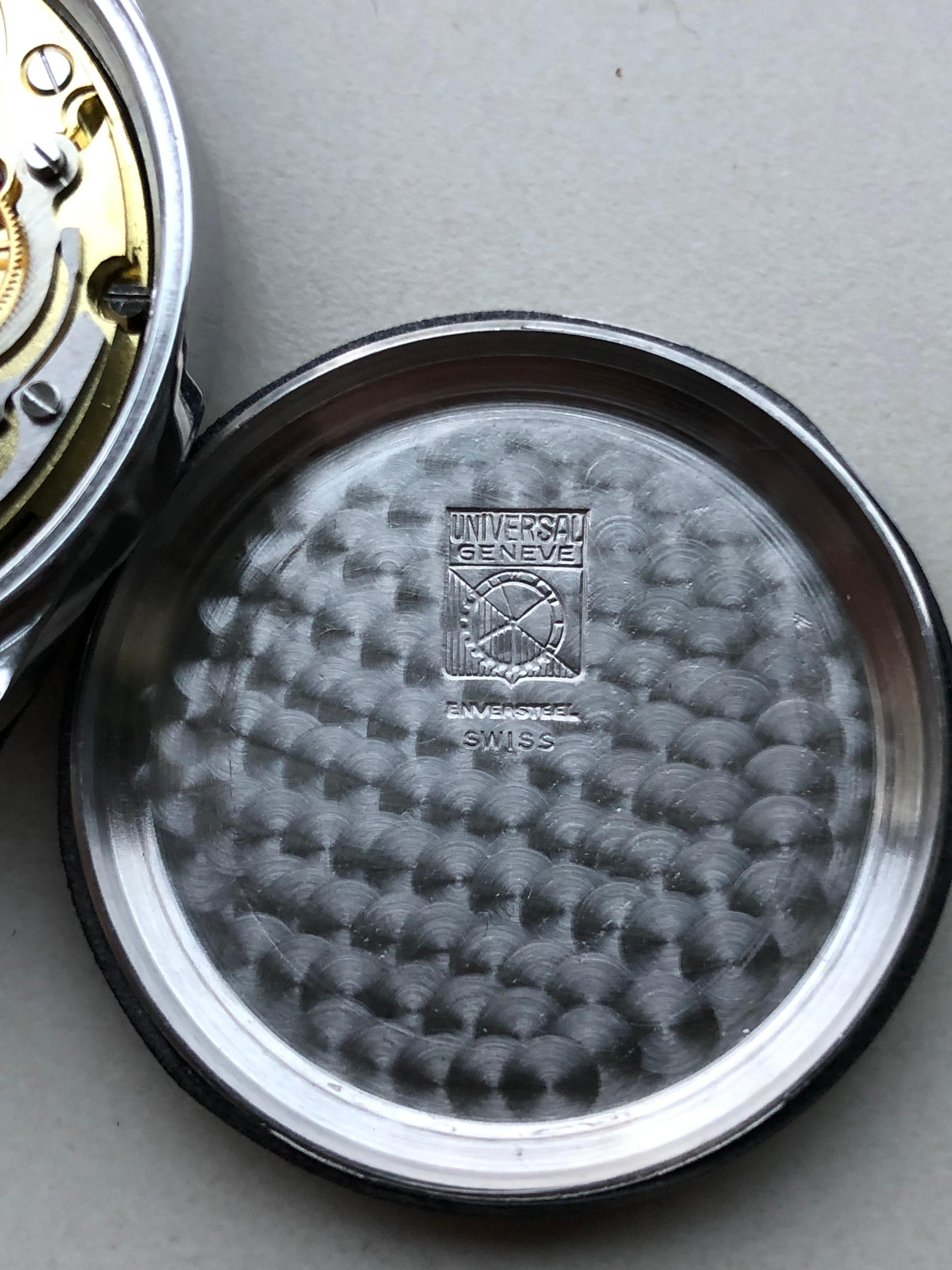

I am confused by this watch on several levels....

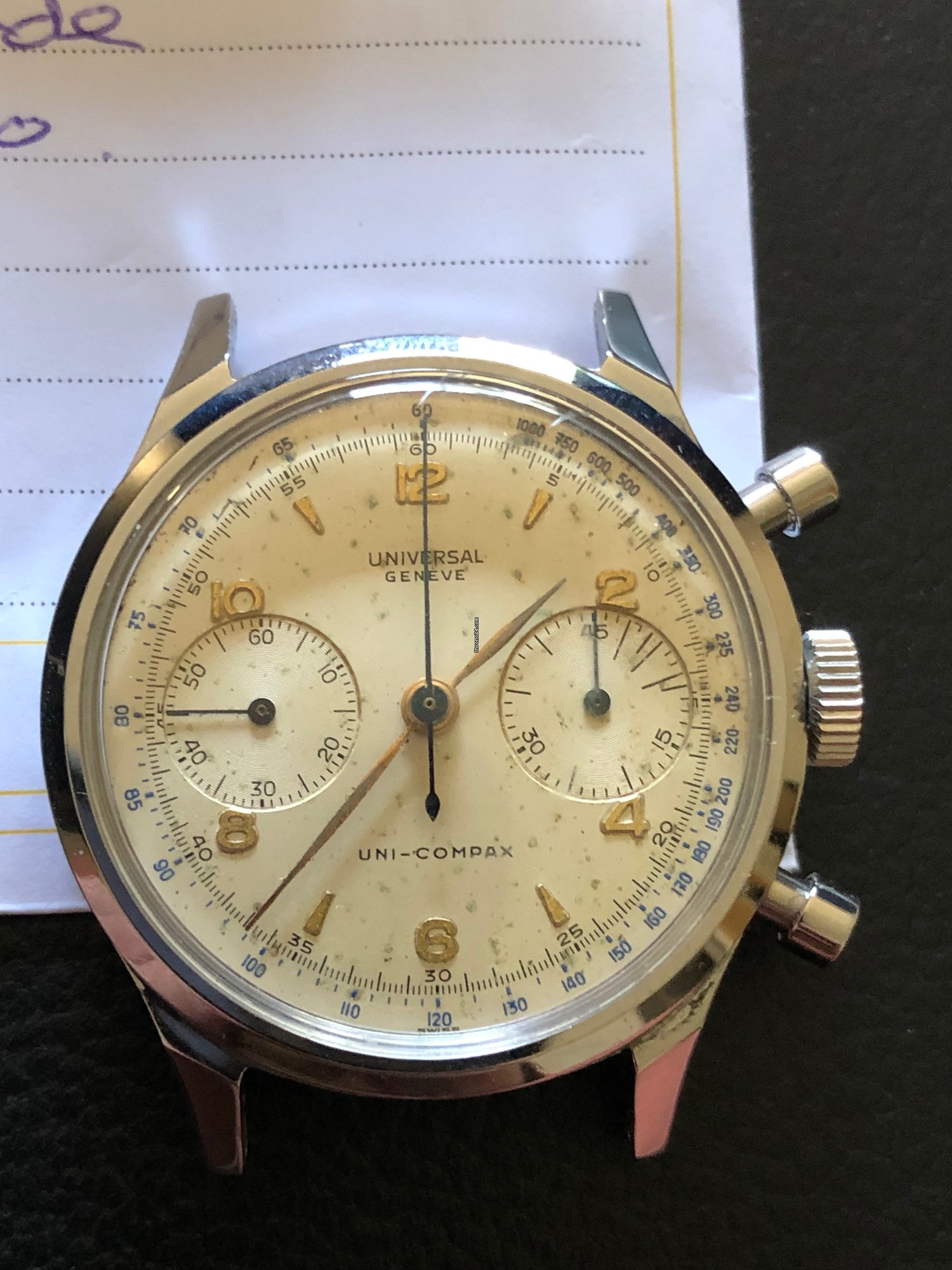

1) I'm not familiar with the reference, it's Spillman esque but different ?

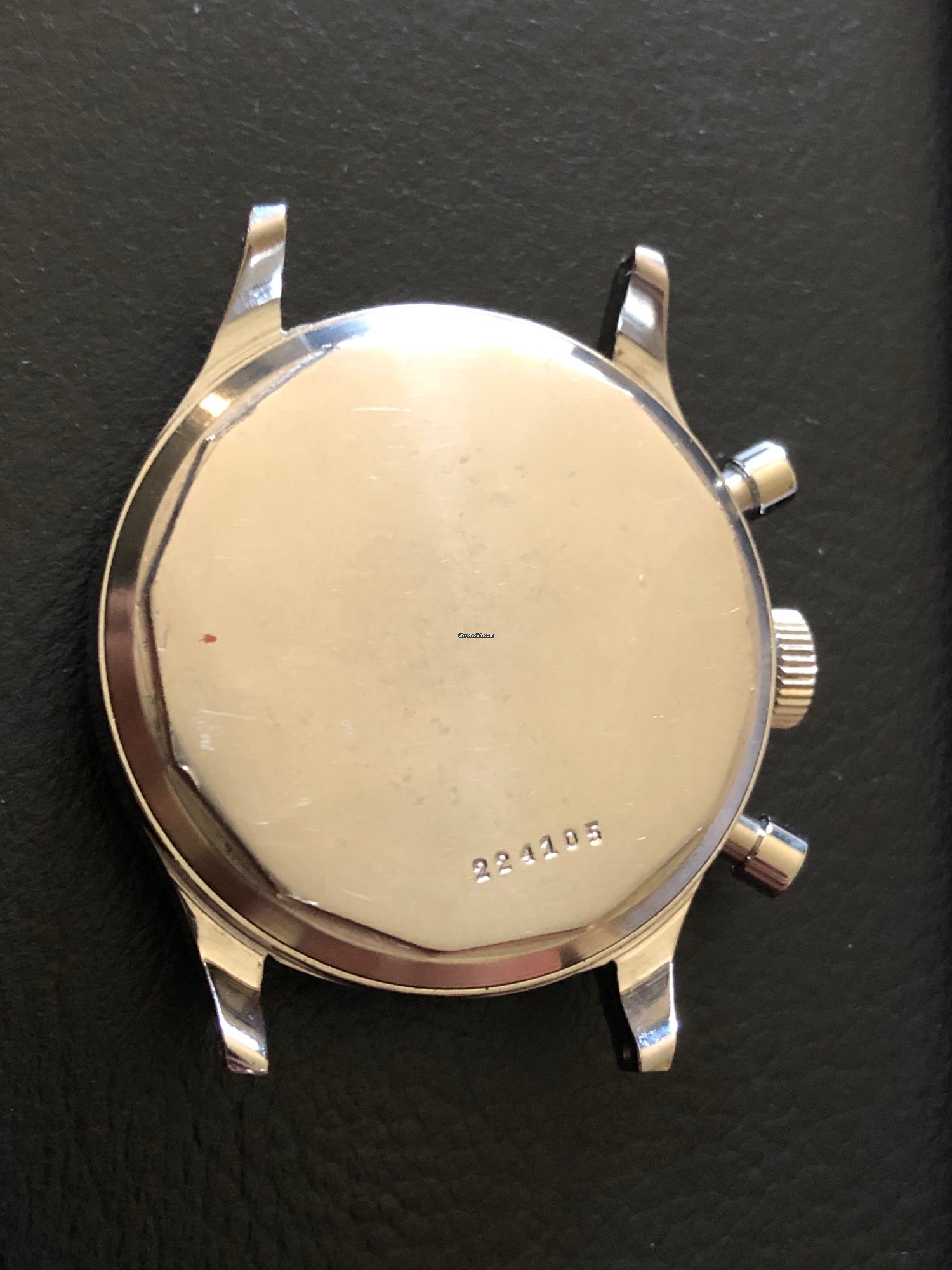

2) the case has no serial, I don't think I've ever seen this before, but the interior caseback stamping looks OK ?

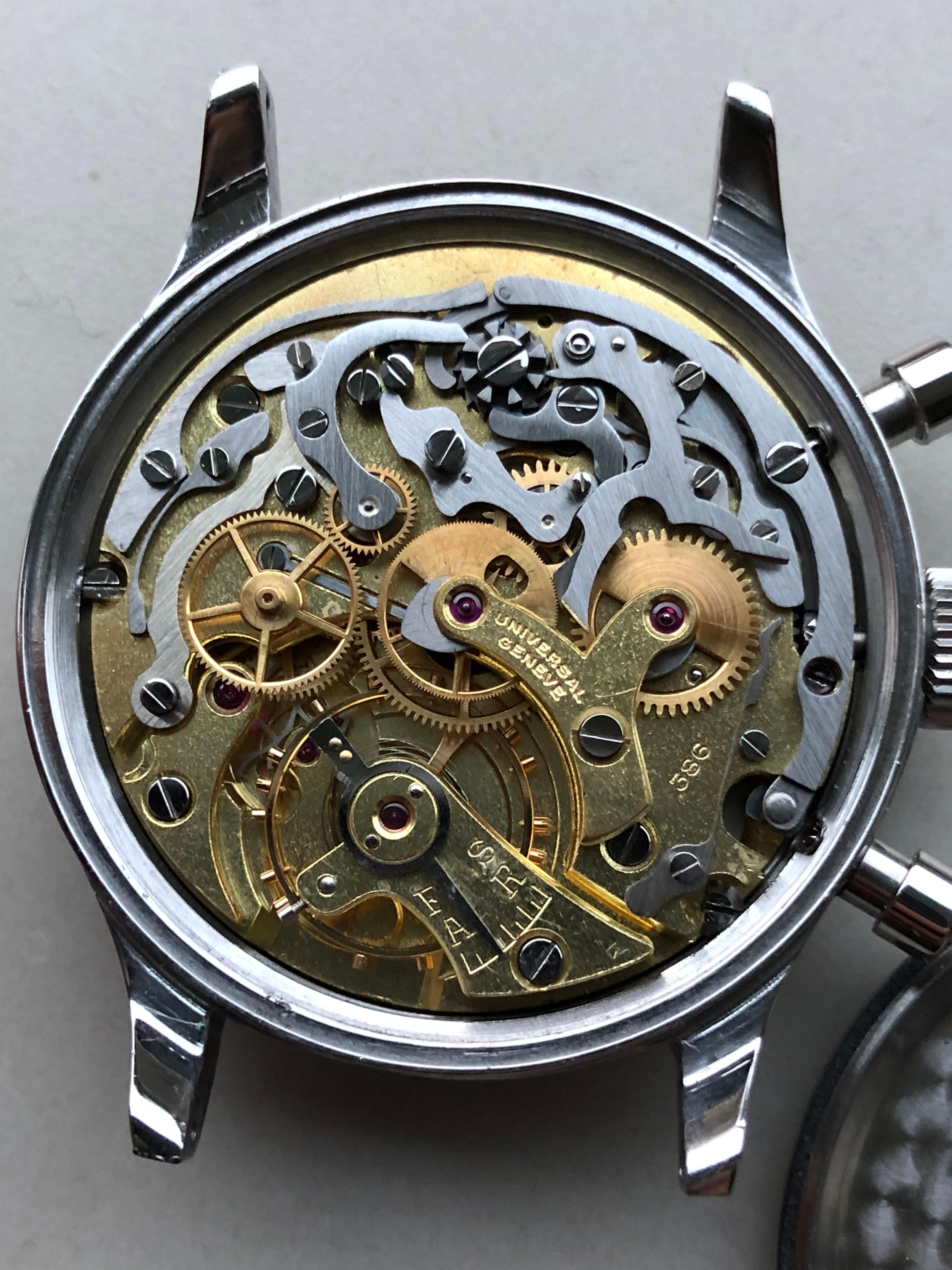

3) I wouldn't expect a Uni Compax to pair with a cal 386 ?
Any thoughts? Is this some kind of franken ?

Page 202 of Sala has a Uni-Compax with a 386 but I'd be interested in the opinions of others as I think the A in Universal is a bit pointy and I think could be a redial.

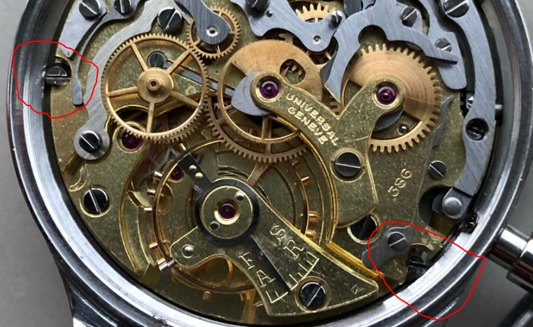

I have seen a 224106 which is very similar, but not a 224105. Dial is original, a little aged but acceptable. I don't believe that dial started life in that case and movement combination. I don't see a serial number on case back which is unusual (usually when watch parts are provided to other manufacturers by UG) and the exceptionally clean 386 caliber is quite unusual. Clues that is is some sort of marriage are the movement retaining screws that hardly touch the case (the caliber 285 would be a much better fit as it has a different base plate which would accomodate a movement ring/spacer).
The above are a give away. Needs a little research but agree that it has been put together.

Thanks D, my thoughts as well. I think the dial is orig but not to this case. It's still an interesting combination. The near nos 386 is quite valuable. The original case pushers are included as well, and the whole thing is just under $2500, which I think is quite reasonable really, if someone doesn't mind the likely non factory configuration.
