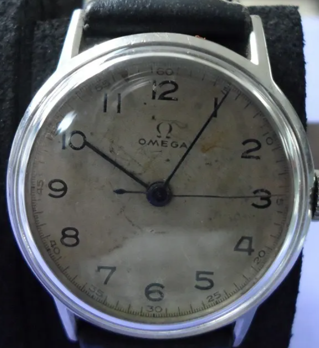

this is hard for me to identify is?

the dial does not bear the inscription swiss made, year ?. movement does not bear the cal.

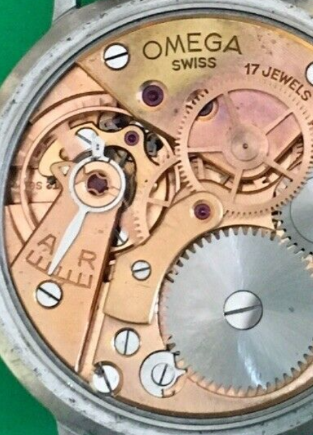

The movement looks like a cal 30T2 with a balance and balance cock that have been replaced by later ones - the ones of a 268 or a 285. Do you have better pics?

An Omega of this vintage, early 1940s, would not necessarily have SWISS MADE on the dial.
Movement is a bit of a mess, caliber should be marked under the balance.

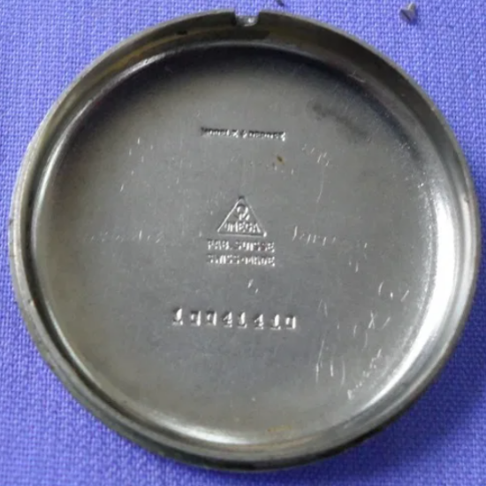

thank you so much, it is in the Second World War, the omega emblem on the caseback gives me the impression of being different

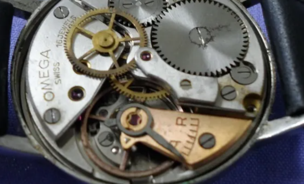

it looks a lot like omega military pilot year 1942 same cal 30t2st 16jewell but not marked on the back A M, I find the balance wheel different.

As I said, the movement is an early cal 30, likely a 30t2. But, as far as I can tell from the pics, the balance and the balance cock come from a later caliber, with a ring balance but not yet the smaller inca system: 268 or 285. As per collectible value, it is a big deal! And finding the proper parts will be expansive.
