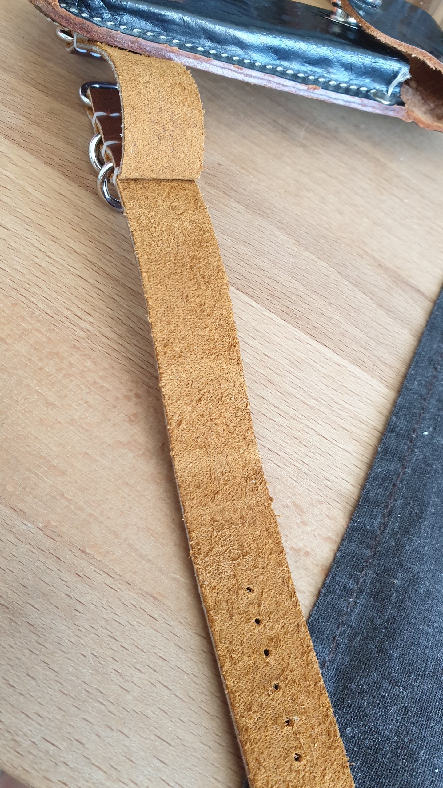

Of course, and many thanks for the advice. It's a lovely strap, and I am trying to do my best not to ruin it in the process!

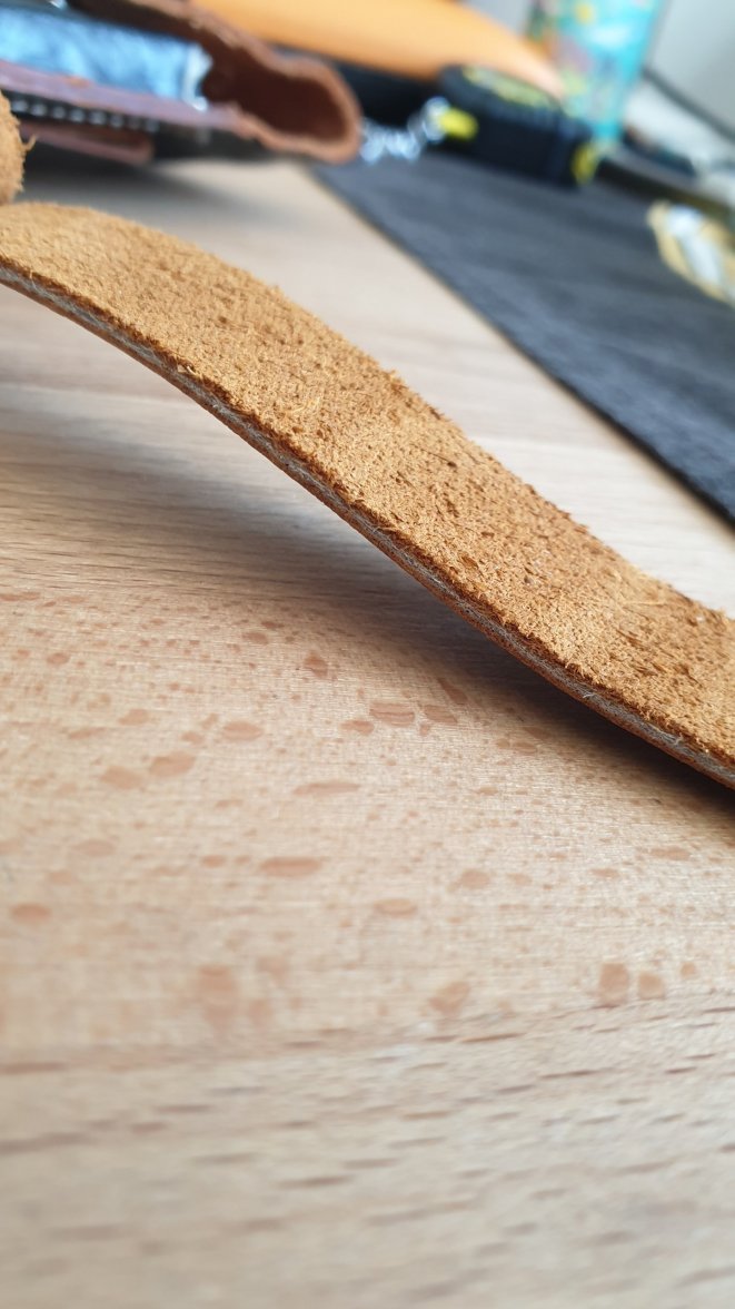

Looks like you'd have to sand down the top and bottom. Just sanding the bottom makes it seem you'd go right into the middle layer.
Personally, I wouldnt do it.

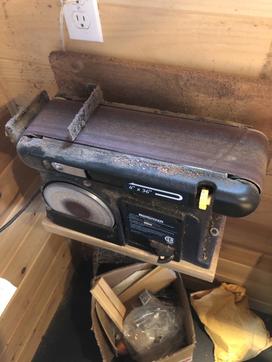

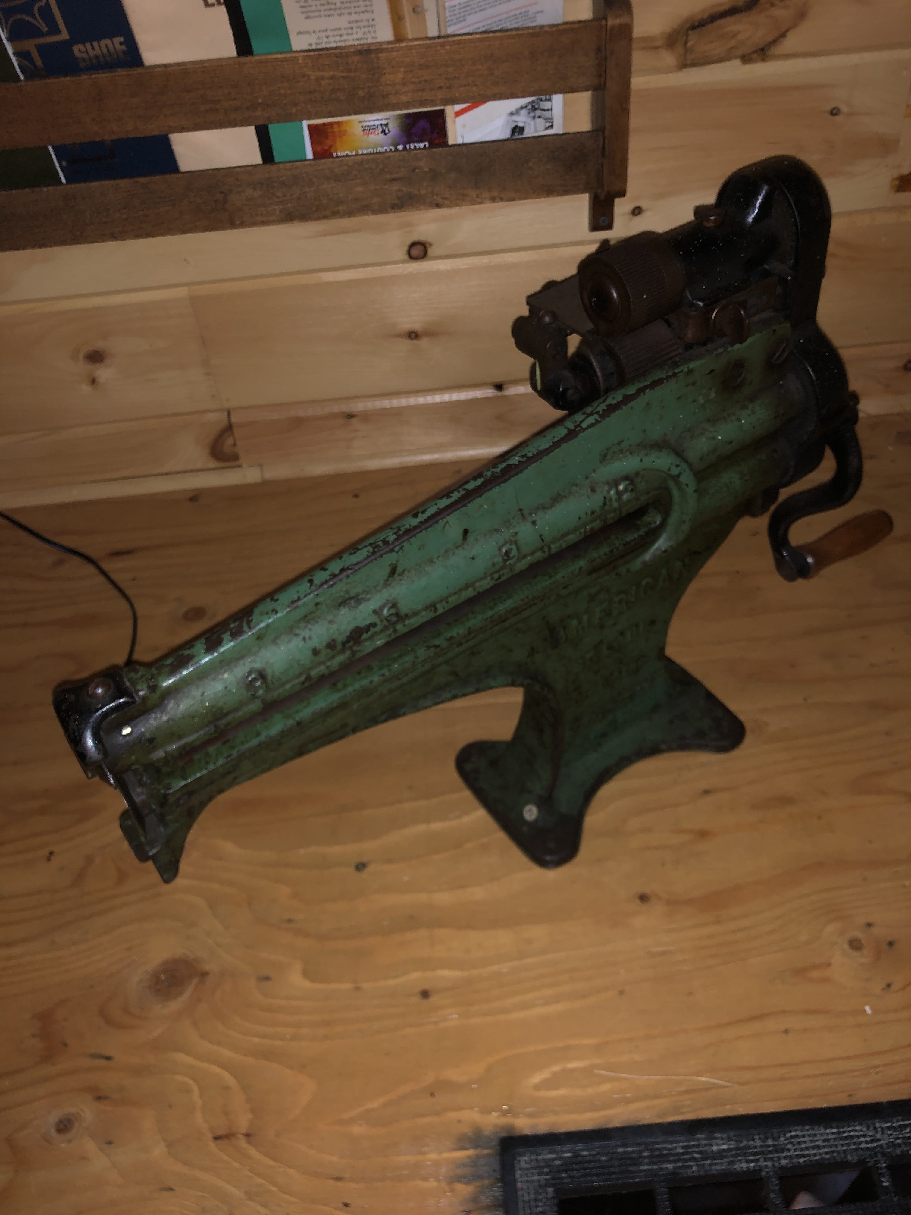

Tough. On a day to day basis, and only while making straps (not after they are finished) I use a hand held skiver (looks like a razor). I also use my belt sander with 120 grit, and if all else fails I have a monster machine (see pics). If your leather is oily though it does not always work well. It may be easier to try to pound it with a hammer. This may compress it enough to let you slide it through before it expands again. These fixed lug straps are next on my to do list. (For trial and error)!!!

Very helpful indeed. I've experimented on a spare (lower-grade) leather strap, and the sandpaper seems to be working. We'll see . . .
