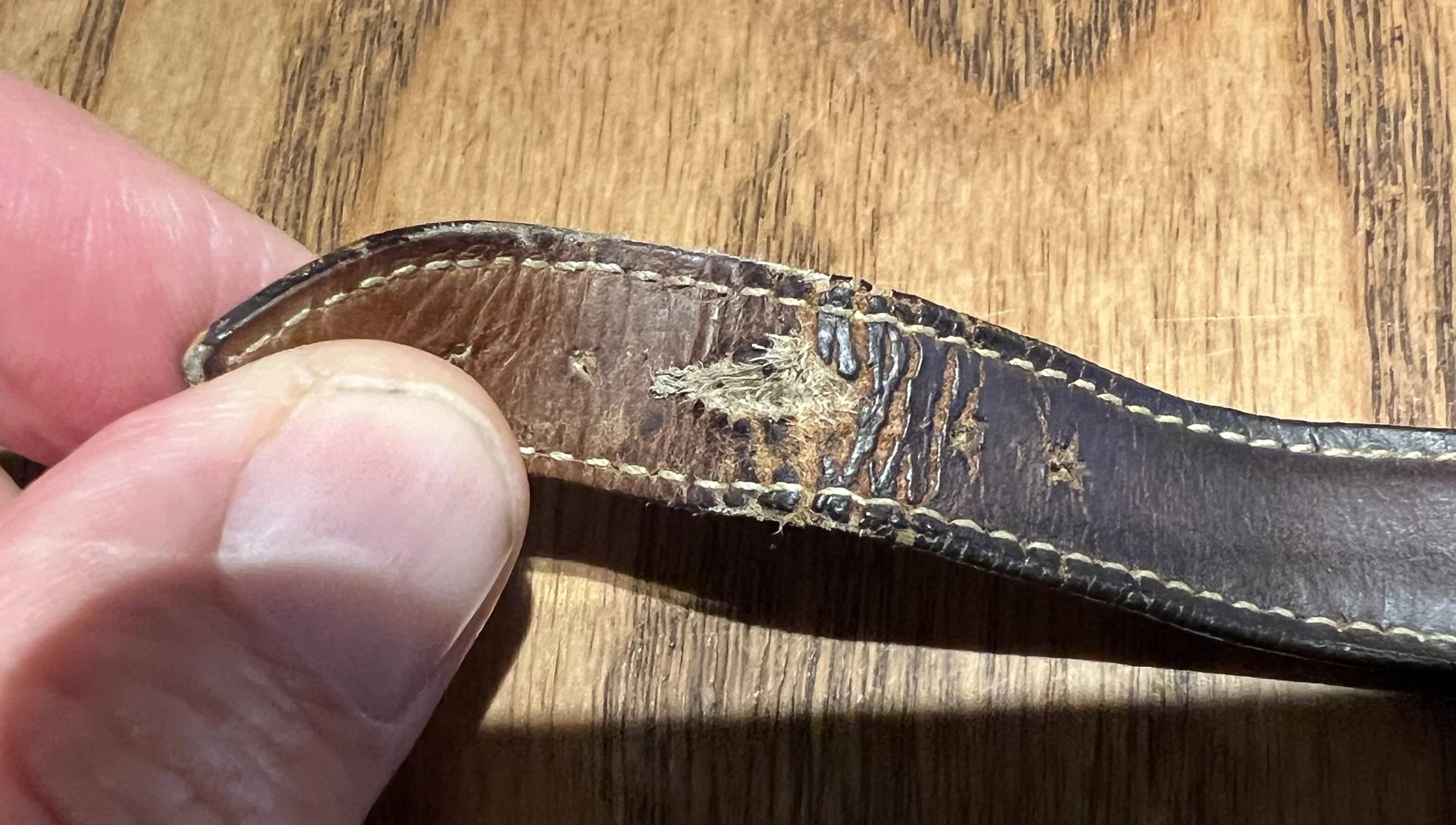

Hi chaps
My JLC Reverso ostrich strap is becoming worn. The outside has a lovely patina, so I don’t want to change it (not to mention that JLC straps are pricy).
Does anyone know how Incan repair it myself please?

Leather wears out over time, your strap Isn’t fixable, replace it.
13,935
54,146
Will defer to our leather experts like @Duracuir1 … but… You have a nice watch at risk IMO.
5,076
15,712
I’d say it can be repaired, at some expense, for presentation, but not for wearing. There are few but certainly some 19mm straps available. The Reverso’s lug holes are pretty close to the case, so some thicker straps won’t fit. You’ll want to look for a fine strap, not a beefy one, not that you would anyway…
2,997
4,752
I had success using the open weave fiberglass stuff used in patching to repair a pigskin strap. Barge cement (shoe glue) is great at holding the peieces back together once they have been cut apart. I had to resew it. The tricky part was the buckle as it does not use a springbar. edit: I find the thinnest beading needles work the best for re stitching. There are plenty of YT vids showing how saddle stitching is done.

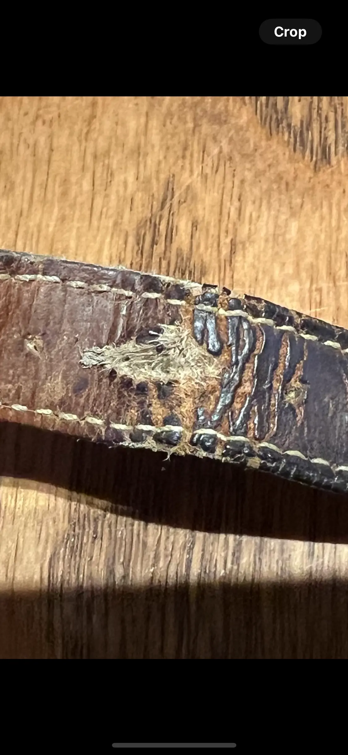

I don't know what I'm looking at in those photos, but the strap doesn't look like it's about to break, so maybe you should just keep using it. Eventually it will need replacement, because straps don't last forever.
Yes that is an option. No, I don't think it is about to break. But is is a nice, patinated, strap and I'd prefer not to replace it if possible.

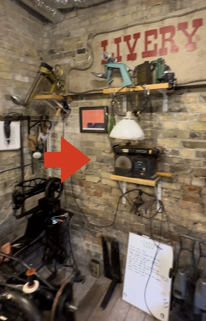

In my shop I have the advantage of having leather dust from my belt sander. (Usually collects where the arrow in my photo points).
Mixed with glue in just the right amount and then burnished.

If you like your patinated strap, buy a new one from the same maker and put yours aside as is. Use it on special occasions. Your new one will age with use.
