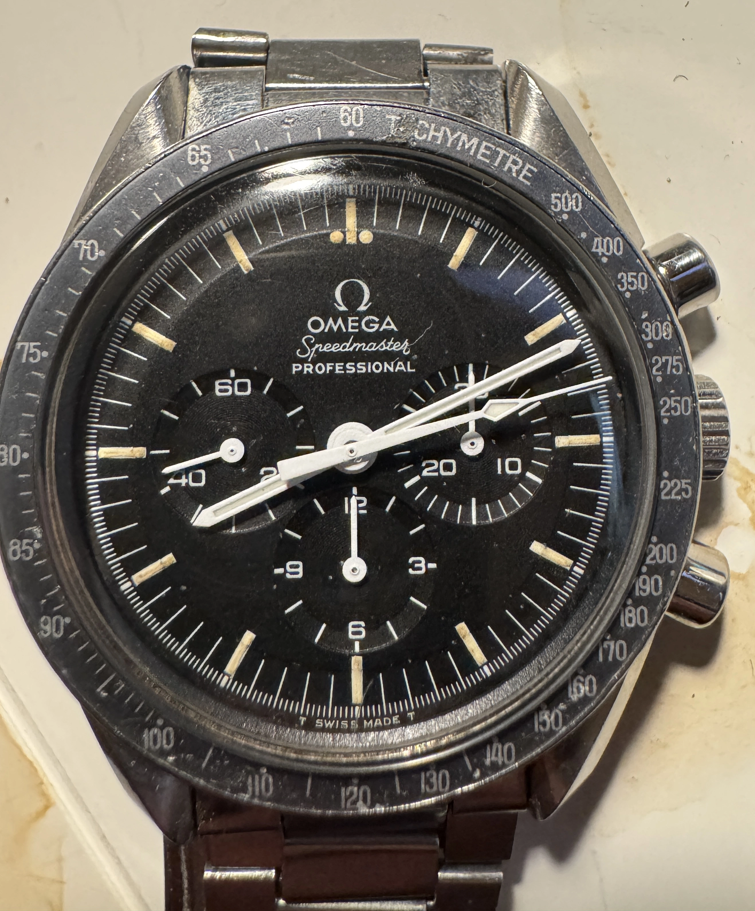

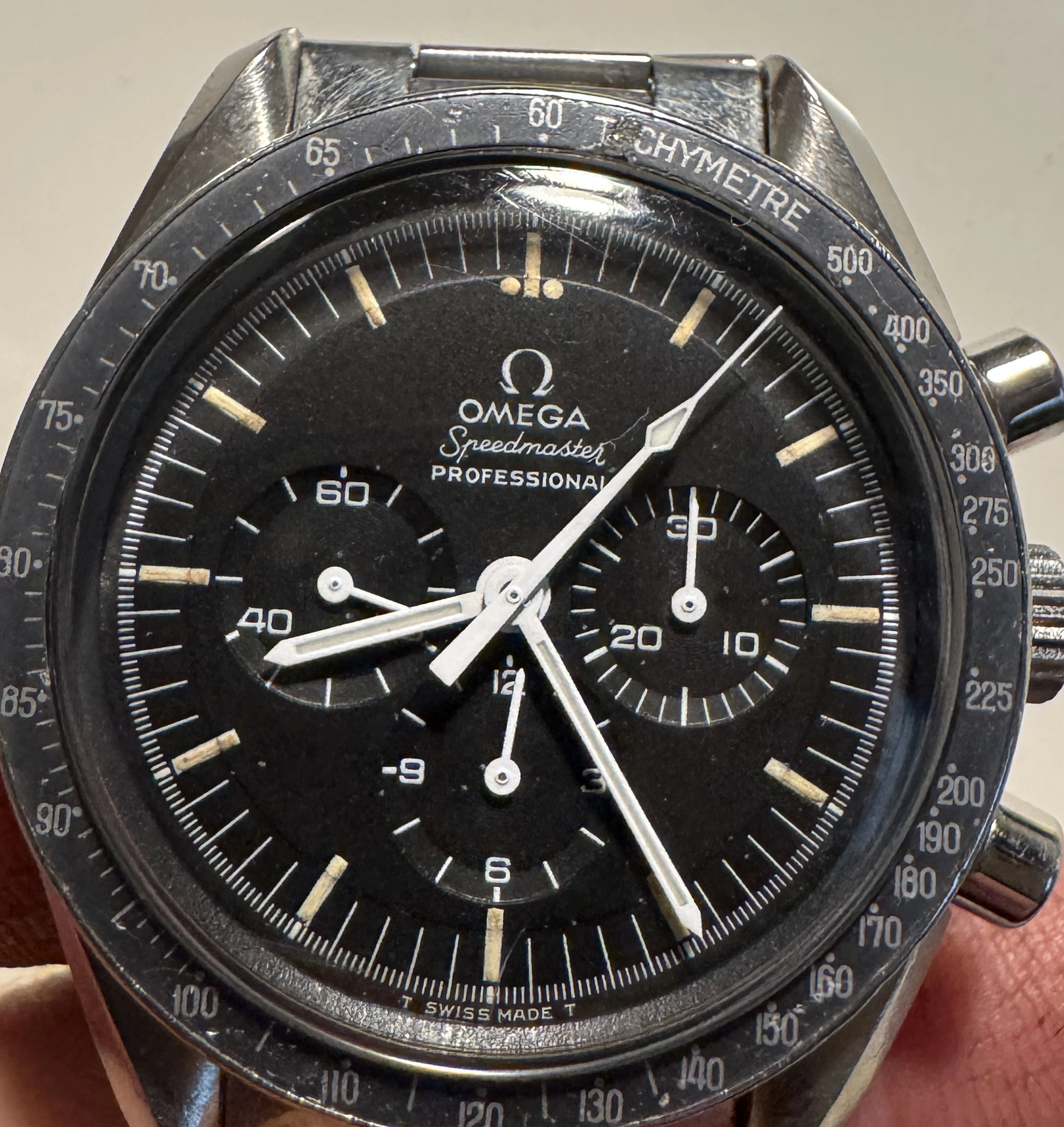

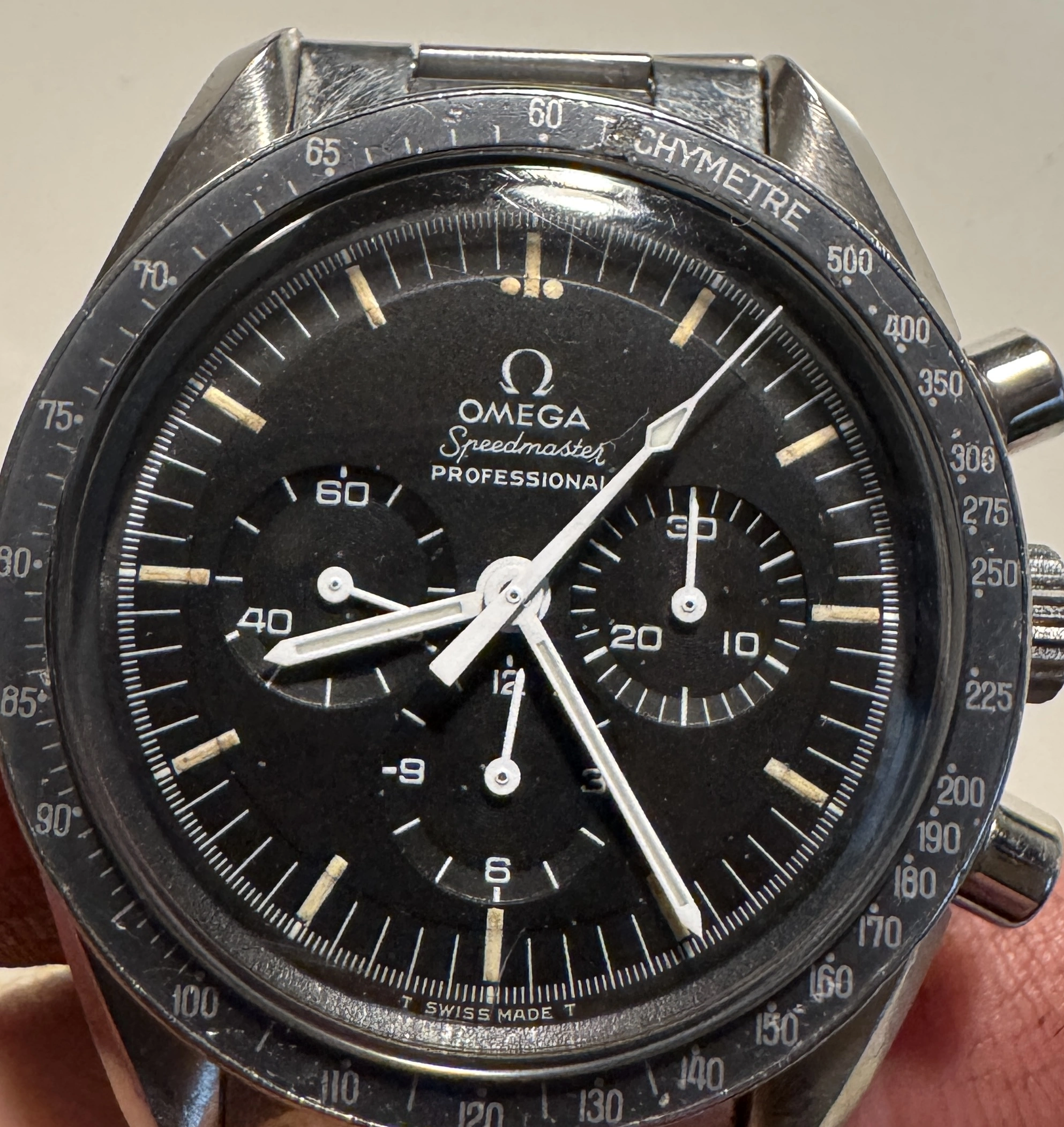

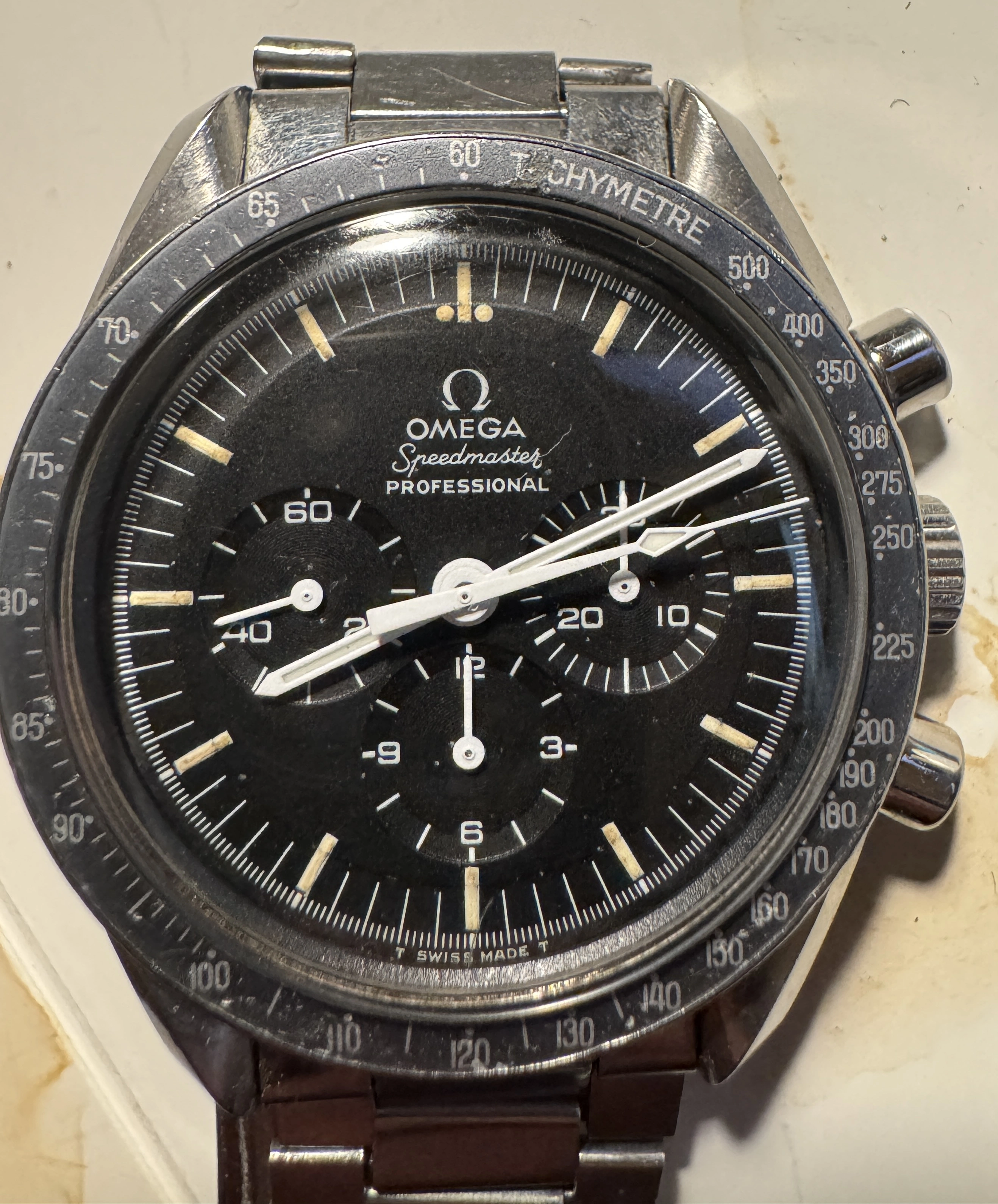

Here are pictures of the two typical reset points.
I have started and let the seconds sweep run a little bit after the reset, to give a clear sight of the locations the hour counter resets, BTW
Picture#1 is a reset after typically less than 10 minutes or more than 6 hours.
Picture#2 is a reset after 15 minutes to approximately 6 hours.

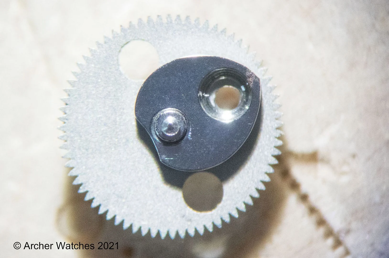

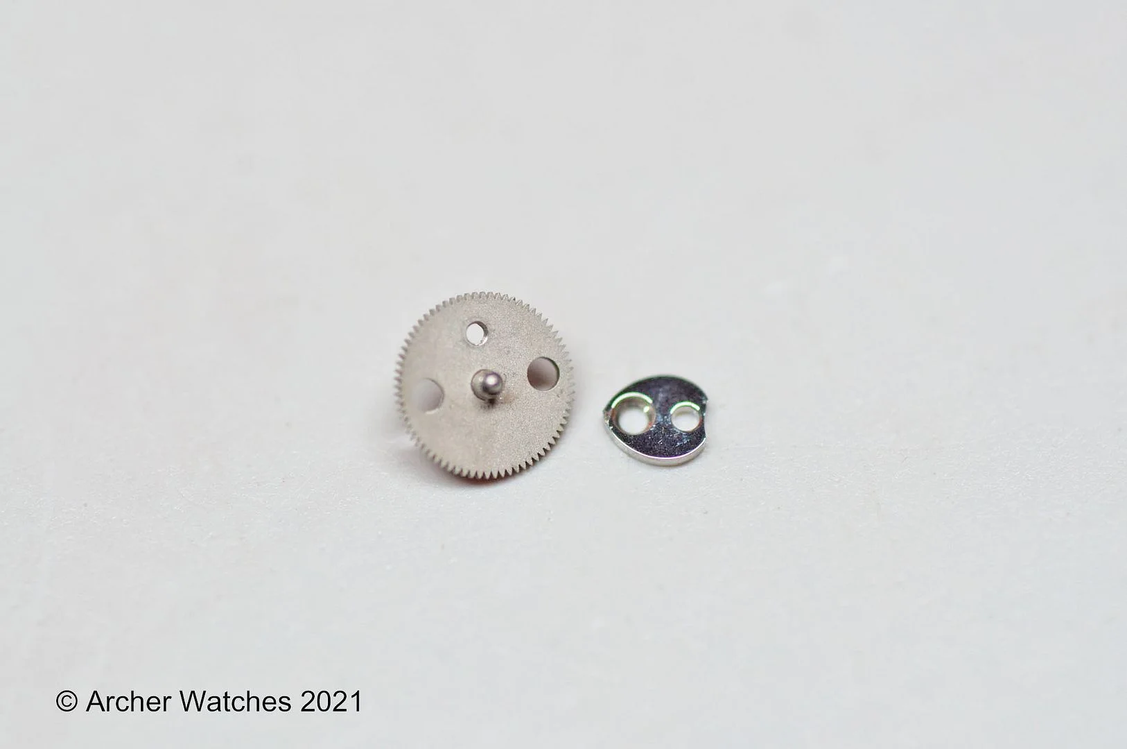

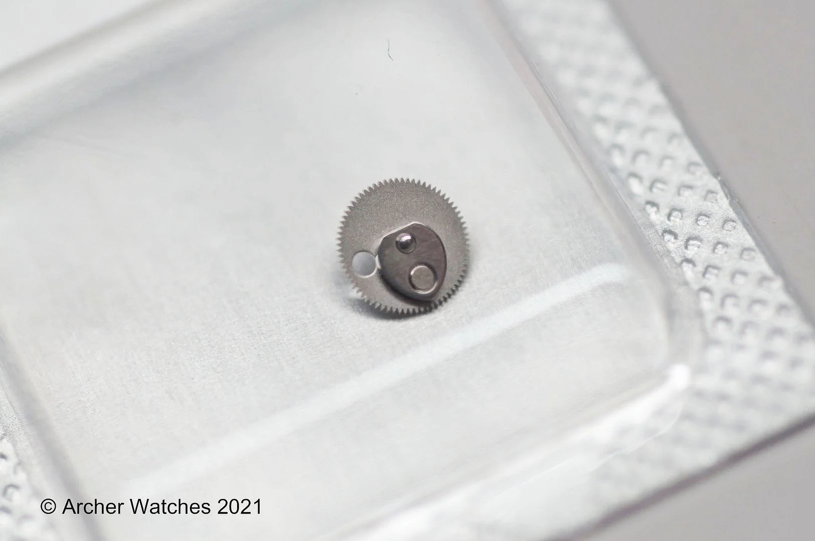

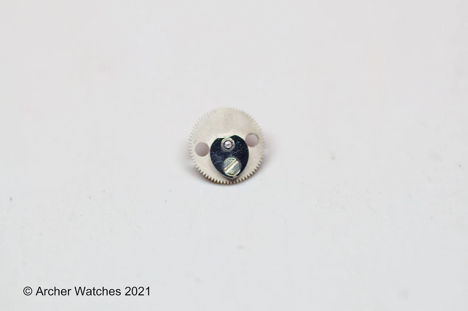

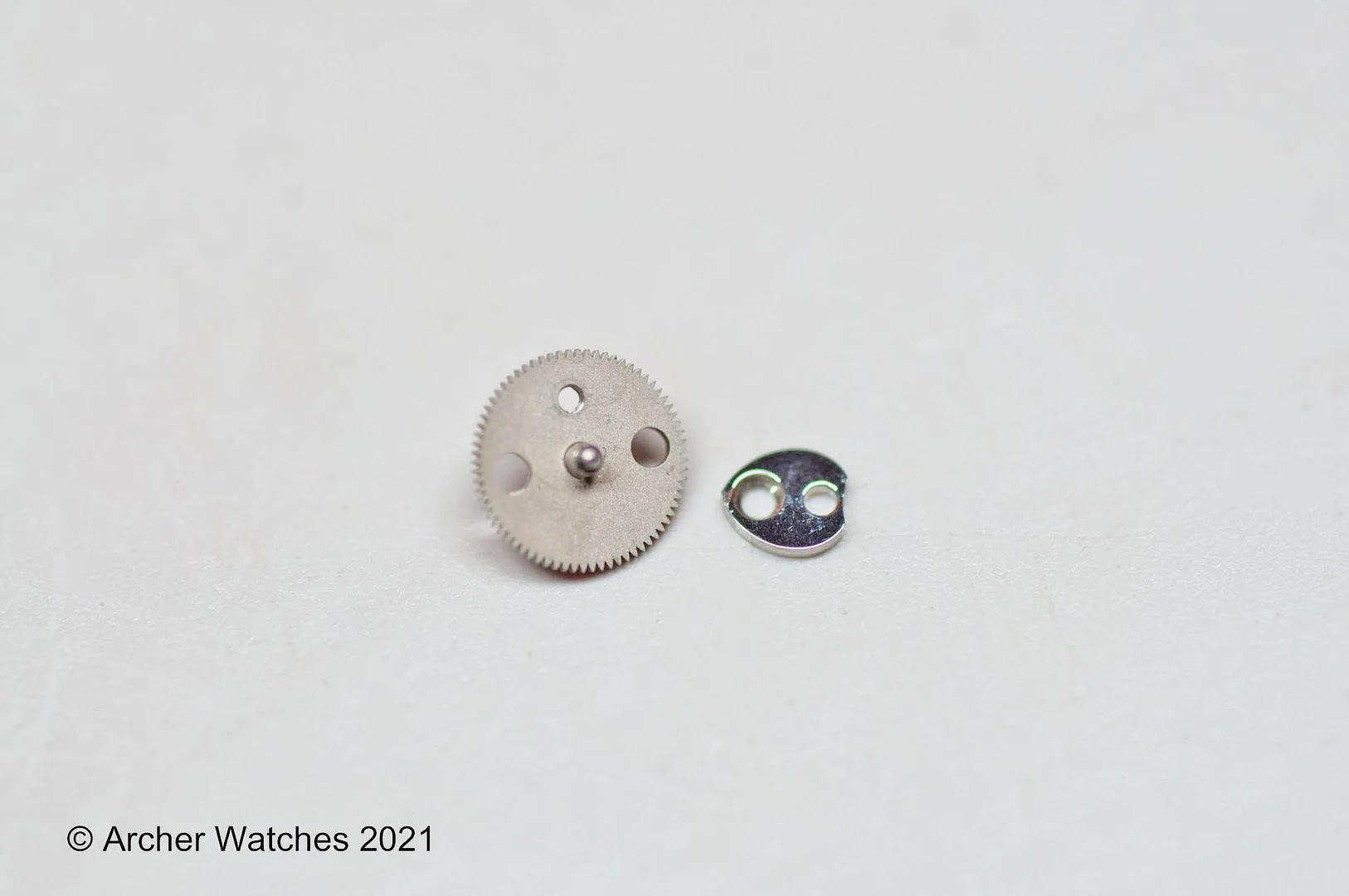

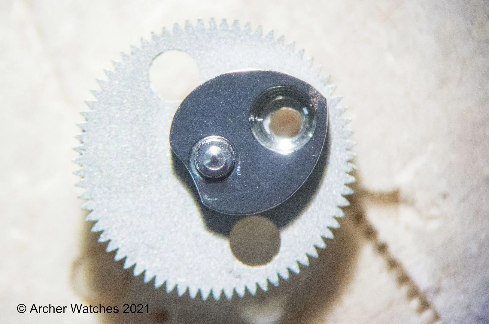

That sounds like it has an older style hour rec ording wheel. This wheel was originally produced with a screw holding the cam to the wheel, so it was possible for that screw to come loose and fall out - I've seen that several times...screw missing here:

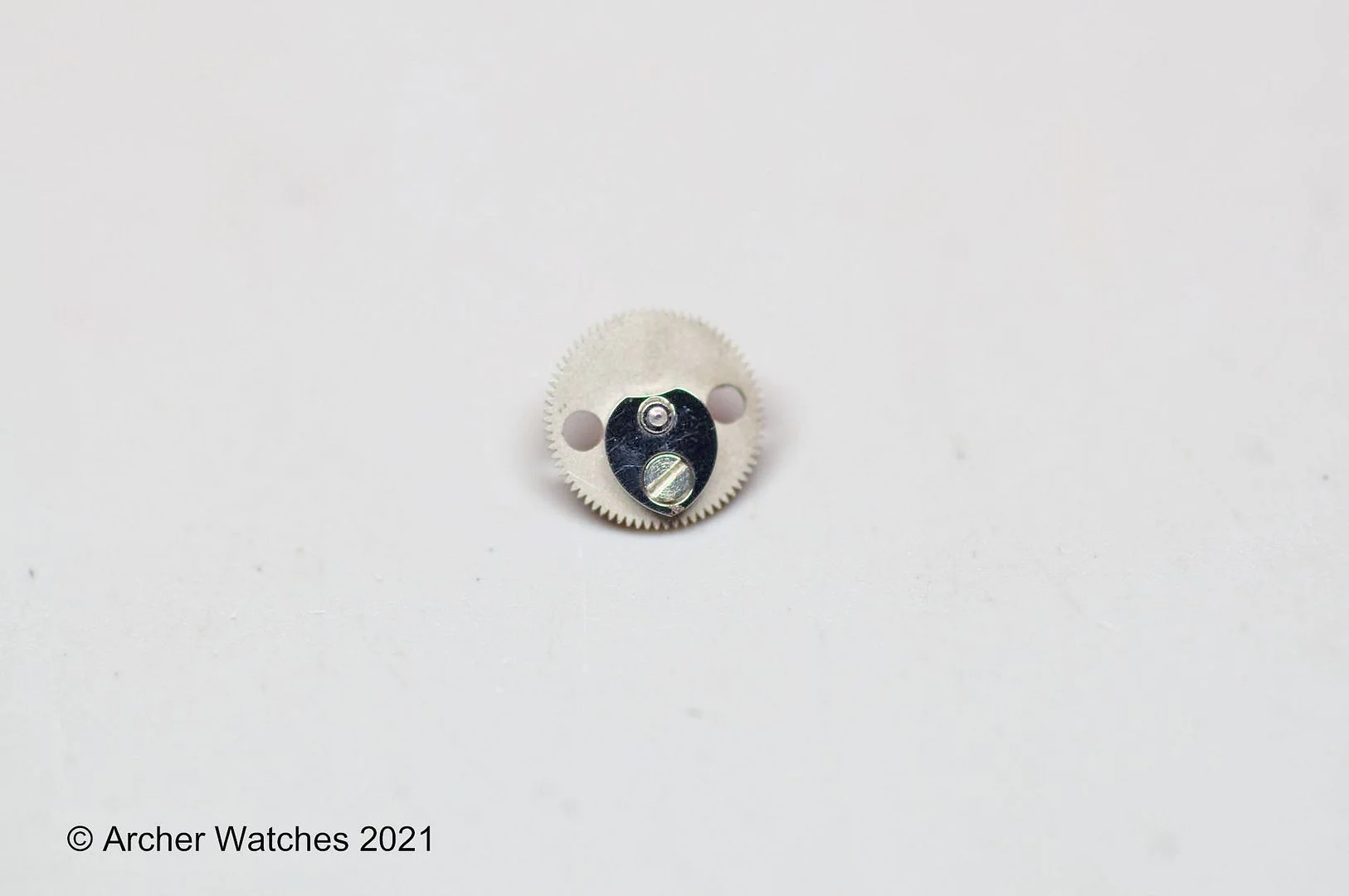

And assembled again:

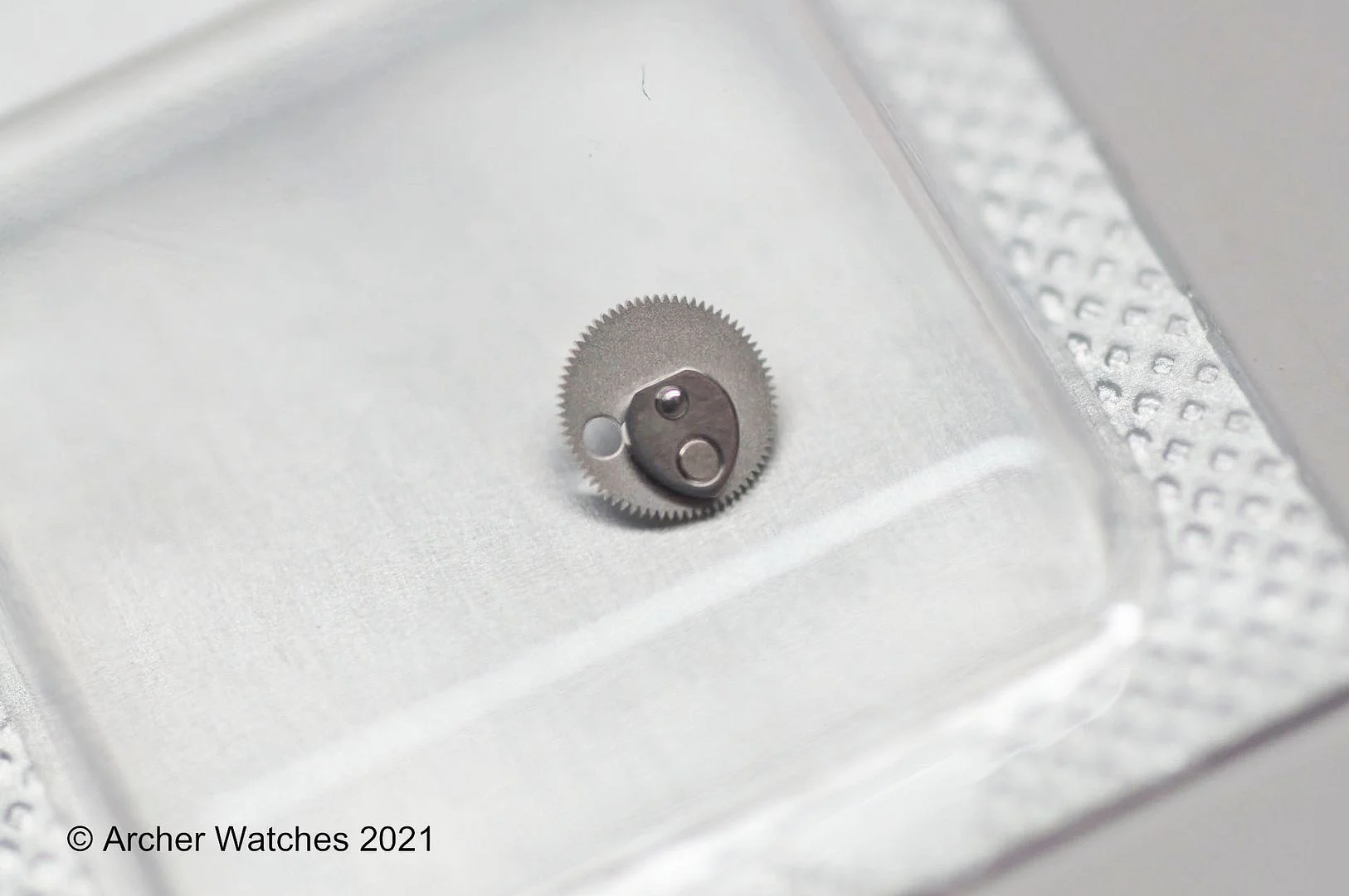

Omega changed the design of this many years ago so that the cam is now riveted to the wheel, so this fault cannot happen:
Typically when this happens the screw falls out completely, and the hour recorder hand won't reset at all.
