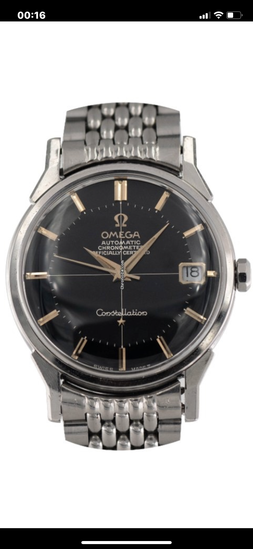

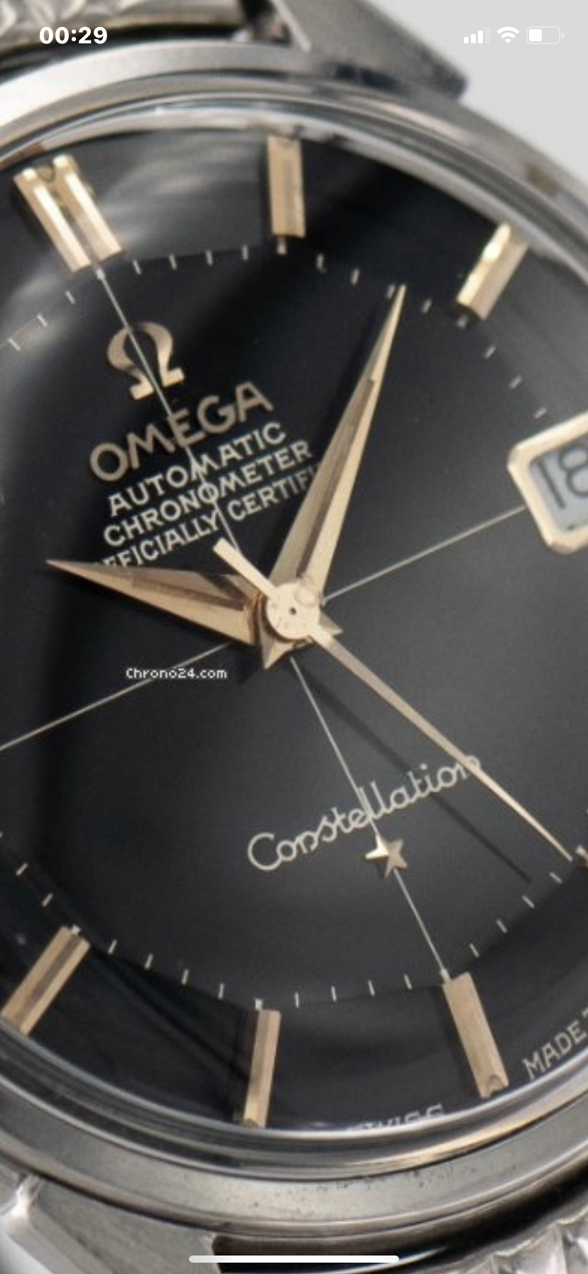

I may be completely out on a bike ride here but has this connie’s dial been redone. It looks lovely but I thought the minute markers are not meant to touch the edge, where the dial changes it’s slope. Also the “R’s” in chronometer arr different to eachother. Its super expensive either way. I may be wrong but it just doesn’t look right to me.

Does that large omega script look off? I see what you are saying about the letter R but those photos are a bit blurry the Omega looks odd to me though

I would like to see better pictures in daylight but at first glance it looks to be a well preserved glossy black dial. See a bit of old lume on the dial. Case looks to be polished. But I have the feeling the dial is genuine. But better pictures are required. Price is absurd of course.

Well, as a new fan of vintage Omega watches, I have to say that is a stunning looking watch.
I agree that the two "R" letters on the dial don't match.
Also, the hour markers on the dial do seem to be placed such that they touch the inner dial.

Black dials are always a nightmare to judge. Especially if they are in good condition with almost no aging.

From the photos provided, looks ok to me.

Seems to be genuine and the seller is from Sweden. He sells by the name MarcelsWatchGroup on the Swedish auction site Tradera. All his watches are extremely overpriced.

These minute markers on this watch are not touching the “edge”, which is what I always check for. But if the minute markers are touching the edge, as they are on the Connie on Chrono24, it doesn’t necessarily need to raise a red flag? I thought they should always be a space between the minute markers and the “edge”

Both variants can be found.
