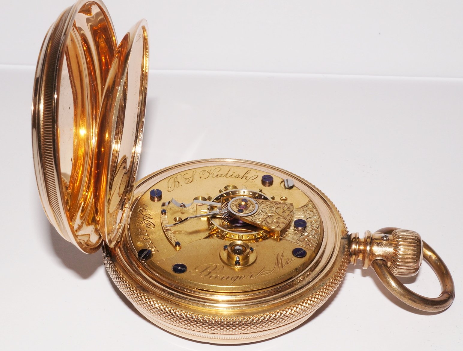

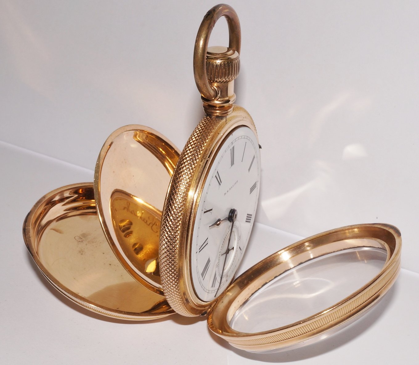

The Illinois Pocketwatch Thread
8,841
62,604

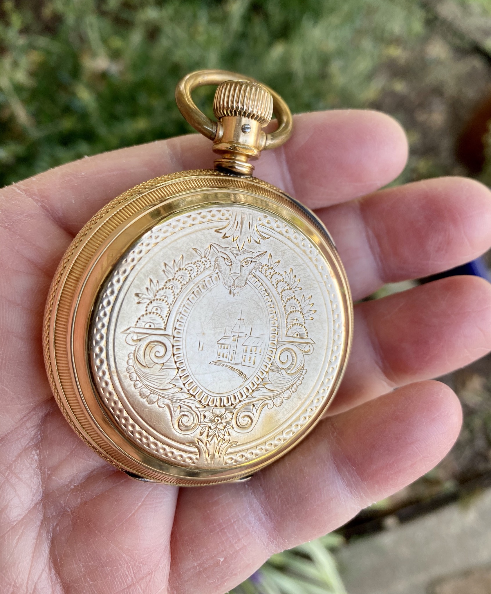

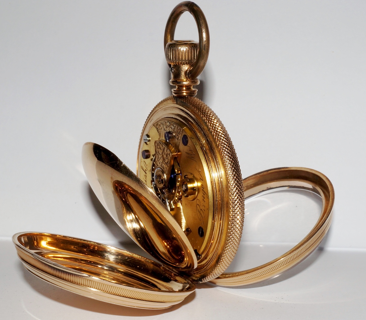

Illinois private label
Model 3 Columbia grade
Transitional (5th pinion) therefore SW/KW
Circa 1881
GW Ladd case
Triple hinge
15,963
47,957

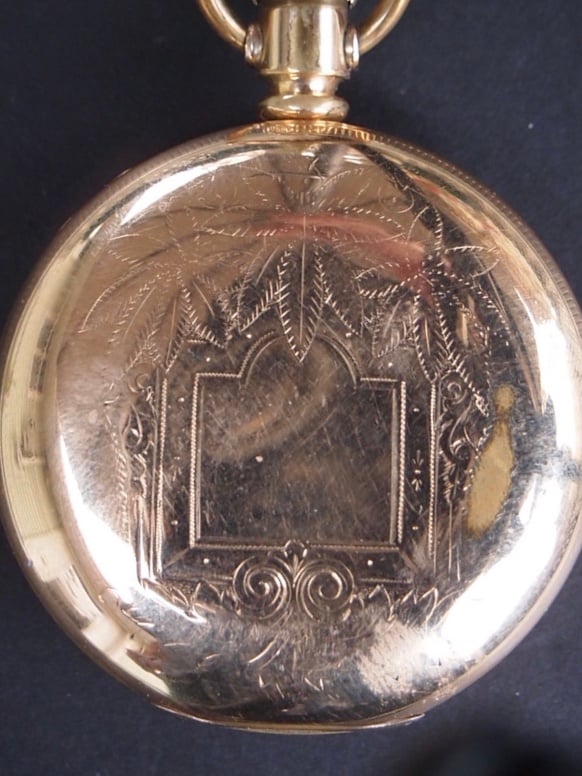

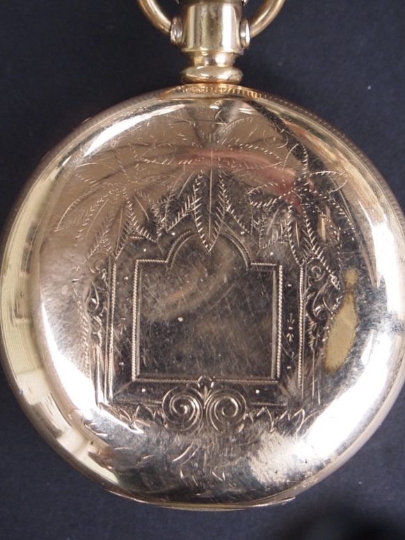

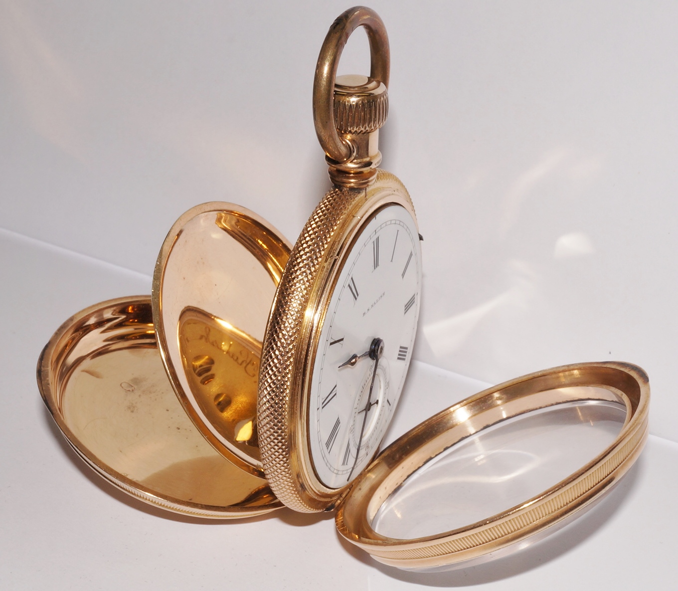

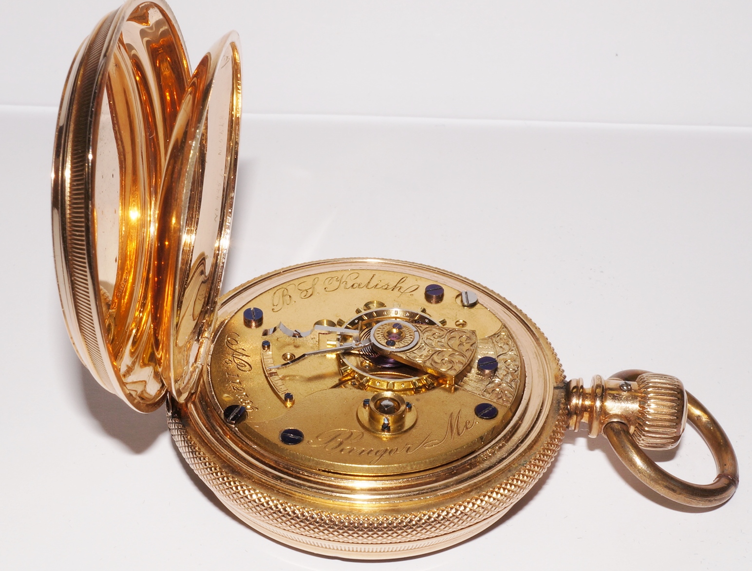

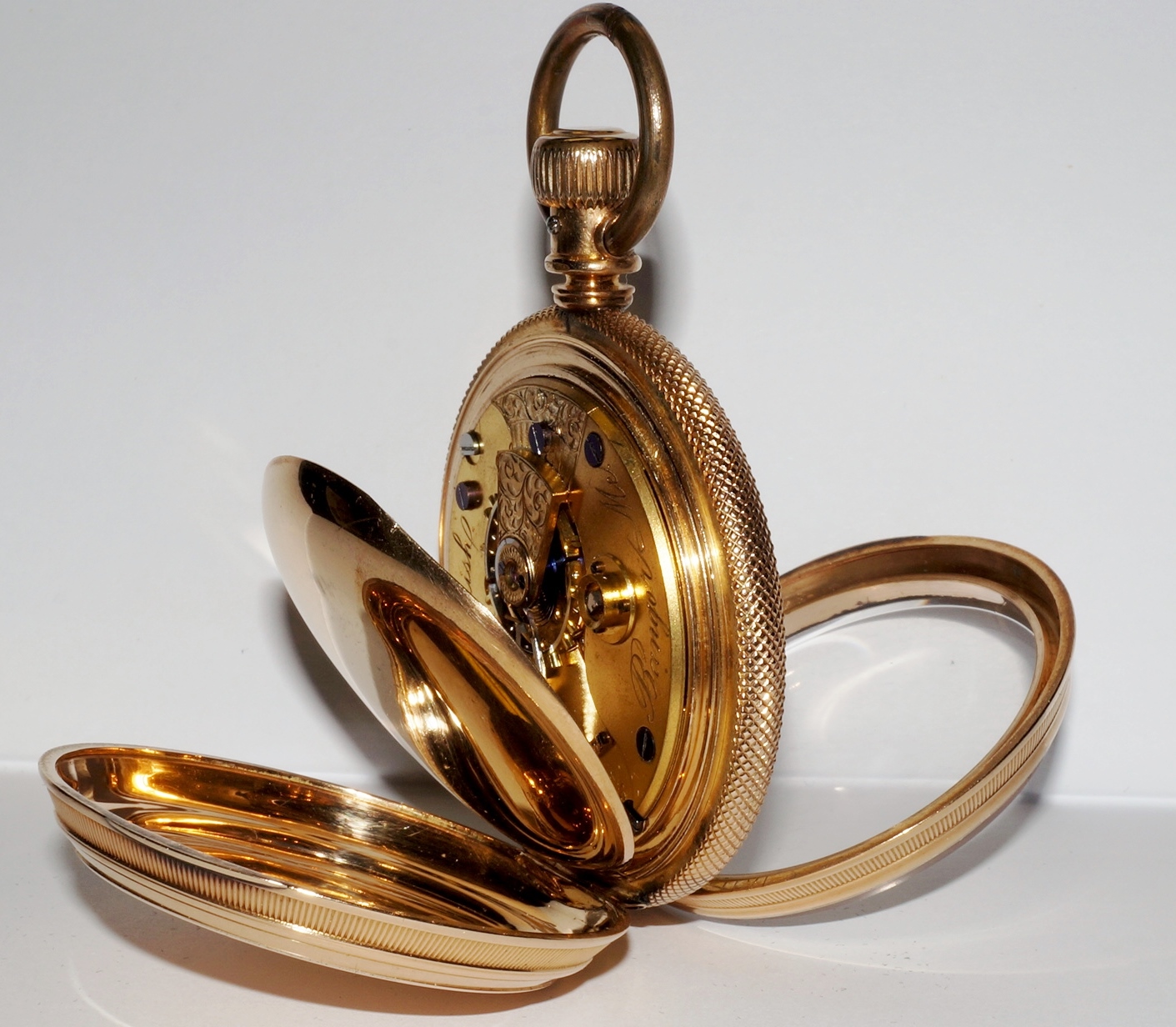

When Illinois decided to introduce an open-faced, 18-size watch, they didn’t have a movement suitable for the open faced case. The model 2 was designed for a hunter case, and was a transitional key wind which could be wound either with a key, or by the stem. Fitting the model 2 movement into an open faced case would Involve turning the movement 90°, and making a new dial, and it would leave the seconds hand in the wrong place. On the model 3, by adding a fifth pinion to the model 2, 180° across the third wheel from the fourth wheel (which carries the seconds hand on the model 2), they came up with the model 3, commonly called the “fifth pinion” model. The second hand is a little closer to the centre of the dial on a model 3, as compared to the model 2. Nice watch!
15,963
47,957

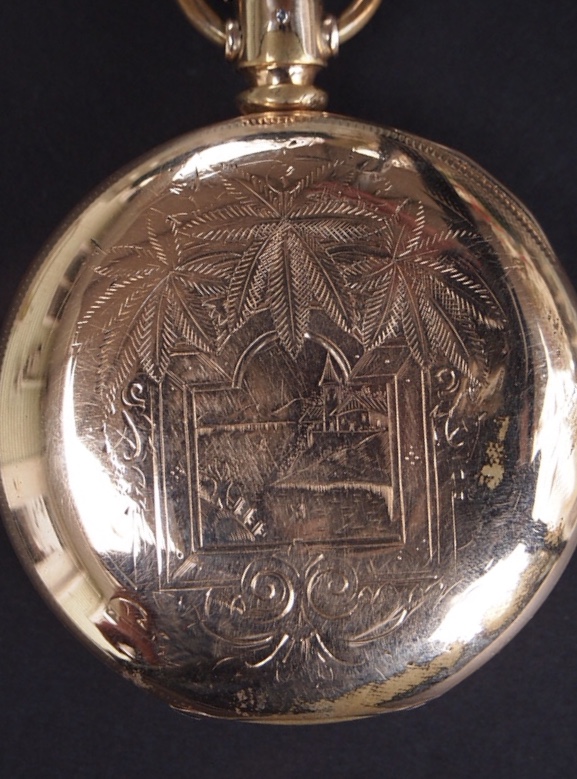

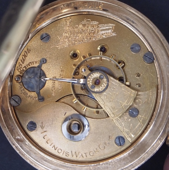

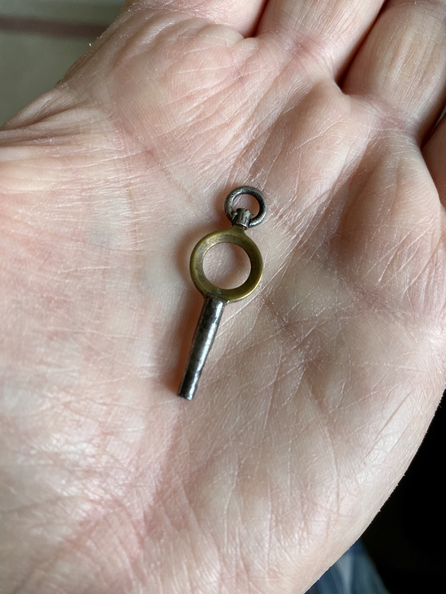

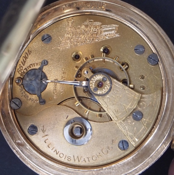

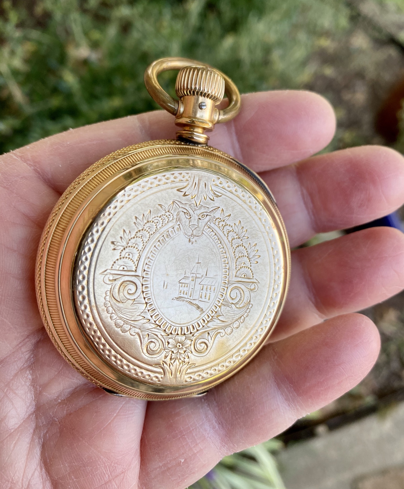

This is a model 2, grade 4 Illinois Railroader. 18-size, 11 jewels, transitional key winder (can be wound by stem or key), hunter case, circa 1887. I am told the Railroader is the only Illinois ever produced that had an image engraved on the plates. The image is a hand-engraved rendering of a wood burning locomotive. One of 4,500 made.

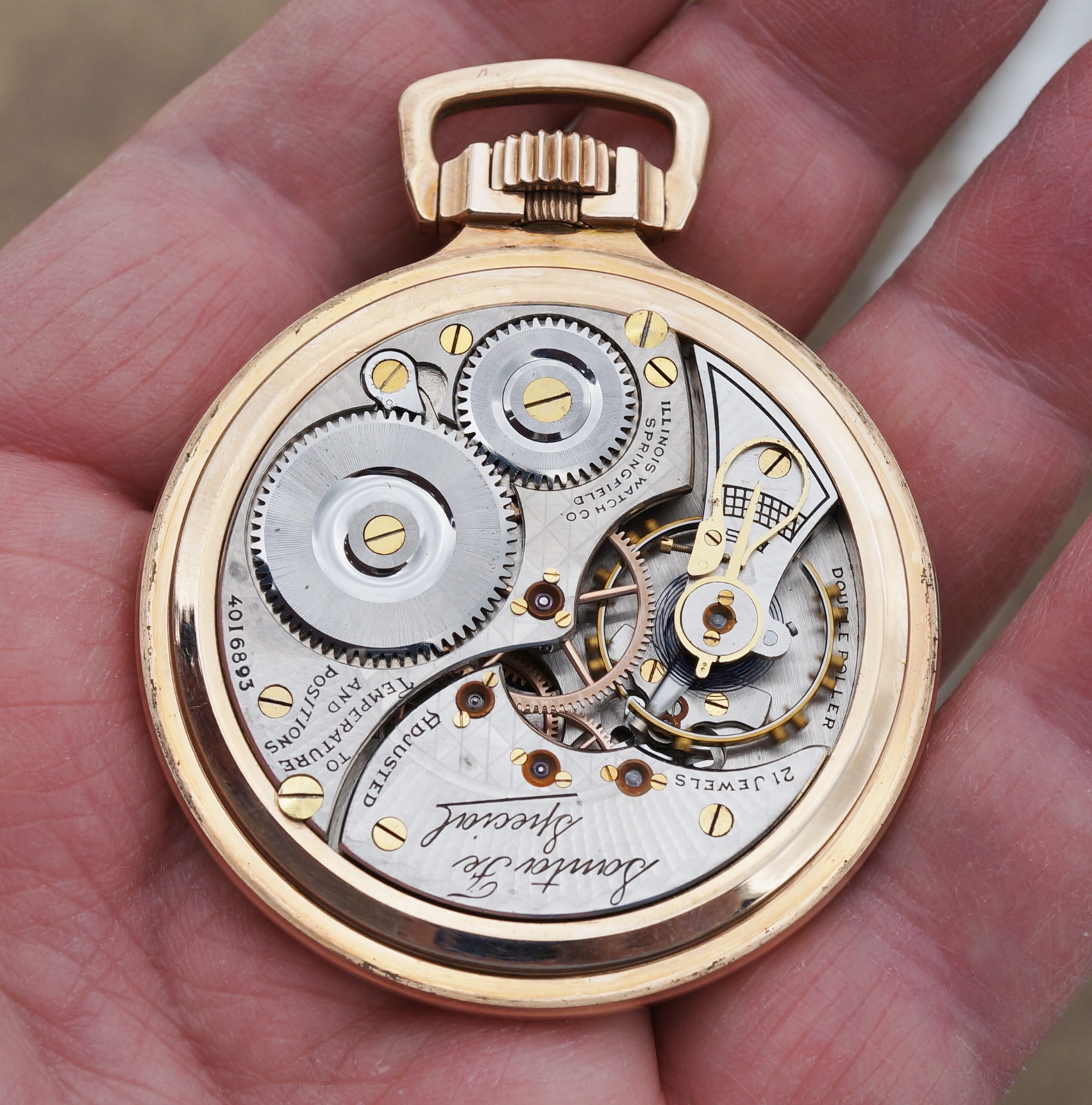

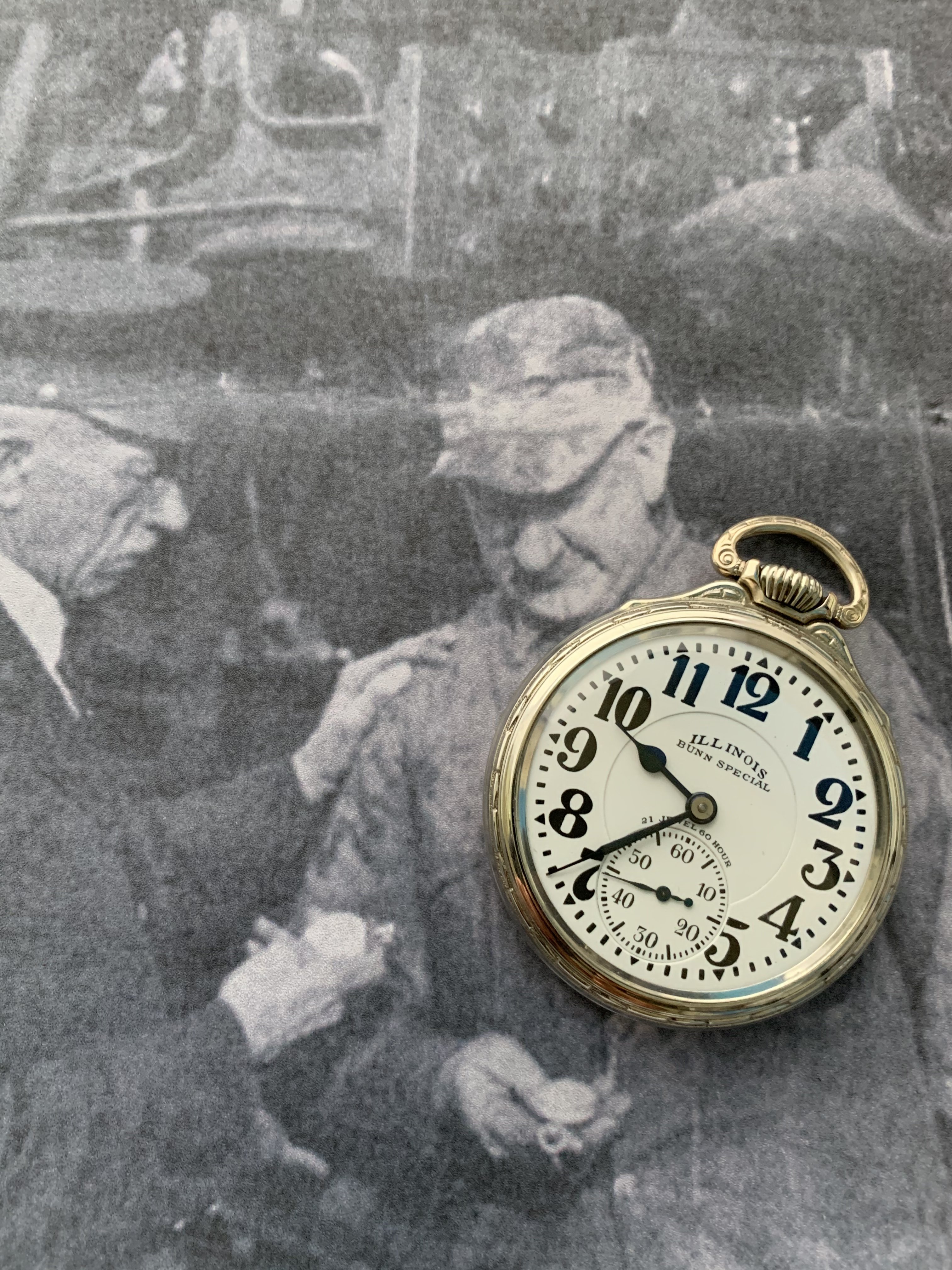

I like some of the older models you guys are showing, keep it up!

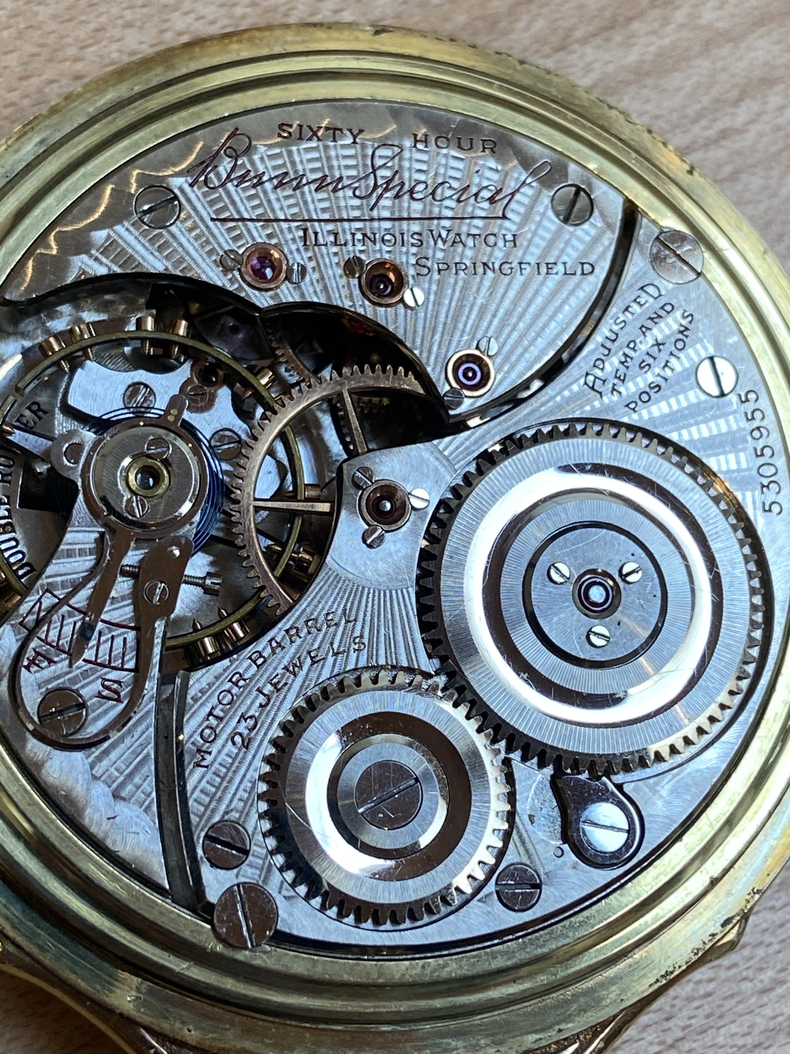

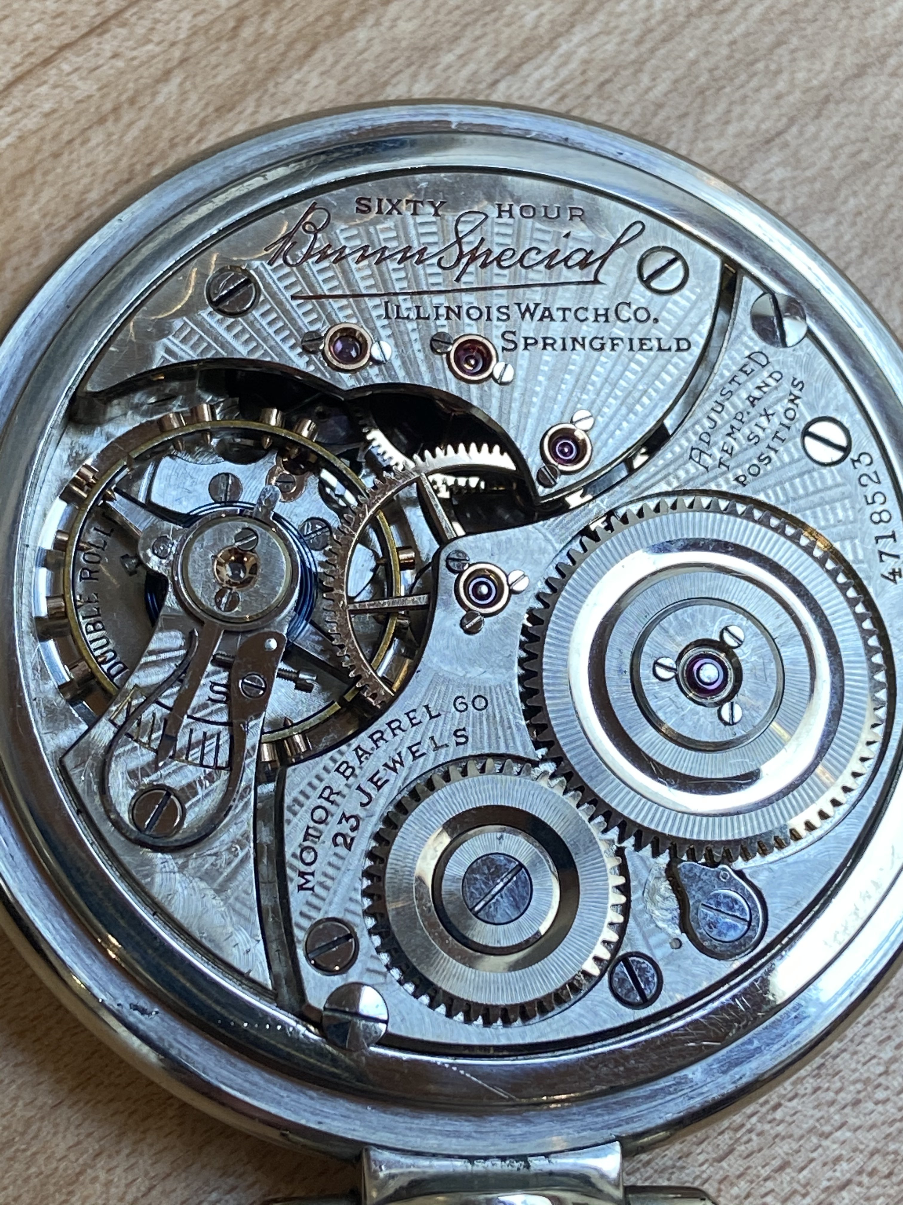

Me, like I have mentioned, I like the 60 Hour models that are from 1924-1932. This is the end of the Illinois Era, the transition from the sale to Hamilton began in 1928. This was (IMO) the pinnacle of watchmaking in the US before pressed jewels and Swiss movements became the norm.
So let’s talk 60 hour movements.
60 Hour moments came in 3 different jewel configurations, 19j, 21j and 23j all of which were Railroad Approved.
Additionally each jewel type also had variants with in the line. Identified variants are known as Type I, Type II and Type III movements. For both 21 and 23 jeweled movements there are also sub variants of Type IIIa and Type IIIb. Commonly seen as TI, TII, TIII in listings. The differences between these I will show below in 23j versions, same points for 21 and 19j models just different jewel numbers.

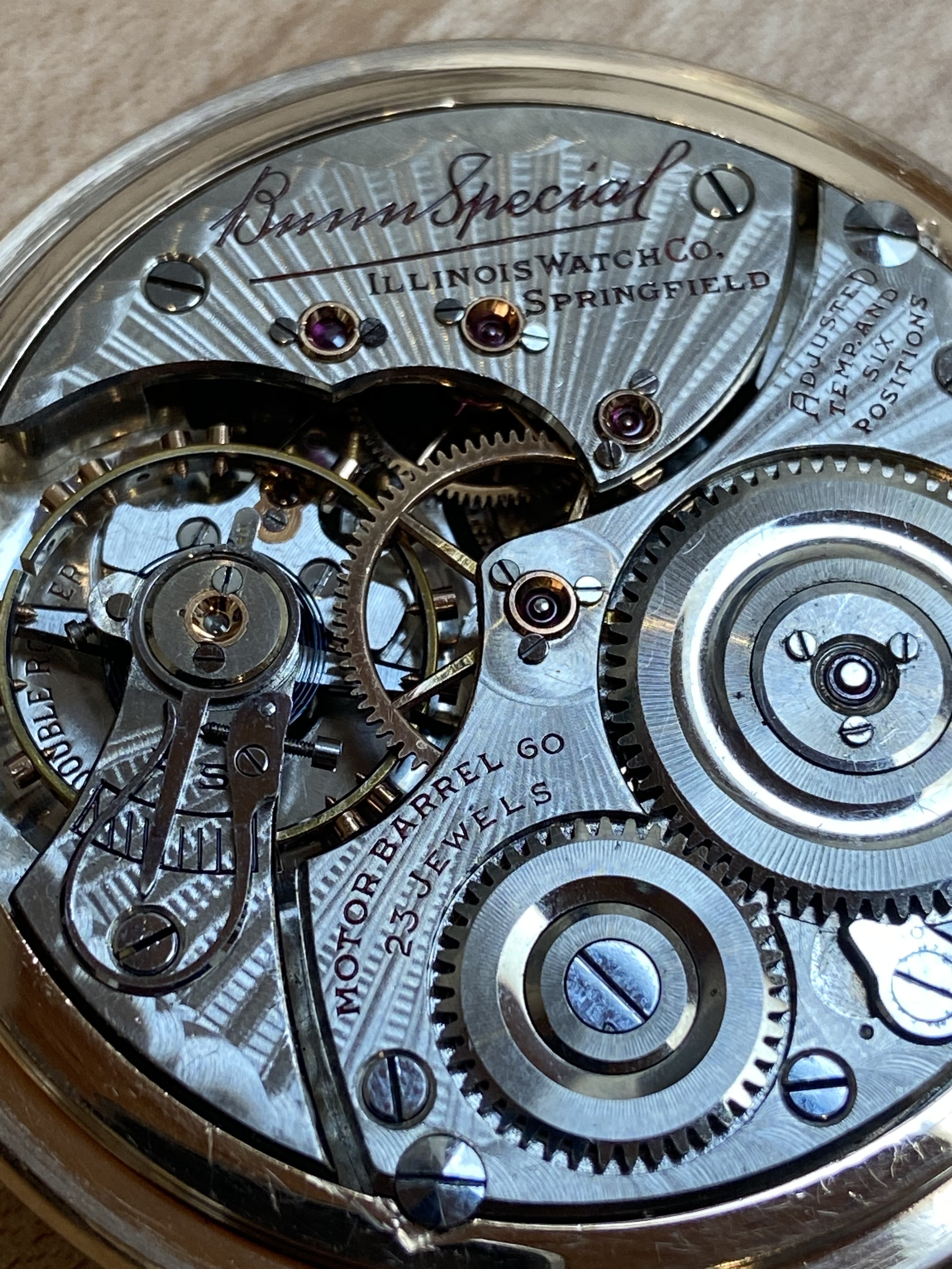

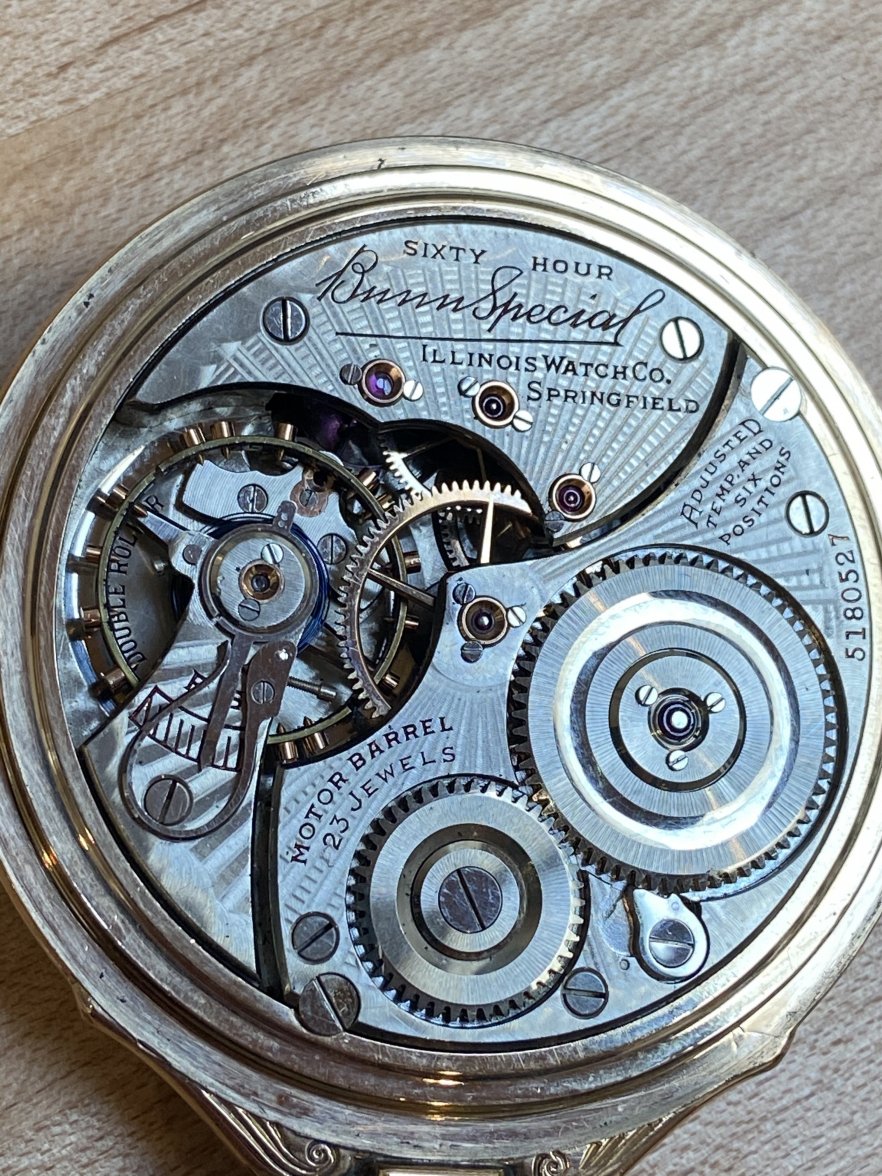

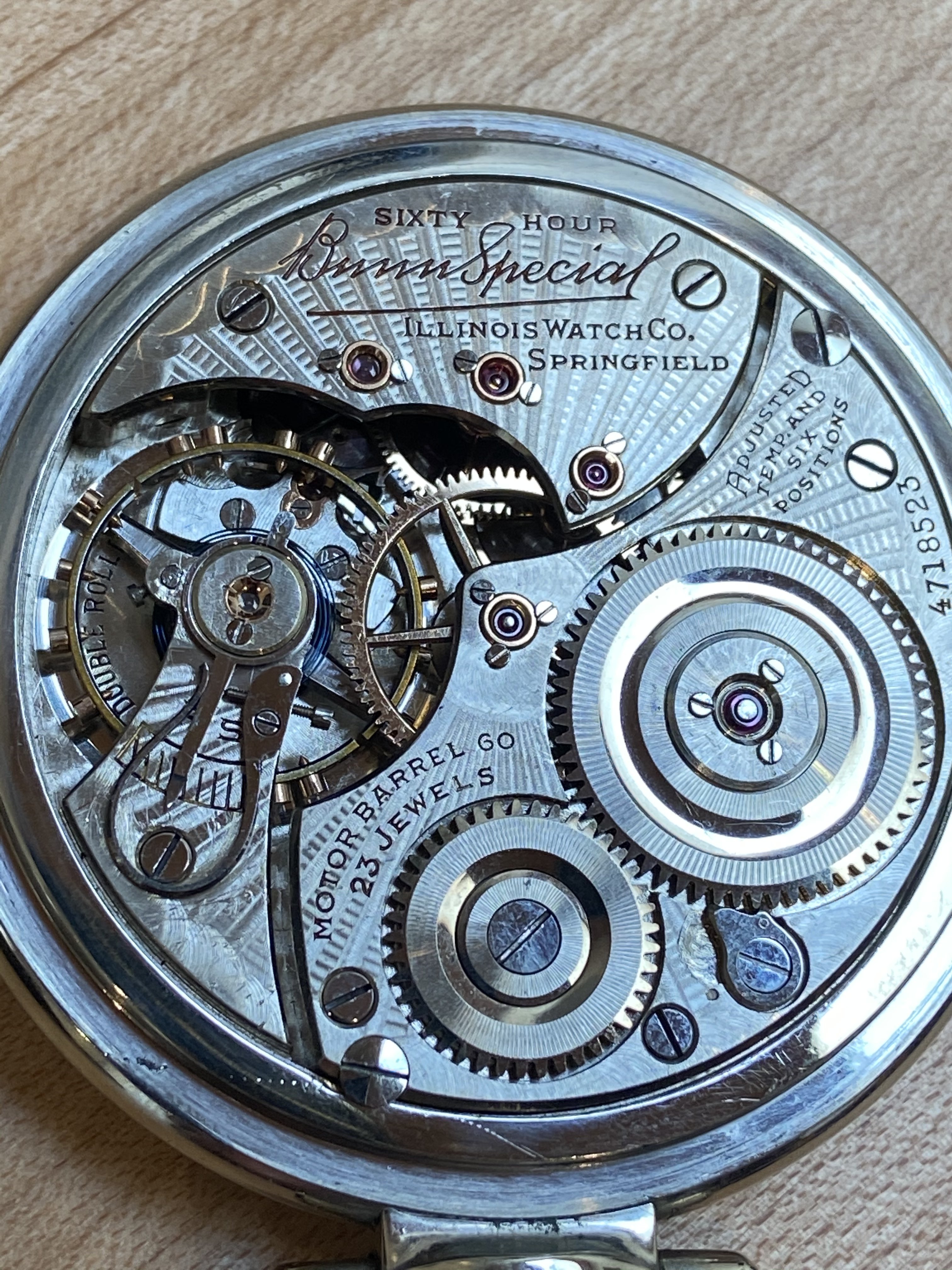

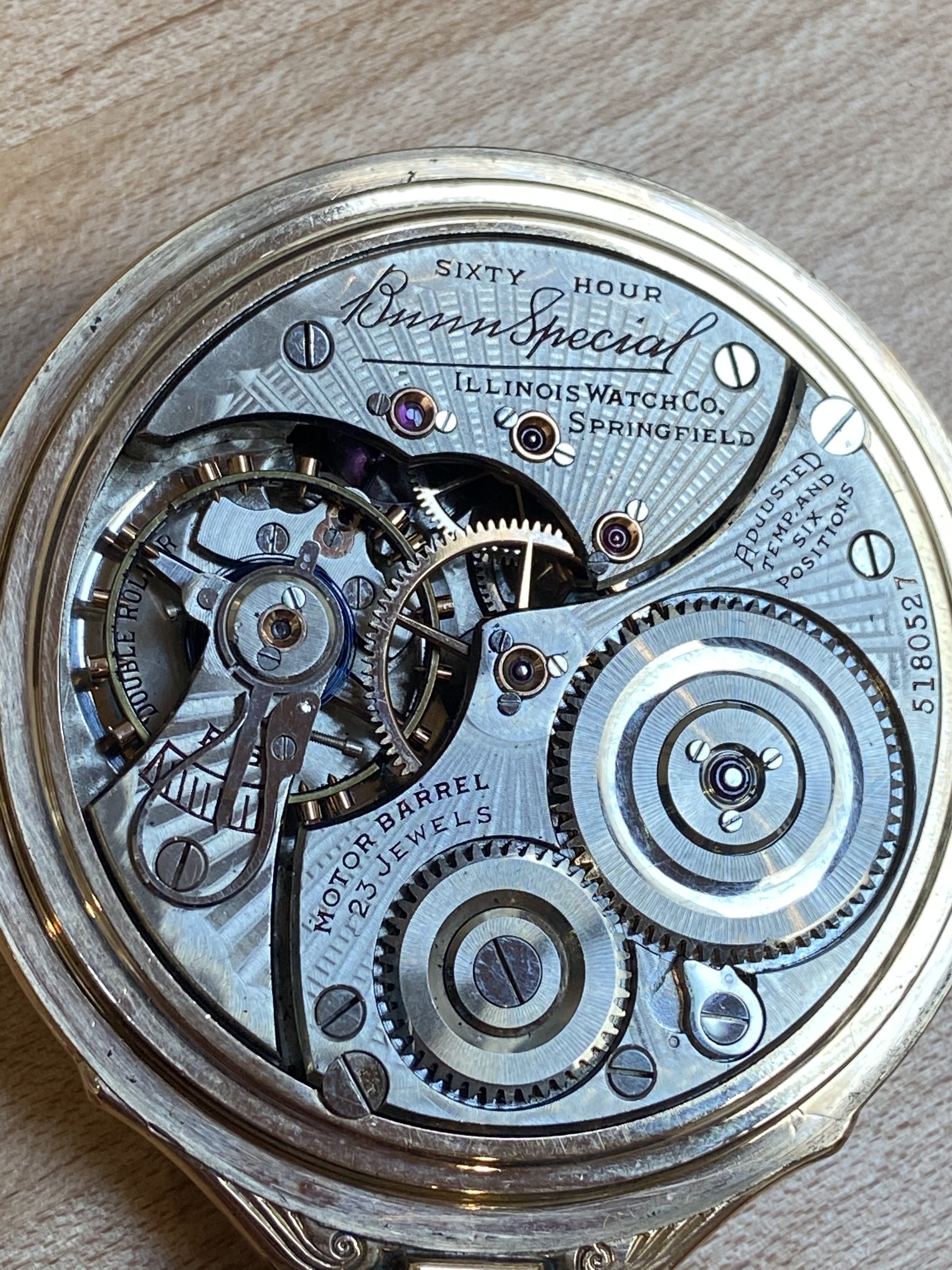

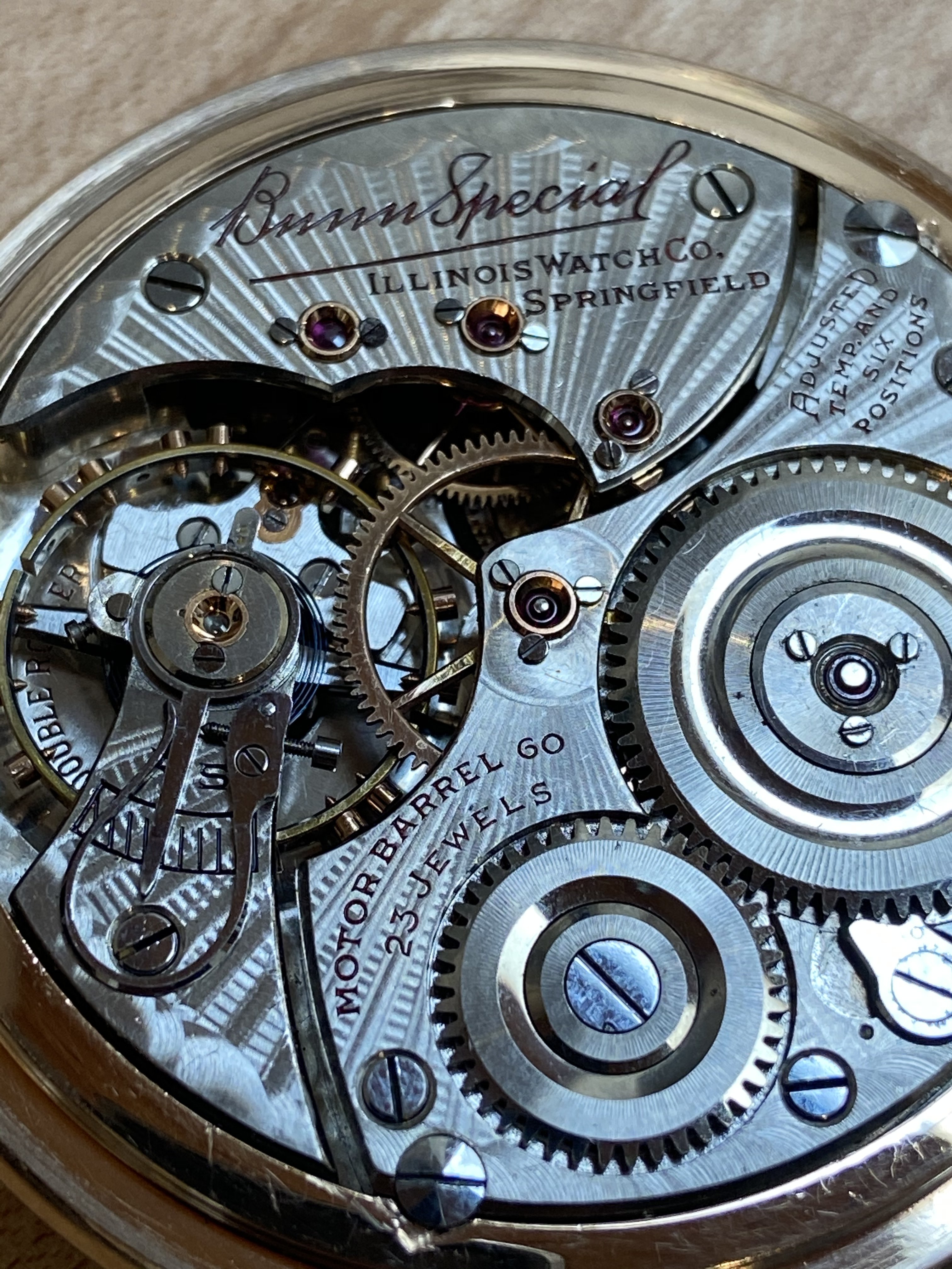

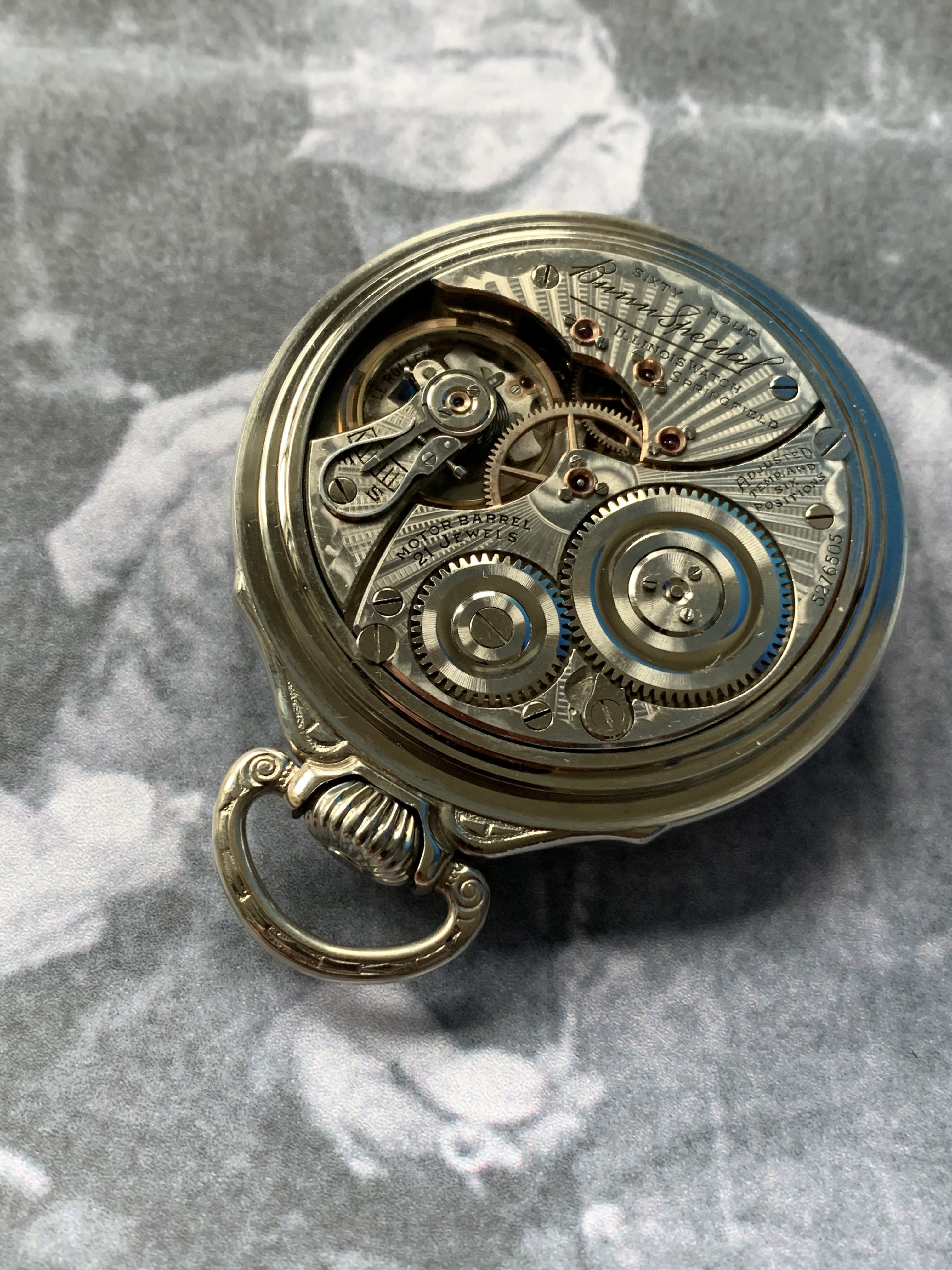

The 60hr 23j Type I (TI)
Marked “60” next to “motor barrel” only, no other notations of 60 Hour on the bridge.
The 60hr 23j Type II (TII)
Still has “60” marked by Motor Barrel but now added “60 Hour” above “Bunn Special” on the bridge.

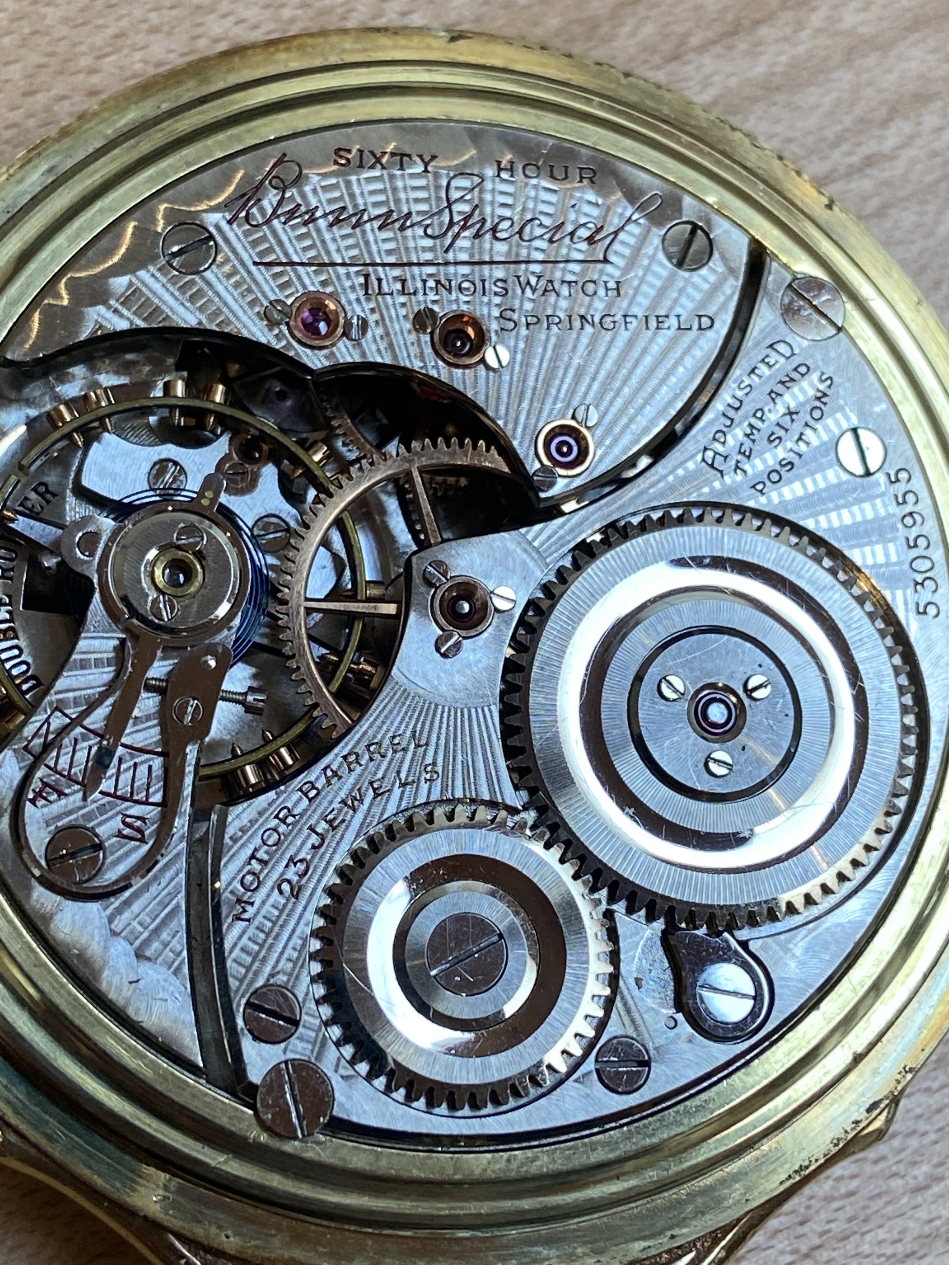

60hr 23j Type III also called TIIIA
This is the last model produced by Illinois before the Hamilton takeover and the most common. “60” mark has been removed from “motor barrel” and is now only on the top of the bridge.
60hr 23j Type IIIb
This is the first Illinois model produced by Hamilton. Looks the same as a TIII except on the bridge where it changes from “Illinois Watch Co” to simply “Illinois Watch” since the Illinois Watch Company no longer existed. This variation is only on 21j and 23j movements as Hamilton discontinued production of and never produced the 19j movement.
There you go, 60hour TI TII and TIII in detail. A long posting but hopefully helpful to someone, somewhere, someday. 11 variants for you to chase down. Happy Hunting!

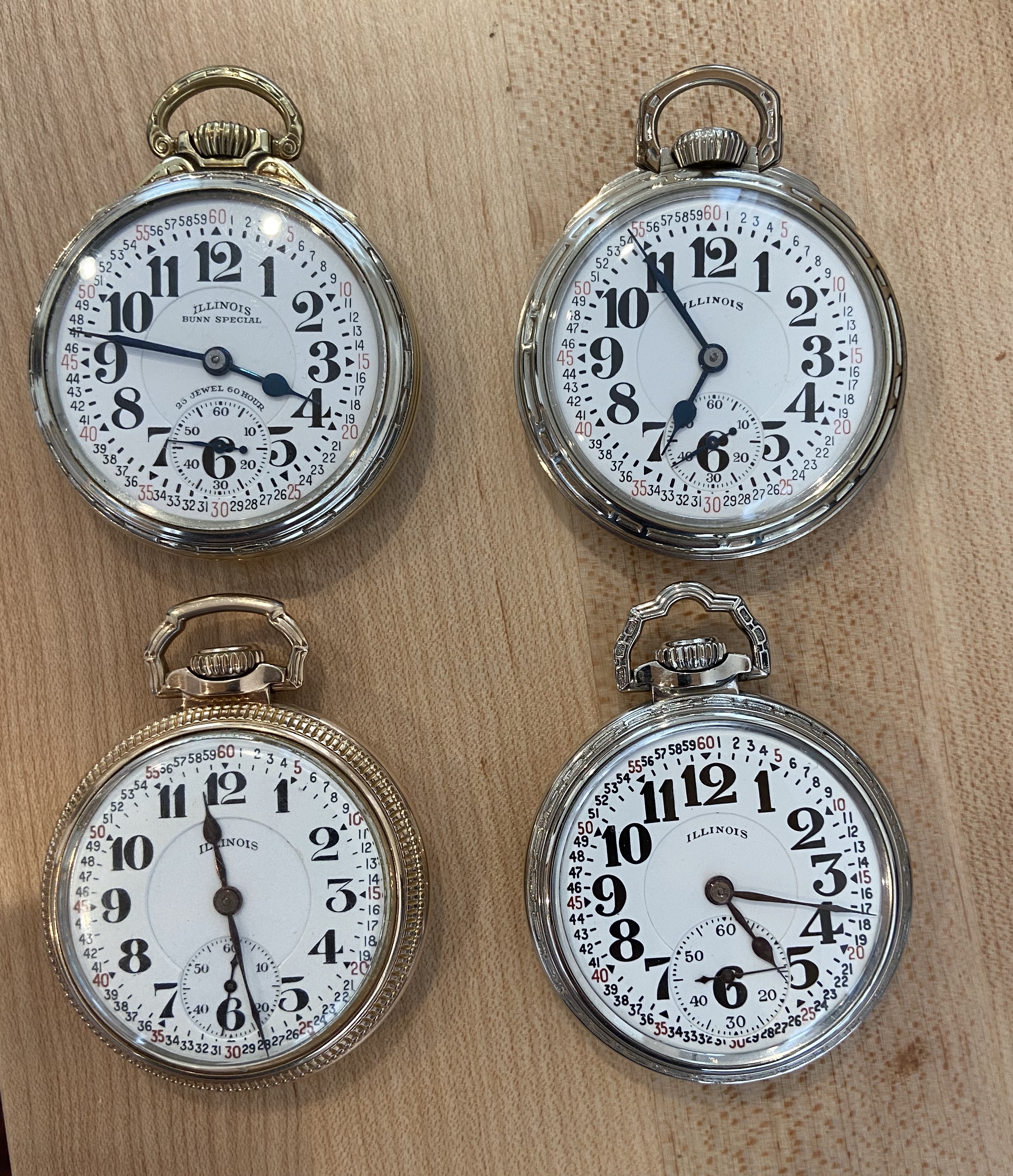

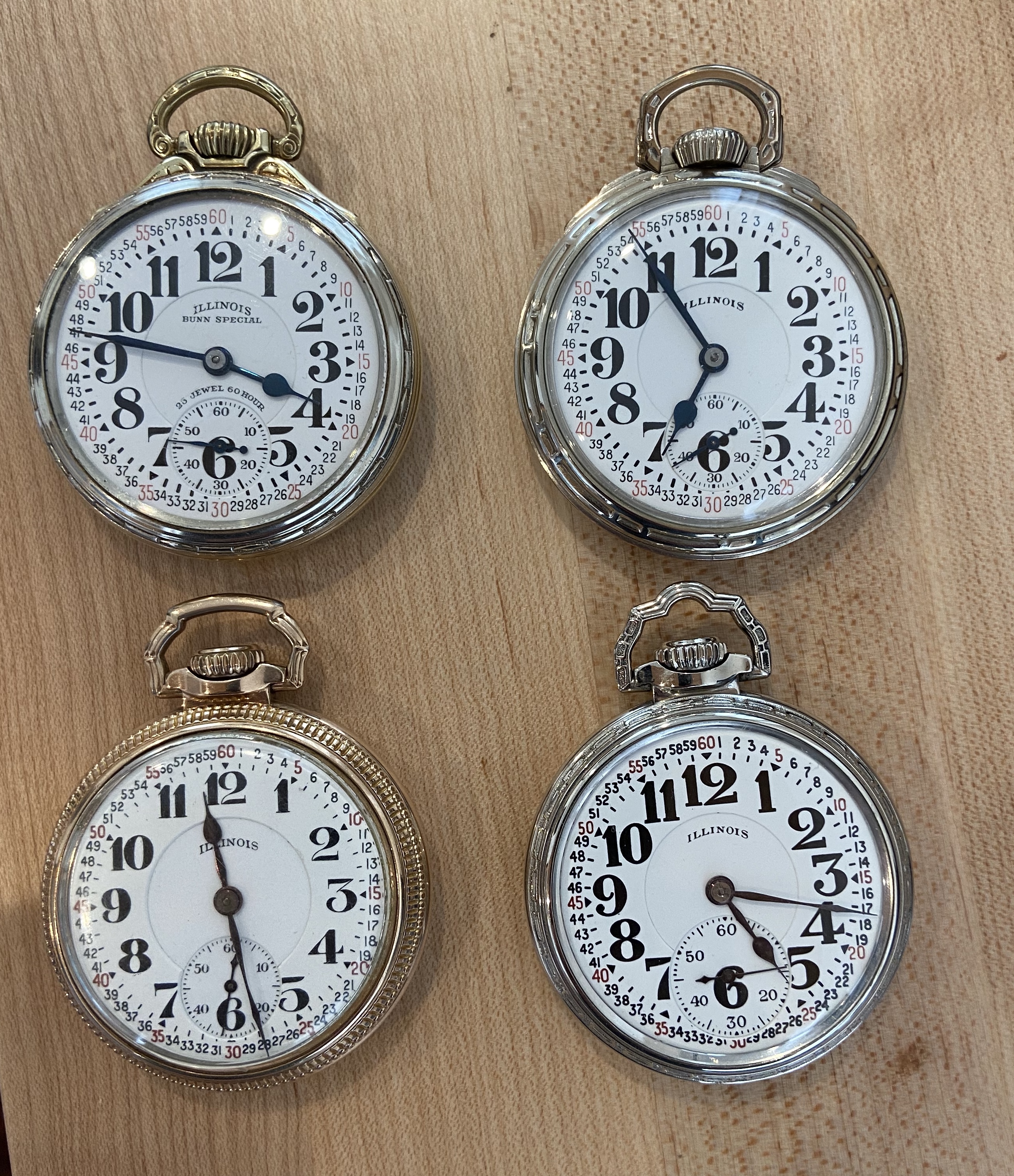

[QUOTE="ebrohman, post: 1629334, member: 29784" I'm in the market for a Bunn/60hr/motor barrel, especially with a Montgomery dial.” [/QUOTE]
I haven’t even begun discussing dial and case variants yet but since you mention, here are 4 different types of Montgomery dials for Bunn Specials.
Clockwise (of course) from top:
“Marked” 23 Jewel Montgomery (TIII and 163)
“Arrows-Out” Montgomery (TIII and 161/163)
“Arrows-in Big 6” Montgomery, very rare (TI and TII)
“Arrows-in” Montgomery (TI, TII, also A.Lincoln and earlier Illinois models)

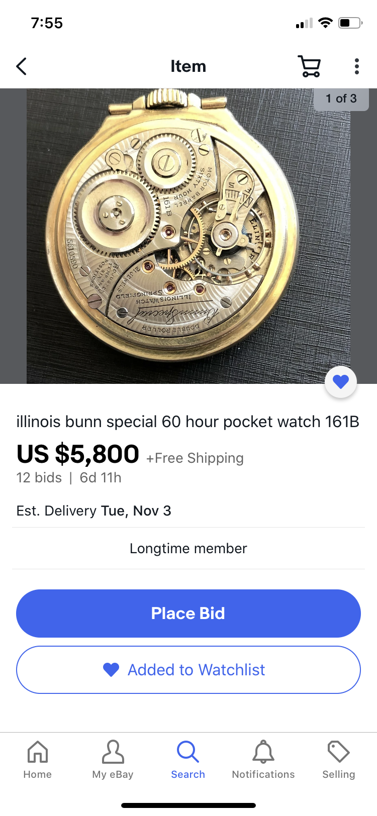

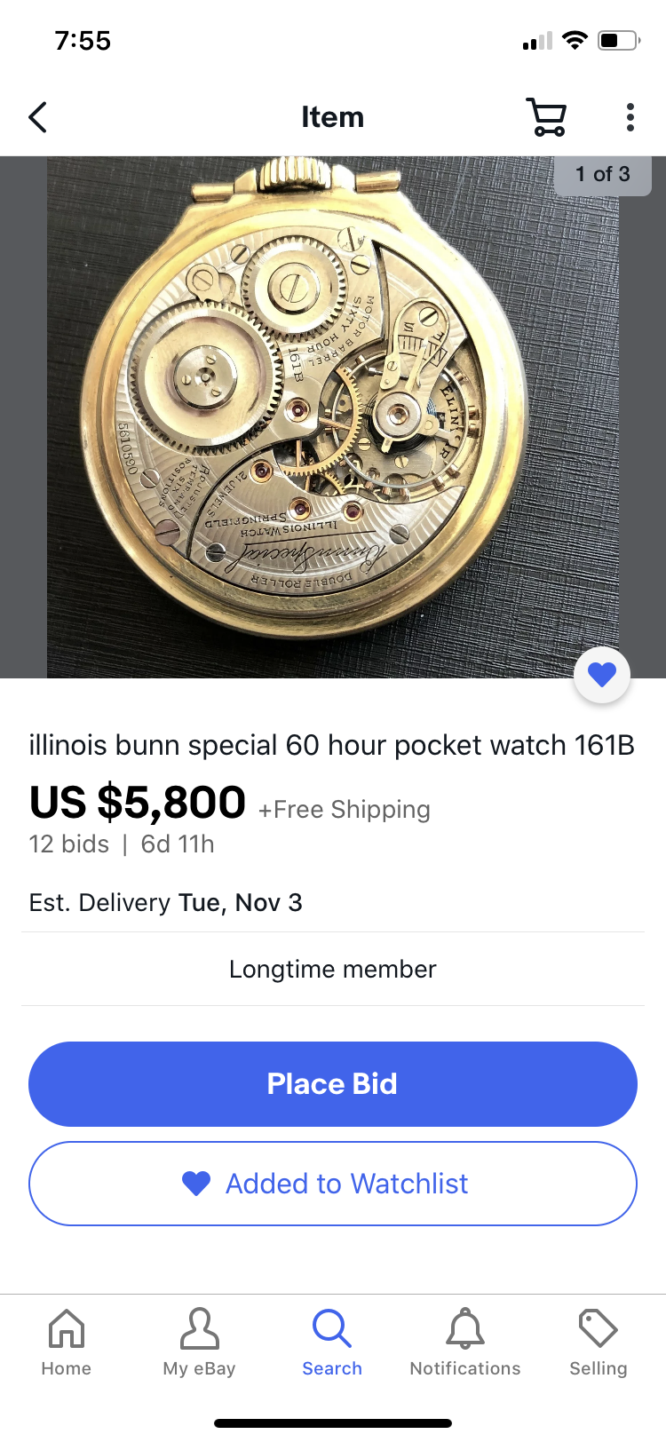

Wow! Look at what is on eBay. For those that don’t know this is about the rarest of the rare for Illinois. 161B with pressed jewels, under 50 thought to have been made, I’ve seen 2 for sale in the past 10 years. Check the description, seller has no clue what they have. Up to $5800 in first few hours. Watch this one!
https://www.ebay.com/itm/114475394582

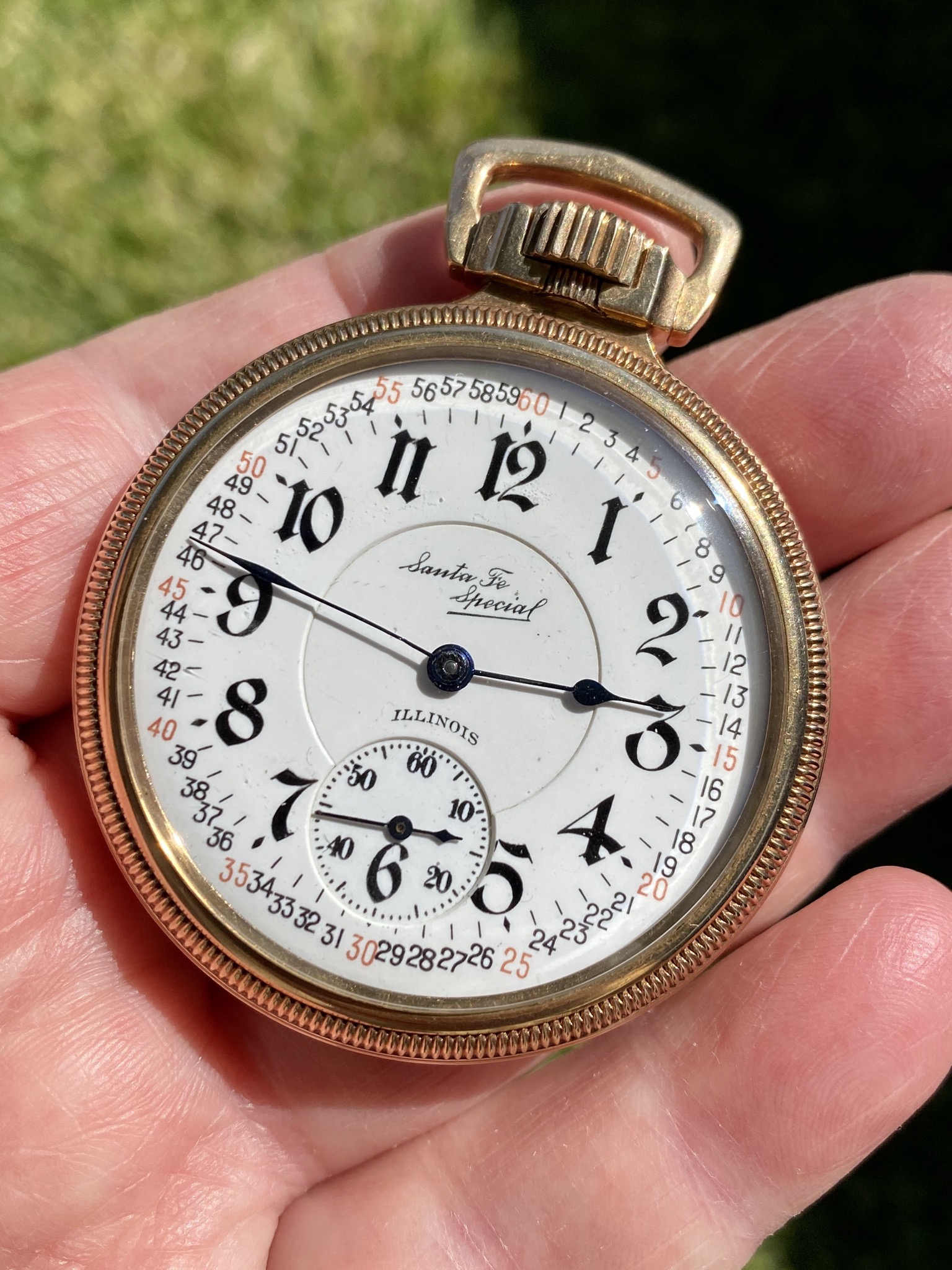

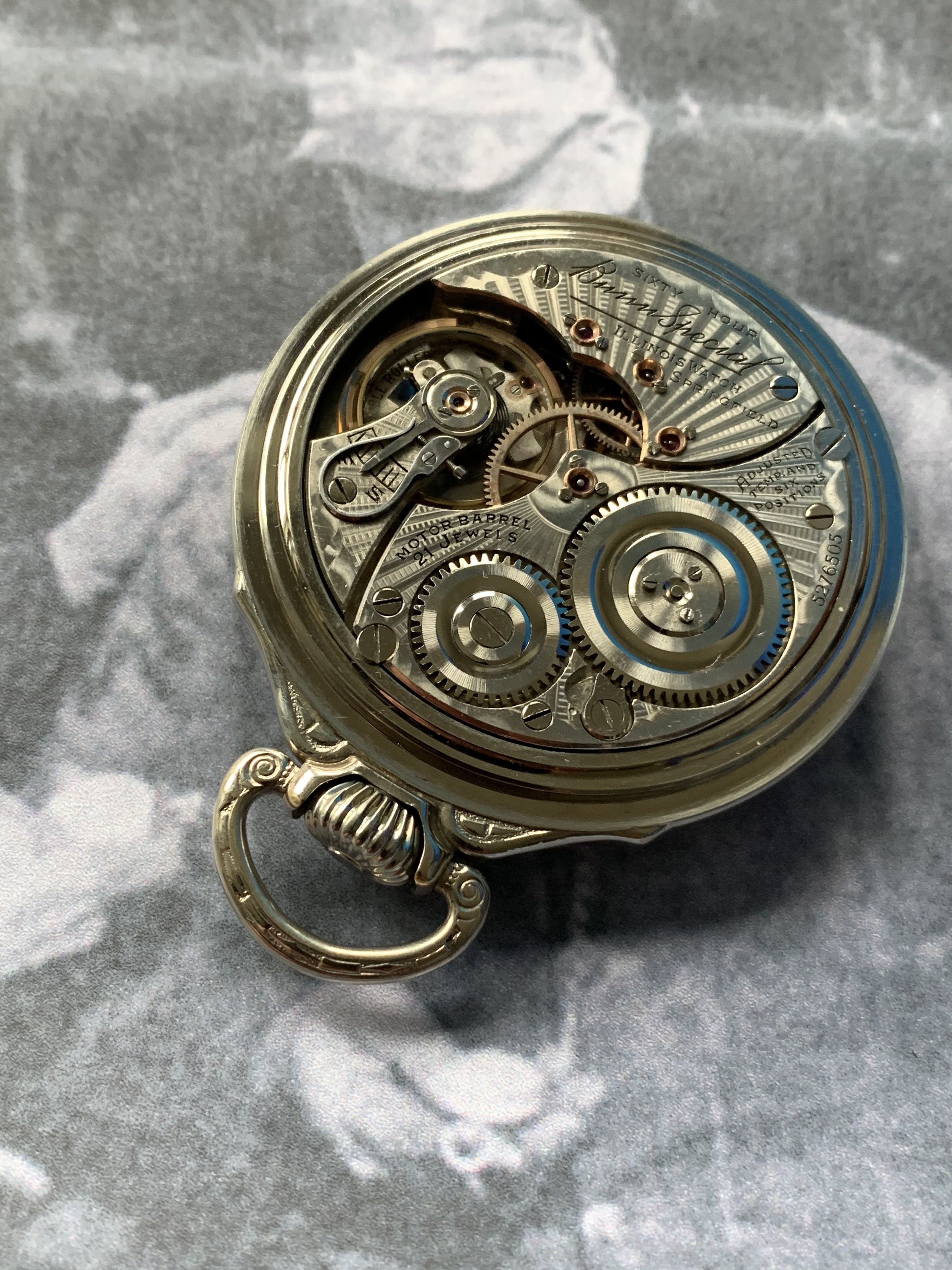

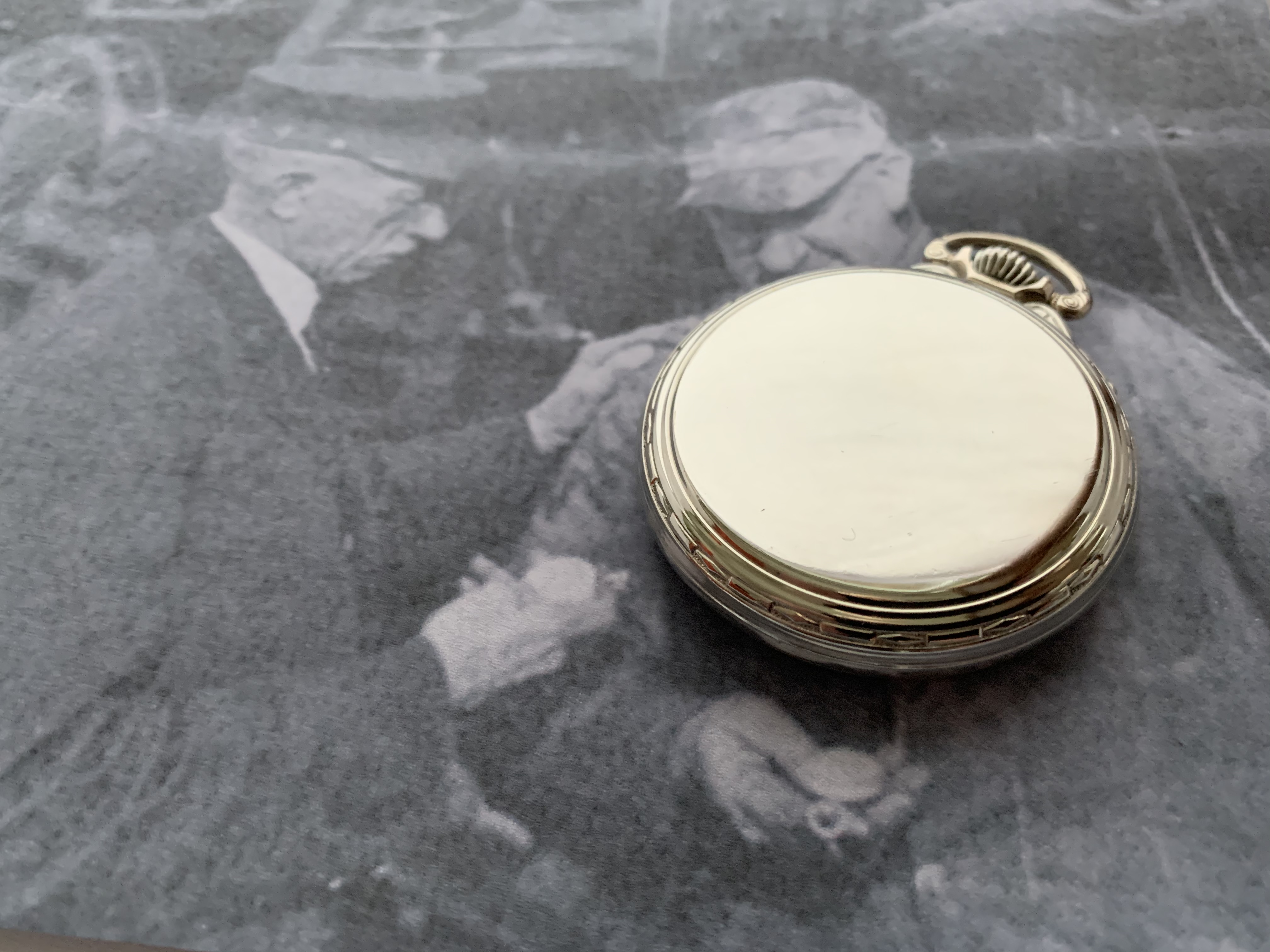

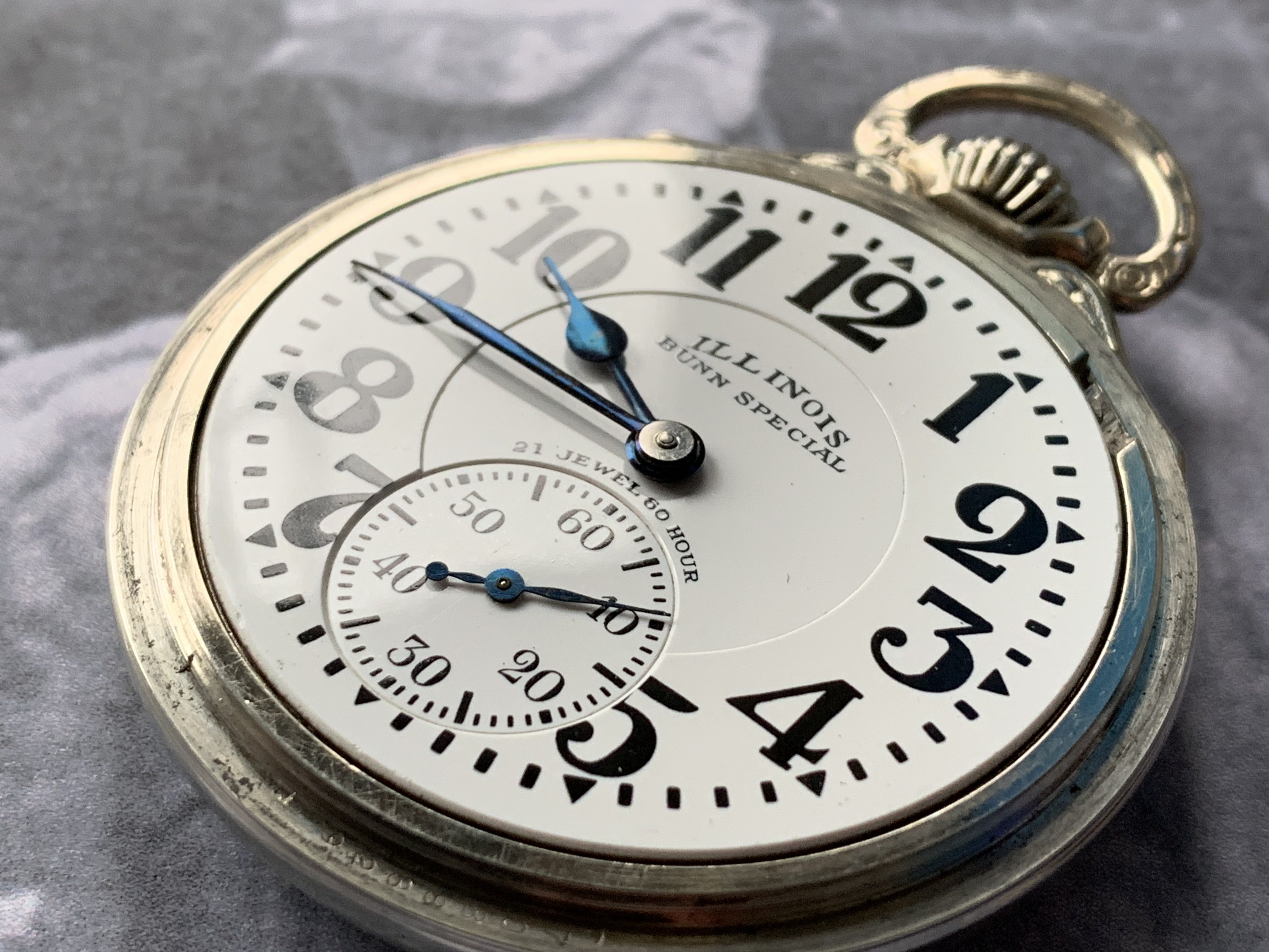

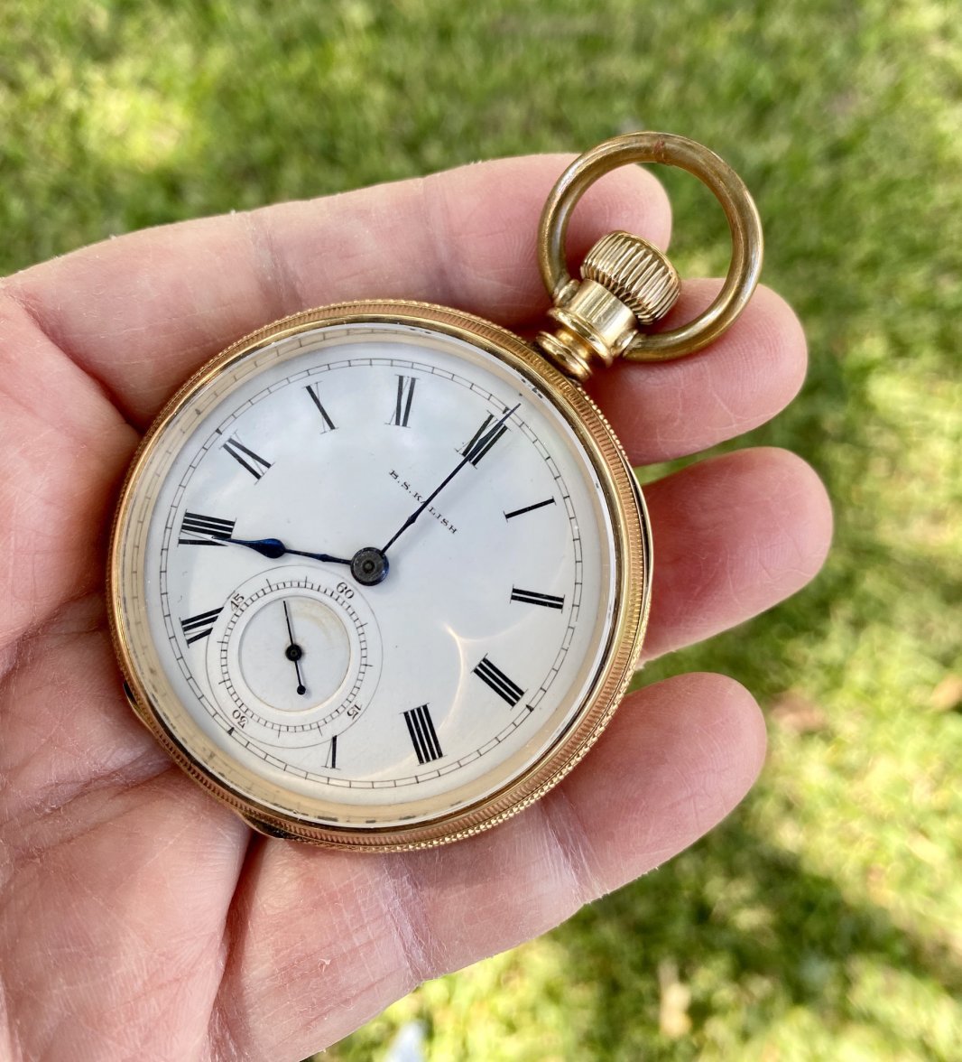

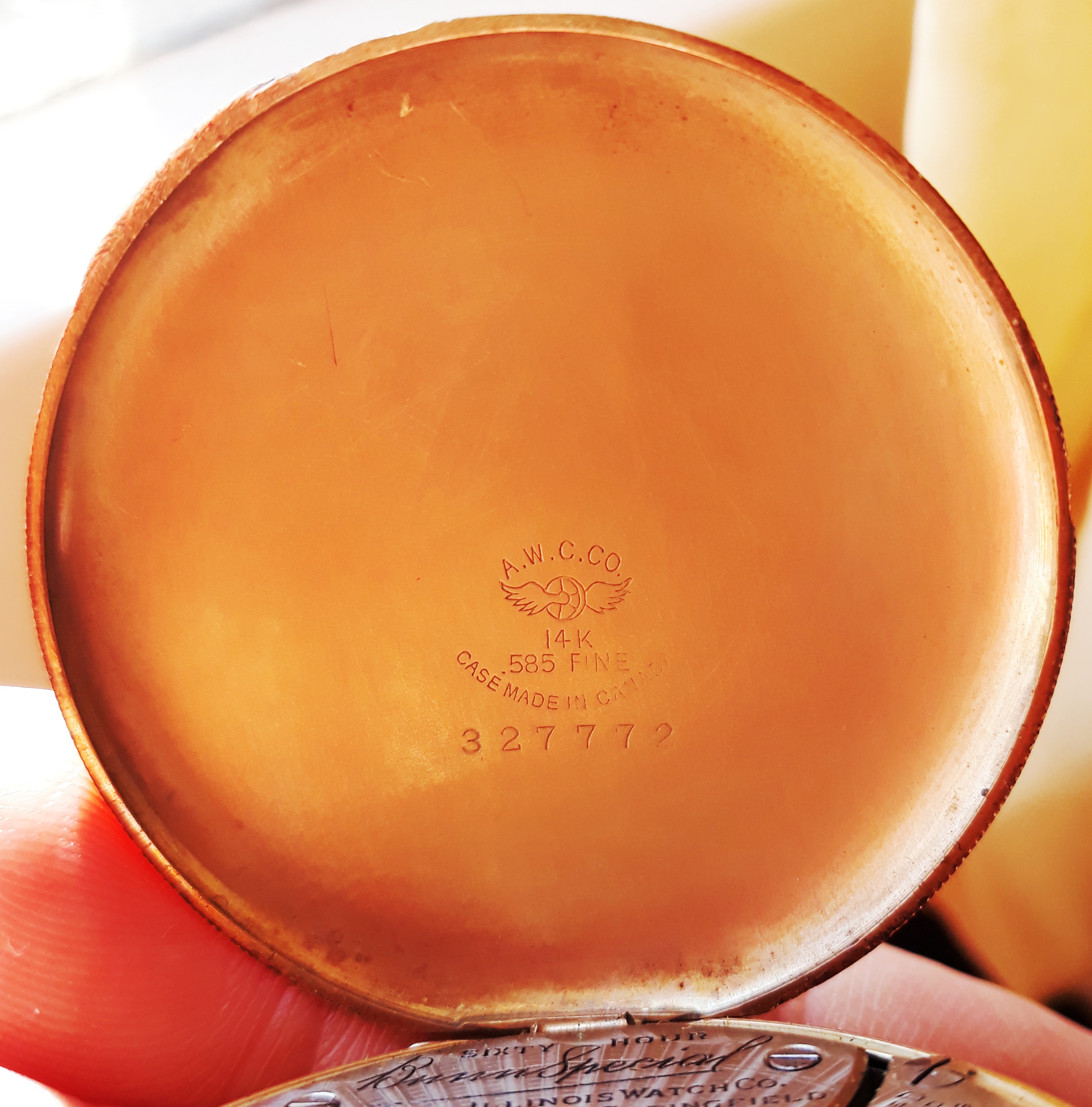

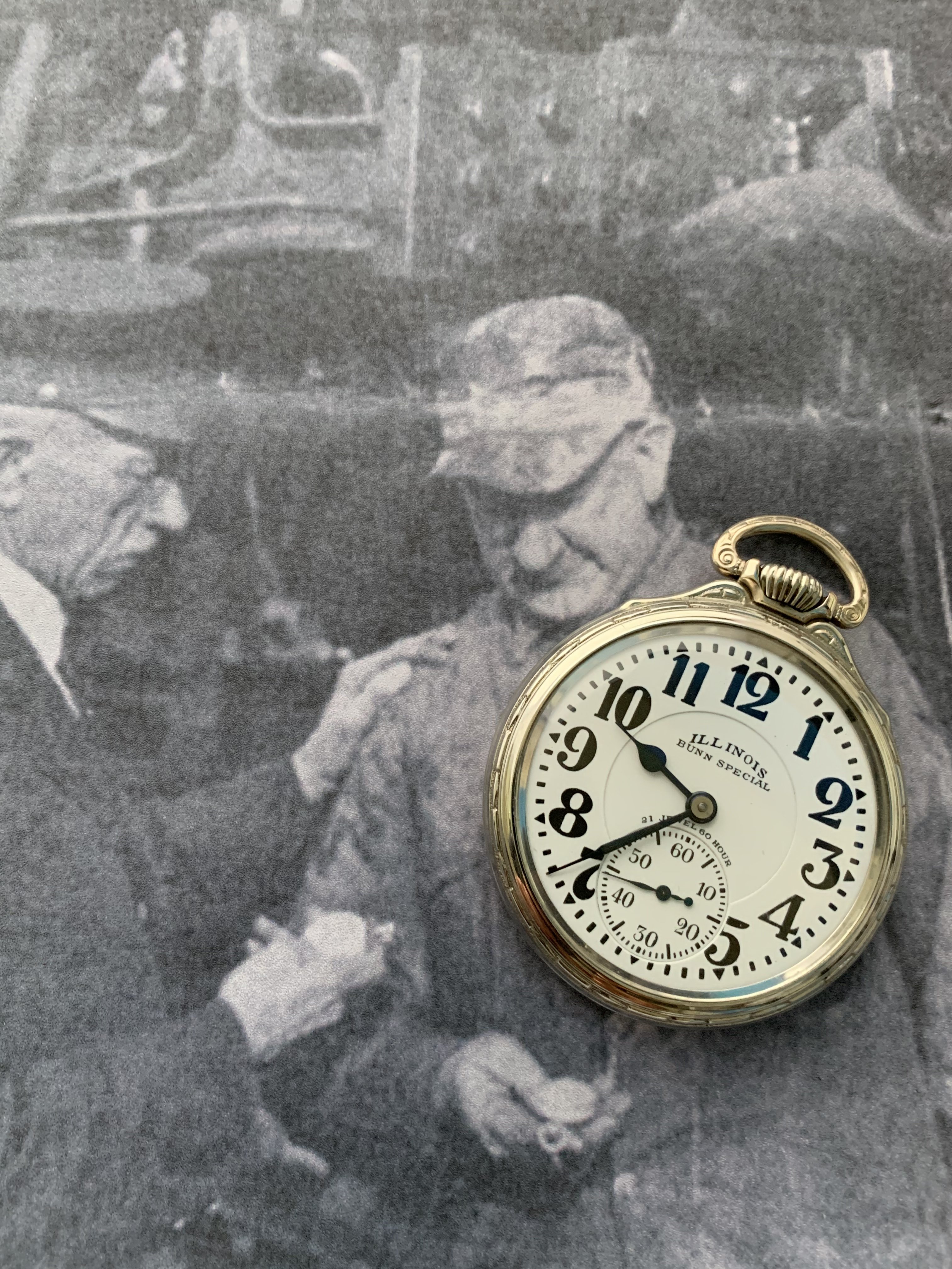

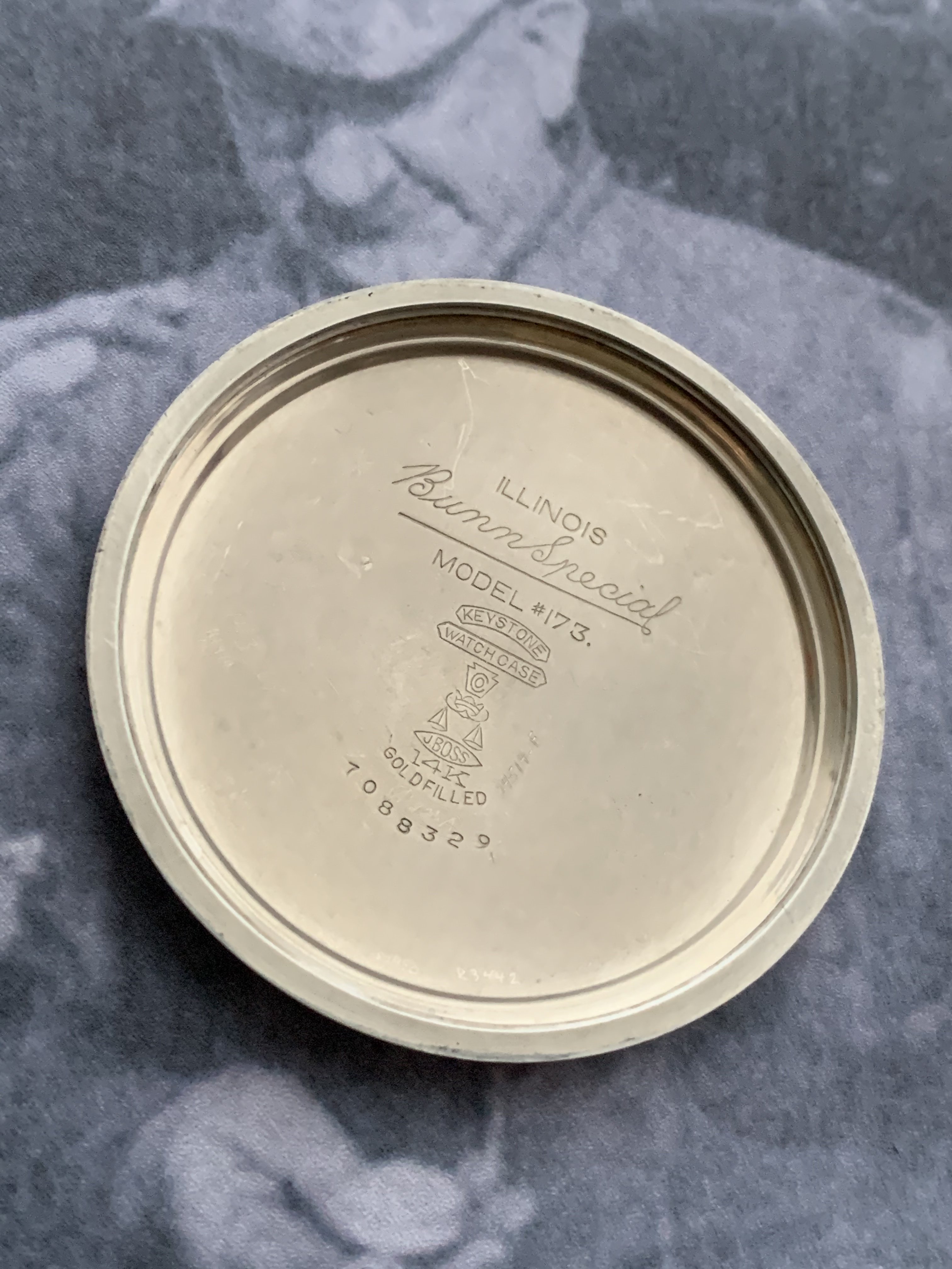

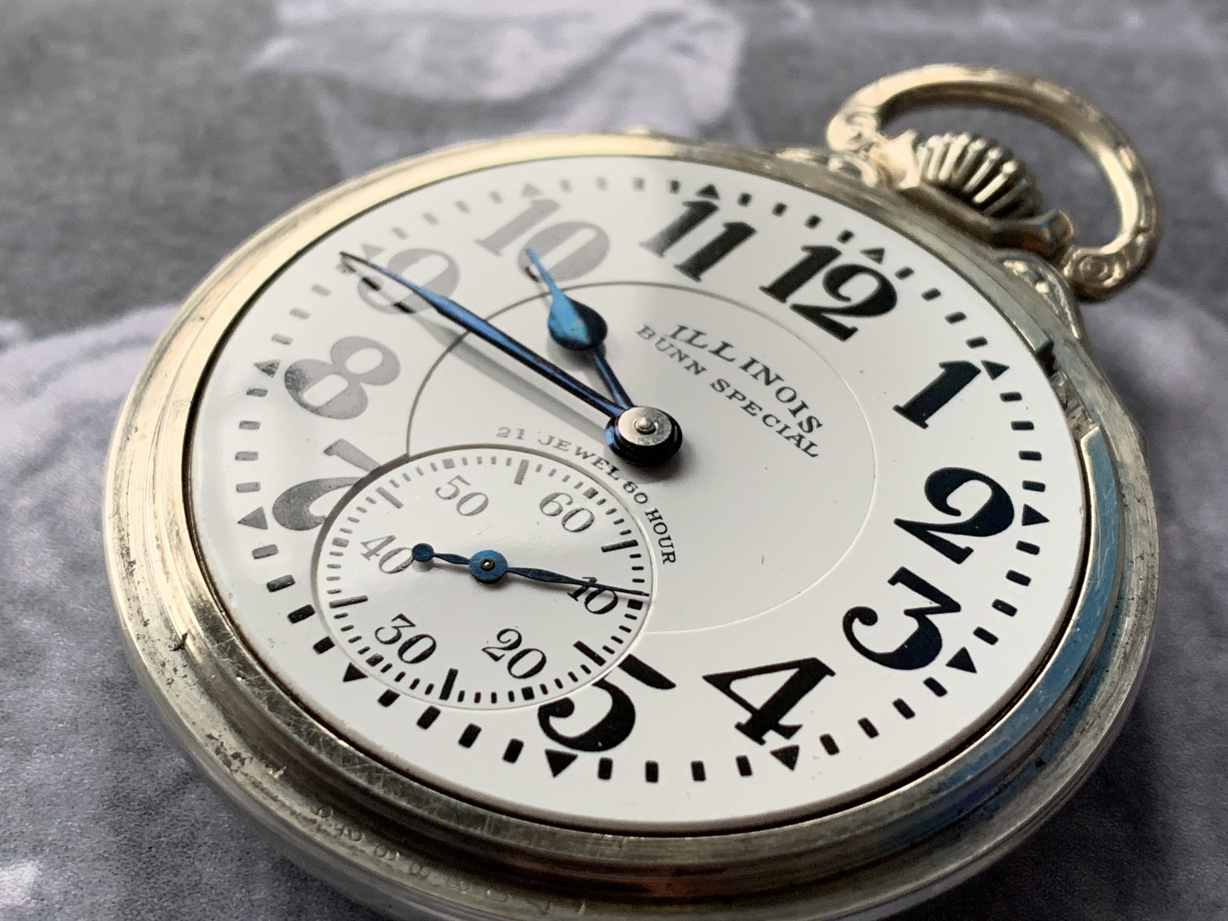

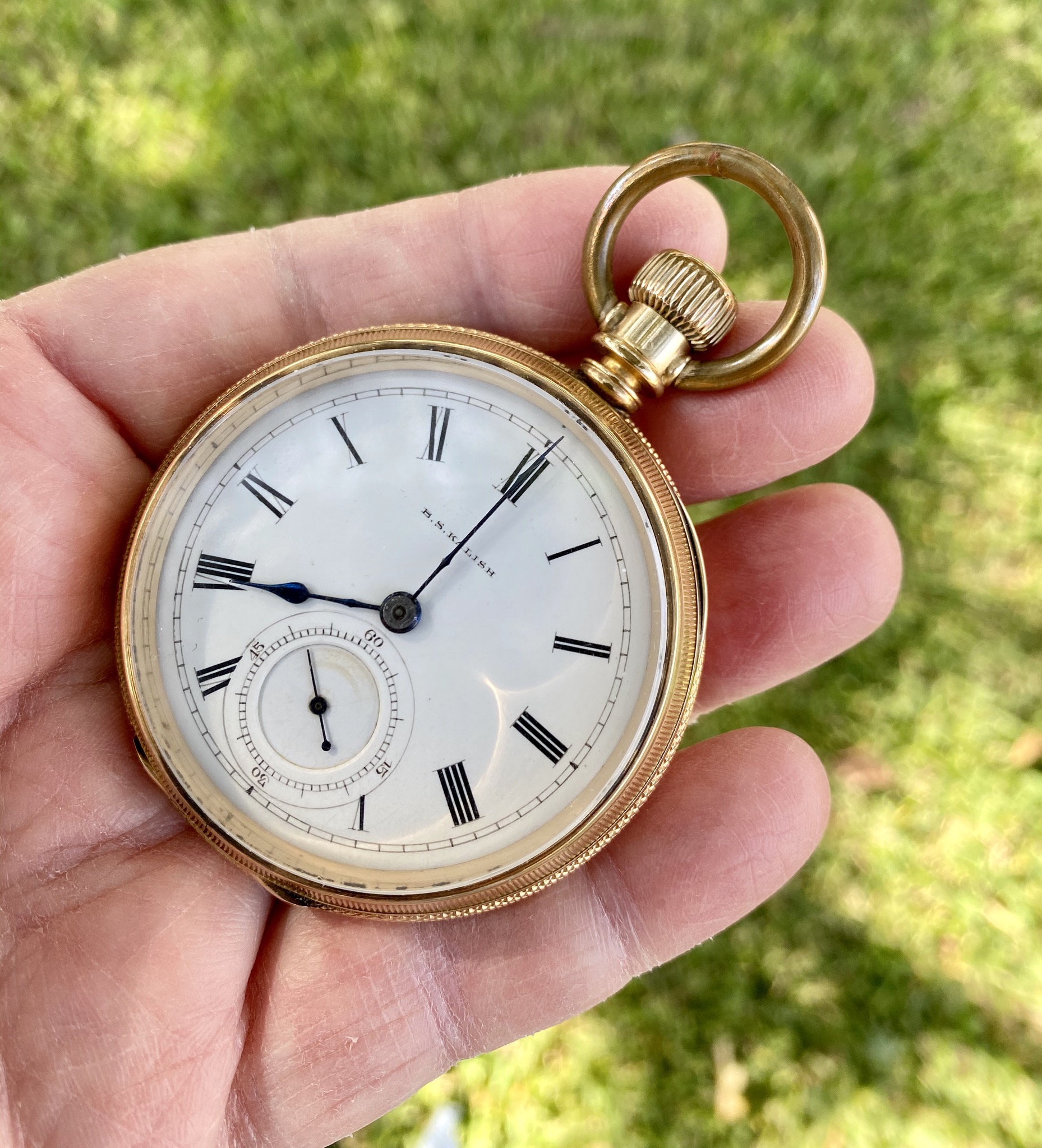

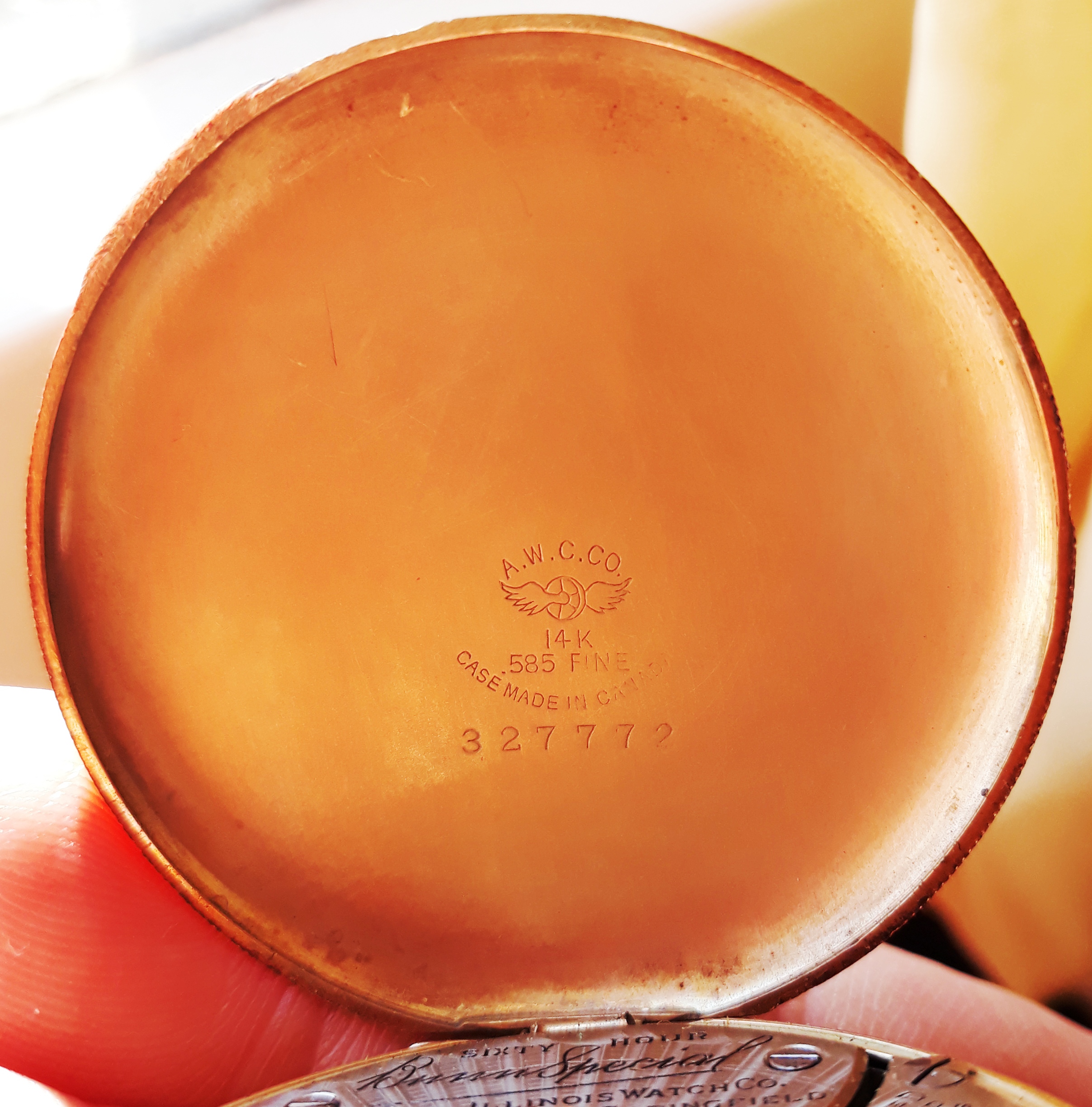

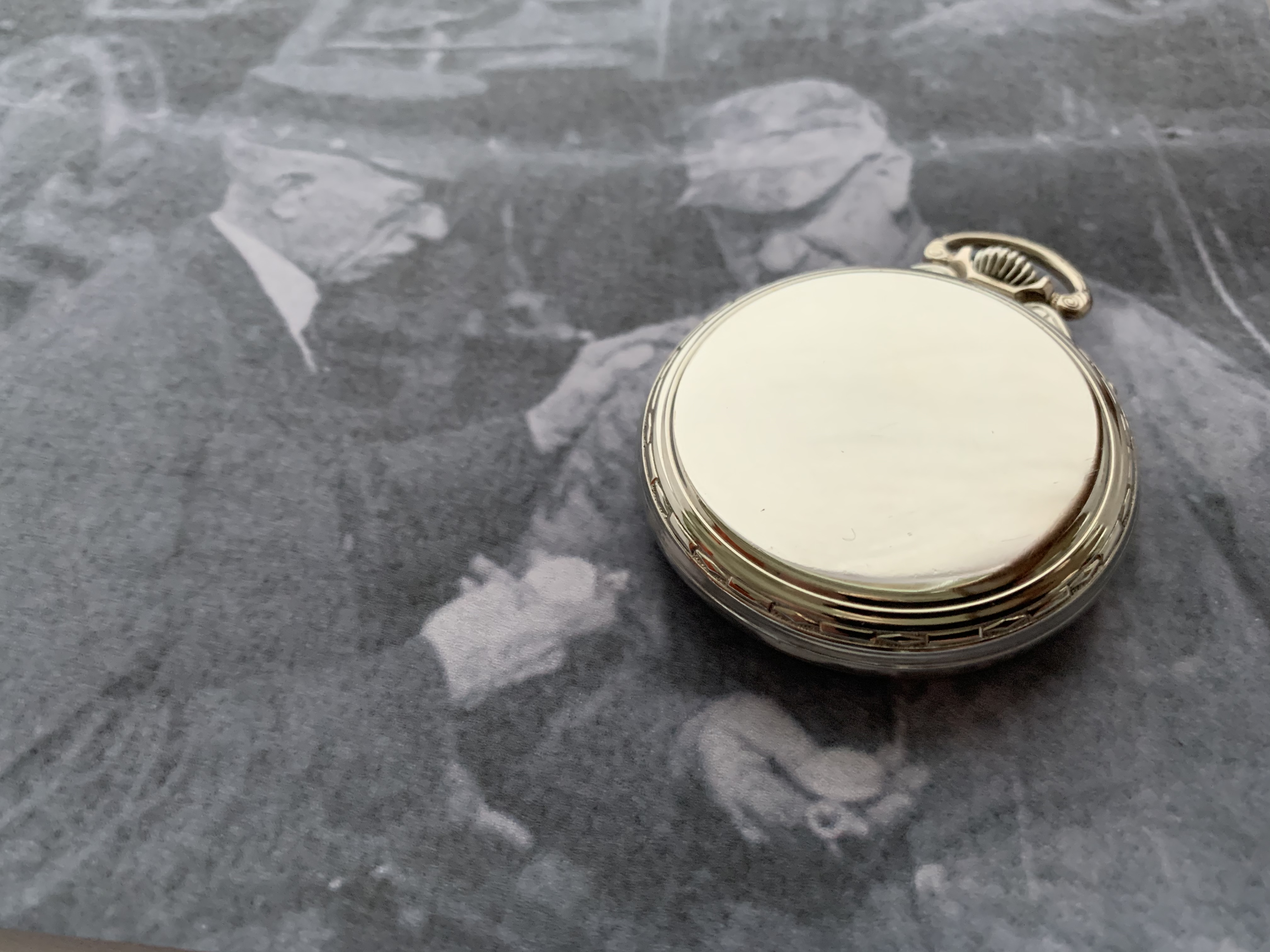

This 1929 railroader was talked about in it's FS thread (Again, thanks @140dave !), but I figured it also belonged in this thread as well.
Borrowing heavily from 140Dave’s research… In collector’s circles, this one is known as a Type IIIB (TIIIB). Earlier variants will all have “Illinois Watch Co” signed on the movement, but this was one of the few TIII movements made after the 1928 takeover by Hamilton, so the movement is signed “Illinois Watch”, without the “Co”. There were very few of these produced, around 1200, before they moved to the “161” movements from 1929-1932. This watch comes from the final run before the 161 movement was introduced.

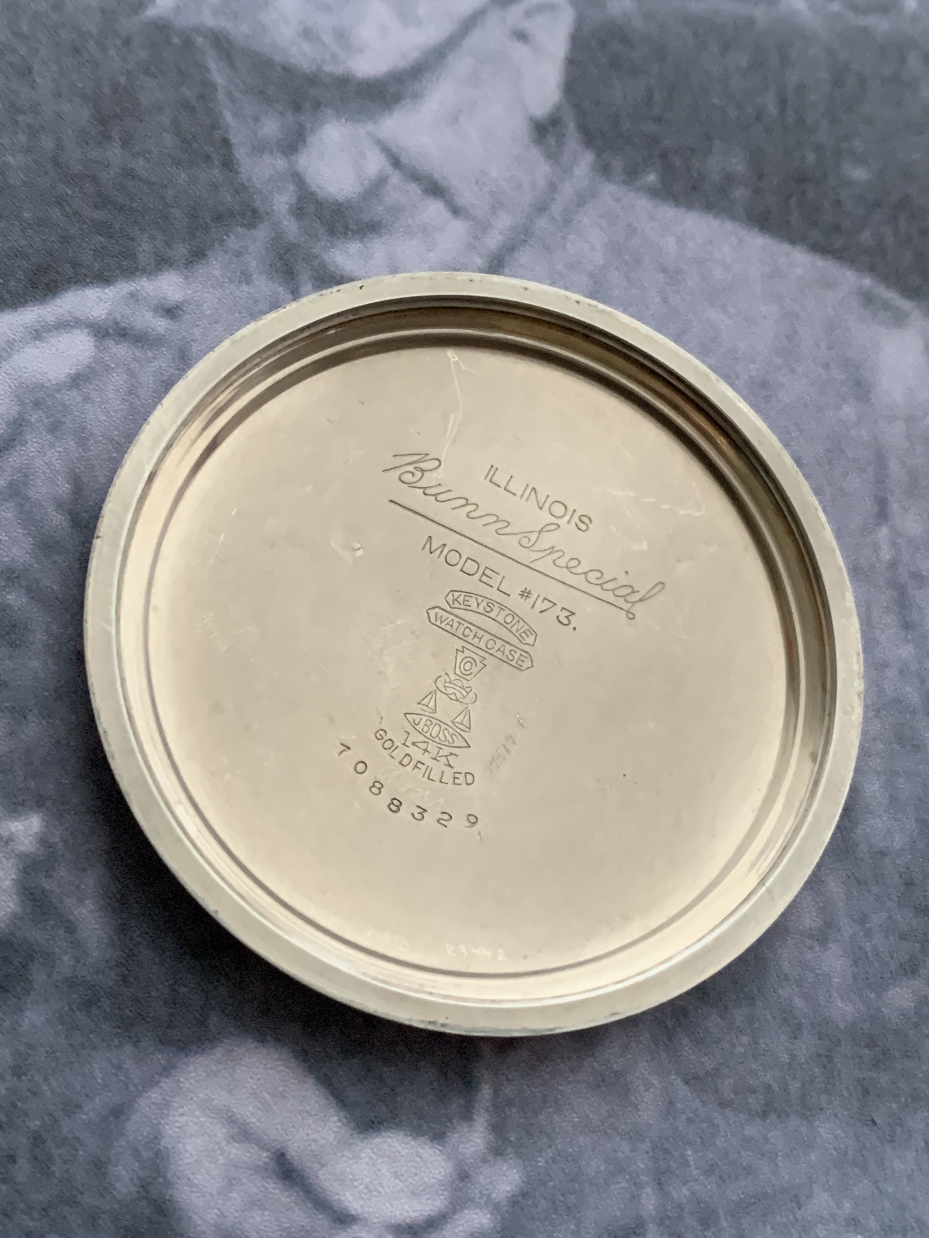

I was particularly drawn to the near perfect factory model 173 case, the rare 14k white gold filled model. All case part serial #s match, which allows you to determine if someone put pieces together to make a better looking case.
The enamel dial is a pleasure to look at, marked Illinois Bunn Special, and then 21 Jewel and 60 Hour above the sub second register. Blued hands are very camera shy, but I finally got them 😎
1,990
9,505

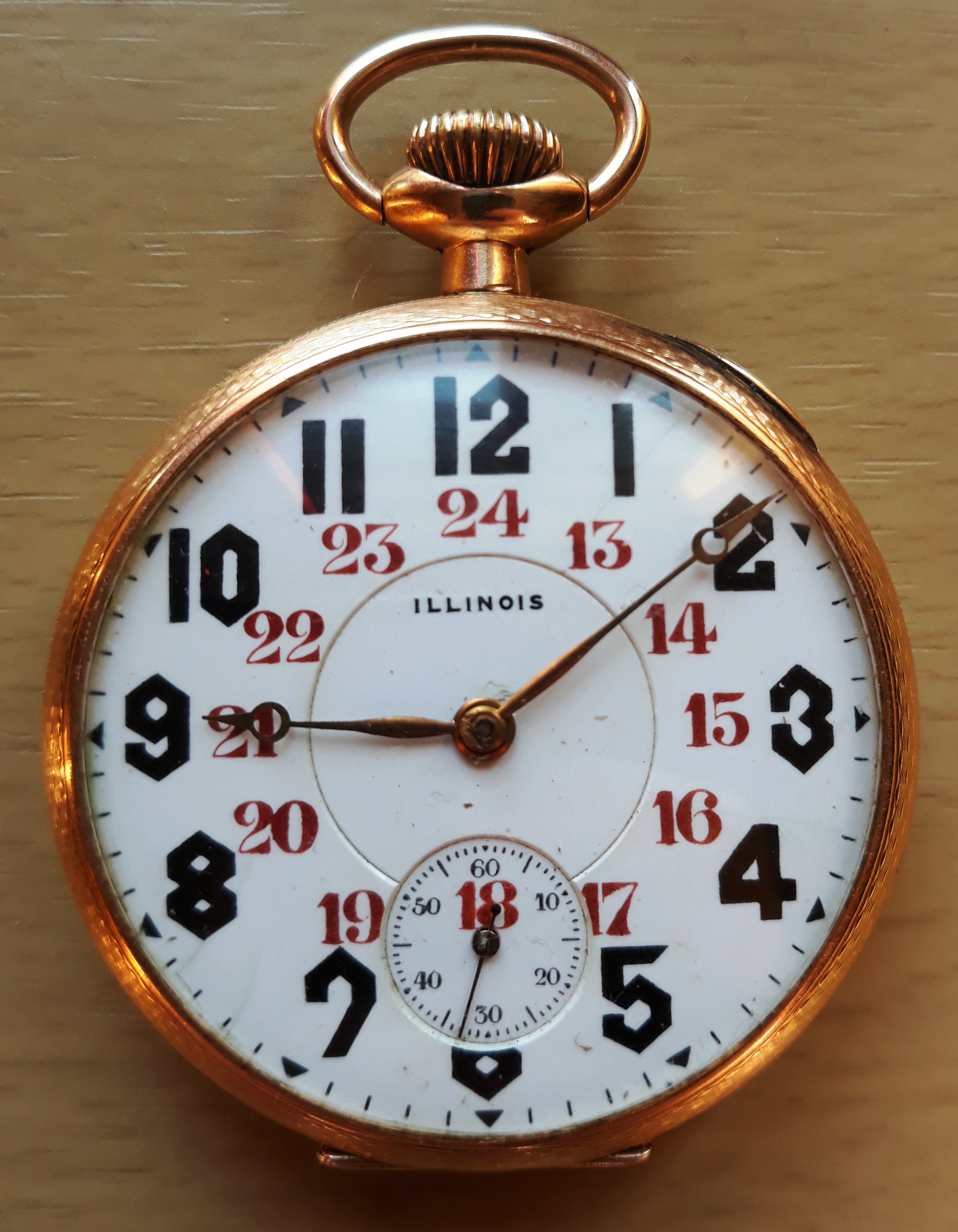

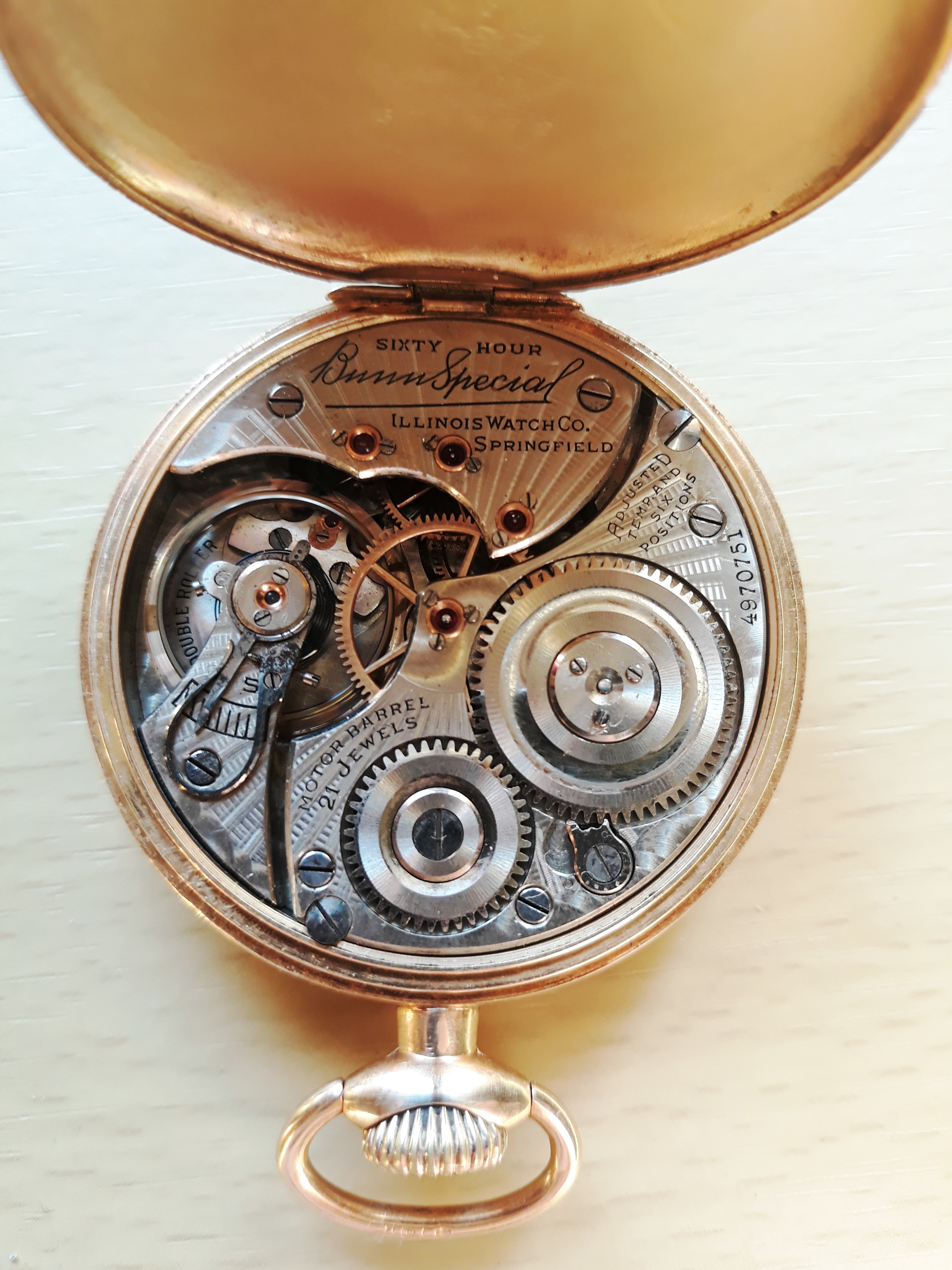

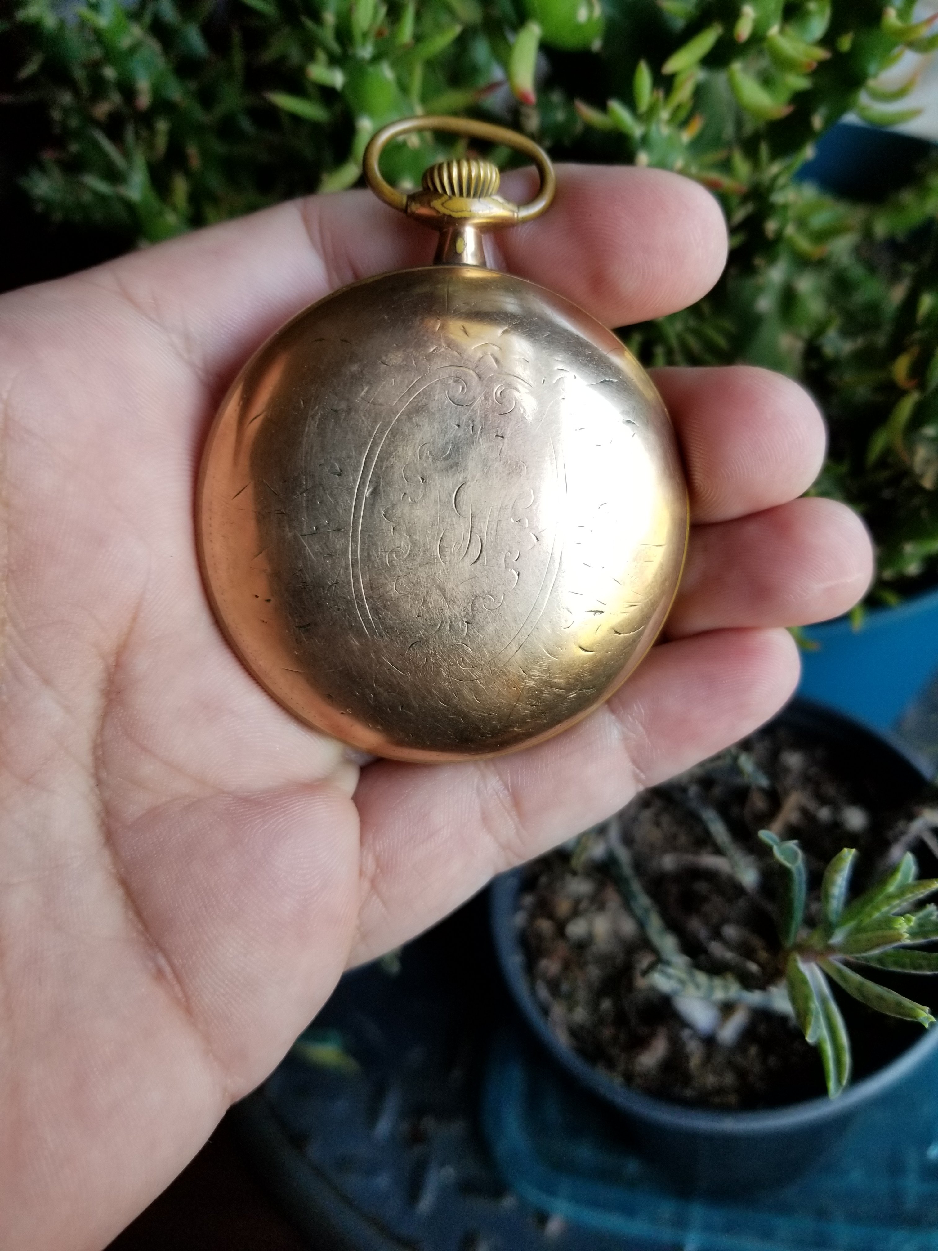

Well, to start with, a solid gold case always impresses!
The Movement is a 21 Jewel 60 Hour Type III most likely from about 1928. Pre Hamilton take-over but not by much, this is the last 60hr 21j movement type Illinois produced before the sale.
Dial and hands are not original. Should be either plum or blue hands (borderline on the changeover so could go either way) and should have an Arrows-out Illinois Dial with Illinois on a curve instead of straightline like yours.
Your dial is a Gothic Canadian RR which has its own appeal but meant for an earlier watch from 1918-1924 approx.

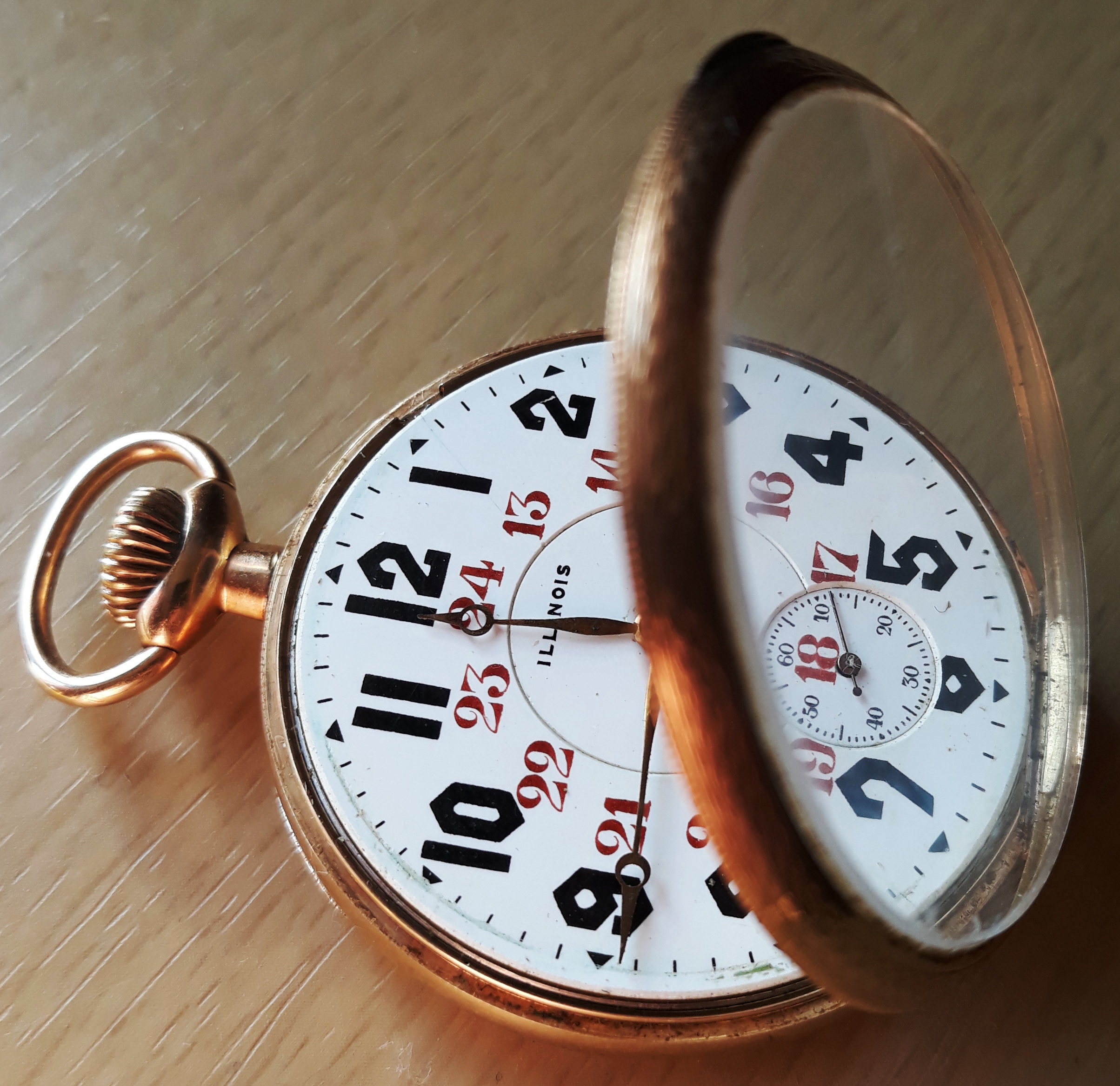

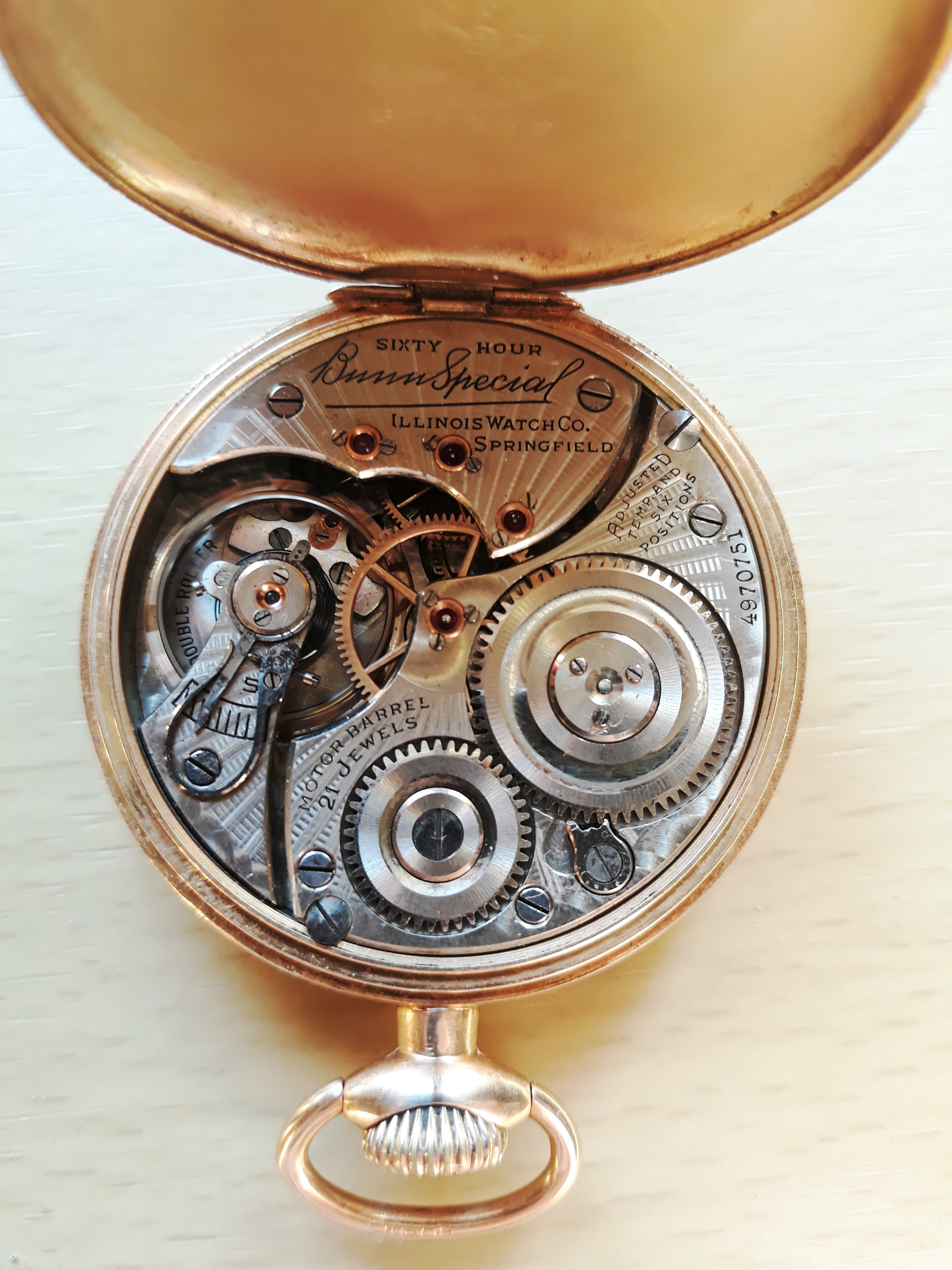

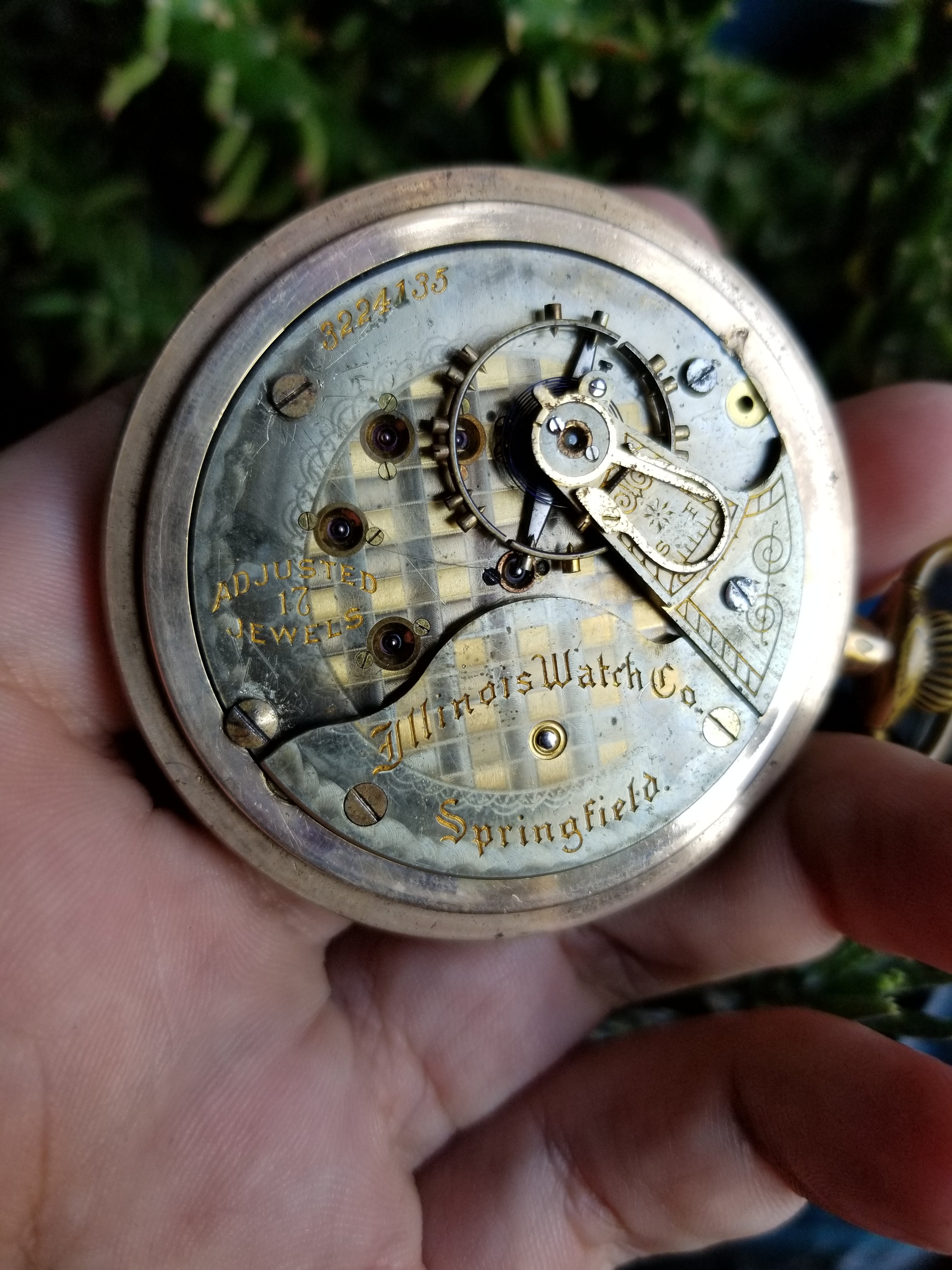

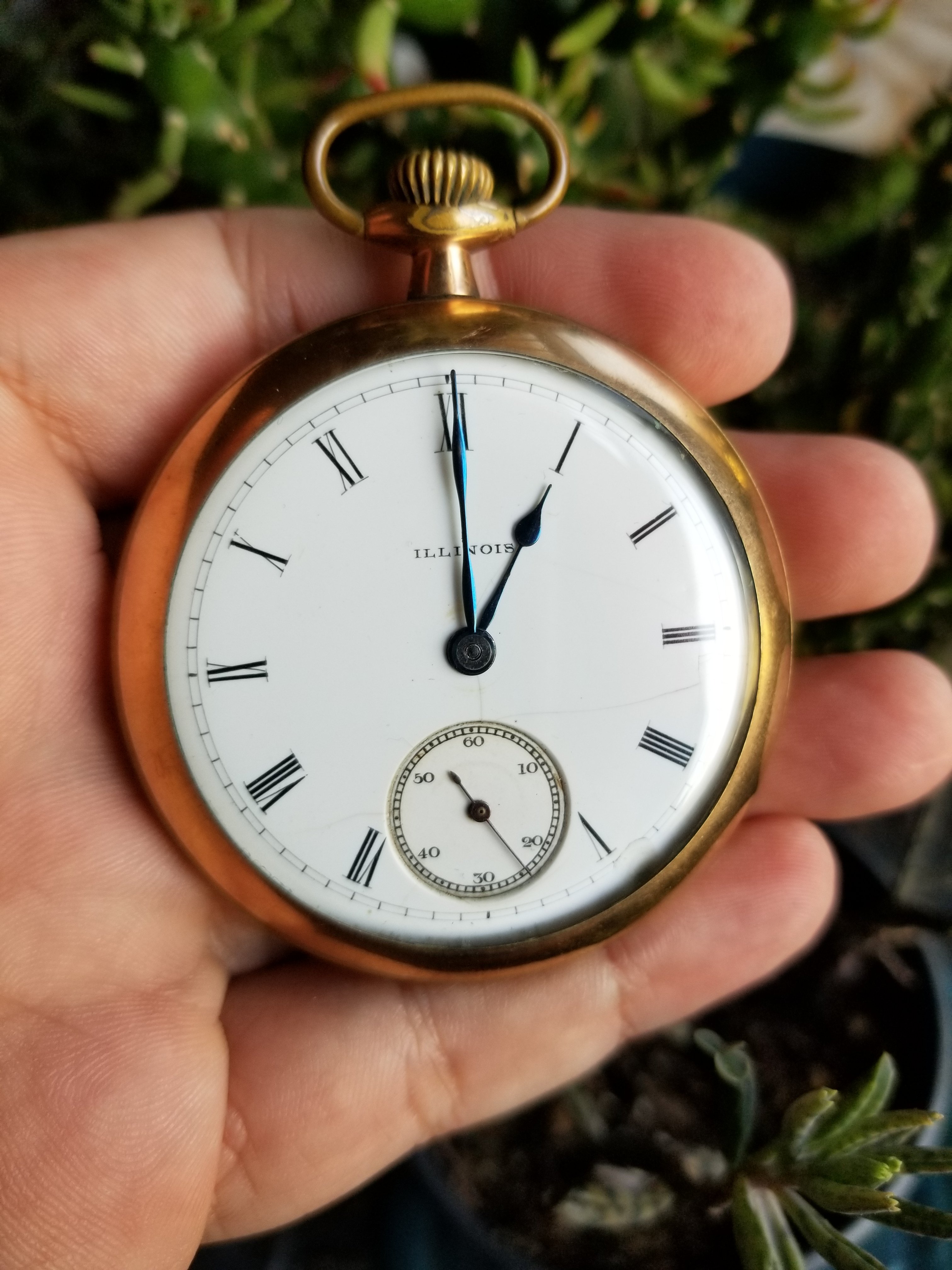

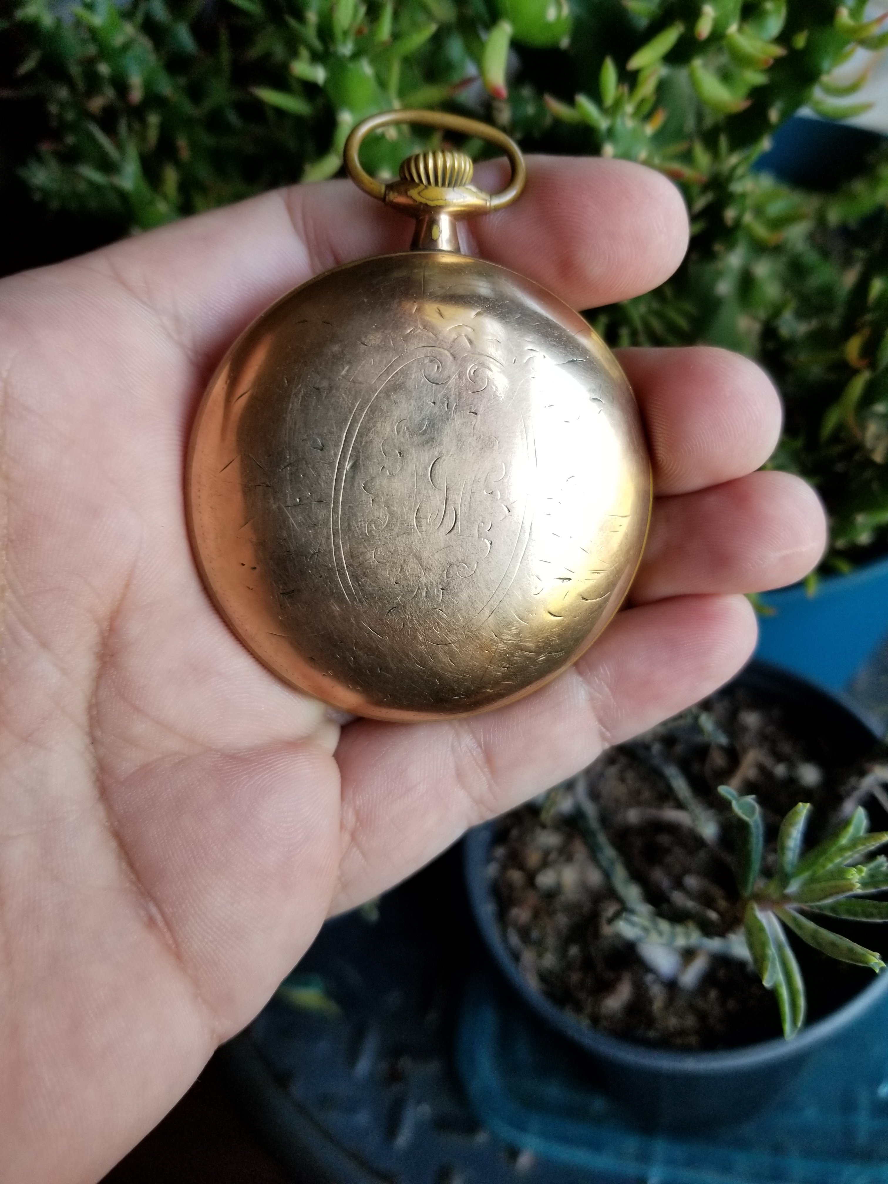

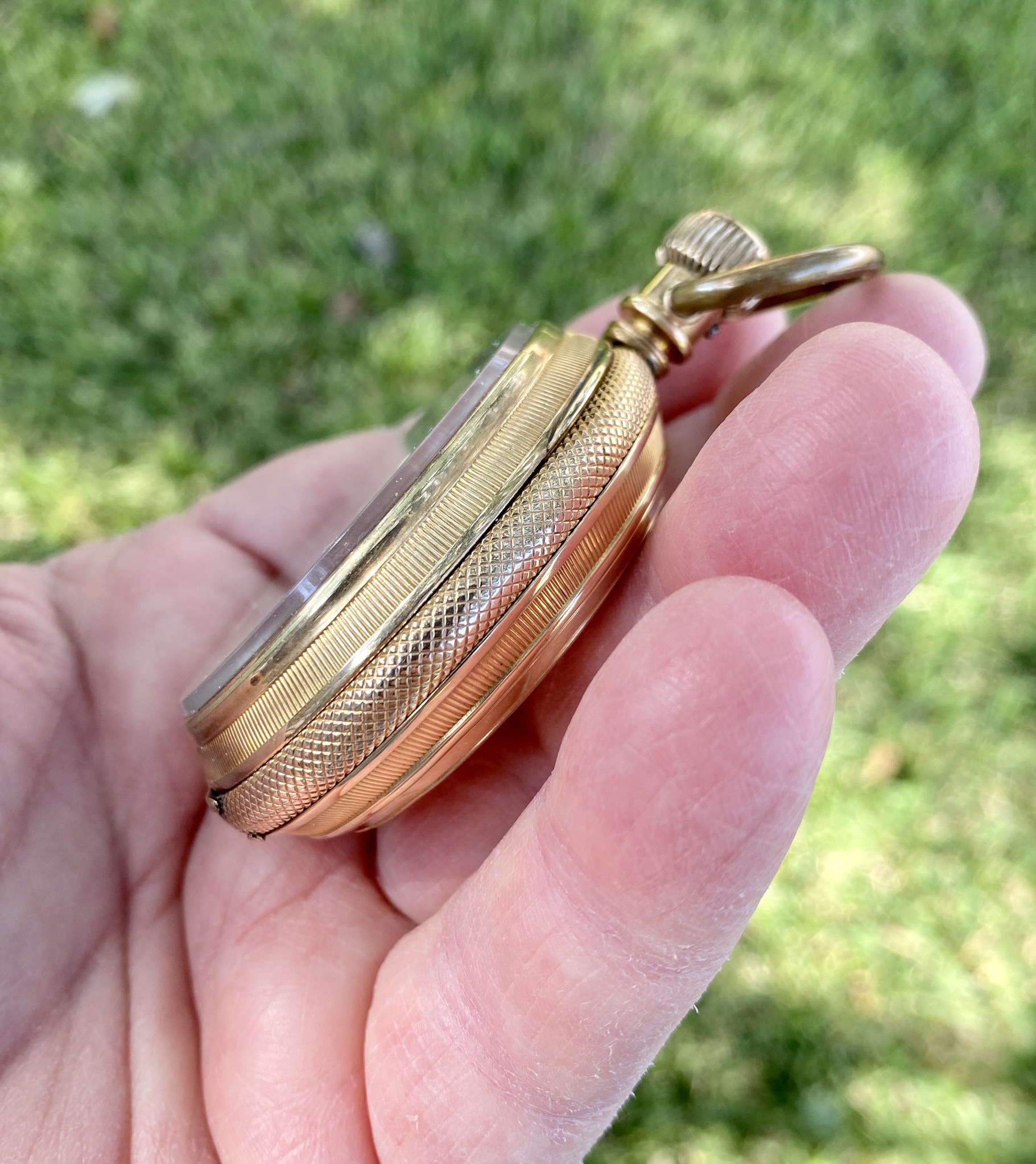

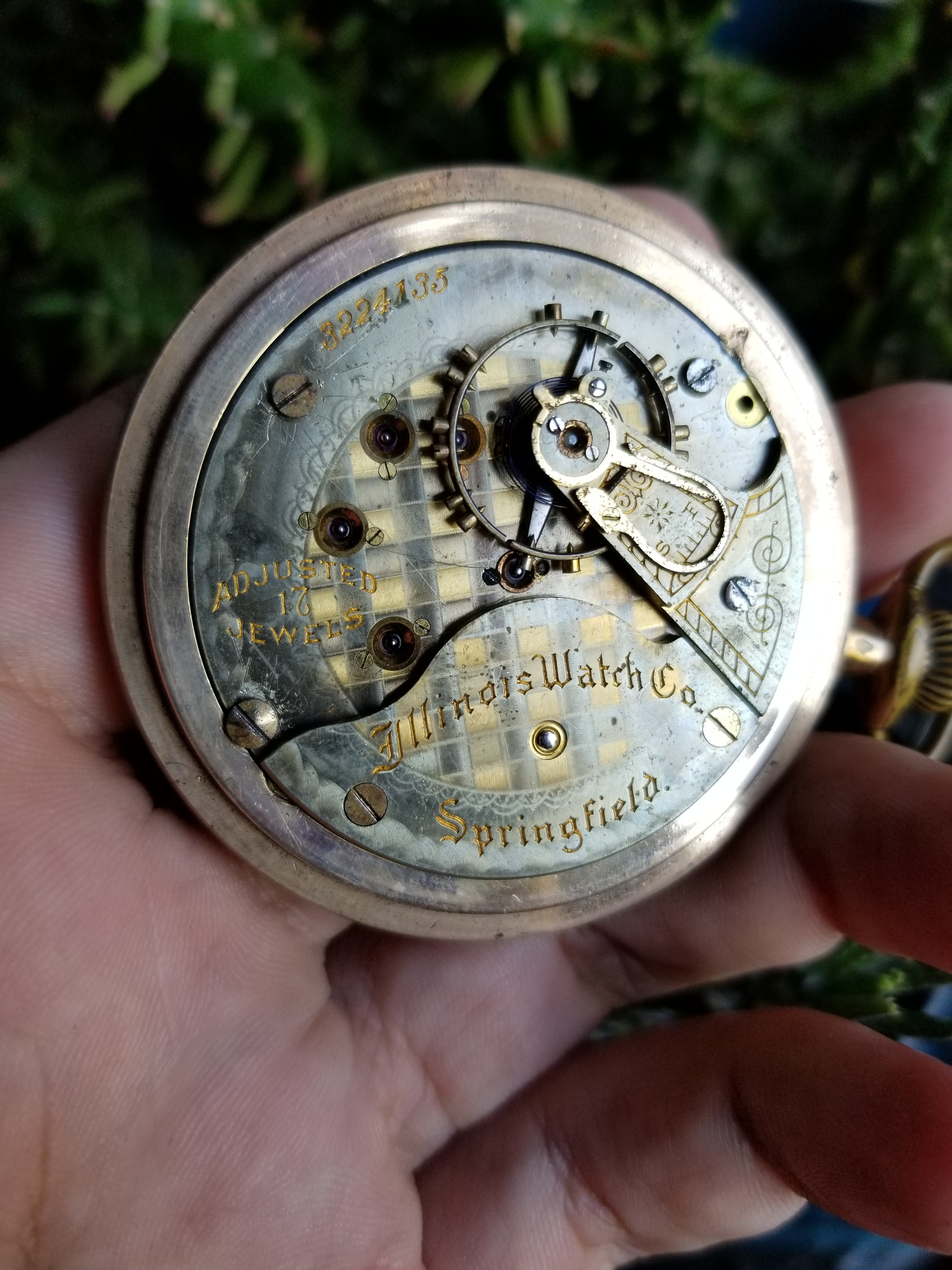

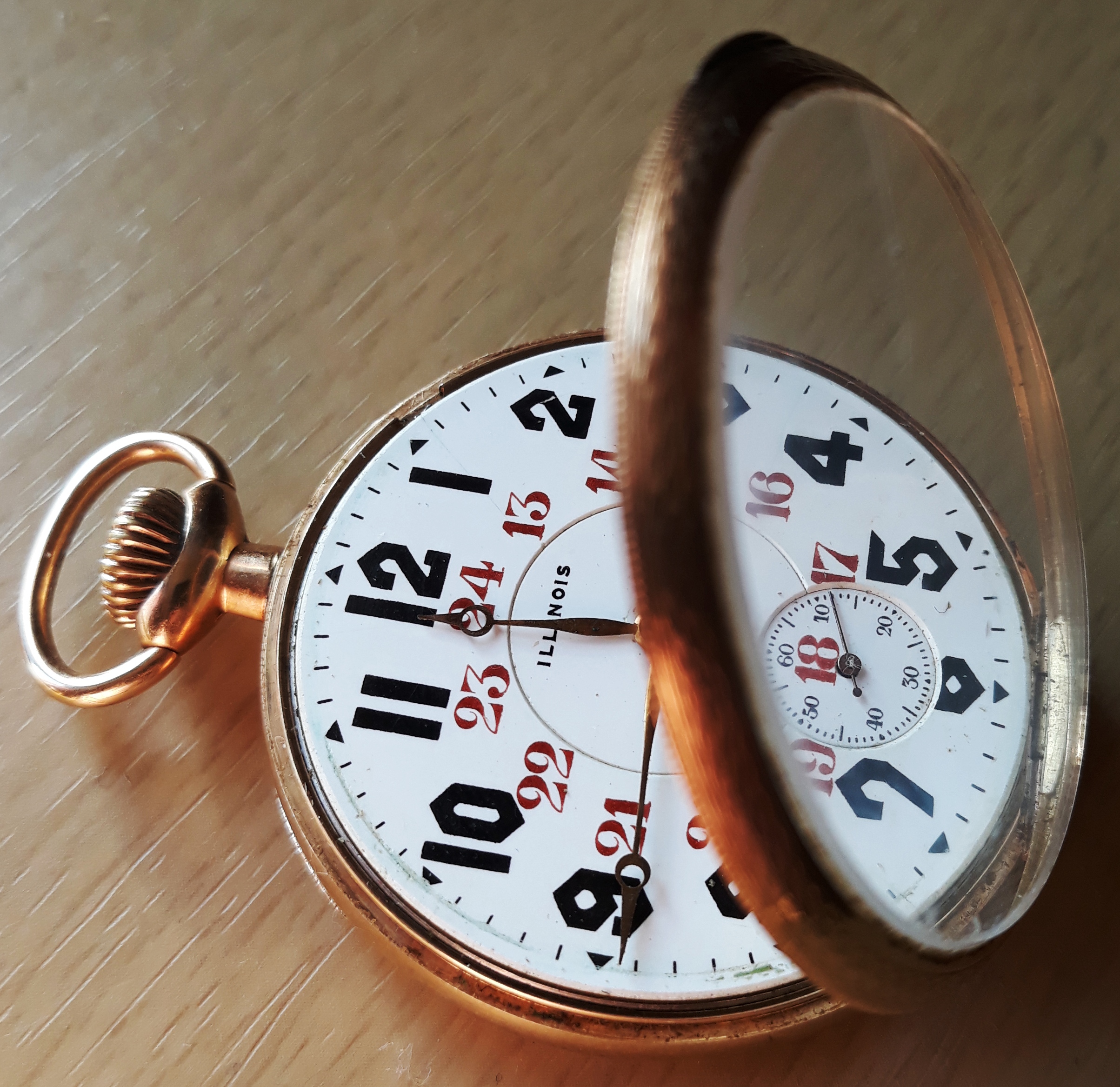

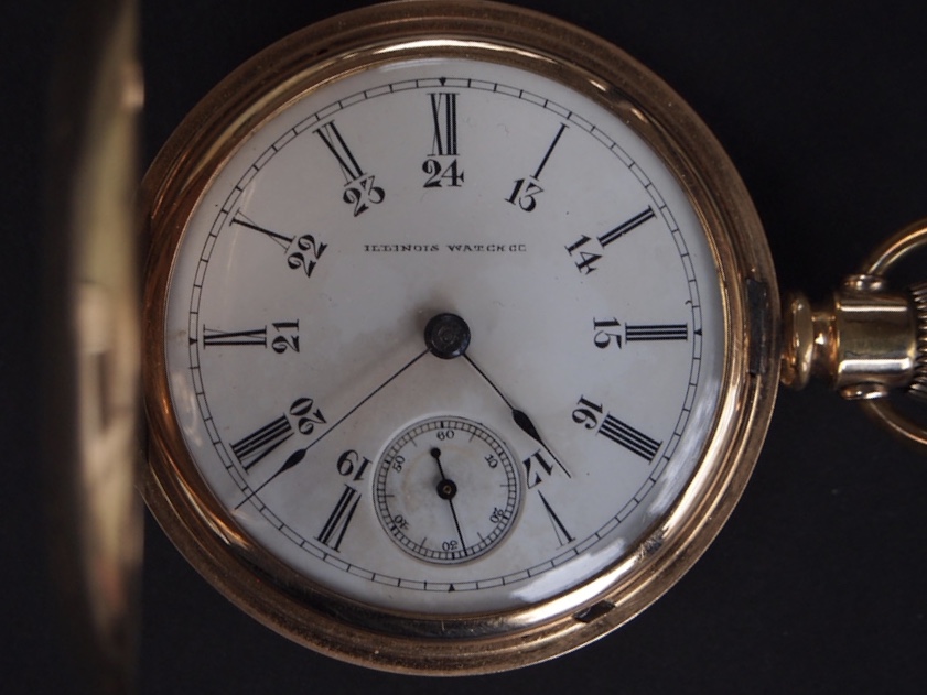

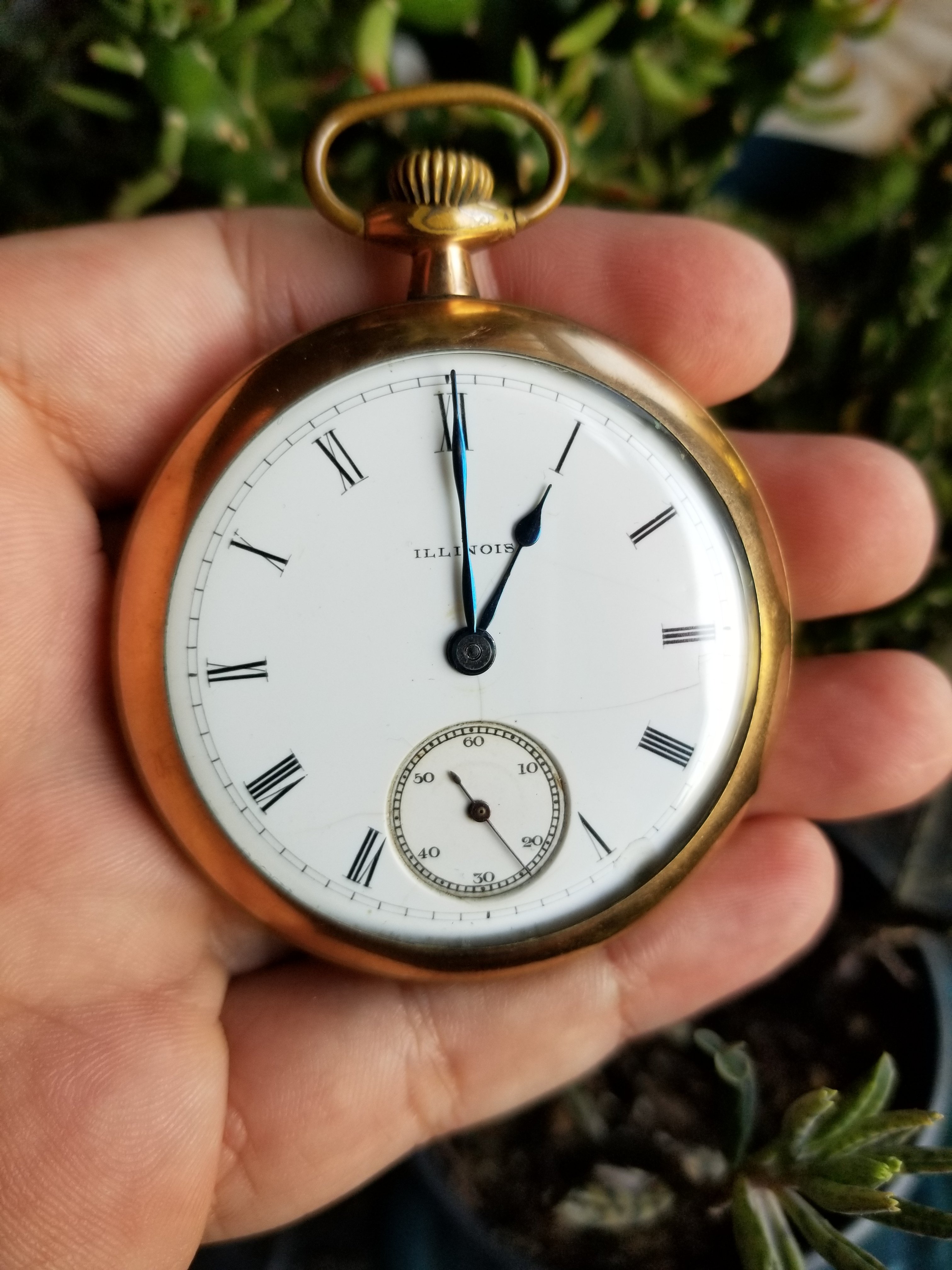

Hi, here's my Illinois. Please for comments and informations. Thank you
I like everything about this one. That dial is outstanding!
