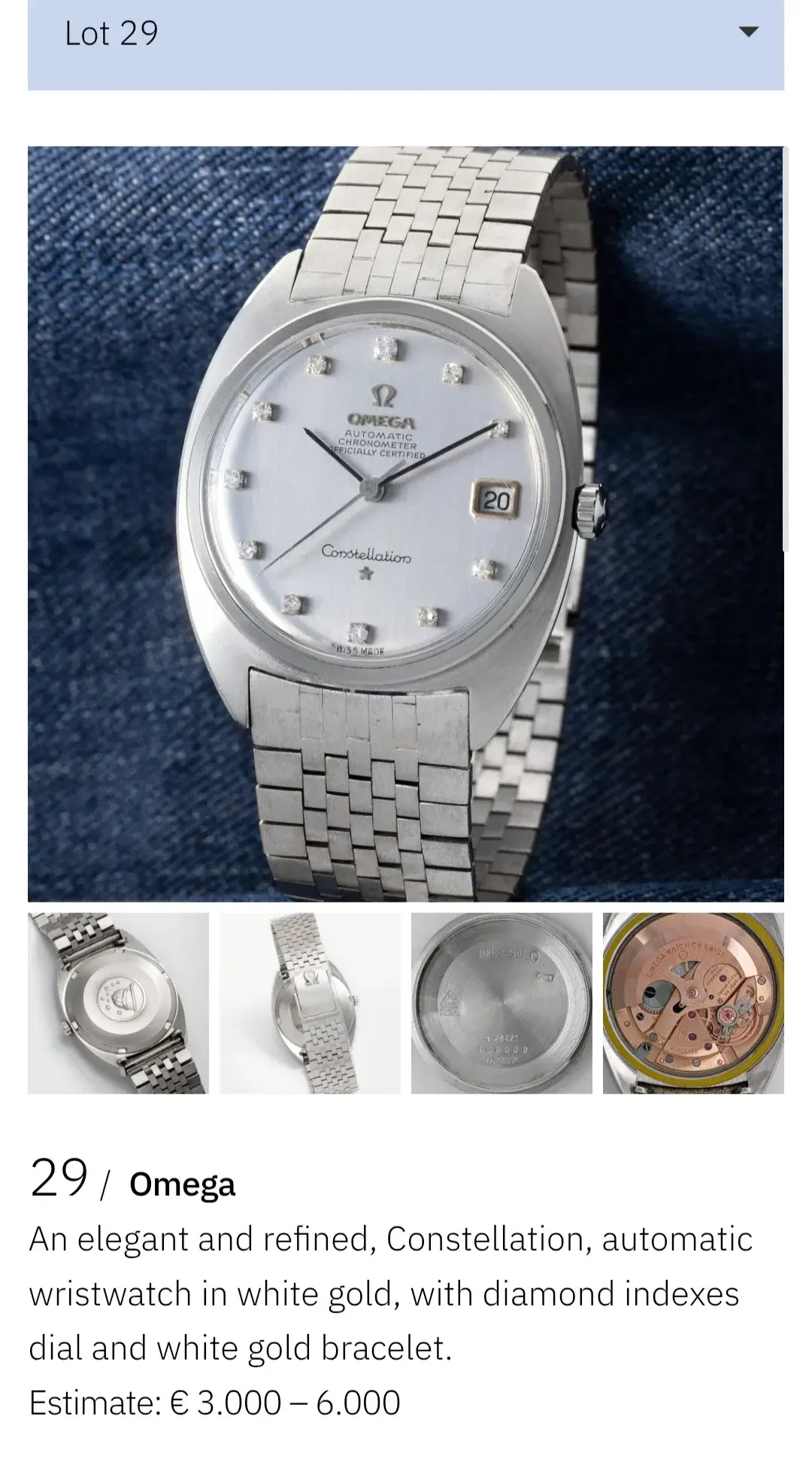

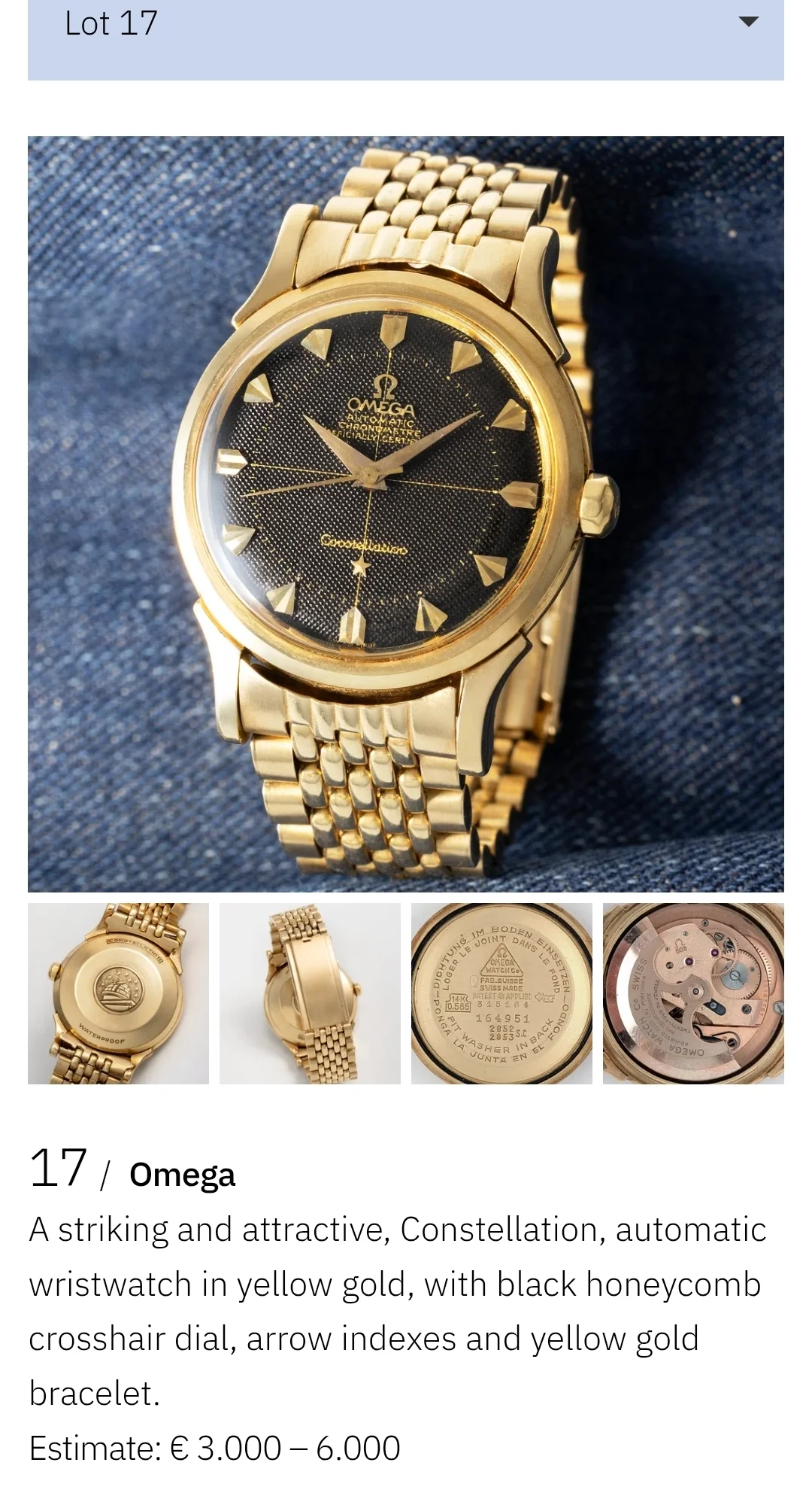

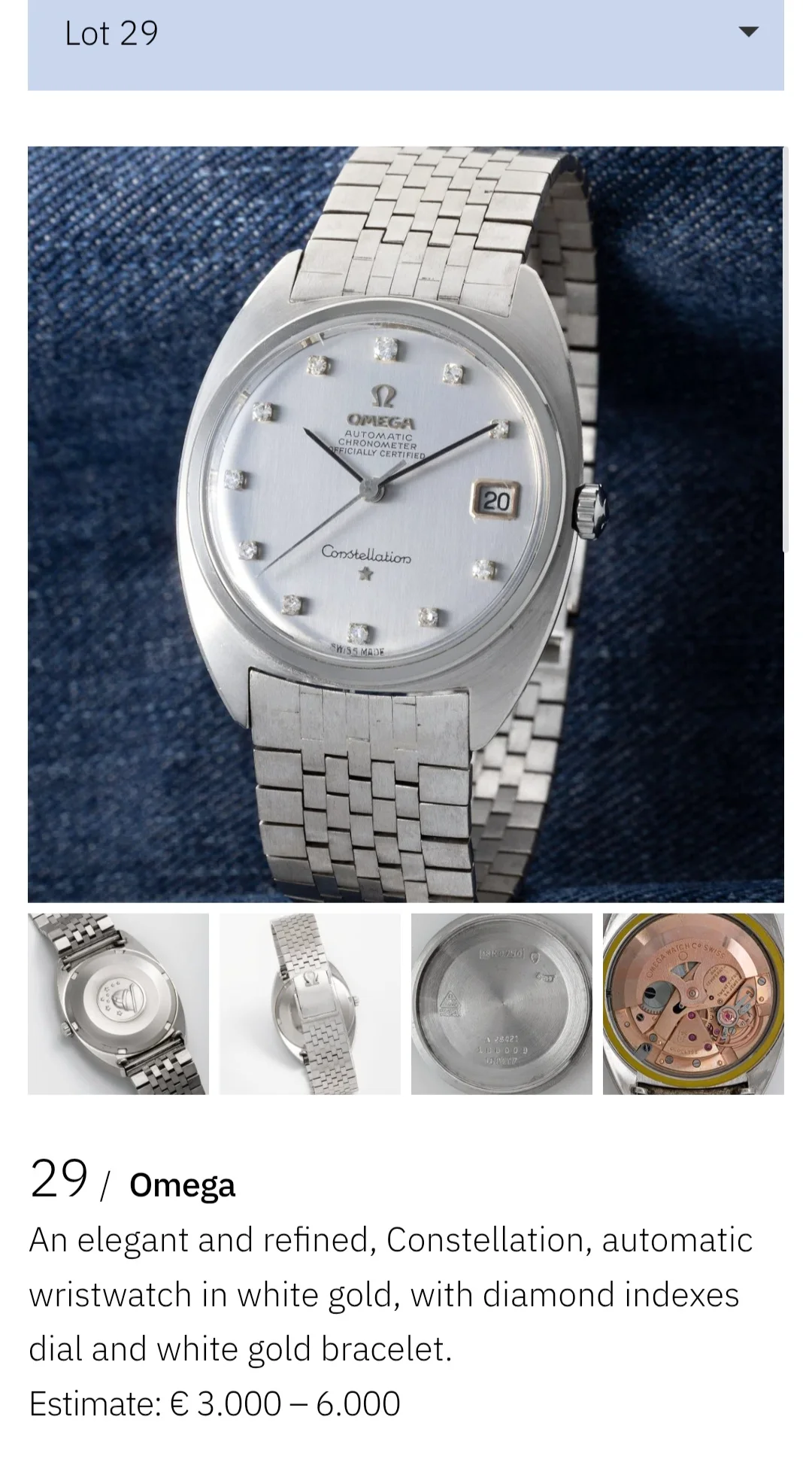

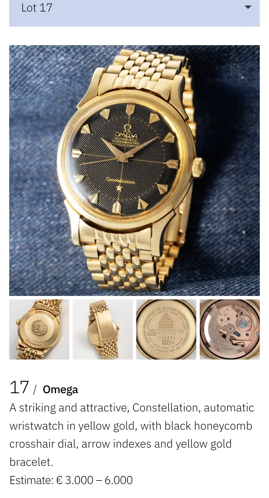

I'd say mixed, I mean the Franken Connie and some of the other shabby ones will probably come in within estimates, but there are a lot of gold pieces, some on gold bracelets, that are wildly under estimated.
A couple examples...
Lot 17. Black waffle 18KT Constellation with arrowheads and ( non Omega ) 18kt bracelet €3-€6K
Lot 29. White gold 18kt/diamonds C-Shape Connie on 18kt bracelet
€3-€6K

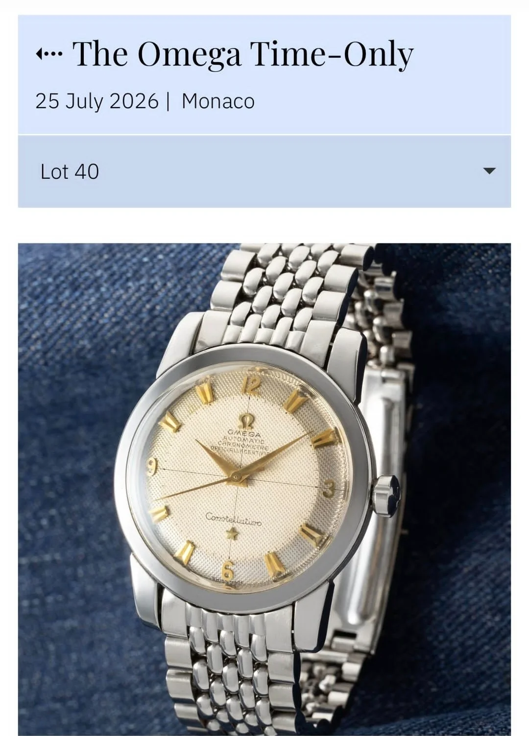

Lot 1 - hands don't look right
Lot 27 as mentioned - rep dial - wrong movement
Lot 39 Not even sure. Never seen that dial with a gold plated case. Gold plated crown and off color bracelet
